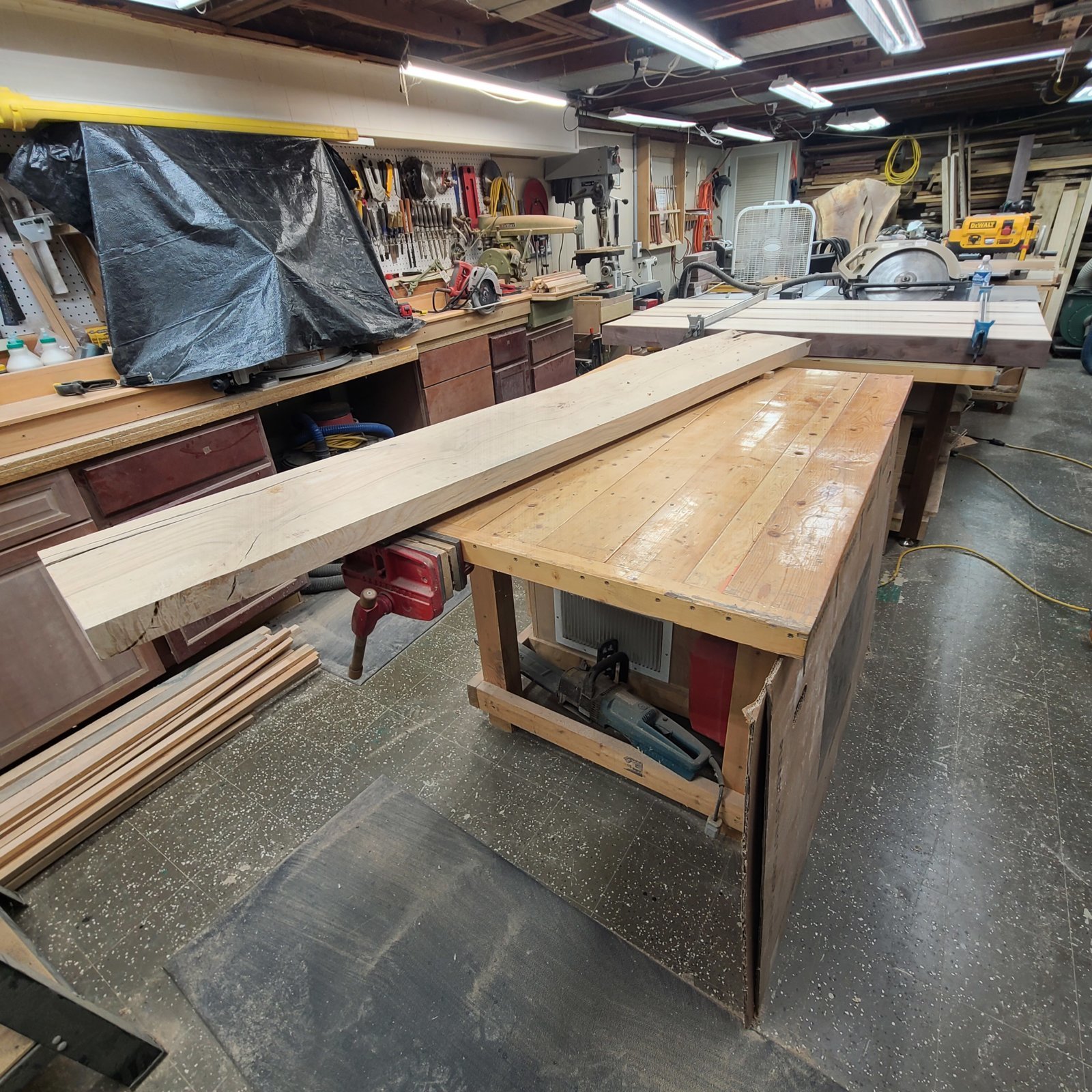

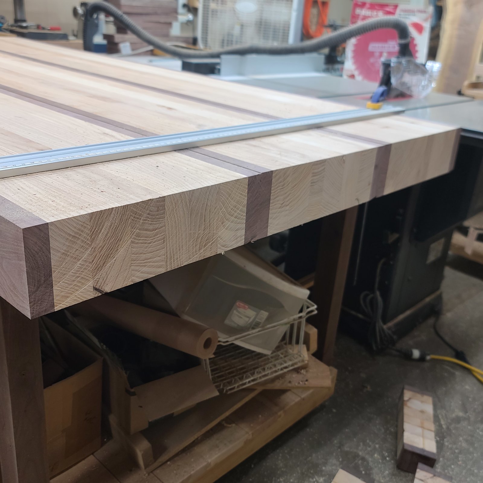

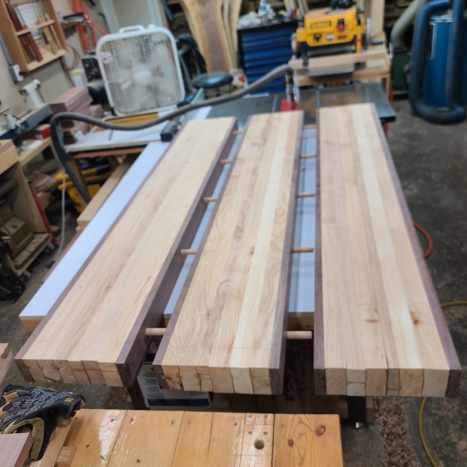

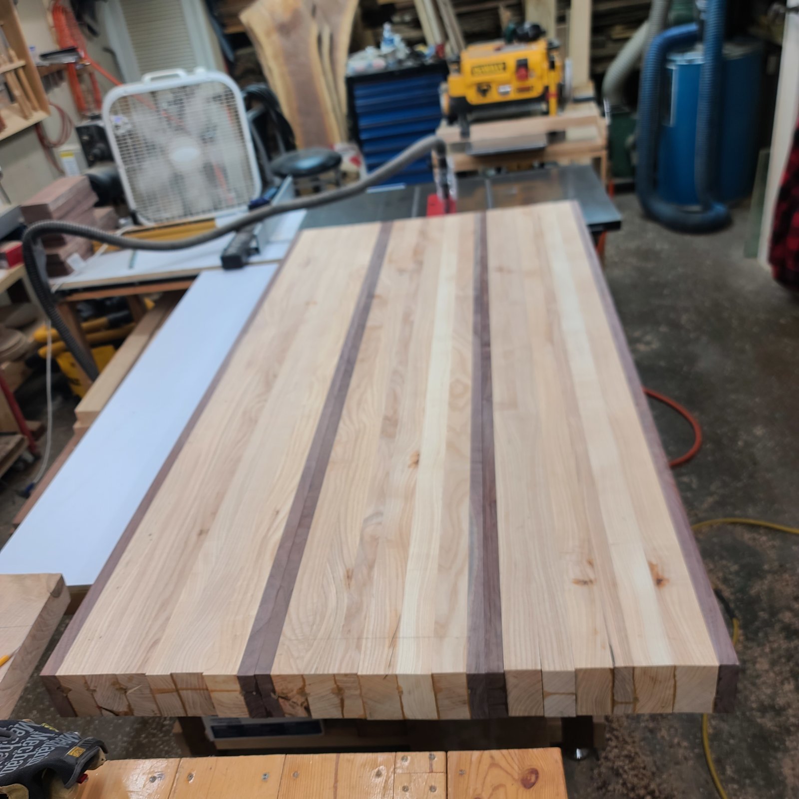

    Today's bench top progress.
    All the holes are drilled, dowels sanded, and inserted.
    Here's the top closed up with the dowels inserted.

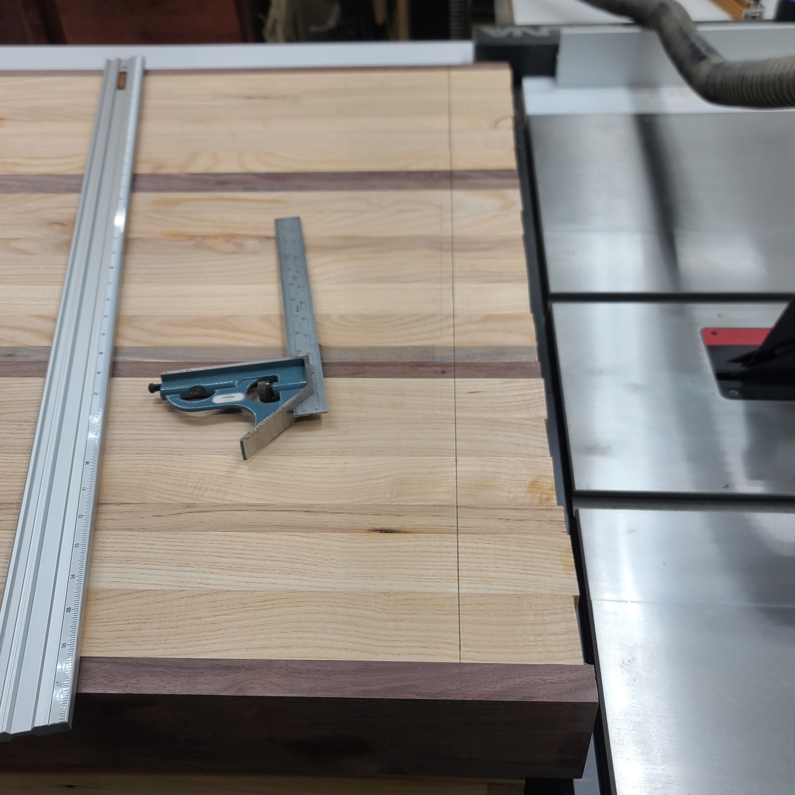

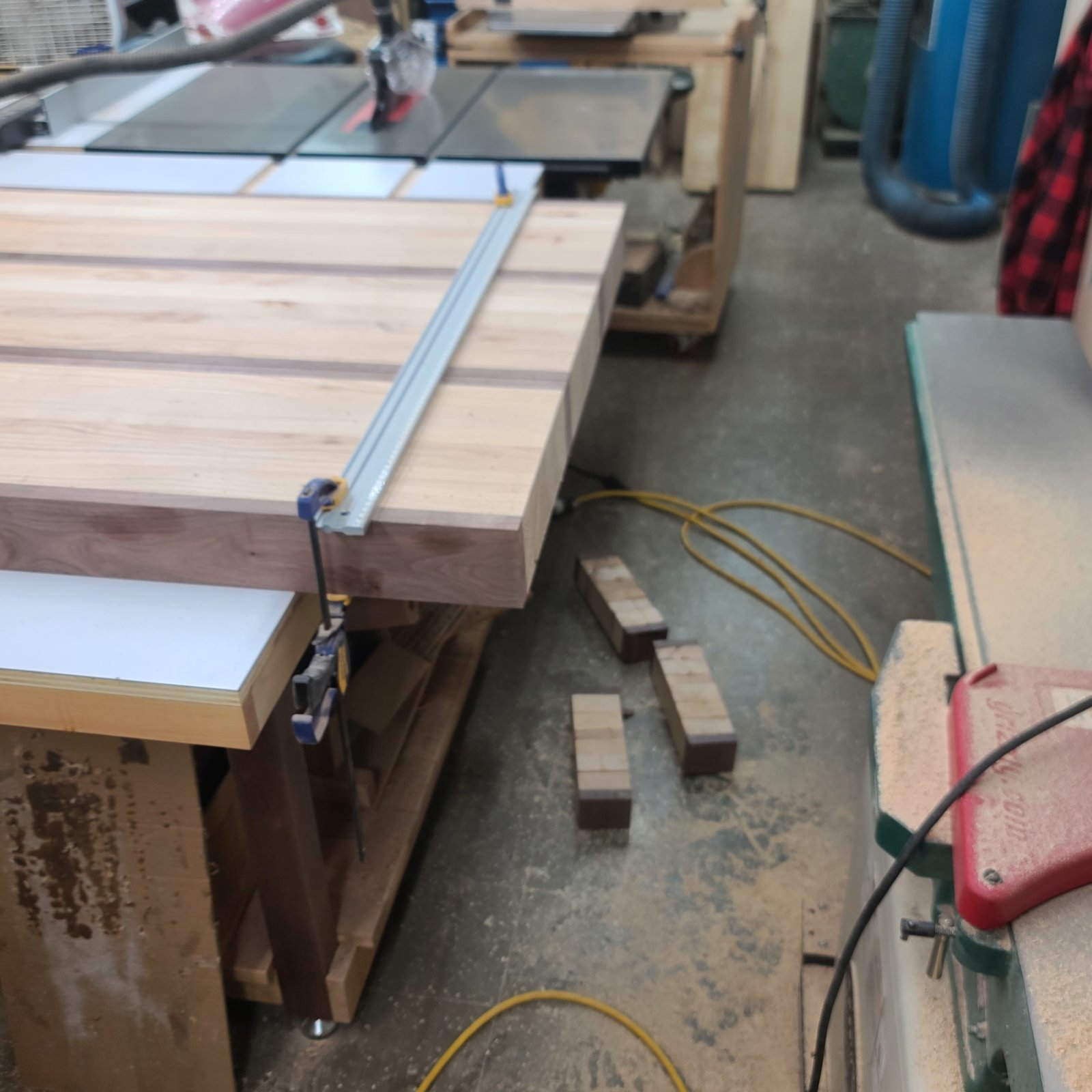

    I did some layout to cut the top to length. Ill be cutting about 2 3/4" off each end.

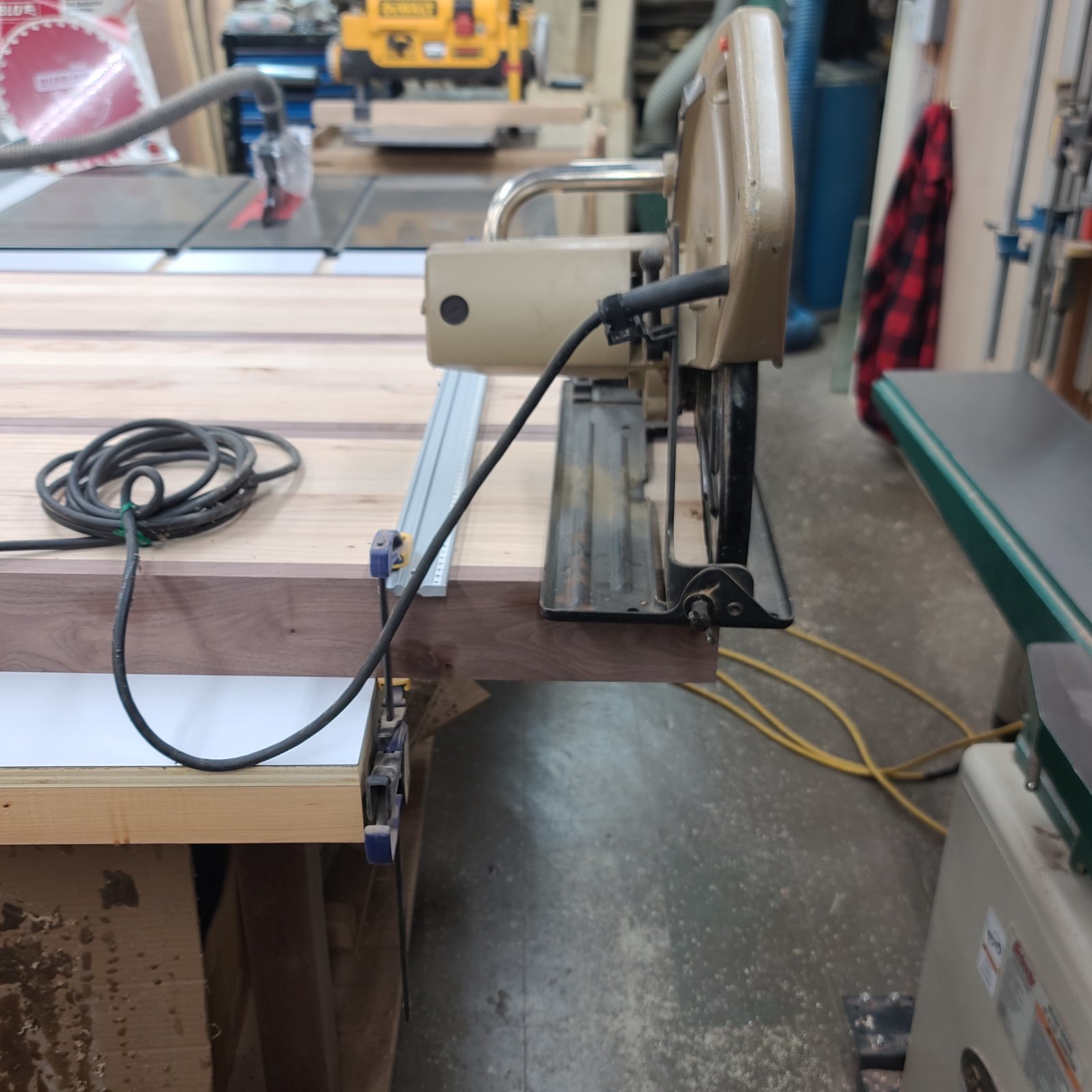

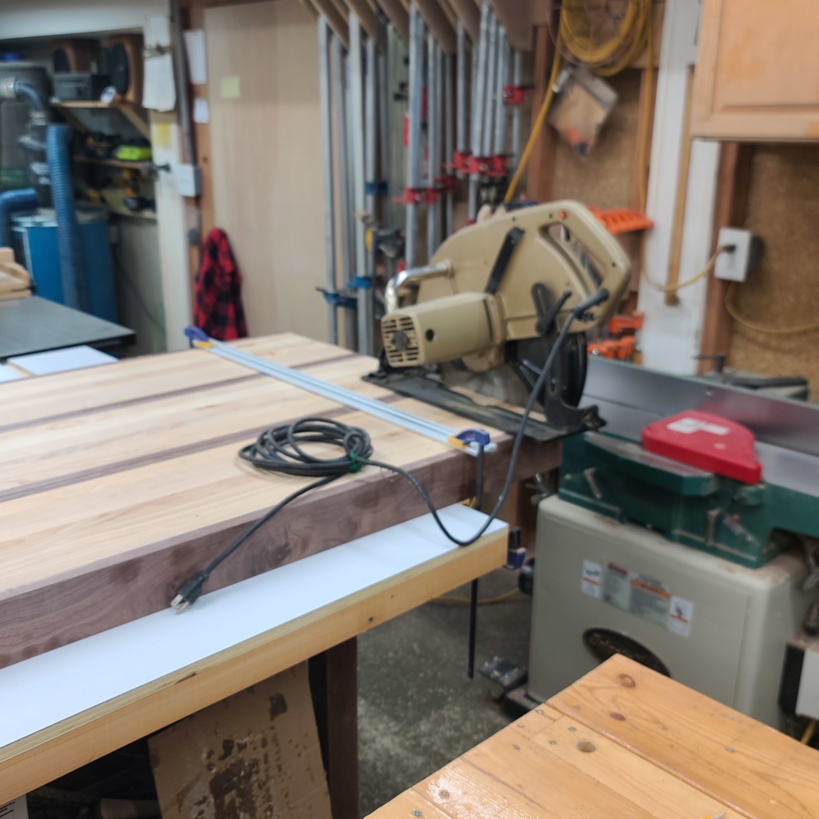

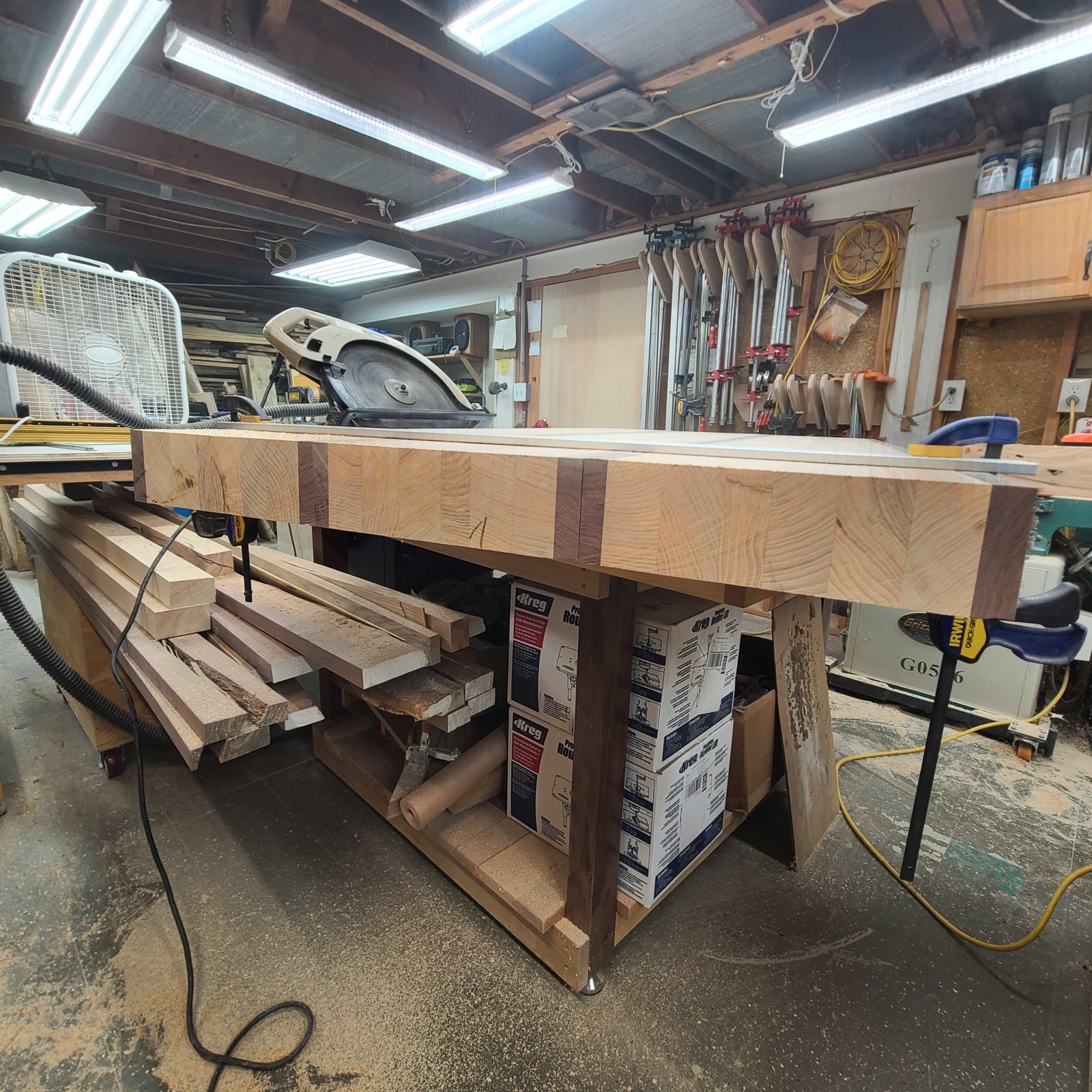

    I'll be using my Makita 16" beam saw to cut through the 3 1/2" thick top.
    I clamped a straight edge on the top to use as a saw guide.
    Cut like a dream.
    Pretty clean cut that will sand up nice.
    Both ends are now cut to length. Top finished size is 5'6" × 36" × 3 1/2" thick.
    A view of my old bench.
  5. Nov 15, 2023 at 6:16 PM
    RichochetRabbit
    RichochetRabbit Bing Bing Bing
    Mar 6, 2023
    #419488
    6,318
    Smooth/fast AND no-burning depends on metal-to-wood contact. I once tried making fast/clean holes in maple, with both auger-bits and spade-bits. The auger-bits burned easily because of too much meta;-to-wood, while the siple spade bit was clean/fast if I drilled straight-on.
    I am not sure what auger-bits would be best for, except possibly with more power than my hand drill, straight-drill, thinner wood. Anyone who wants to set me straight, please do.
  6. Nov 16, 2023 at 2:36 AM
    woodtickgreg
    woodtickgreg Well-Known Member
    Jun 10, 2021
    #368186
    3,380
    Greg
    Michigan
    Auger bits work best at slower speeds like in a hand drill or brace as it's called. The exception is the millwaukee hole hawg right angle drill that electricians use for boring holes for wire. But those are also self feeding bits that pull themselves through the wood. And they do turn at a lower rpm.
    Forster bits cut really clean flat bottomed holes but at very slow low rpm.
    Spade bits work better at high rpm for faster clean holes. I'll use the spade bit again to drill the dog holes in the top.
    Getuponit likes this.

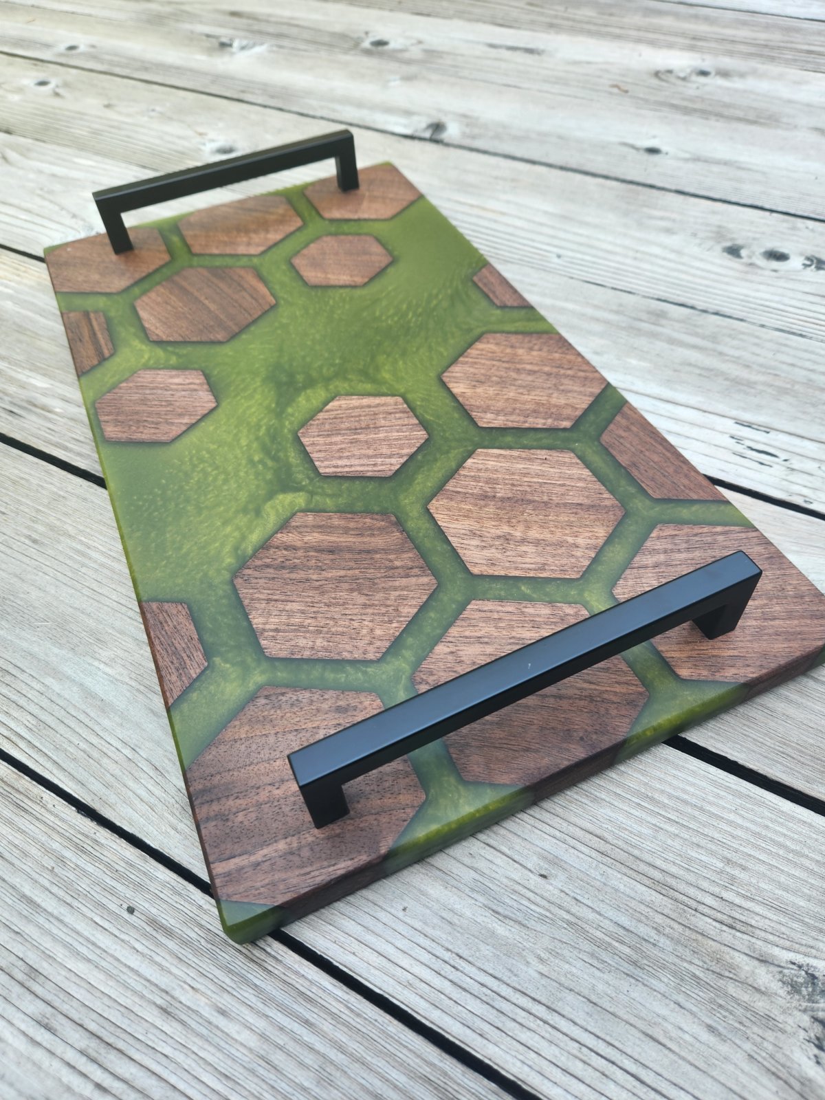

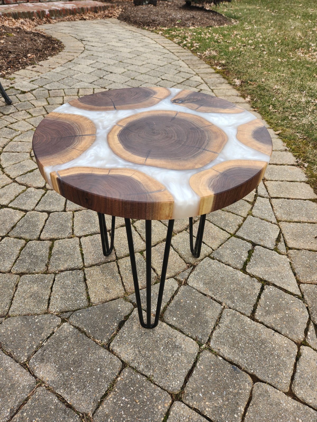

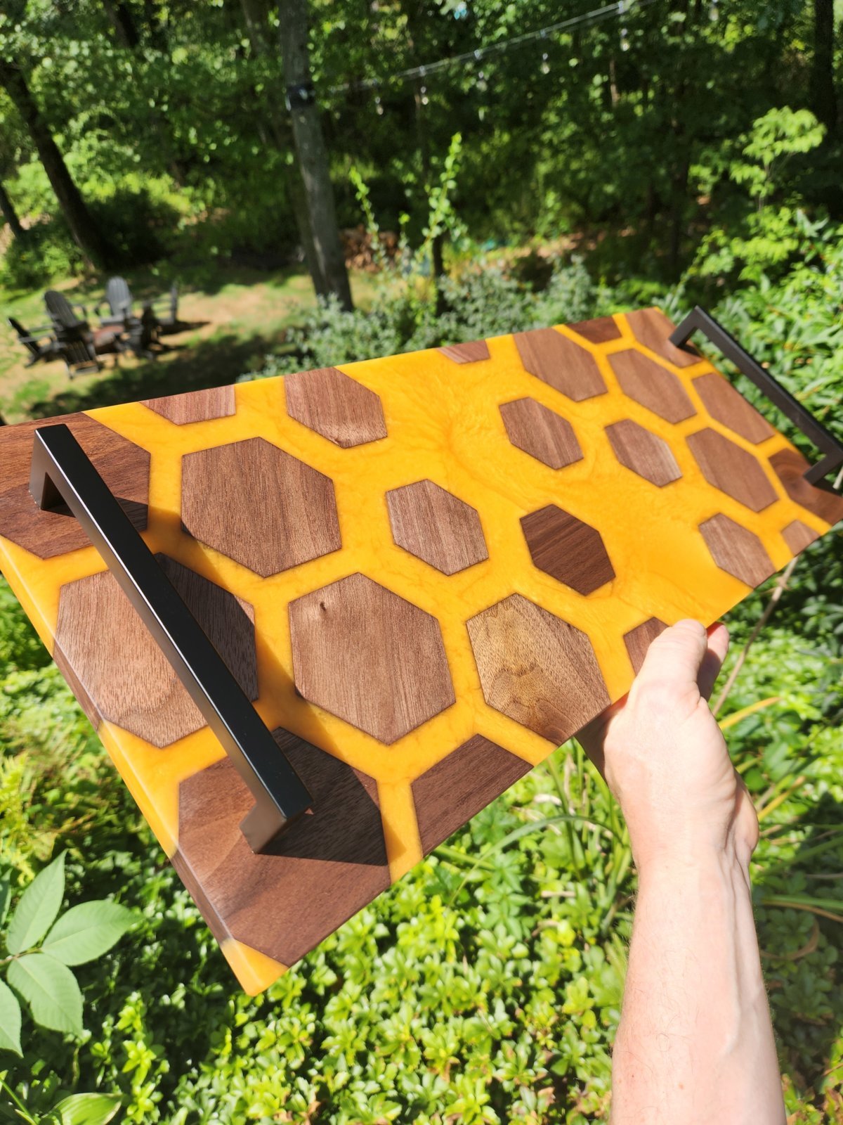

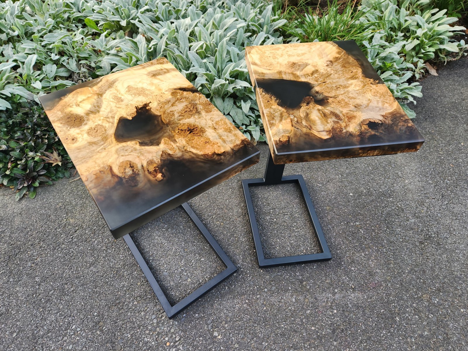

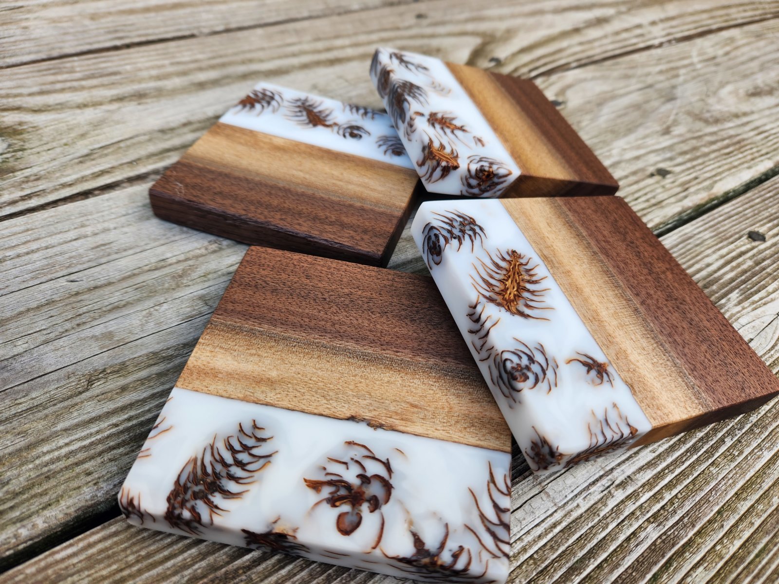

    I do a lot with epoxy. Been making small items like coasters and bottle openers, to serving boards and large tables. I use reclaimed wood a lot too. Biggest problem u have is finding cool pieces of wood and other things to embed in the epoxy. I've tried pine cones, but need to branch out.

    I remember seeing the green one before I think. These are great!! I've been saving a giant redwood pine cone i found out west for something.
    Are you anywhere near the mid Atlantic? I'd love to watch someone else do it in person before I try.

    I live in North Jersey. Don't know if it's worth the drive. Epoxy work is 15 minutes of mixing and pouring and 2 days of waiting for it to cure, then just a lot planing and sanding after that. I can definitely help you or anyone else out with some tips! Epoxy can be have a steep learning curve...and it's not cheap either. It's about $80-100 per gallon. But it's a lot of fun when you figure it out.
