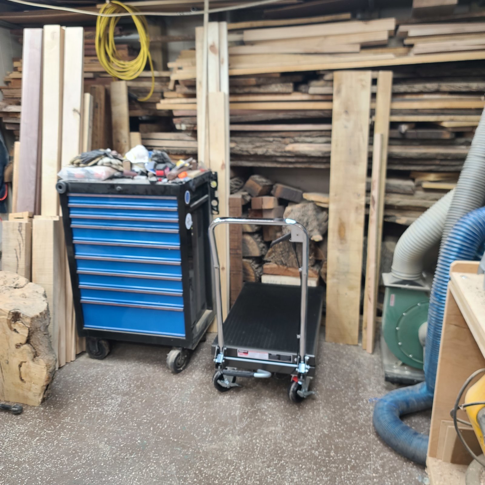

    After work today I had a little time in the shop to move some wood around and make room for the new planer cart. Found some volunteers for the fire pit too, lol. I have so much wood I can be picky about what I keep, I've got to start letting go of every little tiny scrap!

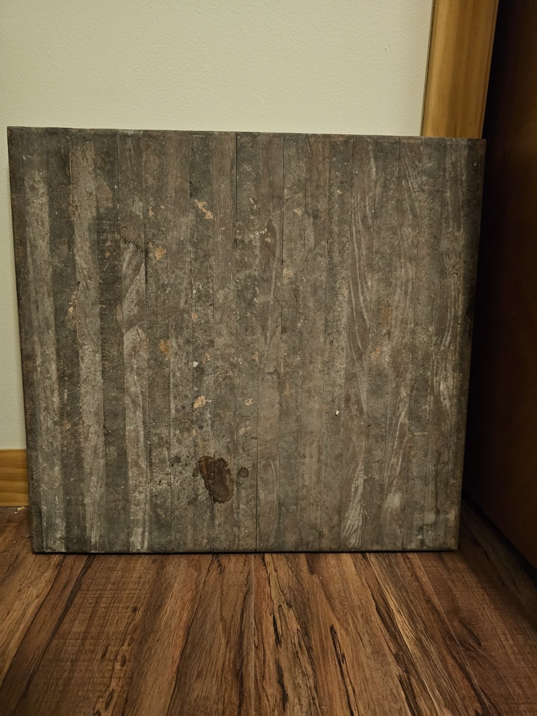

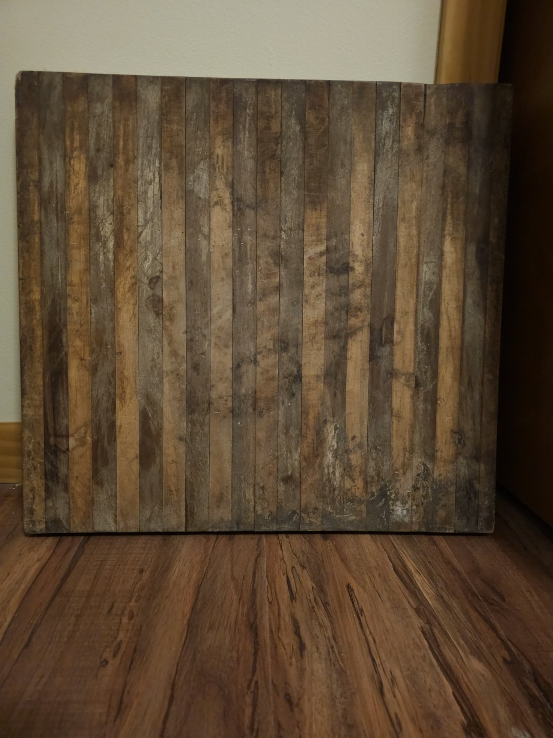

    A coworker asked if I could restore a cutting board and it's not something I've ever done before. I know my initial thoughts are no way based on my experience but it has sentimental value.
    Sure I could run it through my drum sander but I'm not sure about this.
    What are your guy's thoughts on this?

    Drum sander and a new coat of butcher block oil
    how thick is it?

    I don't know yet... I just have those photos

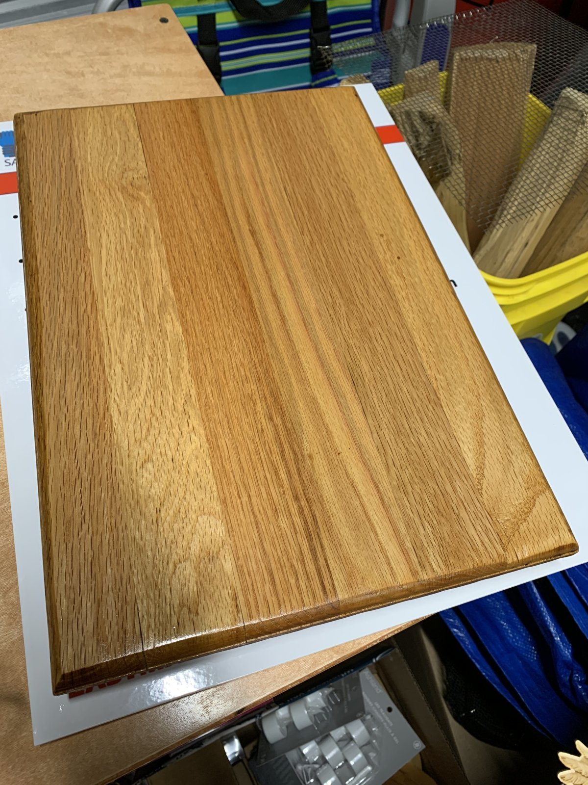

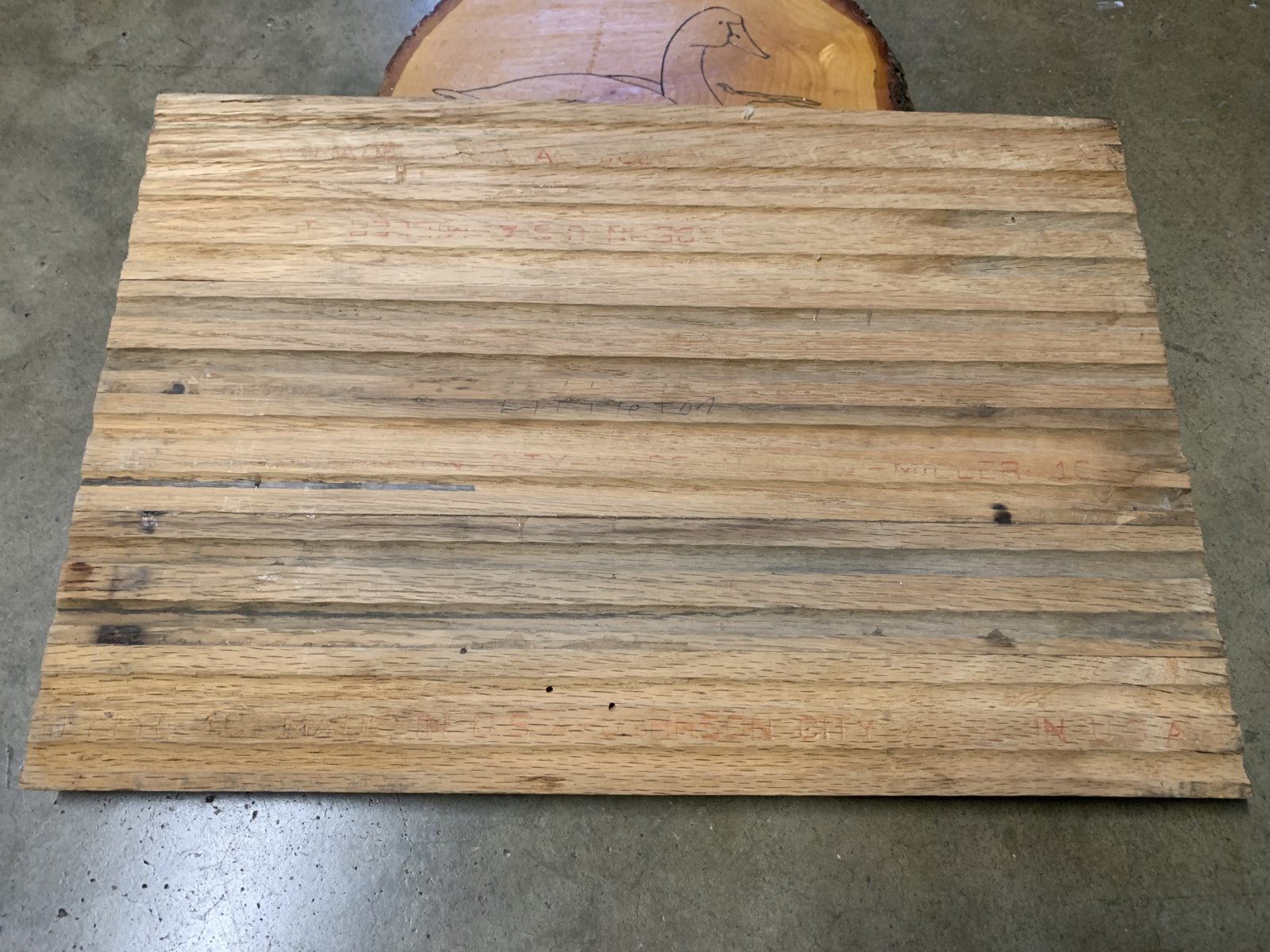

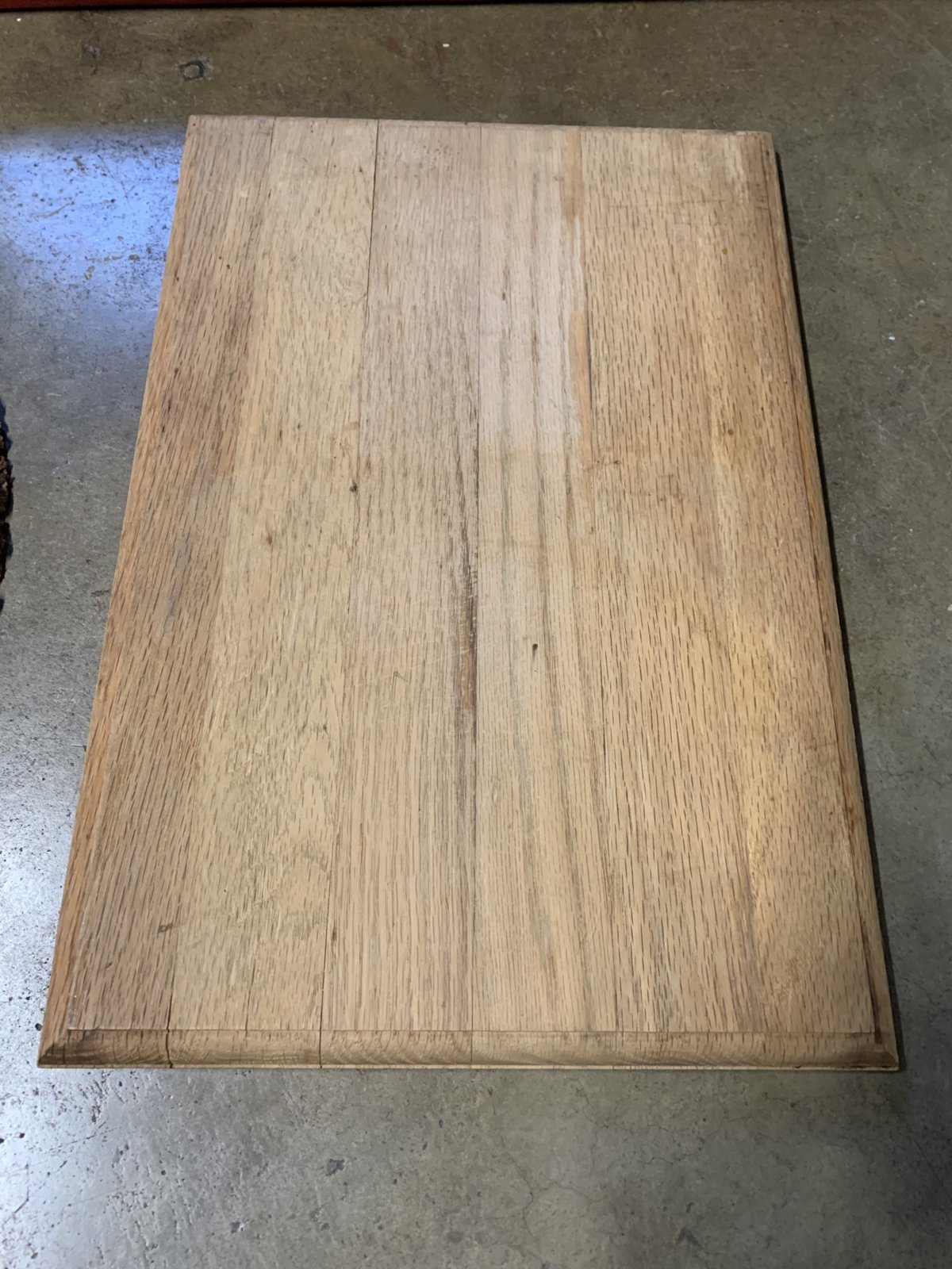

    I restored this one a while back, ran it through a planer and shaved off the least amount possible.
    After oiling

    Apparently it's 15 3/4 by 16 3/4 by 1 1/2 thick... a little too wide for my planer so I'll have to use the drum sander if I take on the project.

    Take a 1/8 in off and it’ll be perfect I bet.

    I've restored one before. Yup a few passes through the drum sander cleaned it right up. Then oil and waxed it.
