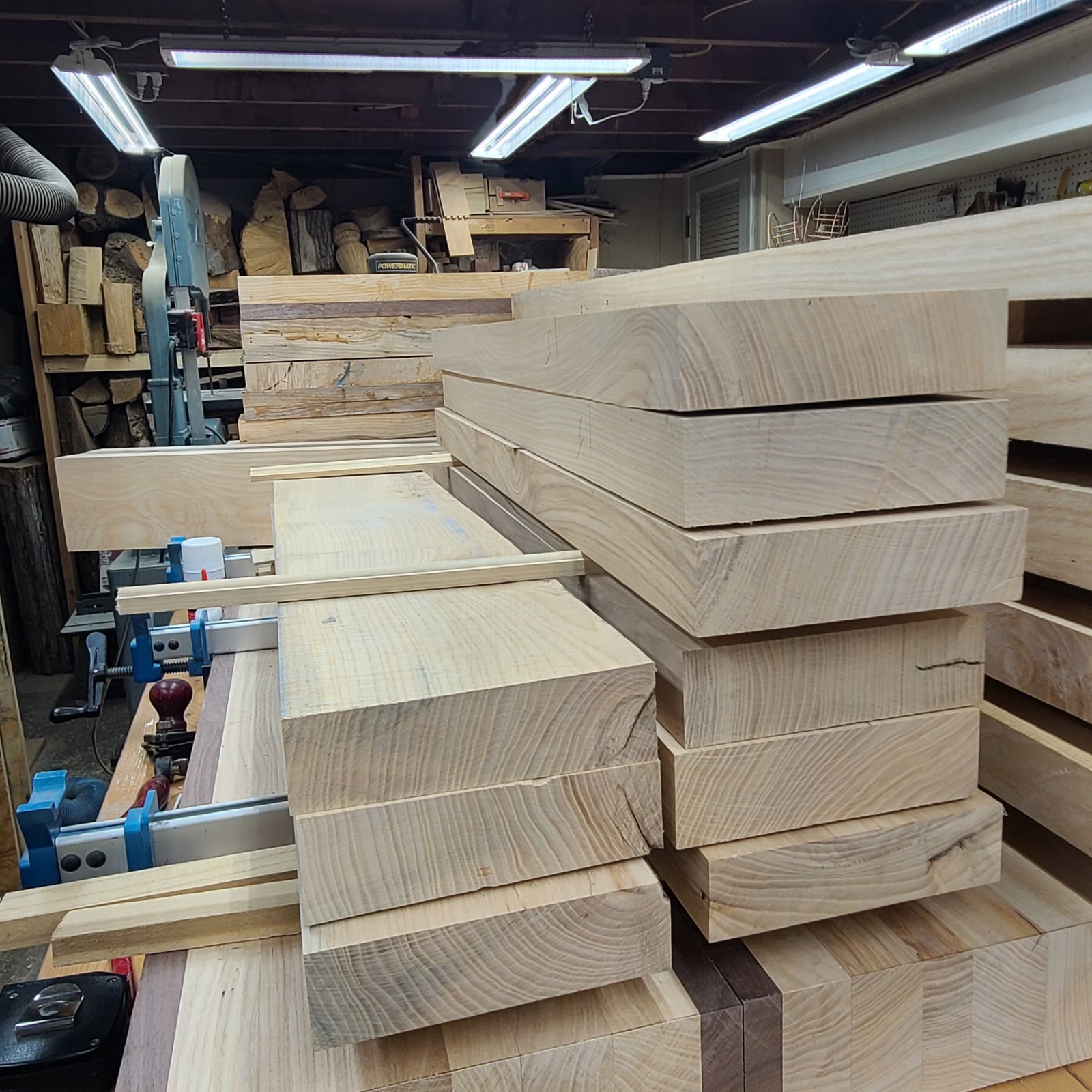

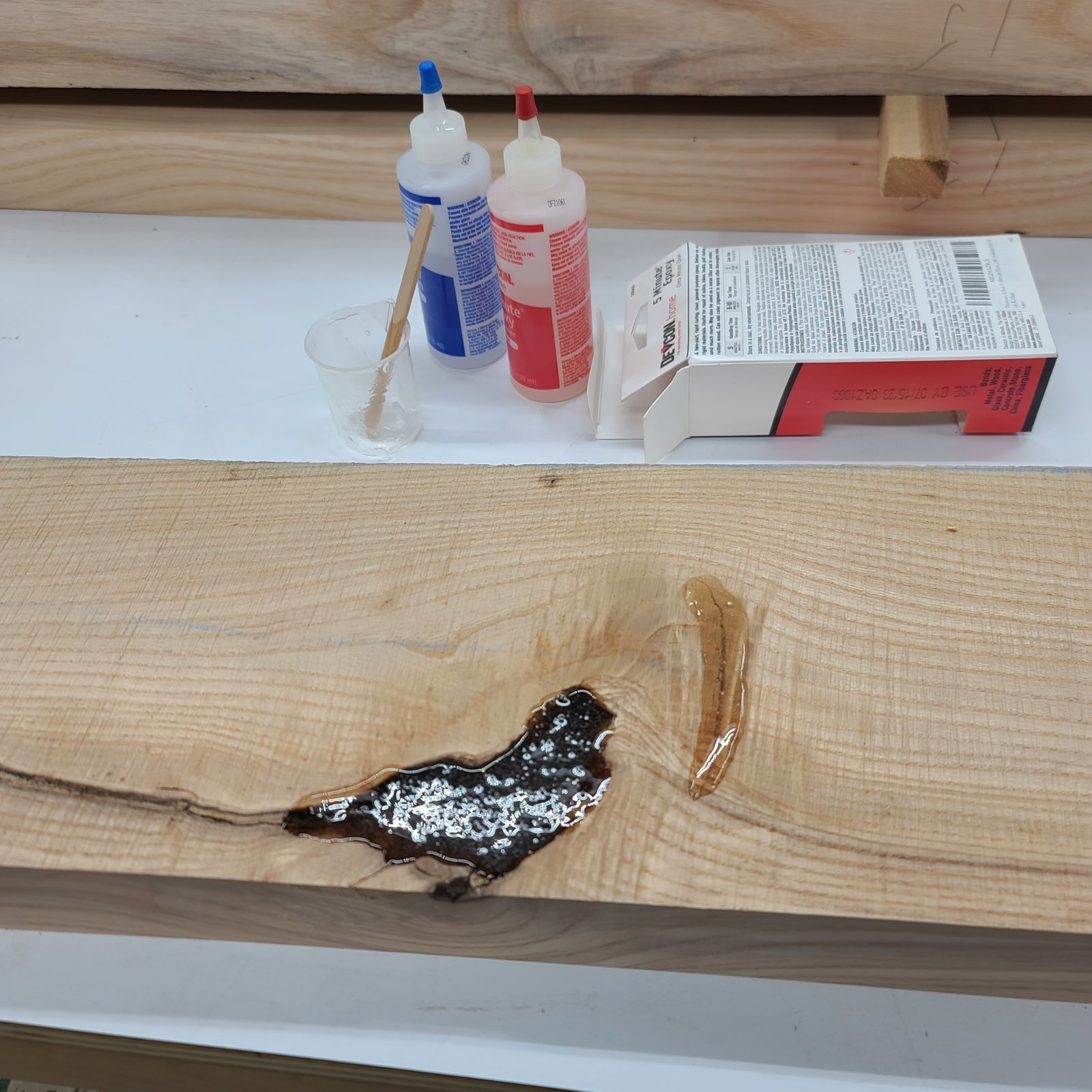

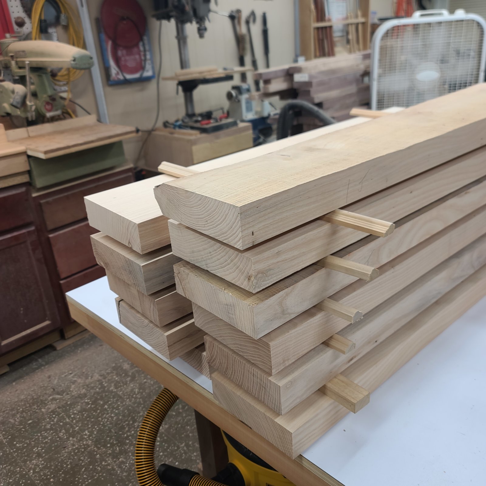

    Well I got pulled away from the bench build for awhile with family and other projects but I'm back at it. So after work today it was down to the shop.
    I ran all the stock for the leg end cross stretchers through the jointer on 2 sides.
    One board had a pretty big bark inclusion so I cleaned it out and filled it with epoxy. It won't be seen because it will be used in the center of a glue up.

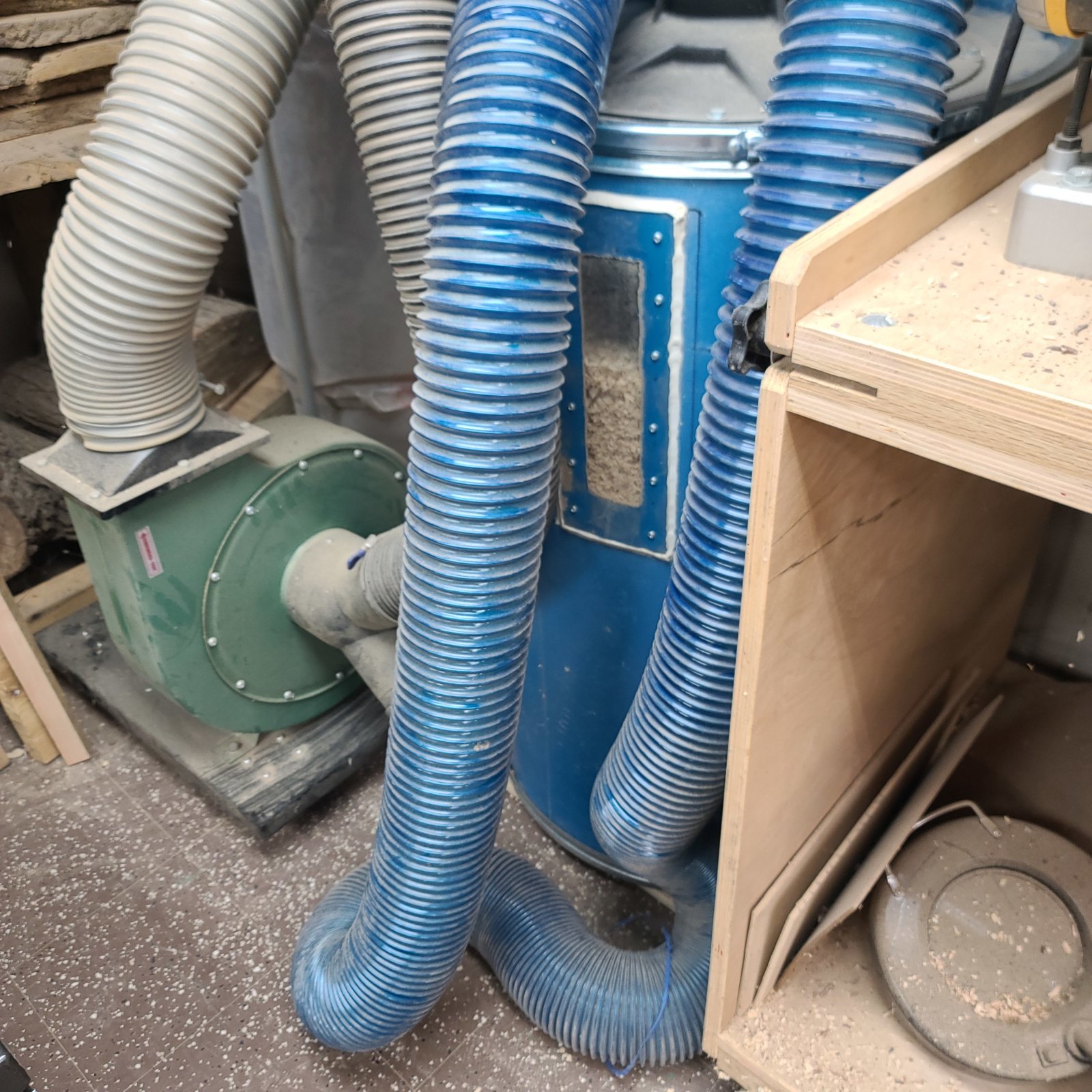

    And of course I filled the dust collector drum again, so I emptied that while I was at it.
    Next I'll run the 4 ugliest pieces through the planer so the 2 flat surfaces will be parallel for the glue ups.
    Those will be used in the center of the glue ups and will be pretty much hidden.

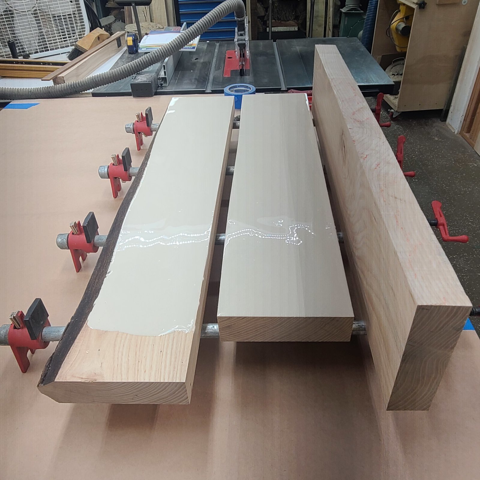

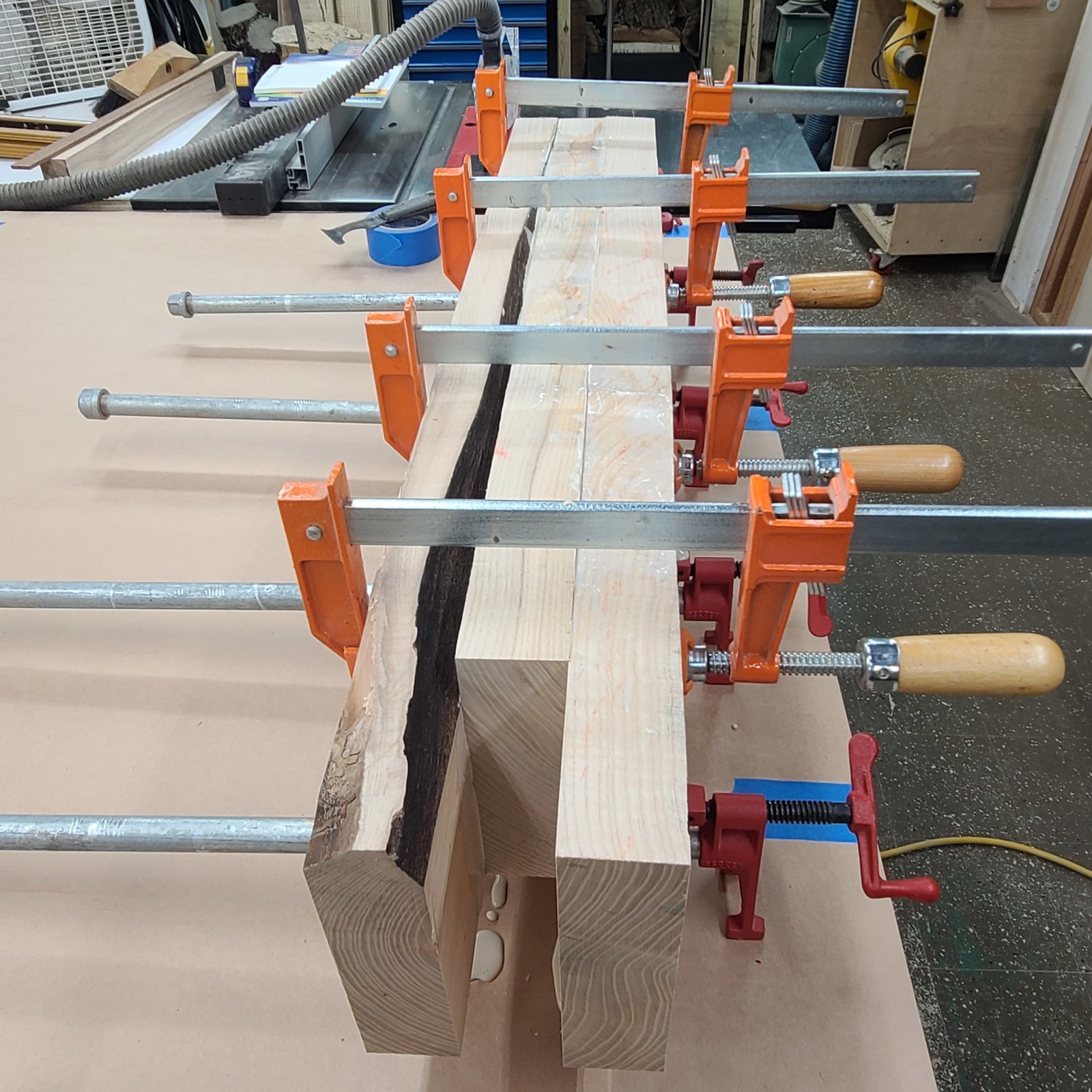

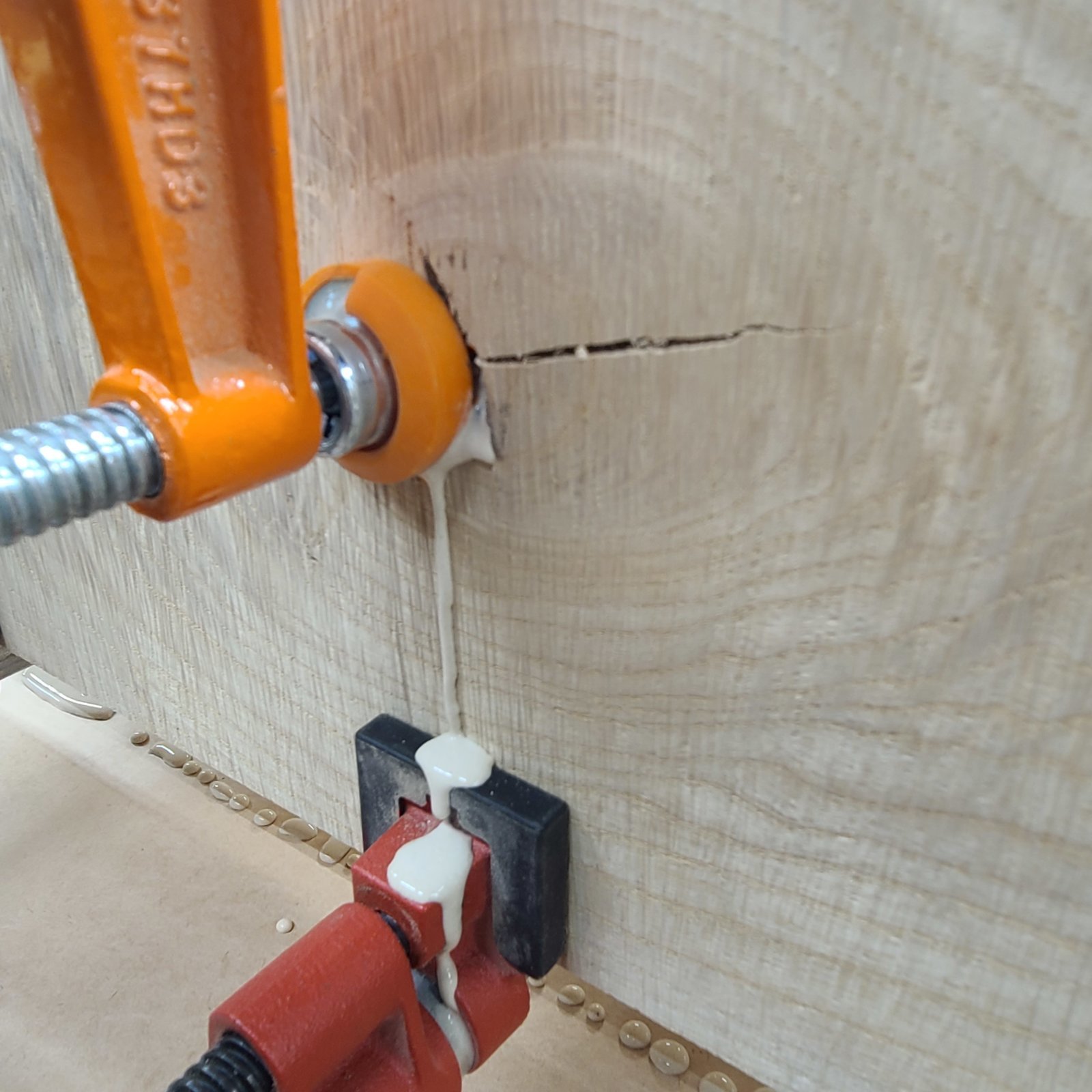

    Started the glue ups for the leg cross stretchers. Ugly board will be planed away or cut off, it will go on the ground and won't be seen.
    Glue squeezing out a knot means good clamp pressure, lol.
    3 to go.

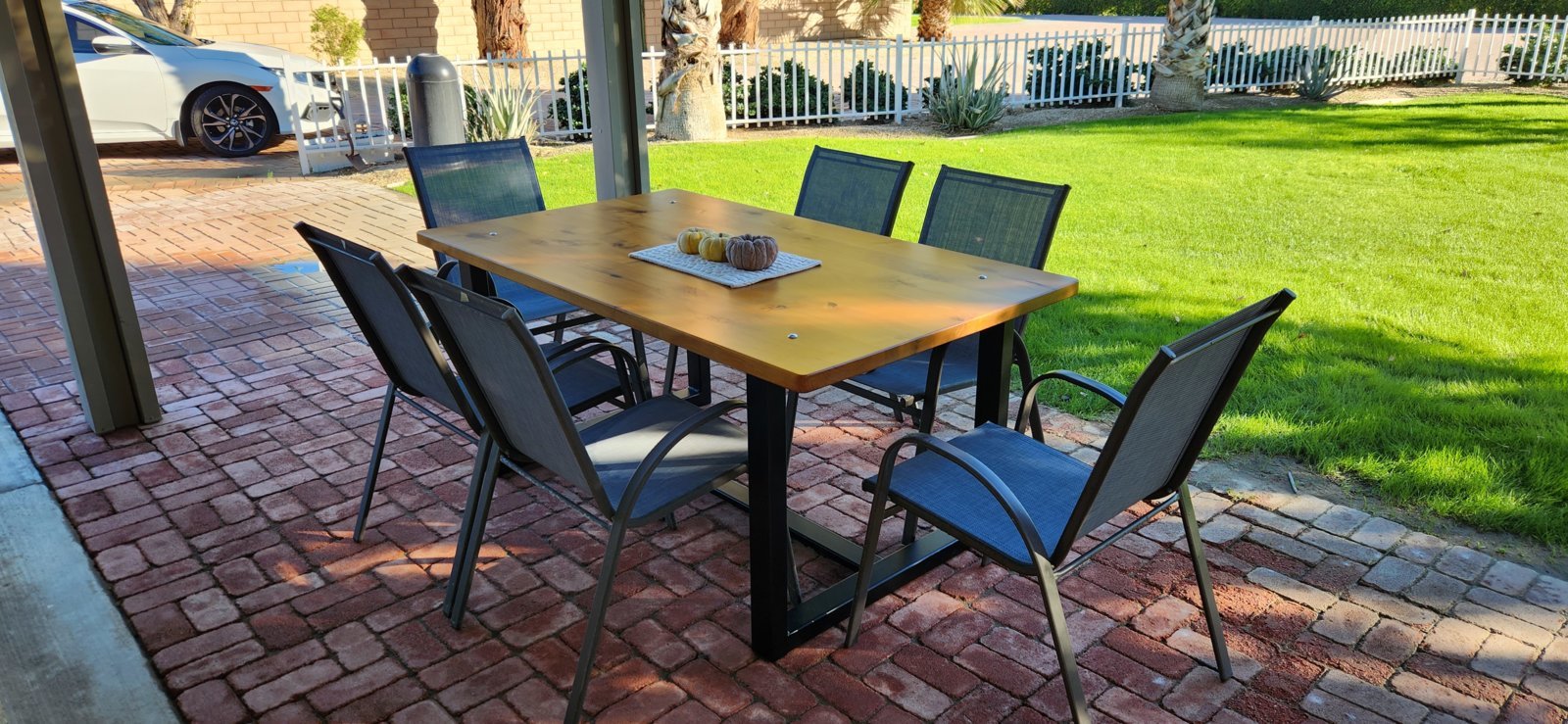

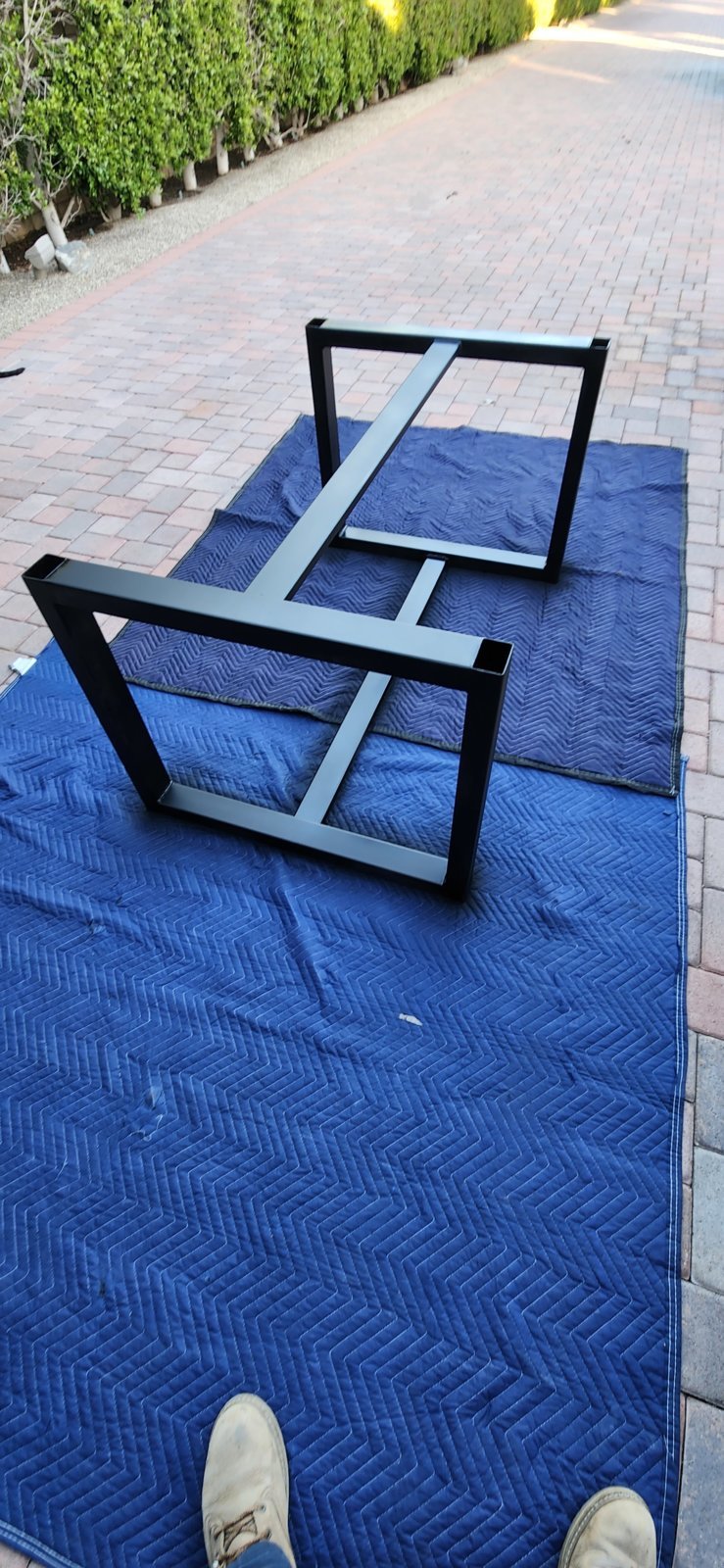

    I work in both medias

    Looks really good!
    I meant more than just square tube and welding.

    I'm definitely still a n00b with metal , so I'm keeping it simple.

    No way dude, your execution was awesome and that's a beautiful piece I didn't mean it that way
    I meant, I'd love a local to do a hardwood top, or background piece, or more for stuff I'd cut on CNC or fabricate
    Love that industrial look

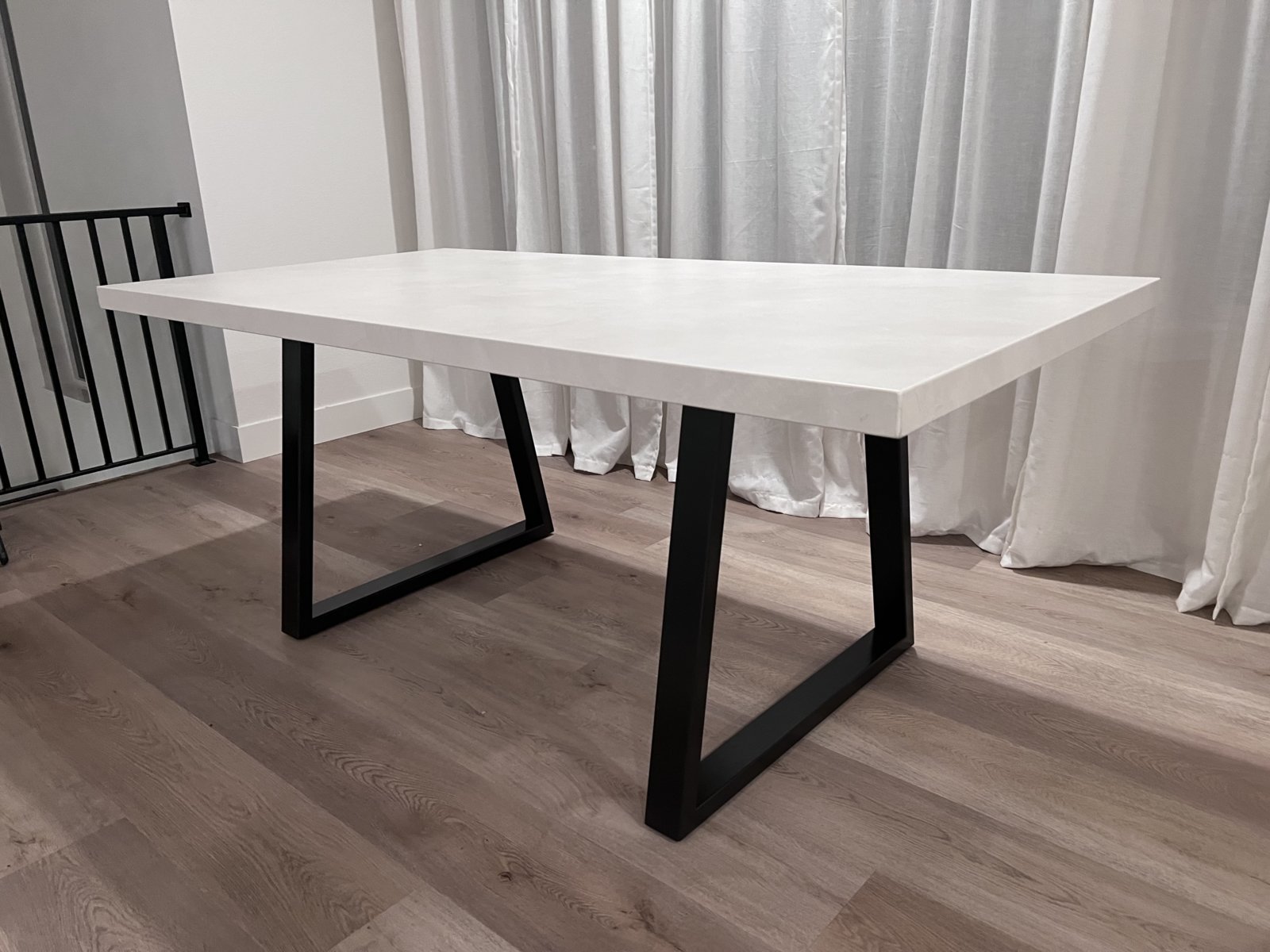

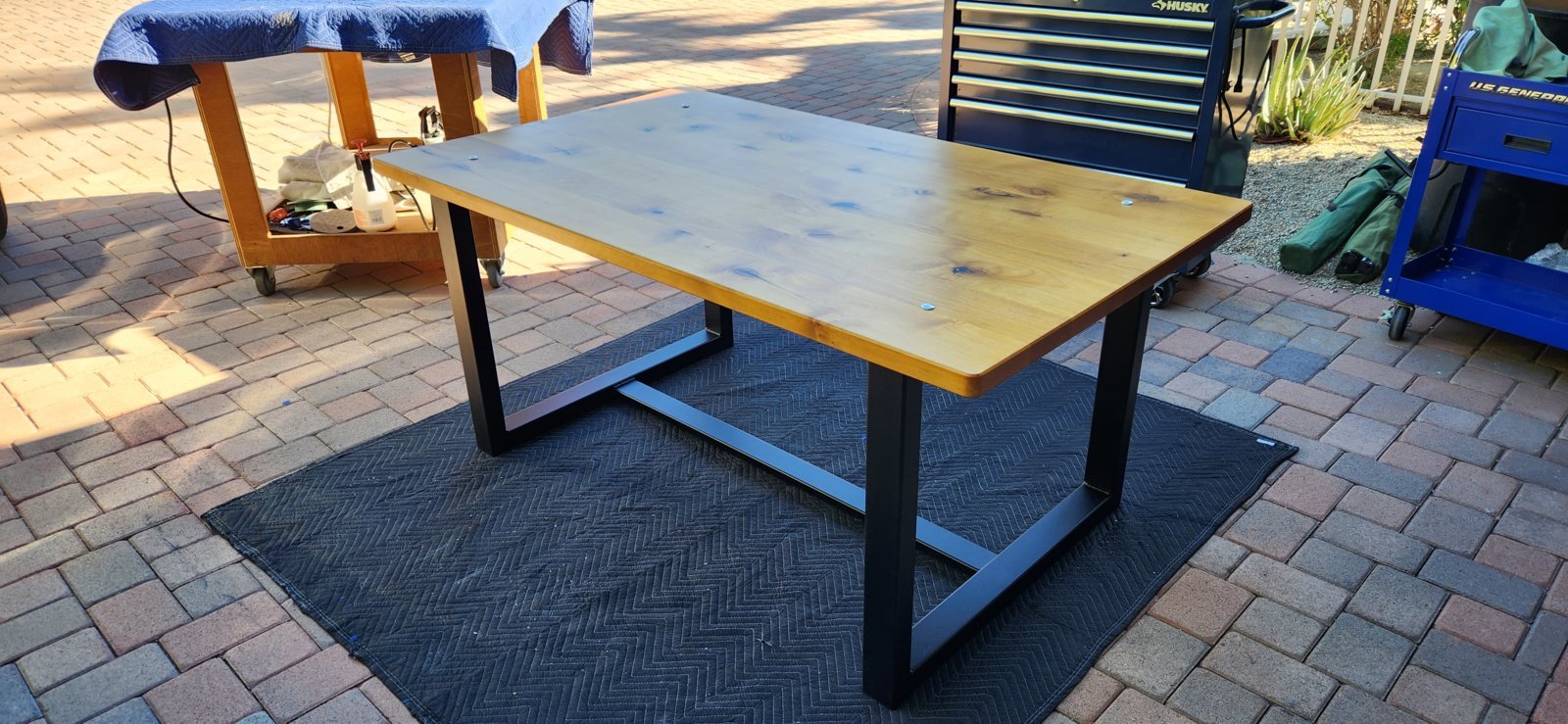

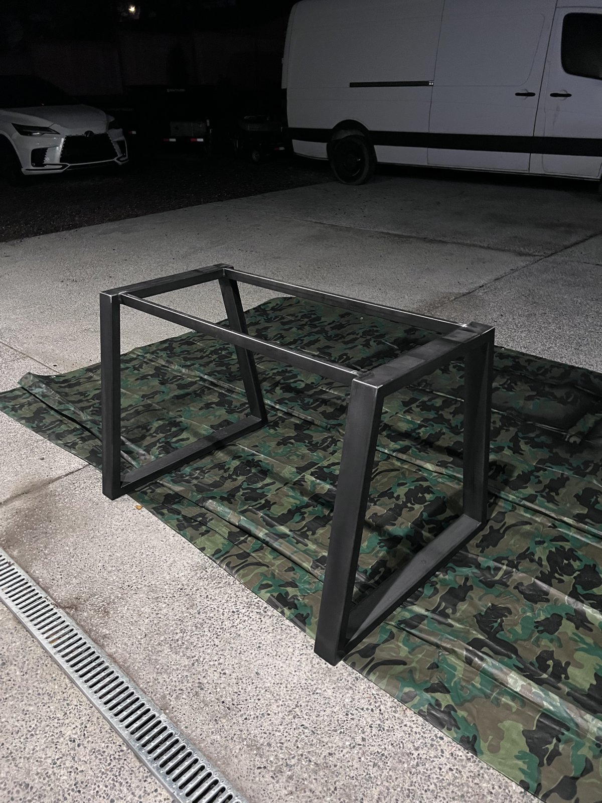

    Love it. I did a similar design last week on my first table how did you calculate you and goes? Hers a pic of how mine came out. Did 2 smaller post on top and it was solid.

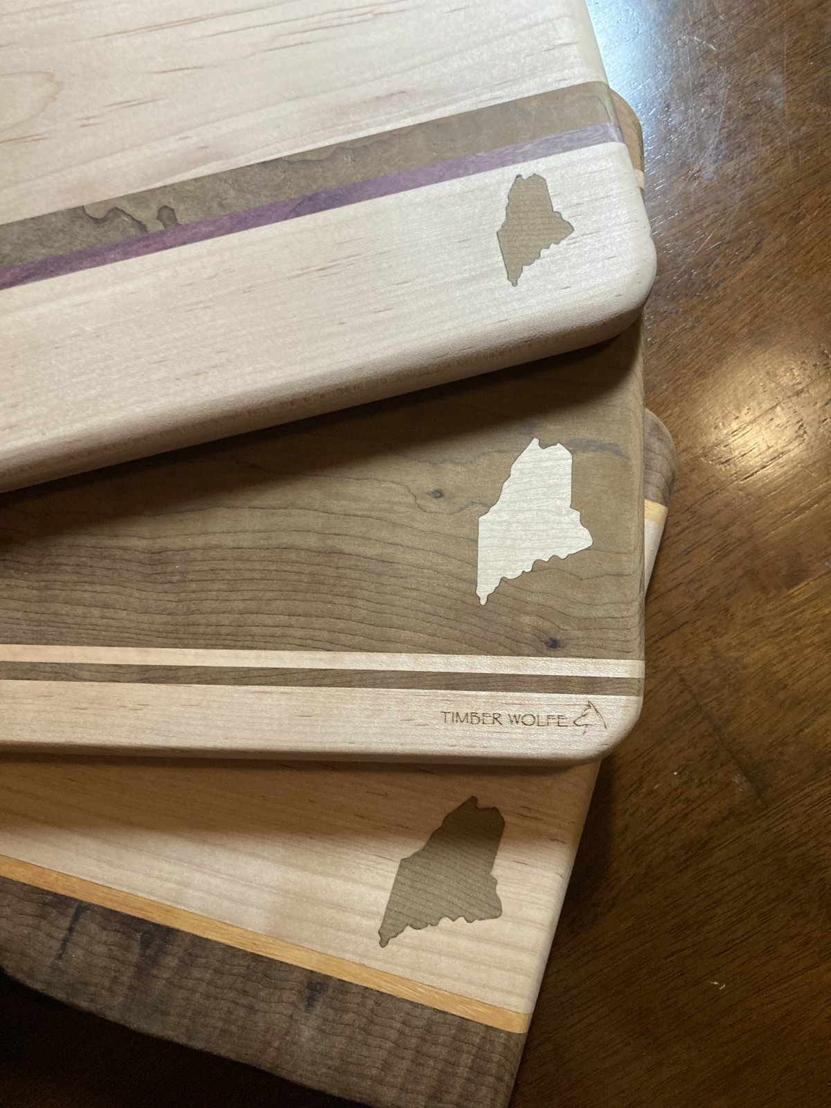

    Did some Maine inlays on some cutting boards, came out pretty good! :)
    Edit: Lasted two hours from posting on my website, all sold. Jesus :eek:
