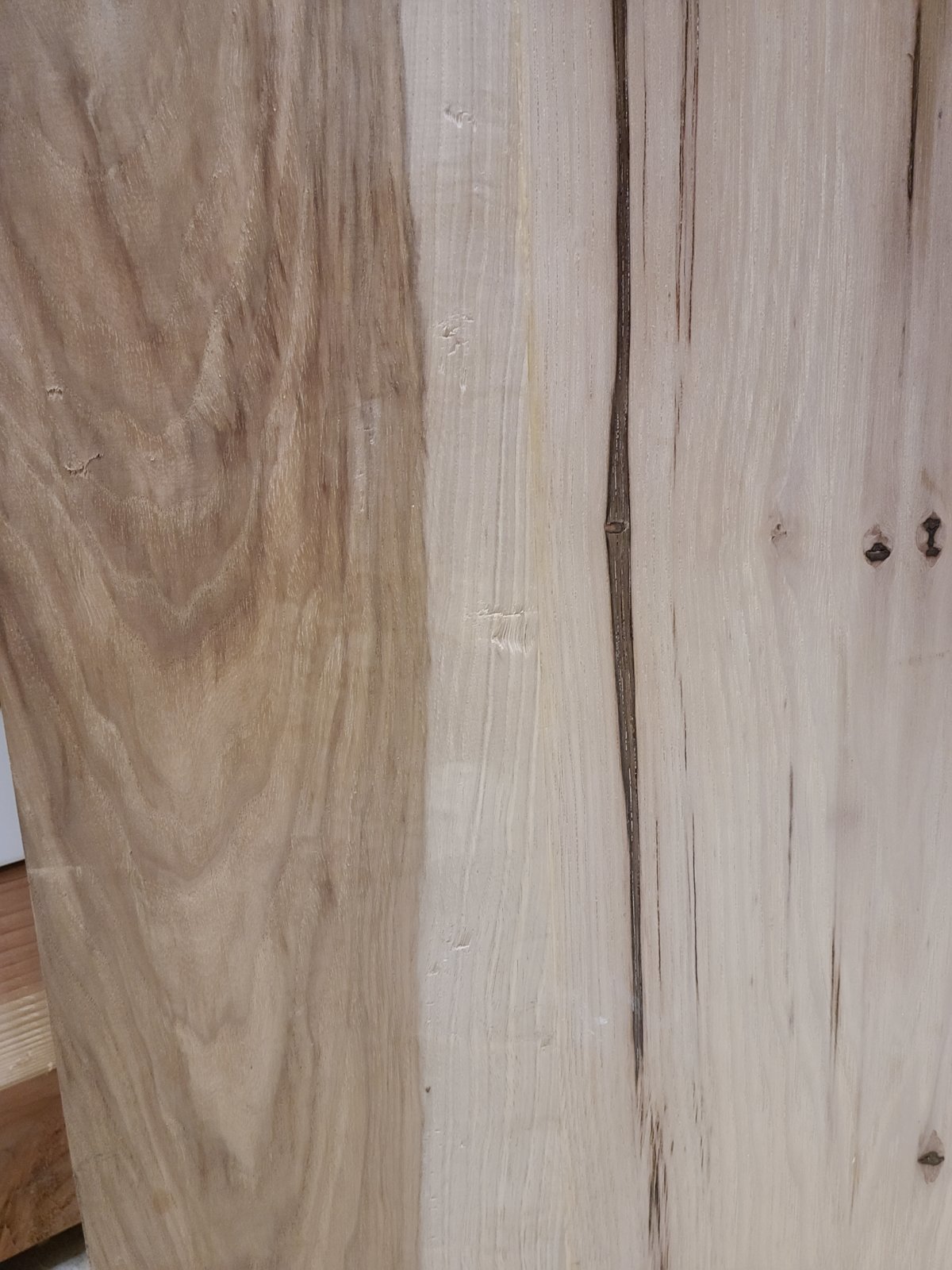

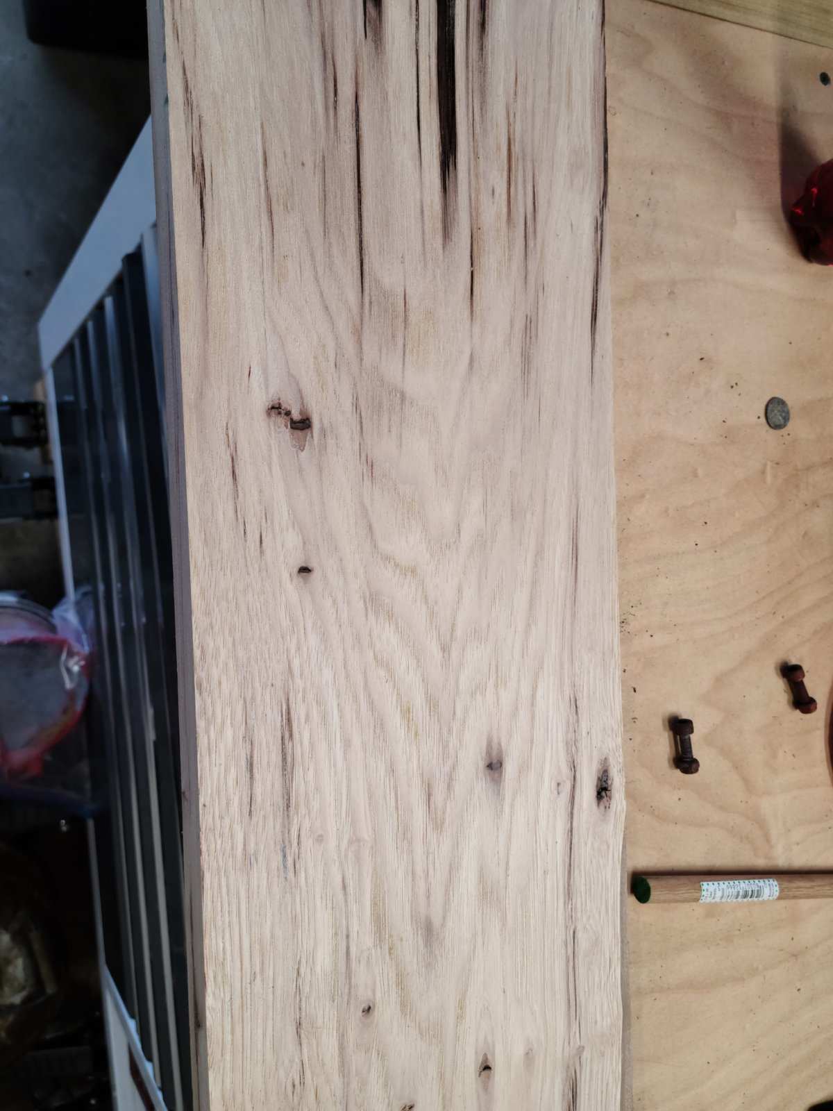

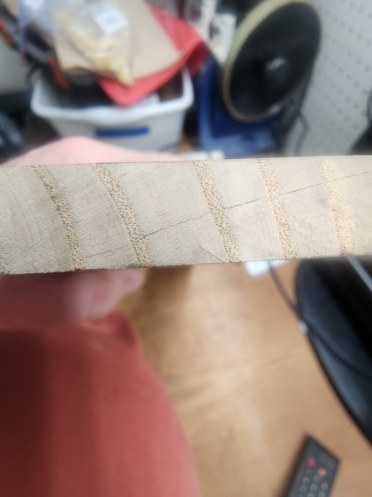

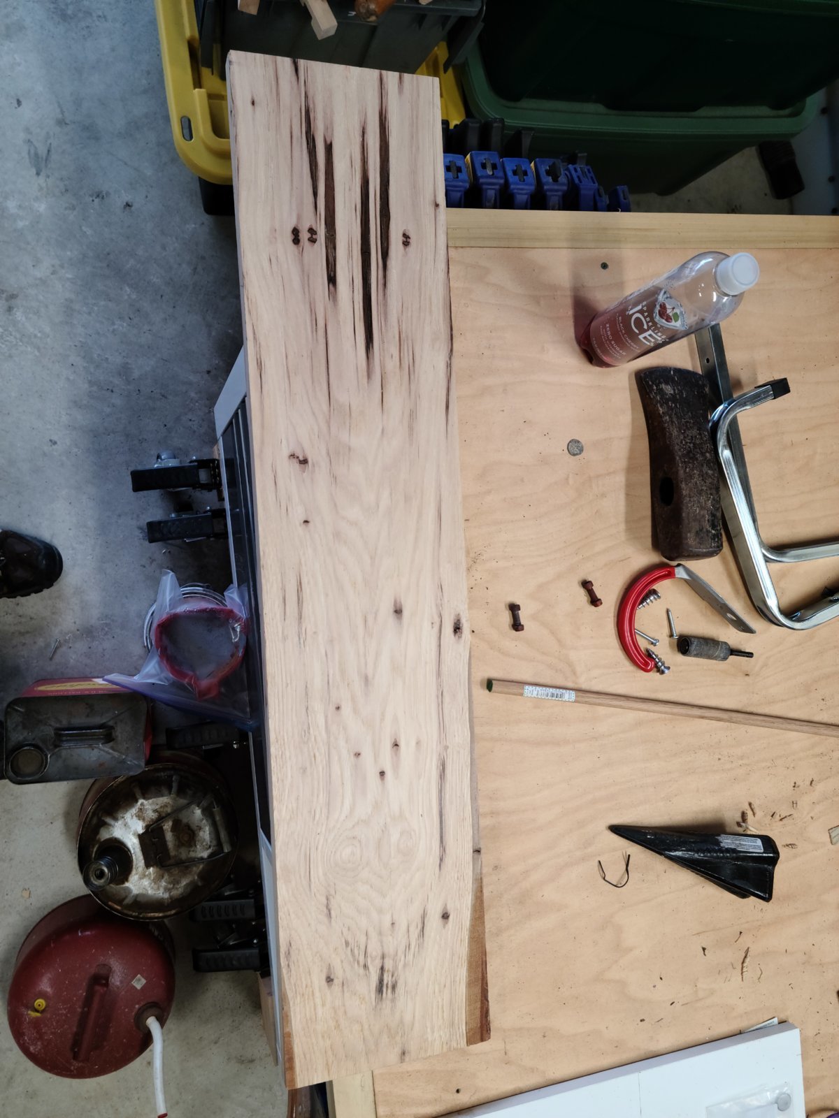

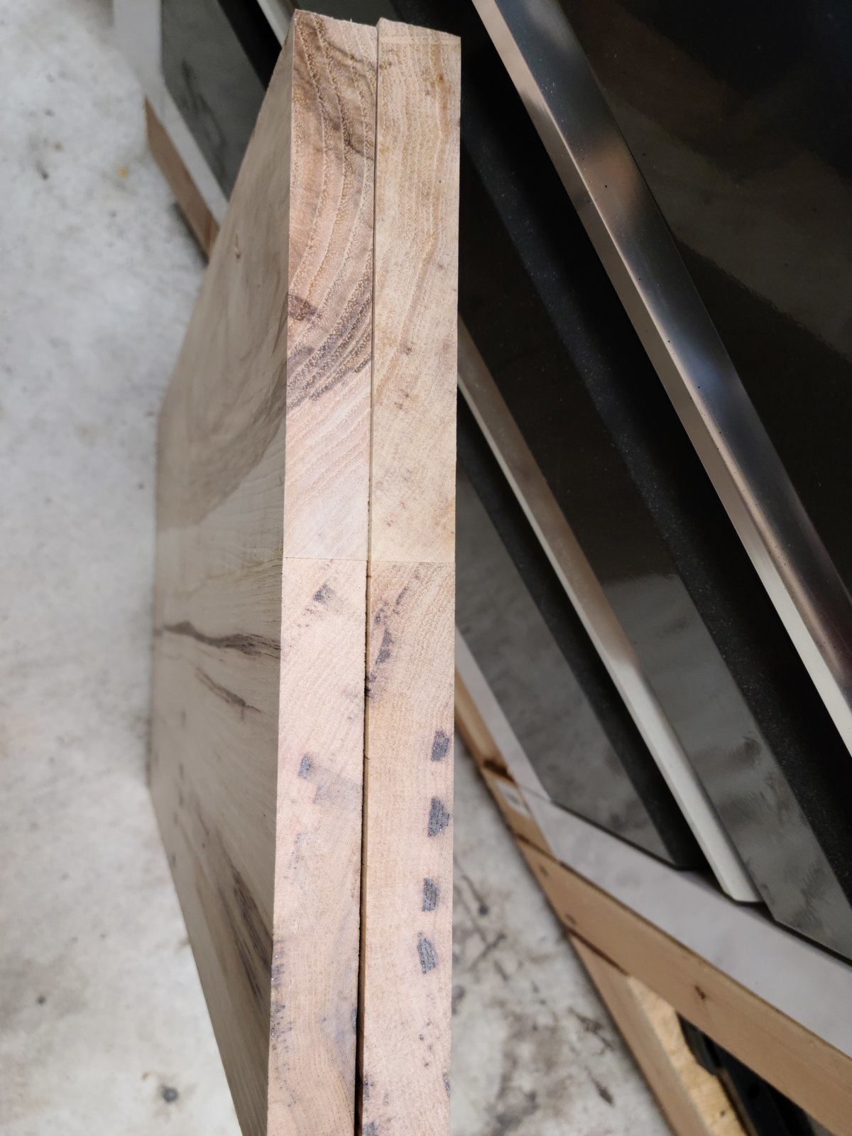

    End grain and a little better shot of the grain on two of the boards that were glued up.

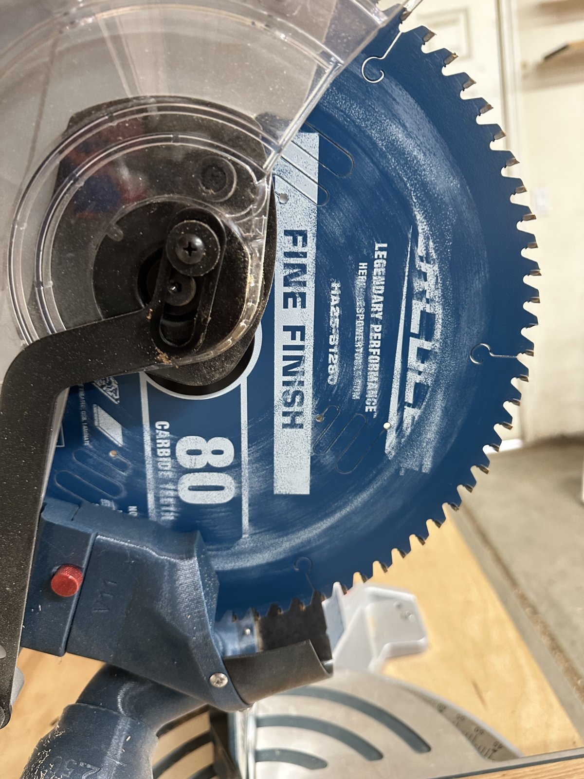

    I am currently using Hercules blades from Harbor Freight on my table saw and miter saw. I tried to use a Diablo on my table saw, but the thin kerf does not work with my riving knife. I do still use a Diablo dado stack. My Father In Law uses fancy Forrester Blades on all of his tools and honestly I can’t see a big difference. I just make sure that my blade it sharp. When they start to get dull, I toss them and buy a fresh one. I currently have an 80 tooth Hercules on my miter saw just for breaking down to rough length.
    [/QUOTE]
    Looks more like hickory

    Thank you sir.

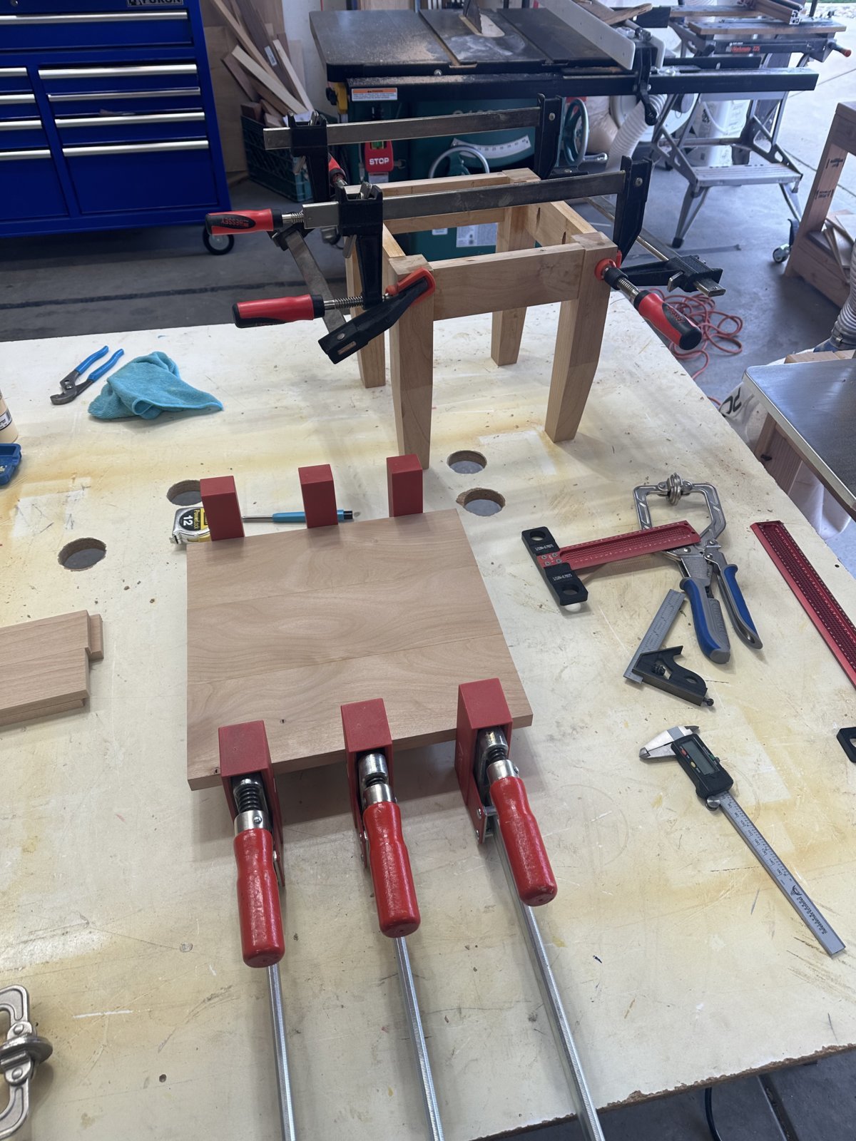

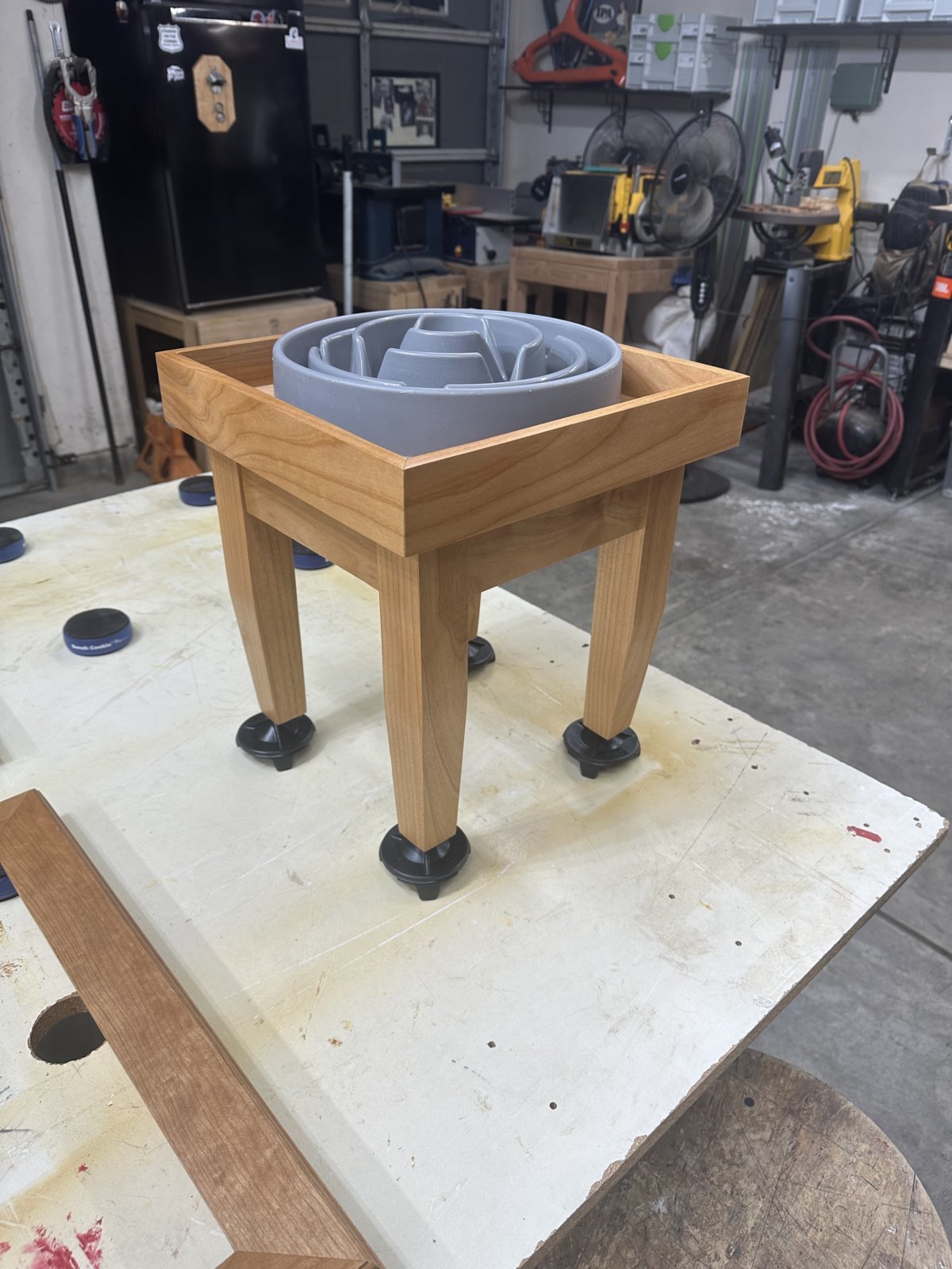

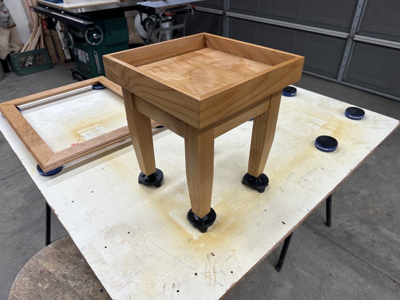

    I see you used pocket screws for the top. Besides glue, did you use pocket screws for the legs and side pieces as well?

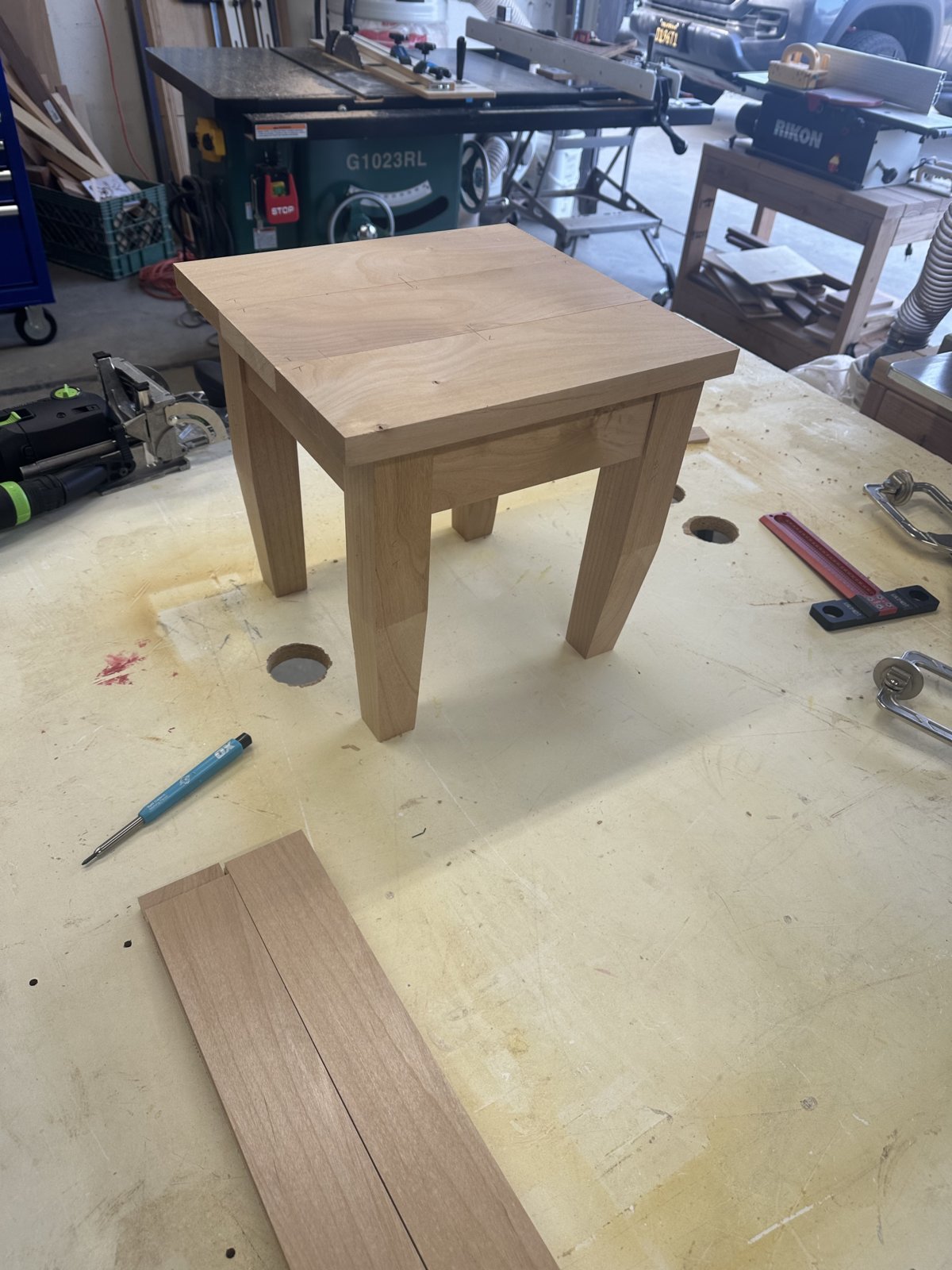

    The base is assembled with glue and Dominos. Sorry no pictures of that step. I am using pocket holes to attach the top because this will hold a dog food bowl and get lots of abuse. I want the top to be easily removable for any needed repairs or replacement. I used 8/4 Alder for the legs which are tapered on two sides and 4/4 Alder for the rest. The sides for the top were planed down to 1/2 inch.
    Here is the top just resting on the base. Everything needs another coat or two of finish.
    BA25078B-5724-4D1F-AC30-E5833636D71F.jpg 019CD03D-D12C-4601-8D15-D73521F23FA1.jpg

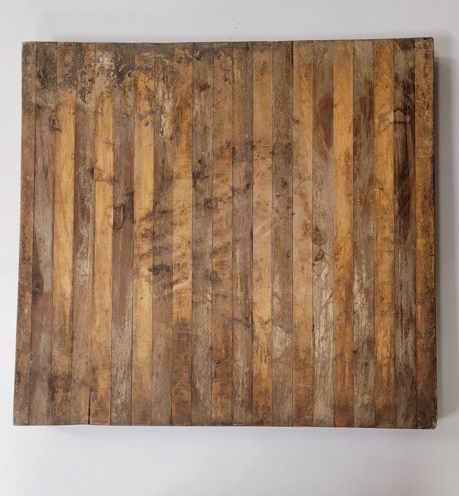

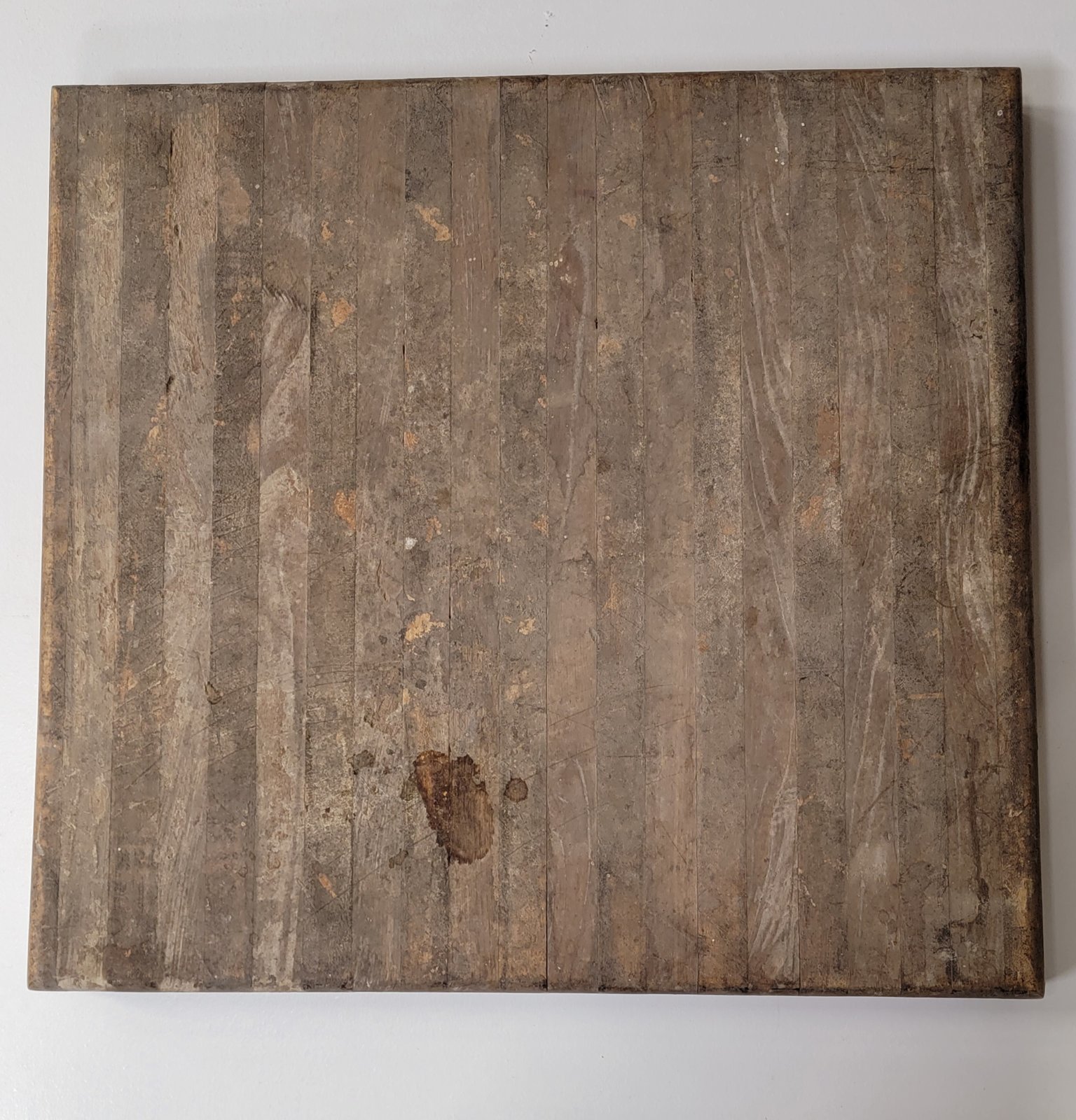

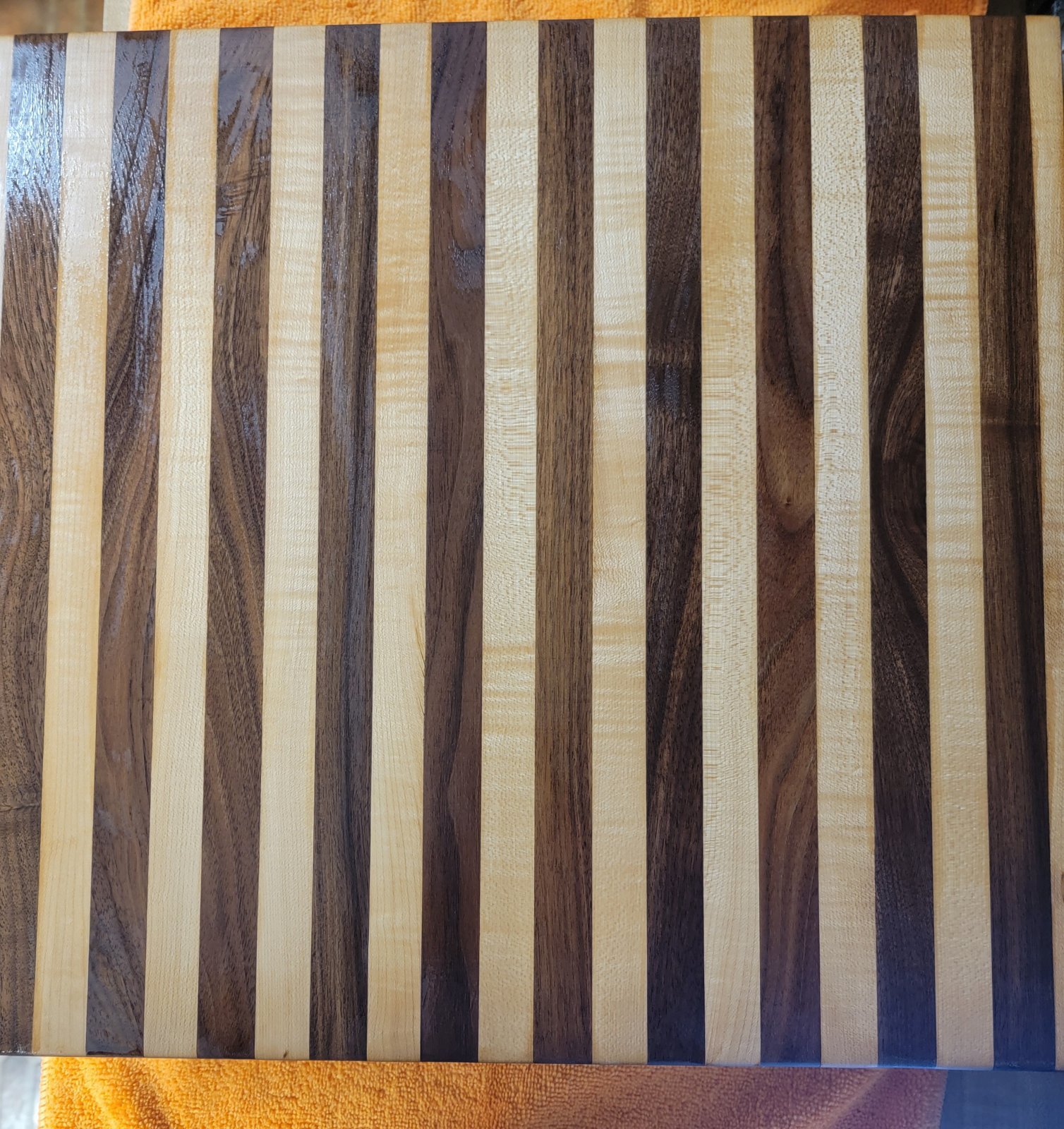

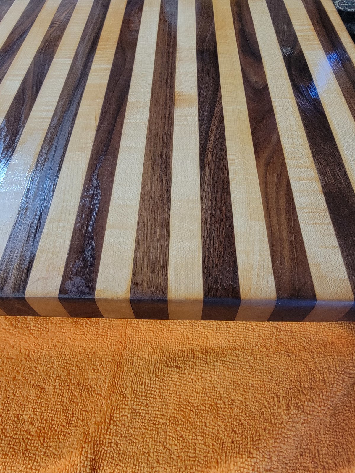

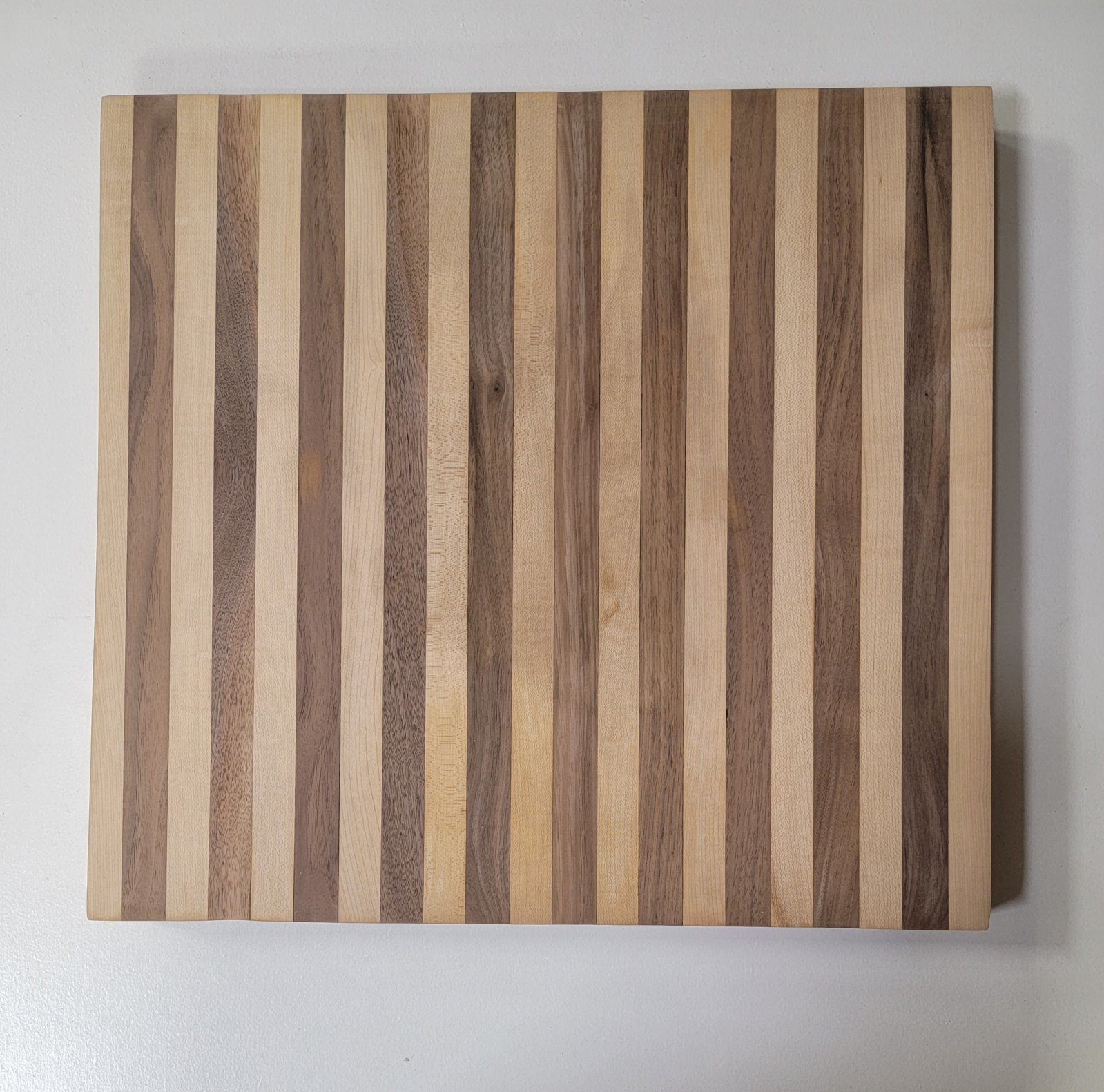

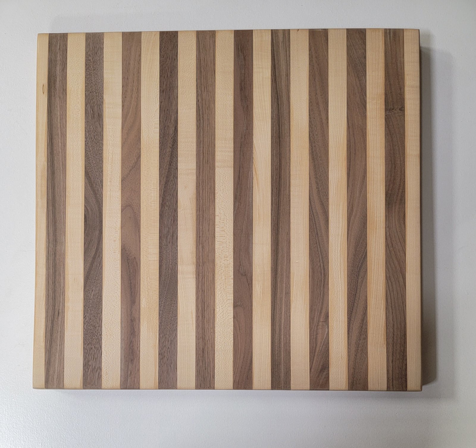

    Coworker finally brought the neglected cutting board to work and I decided to take on the challenge.
    I didn't want to make this perfect.. I tried to leave a lot of character in it as it's nearly 40 years old.
    I think the coworker will be satisfied.
    Front
    Back
    Front
    Back
    I use Walrus Oil Cutting Board Oil. These photos are fresh. It will absorb in and the excess will be wiped off for a matte finish.

    Looks like new!:101010:

    He's going to be quite pleased!

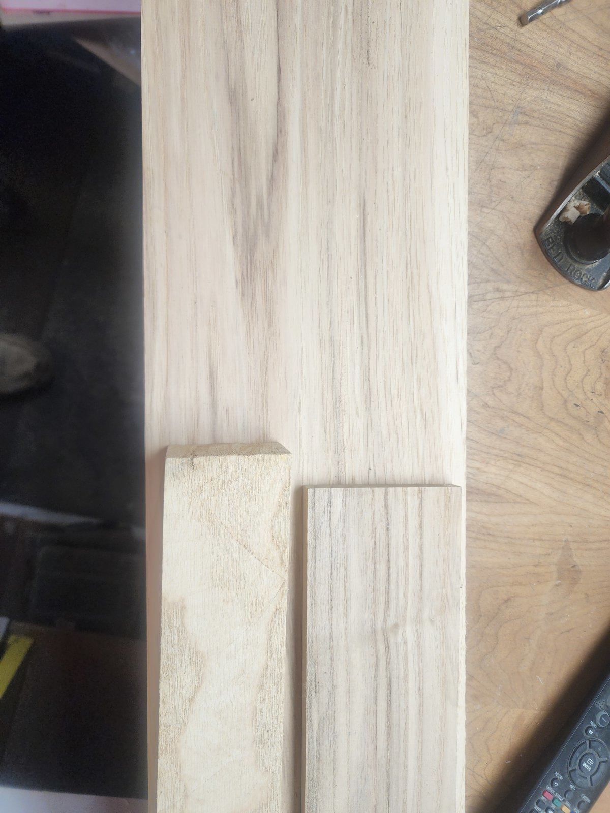

    Some stuff. Not a lot, just some.
    This is ash.
    This is hickory
    The bottom pic is the ash on top of the hickory. The light piece is also ash the is flat sawn. The darker ash is quarter saw.
