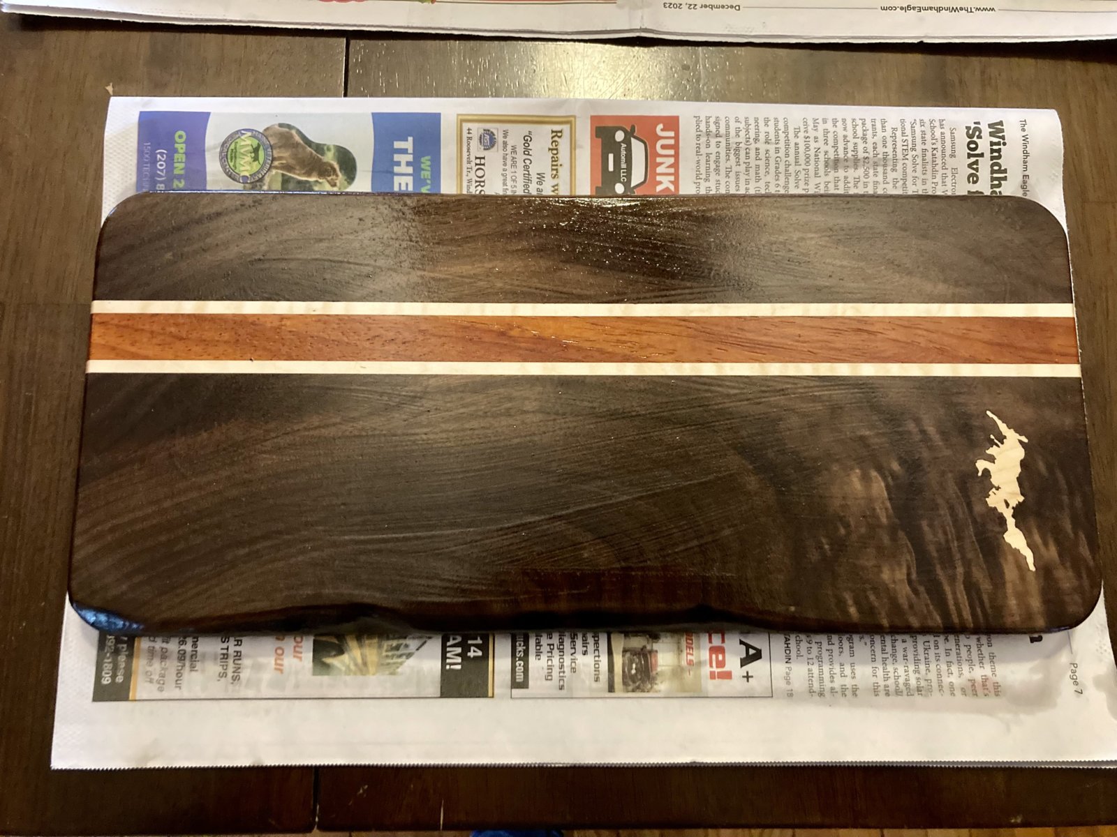

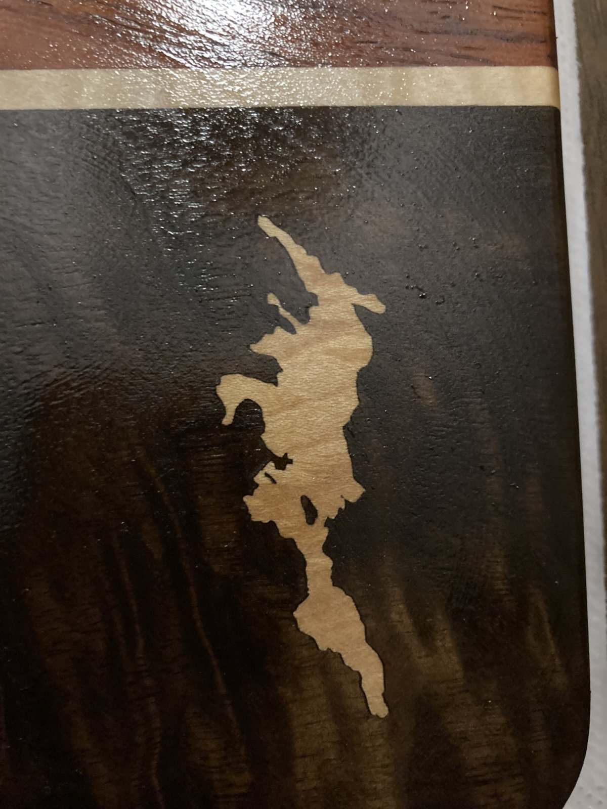

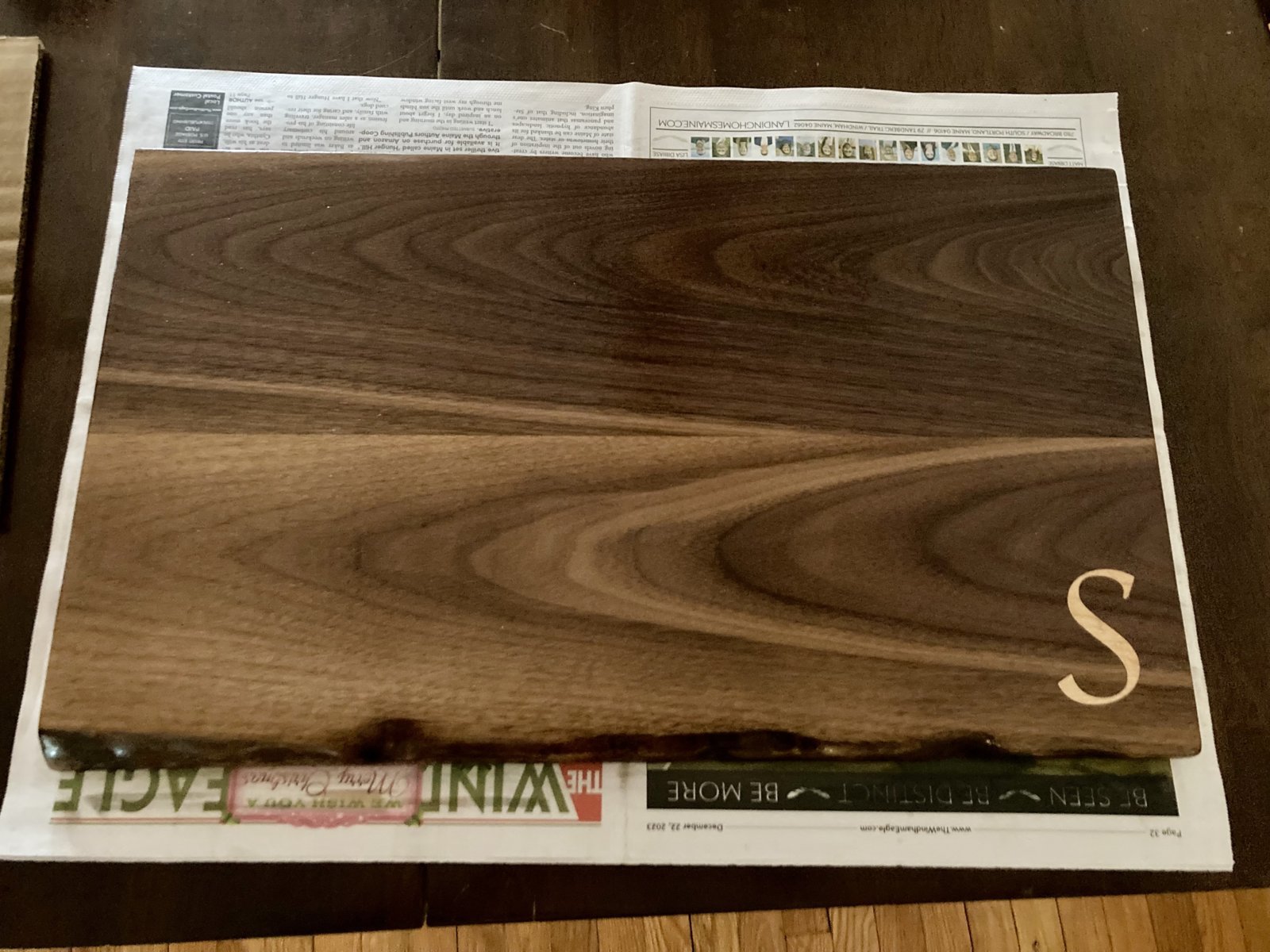

    A couple of inlays for clients. The most boring shark-coochie board and cutting board ive made yet. Didnt want any handles, holes, nada. :notsure:
    Engraver is awesome, Lake Sunapee has the little islands and everything.

    What are you using to be able to do that detailed of inlay?

    Id guess laser cut

    Yup, laser. Cuts the inlay out and engraves the hole for it to get glued into.

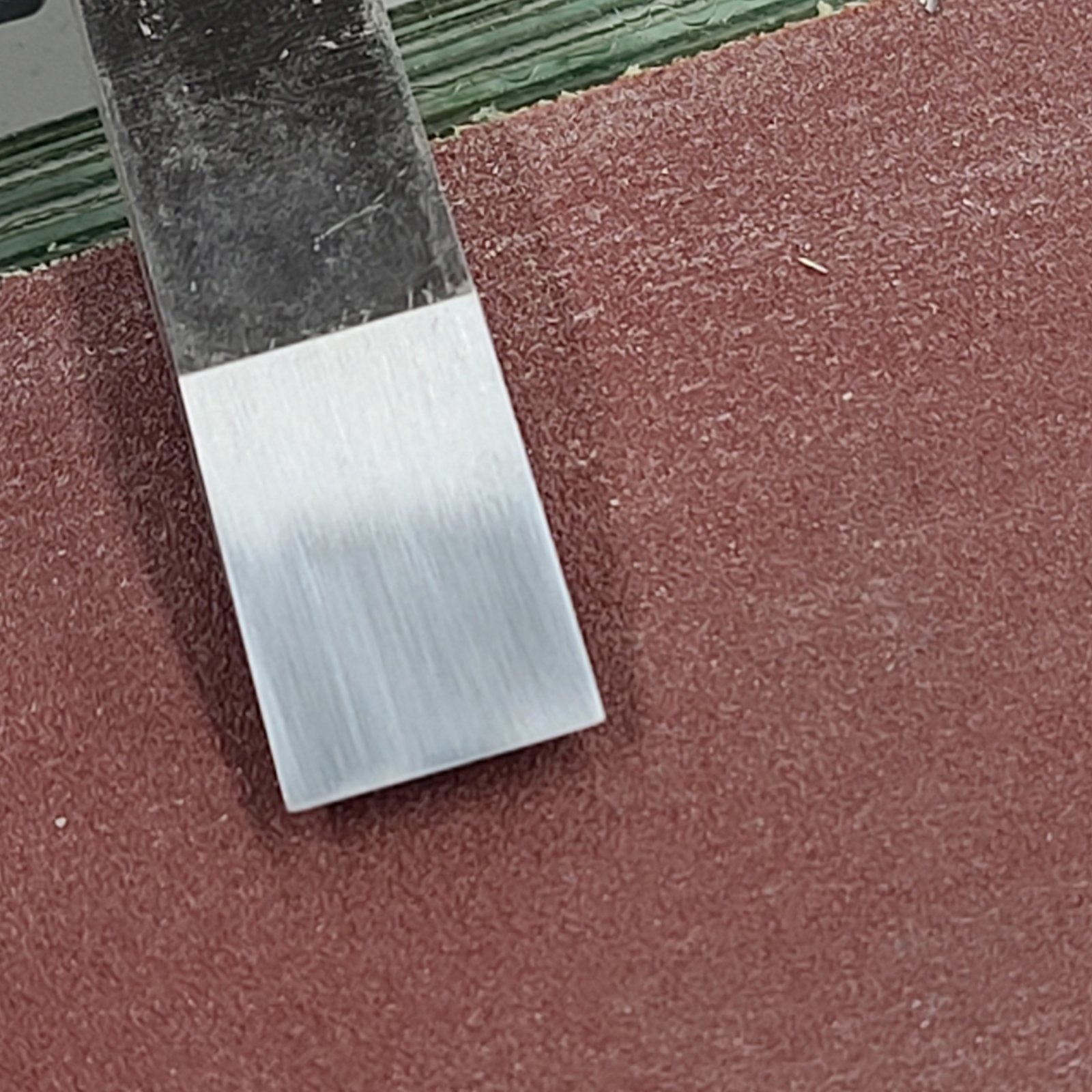

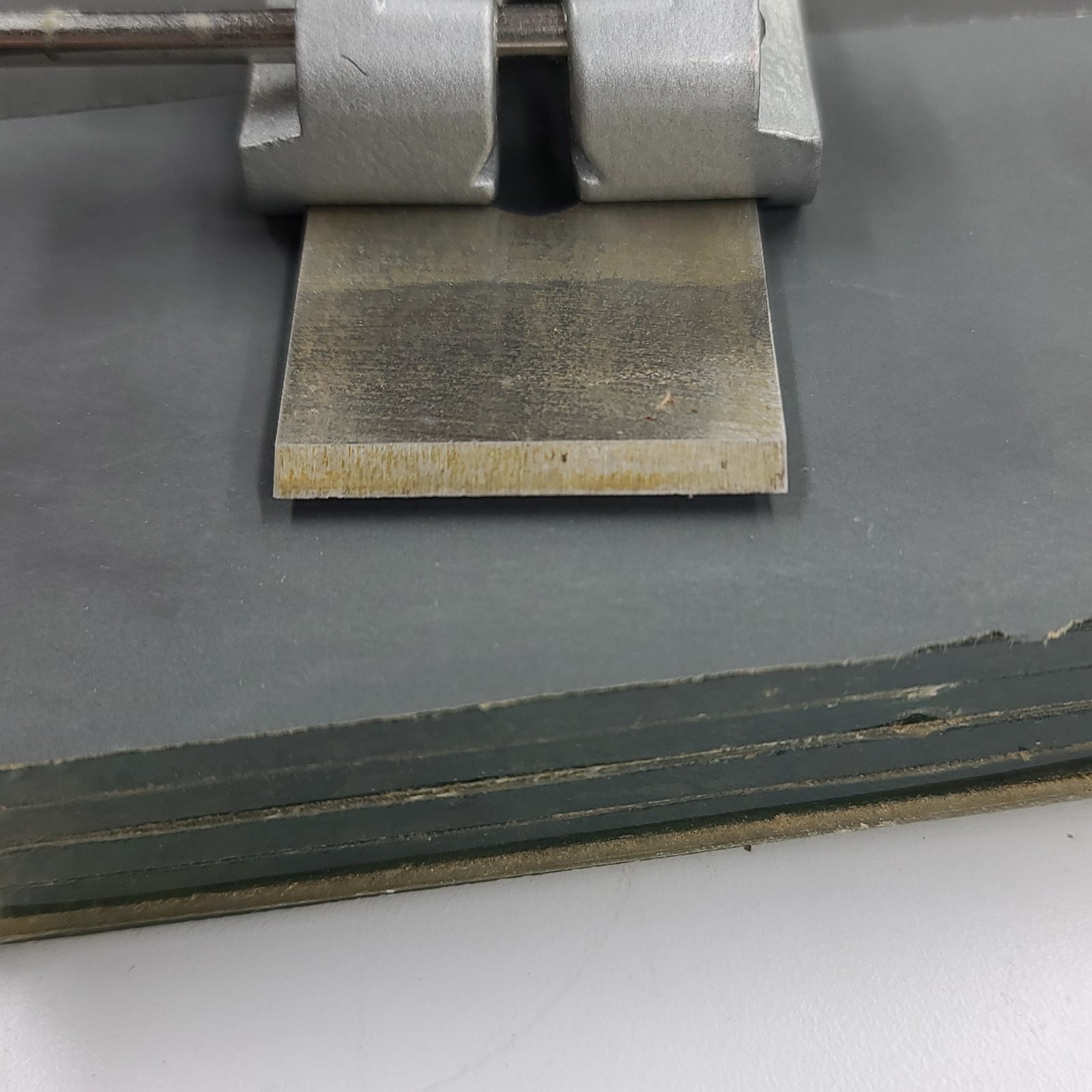

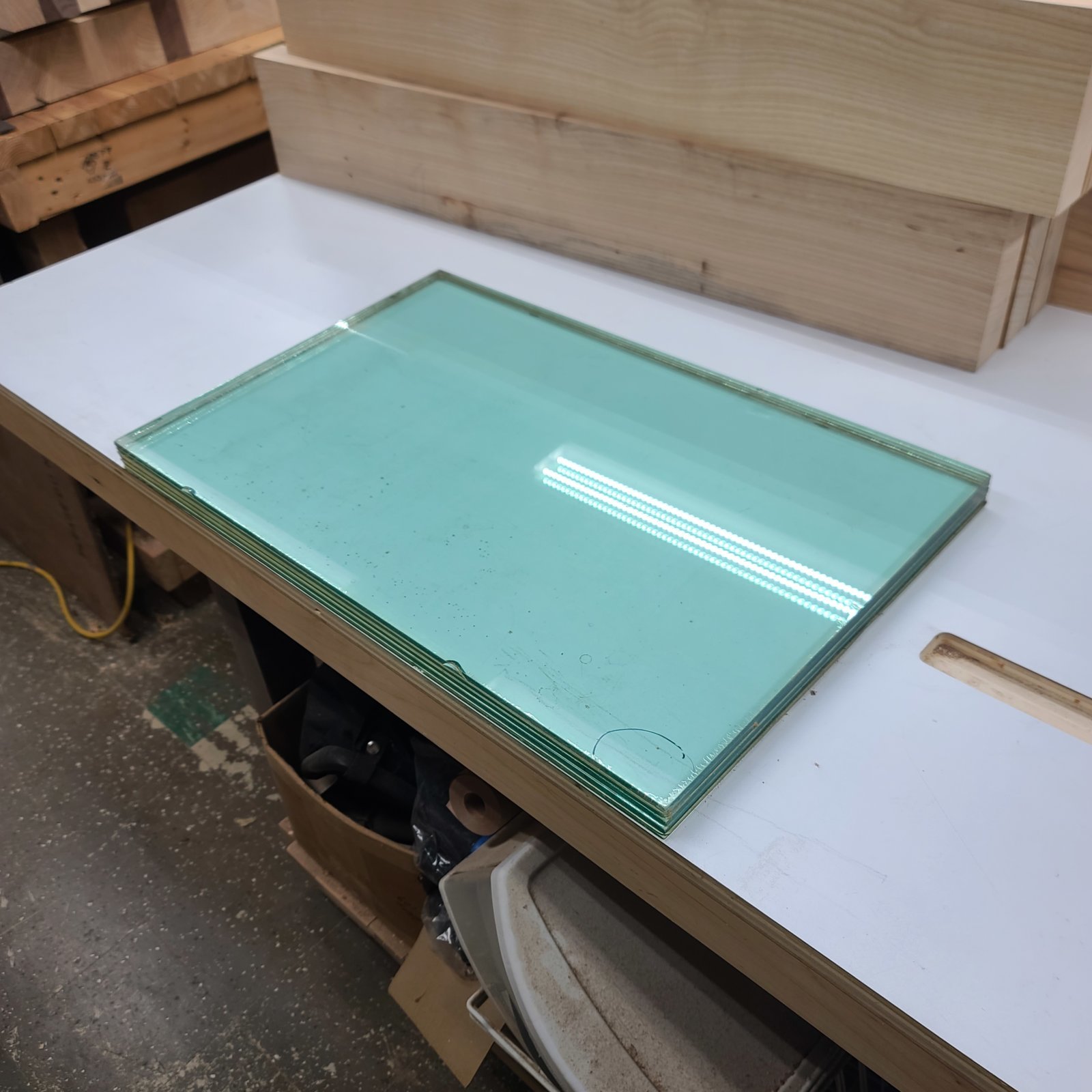

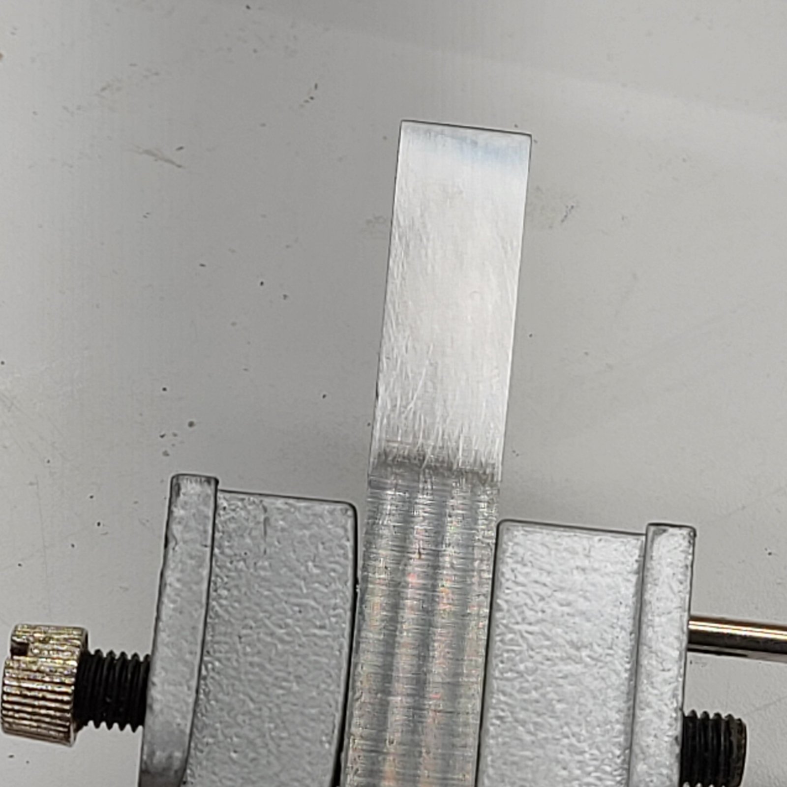

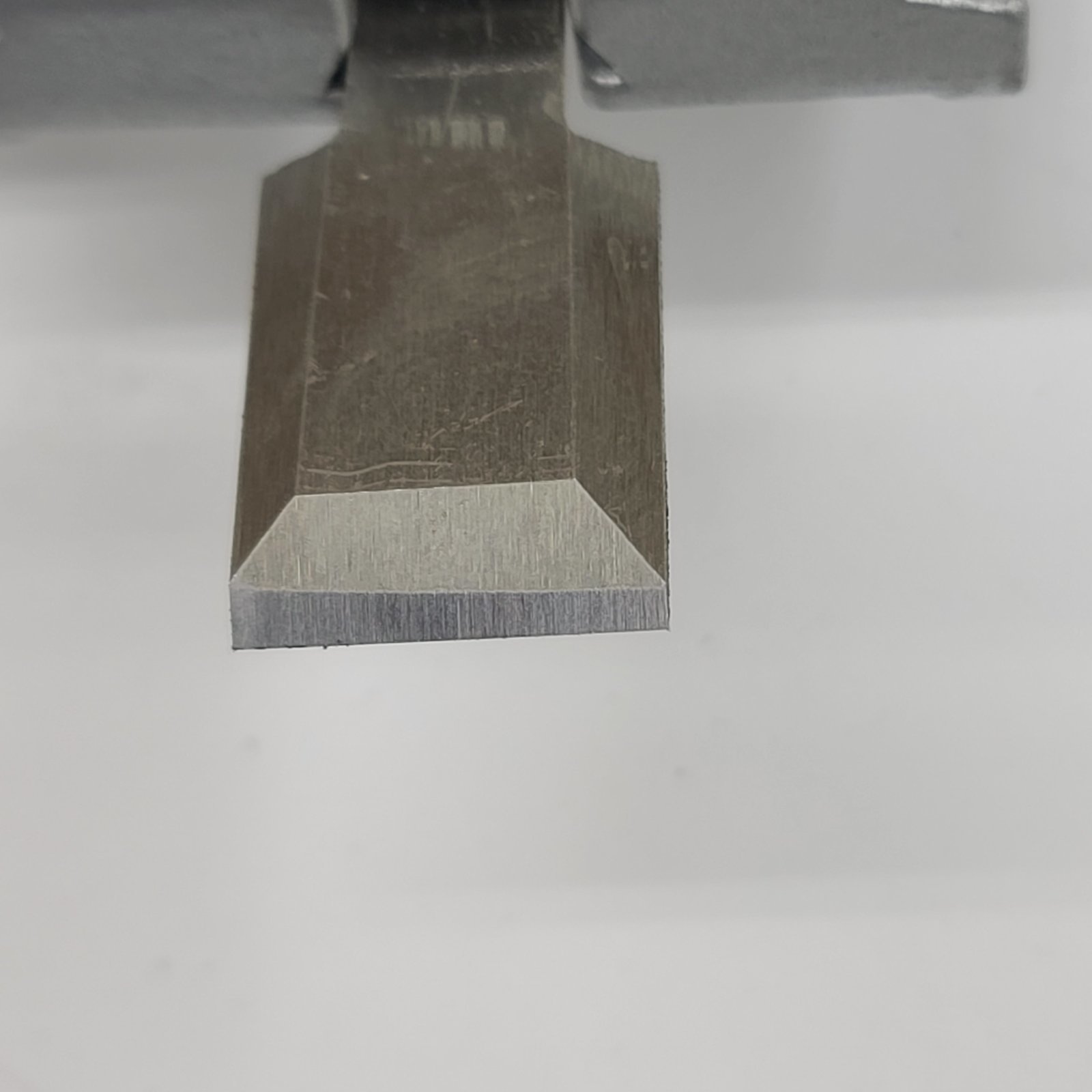

    No wood working in the shop today. It was all about maintenance and sharpening tools.
    I use the sandpaper method to sharpen chisels and plane irons.
    This is a piece of laminated tempered glass, also known as bullet proof.
    I use spray adhesive to attach the paper to the glass. This is mostly Klingspor cloth backed paper.
    This is what I started with. I need to sharpen most of my morticing chisels.20240101_140711.jpg
    I work the backs as well as the face through the grits. It really doesn't take more than a few strokes on each grit.
    And this is what I end up with. I only sharpen the edge, not the whole face. Kinda hard to see but it's only polished about half way up, and it's now very sharp.

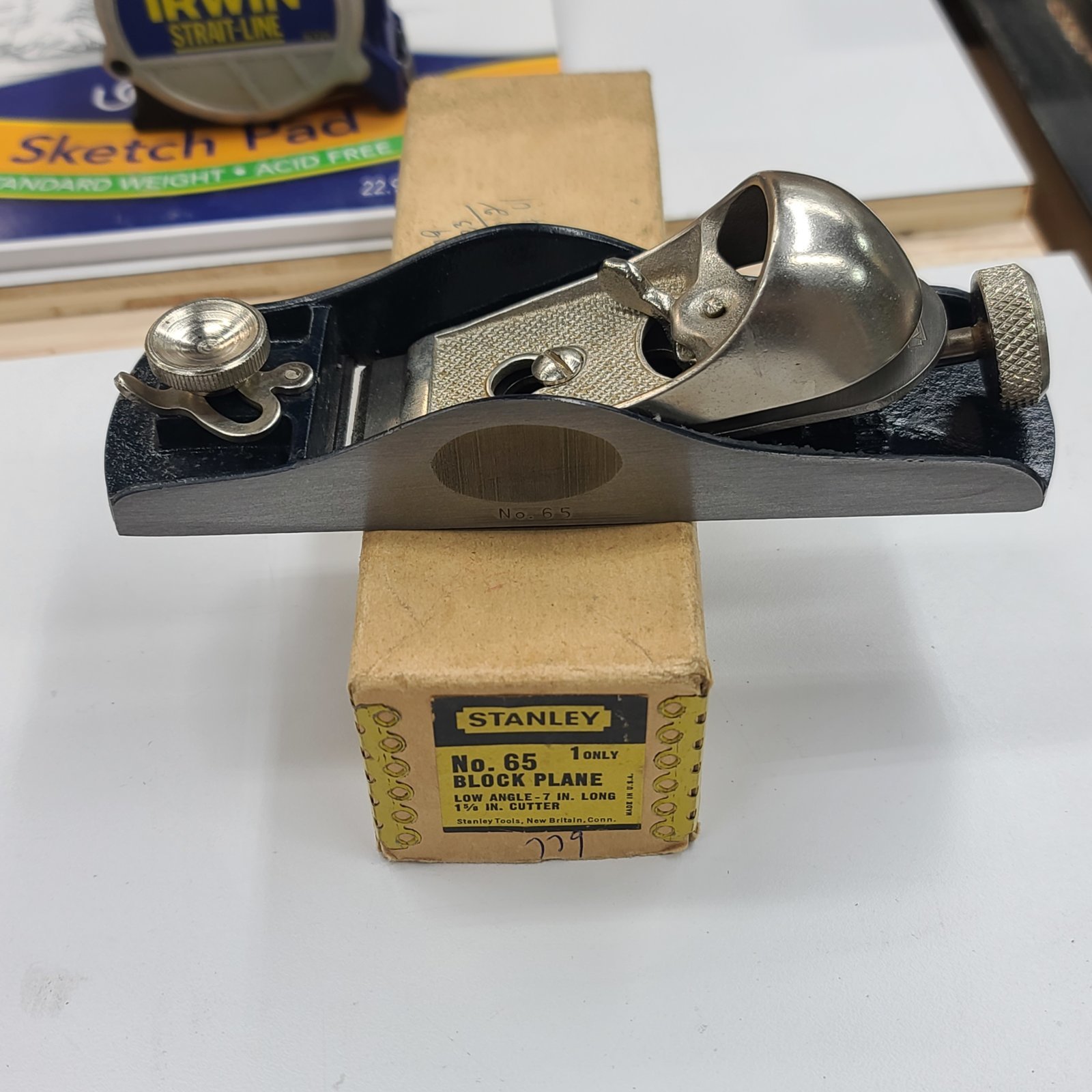

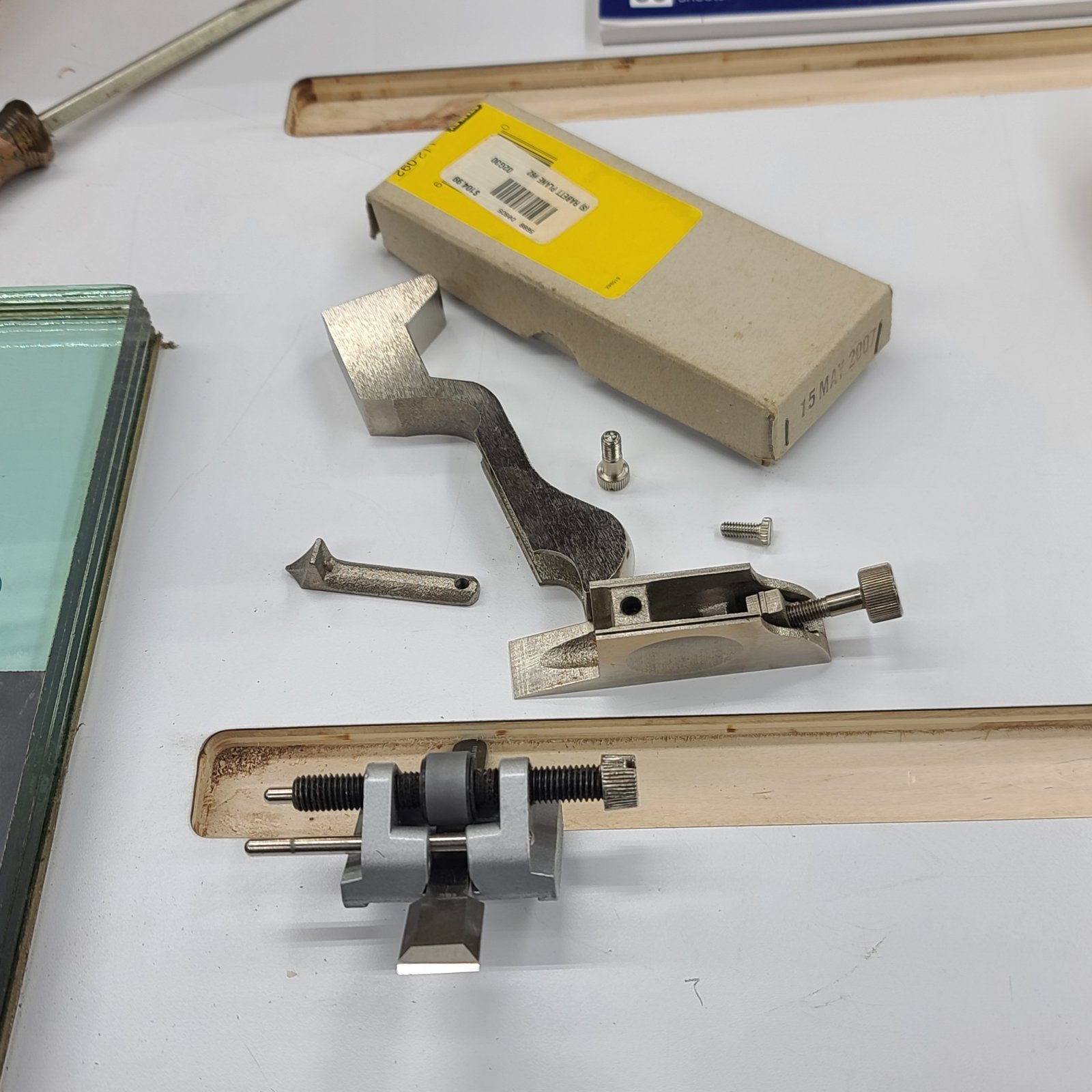

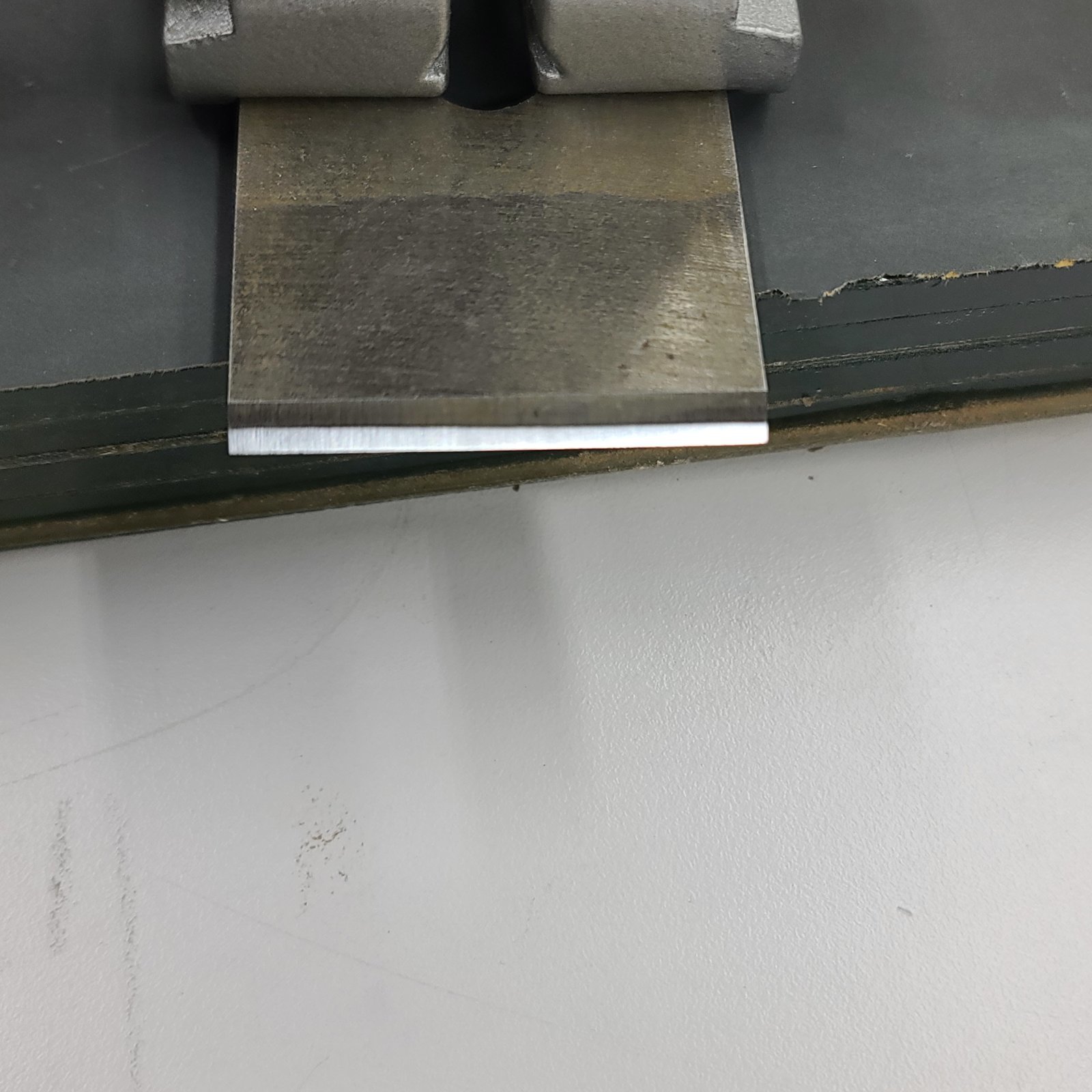

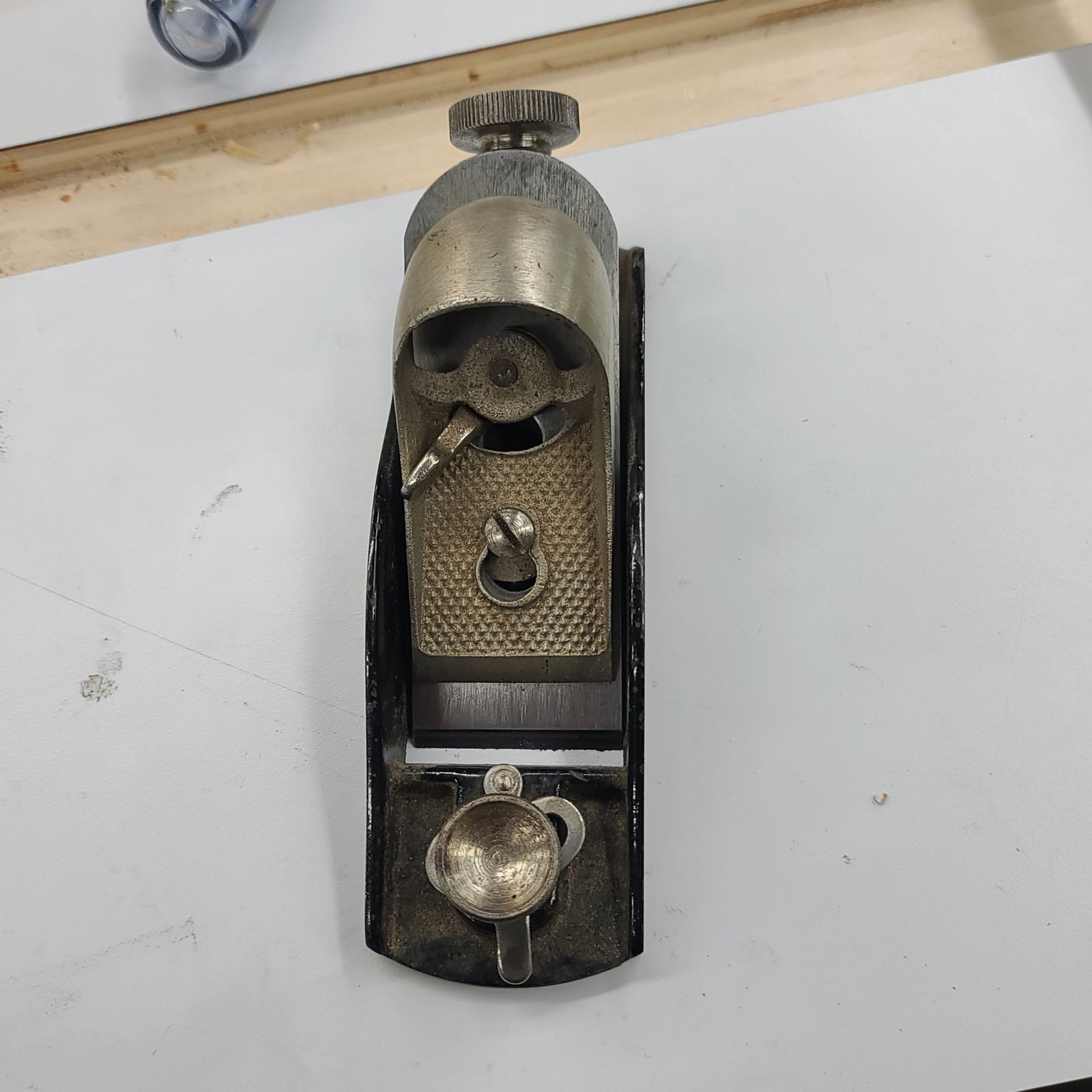

    After sharpening about 6 chisels I moved on to my most used planes.
    Rabett plane is going to be needed soon. And the no.65 is a recent score, new in the box. So it needs some tuning.
    Rabett plane is newer but works well.
    Blade looks like it isn't square but I checked it with a machinest square and it is. Factory grind was off
    It cleaned up well and is ready to go back to work.

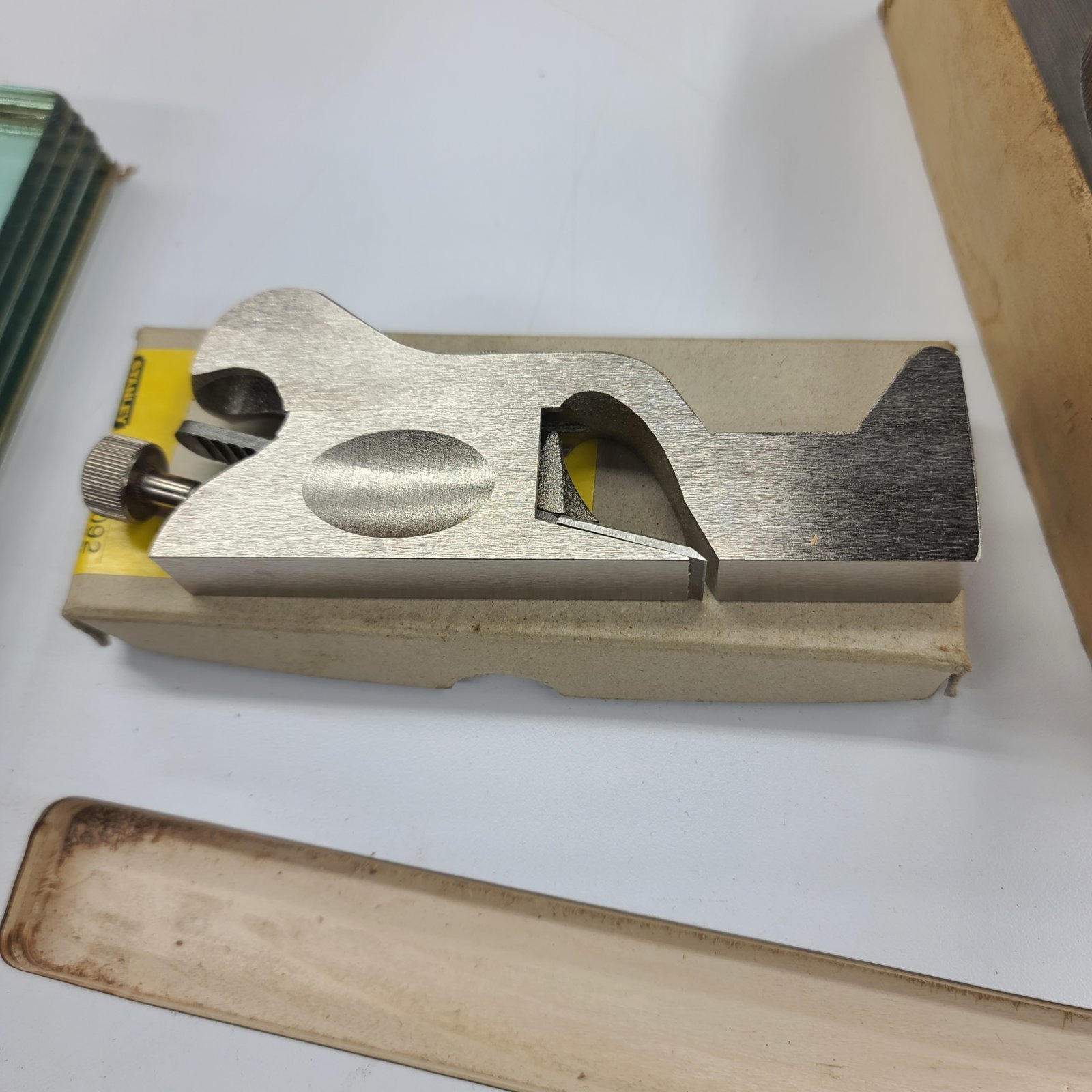

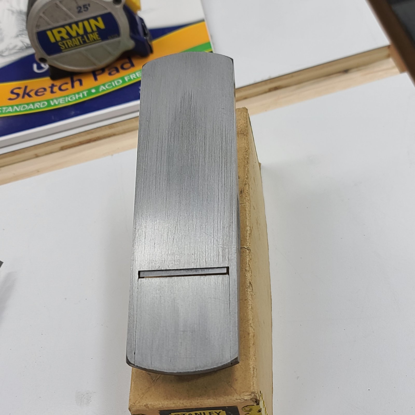

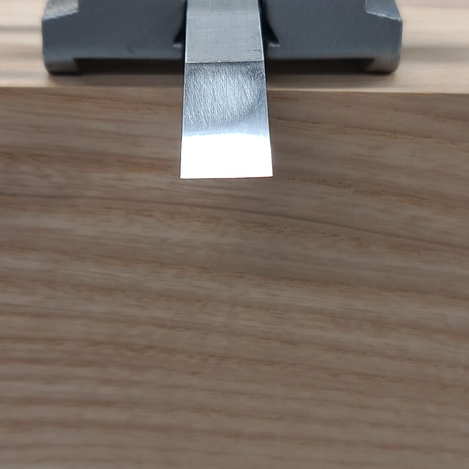

    Next I sharpened a couple of my favorite block planes. One is a new score new in the box, never sharpened. I have another one just like it.
    So I decided to show it some love.
    Never sharpened plane iron, factory grind.
    Now the iron is sharp.
    A nice example of a user no.65
    I flattened the sole a bit, but it needs more work, that's for another day. I also waxed all the cast surfaces.

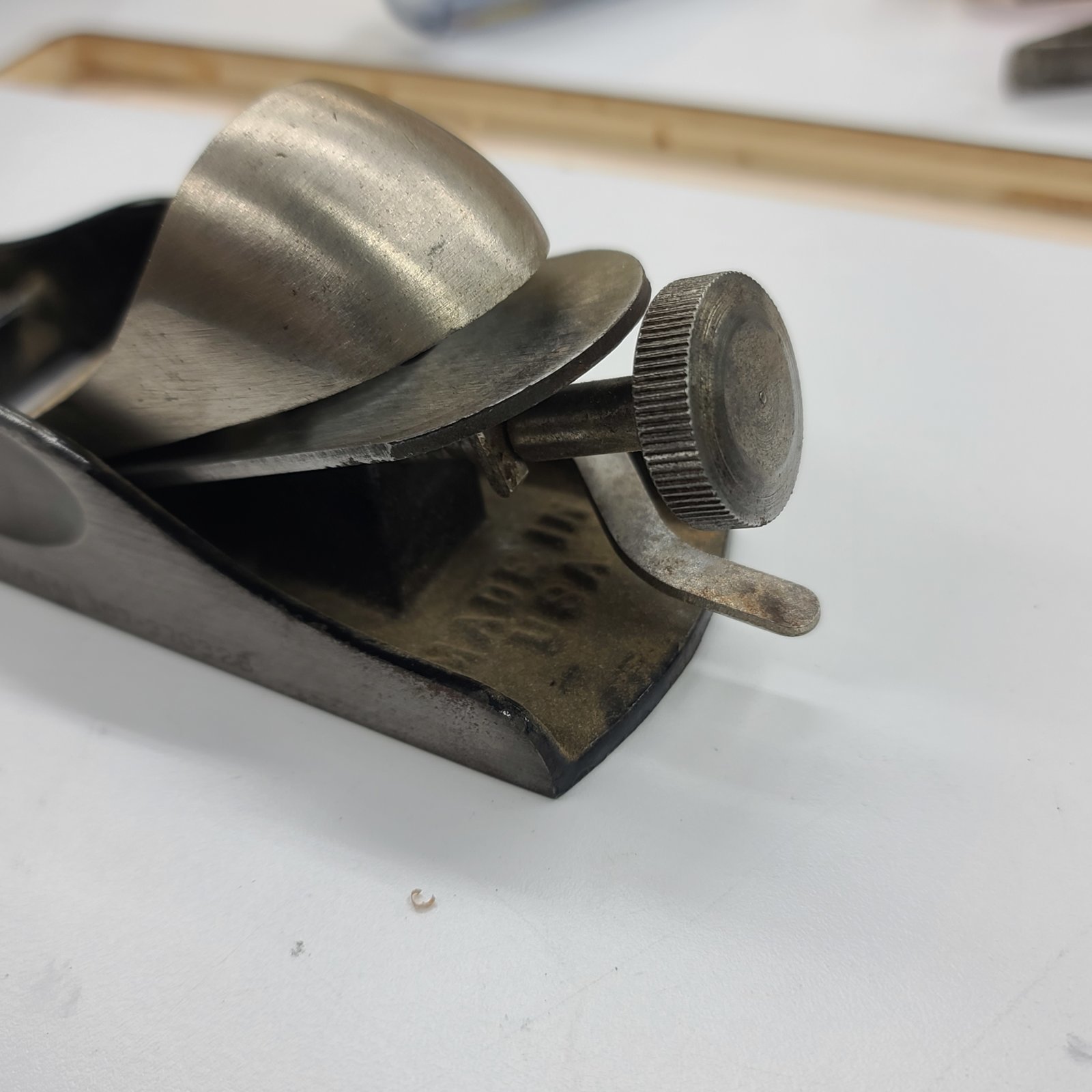

    I also gave this craftsman block plane the same treatment. It has an adjustable mouth and the plane iron can also be adjusted with the lever in the rear. It has always felt good in my hand.
    I could spend months maintaining restoring my planes, I have an extensive collection. But the ones above are my most used.
