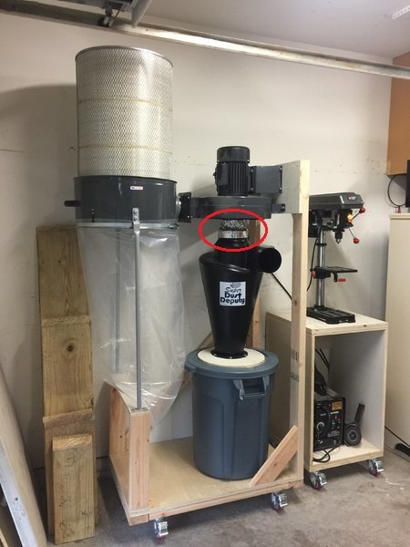

    Yes, there is a little flex in the connection between the Cyclone and the blower. As of right now, that connection is made with tape, but I'm planning to swap the tape for a rubber union with some hose clamps.

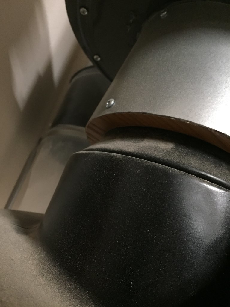

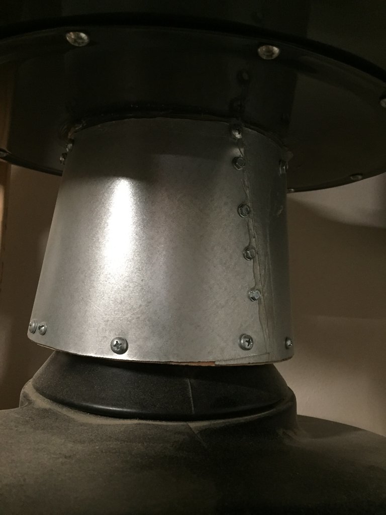

    I made an adapter with some wood rings and sheet metal. Rubber would be easier I'm sure, but it's what I had on hand. I also used tape, but over time it separated and just made my life more difficult.

    Yea, the tape was just a quick and dirty way to get it up and running. I was thinking of looking for some sort of rubber adapter but haven't had the time to devote to it yet.

    I did the same thing with the tape, just wanted get to work building things. I looked at A/C transition, chimney pipe, dryer vent duct, etc. couldn't find anything that matched the diameter of the dust deputy. I eventually gave up and came up with the thing in the photo.

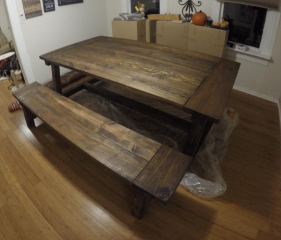

    Girlfriend wanted a "rustic" farmhouse table which go for $1,000+, so I built her one for under $300 :headbang:

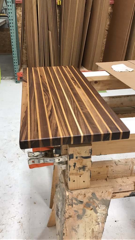

    IMG_1871.jpg Butcher block I made at work today.

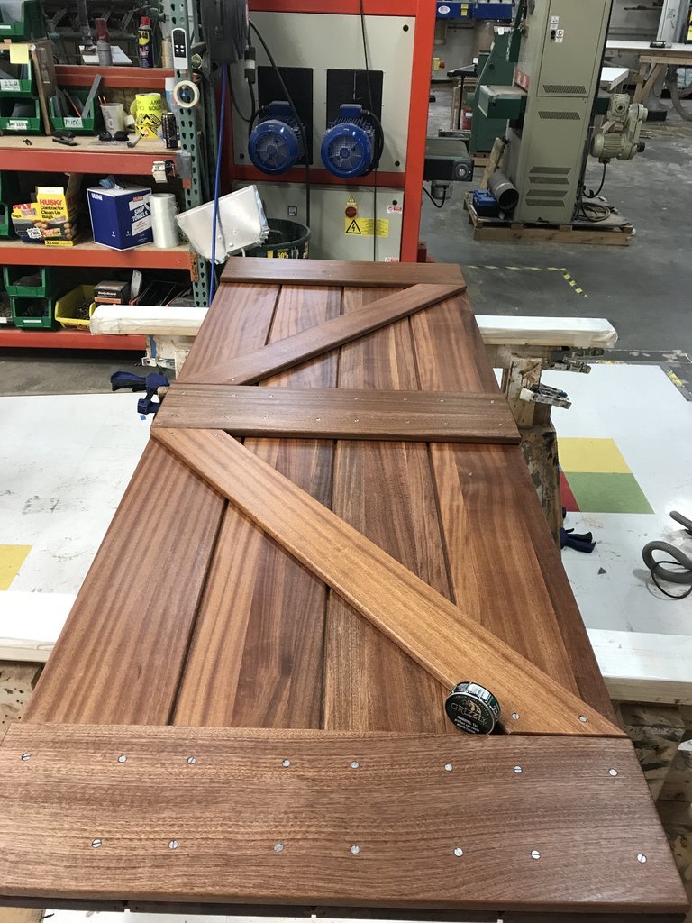

    And a mahogany barn door.

    very nice!

    :drool: I need to make some barn doors for our laundry room

    This looks like craftsmanship... that other "farmhouse" or "rustic" stuff gives carpentry a bad name in my opinion.

    Yep, looks like I will be building her a table soon

    Believe it or not the butcher block is made of all my cutoff scraps from my doors.
