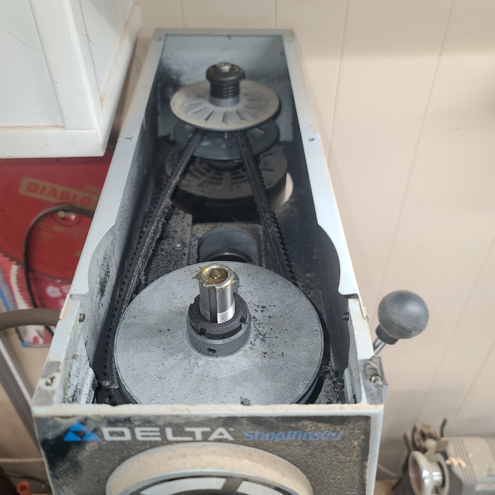

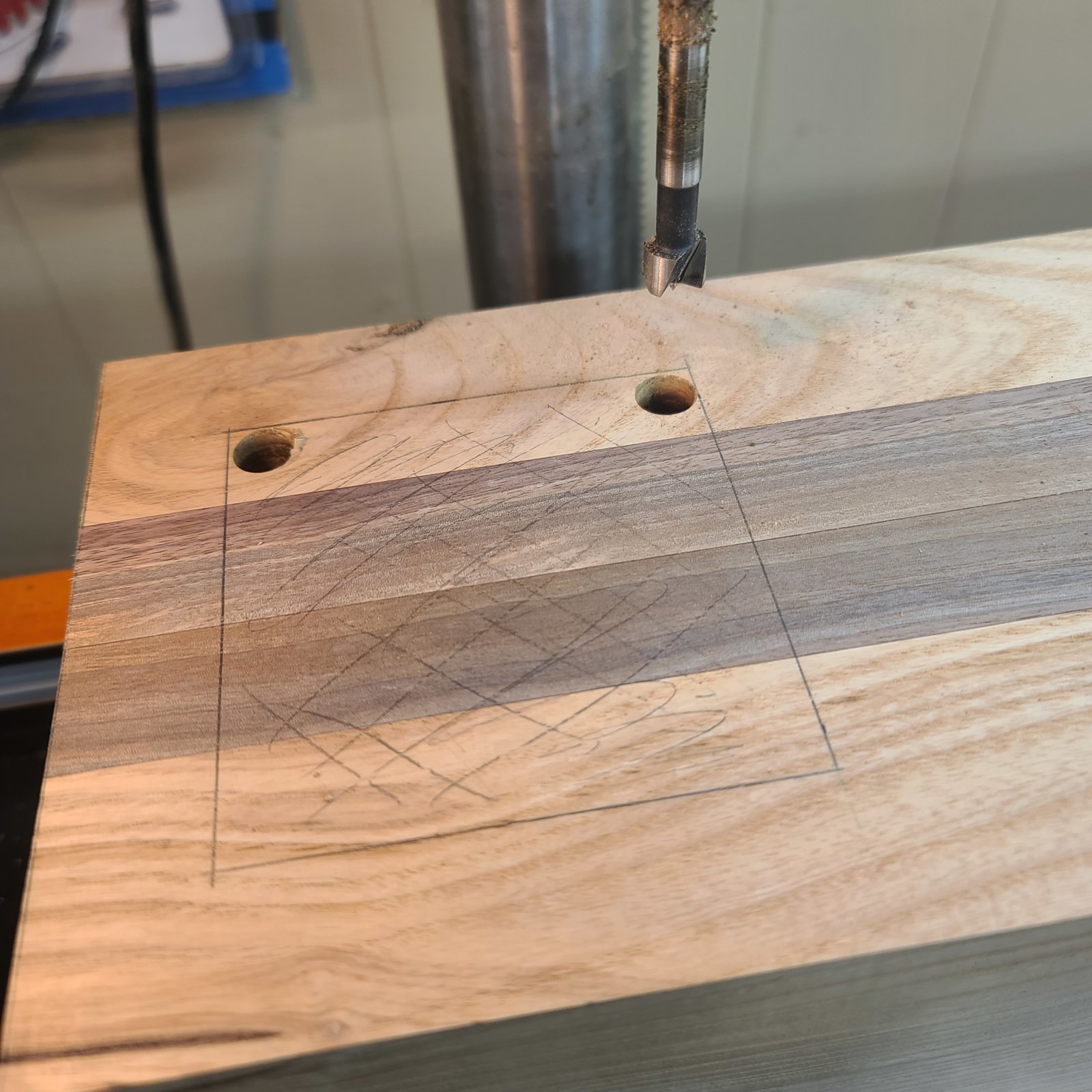

    Well I started drilling out the holes for the mortices. Started with a small forster for the corners and then I'll use a larger bit for the bulk of the waste.

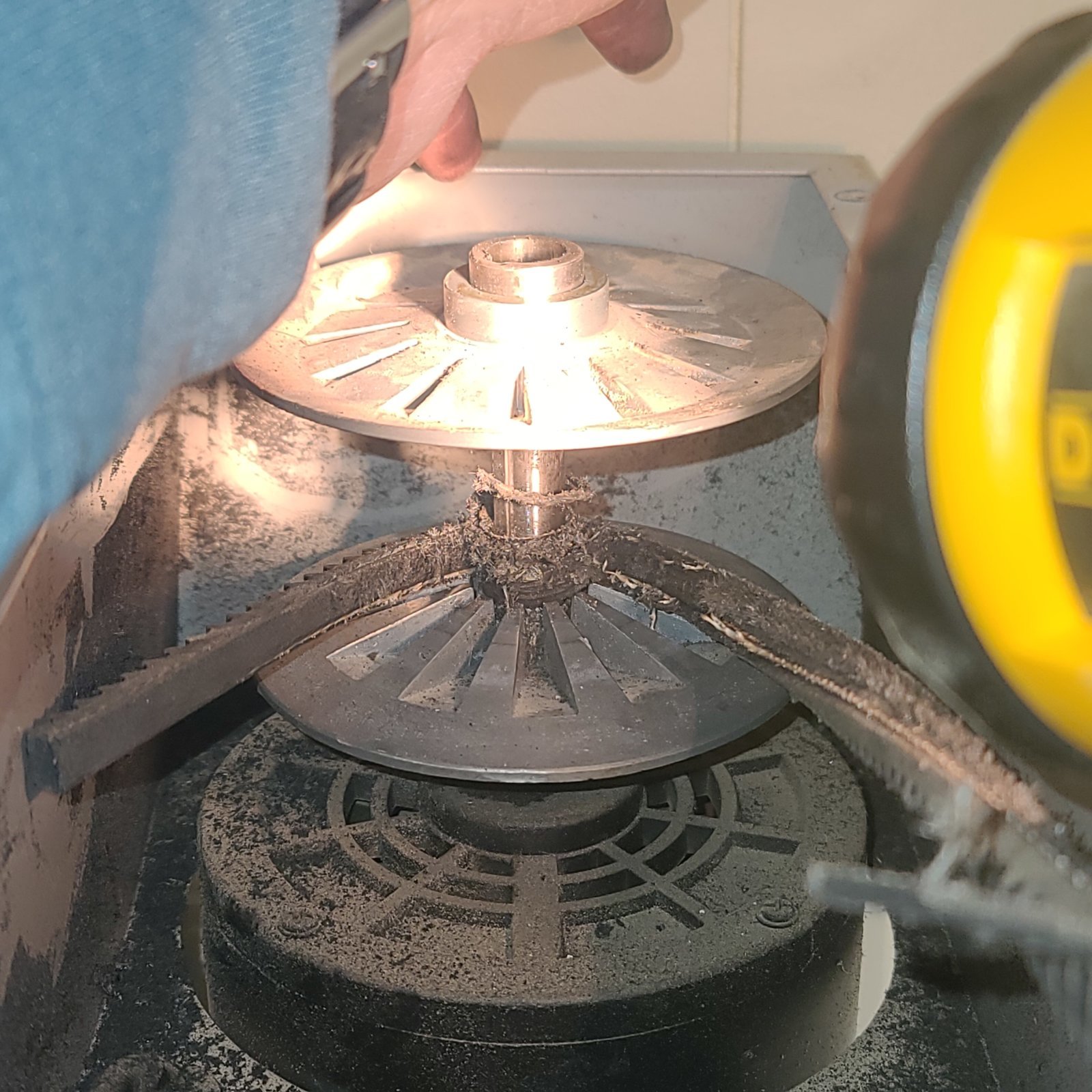

    I was making good progress, had the drill press set at its slowestbspeed so I didn't burn the bit up. Then I heard thwap thwap thwap thwap and rubber started coming out the back of the drill press right before it locked up at full depth of hole. I smell rubber! That's not good.
    Shredded the belt and it got all wrapped up in the reeves drive.

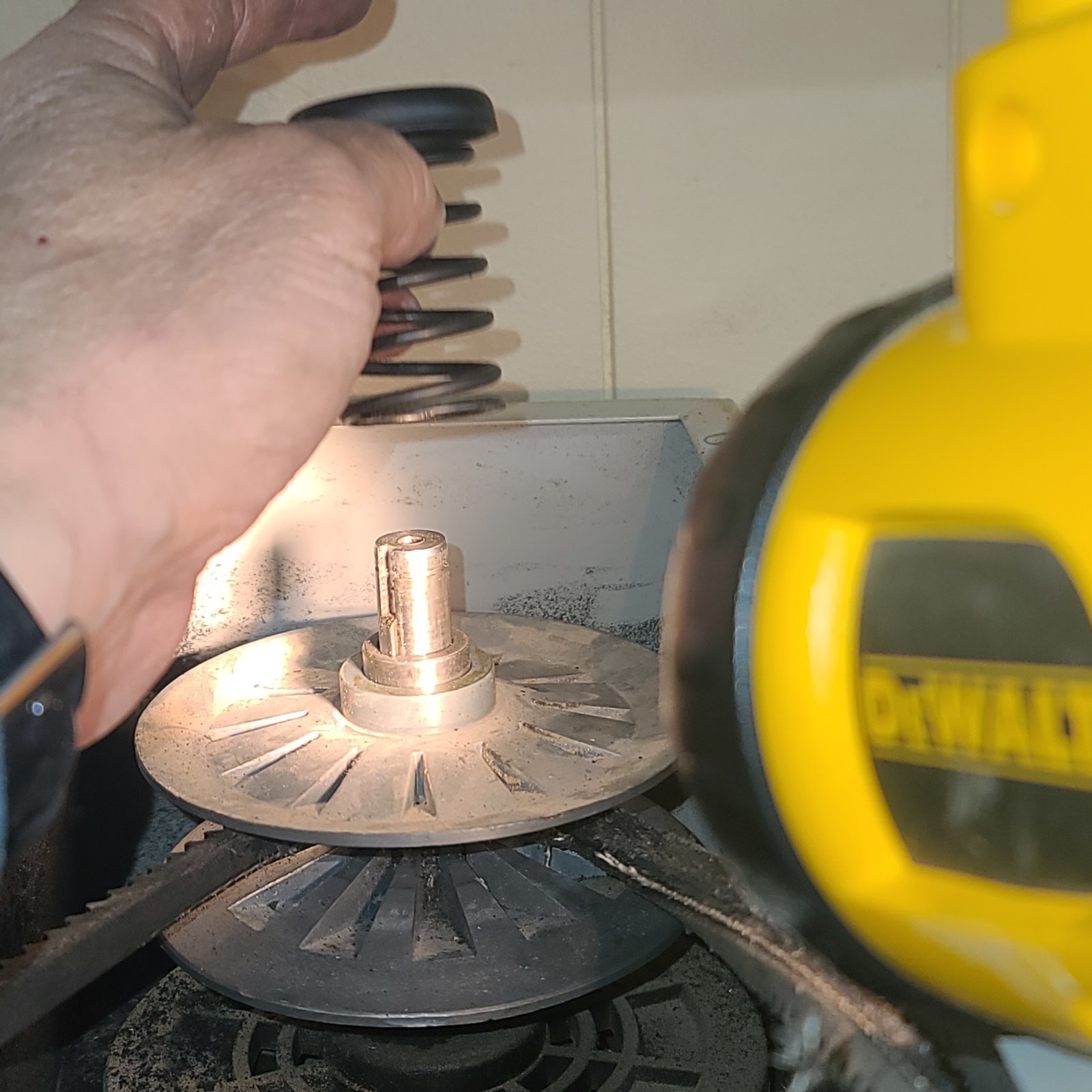

    I had to take the drive apart to get the belt out. I covered the top of the spring while I took the snap ring off so it didn't launch everything.
    Then I was able to remove the top pully half.
    Old delta can be hard to find parts for sometimes but I found the belt on ebay. It's a 2007 drill press, I like it because of the variable speed. I've never really needed anything bigger than it's 12" size. So I'll clean the top half up while I'm waiting for the belts to come. Dead in the water for now.
    Stuff happens.

    Do you know the belt size? It might be possible to find one at a parts store if you know the length.

    What model#?
    Is a DP350?

    I dont know the length, it was pretty shredded. And its cogged on the inside so not just a simple belt.
    Yup, it's a DP350 type one. 2007 I believe.

    Dunno what the advantage is. Heat reduction or grip?
    Different machine but we bought new rotortiller 1 season or so use and belt wore out. Bare used it a handfull times...put new belt on and ive used it about the same amount and new belt is holding.

    It's not for grip, it's for flexibility so it can make a tight bend.
