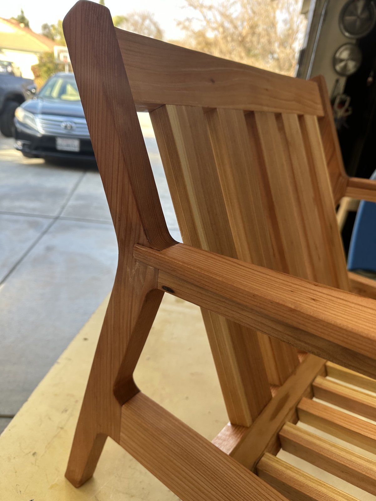

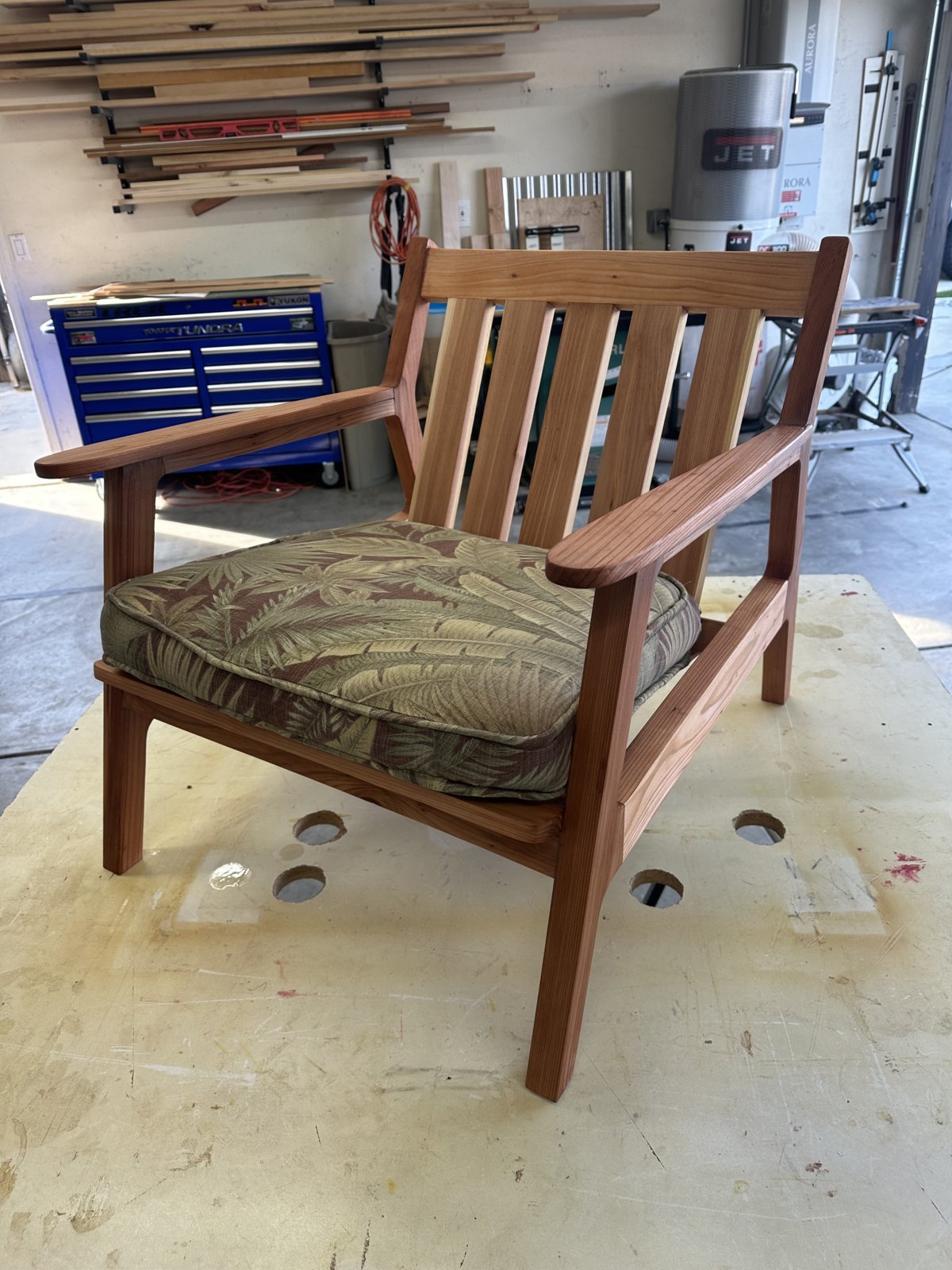

    Went with Watco Danish Oil. I was going to use Pure Tung Oil, but hate waiting for a week for it to dry.
    1 coat of oil on so far.
    Will hopefully start chair #2 next weekend.

    What stock did you start off with (i.e. 2x4, 4x4, etc)?

    I used 2x8 and 2x6 lumber from Lowe’s. You could also use 2x4 for some parts, but the 2x4 selection seemed to have more moisture and knots so I skipped them. I bought extra of each knowing I will be making a second chair soon and wanting to work around knots as much as possible.

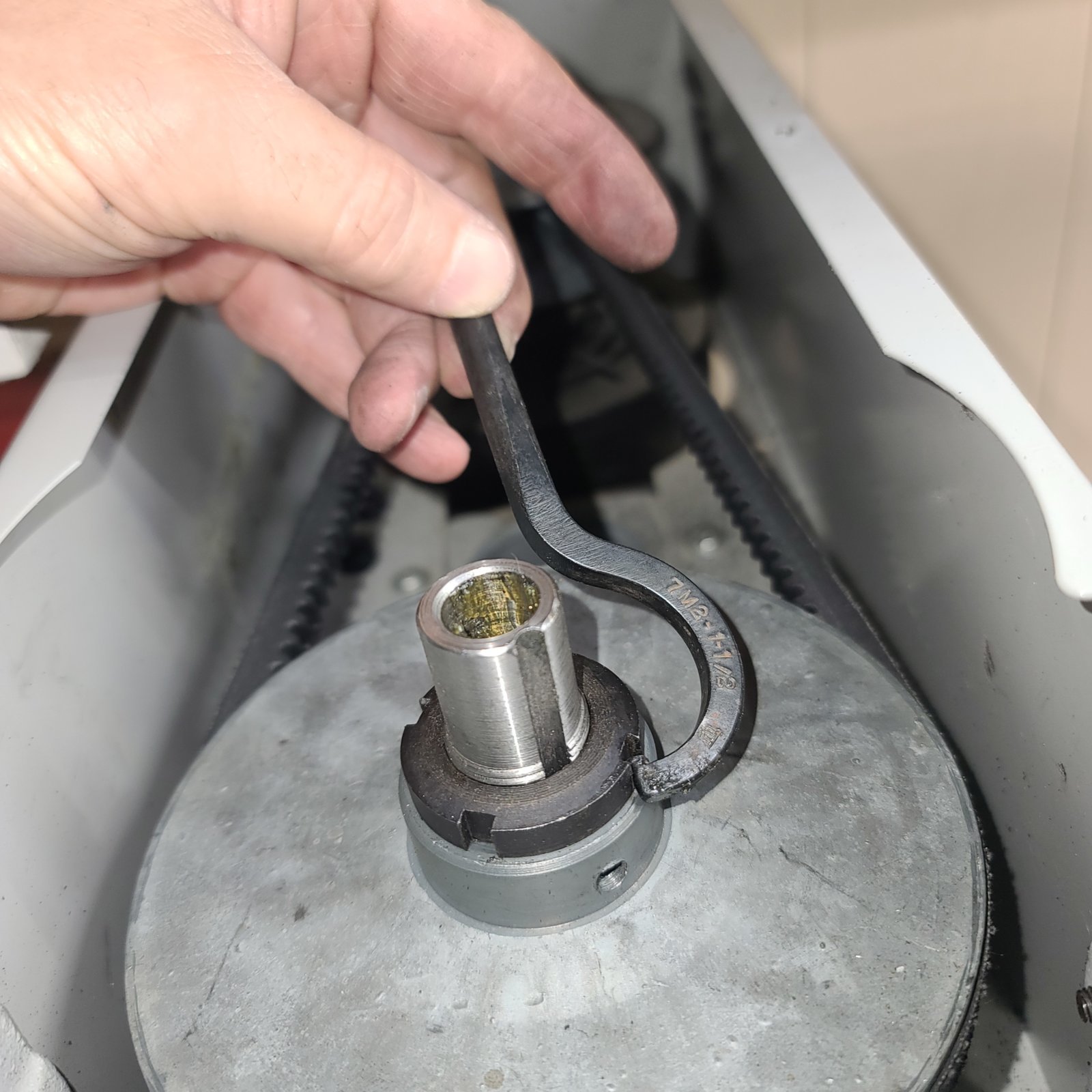

    Well I still don't have much grip strength in my thumb but I figured out how to get the belt on the drillpress and adjust it with one hand more or less, or should I say with one thumb.
    The top half of the front pully needed to come off. 1 lock ring and one set screw. Then a couple of wood wedges and light taping to work it off. You do not want to pry on these cast aluminum pullys.

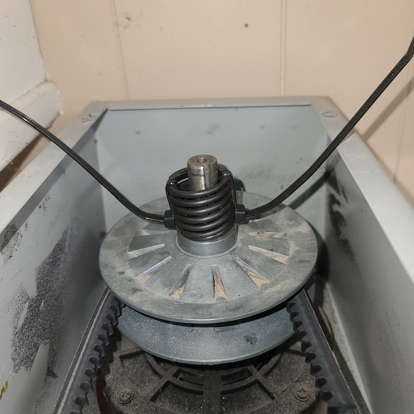

    Once I got the belt on and both front and rear pully halves it was time to put the spring and snap ring back on. Since I can't squeeze the spring I clamped it in a vice and put a couple of zip ties on it to hold it compressed. Then set it in place.
    I put the spring cap on and then the snap ring.
    Then just cut the zip ties and pulled them out with a pair of pliers.
    Here I'm backing off the lock ring on the front pully to raise the pully half up. Once it's adjusted properly the set screw will be tightened and the lock ring also tightened.
    You want to adjust it so the belt doesn't come out past the front pully when it's at its slowest speed. This also keeps the belt from rubbing on the speed adjuster shaft.
    So the drill press is back together, tested and fully operational again. So soon back to drilling out the waste on the leg mortices I hope. I'm a one thumb man still.
