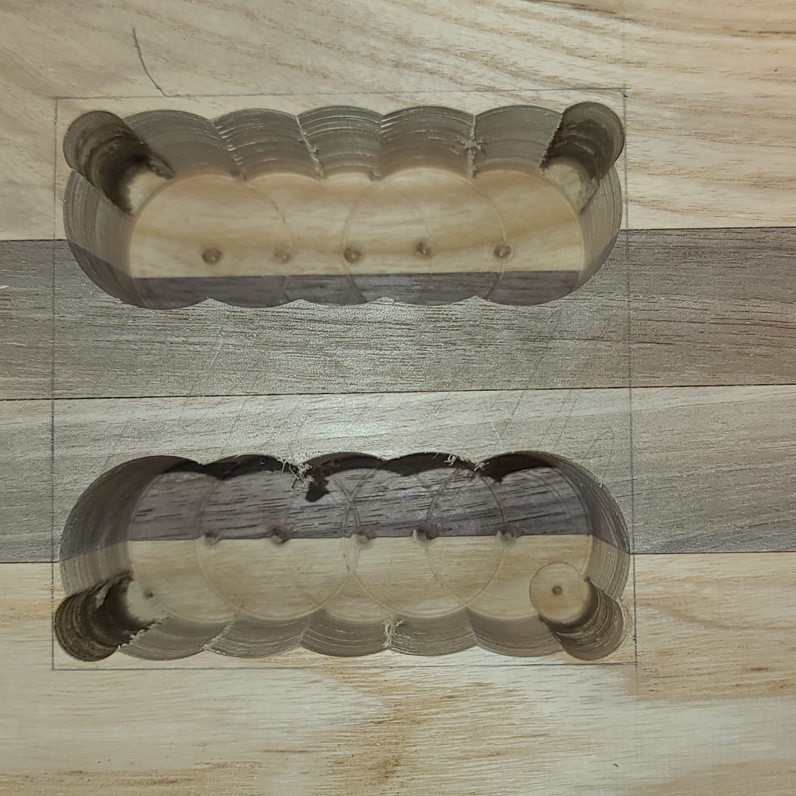

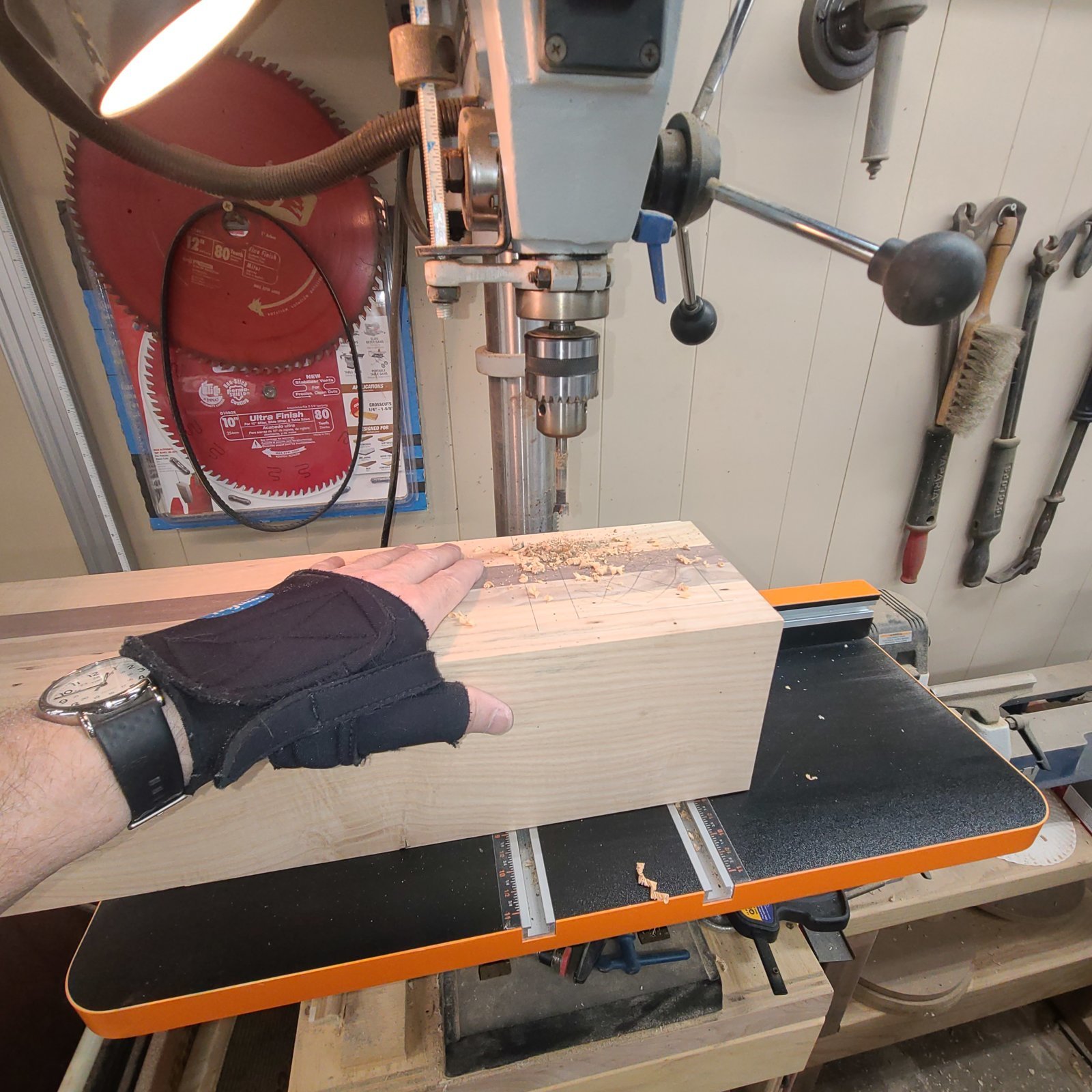

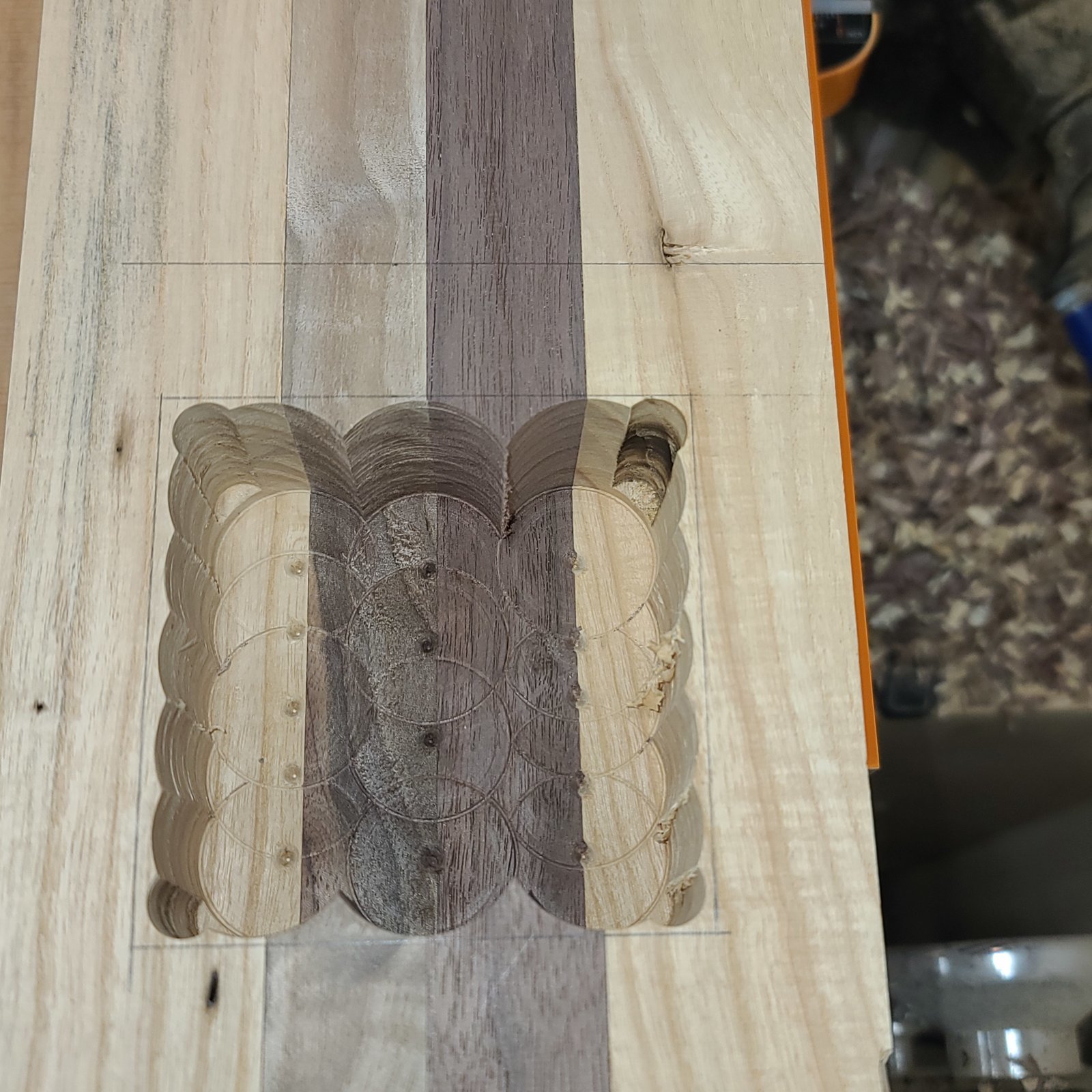

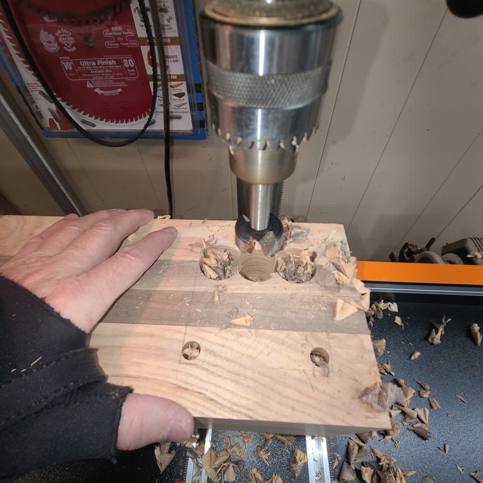

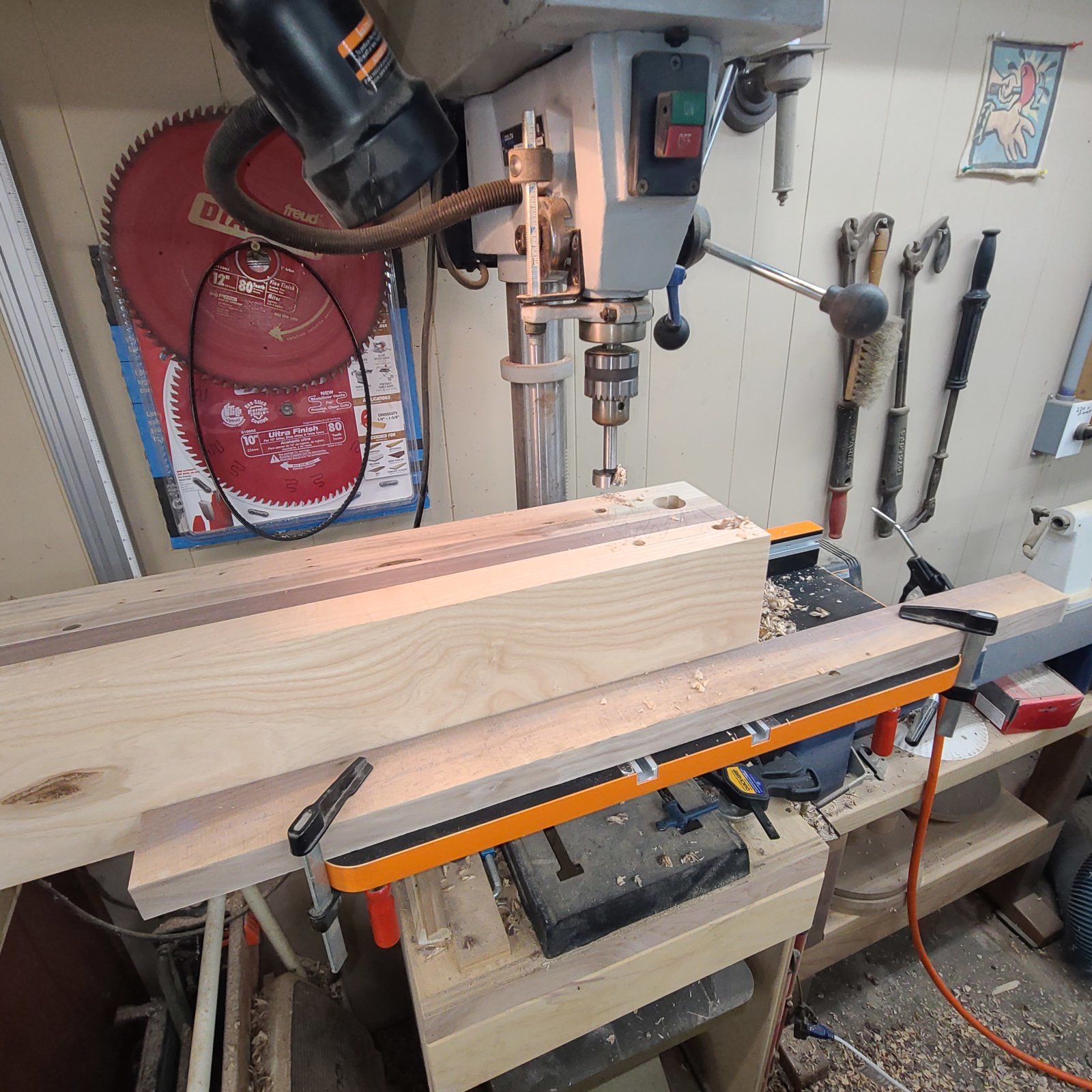

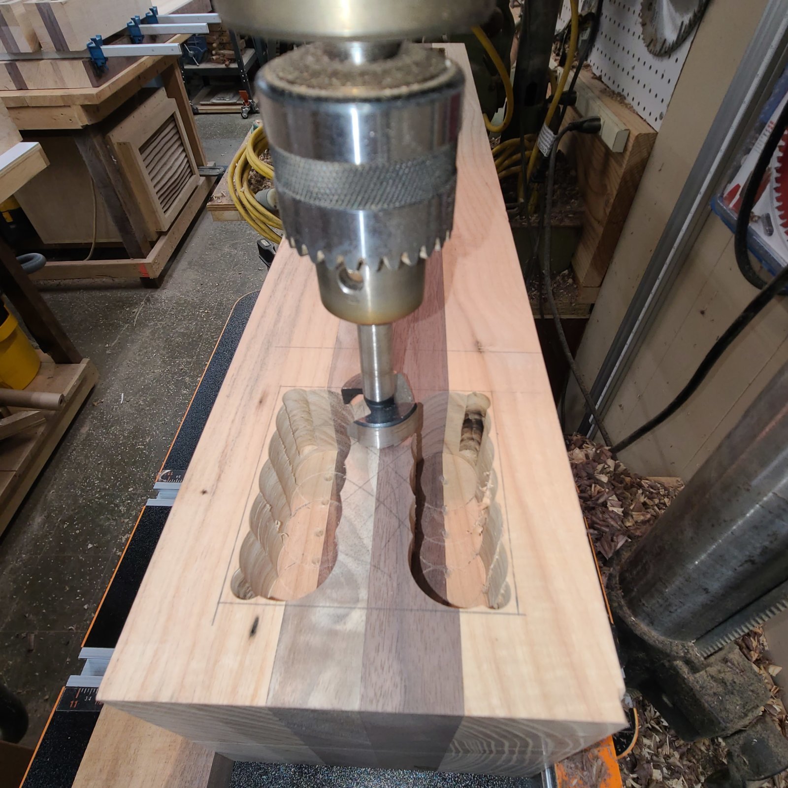

    So my thumb is feeling a little better , I put my brace on and went to the shop. I've been away for far to long. Now that ythe drill press is operational again it's time to finish drilling the corner holes.
    The I switched to a larger forster bit to drill out the bulk of the waste.
    Drill one row and then flip the piece and drill the other side.
    I clamped another board to the front of the drill press table to help hold the workpiece against the fence. This made it easier with my sore thumb.
    Then I drilled out the remaining waste.
    The drilling carnage, lol.

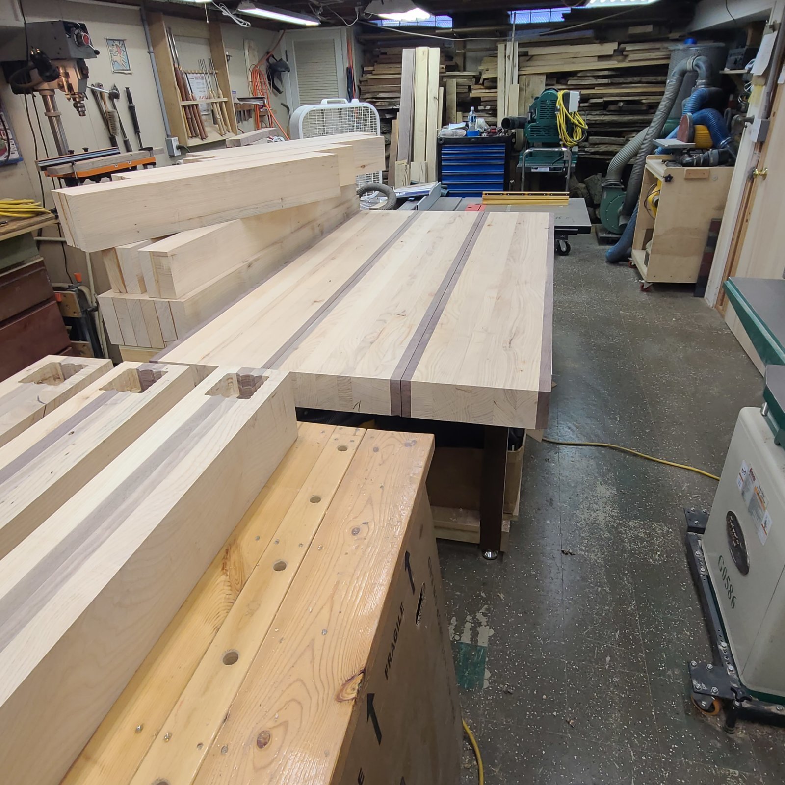

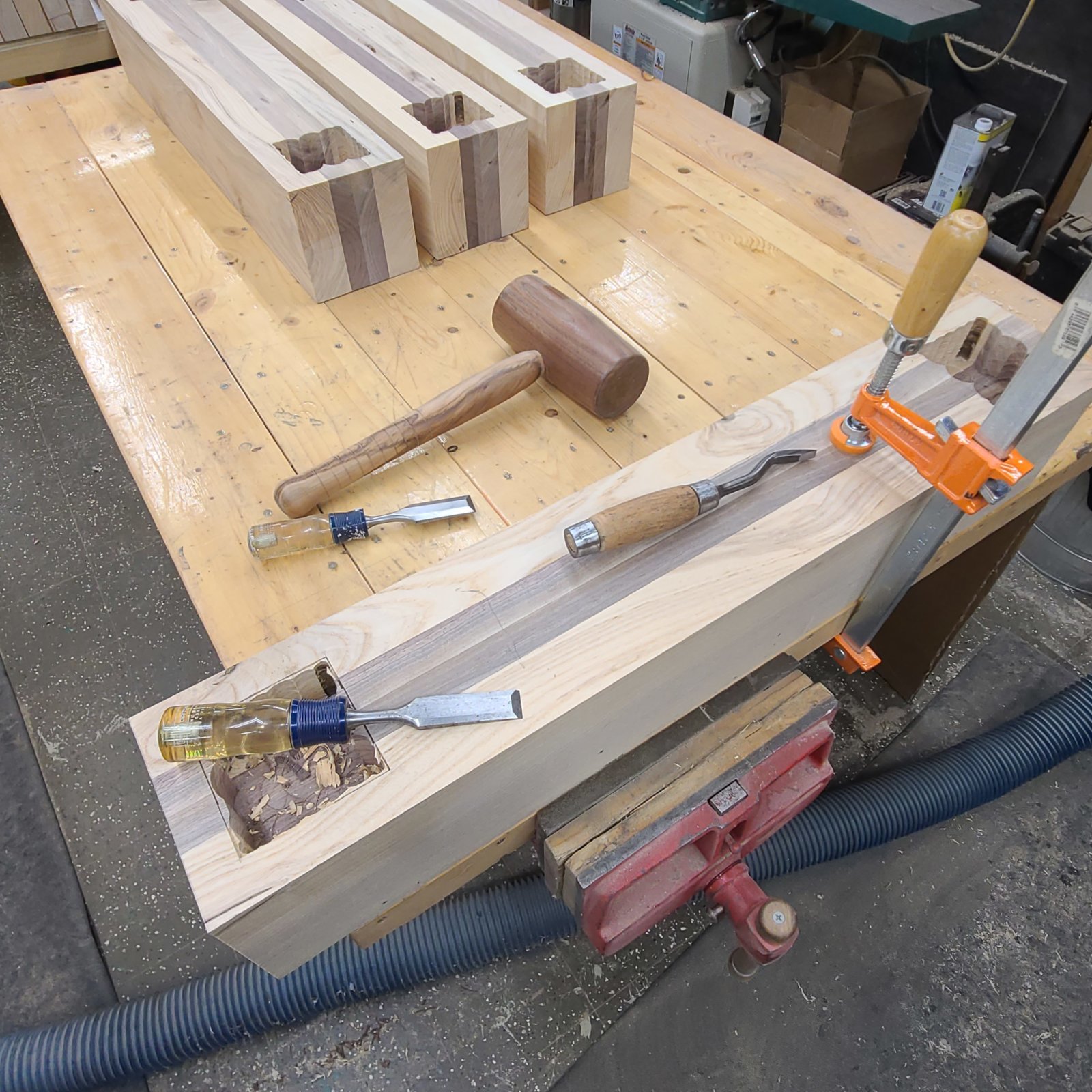

    Now it's time to chop out the mortices square. I need my old bench to work on making the new bench so I solid the top onto my saw outfeedd table. Man it is seriously heavy.
    Now I can clamp a work piece to the bench to chop out the rest of the waste and square up the mortice.
    This is going to take some time with my sore thumb, but it's actually good therapy. I just can't do too much at one time.

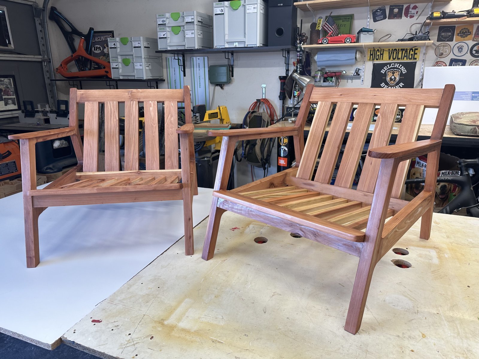

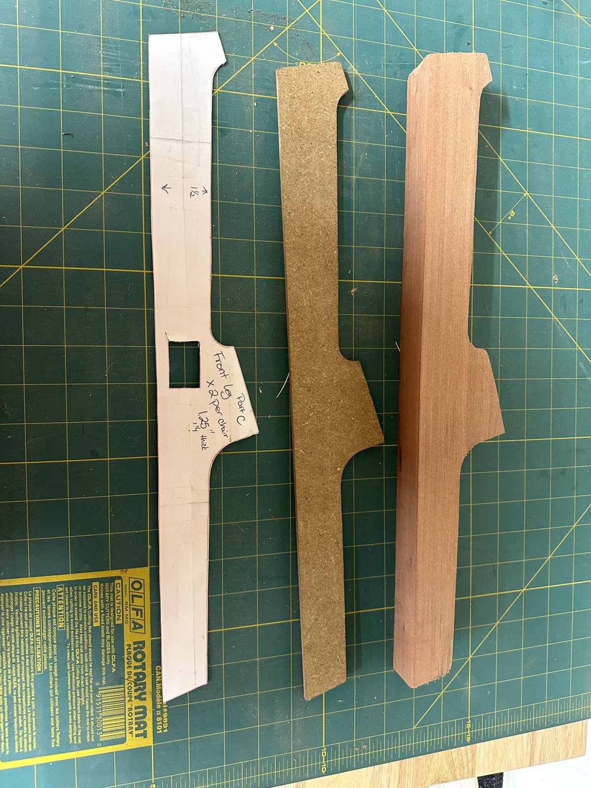

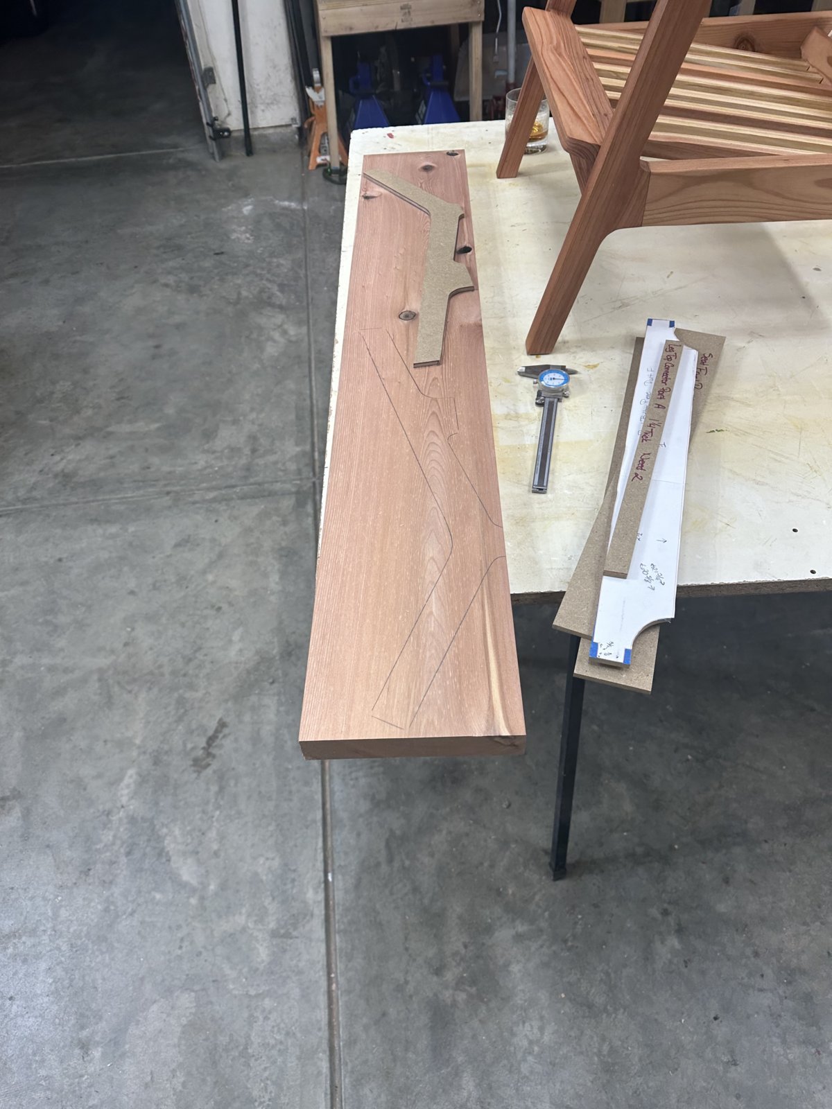

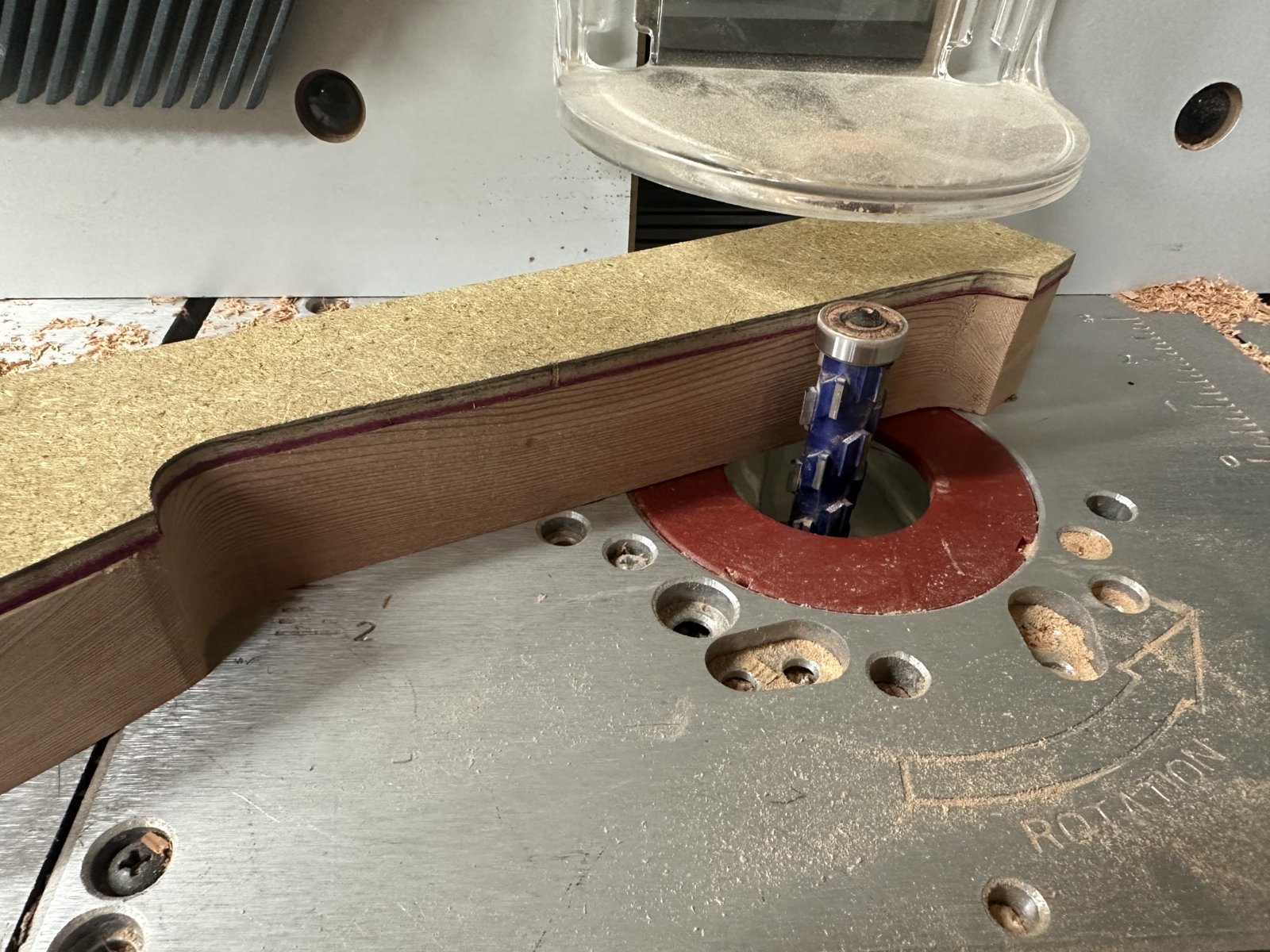

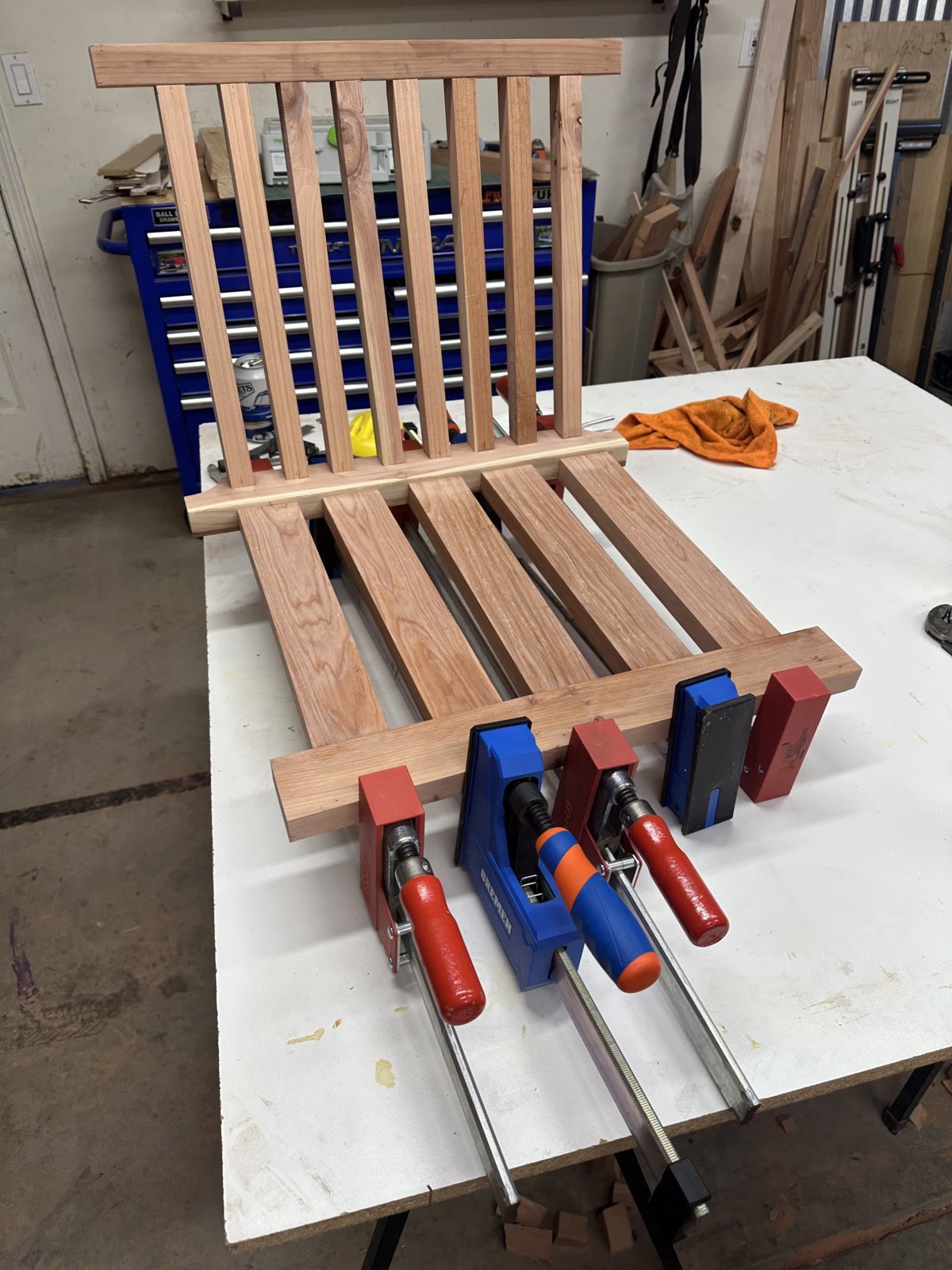

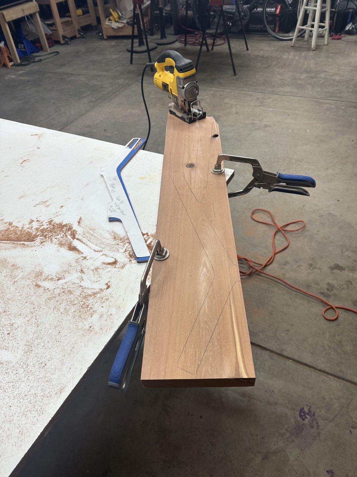

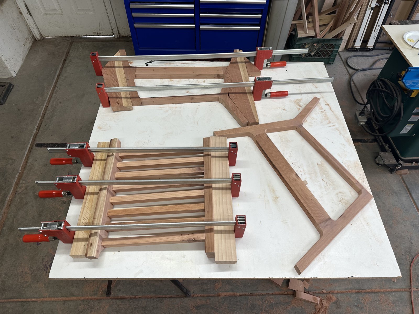

    Made decent progress on Redwood Lounge Chair #2 last night and today.
    85D067A4-C6EF-4D53-BEAA-F00A8C652354.jpg E678D4B2-E014-4ADC-9791-8EECFCE86B46.jpg 80D515B6-D461-4548-B80F-56D521F5F748.jpg C7B62078-0F93-45DF-9870-ADD65F0DACA2.jpg F4E4ABBB-0A37-4995-A79E-7107E1A2ADAE.jpg B443FDE0-EA26-4796-AAEE-C85D0180AD64.jpg

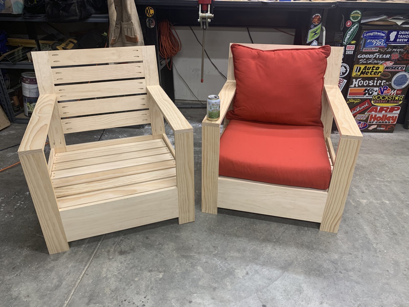

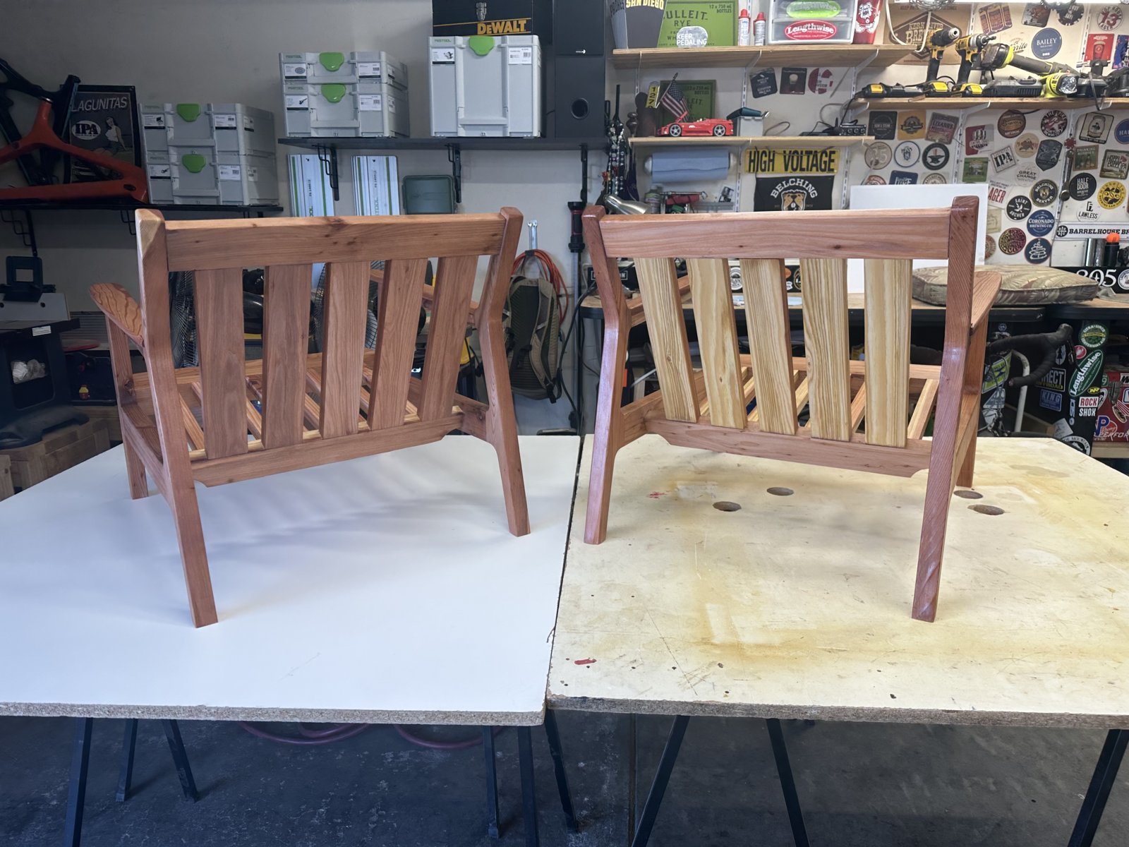

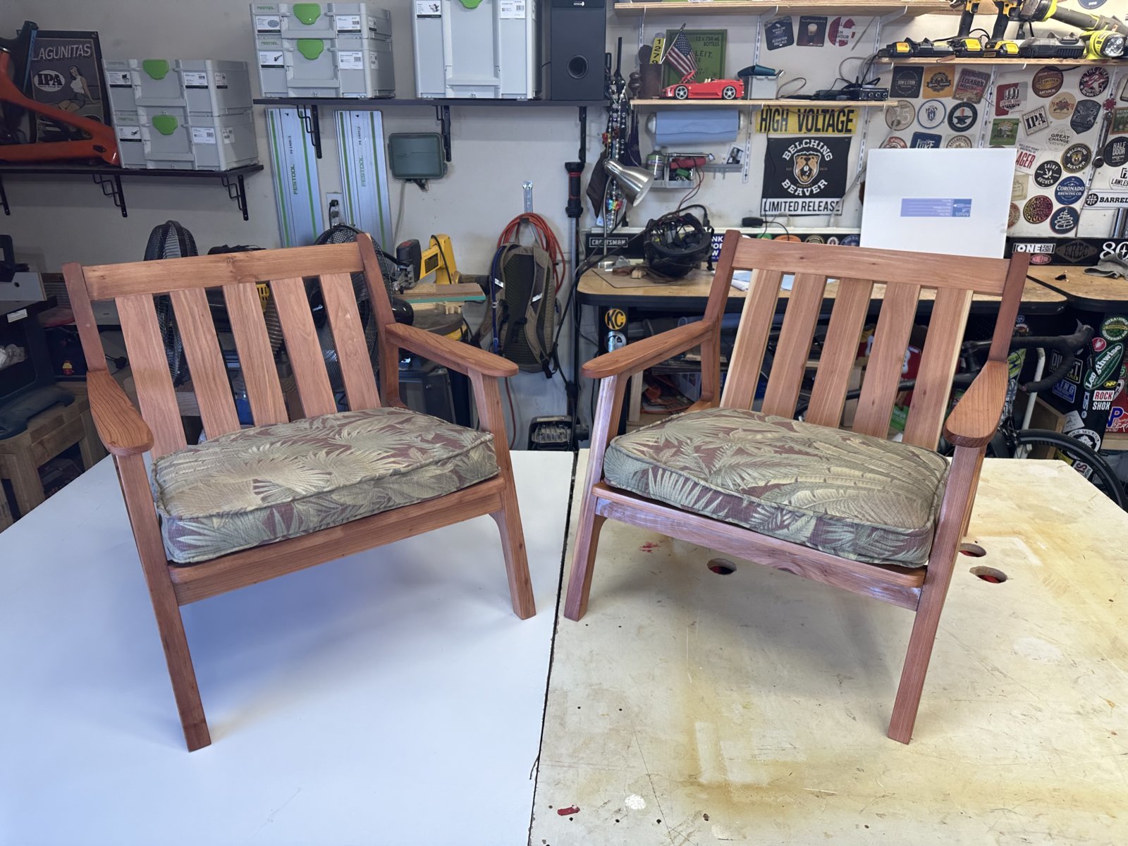

    Old patio chairs when built in 2020. This set was a replacement for the old ones of the same design that became to rotted to sit in.
    What they look like now, 4 years later.
    New Replacements

    I like the new ones way better. Great form on them.
    Awesome work!

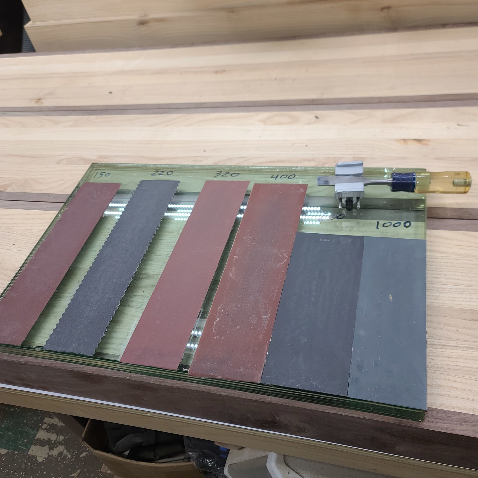

    One down and seven to go for this stage of the legs.
    I'm keeping the sharpening platten out for chisel touch ups.
    I get about 1/2 to 1 mortice done before my thumb gets sore. So this is going to take some time yet. It is healing and gets a a little better everyday.

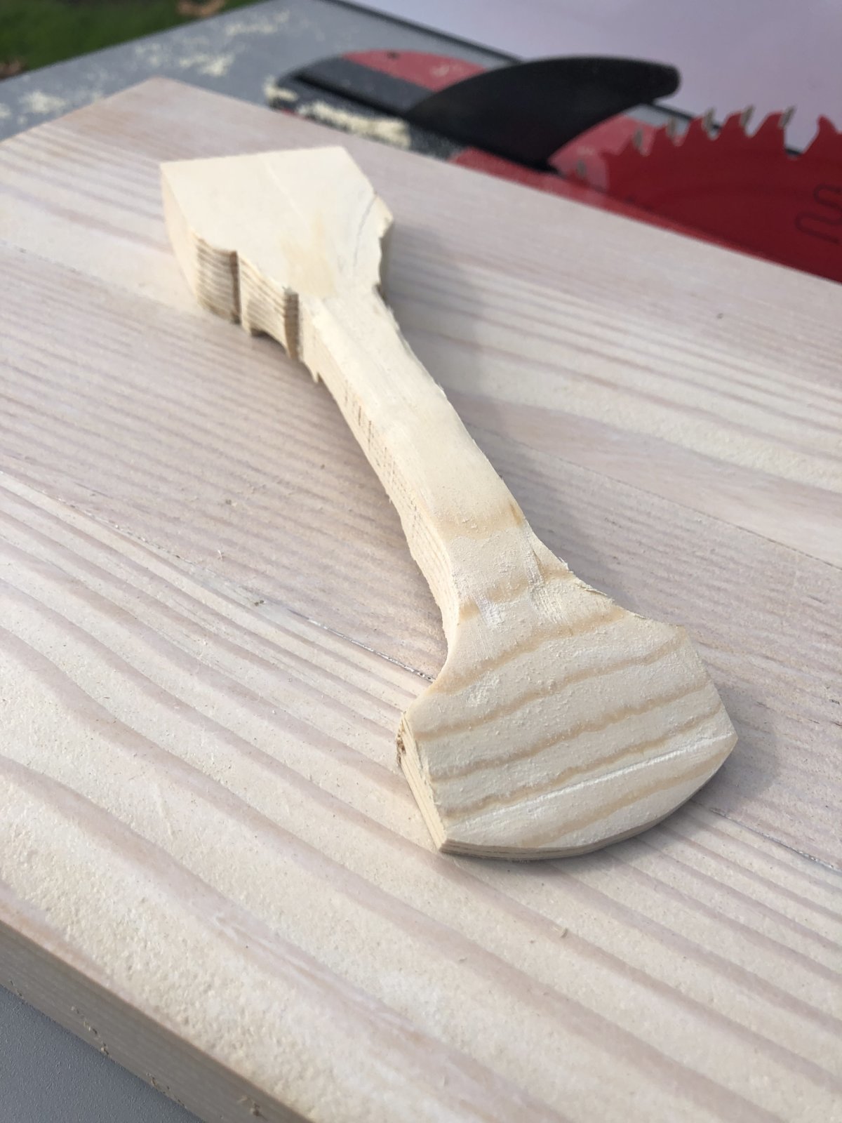

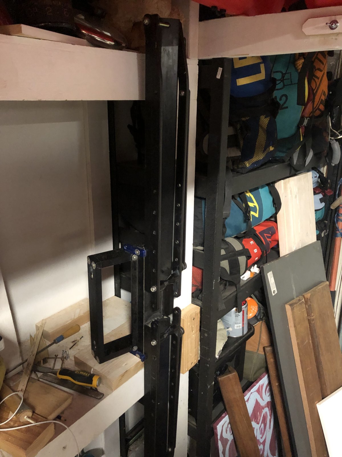

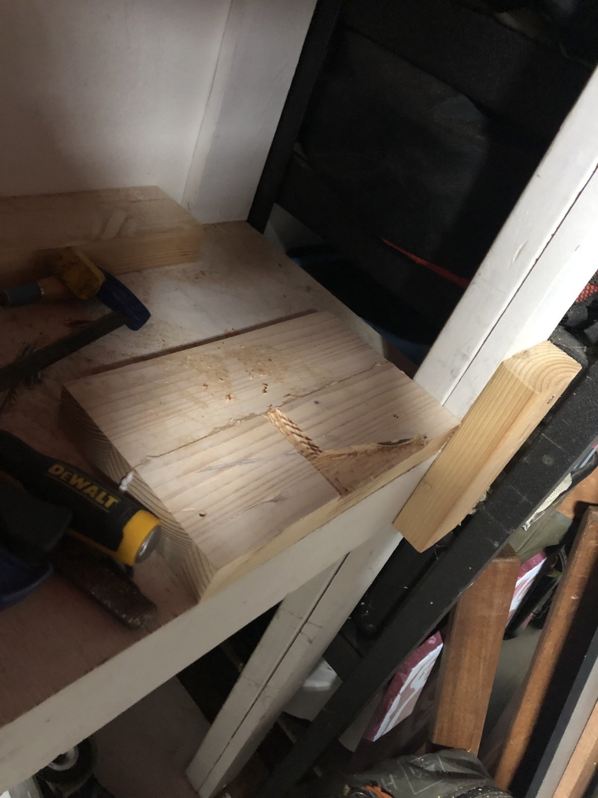

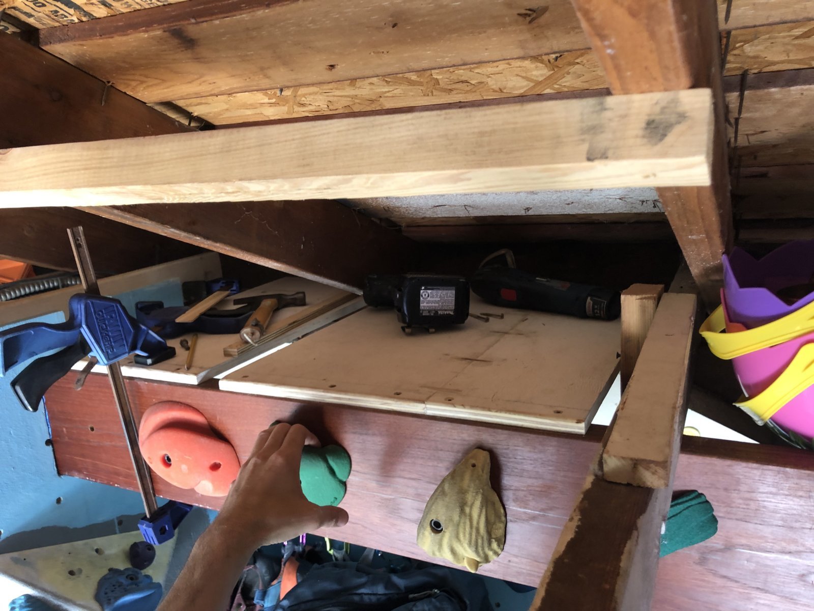

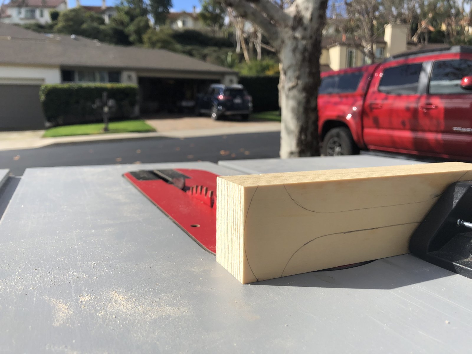

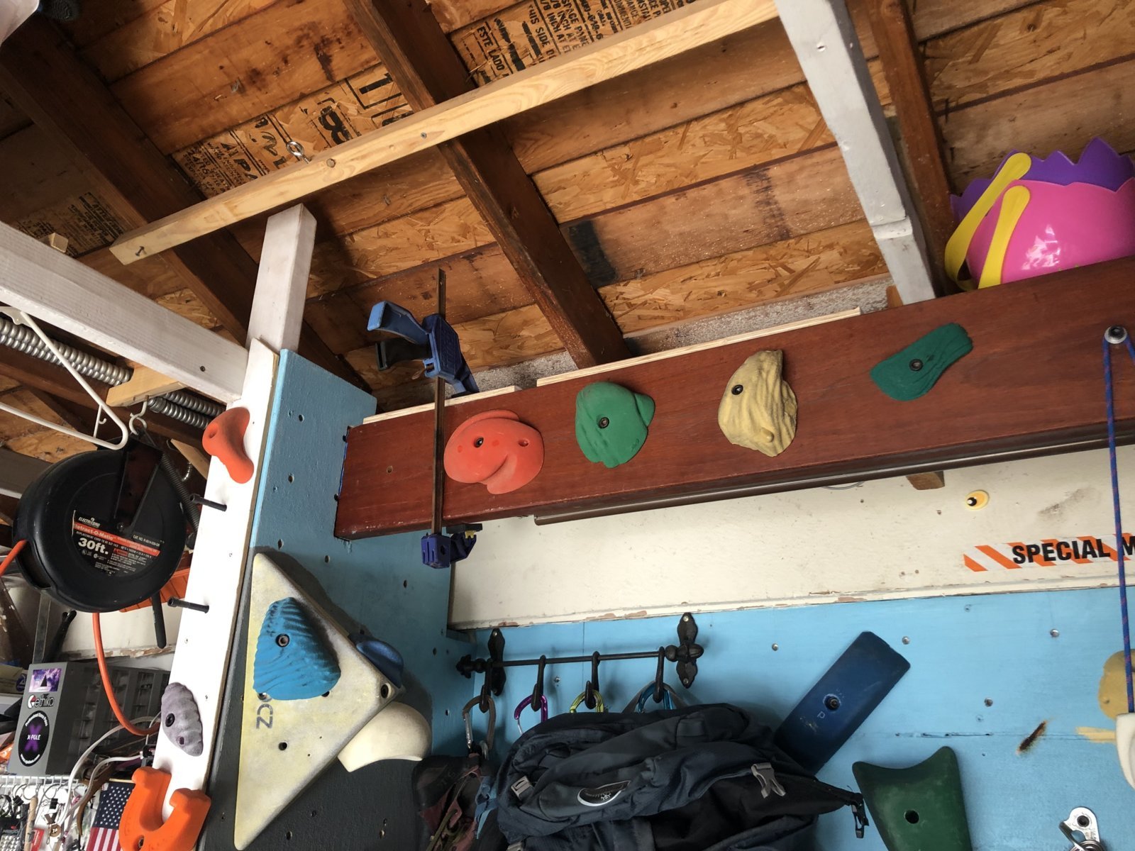

    Added structure and shelving to my rock wall, made spray can storage out of some leftover redwood, and tried to finish a stable drop point for my extra 1UP tray. And a pinewood derby car rough cut. No fine finish endeavors, but a productive Sunday.

    Yes
    That reminds me of the boxcar racer I built 34 years ago when I was in the Scouts. Looked eerily like that. I sanded it smooth and painted it gloss white with an airbrush and polished the axles buttery smooth also ran that graphite lube. We had to add weights to get it back in spec. Mine was CO2 powered and still lost. Came in 3rd I believe, been a long time.

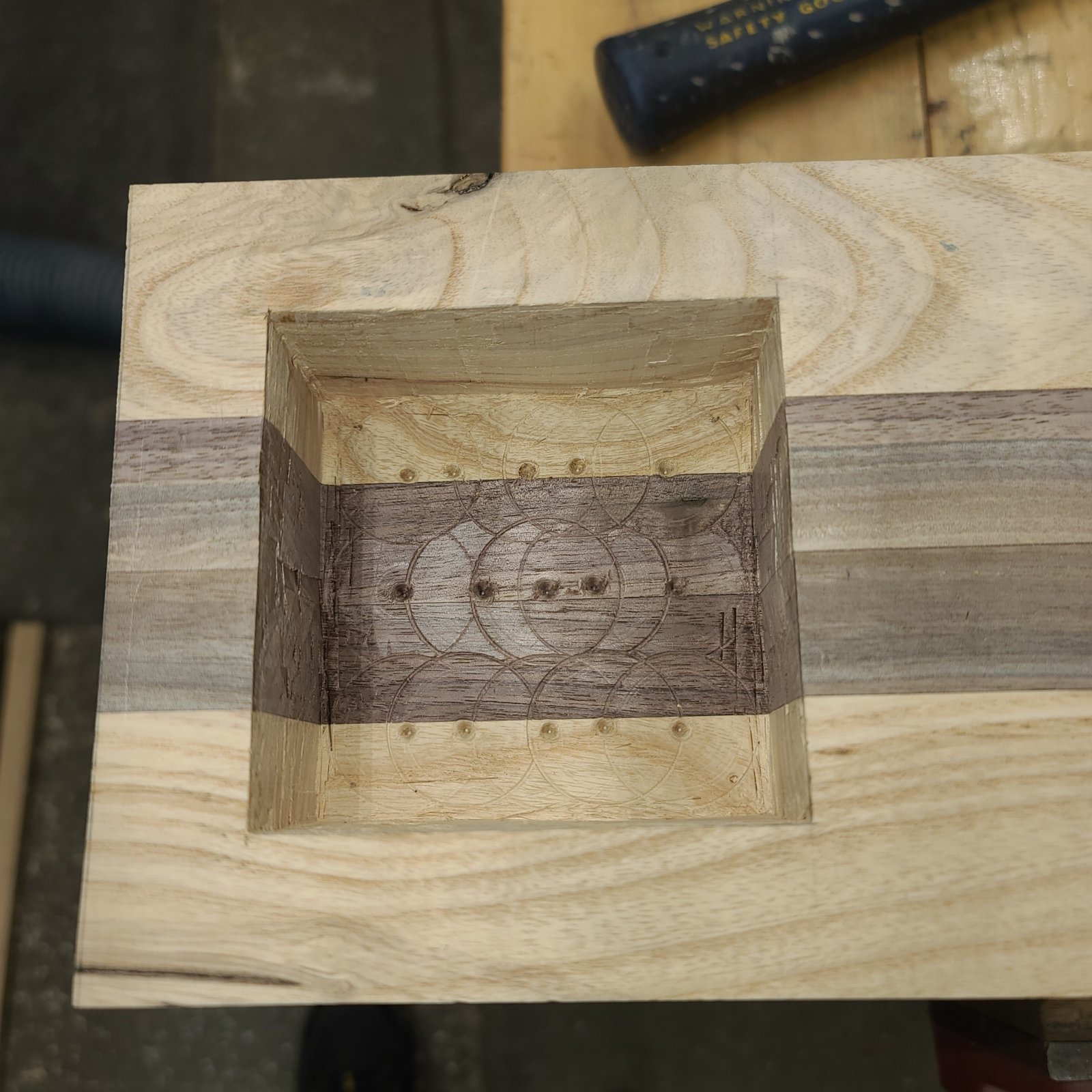

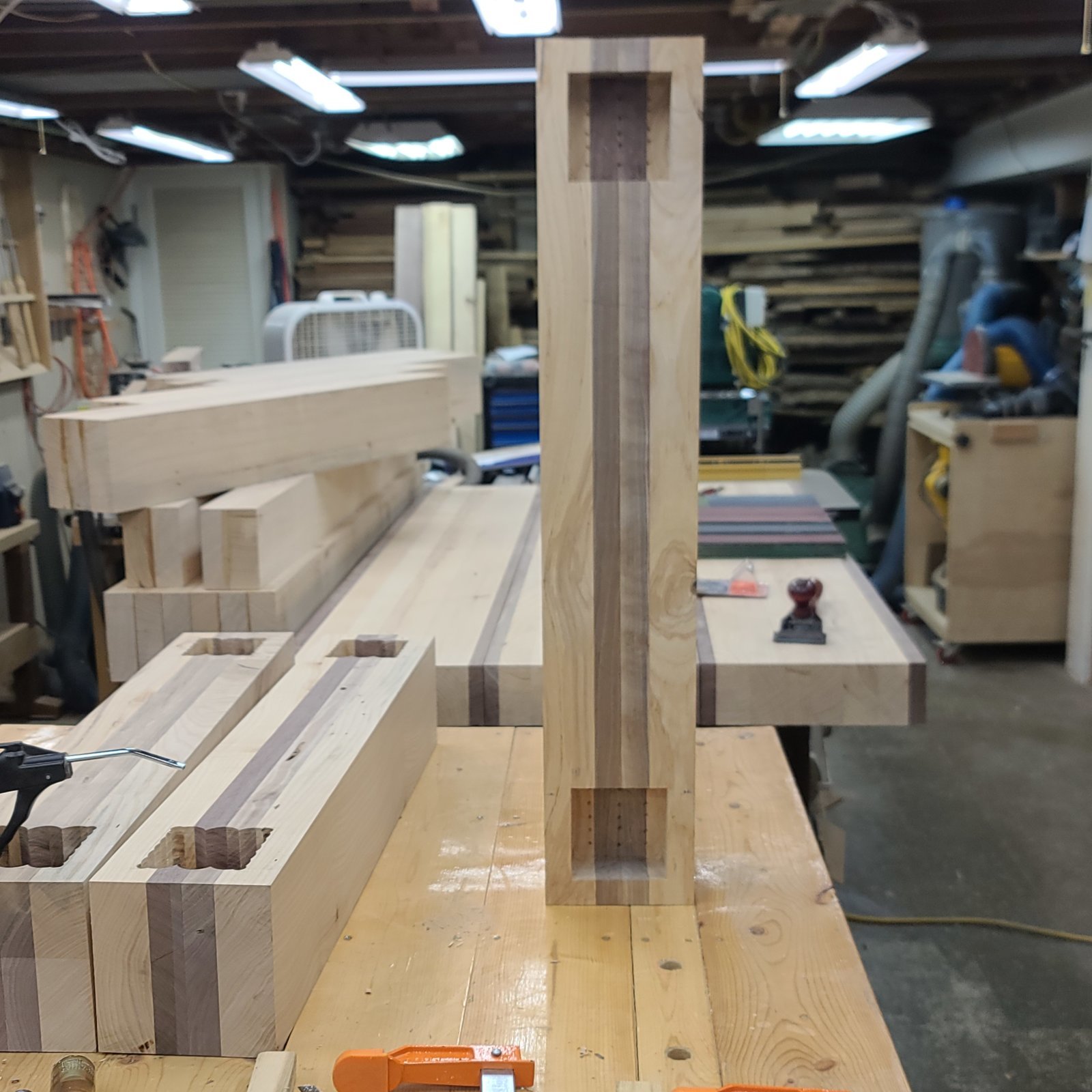

    Mortices chopped on one leg. 3 to go.......
