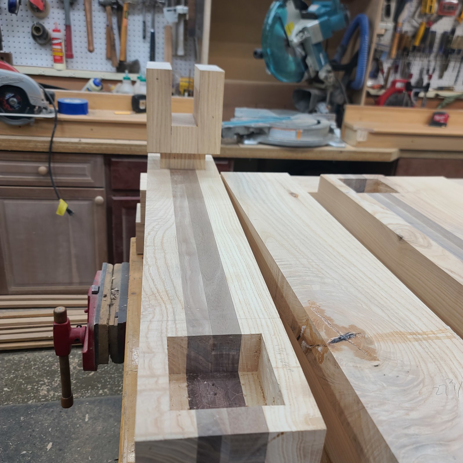

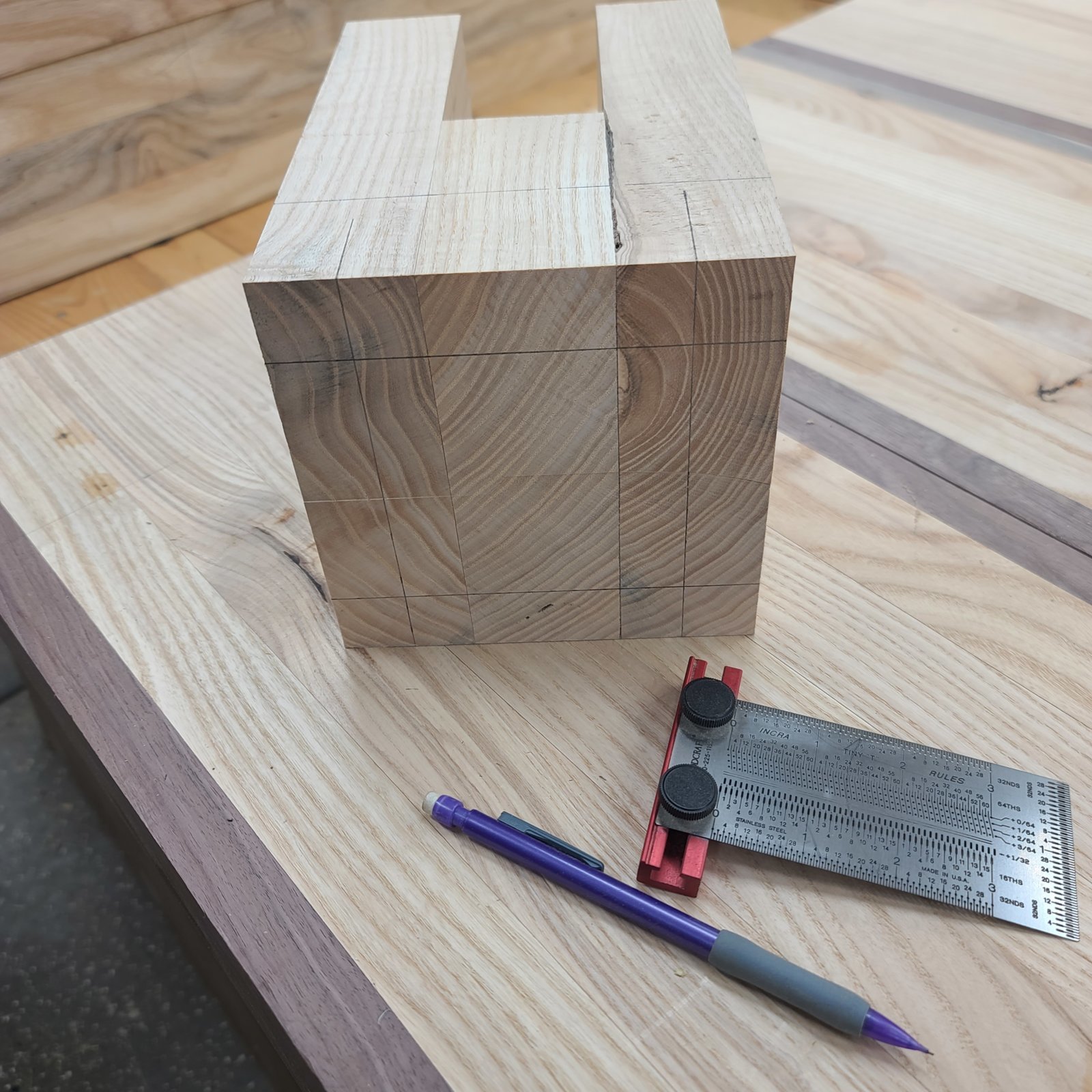

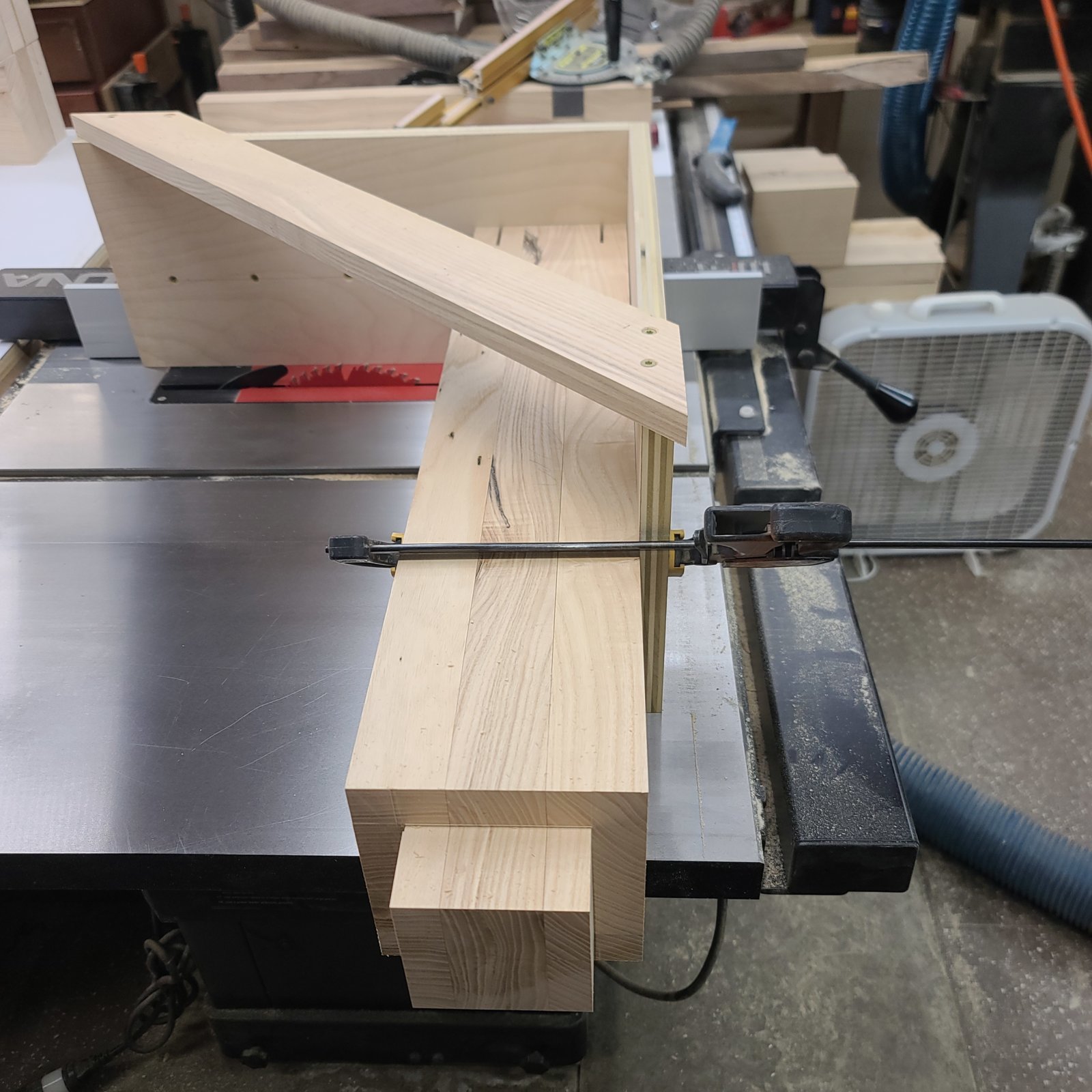

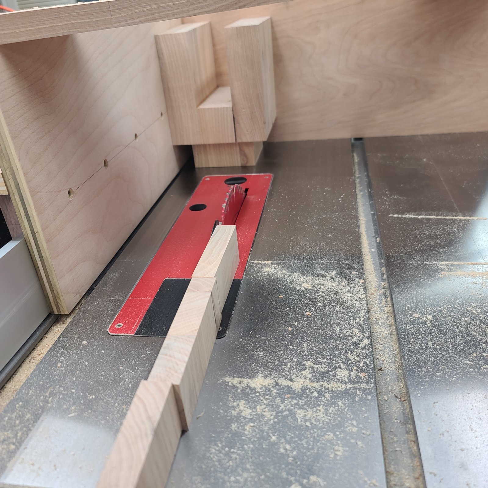

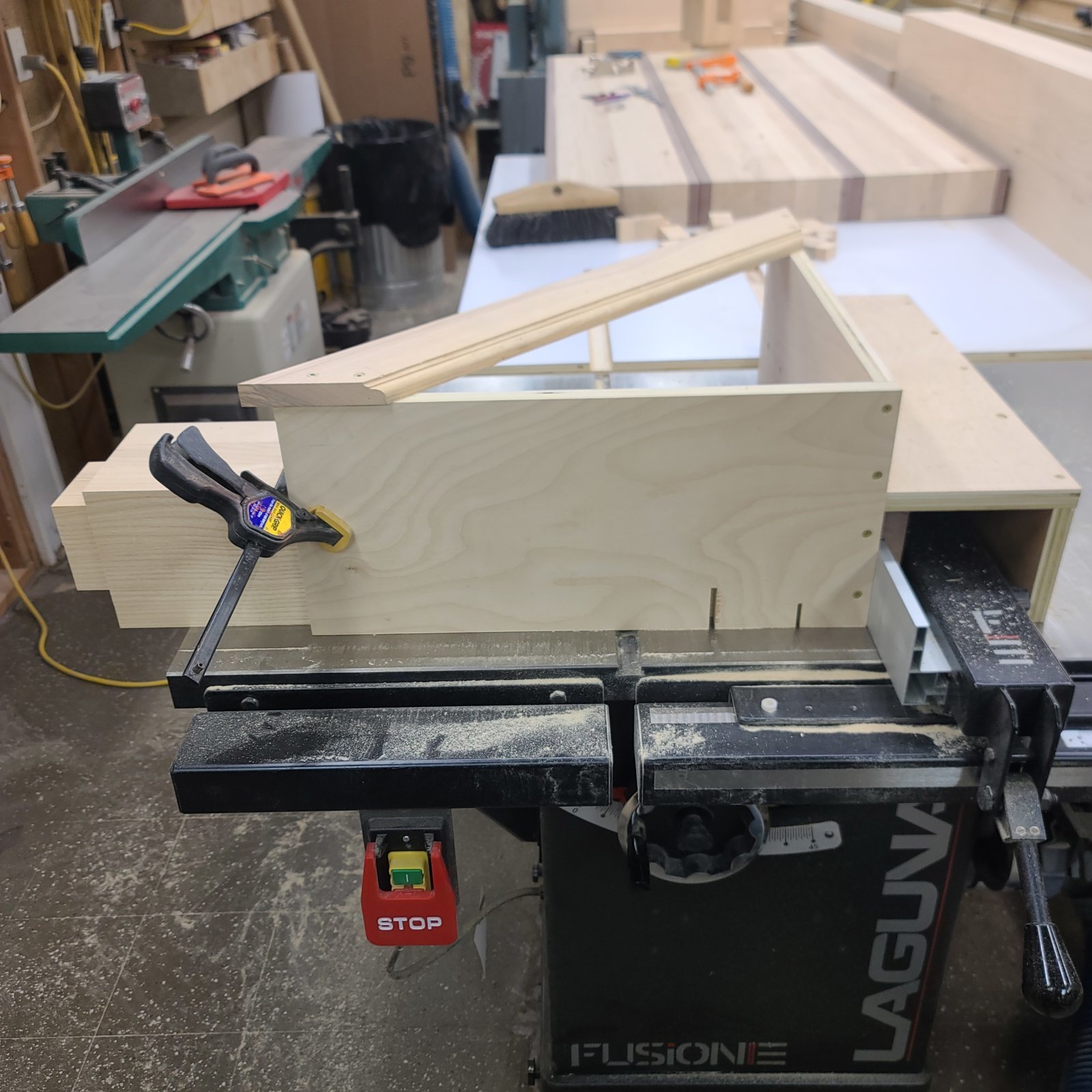

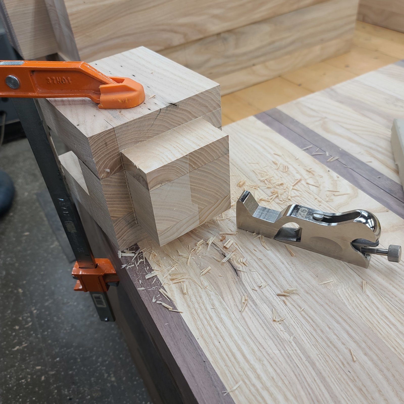

    Got some shop time today. So I grabbed an off cut from the leg stock and did some layout for the tennons. Nice to have exact size stock to make test cuts on.
    I'm using the tennon jig to make all the cuts. First I tested the shoulder cuts.
    Then I tested the cheek cuts. I made it slightly oversized.
    A rabbet plane trims the tennon to fit.
    It trimmed up well and fits nice.

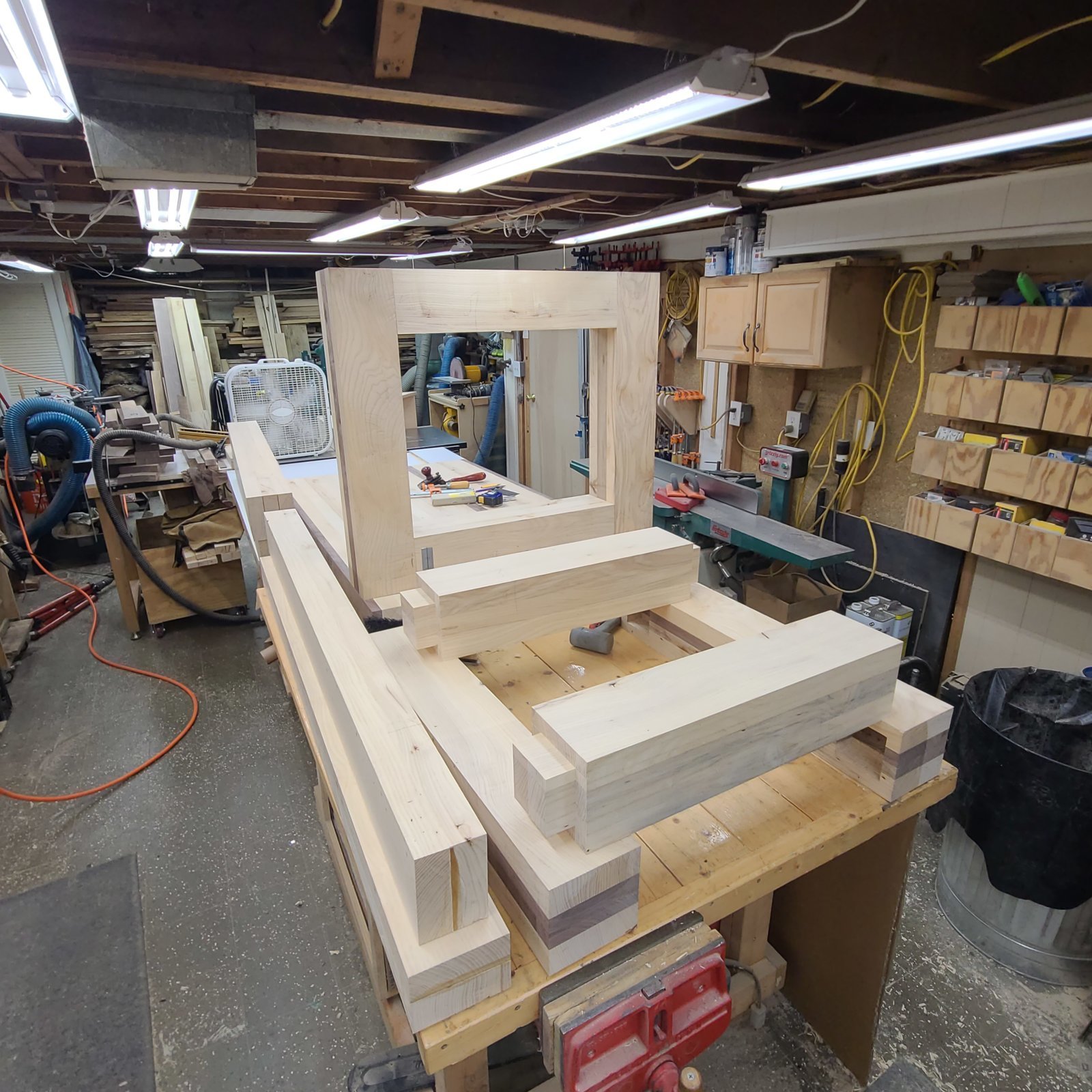

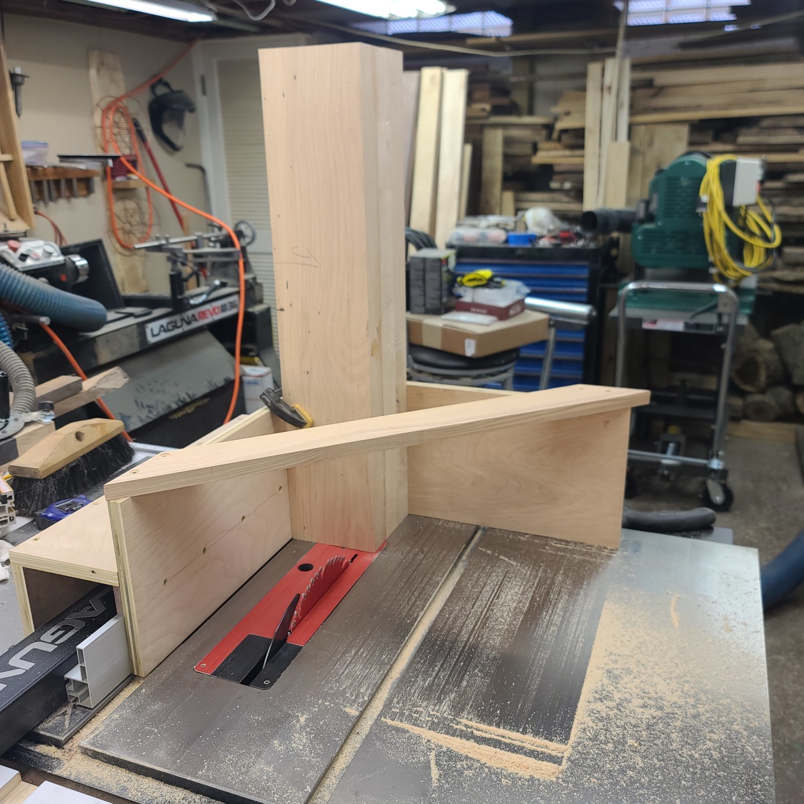

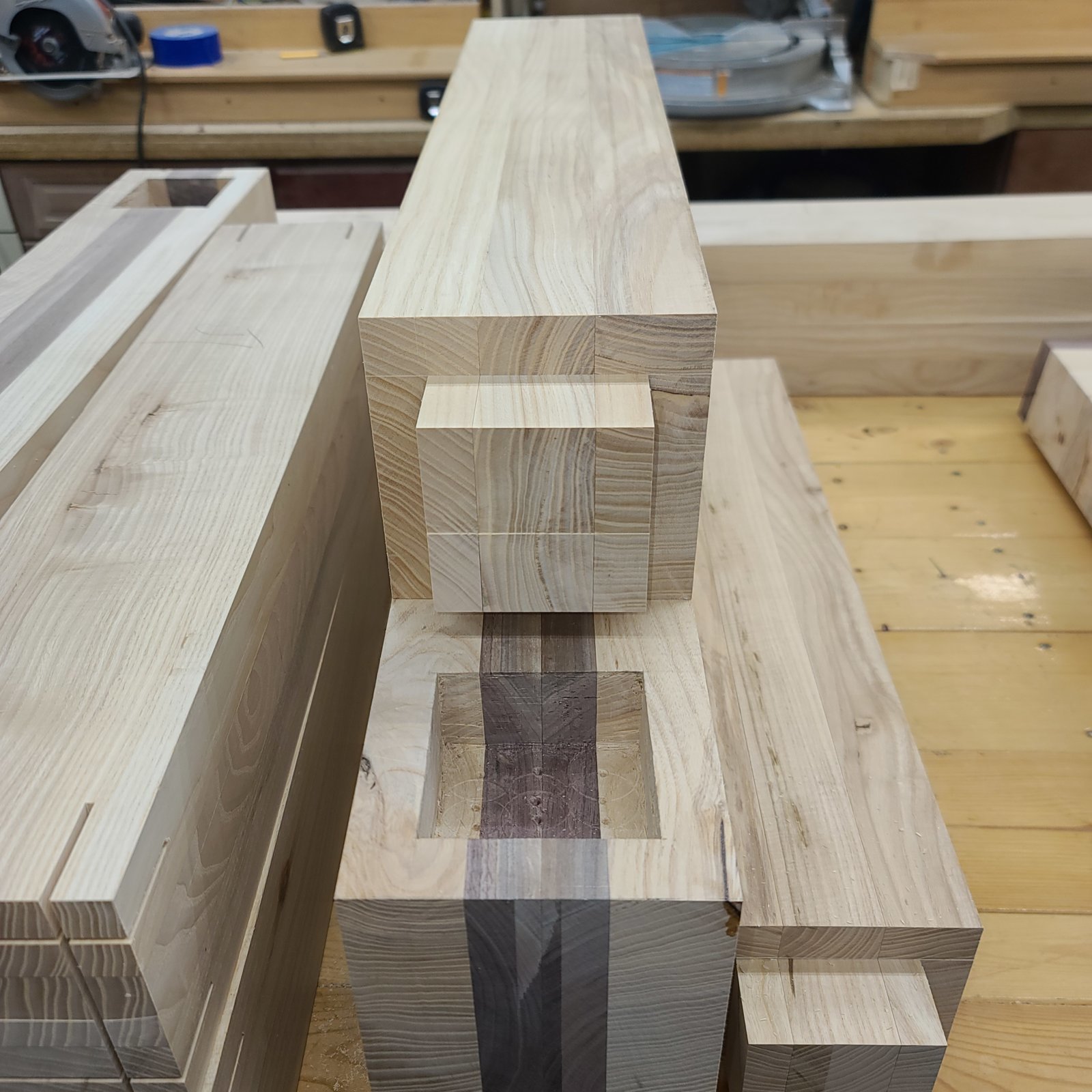

    With the set up and test cuts done its time to move on to cutting the tennons on the leg stock.
    The large leg stock is quite steady in the tennon jig.
    Cutting the shoulder cuts.
    Tennkns formed. They will be planed to final size.

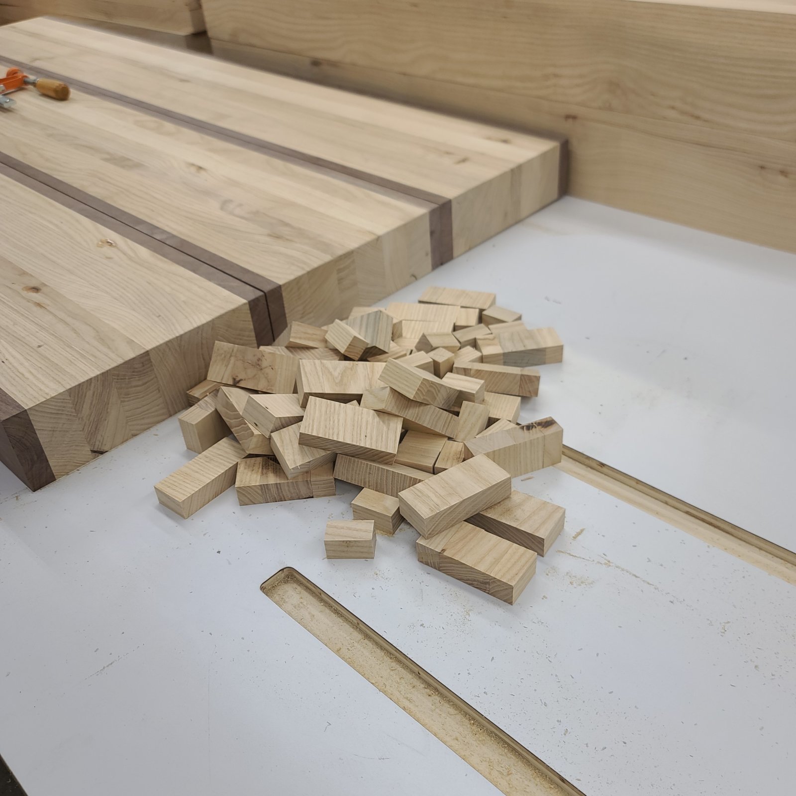

    A pile of off cuts.
    First one fitted.

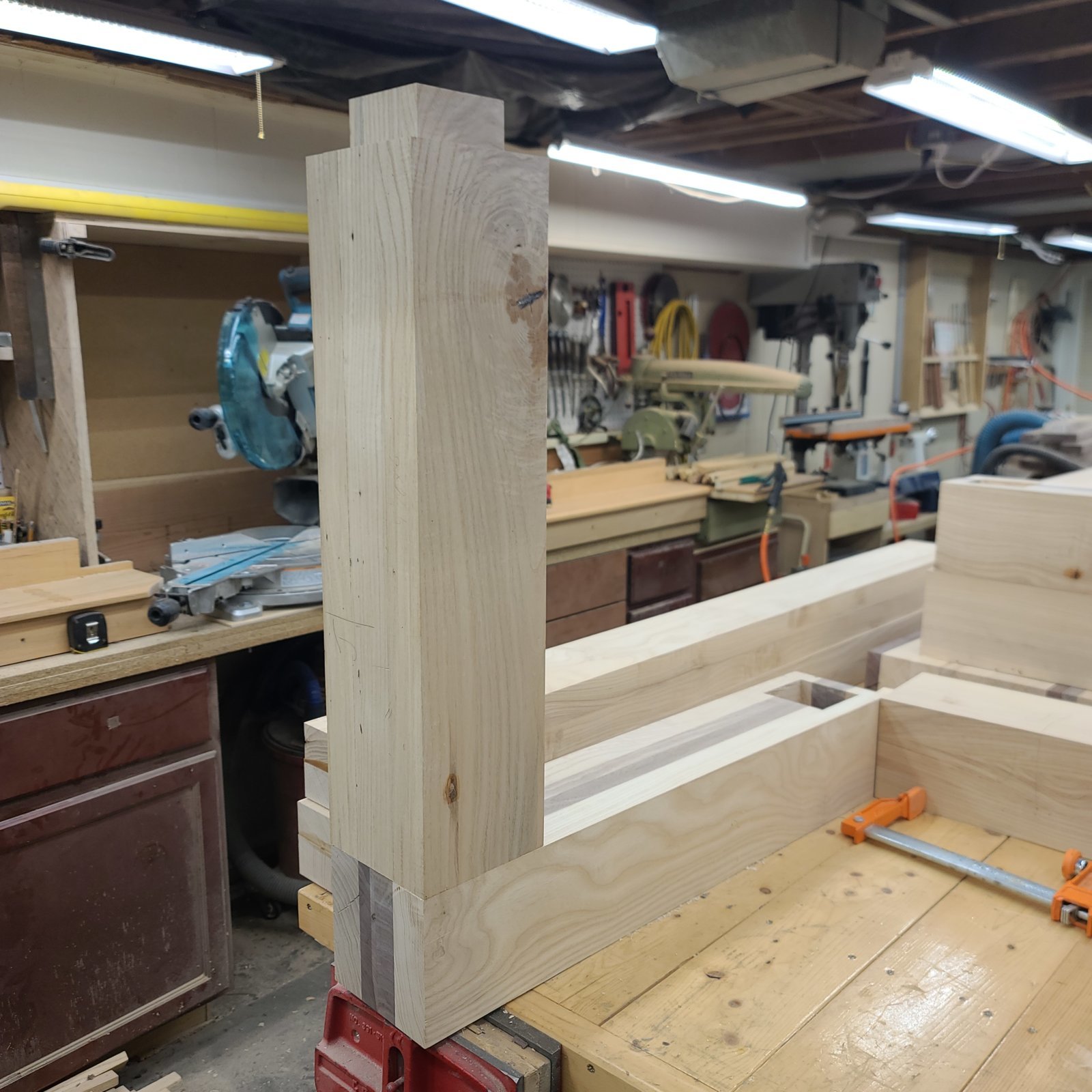

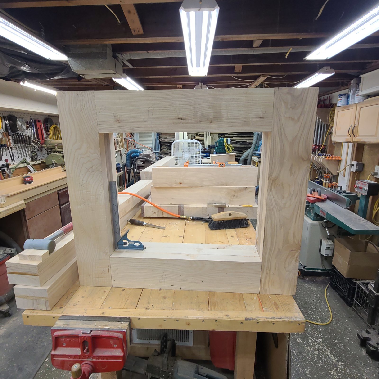

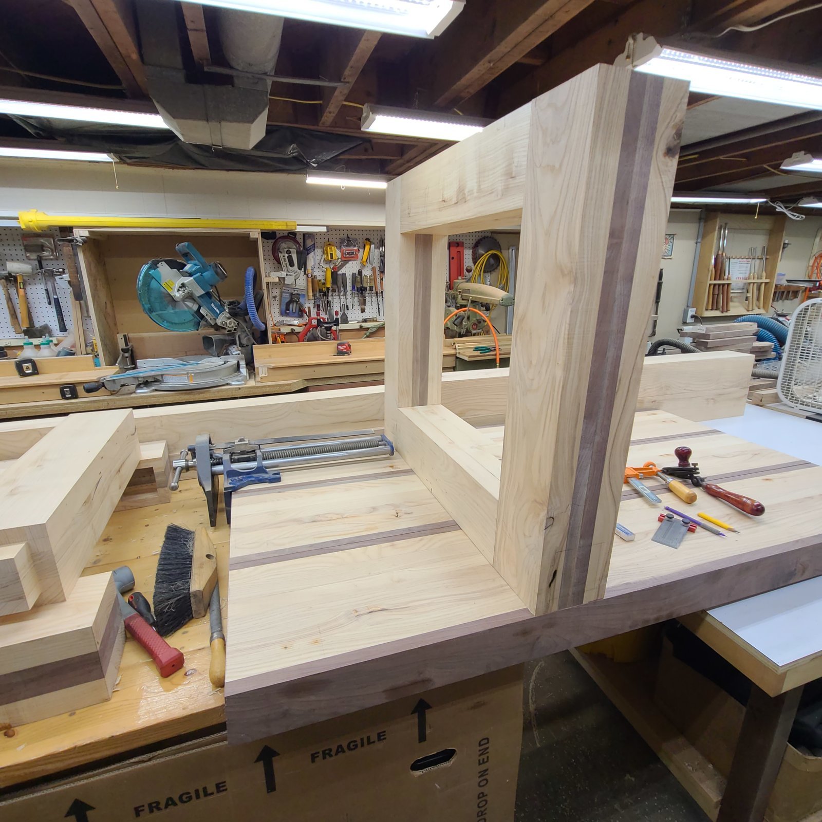

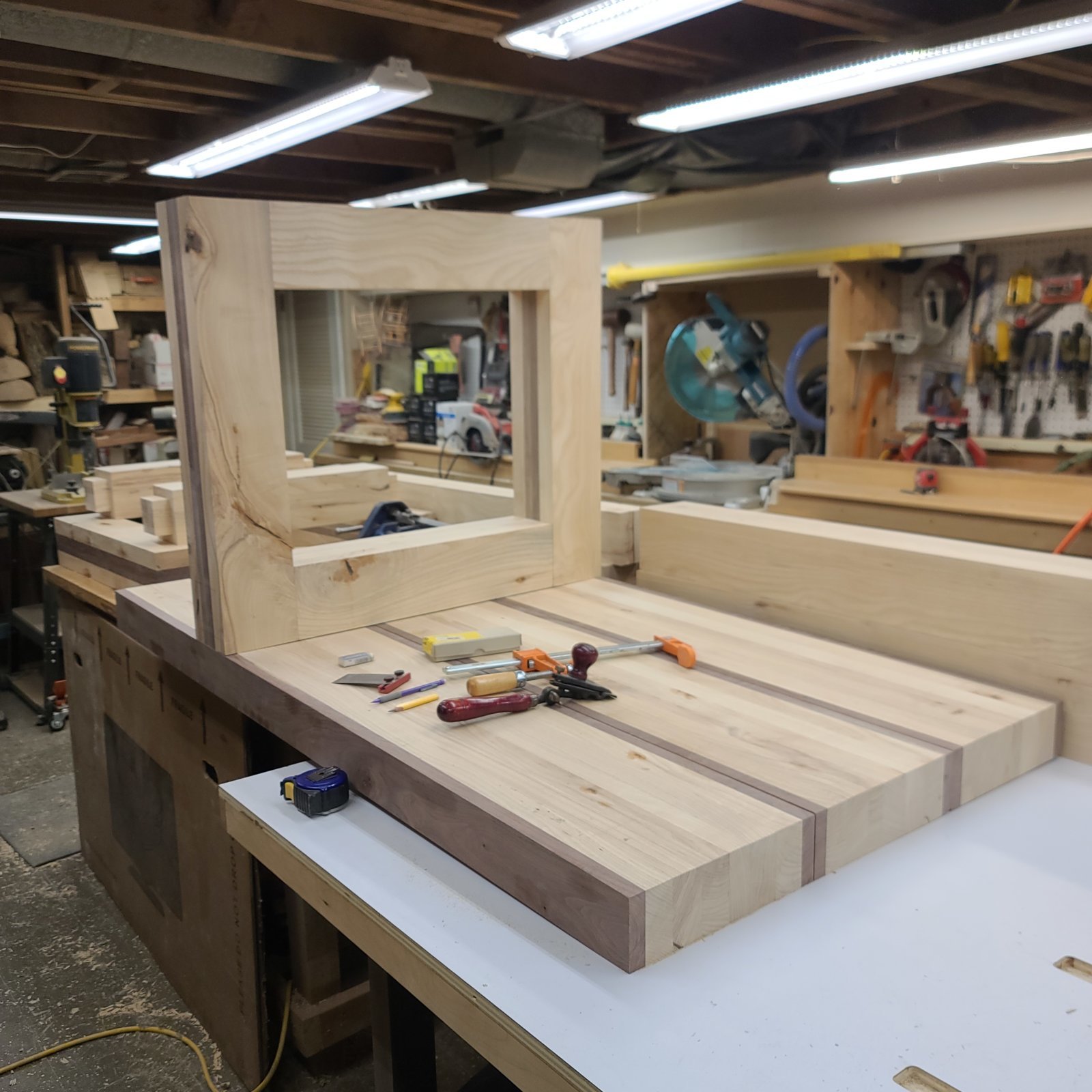

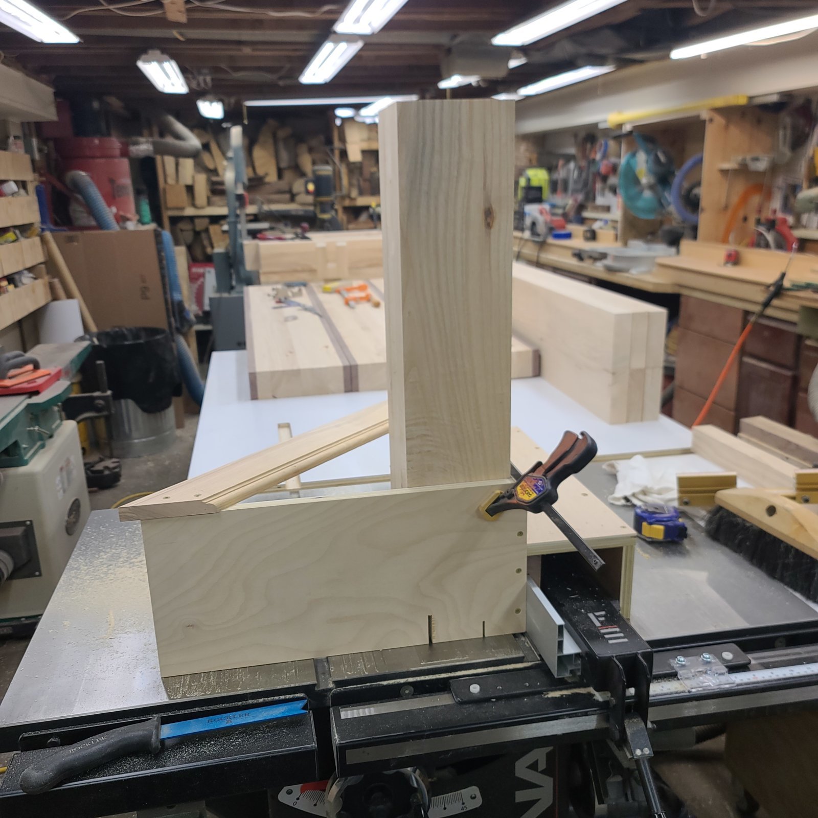

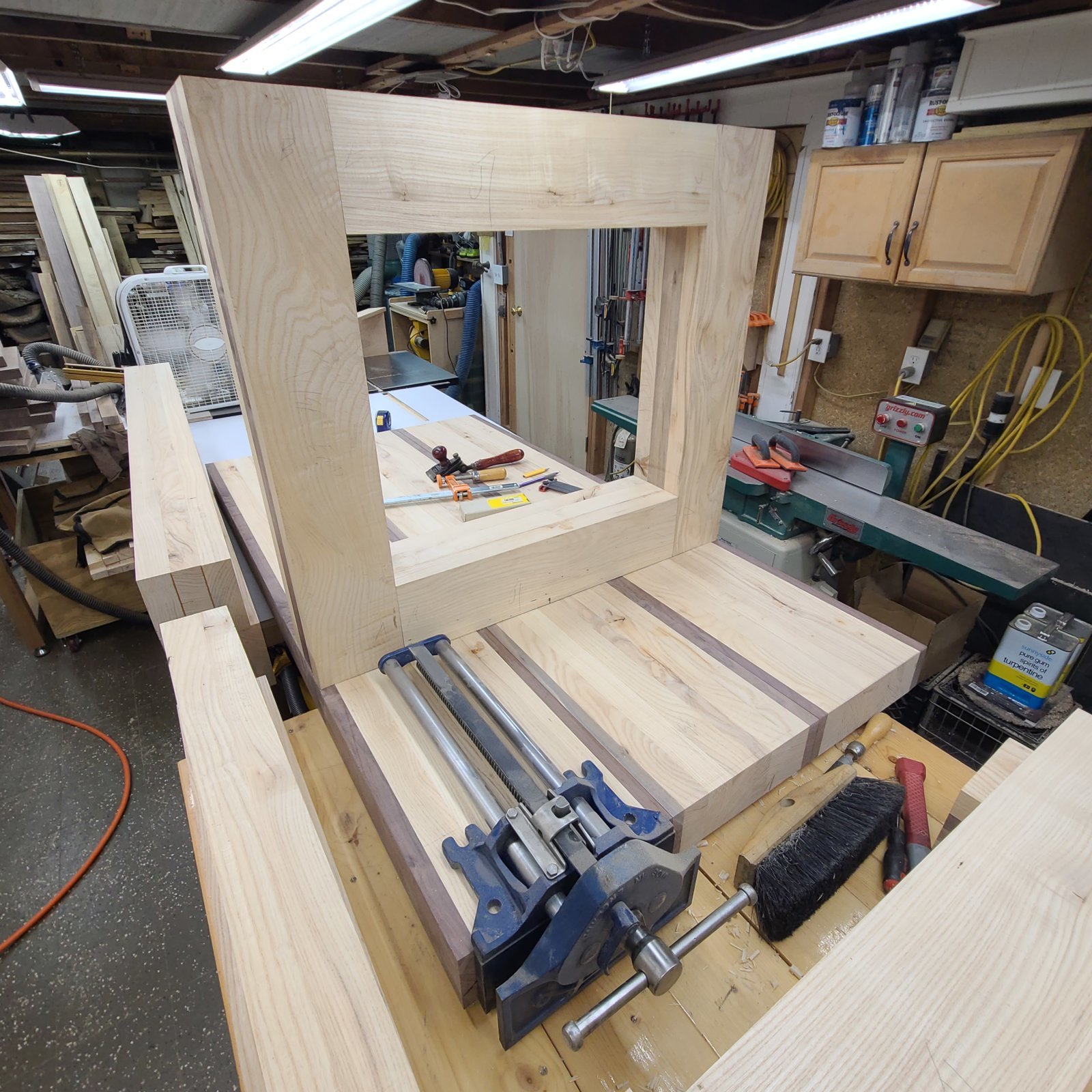

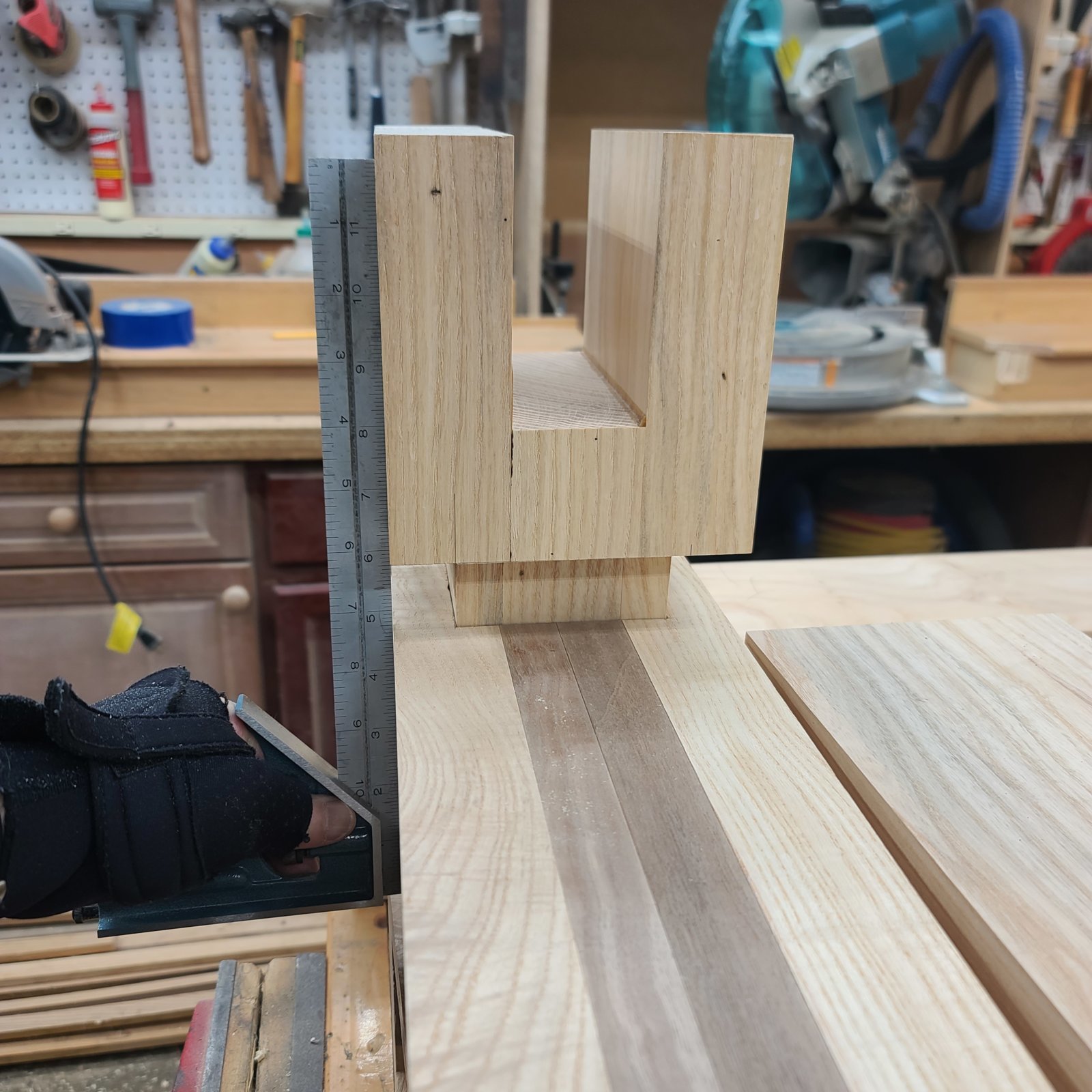

    First leg is all fitted and ready for glue up. Yeah it's going to be heavy and stout!
    Sidew view.
    One more leg to go.
    This leg will set in 19" to allow room for the vintage record vise that I restored.
    The vise will get wood jaws.
    There will be plenty of mass on the other end.
    Making progress. The joinery is time consuming but also very enjoyable to me.

    I have wanted to build this bench for years. It will be exactly what I want in a bench, massivly heavy and solid hardwood. It will fit my style of work. I've seen a lot of nice benches, split tops etc, but they don't suit me and the way I work, this one will. It'll be the last bench I ever build.

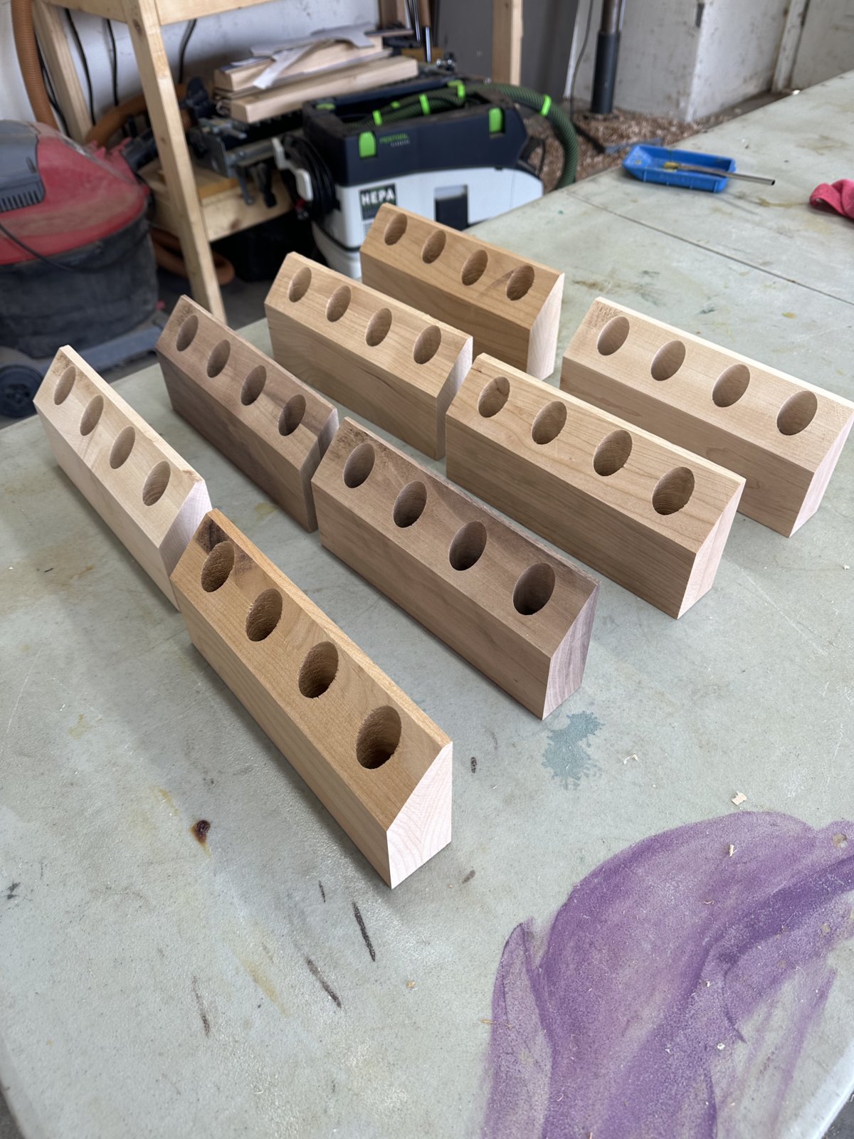

    My wife does a girls weekend every year with eight friends from high school. They are all spending next weekend together in Mission Beach, San Diego. So, I used up a bunch of scraps and batched out 8 succulent propagation stations today. One for each friend. I will sand, oil them, and add the test tubes tomorrow. She is going to fill them with cuttings from her succulent gardens and gift them to each life long friend next weekend.

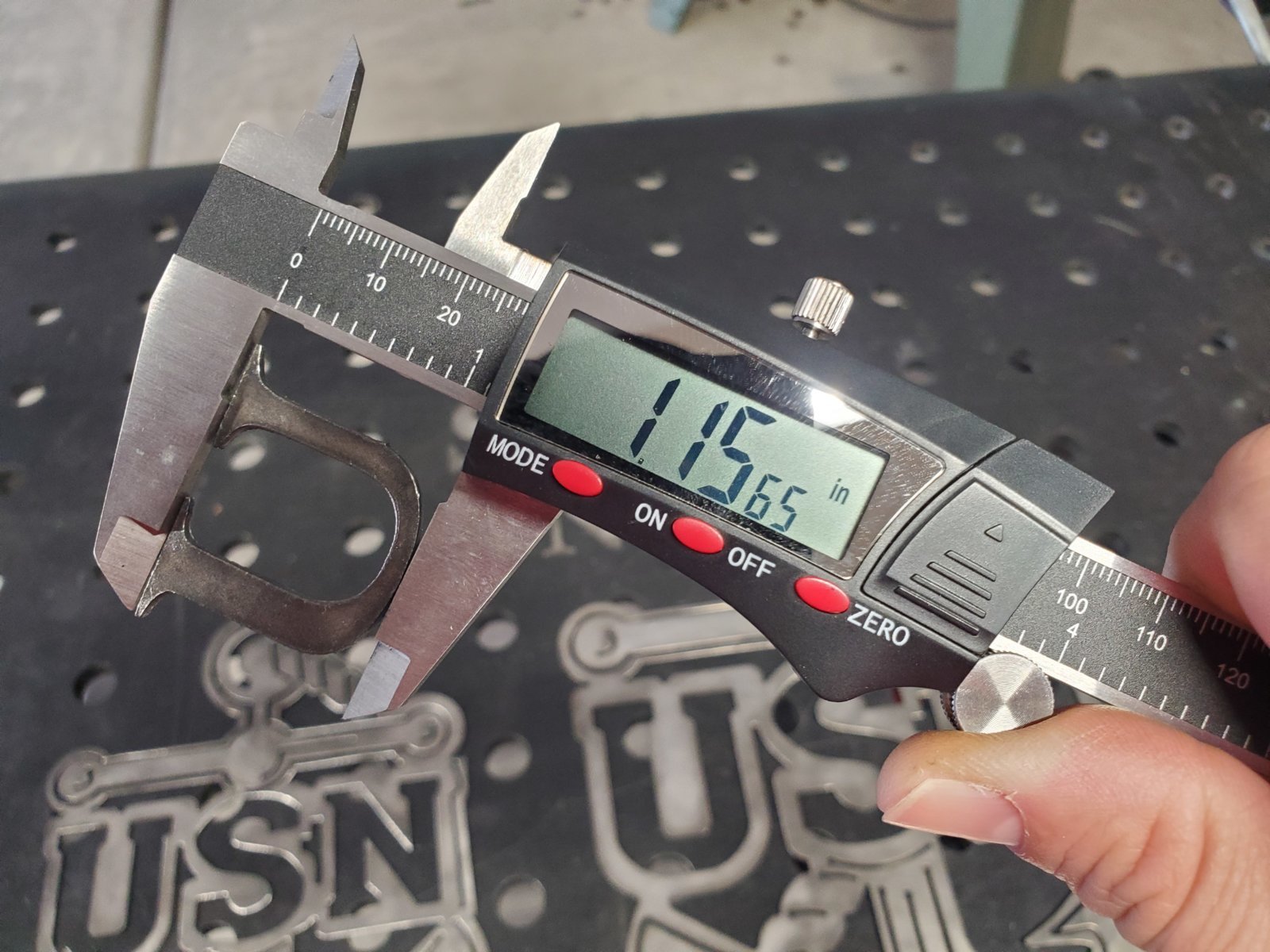

    @wilcam47 posting here cause we were talking about your project in this thread but I hope this will suffice
    I cut lettering in two different sizes so you can choose what works best
    Also scaled down that Navy sign in case you could use that instead or incorporate it in another project you gift or sell
    It's smaller at 8 5/8" total length

    Have you thought about bringing the vice in a little more toward the center then notching out a channel in the "rail" of your legs to accept enough space to slide the bulk of the record vice? My calibrated eye measures that at about 2 to 3 inches toward the middle of the bench. Even though you mentioned that there will be plenty of mass on the other end, I'm still concerned with the length of the bench and if you were to really lean in on something with a hand plane or something similar. With the bulk of your legs, it doesn't seem that you would loose any of your structural stability by notching out a space for the rails of your vice. I hope that makes sense.
    -J

    Well I like having my vise on the corner of the bench it suits my method of work. My old bench is just construction grade 2x material and it's set up the same way, I can sit on the end of the bench and it doesn't lift. This bench is way way heavier than the old bench. I bet I could park my motorcycle on it and it won't lift, lol. But thanks for the thoughts and input. It's all good.
