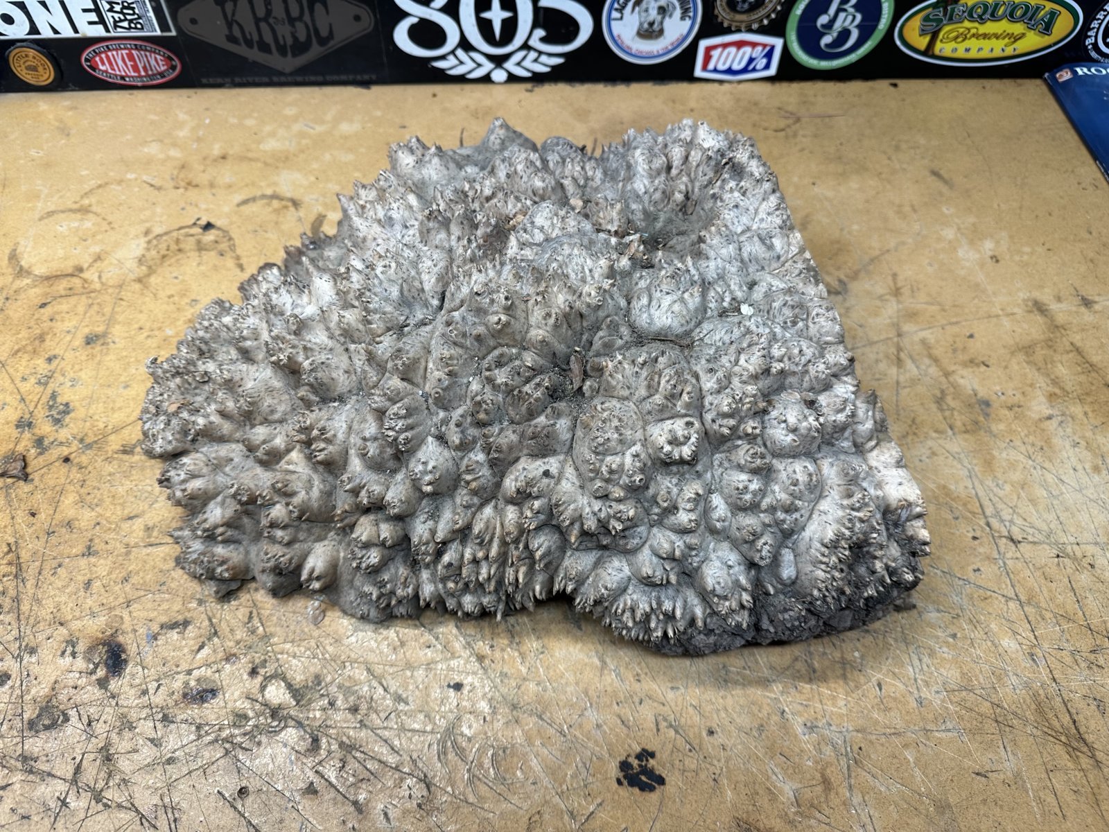

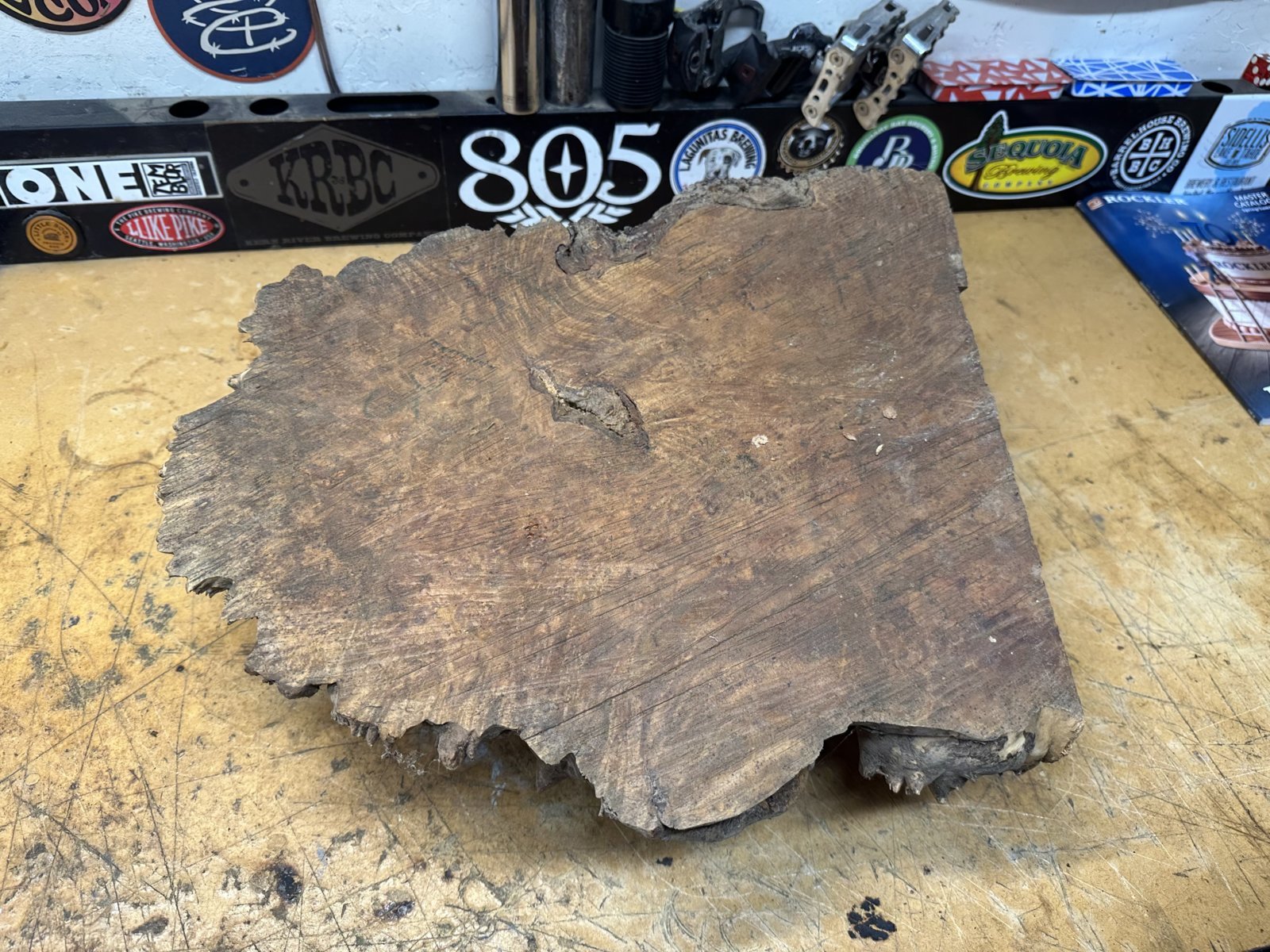

    Piece of burl wood. Possibly cherry, you'd have to sand it see what color it is.
    Some use them for pistol grips

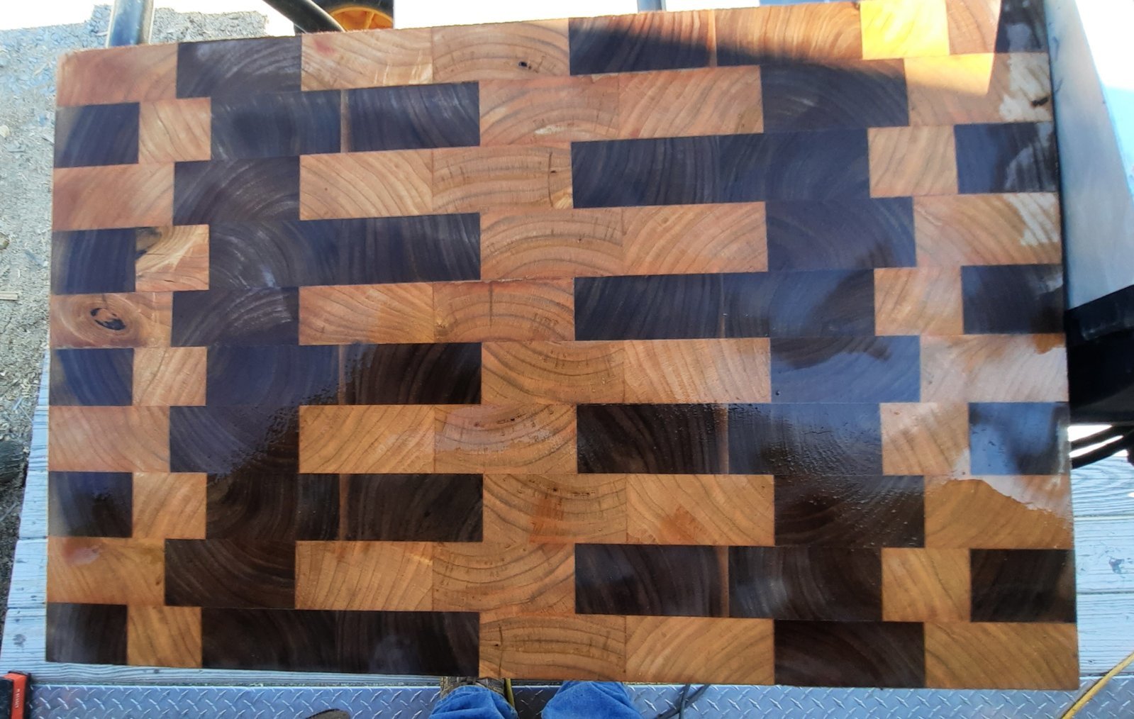

    I have couple cutting boards inw. Waiting for epoxy to dry on one before i post pics.

    Endgrain with a cool pattern.
    Very nice!

    It's a burl, possibly Amboynia, valuable. Has many uses, pistol grips, knife scales, and it makes beautiful bowls turned on the lathe.

    Very nice. But epoxy? Not a good choice to run knives across. For a user a oil and wax finish would be better.

    It will make sense when you see it

    I haven’t tried end grain yet. That might be my next project

    Just don't run end grain stuff through a planer without a frame

    I like them. Looks better with thicker boards though.

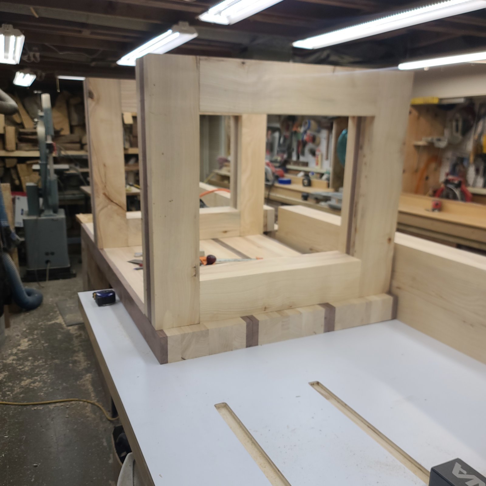

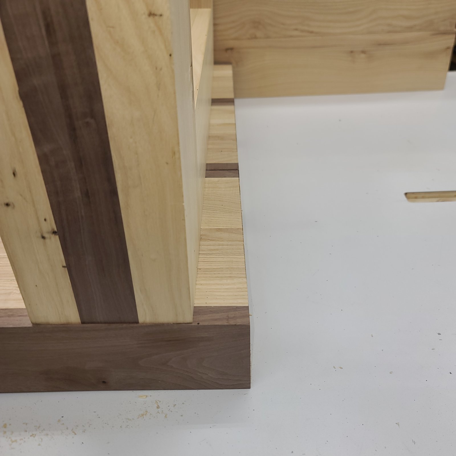

    Only 9 hours at work today so I came home and went down to the shop. I finished fitting the tennons to the second leg.
    Just a dry fit to see how everything lines up.
    Now I'm starting to see what I envisioned in my head. Massive and heavy!
    There will be a 2" overhang all the way around for clamping things as needed.
    Next I'll do the glue up on the legs.
    Then it's on to cross stretchers.

    Greg if you get it much heavier you won't be able to move it, looks great.

    Lol, I don't want to move it. It will be built so I can take it apart if I ever have to move it. I've got massive cross stretchers to go on it yet, and they will be through mortised and wedged so they can come apart if needed. More joinery.
