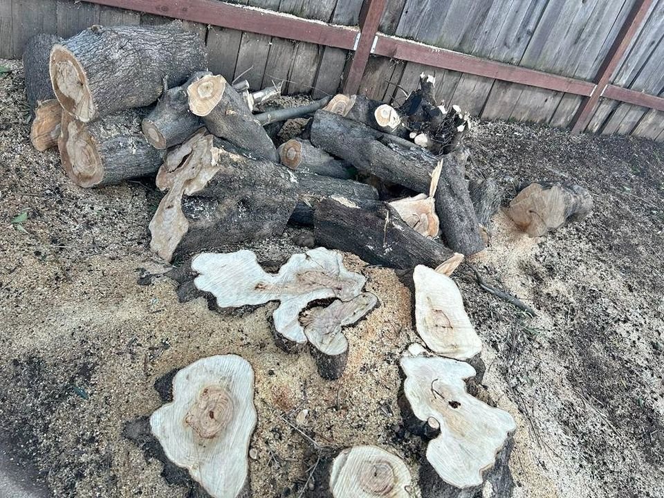

    Some stuff. Not a lot, just some.

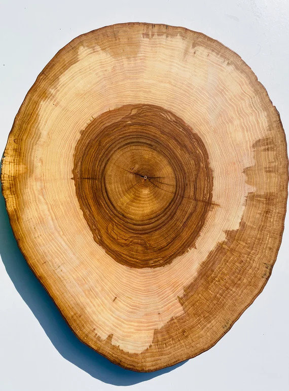

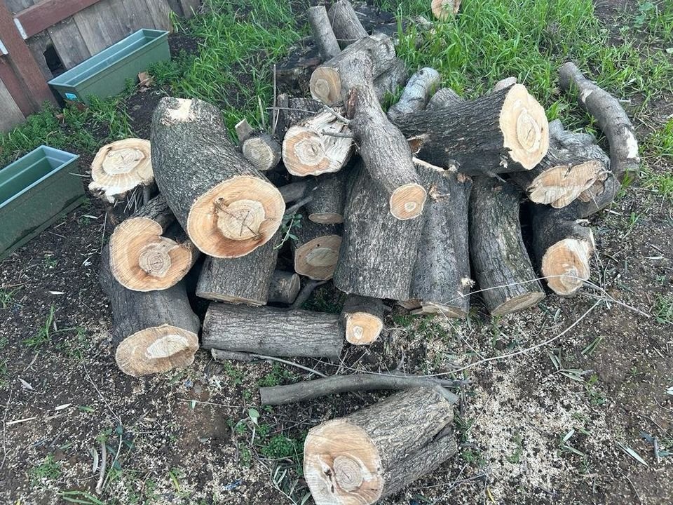

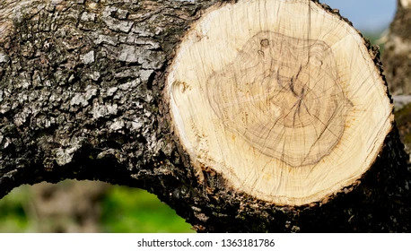

    Judging by the leaves on the ground, I'd say it's olive wood as well.
    You could try splitting it into slabs with a froe. Then process it into your boards latter

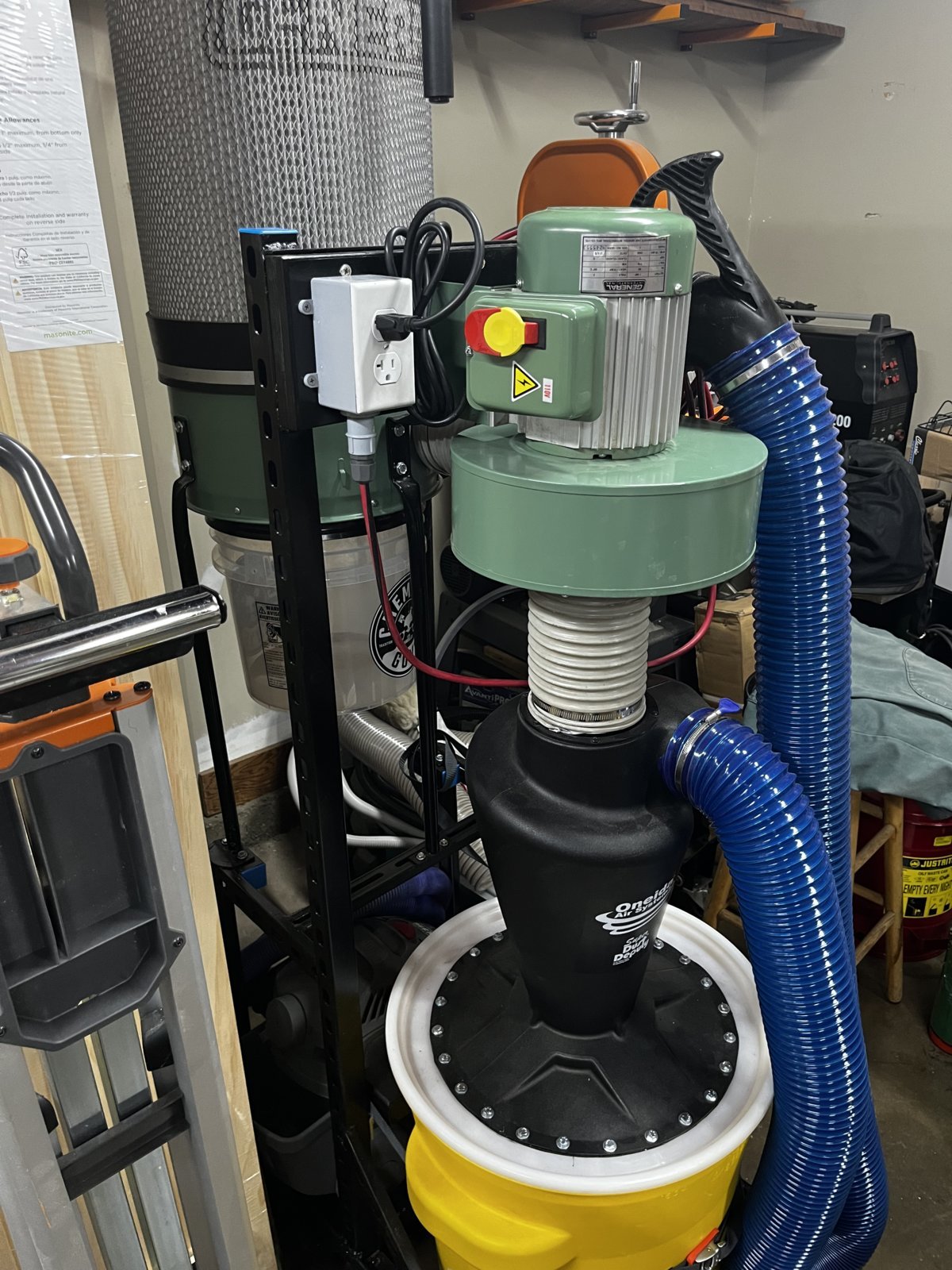

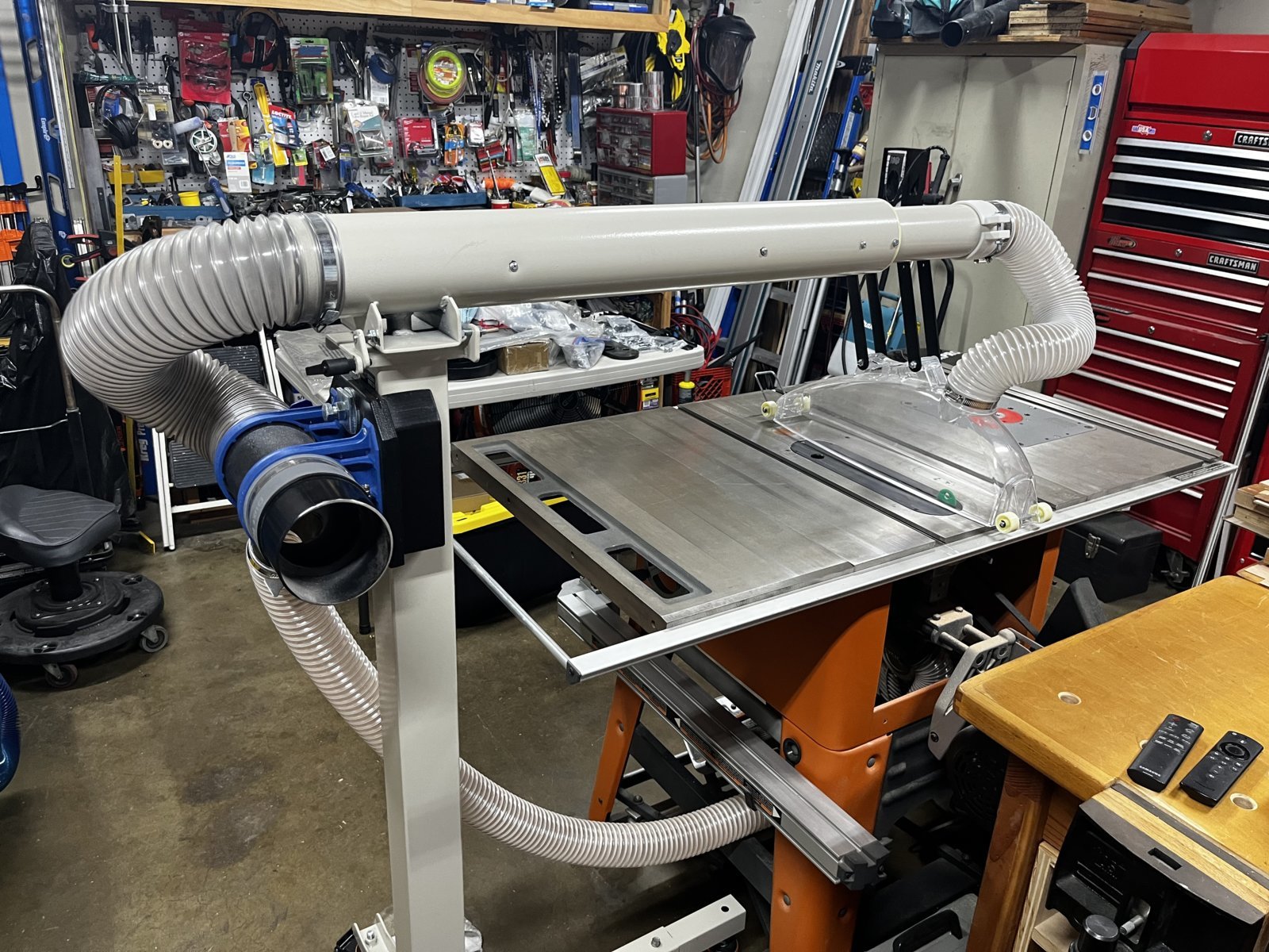

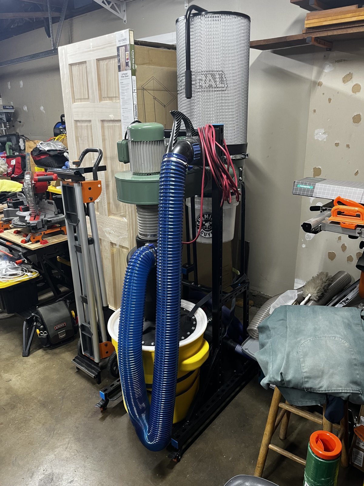

    I never seen me older bro dedicated as he was on this Frankenstein plan. Works very well. Made from remnants.

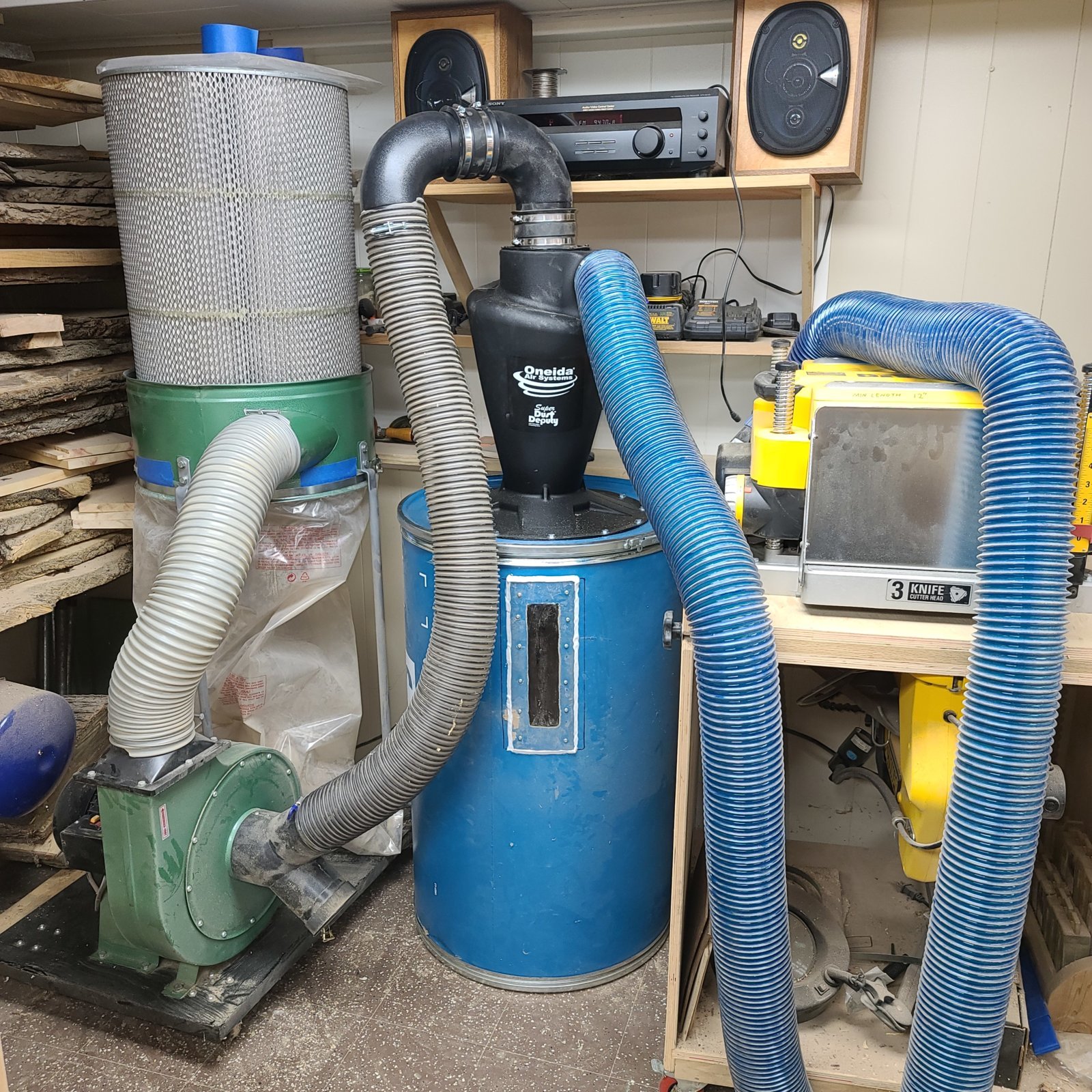

    That's kind of like my setup. I will upgrade this one day to an Oneida set up. But for now this works very well. Hardly anything makes it to the bag now and the drum makes it much easier to empty.

    While looking on FB Marketplace I found a guy who has a mill, advertising he will cut slabs for people. This may be too small a job, but if I get the wood I'll reach out and talk to him. If it works out, would you cut them into 2 inch slabs, 1 inch or a variety of thicknesses? I have a band saw that can resaw up to 6", but any slab wider would be a challenge to reduce the thickness.

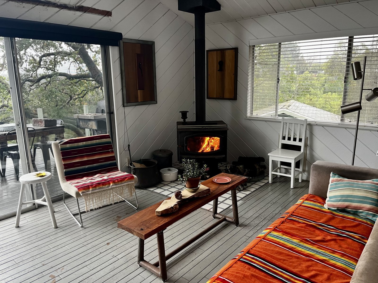

    Crazy amount of time, but fun. Use a plunge router fixed to a jig. That’s what I did to finish off my bench made of Eucalyptus.

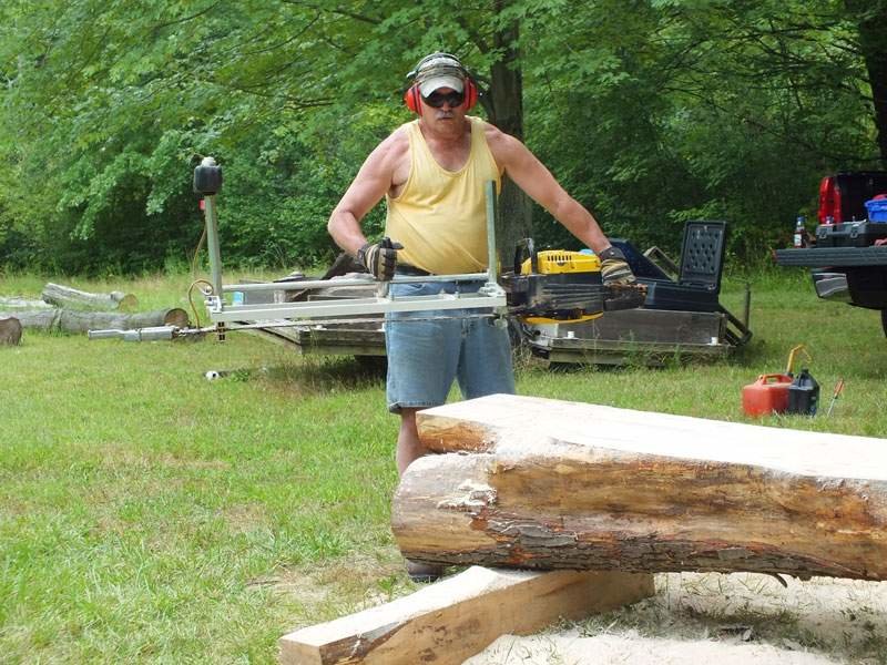

    I don't have a mill. Wish I did (and room for it). I have a small electric chainsaw but that won't work very well.

    Personally I would go 2" just to have the option for bigger stock. You can resaw with a thin kerf blade on a table saw. Just be careful of course. If the blade doesn't reach the middle, you can separate the last cut with a hand saw.

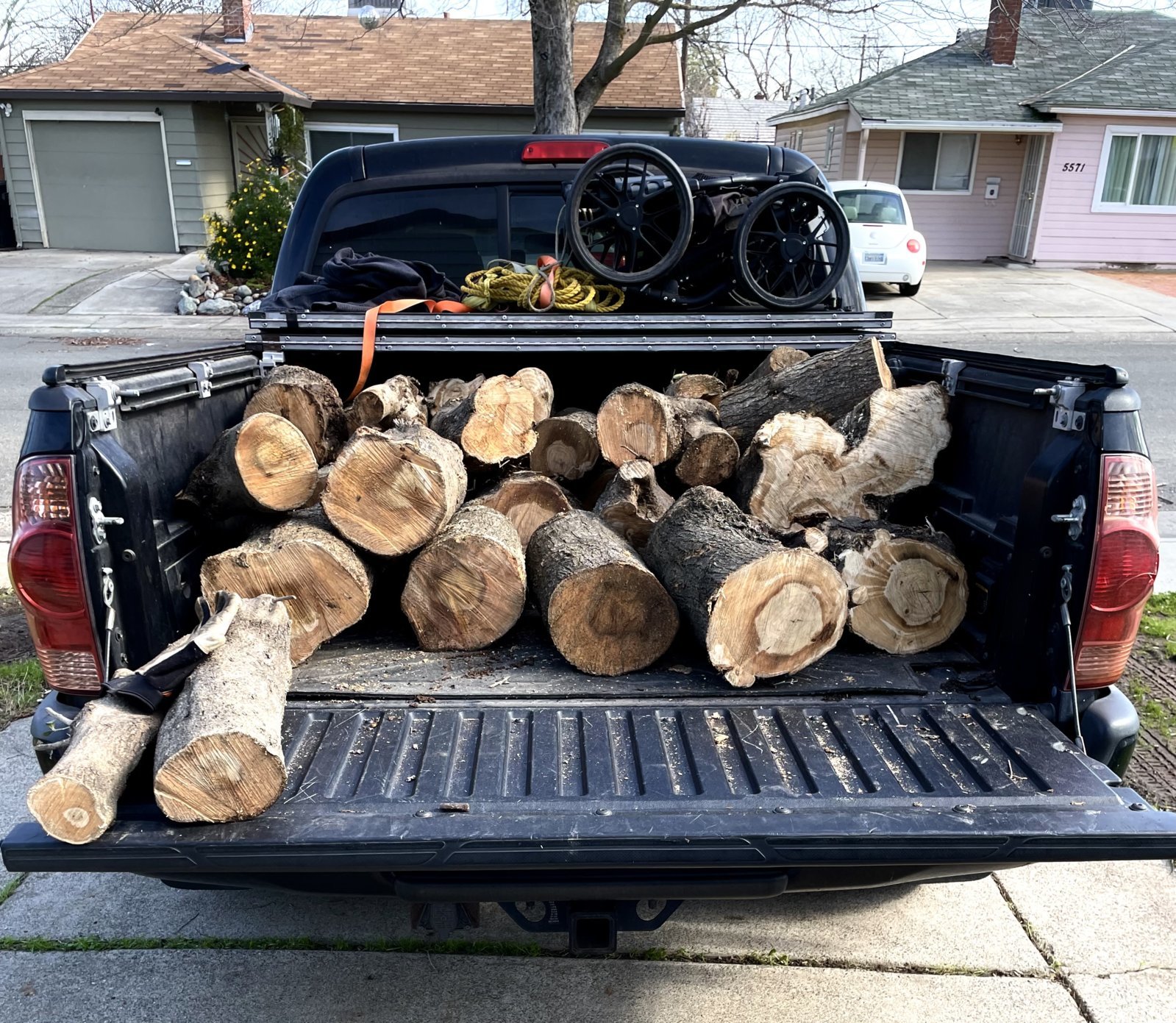

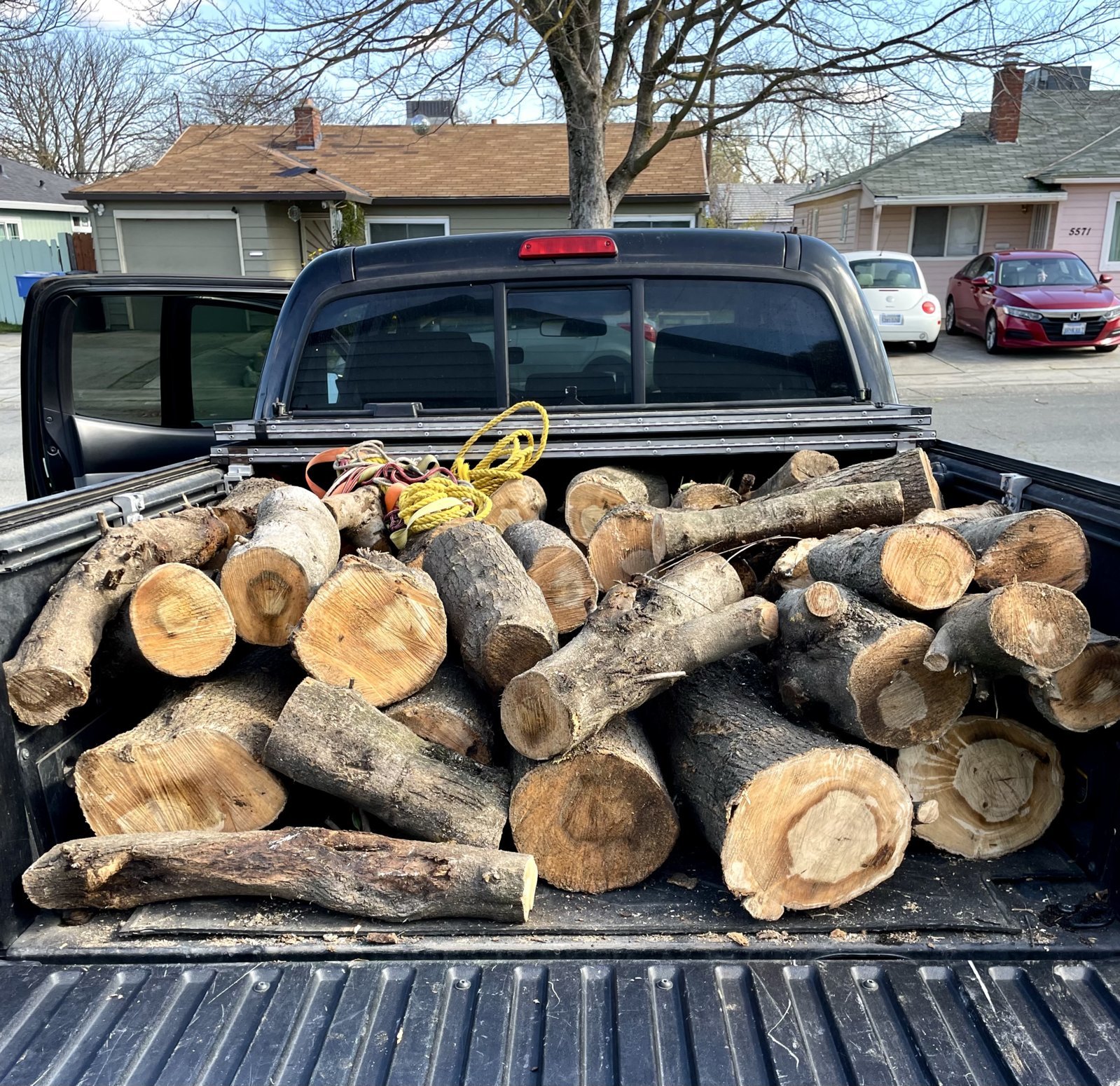

    Well, I got it. A lot of it. Way more than was in the pics. In fact, I left some as my truck was full. It's going to be stored in the truck bed until I can figure out what to do with it.

    If you can paint the ends helps reduce checking
