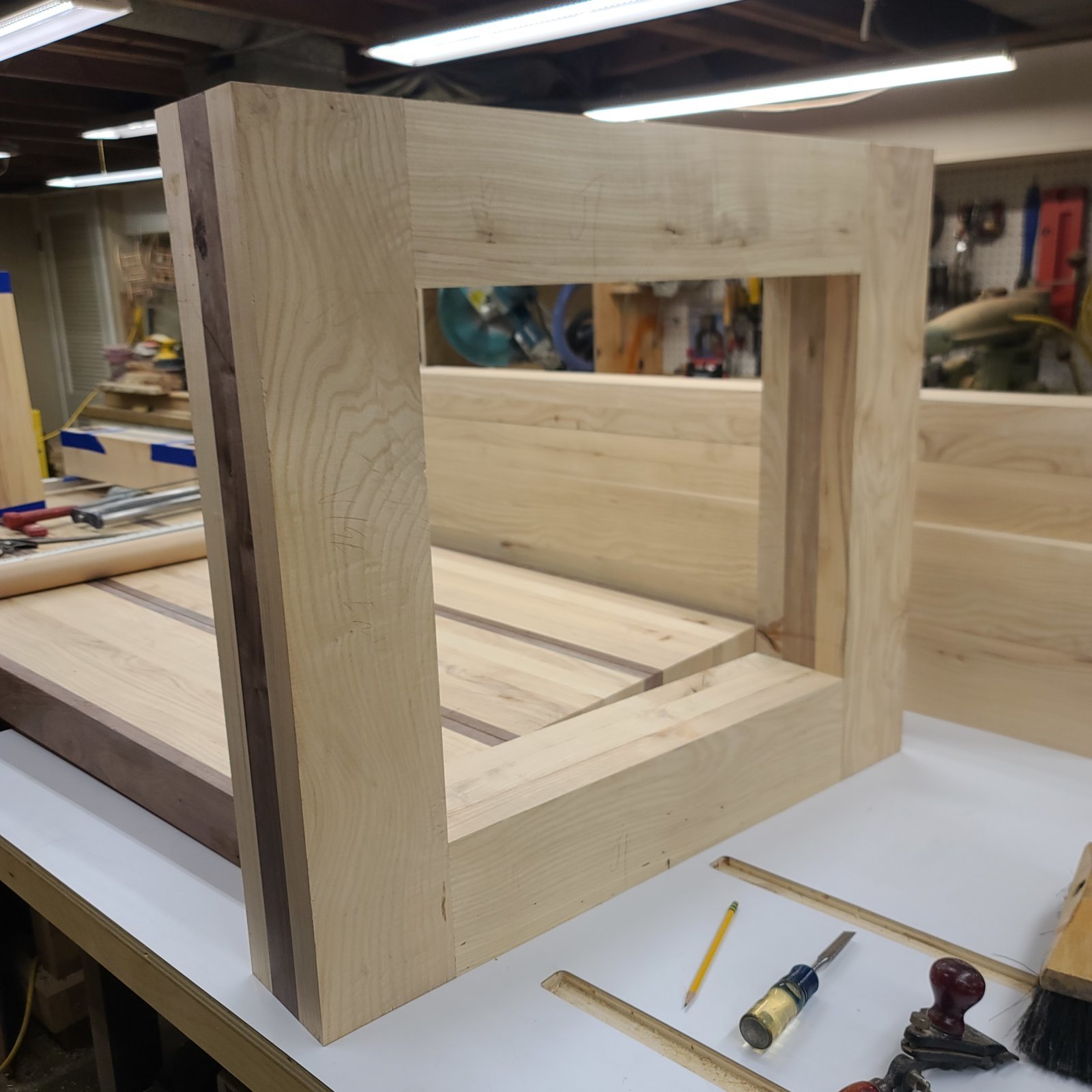

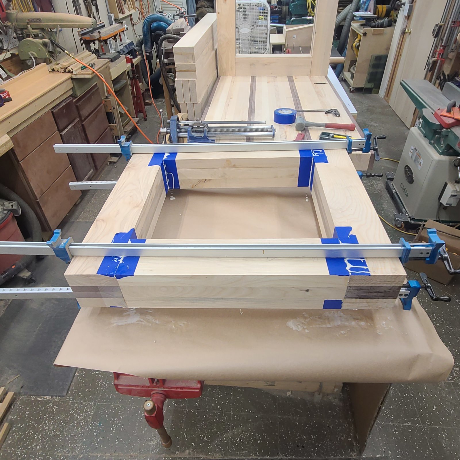

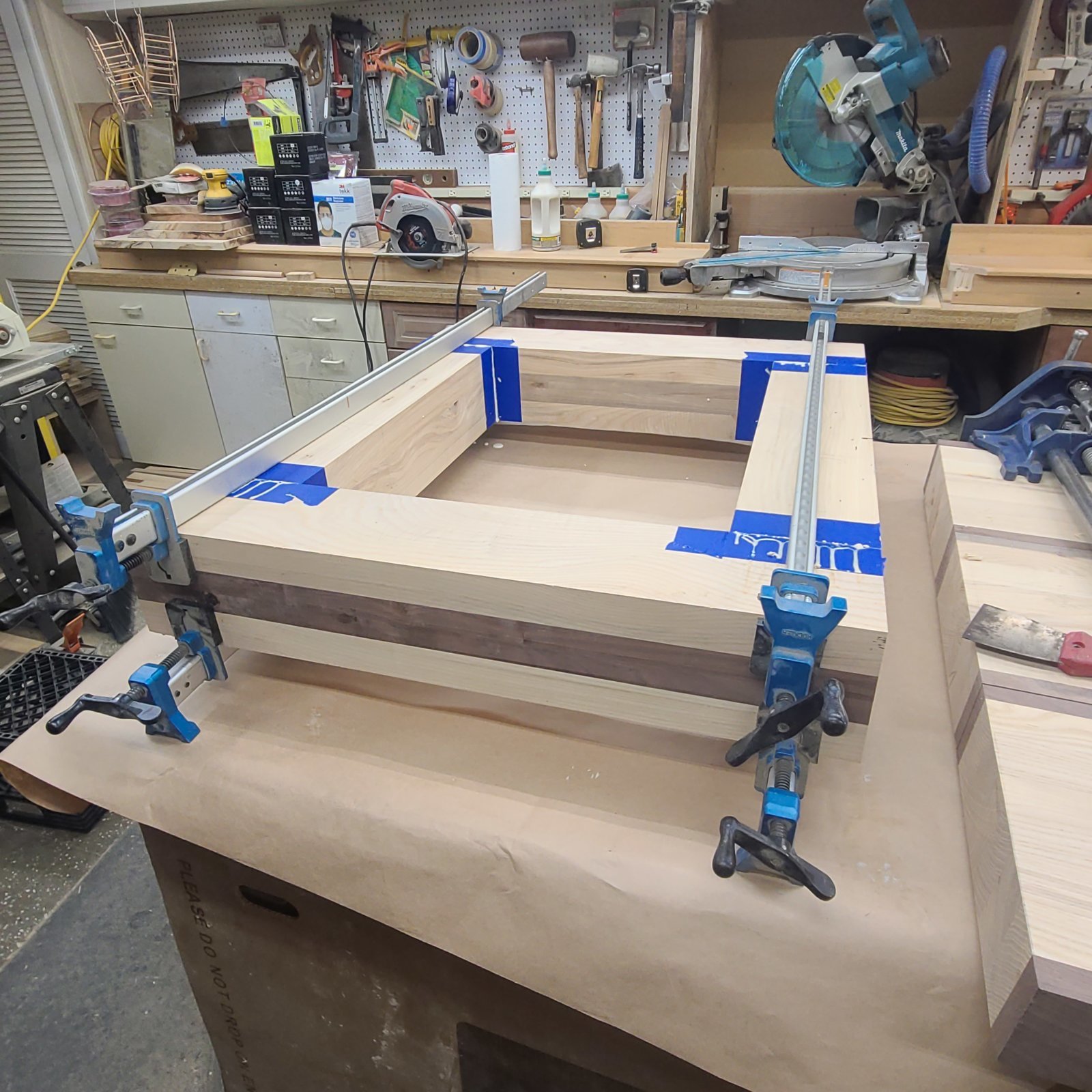

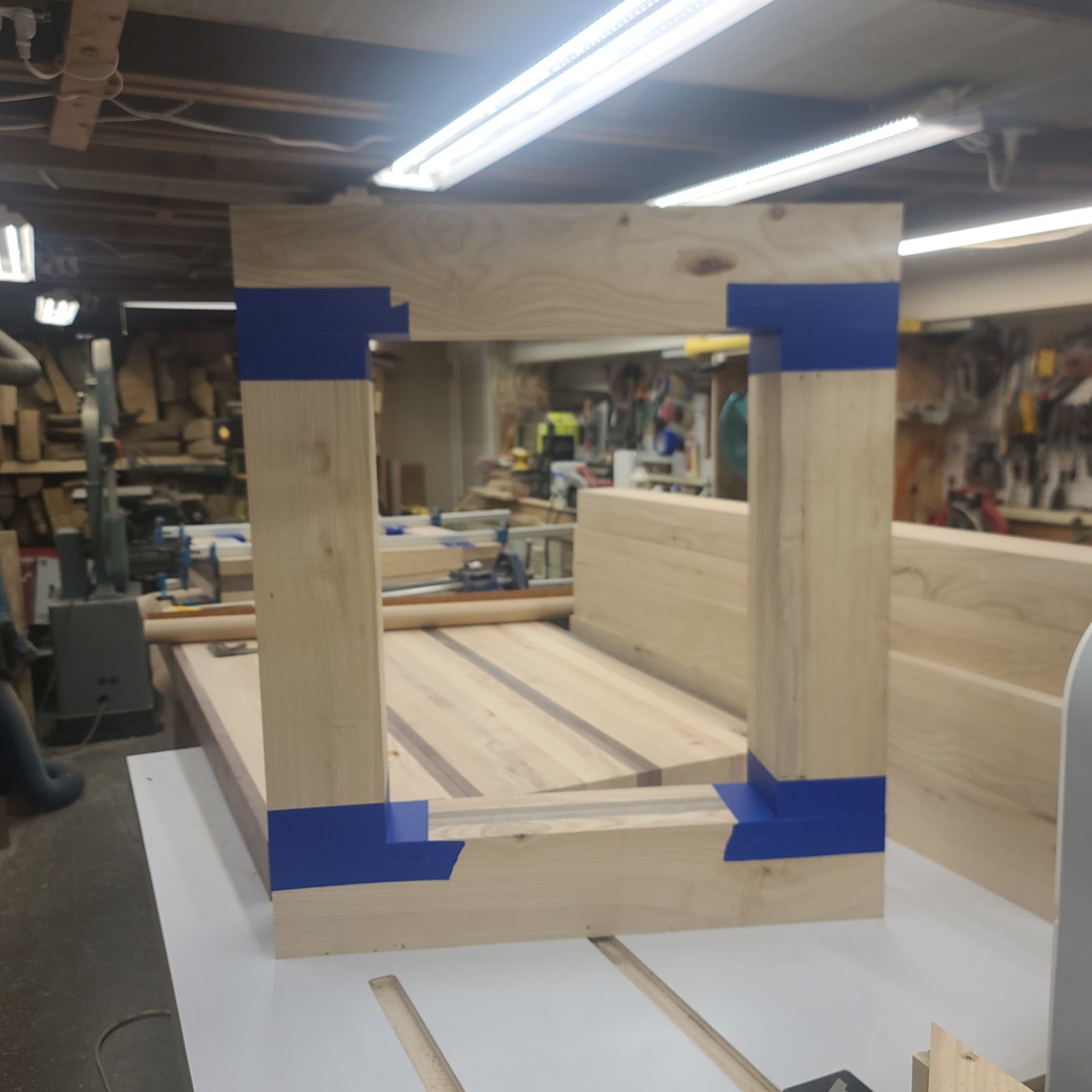

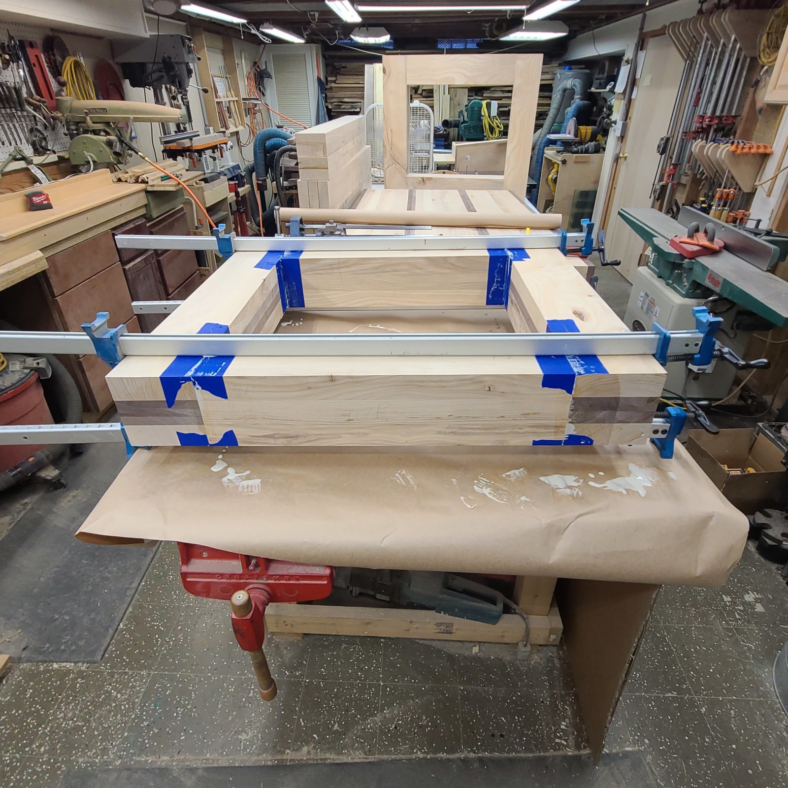

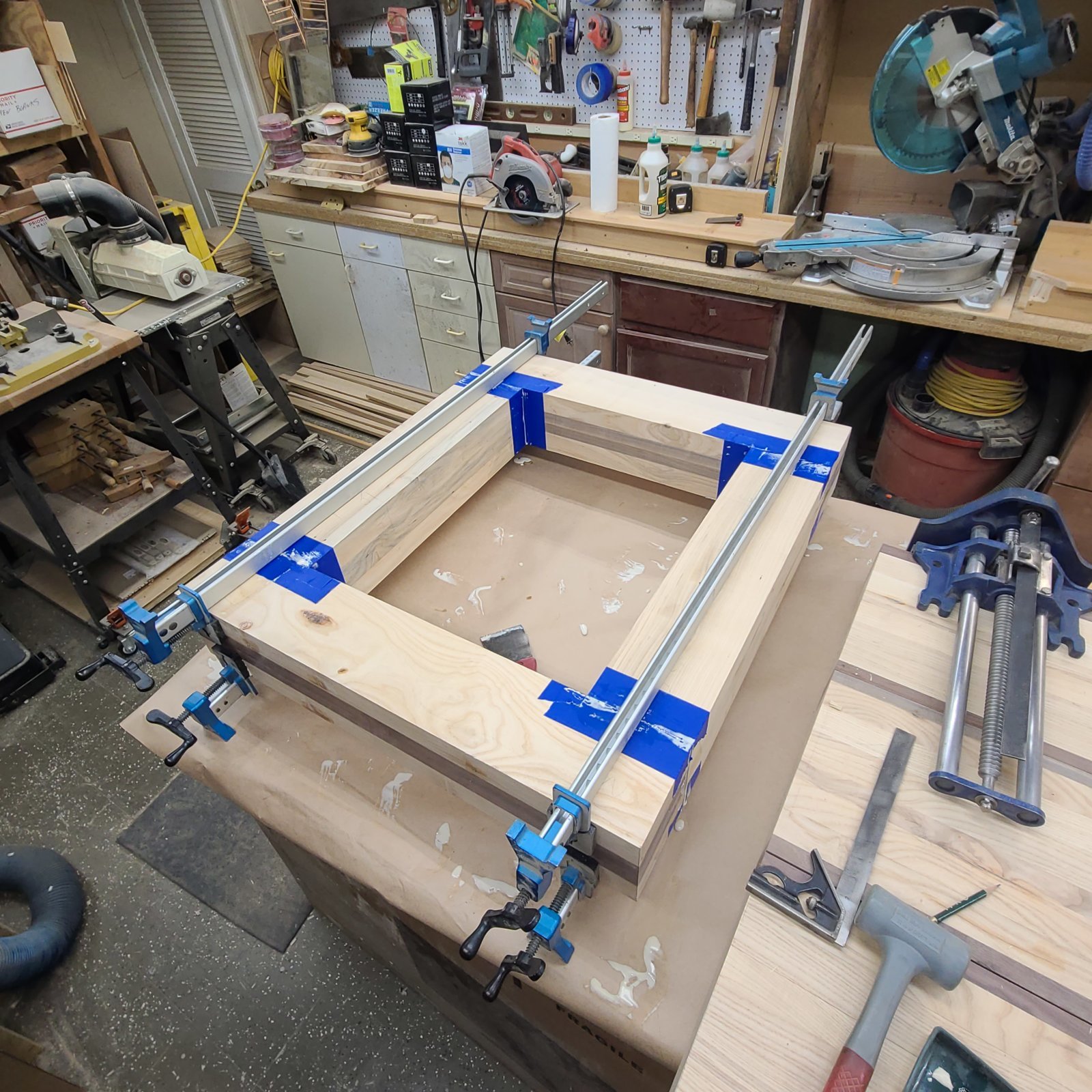

    First leg assembly is glued up and in the clamps. One at a time because I only have 6 clamps this size. The blue tape really helps with the glue squeeze out and prevents it from getting rubbed into the grain of the wood. Particularly helpful with open grained woods.
    Second one is all taped up and ready for the glue up.

  7. Feb 11, 2024 at 1:34 PM
    DoubleB
    DoubleB Well-Known Member
    May 9, 2010
    #36812
    1,173
    Bakersfield CA
    22 TRD Pro / 06 PreRunner
    I wish that I had done this blue tape trick with my Redwood patio furniture. I can still see places where I wiped glue off.
    Well Done!

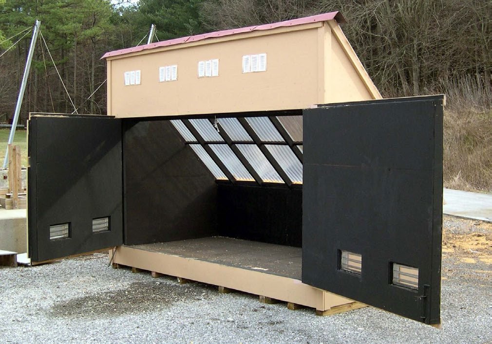

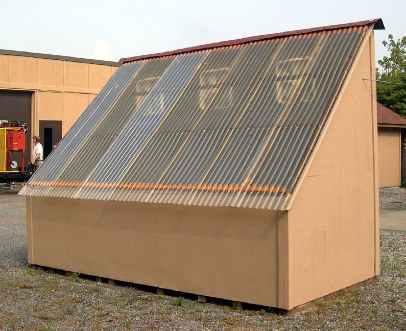

    As I was contemplating how I'm going to mill and dry the olive tree logs, I got the idea of building a small kiln. I was thinking a small, insulated box with some kind of heater controlled by a thermostat. Figuring a lot of people have done this, I checked Google. What popped up was solar kilns. Interesting. Air dry is generally 1 year for each inch, commercial kilns are 5 to 14 days and solar kilns are 30-40 days for 1 inch. From my recent greenhouse build I have lumber and polycarbonate panels on hand. I think I'm going to make a scaled down version of one of these. Much smaller than this one:
    https://www.pubs.ext.vt.edu/420/420-030/420-030.html

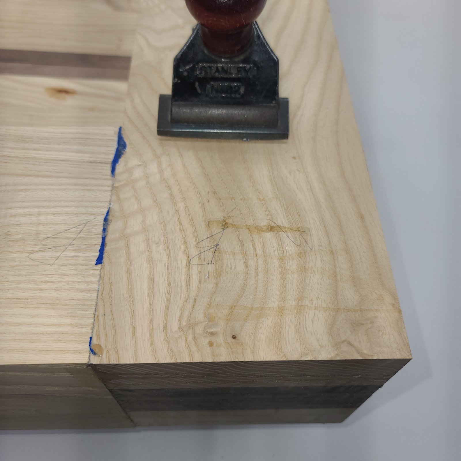

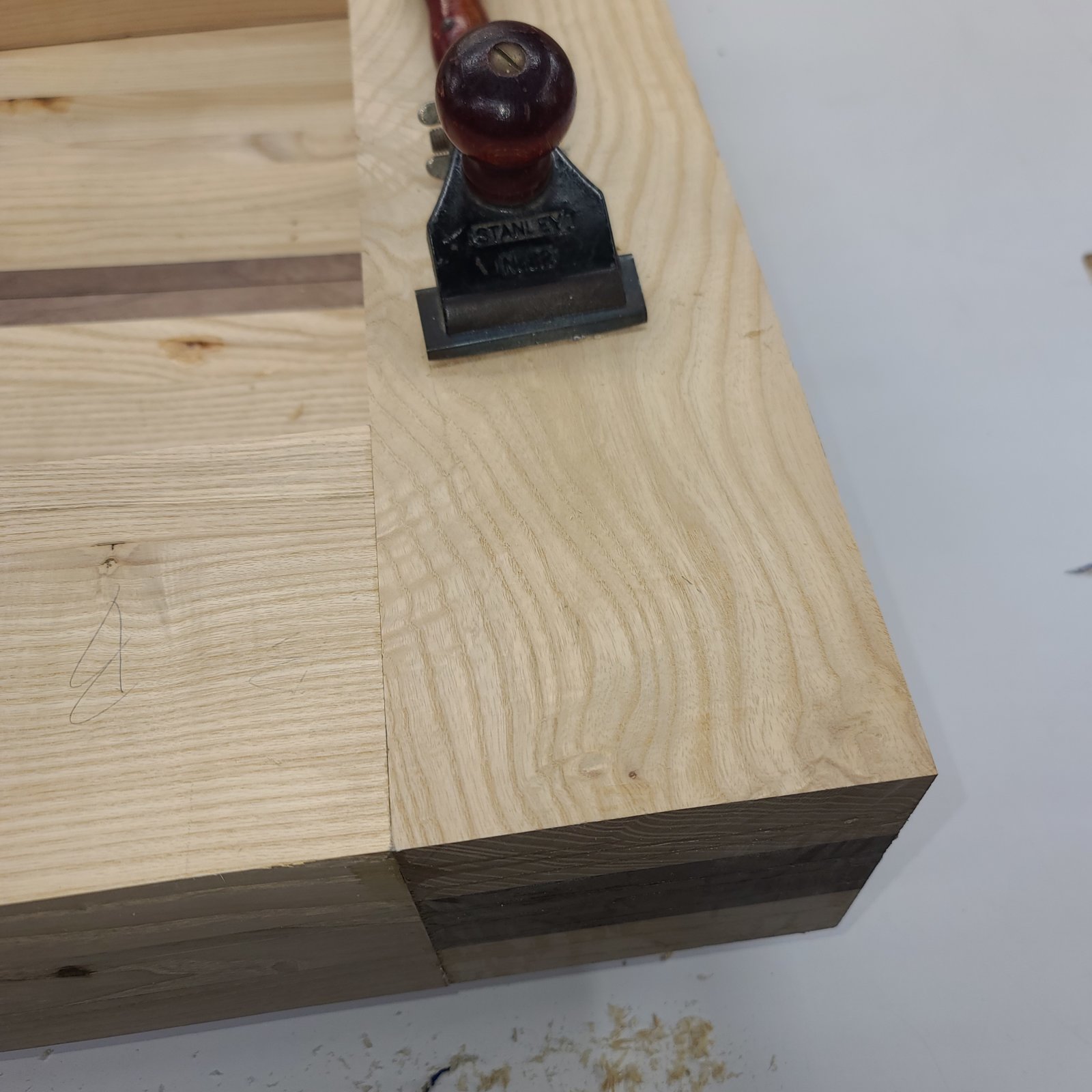

    Short 8 hour day at work means get your butt in the shop! So I took the first leg out of the clamps and pulled the tape off. Of course some got glued on and needed to be cleaned up.
    Stanley 82 scraper made quick work of it.
    Cleaned up nice. A little chisel work on the inside corners to remove tape also.
    First leg is cleaned up. It will get 4 through mortices cut into it eventually.
    Last leg is in the clamps.
    This is the last glue up.
    Once this one cures and is cleaned up I'll start working on the cross stretchers. Still a lot of work to do but it's getting there.
