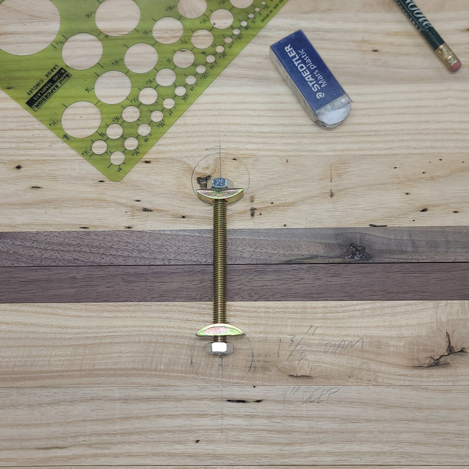

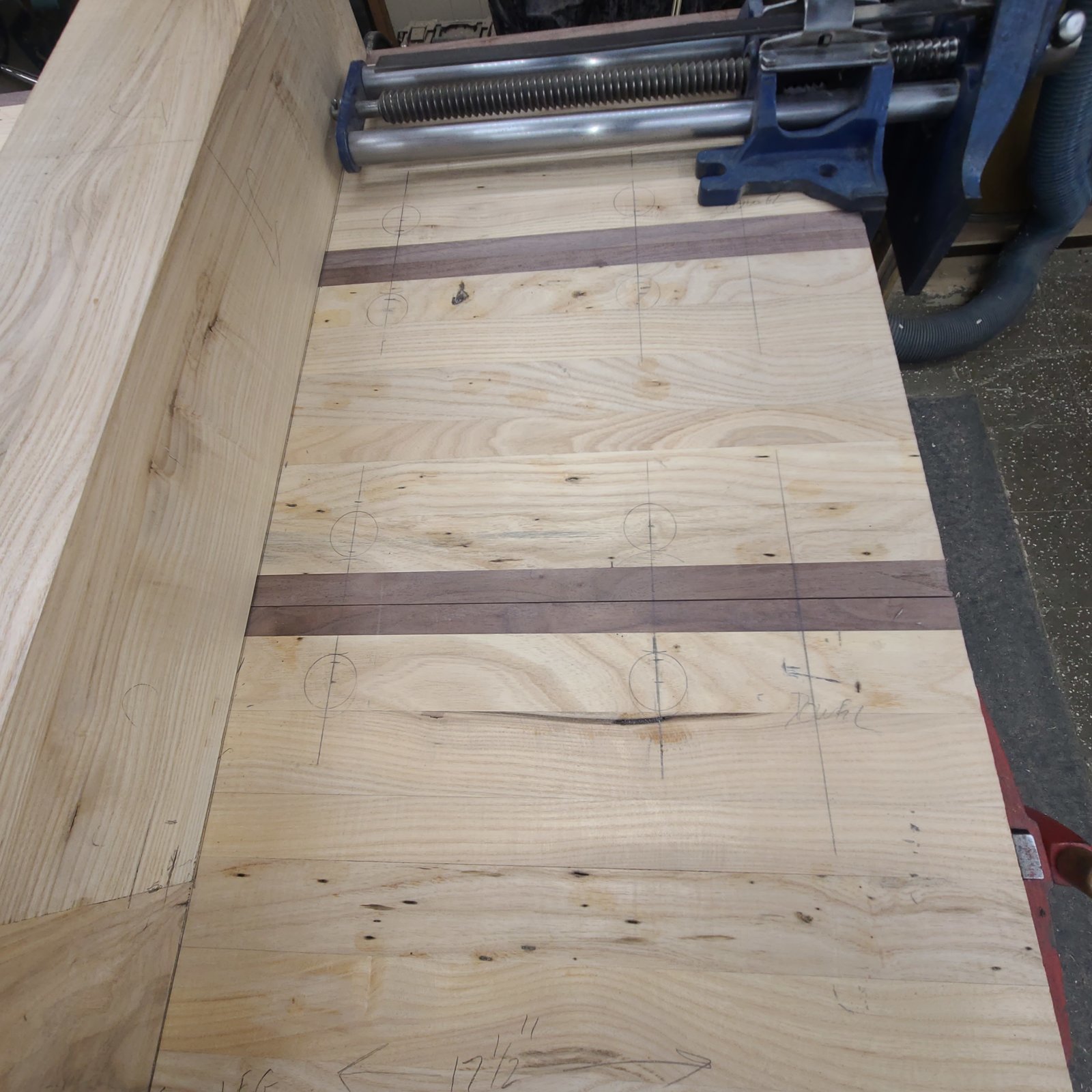

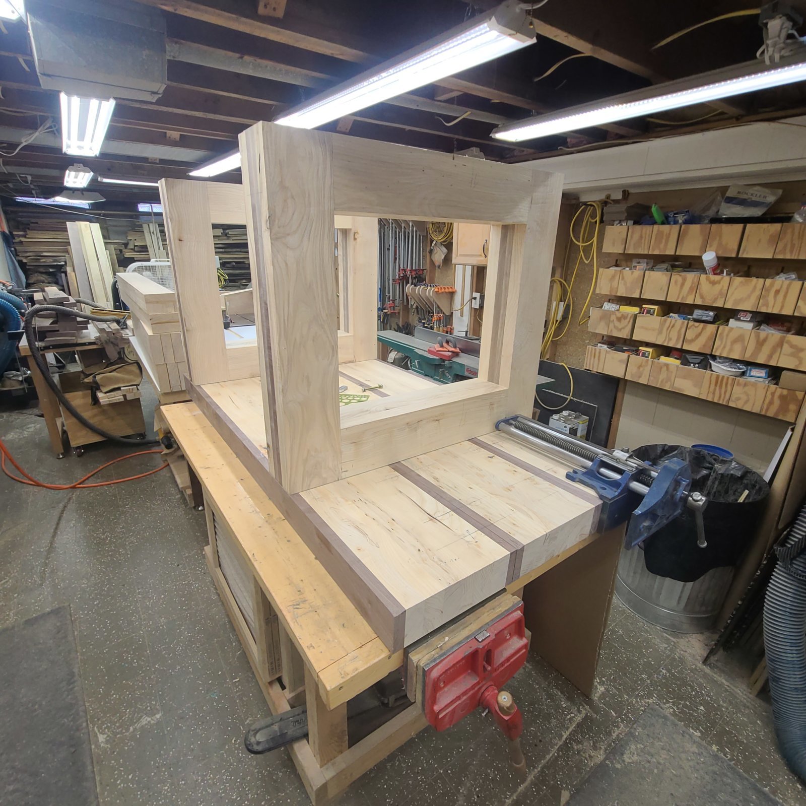

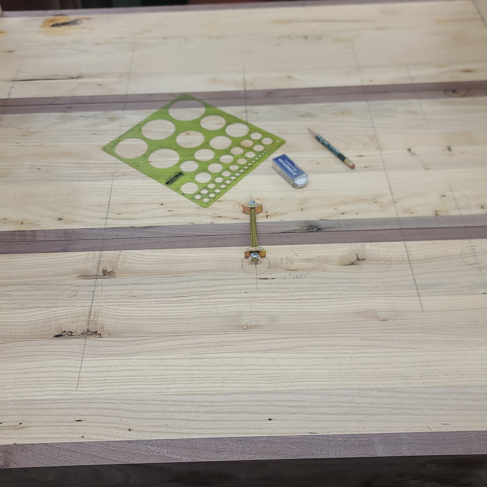

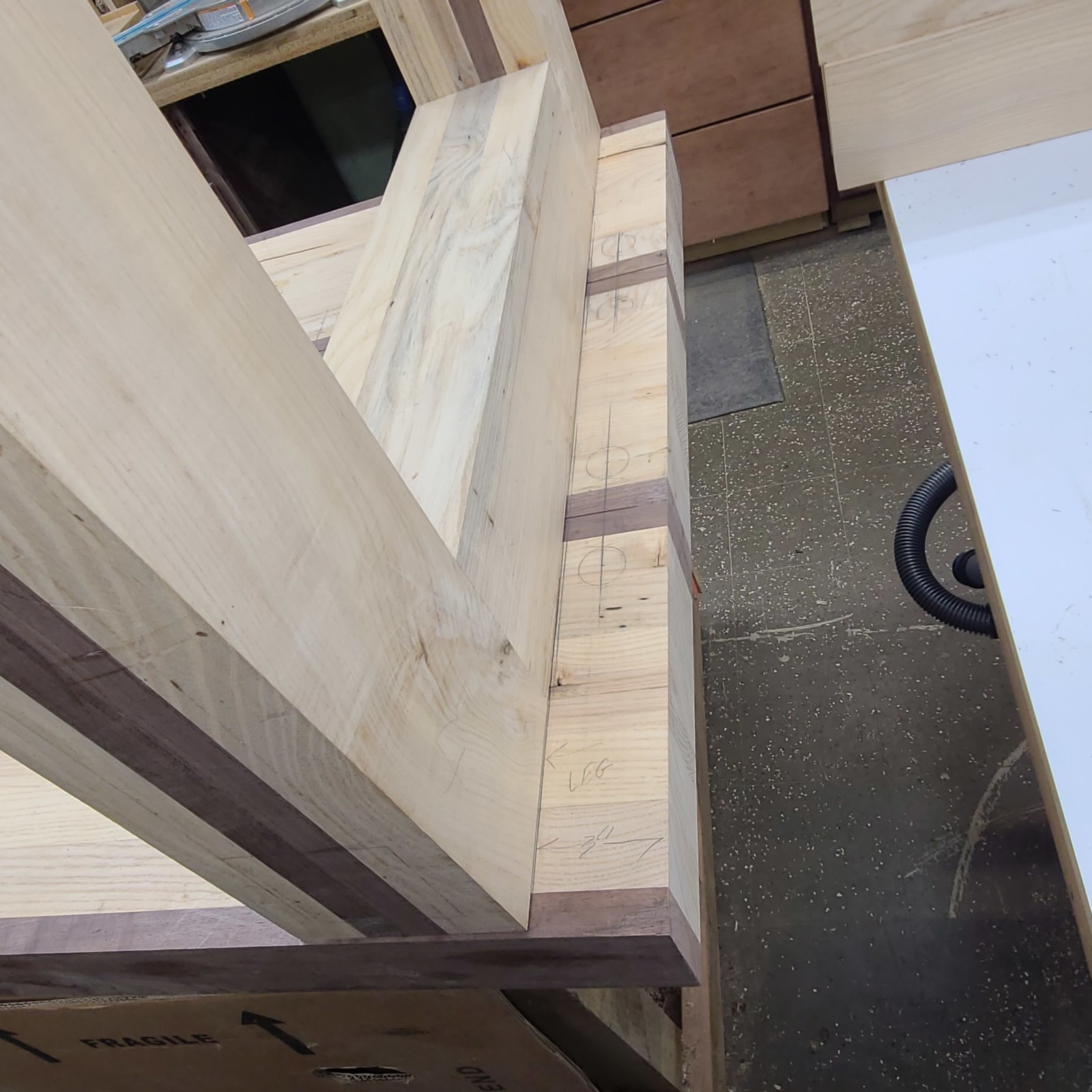

    Well I had to wait till the weekend for this round of work on the bench. So the first order of work was to take apart the bench top, flip it over and move it to the top of the old bench and set the legs in place to do some layout for the bench top counter bolts I'll be using.20240217_151247.jpg
    Made sure the bolts will be clear of the vise, dowels, and legs
    These are the counter top bolts I'll be using, a little heavier than most I've seen. 5/16 stud.
    The eraser was my most used tool for this step. Made lots of changes and mistakes.
    I moved the leg in a little bit so the bolts wouldn't be close to the edge
    These bolts will help to keep the top closed up but I can still take it apart if need be.
    For fun I weighed one of the leggs and one of the top sections, Totaled it all up and it's at 370 lbs so far not including the stretchers. I don't think this thing is going to move and it'll be quite stable.

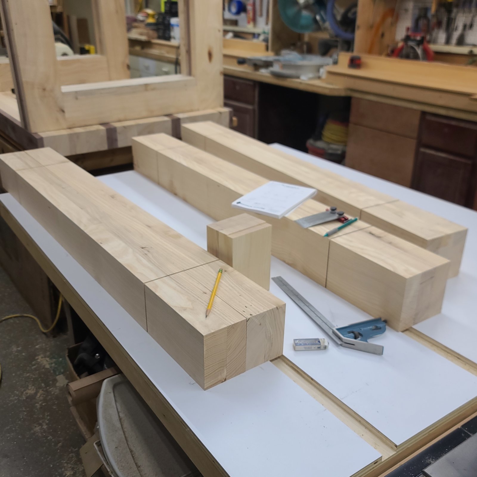

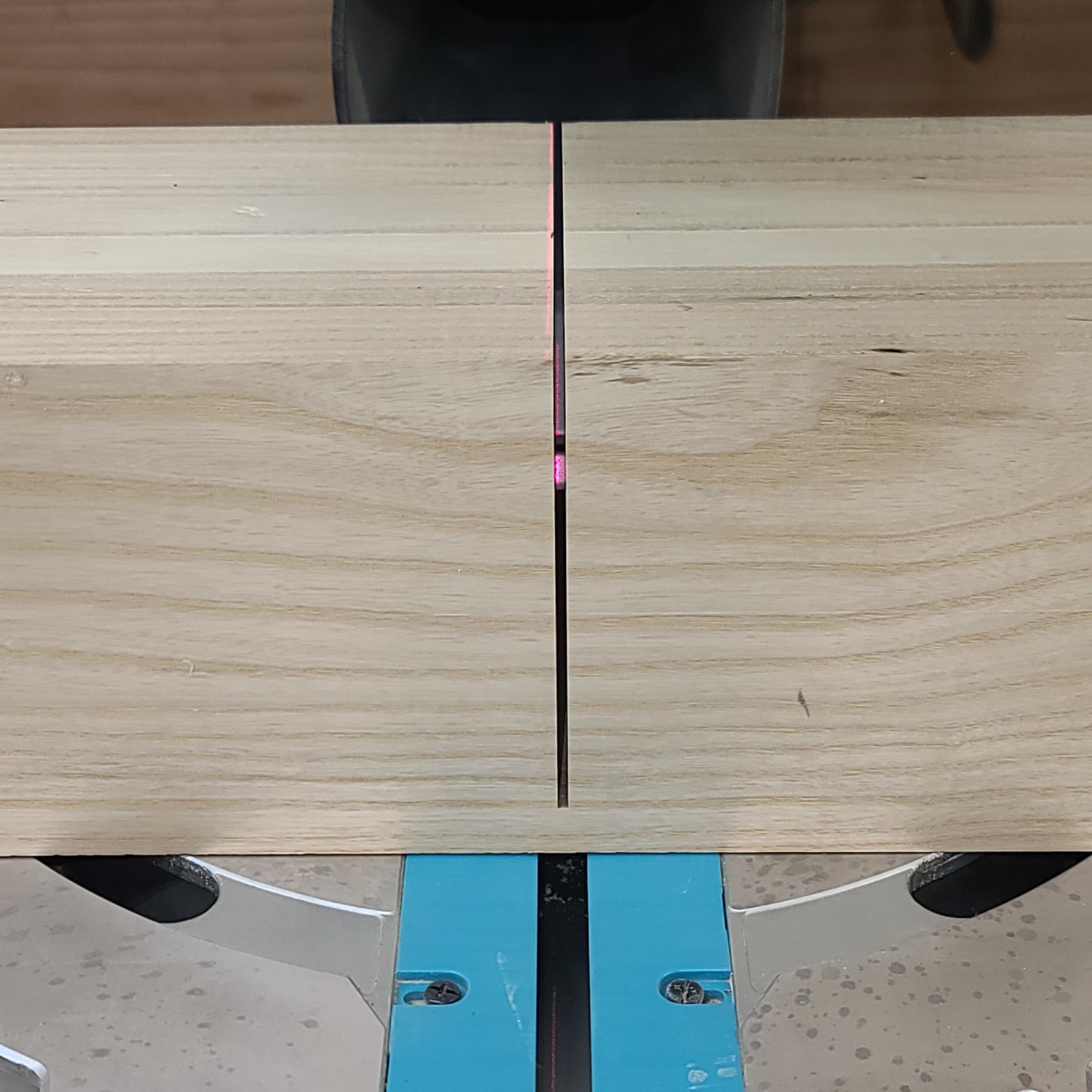

    Next I worked on the stretchers, I had to plane another half inch off of each of the. So my air cleaner will fit under the bench.
    Next I cut the stretchers to length on the miter saw.
    The bottom leg stretchers are thicker and the saw would not cut all the way through in one pas so I just flipped it and completed the cut.

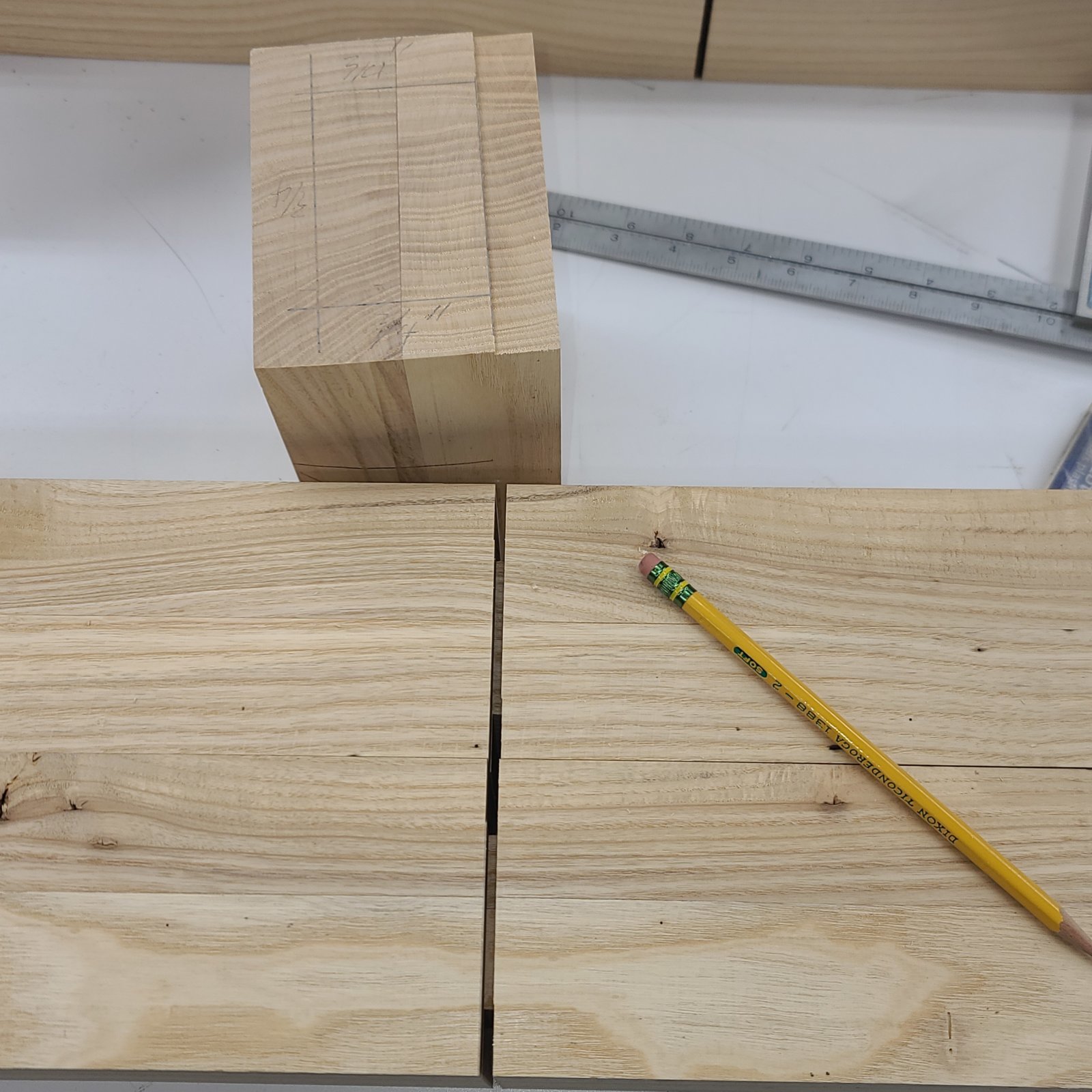

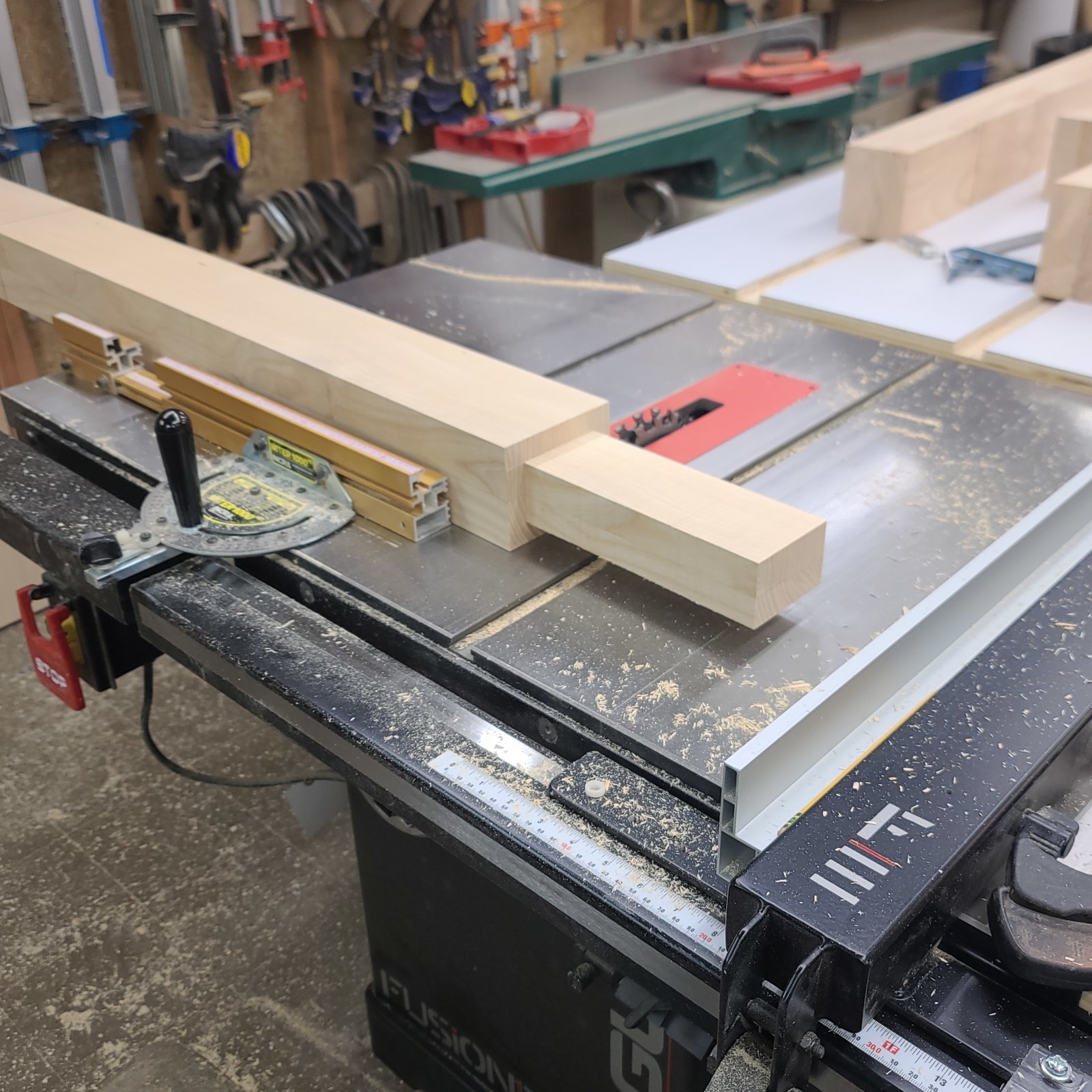

    Next I did some layout for the tennons on one of the cut offs. And then set the saw height for the shoulder cuts.

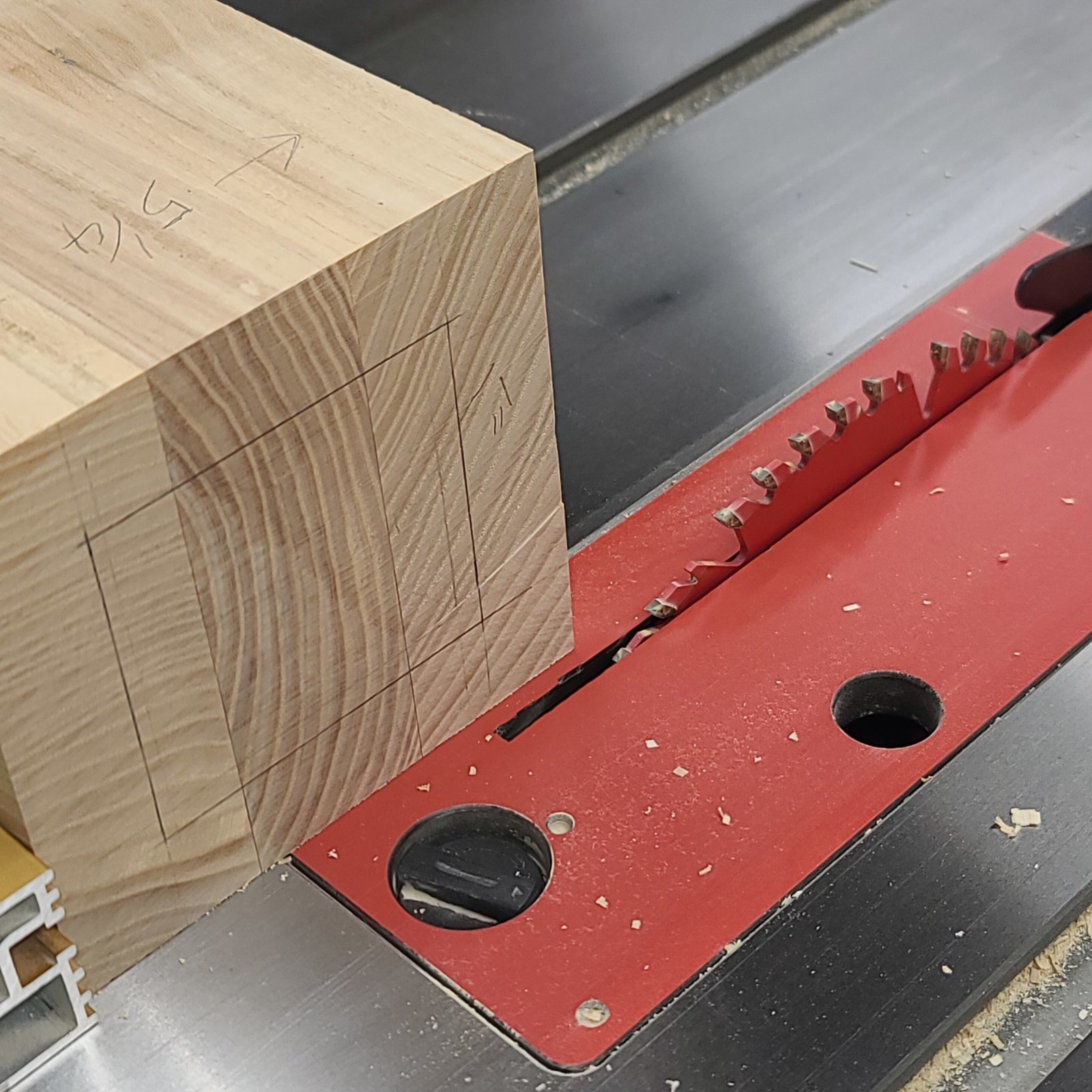

    I used the tennon jig again for the shoulder cuts.
    Nice to have the cut offs for the test cuts
    All the shoulder cuts are now done.
    I set up a full dado stack in the saw.
    And nibbled away at the waste to form the tennons on the stretchers.
    These are really long tennons because they will be wedged through tennons. One down 7 to go.

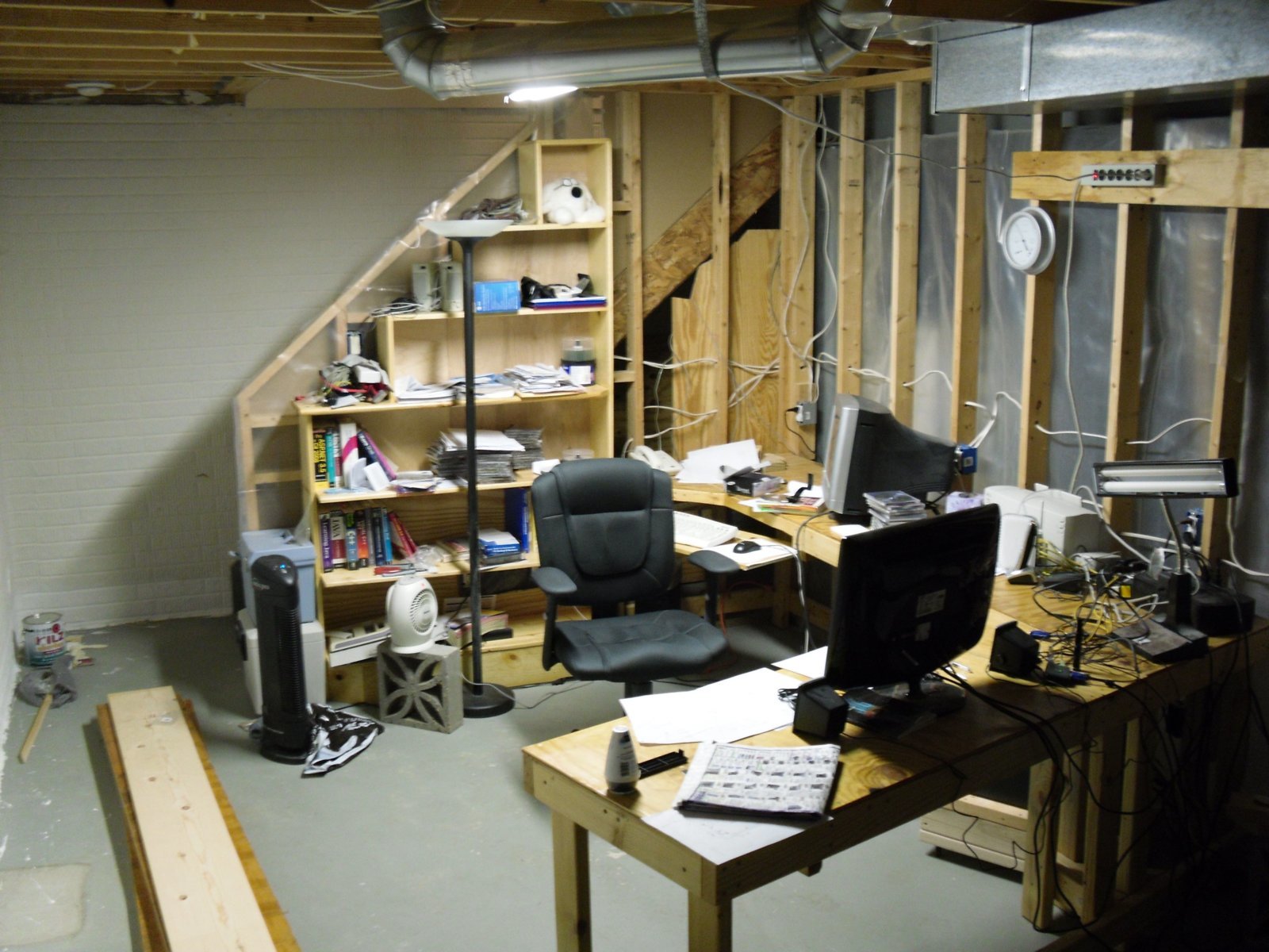

    This bench is based on items I had for years before I moved out of my house: pressure treated 4x4s intended for a bench, and (2) 2x12 8 ft floor joist beams donated by a neighbor who worked construction. I had my own "perfection project". Legs closer to the inside garage door were a few inches shorter than further out (garage slopes). The ONLY metal holding it together was lag bolts into the wall and a few tiny screws holding those front supports that keep the front-joint from breaking off. Everything else is wood dowels ... 5/8 dowels mostly ... and much creative drilling.
    Also a 15 ft work desk and shelf shaped to the basement stairs. "Legs" are half-depth for easy rolling from one end to the other. Two slide-out keyboard trays. Three pieces to make it moveable, but still had to decapitate the top 2 levels of the shelf to move it and had to re-structure the 3-ft wide section of the desk to make it fit inside standard doors in a house. 2x4s under the top plywood to make it a strong top. If you use the 6 3/8-inch bolts to hold the desk together even the steroid-pumped strongmen would find lifting it a challenge.
