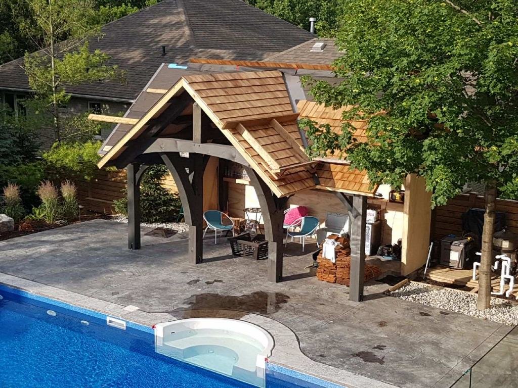

    They are white pine.

    On this one threaded rod gets threaded into a steel barrel in the post, barrel is held in with a steel pin. Holes in the concrete get filled with epoxy and the rod goes in before it sets up. The intermediate posts have a lag in the bottom, same deal with epoxy. All post bottoms have a spacer so the end grain isn't directly on the concrete.

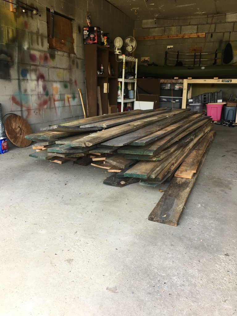

    it looks awful rough, but the price was right and i'm sure you can find some beauty buried in there

    I'll run them thru my planer and they'll be good as new.

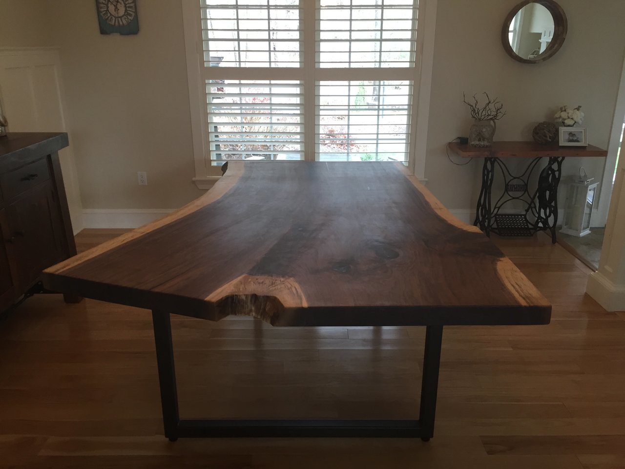

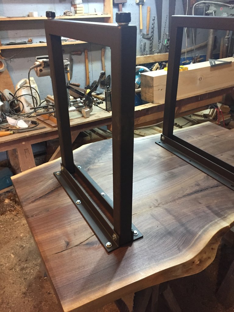

    Made this table for a doctor friend last winter. The table is worth $4000.

    Beautiful

    Beautiful. I'm interested in how you did the legs for this bad boy.

    2" x 1/4" angle iron on wood surface. 2" sq tubing welded. Self levelling feet.

    Thanks. Assume you fab'd that part up yourself? Either way, them legs look good on that table. I always struggle with ideas on legs when I'm going about a project.

    I design and produce a drawing which I email to weld shop. (My farmer buddy who has weld shop in old pig barn) pcs are taken to paint shop for powder coat. It was a bronze sandtex coat. I have a guy in Toronto who has a 52" planner but that slab was 60" so I ended up just sanding flat with floor sander. Another buddy is an arborist and has several large black walnut logs slit into 2 1/2" slabs.

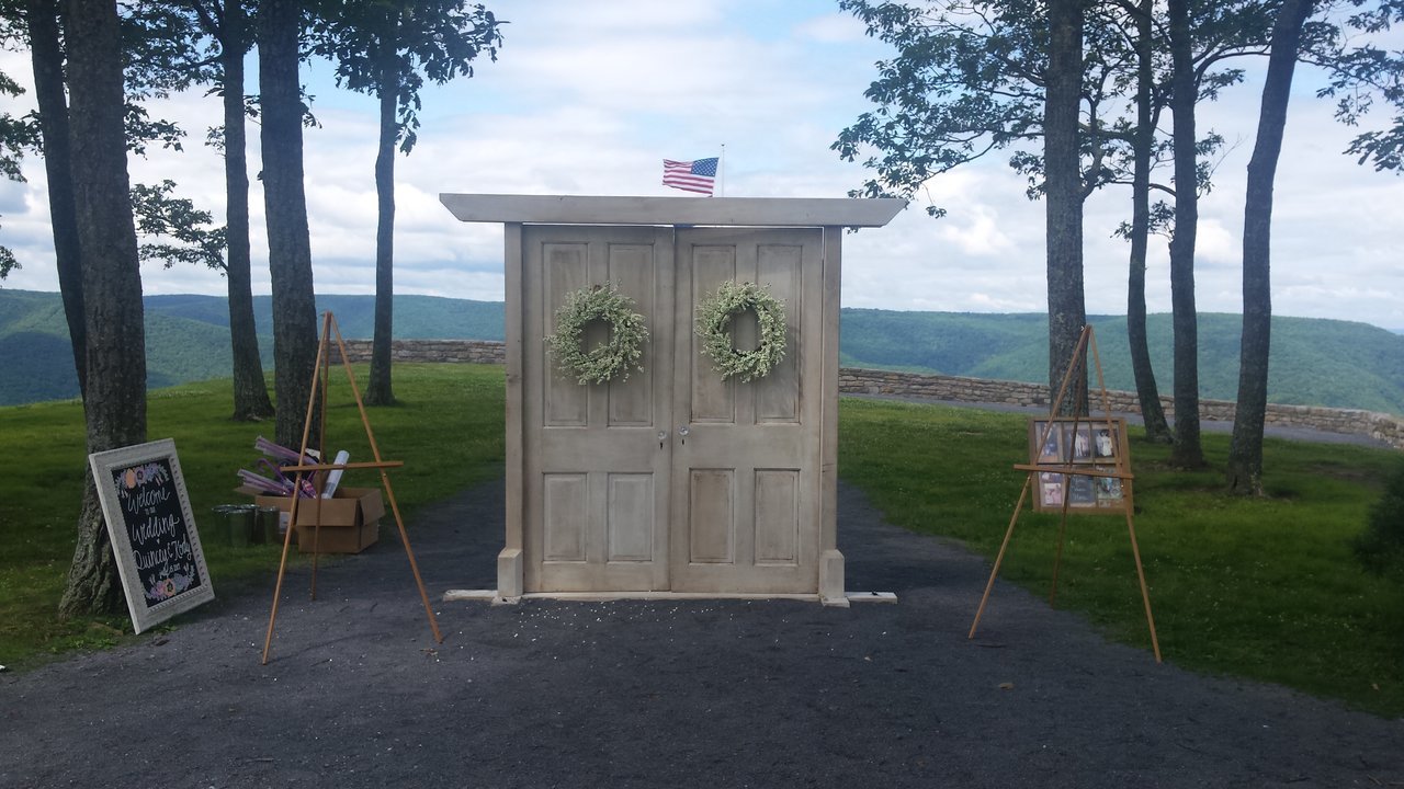

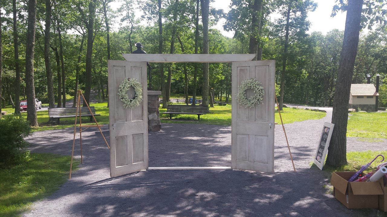

    Made this out of two old doors for a wedding.

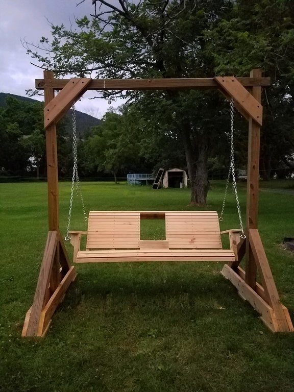

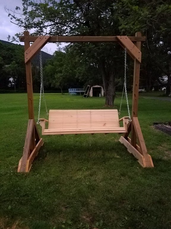

    Finally got a chance to hang this swing. Still needs fine tuned and the excess chain removed.

    Looking forward to your full-scale trebuchet.

    I am very disappointed in the GF. For someone with the amount of degree's she has, I find it inexcusable to be unfamiliar with Medieval Siege Engines.

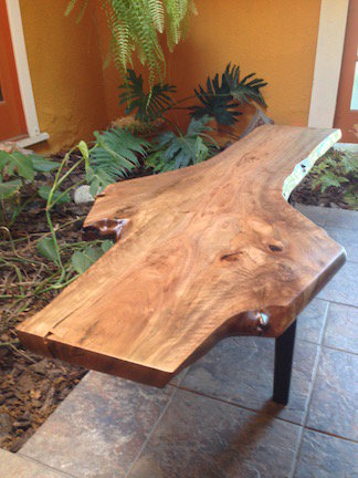

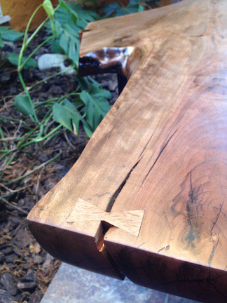

    Live edge coffee table. Claro walnut harvested less than a mile from my house.

    Very fine work Sir!
    Any pics of the under side or is that secret. lol
