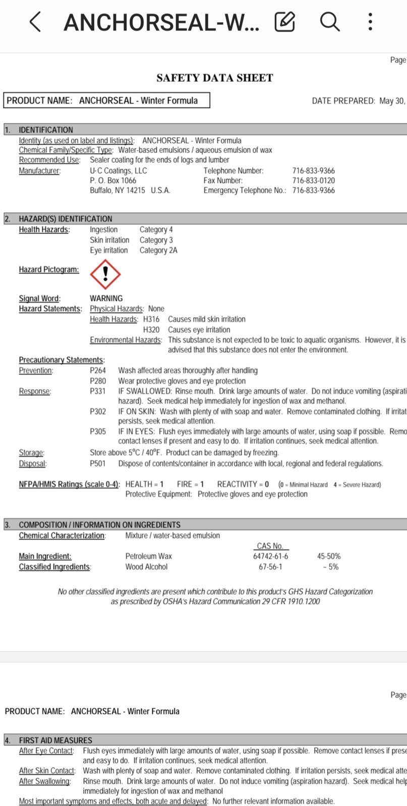

    Is that food safe?

    It’s just to seal the end grain while air drying. Probably is tho. Just wax and water I believe

    I wouldnt use it personally on food items.

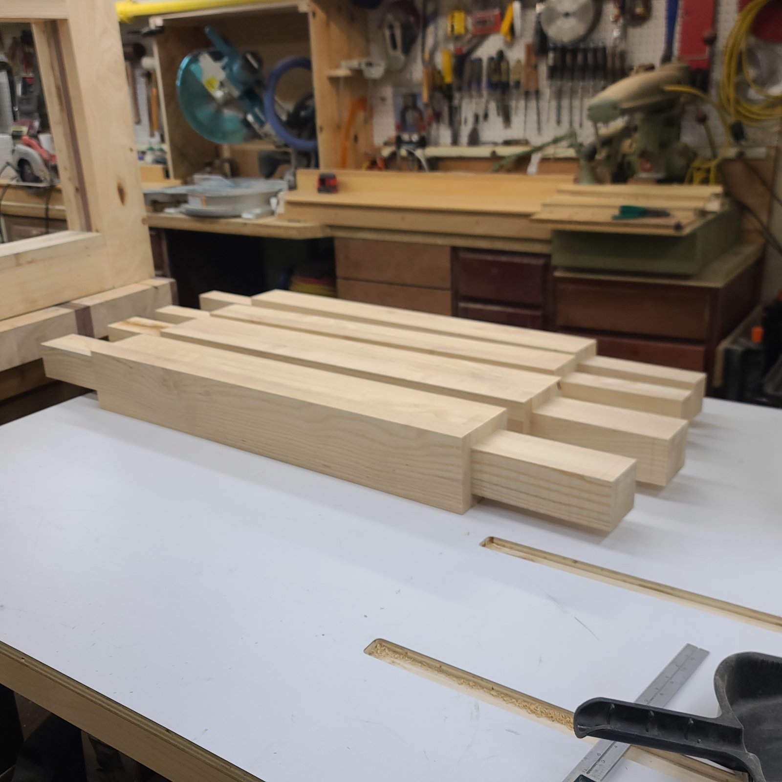

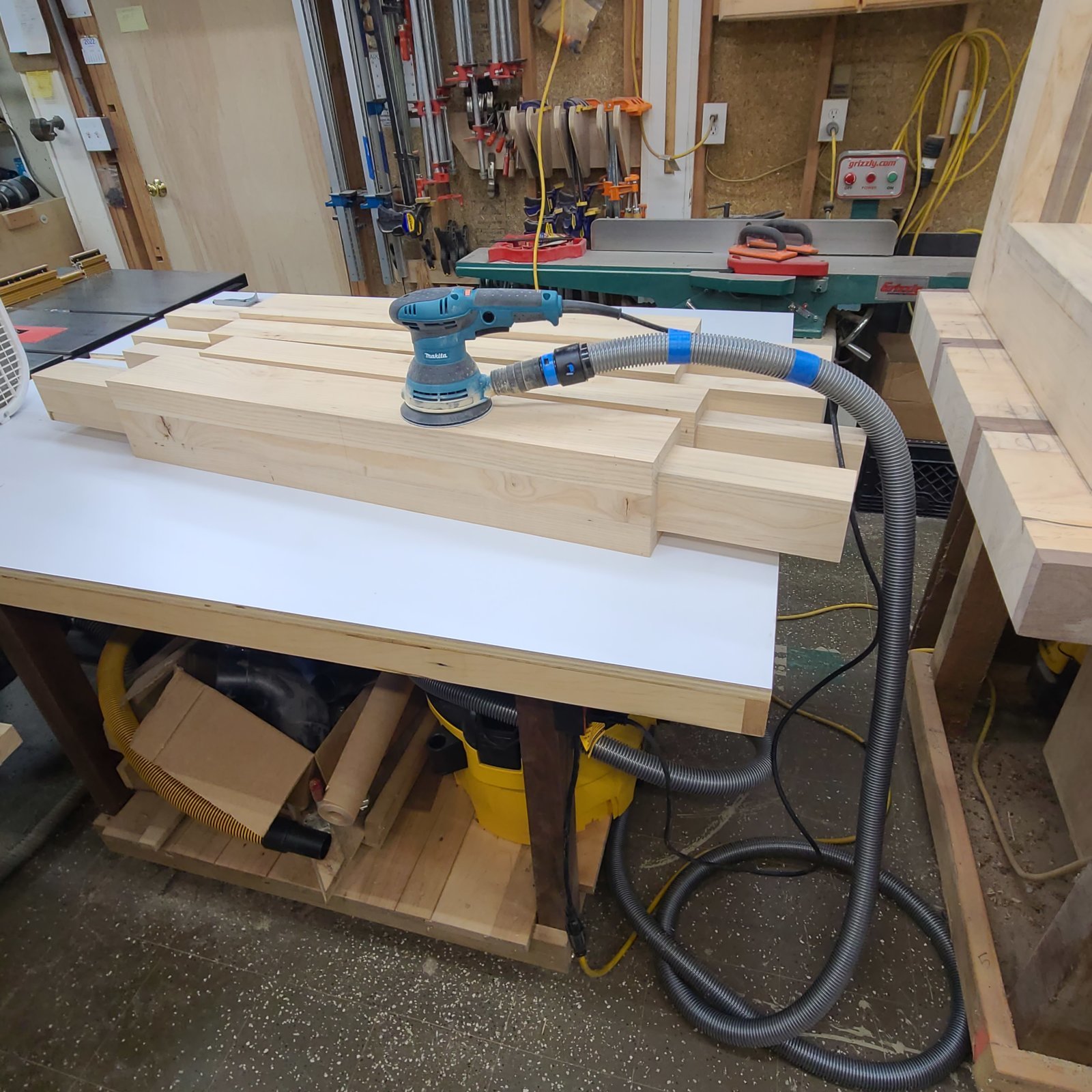

    Today's shop time. Finished cutting the tennons on the cross stretchers.
    The dado set that I have doesn't cut real smooth. The outside plates leave score lines.
    So I sanded all the tennons smooth. This makita sander works excellent hooked up to the triggered shop vac. Virtually dustless sanding !
    Nice and smooth and flat now. They will be much easier to fit like ths.

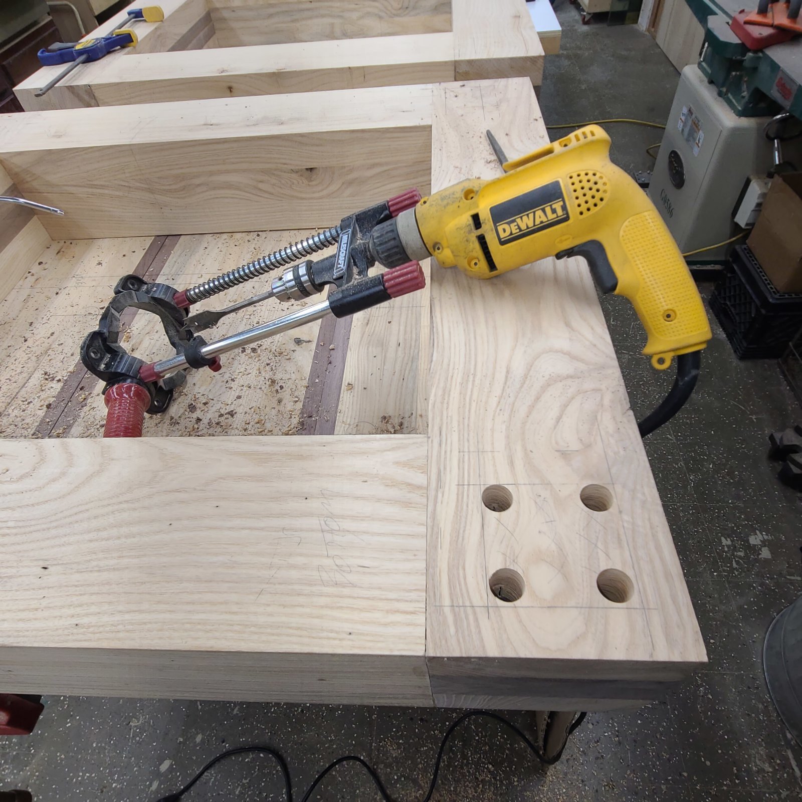

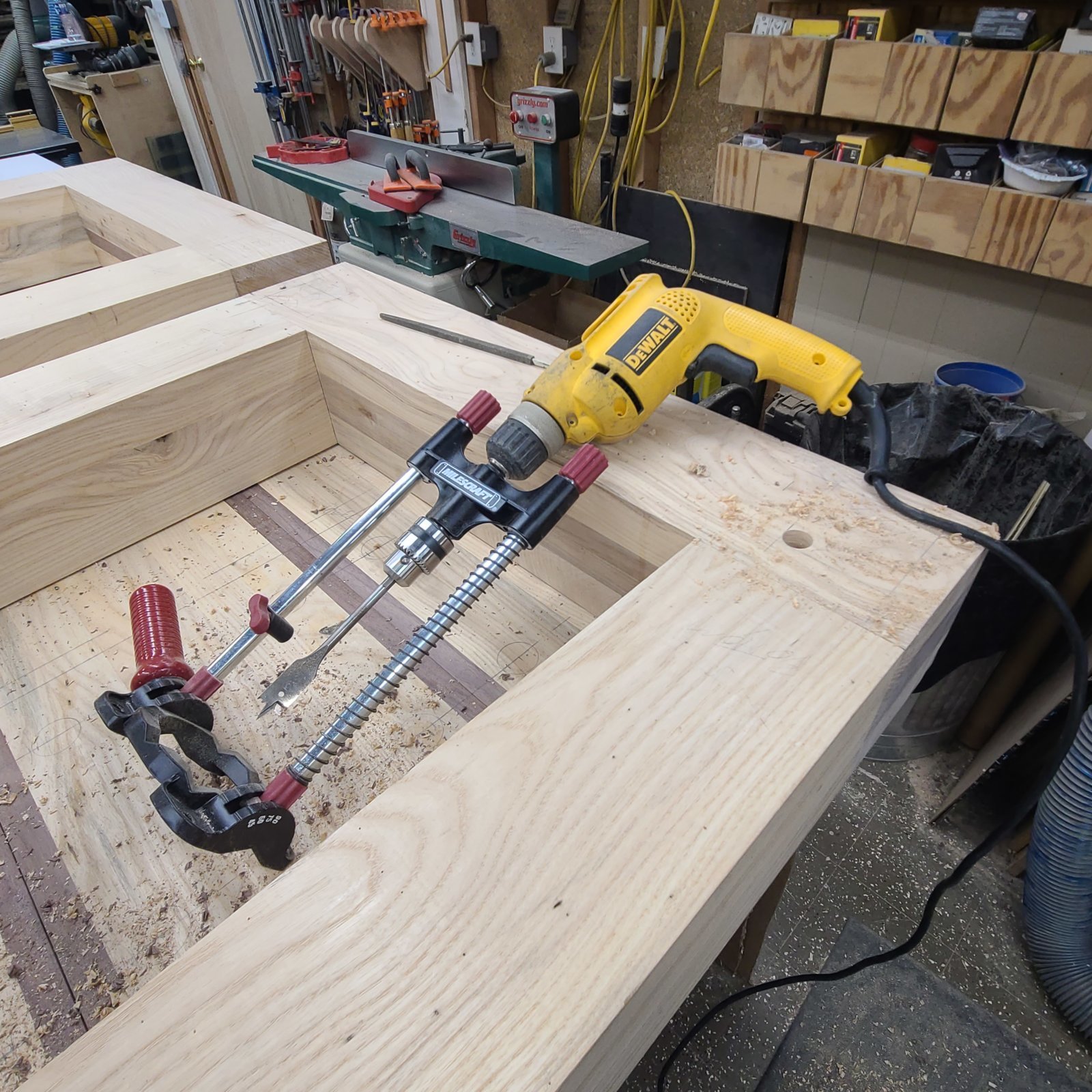

    I got about an hour in the shop tonight so I started drilling out the waste from the mortices.
    Set up the drill guide with a 3/4" spade bit. The drill guide really does help to keep me straight.
    Drilled a little over half way thru.
    I quickly switched to a corded drill so I don't burn up my old blue ryobi cordless. This is going to be a lot of drilling.
    First I establish the corners and then just connect the dots.
    Once I get done with this side I'll flip em and finish drilling from the other side. I do file the spade bit to keep it cutting. It does drill really fast and clears the chips well.
