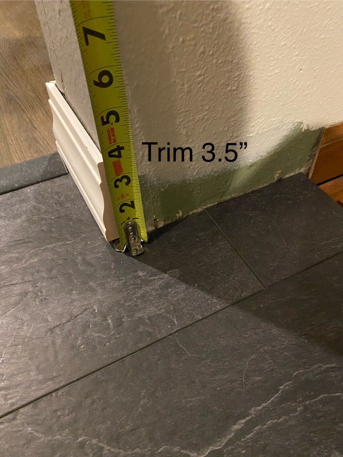

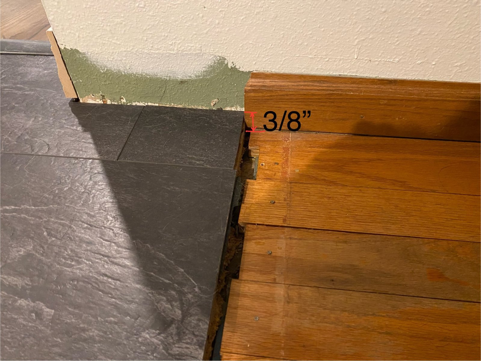

    The oak trim in pic is getting replaced, so ignore it. I planned to install the actual floor transition after base trim is finished.
    the transition at the corner seems trickiest.

    Just wrap the corner and butt the 2 together. Imo. Why make it more difficult than it has to be.

    looks like you'd just notch out 3/8" with a jig saw or an oscillating tool would probably be better. hold the trim against the wall and mark it at the edge of the tile and notch out the 3/8"
    Edit: scratch that, im thinking of it backwards. unless they make 3-7/8" tall foot board :D

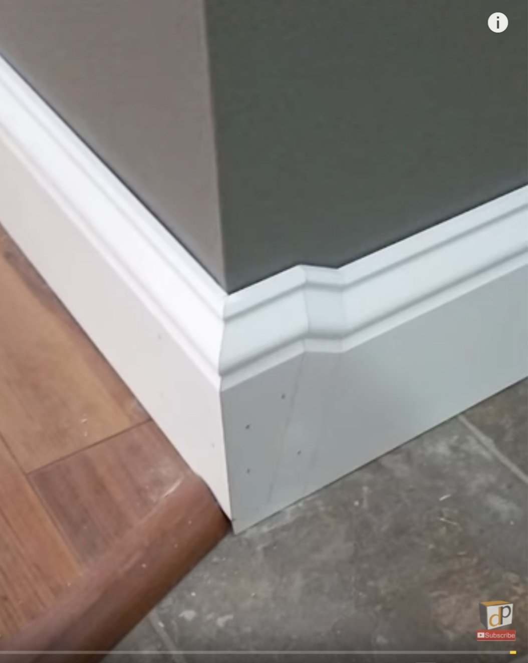

    Why not try something along the lines of a plinth block? Yes, they are typically at the bottom of door frames but you may be able to make it work as a transitional piece between the two trims.
    -J

    Transition idea.
    All things Plinth.
    But seriously, if you aren't following Finish Carpentry TV or Brent Hull on YT, you're missing out.
    -J

    Thats the move right there. I like how that looks.
