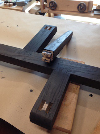

    I made a base from laminated 6/4 white oak. One long member down the middle, and two side members dovetailed into the middle one:
    Legs are white oak, tapered and pillowed, with twin tenons for attaching to the base:
    This was all done using hand tools only. I think it came out pretty well:

    Absolutely gorgeous!

    Very nice work. Really like the shop also.
