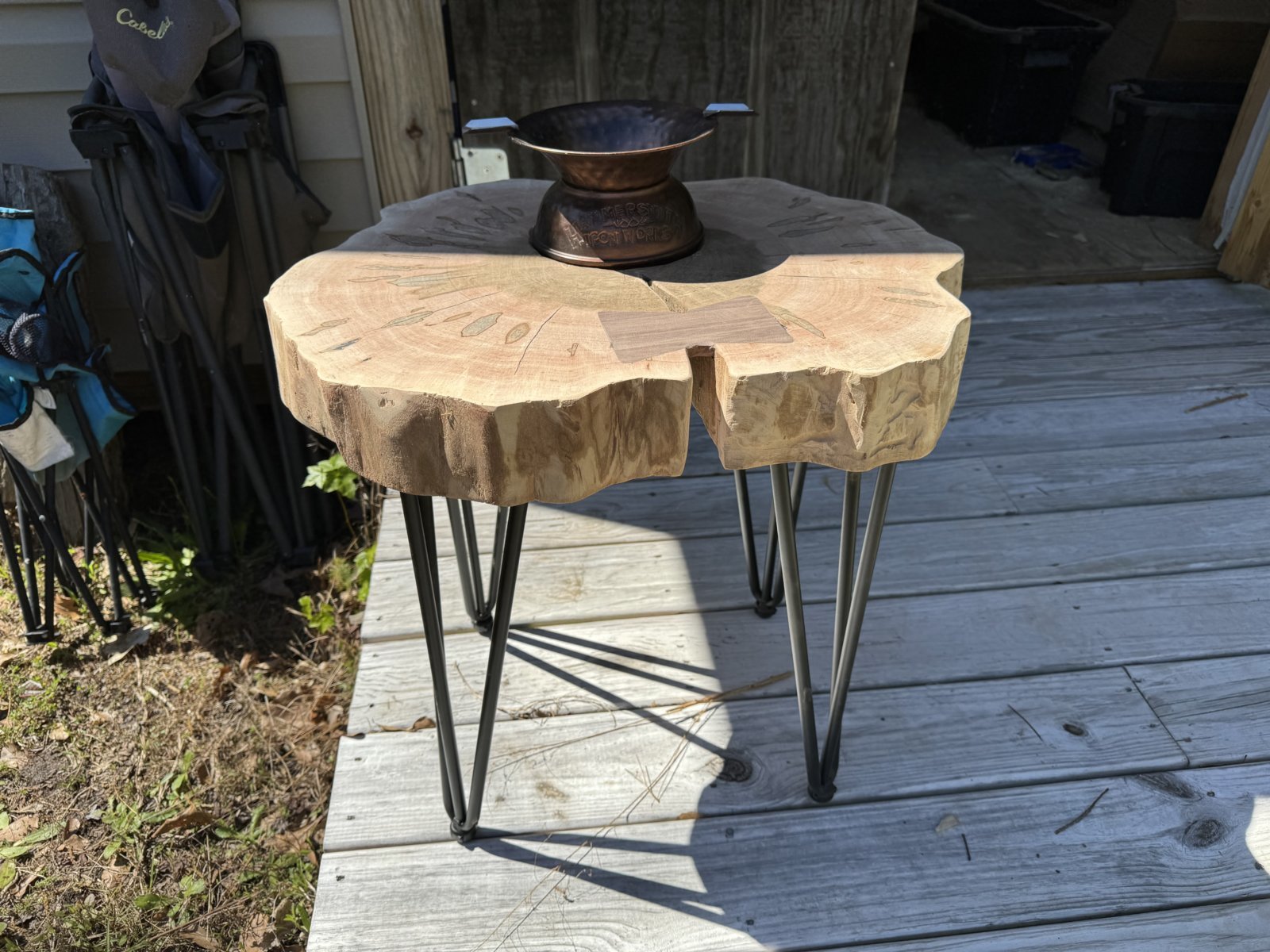

    Well they were dead set on it being set into the table rather than being under it. I actually think it turned out pretty damn good looking.
    waiting for some cigar wrappers from my guy that I’m going to glue down and do an epoxy pour to seal it all up.

    Nice!

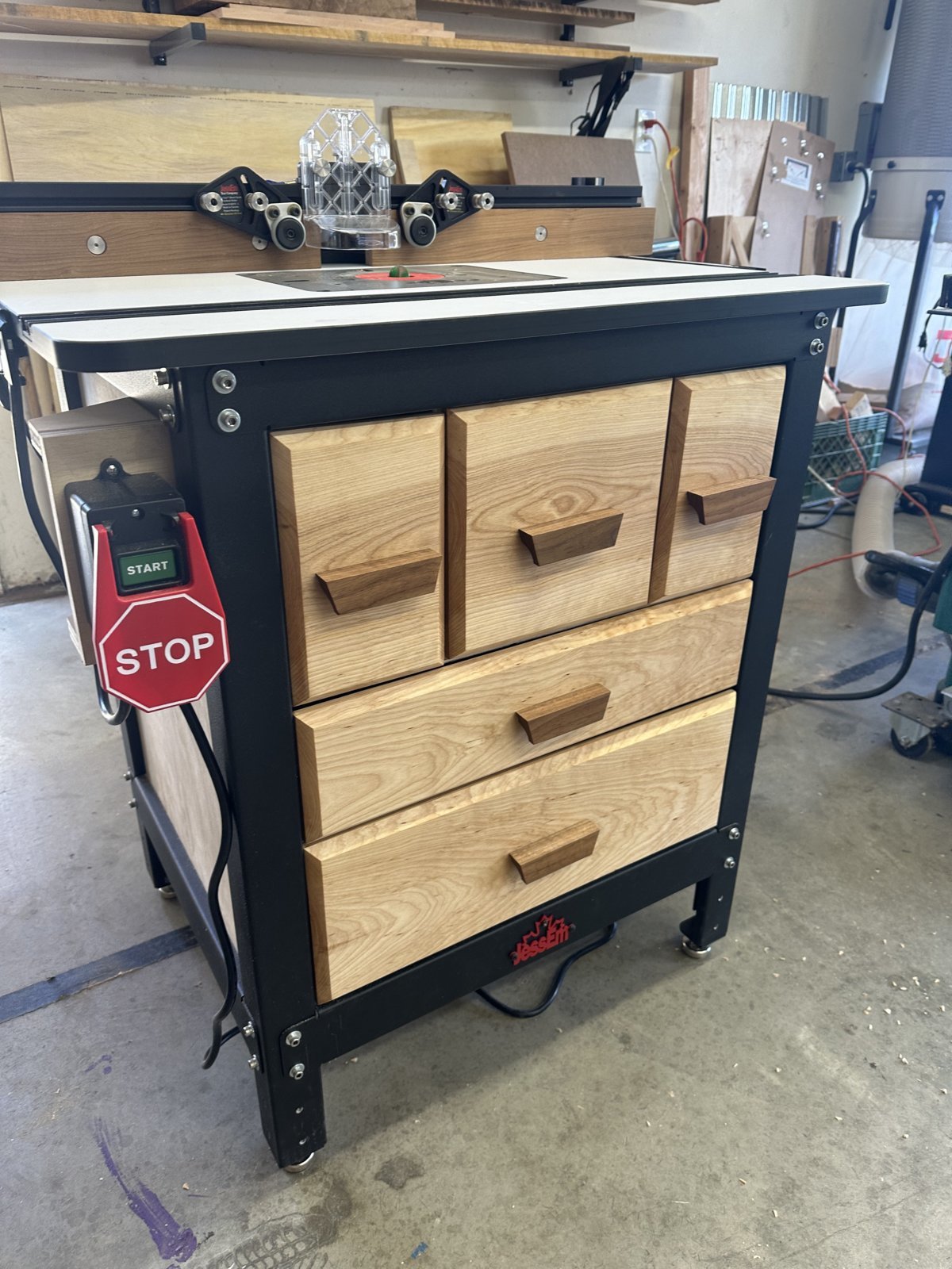

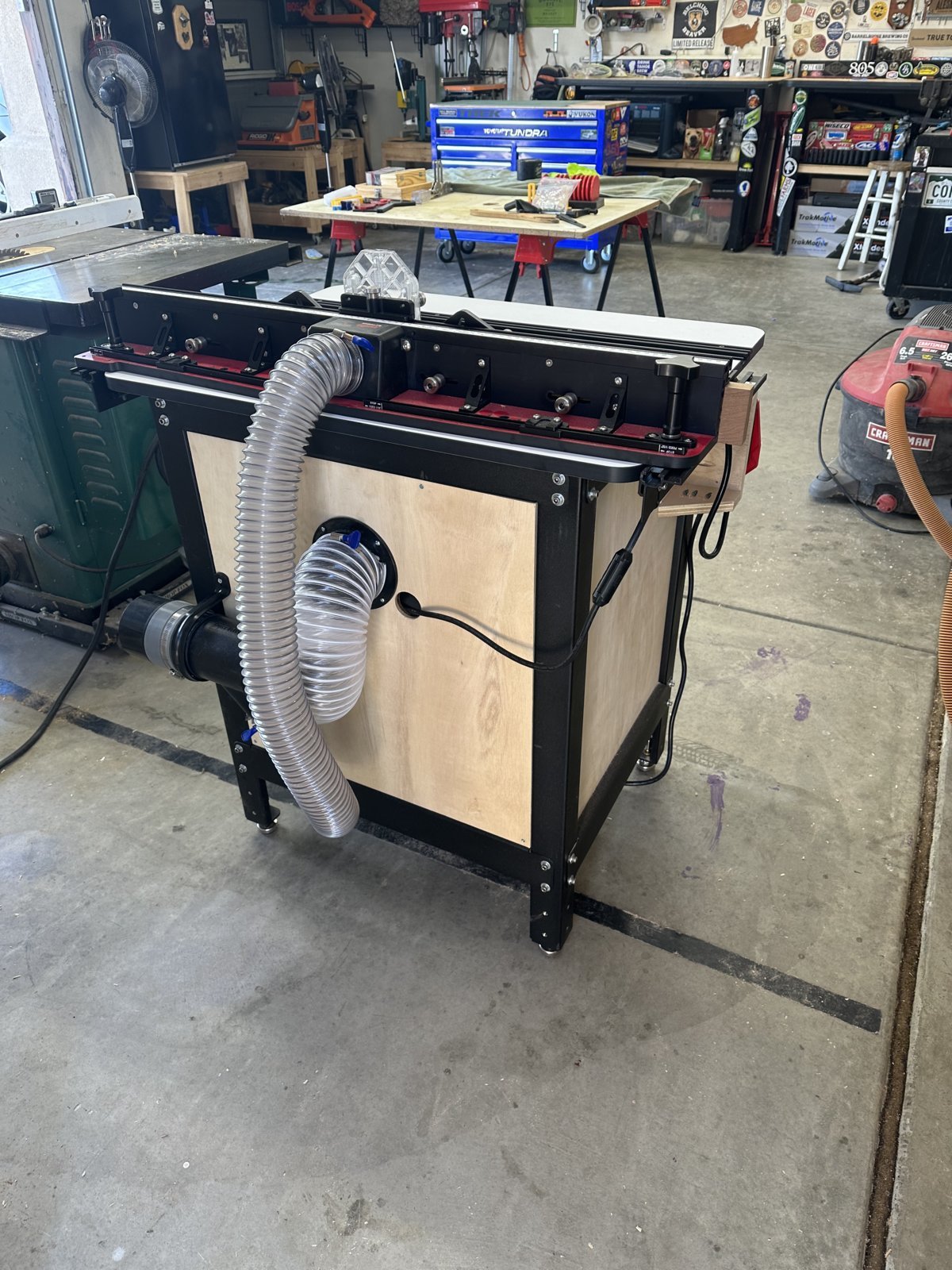

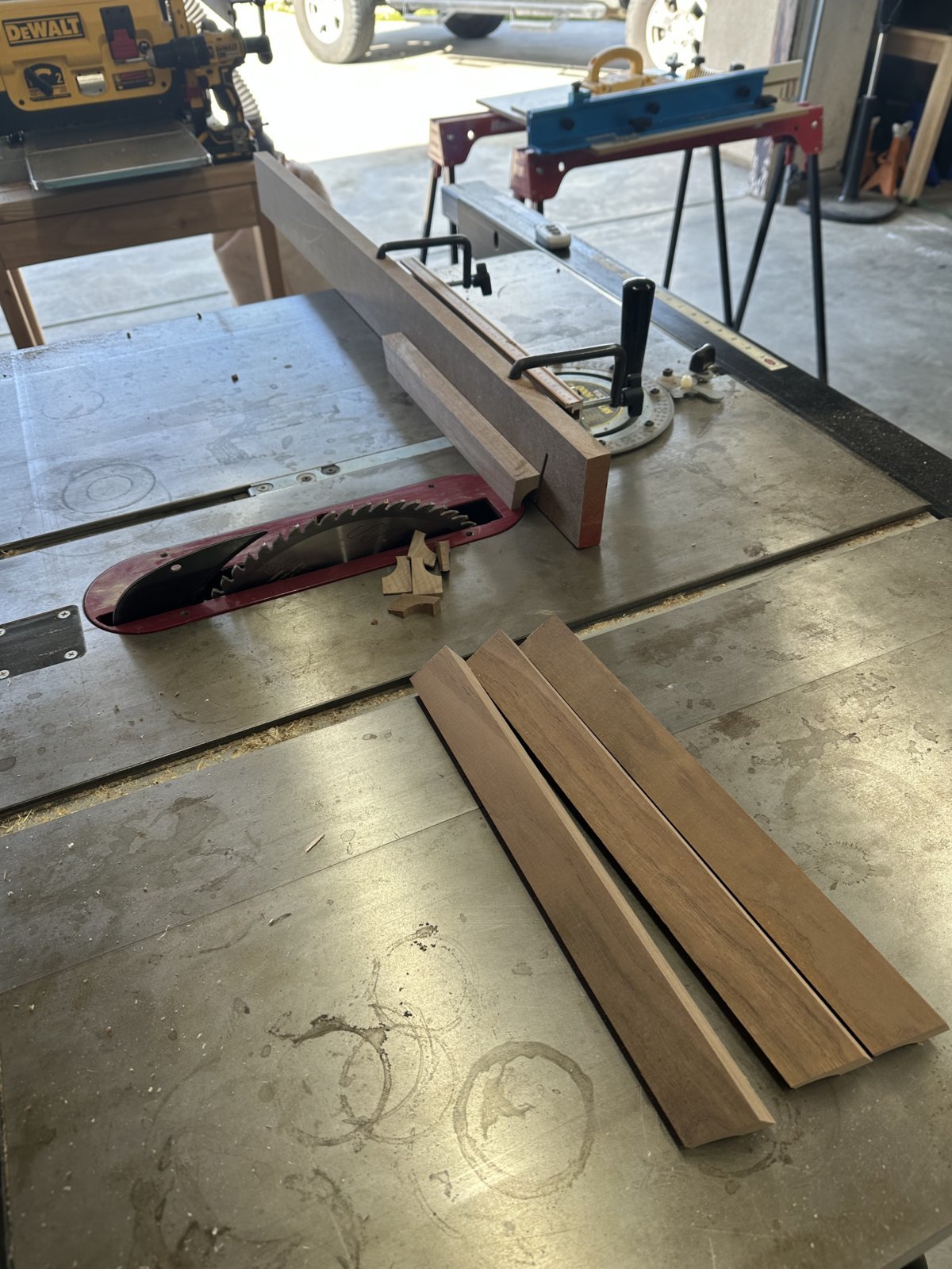

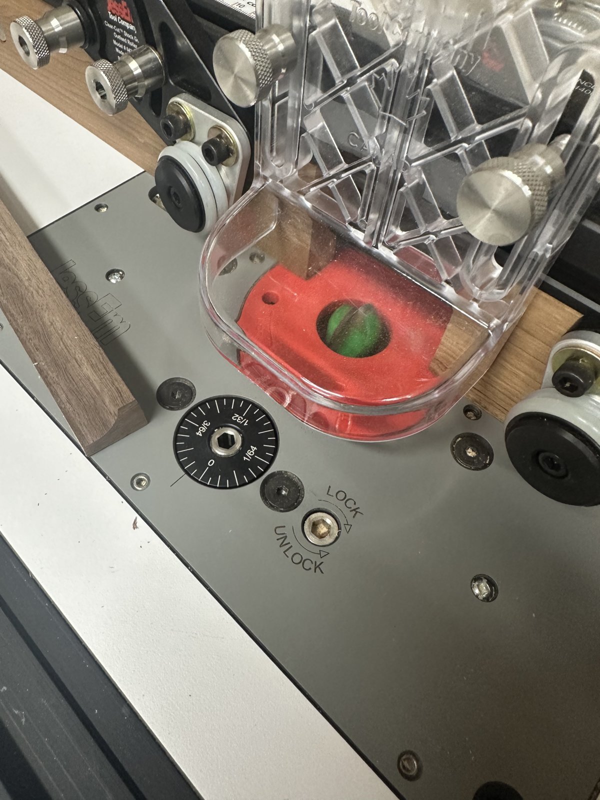

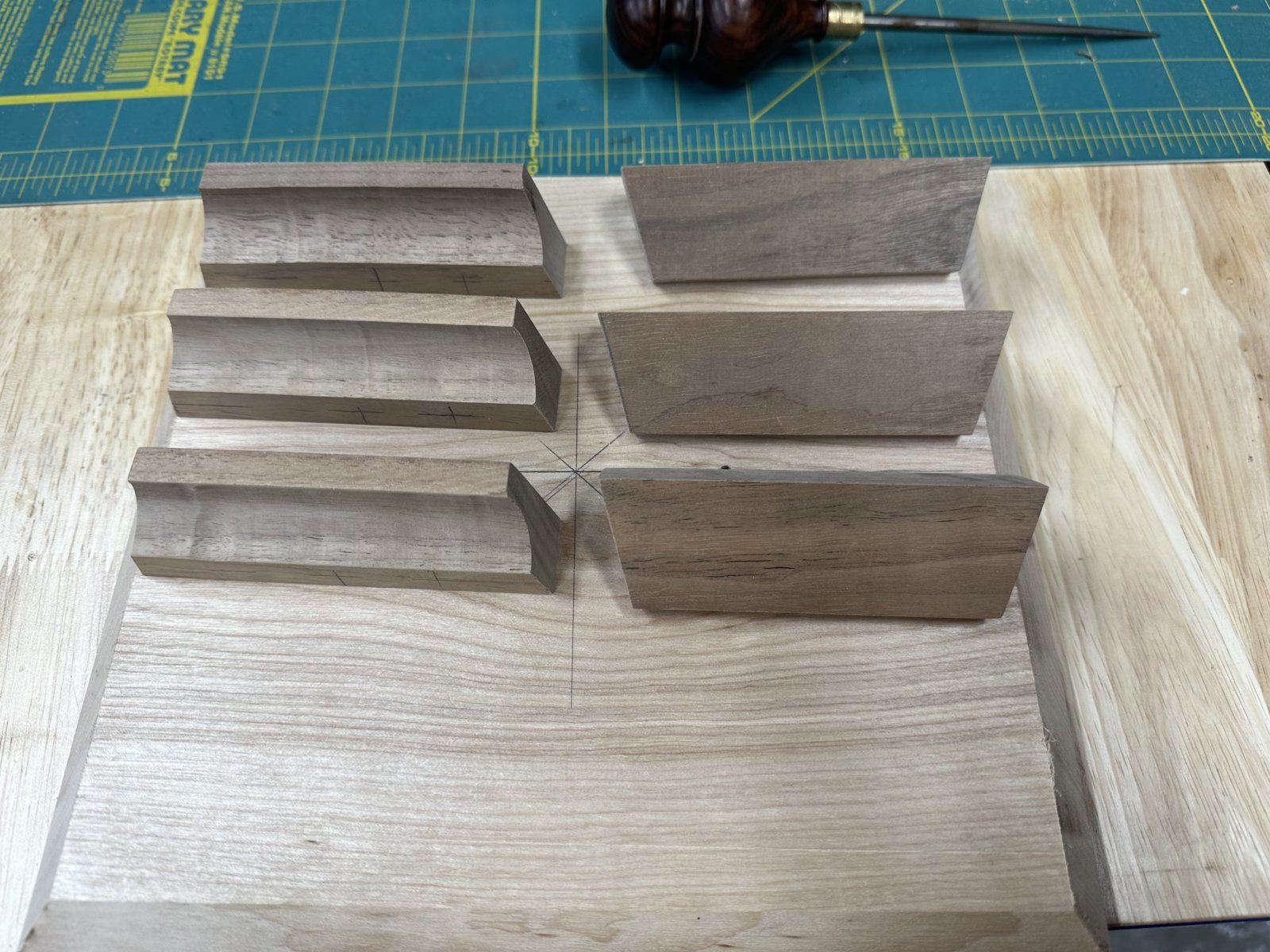

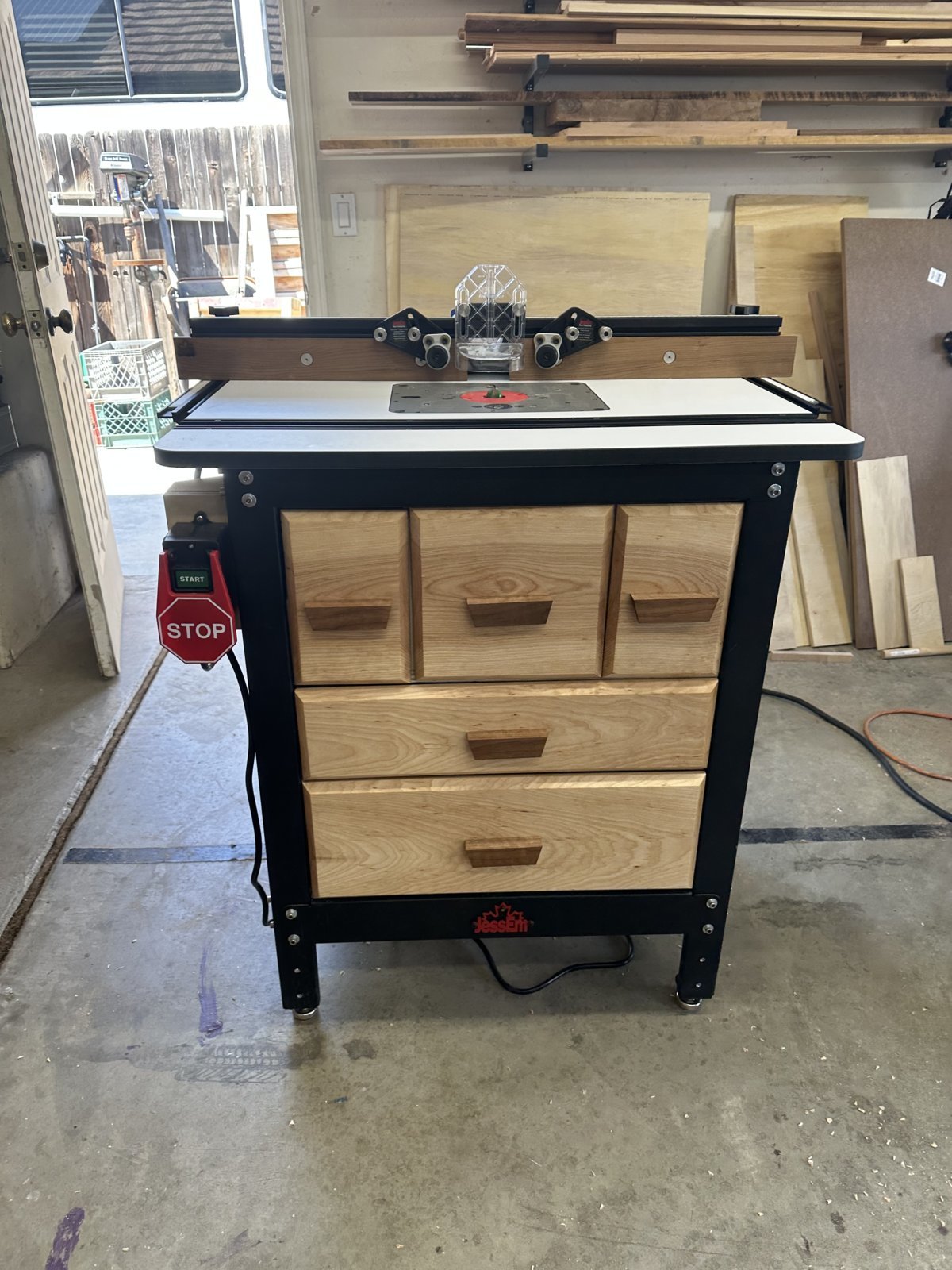

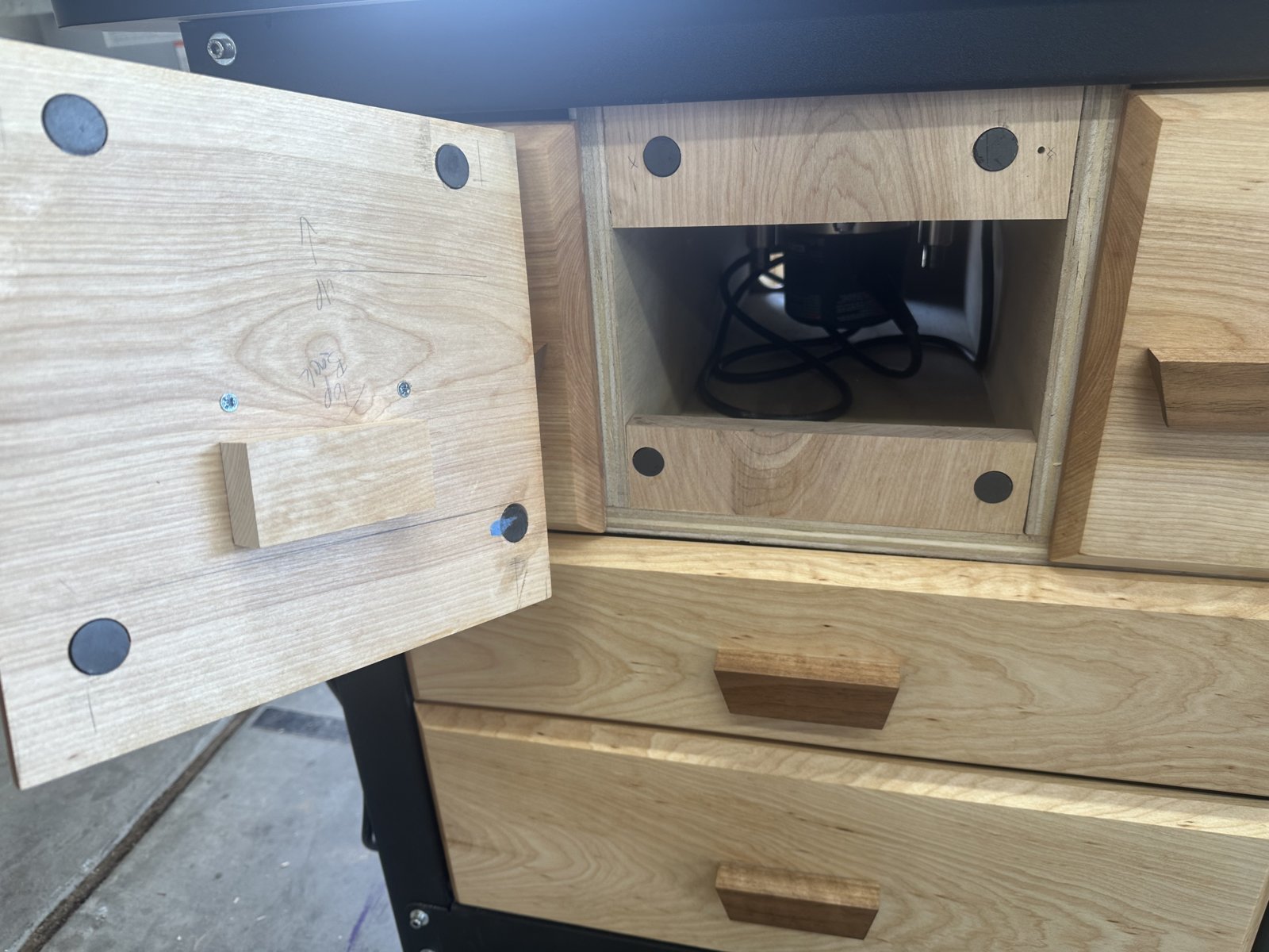

    May add some organizers to the drawers, but done for now
    Made some pulls from a scrap piece of walnut.
    0CDD4972-D2F5-4B29-AA43-D3F24471A992.jpg D4CF01A9-7352-4922-A72B-FC4ACFC4E604.jpg
    Center section is held on by magnets so I can still access the router speed control.
    Finished with Walrus Oil Furniture Butter on drawer faces only.
    3CA0EFAB-6A5E-4A6D-A774-B55DD75258BF.jpg 2808496B-0376-46C2-BB0C-83636D179F70.jpg C02C7C75-10F7-4139-916A-819F450C5349.jpg

    It came out really nice, I'm sure it will serve you well.

    You may want to route in some thin slots to your top center "drawer" to help with dust extraction inside the router box if you're noticing an excess of chips collecting in there. Also ditch the hard 90's inside the box to help dust flow by preventing dead zones.
    Slots like these, albeit lower on the door closer to the bottom.
    Remove the 90's like this guy.
    I saw another video that incorporated all of these techniques but I cannot for the life of me remember who filmed it so you'll just have to stick with those two. Hope it helps.

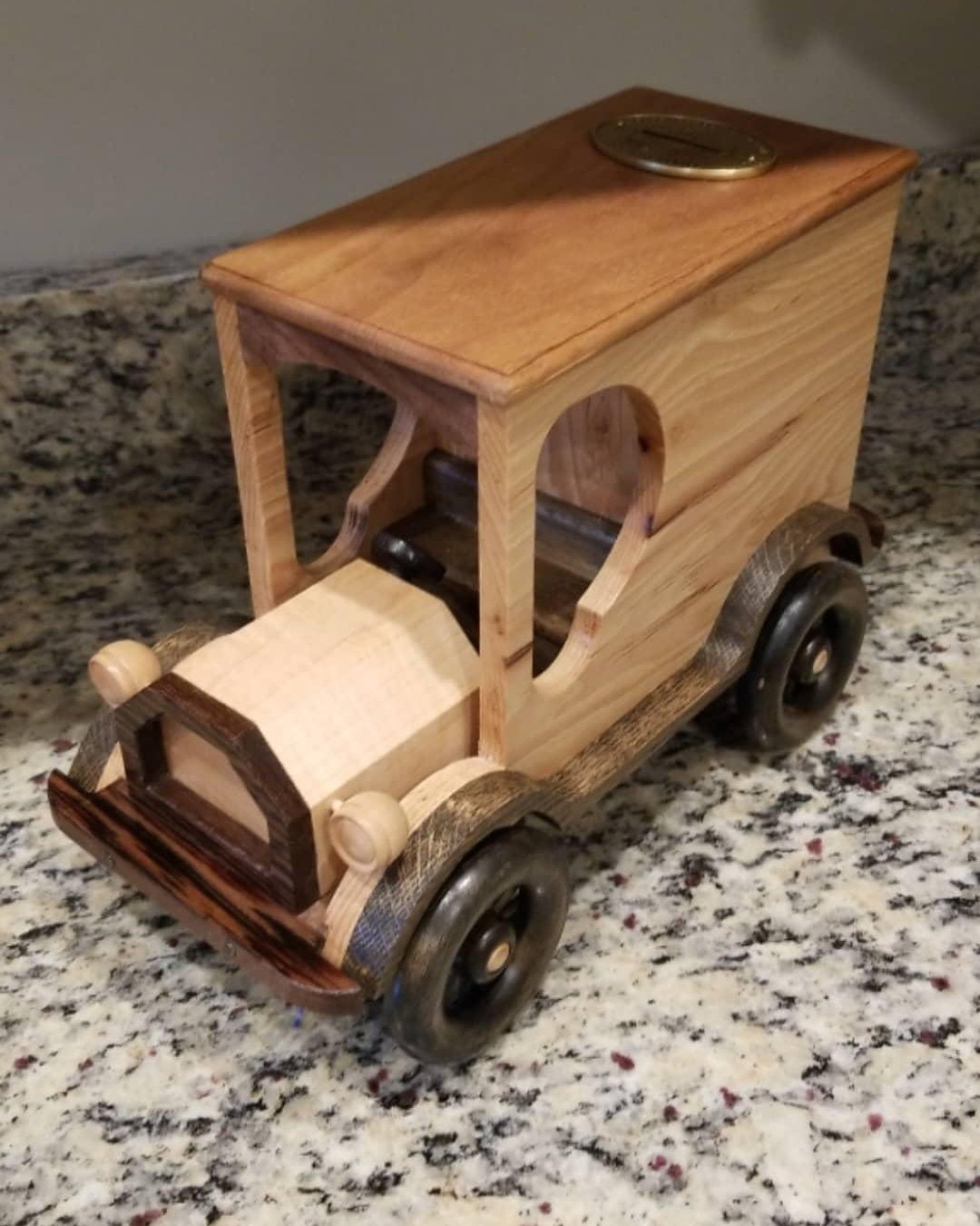

    Some stuff. Not a lot, just some.
    I don't think it's tough top work with. It's just tough.
    This is hickory with walnut, maple, and wenge.
    If your tools are dull, you'll notice. I'd say give it a try.

    Thats neat! Did you have plans?

    Sure do. See attached

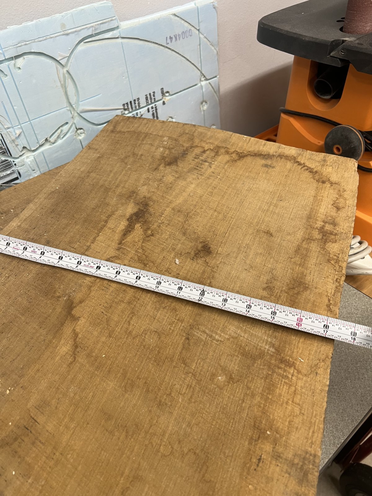

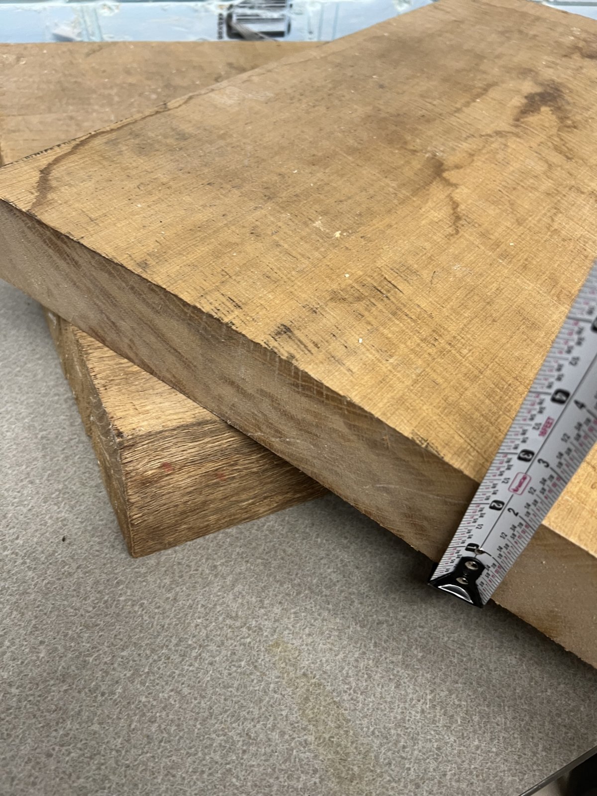

    I’ve got these two small slabs, not sure what they are. Both are about 17”x22”x2” . Anyone have an idea of the wood type and any suggestions what I could make with them? I was thinking of a small side table.

    Could be Maple, need to surface it to see better

    I'll slice them up this weekend and get some pics.

    Just run a block plane across a small section to reveal the grain.

    is it pretty heavy? Compared to other stuff its size.
    Looks like white oak to me, if you sand it and smells a little like vanilla its white oak. White oak is heavy

    Its extremely heavy, I dont think its Oak, could be wrong though. Could it be Hickory?

    A palm sander with #80 grit will clean it up enough to see grain, hopefully it’s Curly Maple, my favorite
