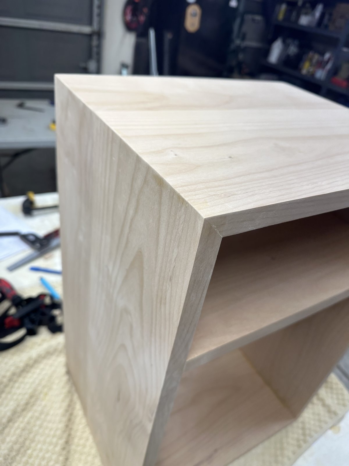

    Are you working with a table saw? This is a dry fit off my table saw from a project about a year ago. I used Dominos to help with alignment.

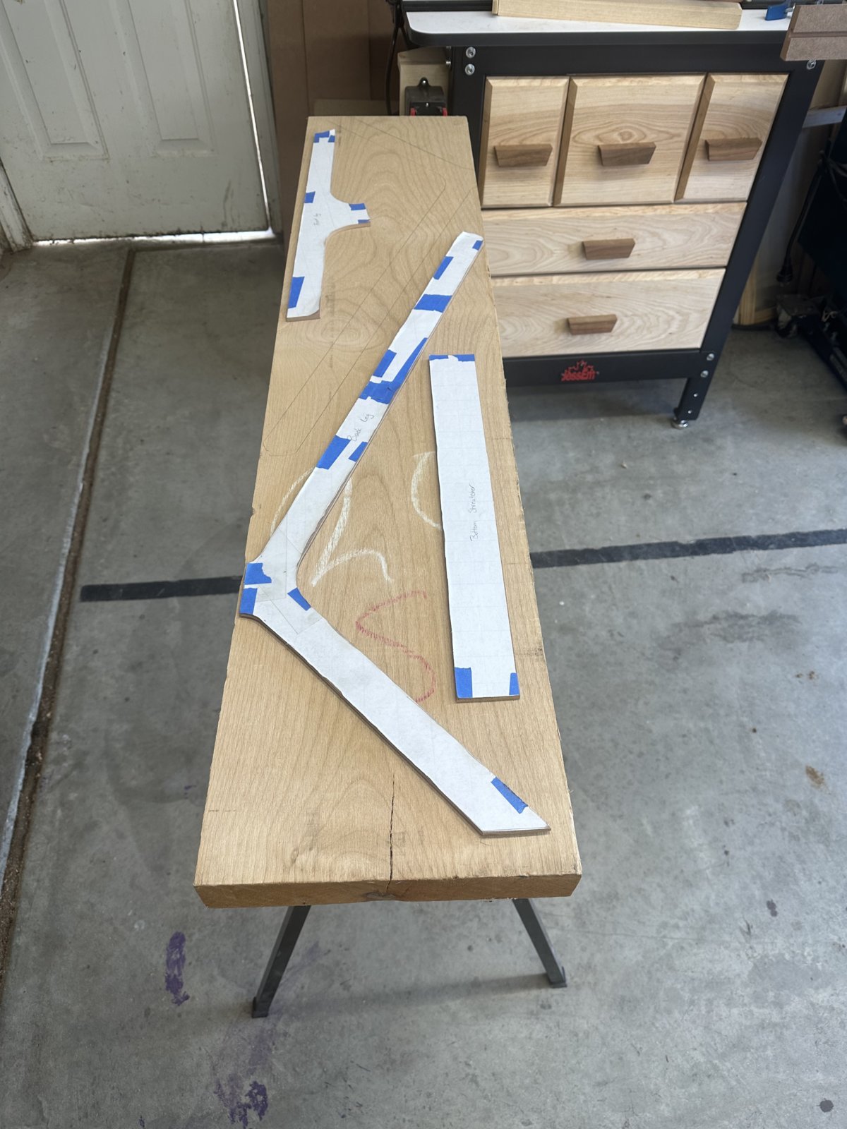

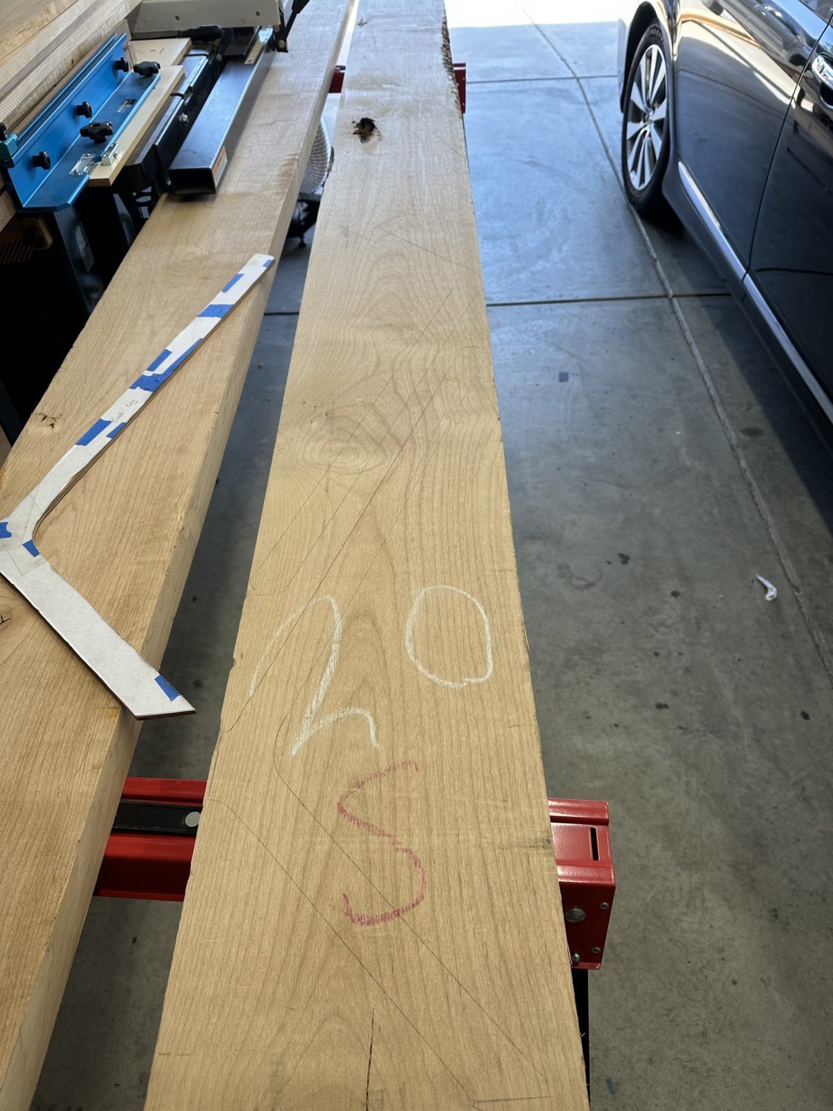

    Finally able to make it to my wood place while they were open. Lots of 8/4 Alder came home with me. That 10+ inch wide board is going to work out great for the rear leg / back rest chair pieces. The extra is for the next project. 2D2510FF-430F-4124-8F0D-CF12FBD661D2.jpg 7DBC80E5-070A-4C4B-B48B-B3394E85C9D5.jpg

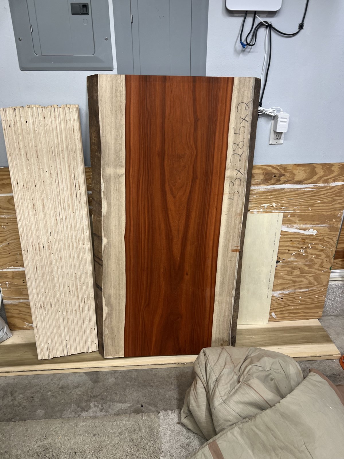

    Picked up a nice padauk slab because it spoke to me. Wish it would tell me what it wants to be.

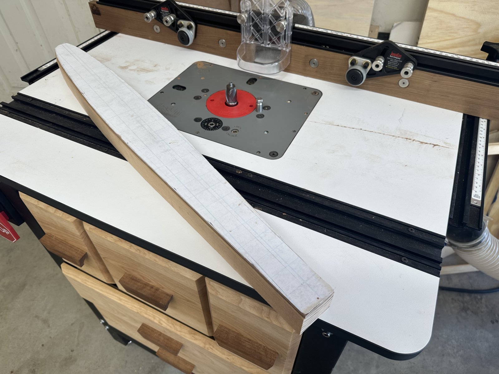

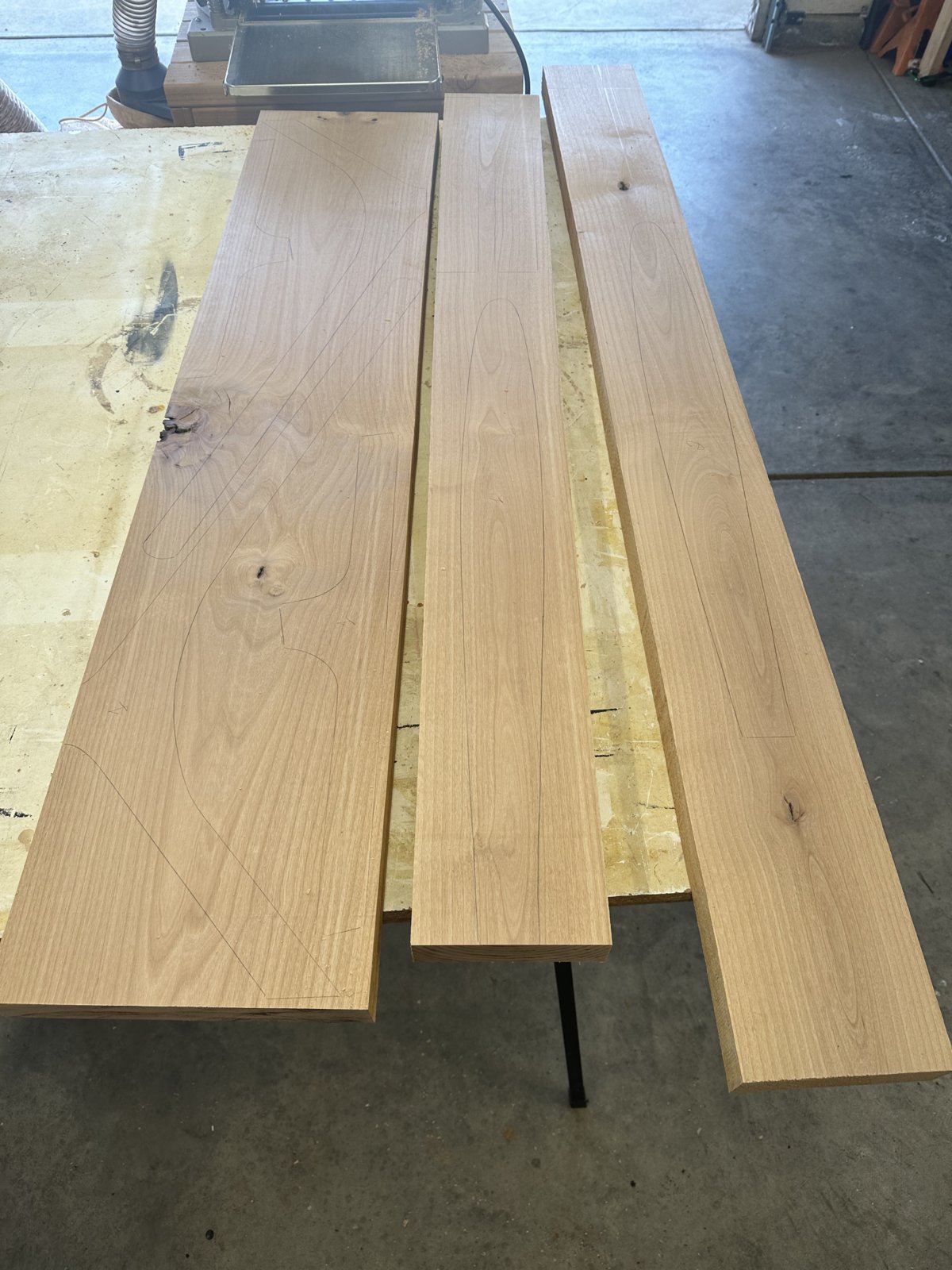

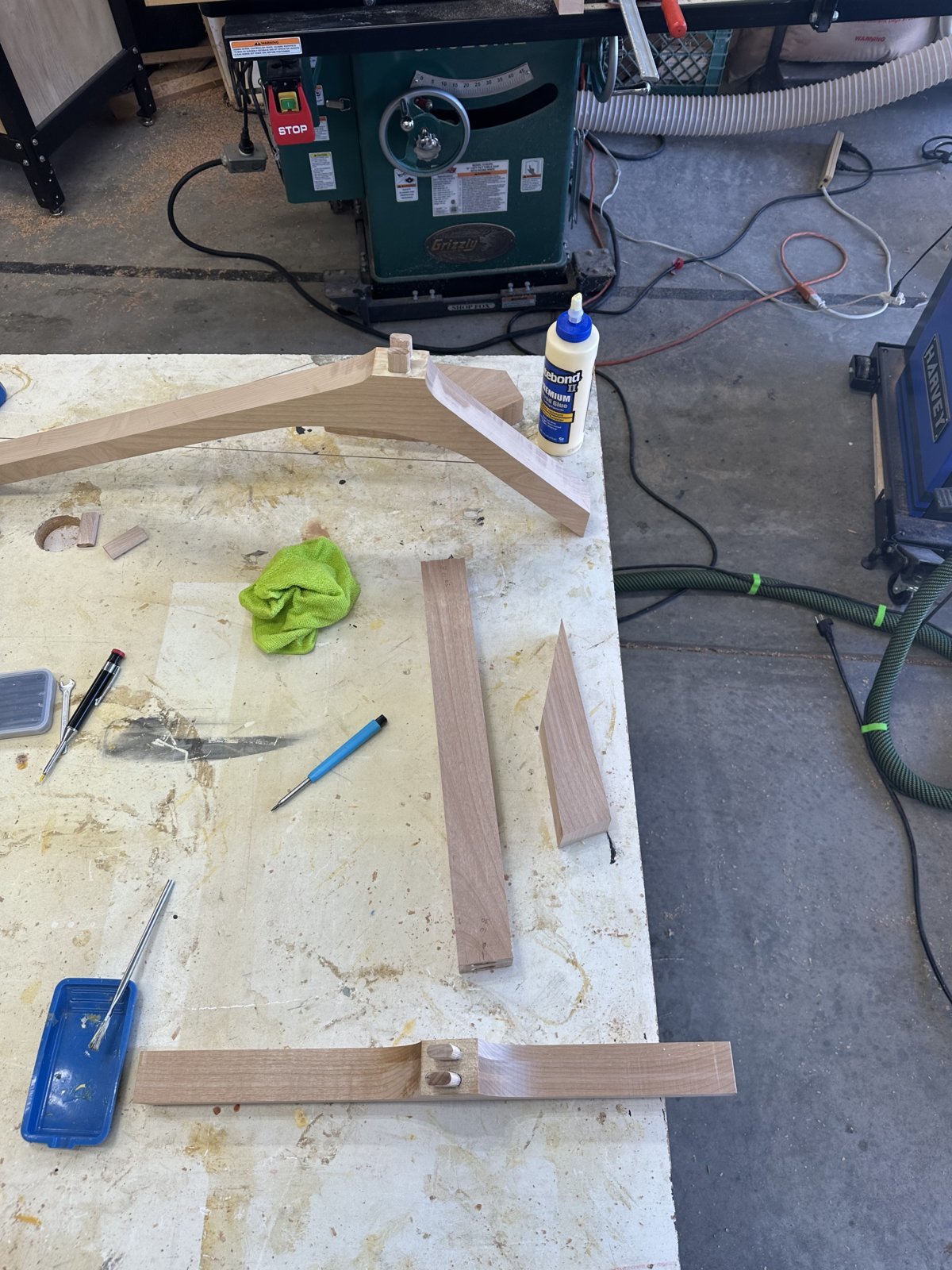

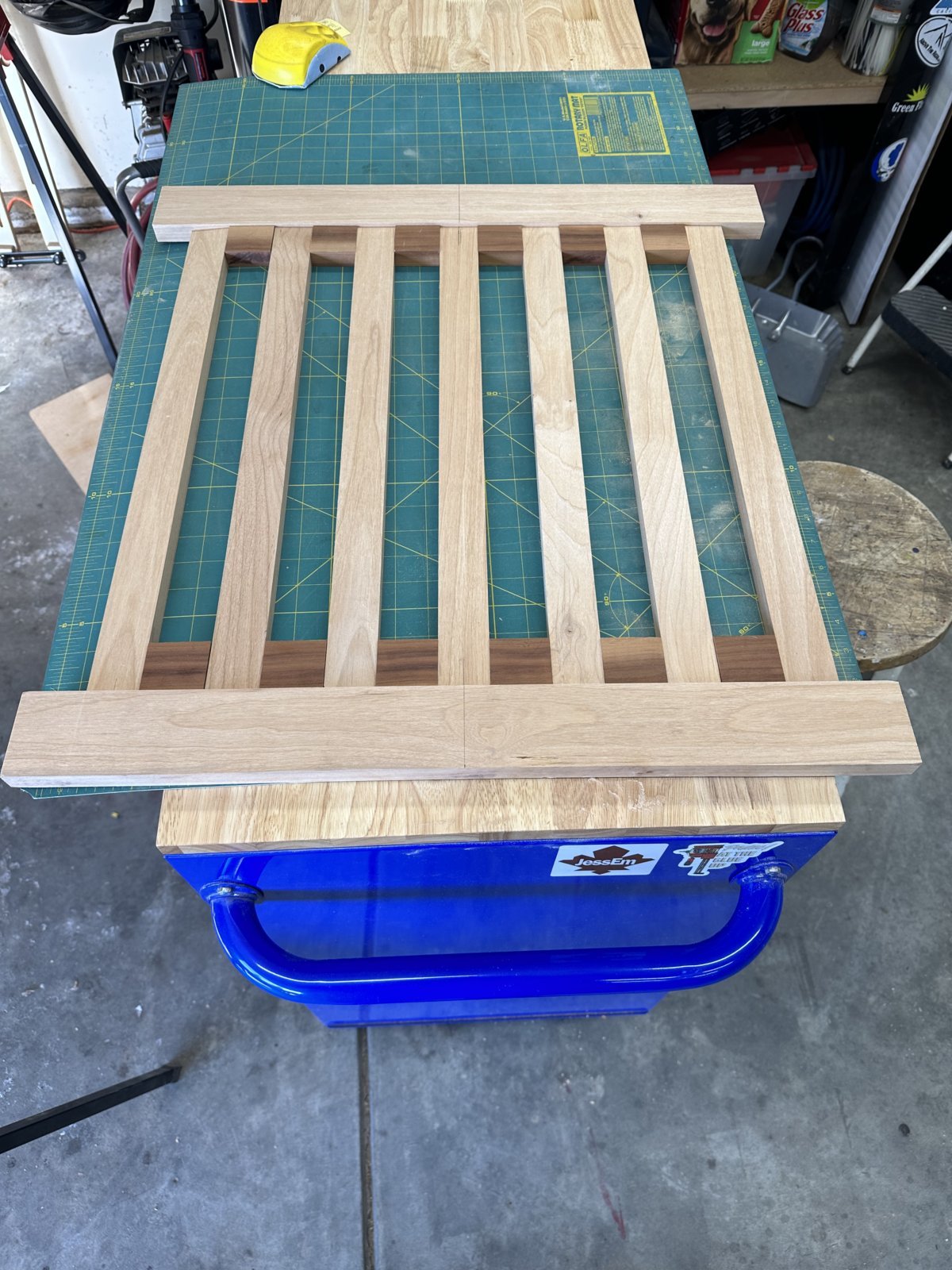

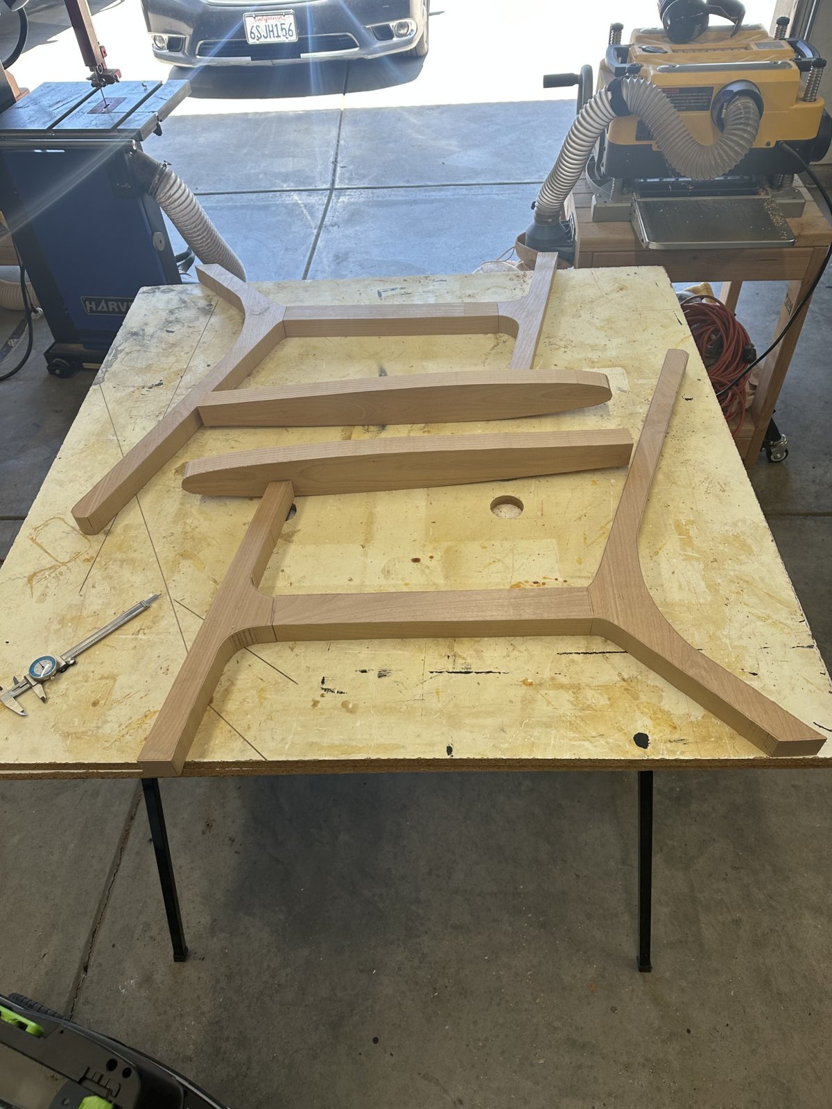

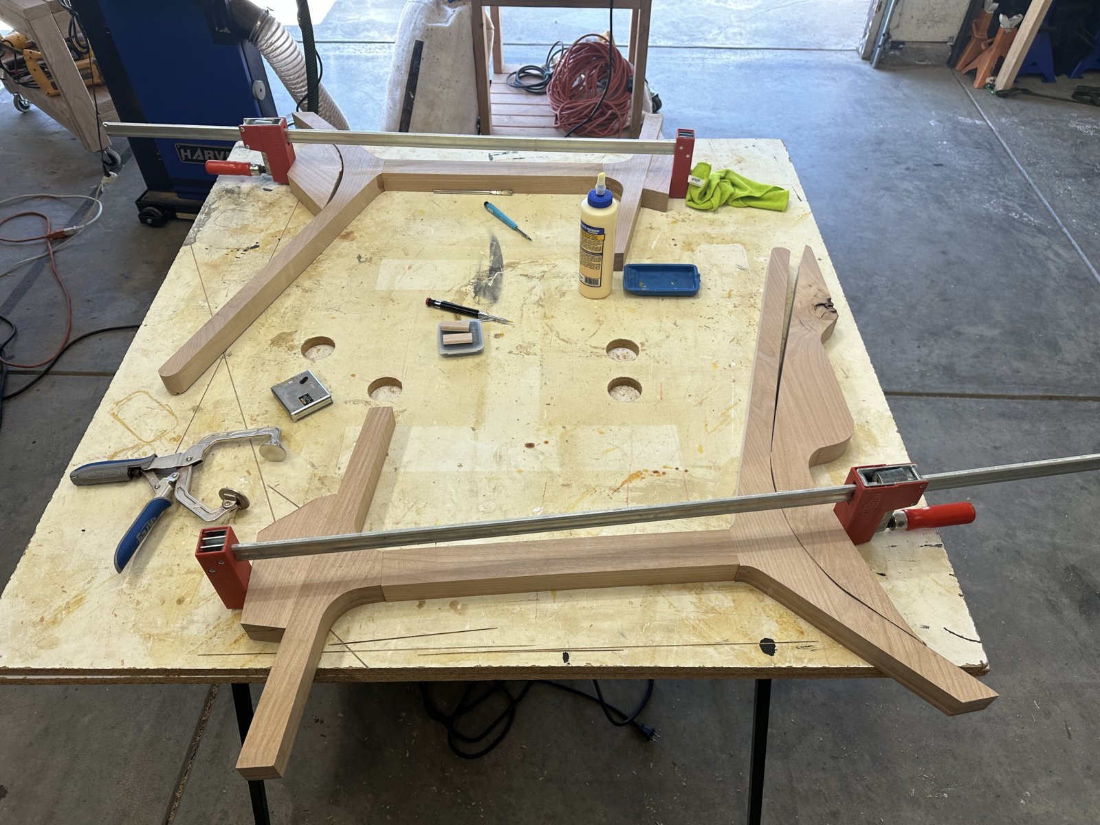

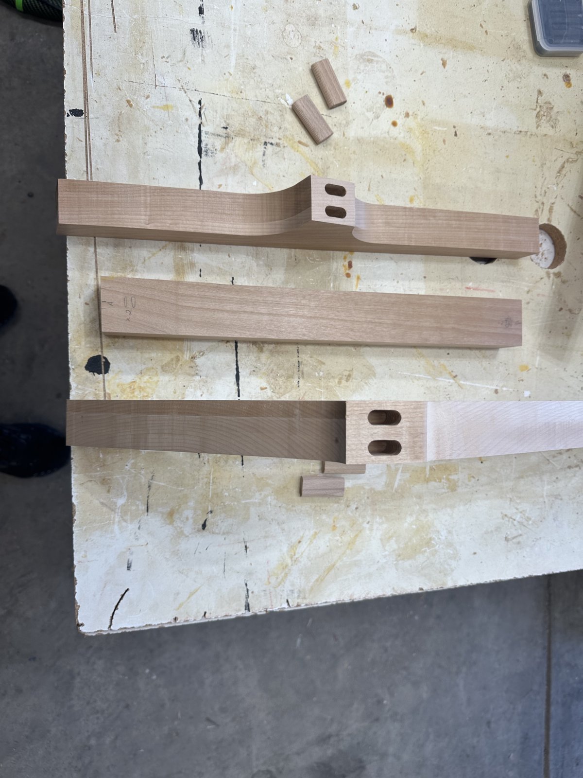

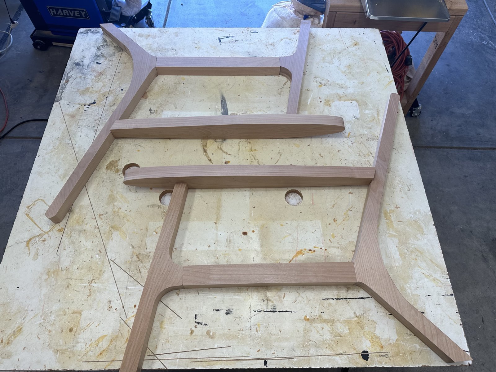

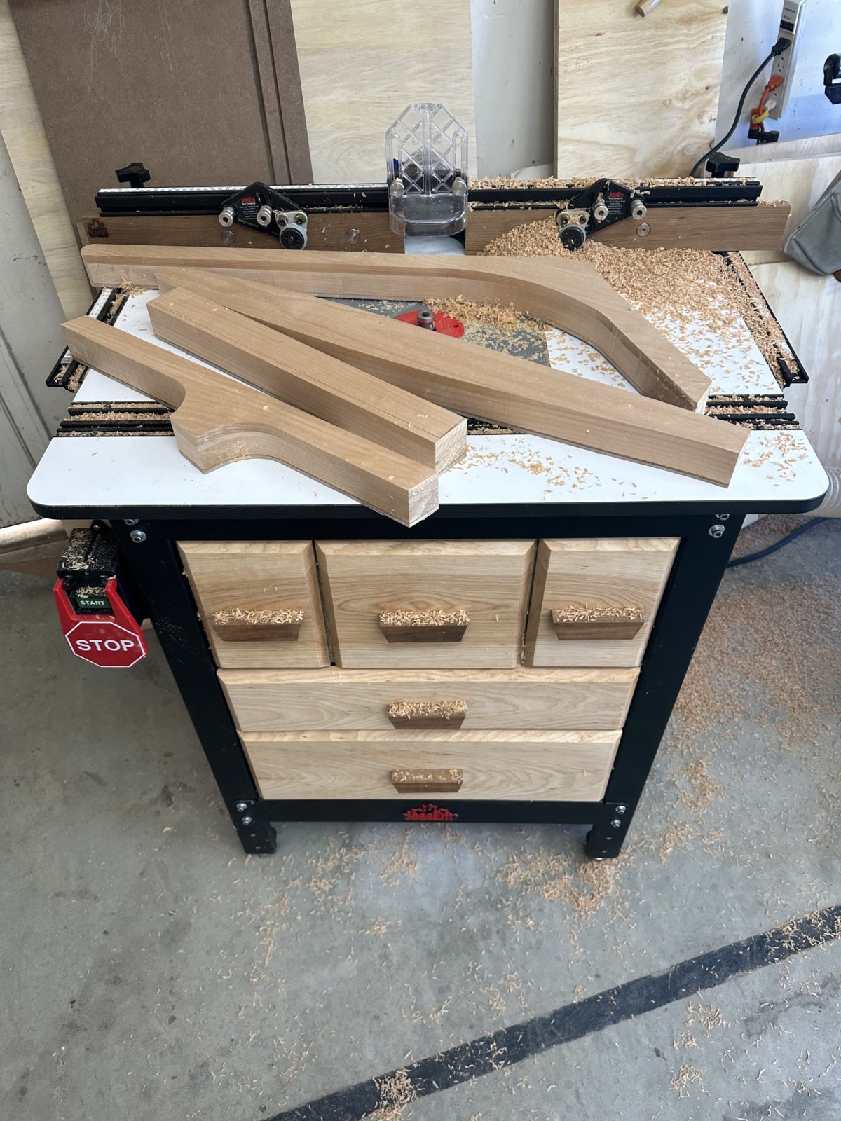

    Progress!
    Layout with templates
    Planed to thickness. Trying to avoid the bad parts of that wide board.
    Rough cut on bandsaw.
    Final shaping with my new compression flush trim bit.
    Need to layout and cut the loose tennons next.
    waiting for glue to dry.
    EC4CA344-0DA3-41E9-881F-A968B1FE1DA3.jpg 8CDCB24B-6D9E-4CA8-814F-8062BA7A5ABC.jpg D5F2236A-B3D3-4DA8-891F-FFCD98A0097D.jpg
    Seat Back pieces cut and layed out. Time for a beer!
