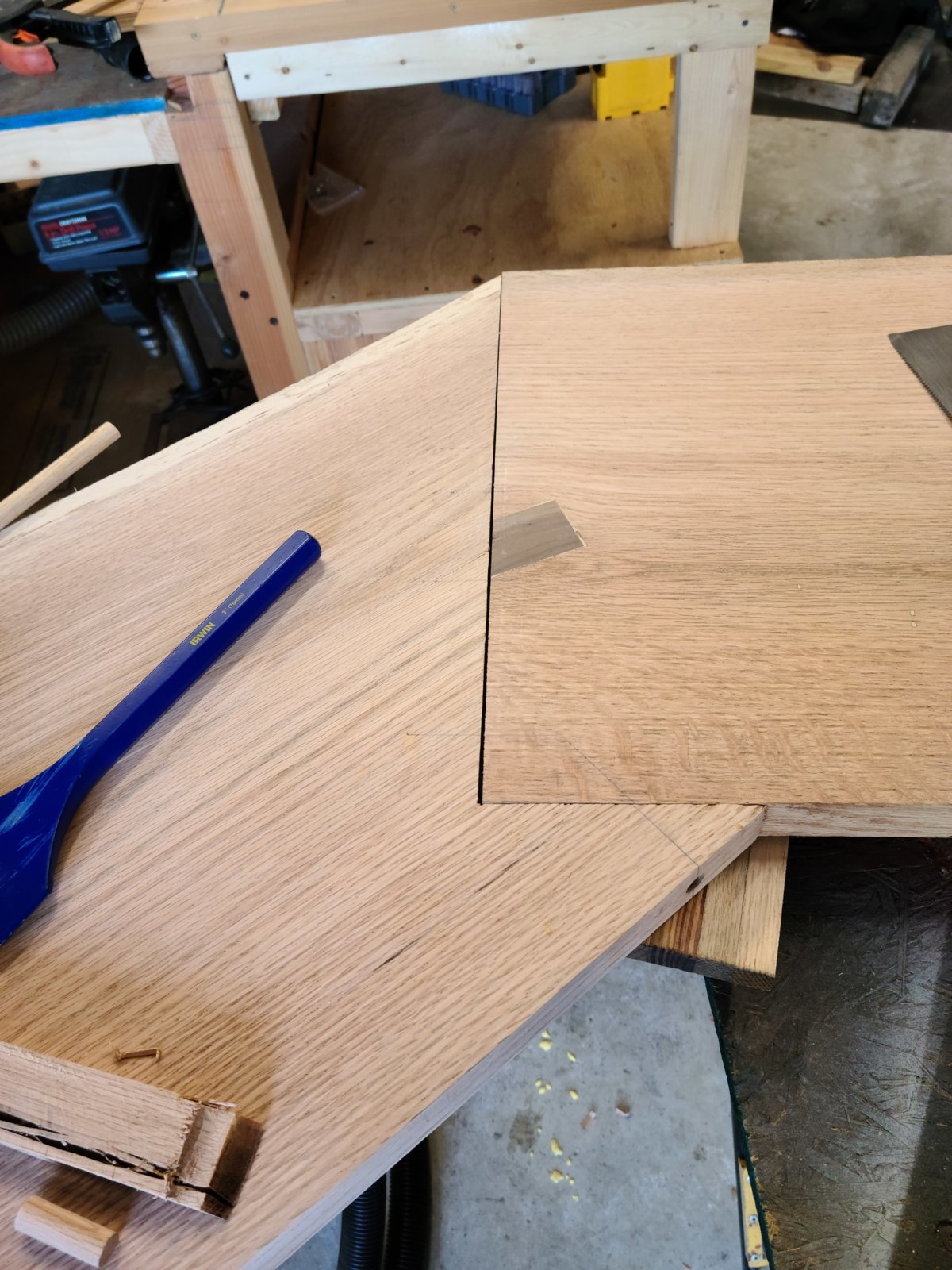

    So my first attempt at gluing this joint failed miserably and I had to pull it apart. I now have clean up to do as I couldn't get all the glue off the surfaces. Ugh.
    Question. I saw a method using cauls (?) glue to painters tape with CA glue. Would this work with the pressure I have to apply to pull the joint tight? I'm trying to avoid using metal fasteners and really don't want to.pocket screw from the bottom. Unfortunately the outside edge is live and not a good fit for making and gluing blocks on to square up the clamps.
    Ideas? Links?

    Do you have the edge doweled at the long part of that piece?
    Id make 4 90° brackets carpet tape them down on opposite sides of the long section on both sides of the project, then clamp those down then pinch the 90° brackets together. If that makes sense

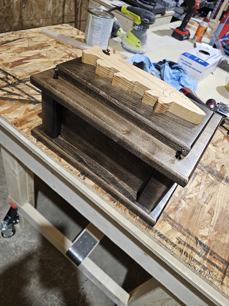

    Finished it up today. Damn tag is off center so I may pull it and redo it. But for now, it’s done enough to make it to my office tomorrow :(

    There are 4 half inch oak dowels. There were five, but even with the dowel jig one was way off. I'm starting to think I may have a pinch point in the corner. On the dry fit one of the dowels was about 1/8th inch too long, so I double checked all if them and don't think that's an issue.
    I tried something similar with 2x4s, but no tape and couldn't get enough pressure on the 2x4s to keep them in place. I'll give the tape a try and maybe plane the surface of the 2x4s to get better adhesion.

    I can cover the distance with clamps, it stopping the slide up as I close them. No square angles to grab.

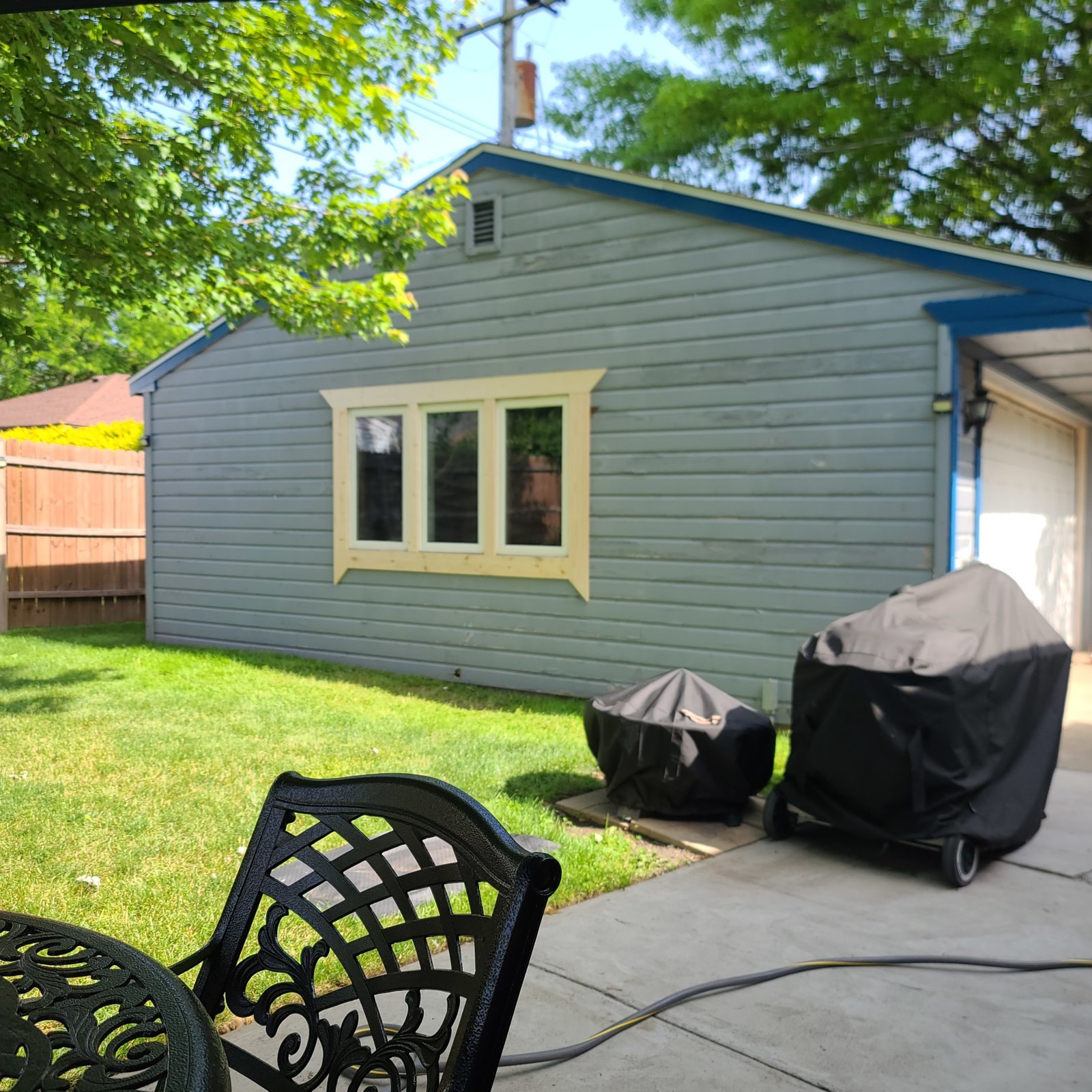

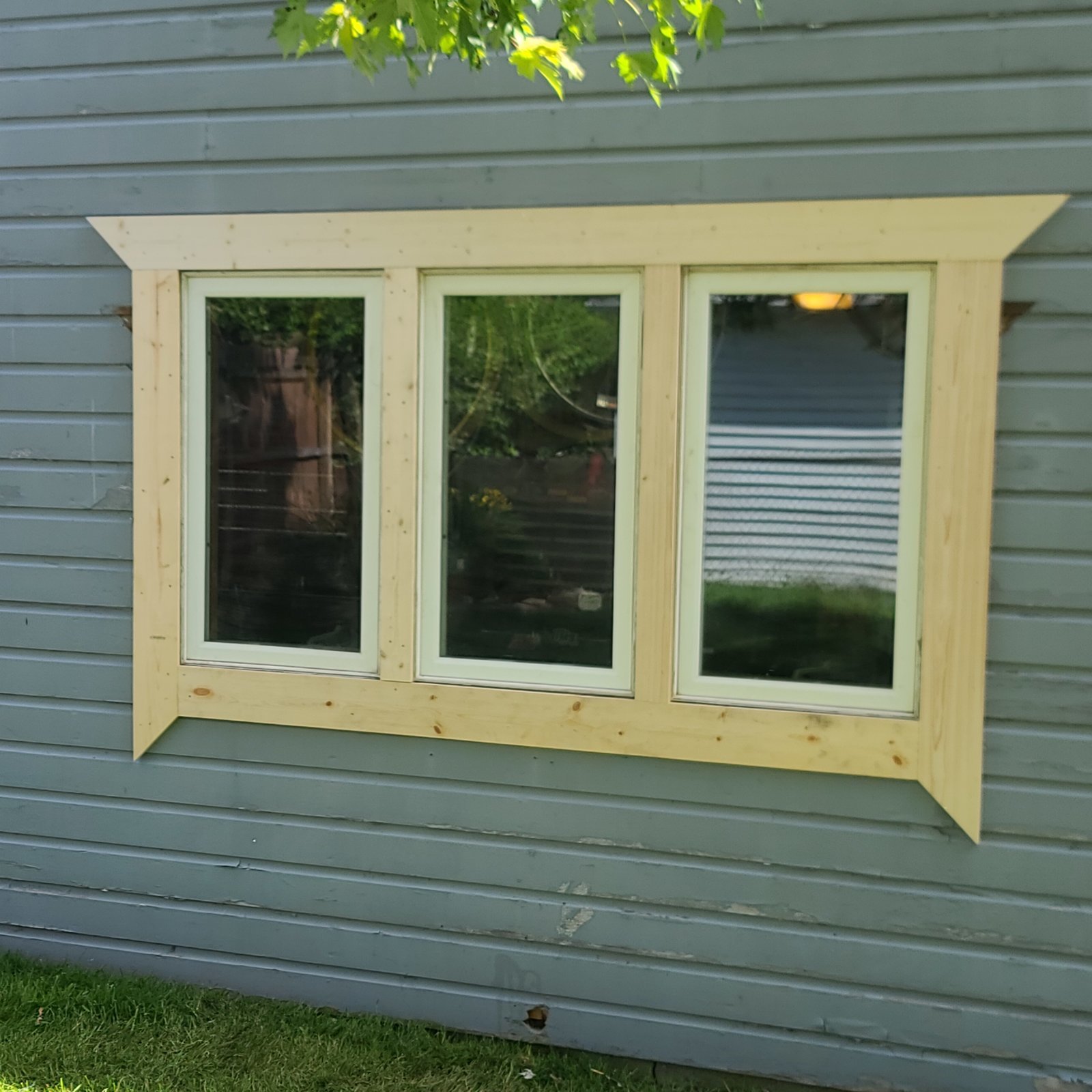

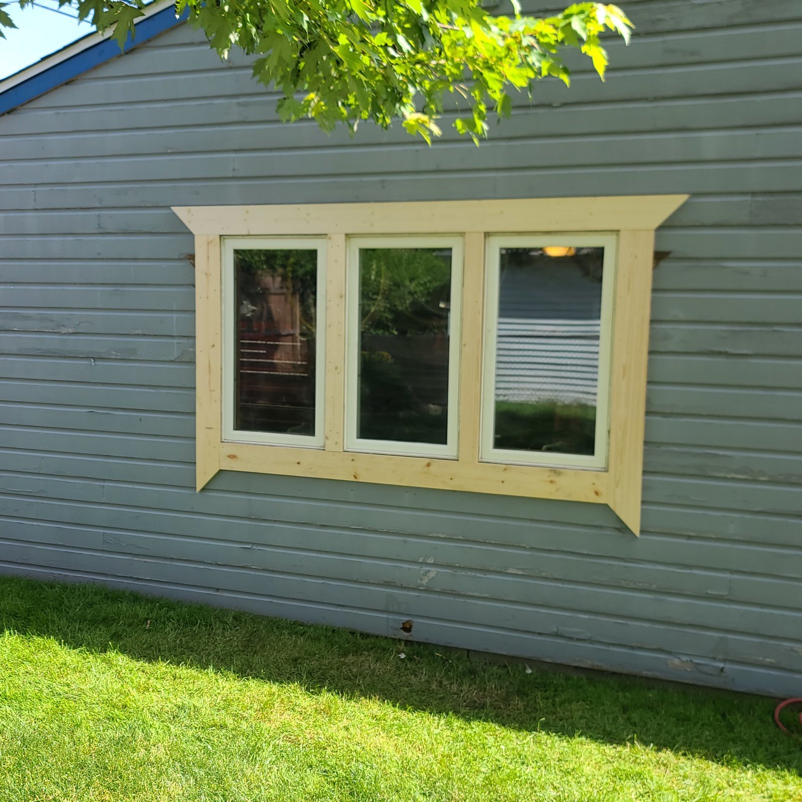

    Well I got the trim done today. Next is caulk and paint. I still need to reattach the electrical boxes on the inside. I got one up but I need to extend the wires for the second one. Then I need to make a workbench again.
    I did my own thing with the trim. Not traditional but I like it.

    I actually dig the 45 hanging off the bottom two sides. Looks kinda menacing! Don’t know a better way to describe it so don’t judge my choice of a descriptive word

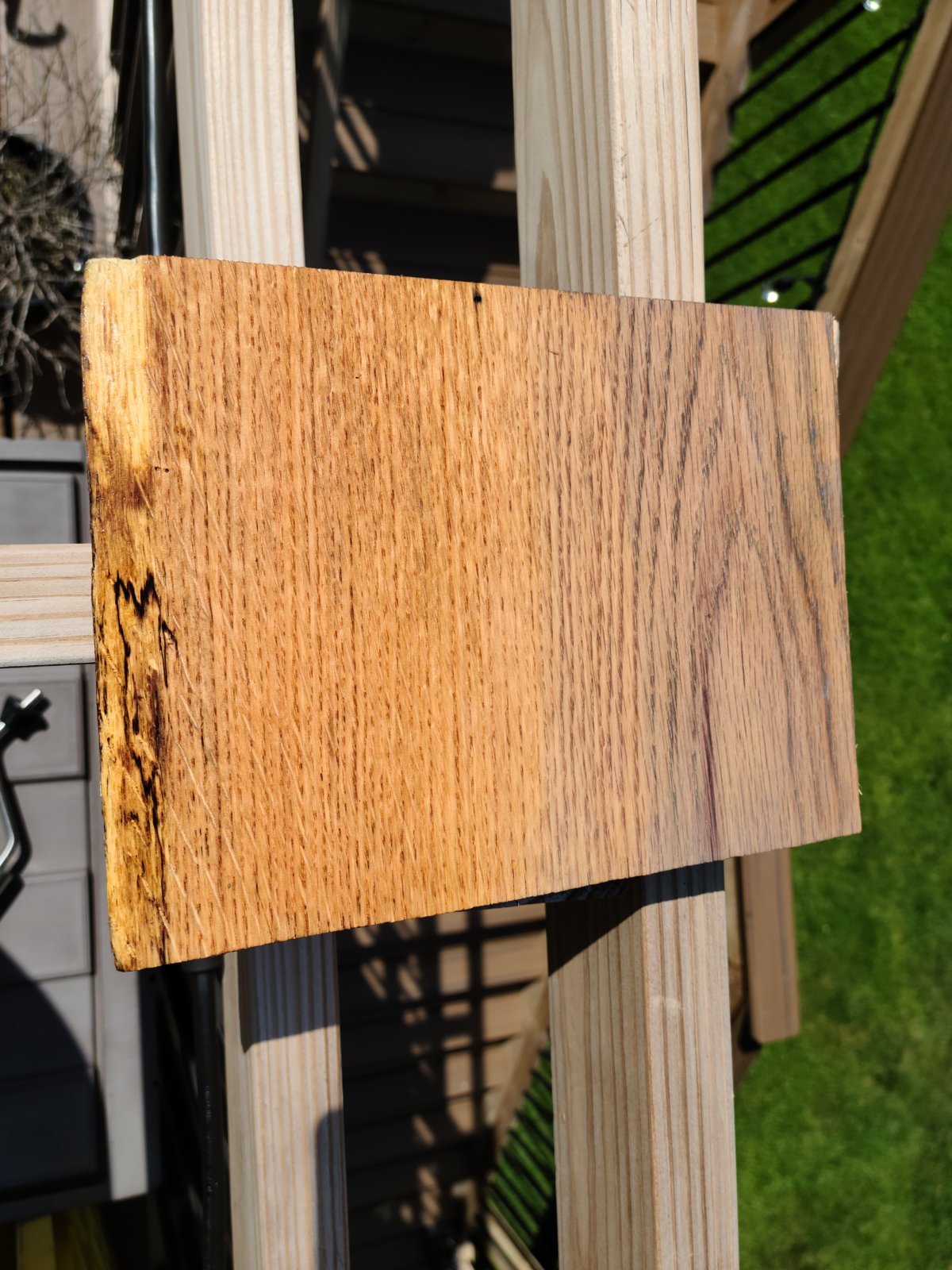

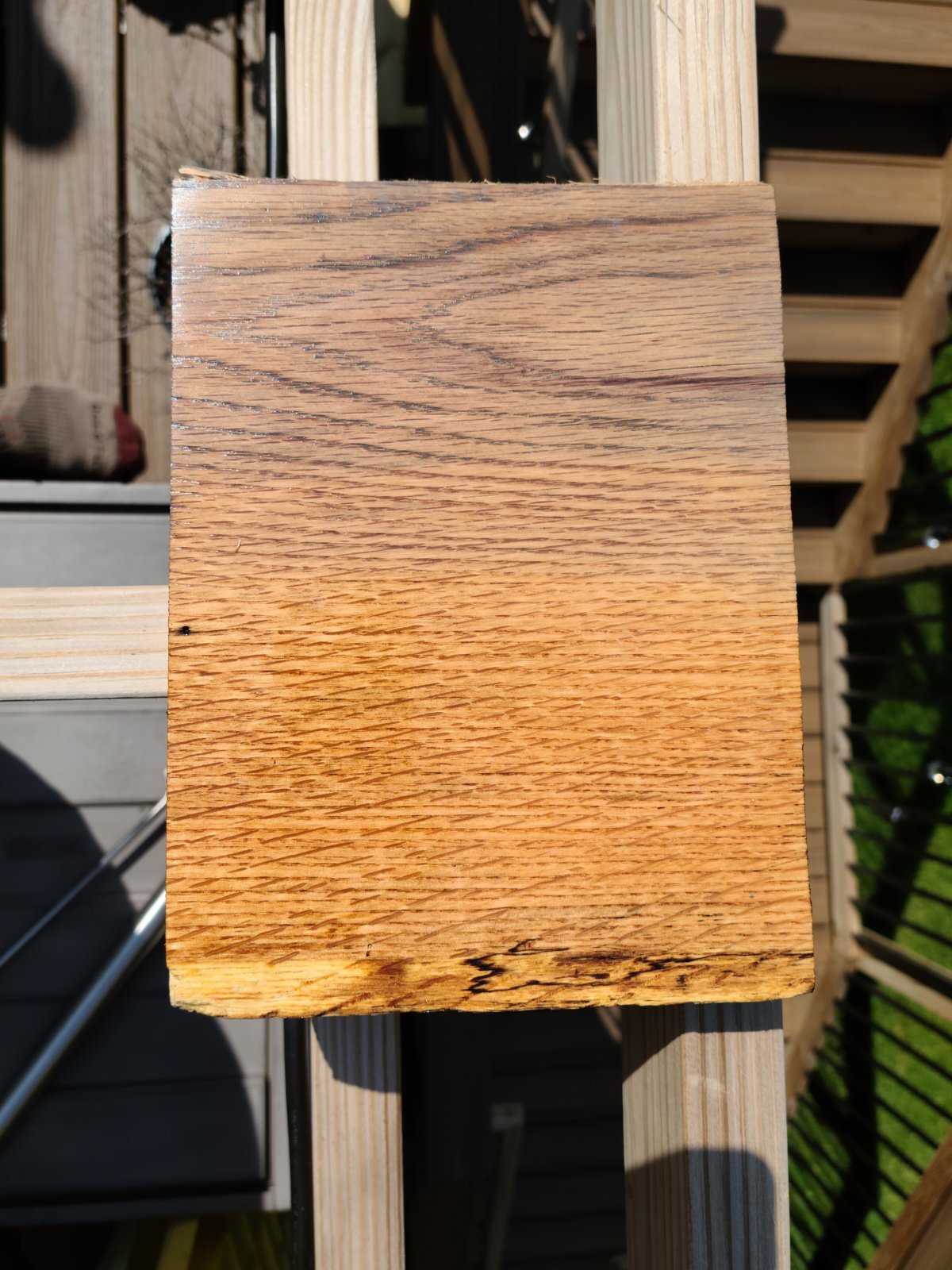

    Tomorrow I tackle the bar top glue removal, and still trying to figure out the best approach to pull the corner together. A plan is appearing through the fog, so we'll see what develops.
    I have figured out how I'm going to finish it. Marine grade varnish from Total Boat. Two step process with a varnish primer base and a satin varnish finish. The mistakes made will show, but does a nice job bringing out the grain and has UV protection. And it seems to have stabilized the live edge portion, although I haven't put any force to it.
    The "red" side is the route I'm going. Other stuff was two other tests.
