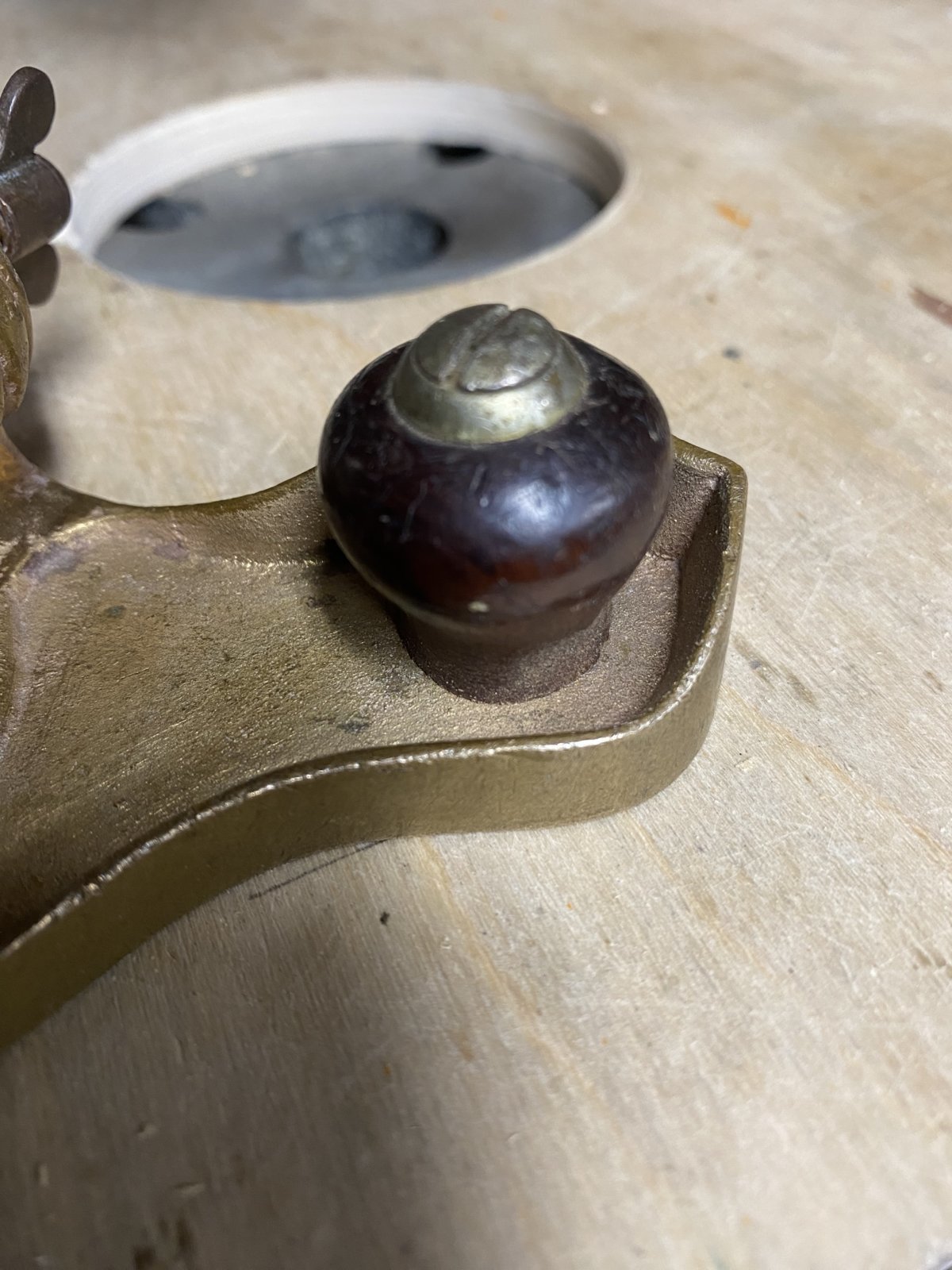

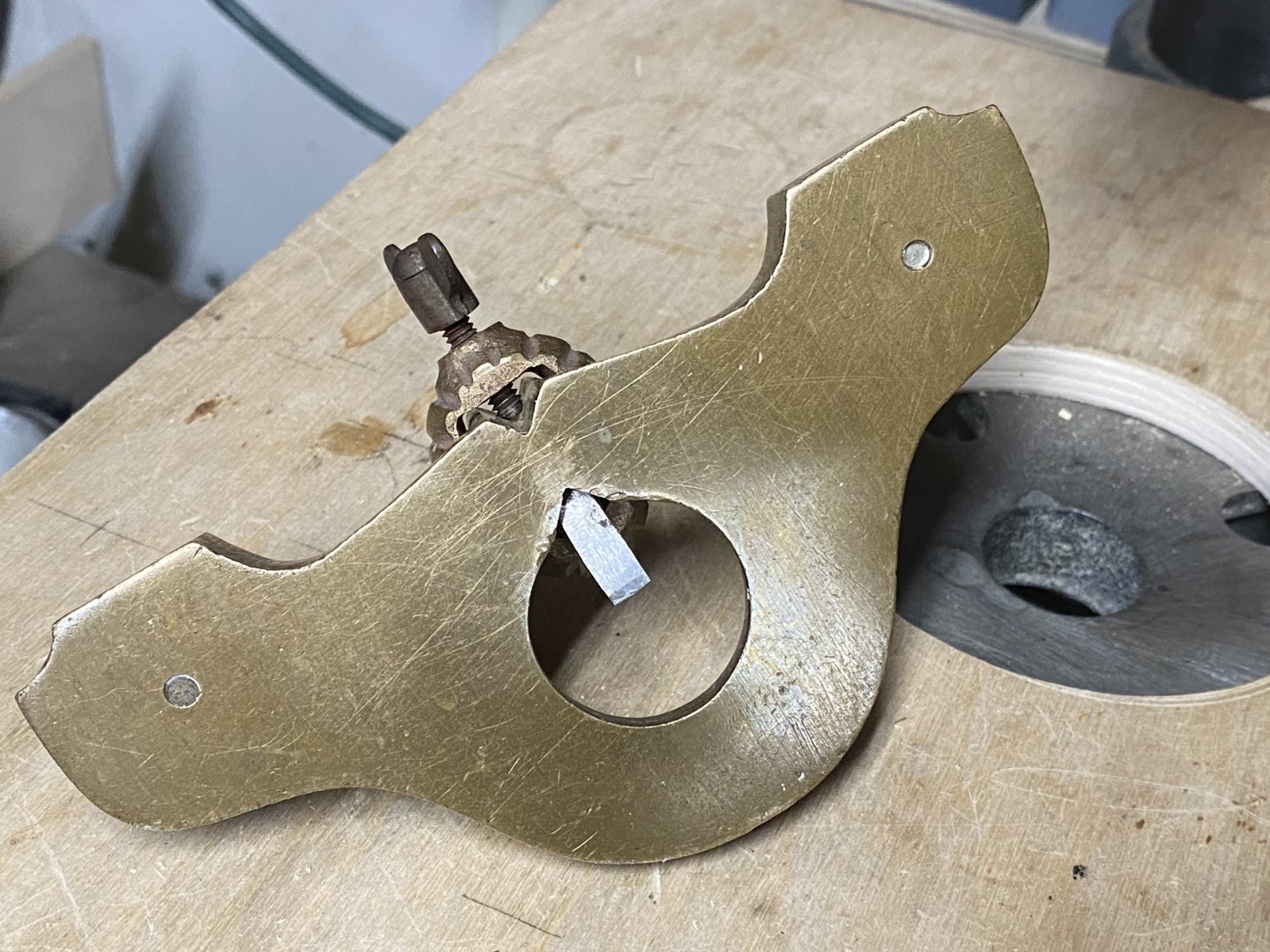

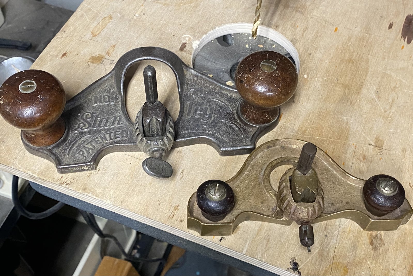

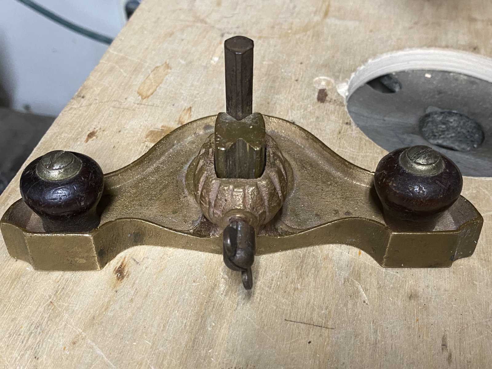

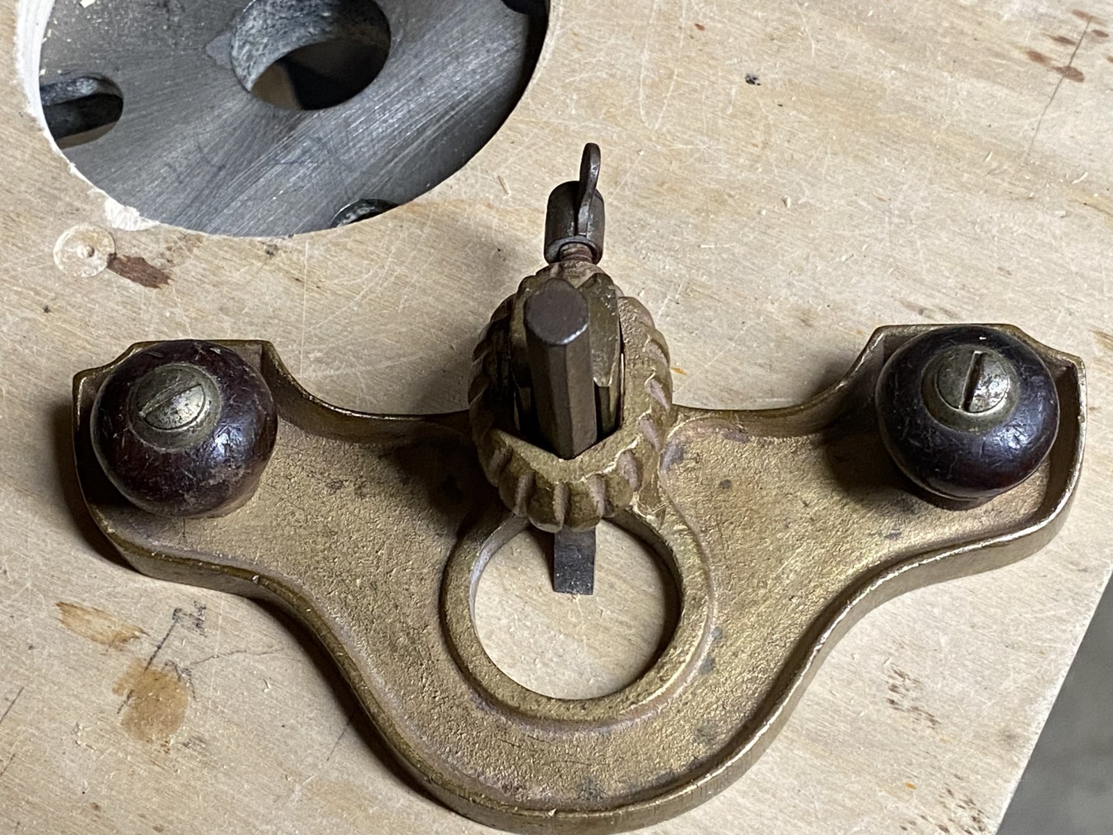

    I think that is a Stanley #55 molding plane, I think. Awesome tool

    I dont get any results with that search. Closeset thing is Stanley #71 router plane but its marked/embossed all over top.

    Stanley #71 ?

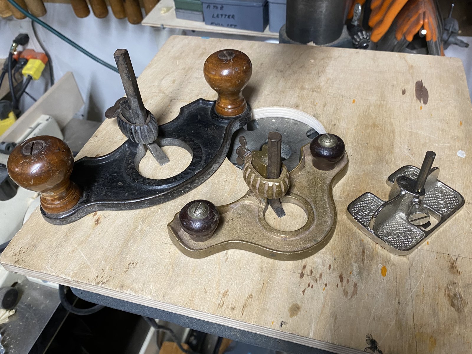

    It’s definitely a router plane, not a Stanley as Stanley was proud of there name, here’s a Stanley no 71 as reference pat’d March 4 84 (1884) the one of brass I’ve just never seen one like this or this size, just very interesting to me

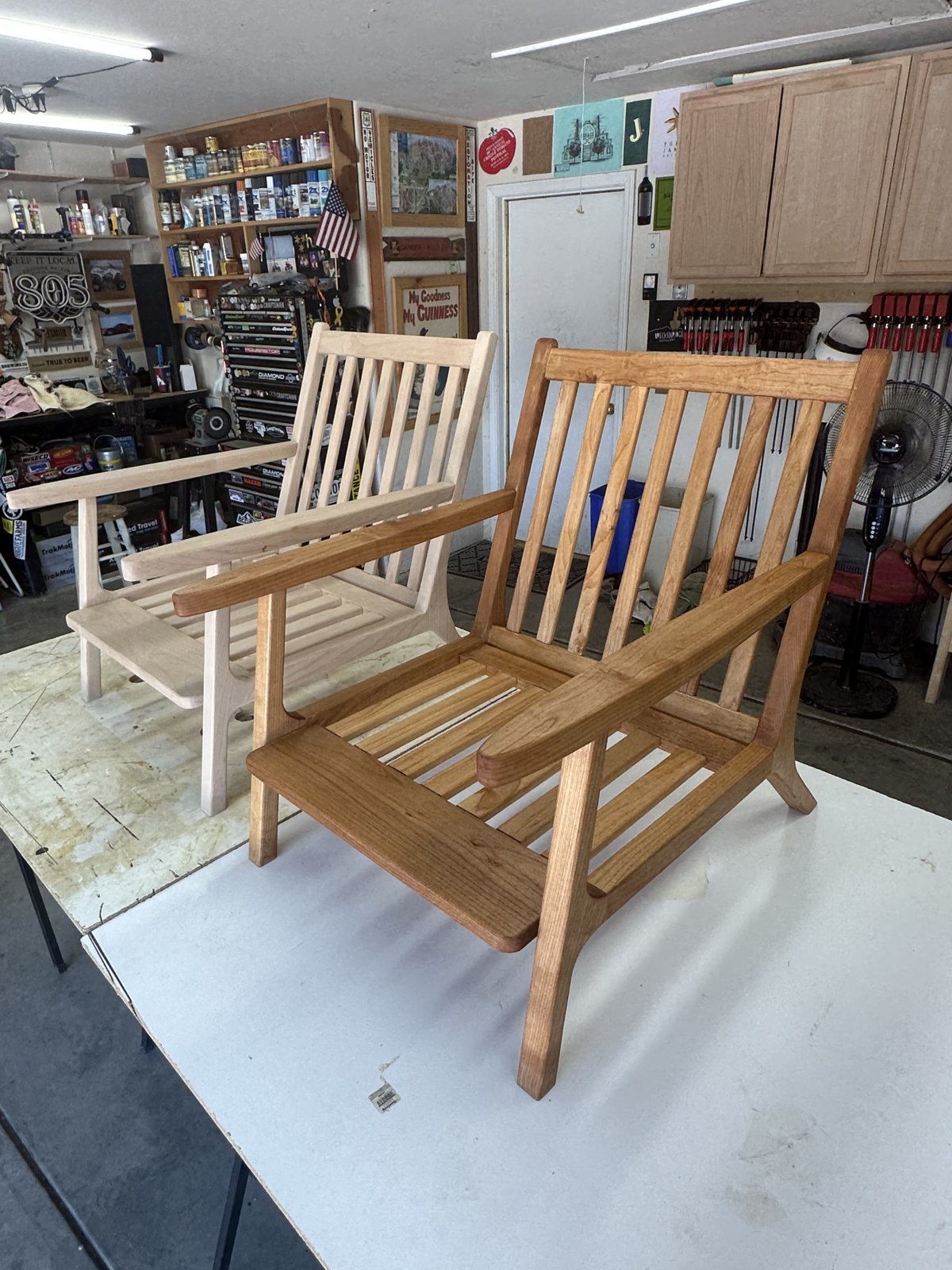

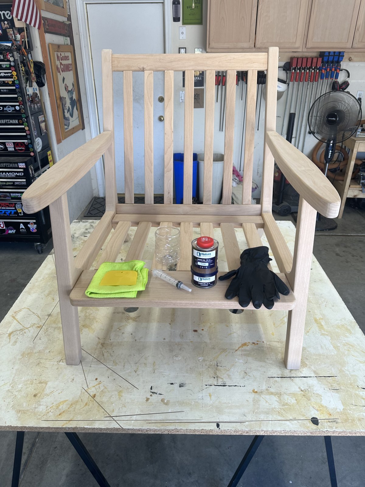

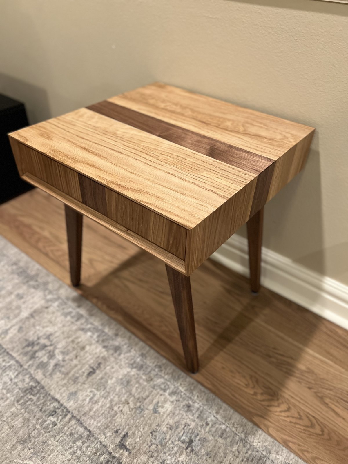

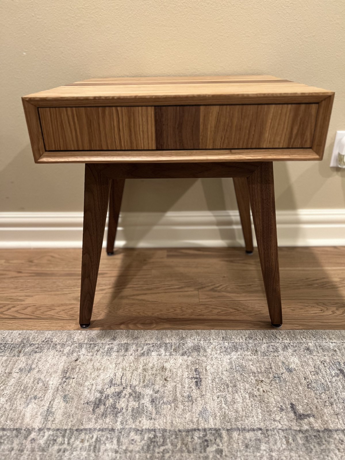

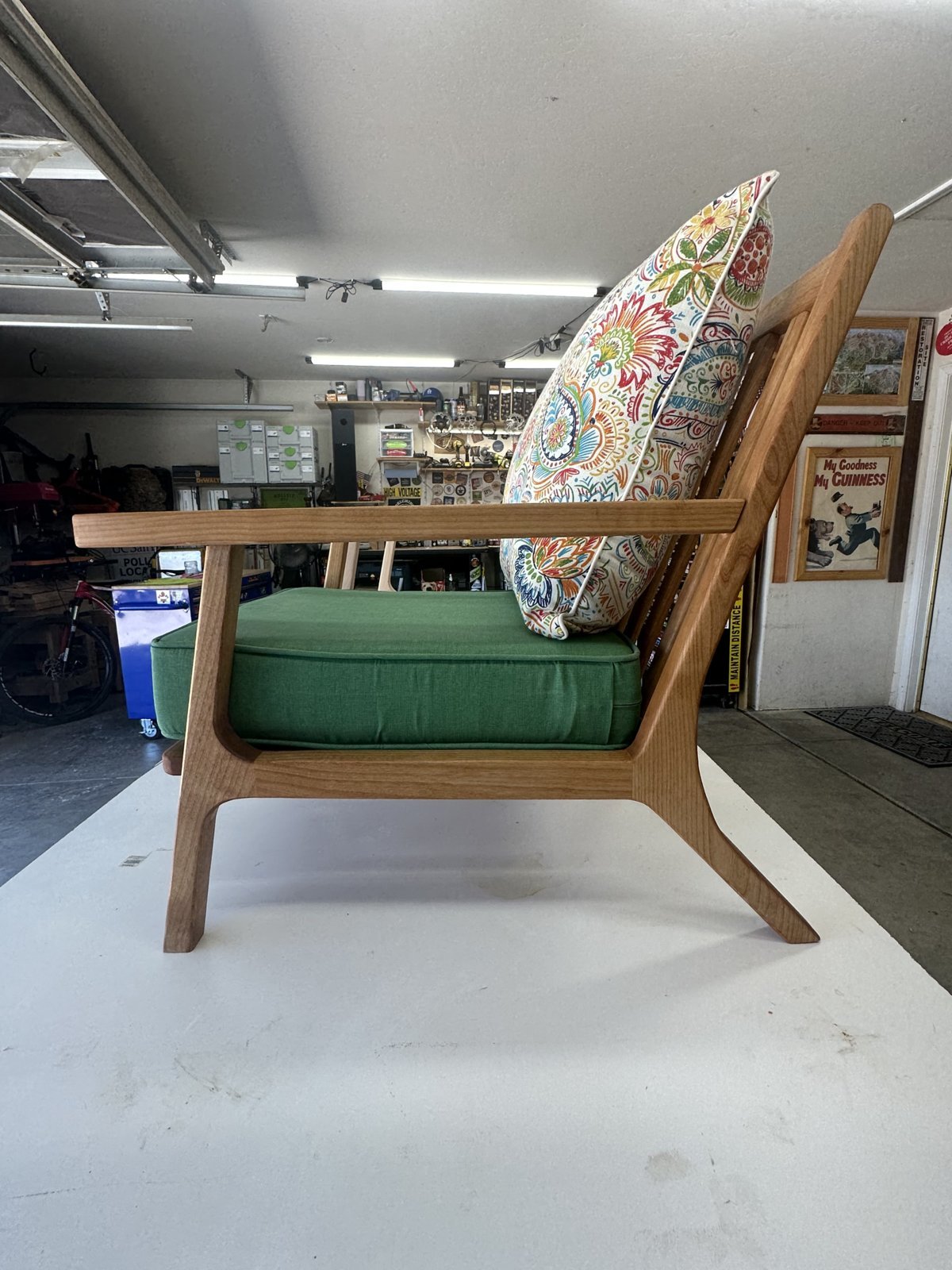

    I've been using Natura one coat as well. Its like Rubio but with a normalish price tag. Love that stuff.

    Beautiful work

    Thank you!

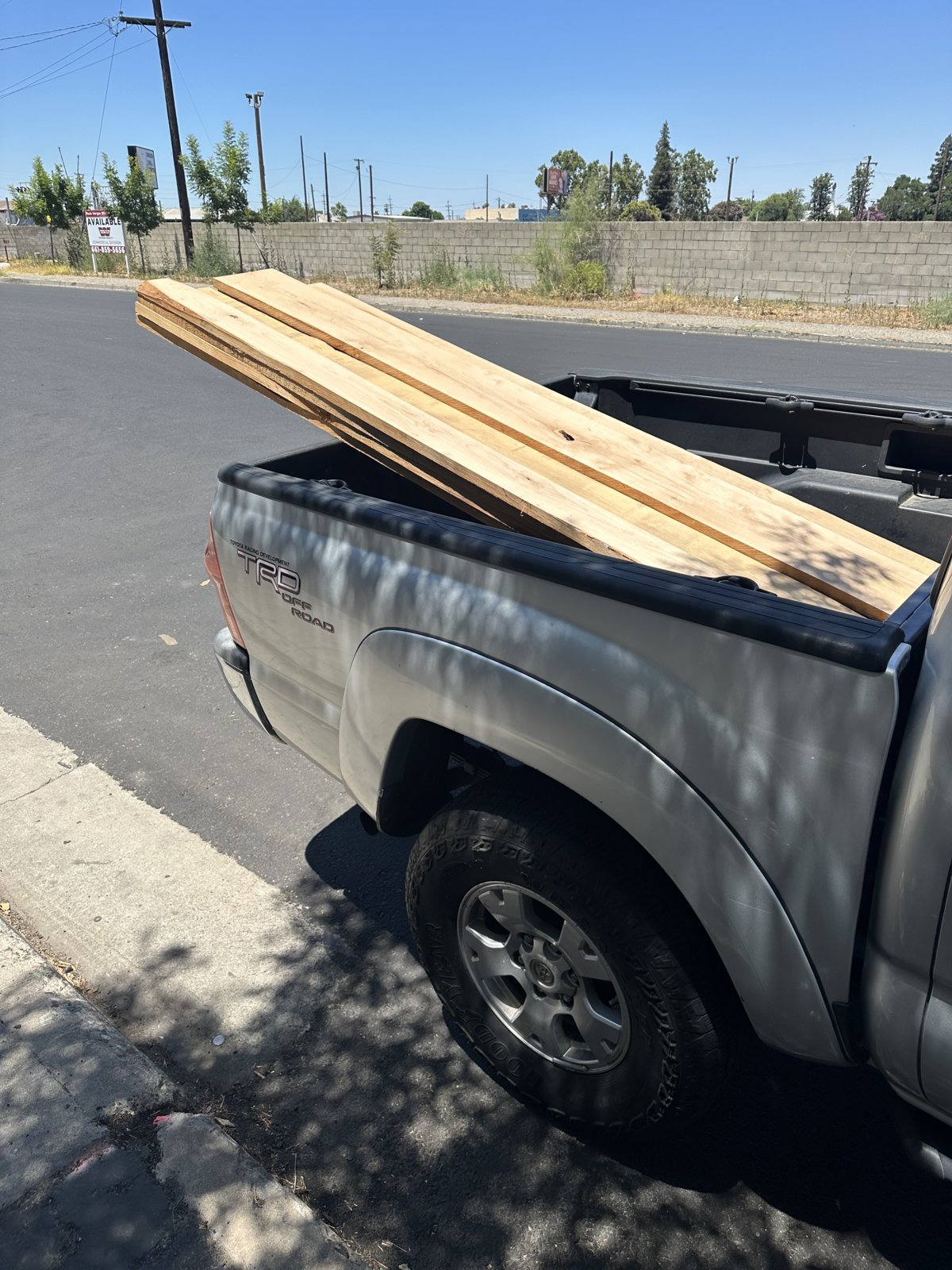

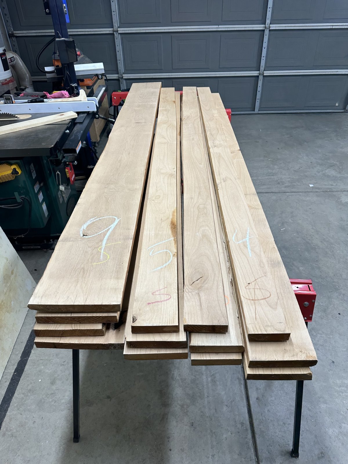

    79 Board Feet of 5/4 Alder
    Materials for the next project.
    Long and low TV Console Table.

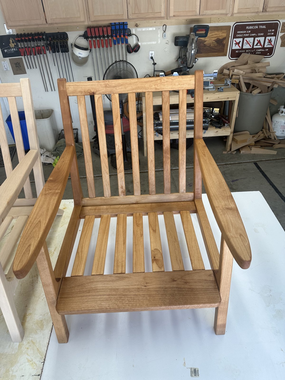

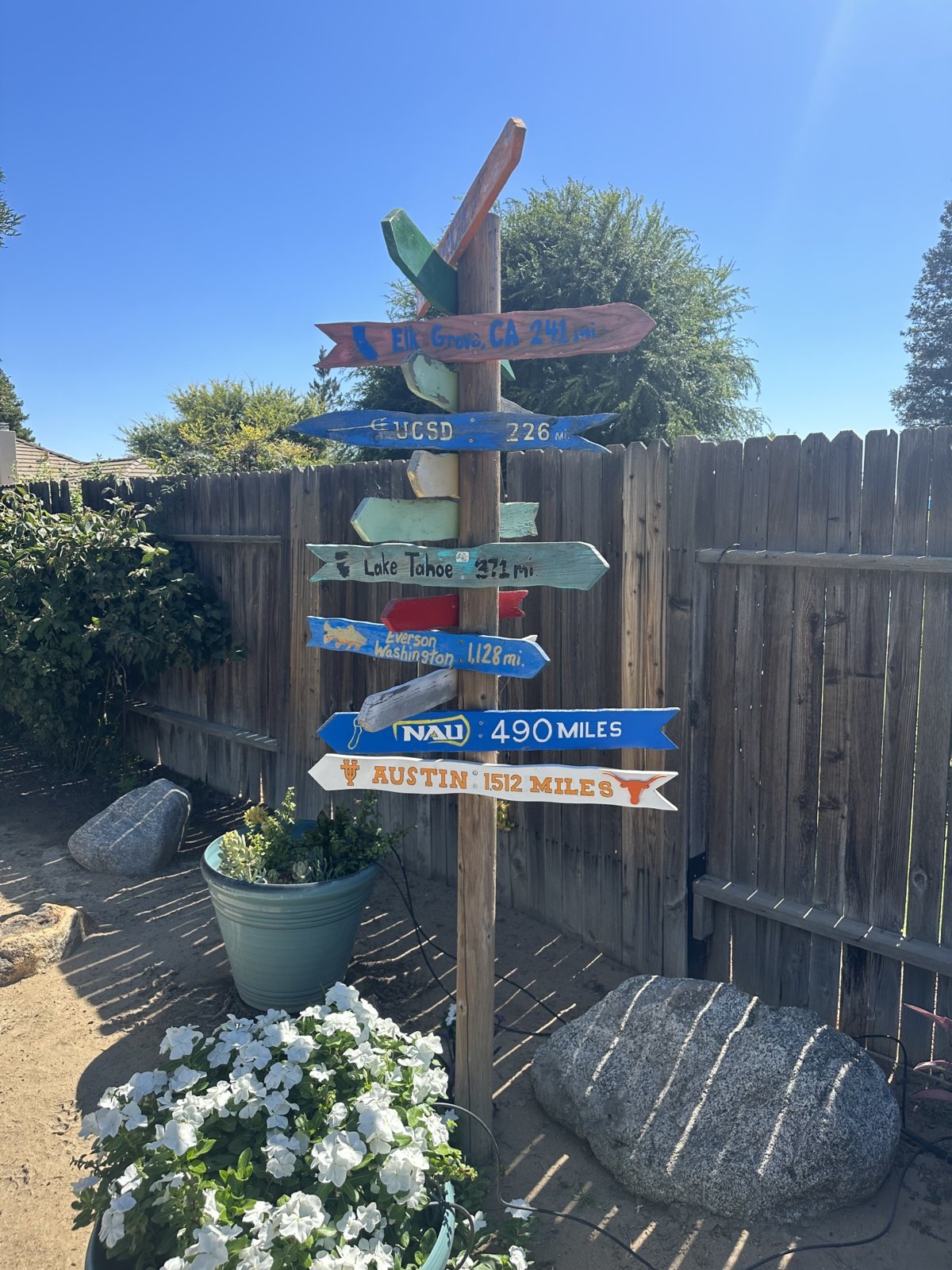

    New addition to our backyard destination post. Moving my son to Austin in a week for UT Grad School.
    These are always fun projects

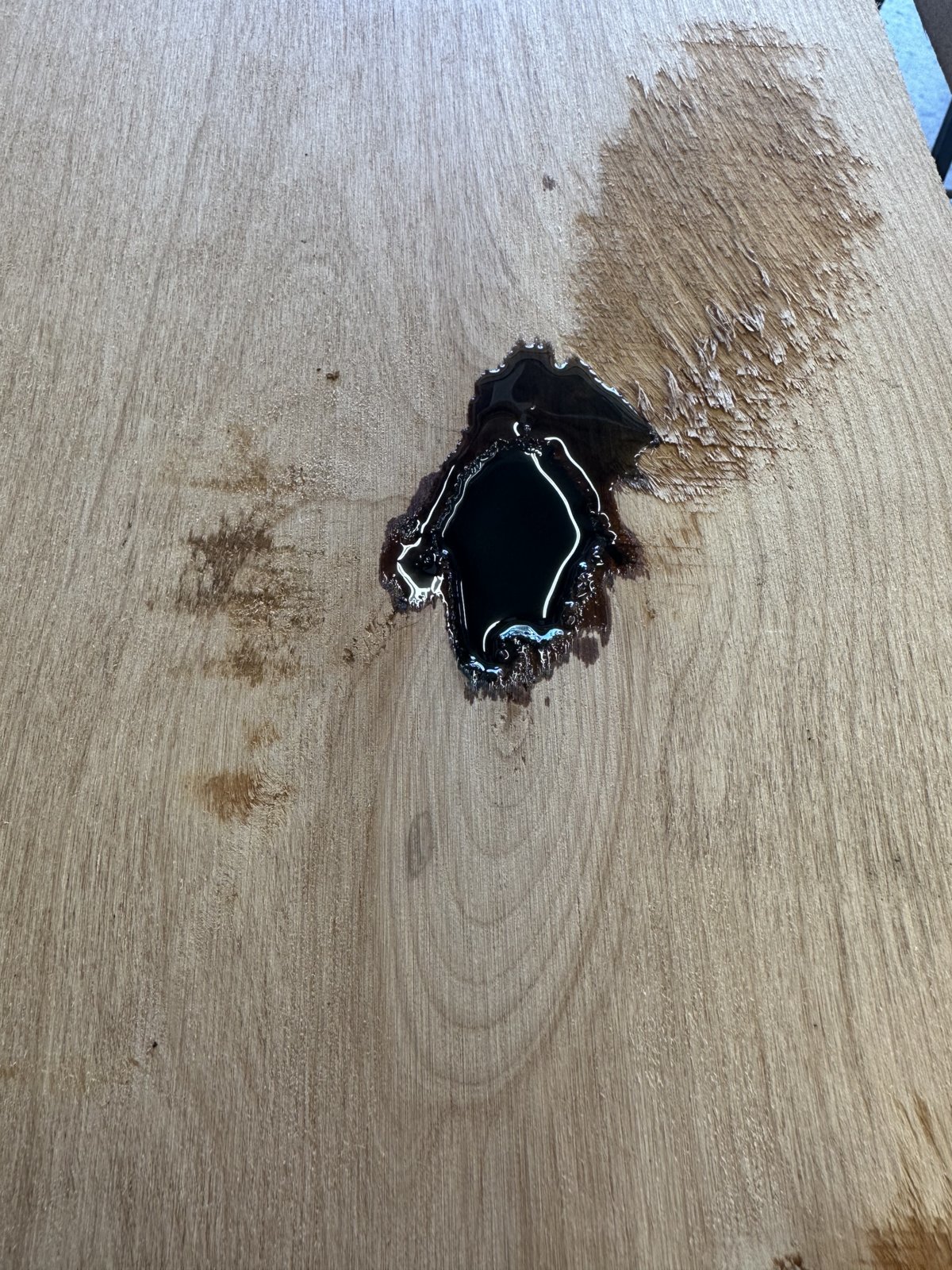

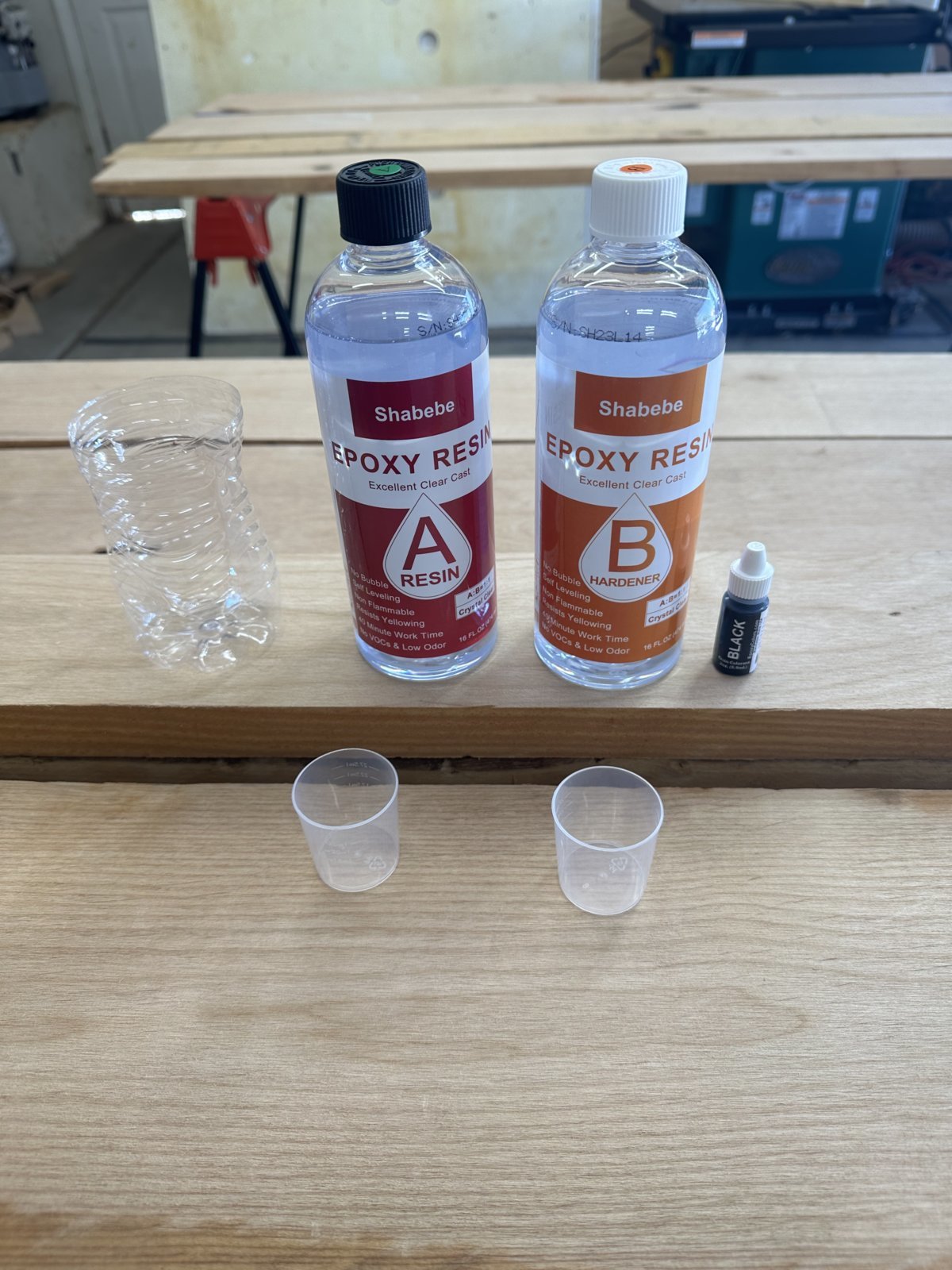

    Then I filled knot holes with black epoxy resin. I hate that stuff!

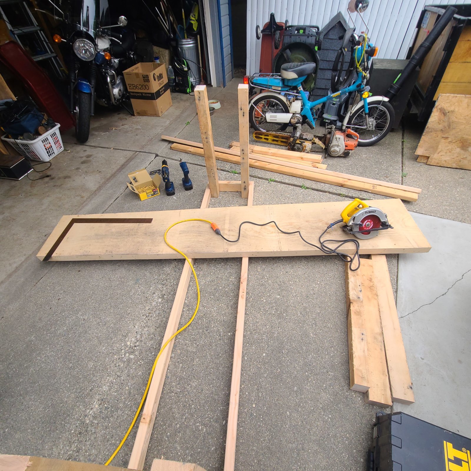

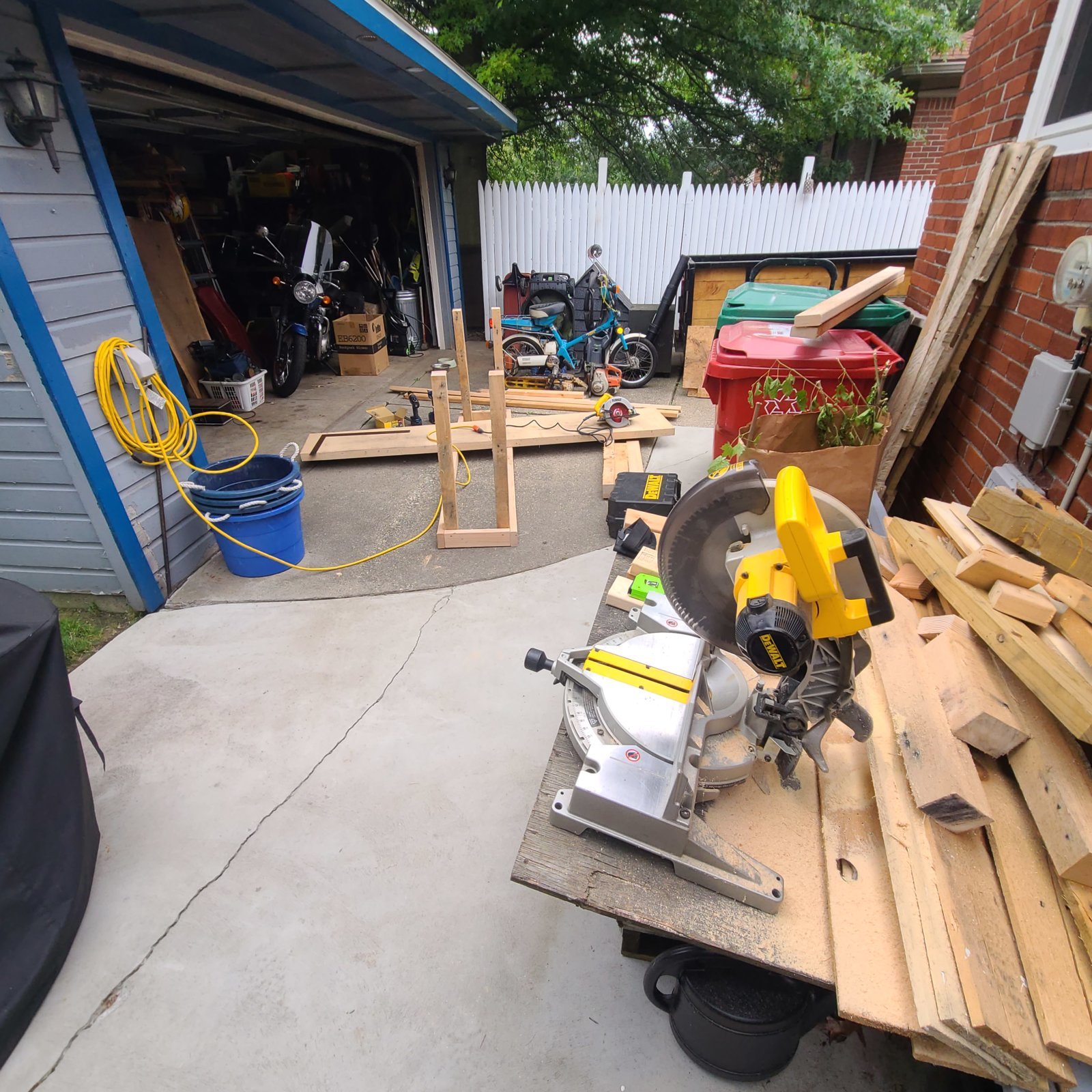

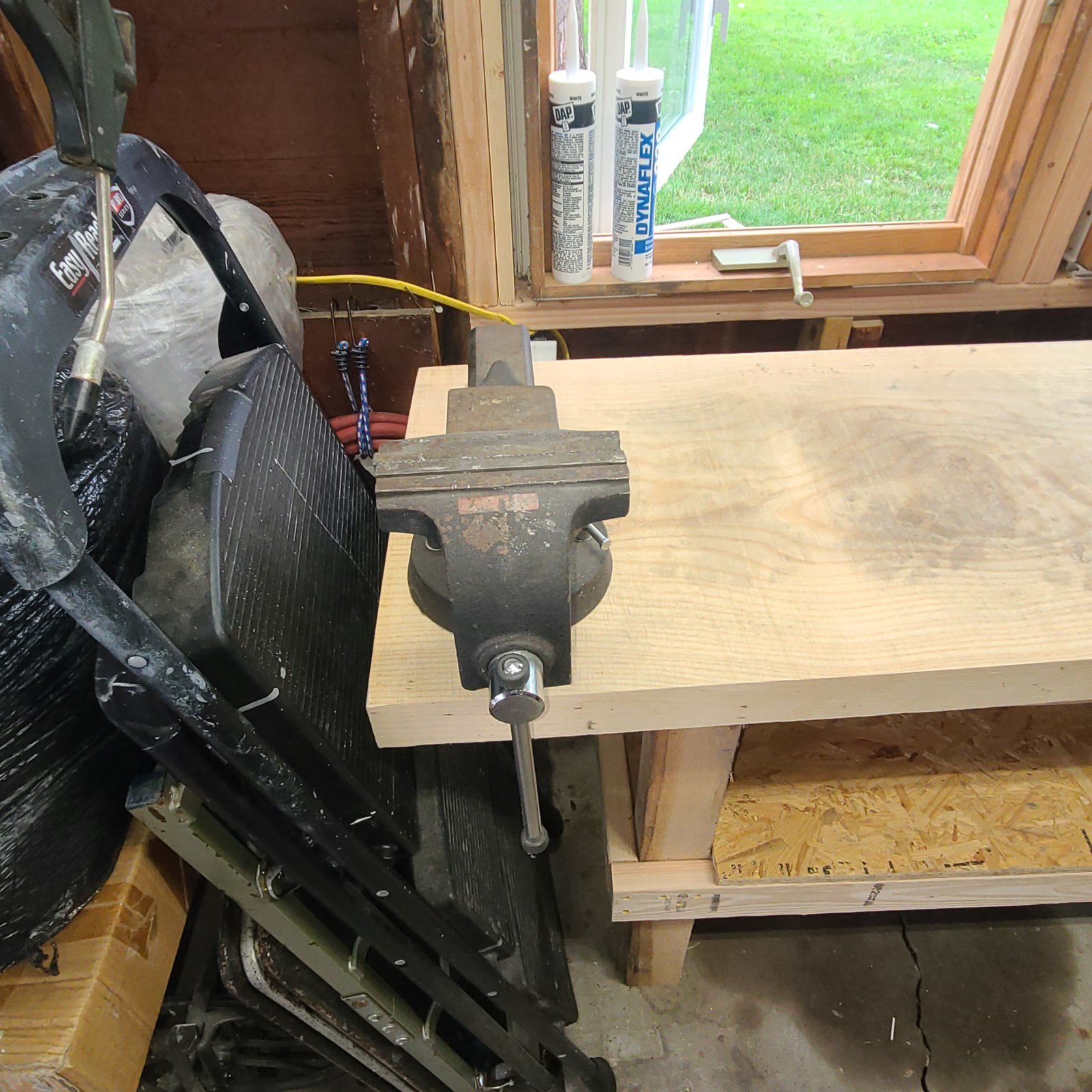

    Not fine wood working but a needed project for my garage makeover. It was my 4th of July project.
    Started with a bunch of salvaged materials and a solid 2" thick ash slab that I milled. It's my last ash slab, it's all gone here now.
    It's going to be a narrow bench at 16" but that's what the slab gives me and I really don't have room for more depth.
    I was going to cut the top down but decided to leave it long and overhang. It will have a middle shelf to store crap on.

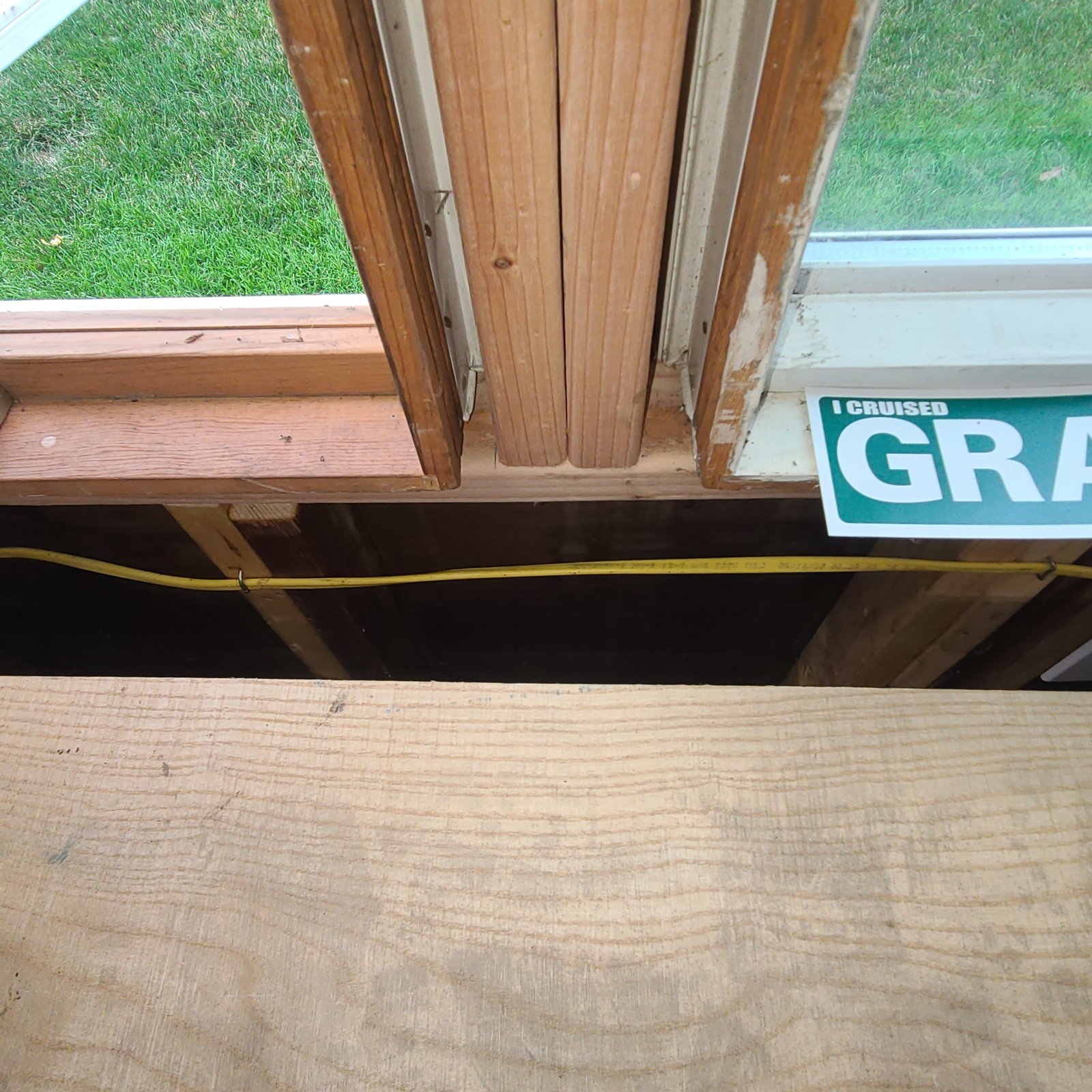

    Set in place but not permanently. I'm going to attach a can tray on the back side.
    The can tray will close the gap.

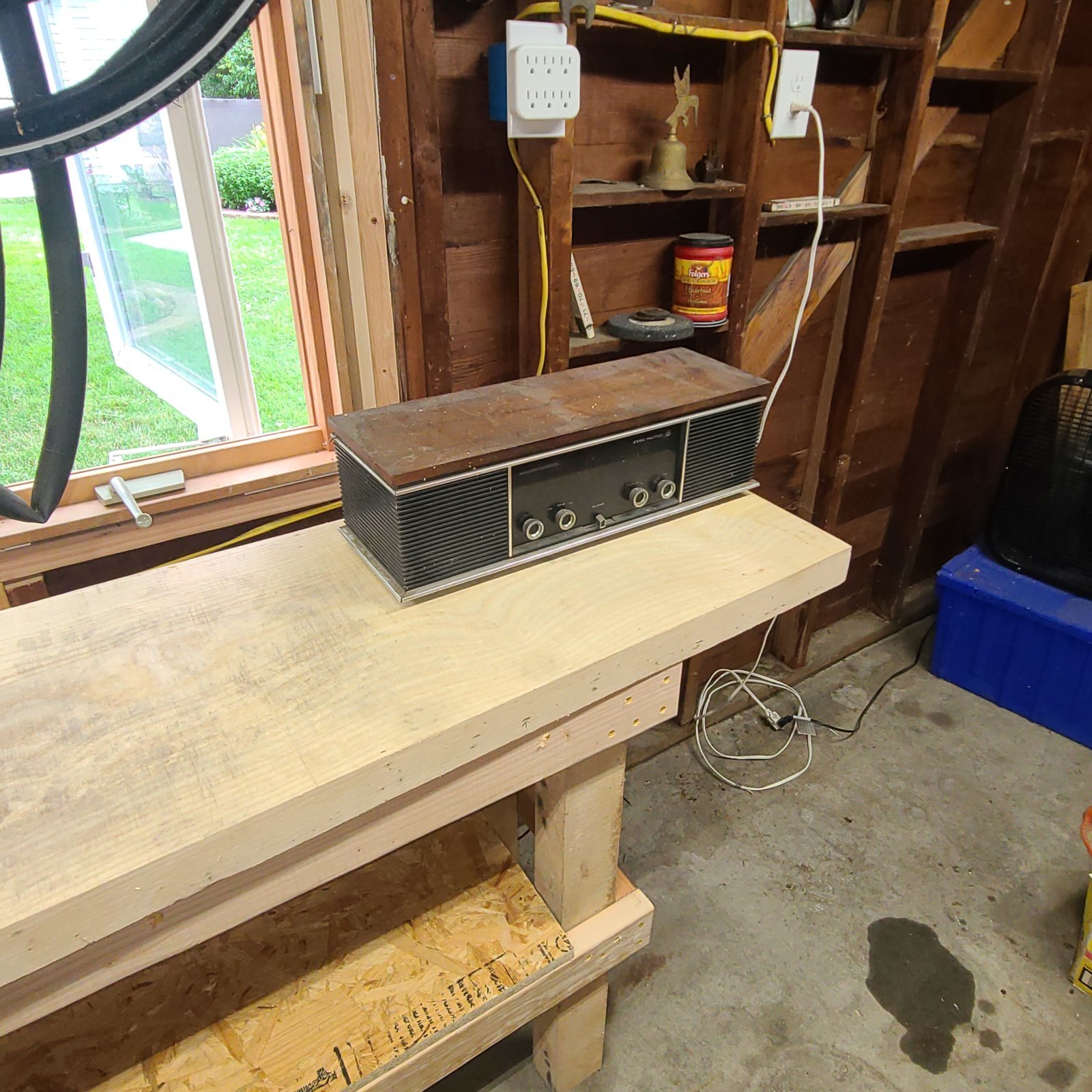

    Gotta have tunes.
    Vise will go on the left end.
    The top will get rough sanded and some kind of finish applied just to seal it. It's a mechanic bench so nothing fancy like my wood shop bench will get.

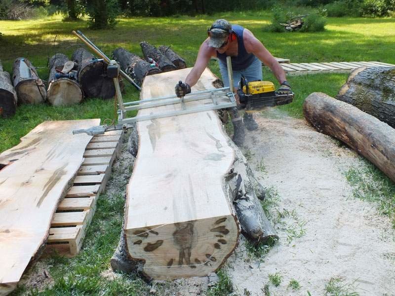

    That's one heck of an ash slab! I had to glue together 2 pieces to make 18 inches wide and thought those 2 pieces were big.

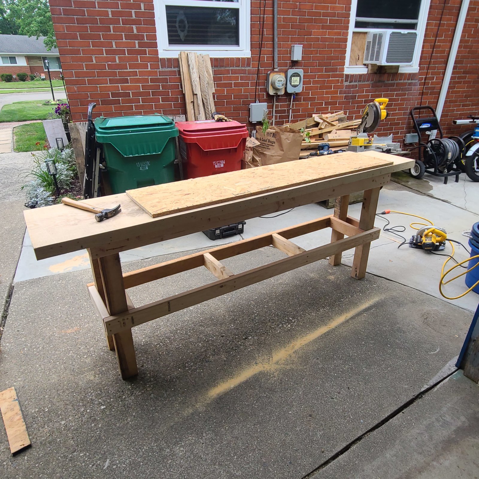

    My 15 ft desk is 2x4s topped with 1/2 in plywood (and a few 2x4s horizontally under the top for extra support). 3 parts at a 70-degree leg for one end. Not sure it weights 400 lbs, but the 70-degree bend means it does not tip over when all 3 sections are locked with 3/8 in bolts, and feels like a ton when all 3 sections make essentially a single 15-ft beam.
    You may need vertical strength more than my desk, but "engineering" works wonders.

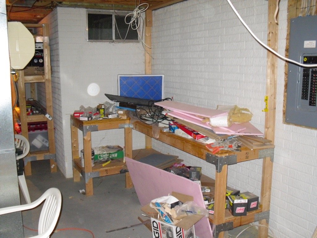

    This bench does weigh a couple of hundred pounds. Top is 1 in thick (maybe 1.5 inches) and bench is 8 ft by 4 ft. Sold that house a few years back but I was bored at the time so started building ... to the left you can see the end of one leg of a U-shaped 4 shelf-design.

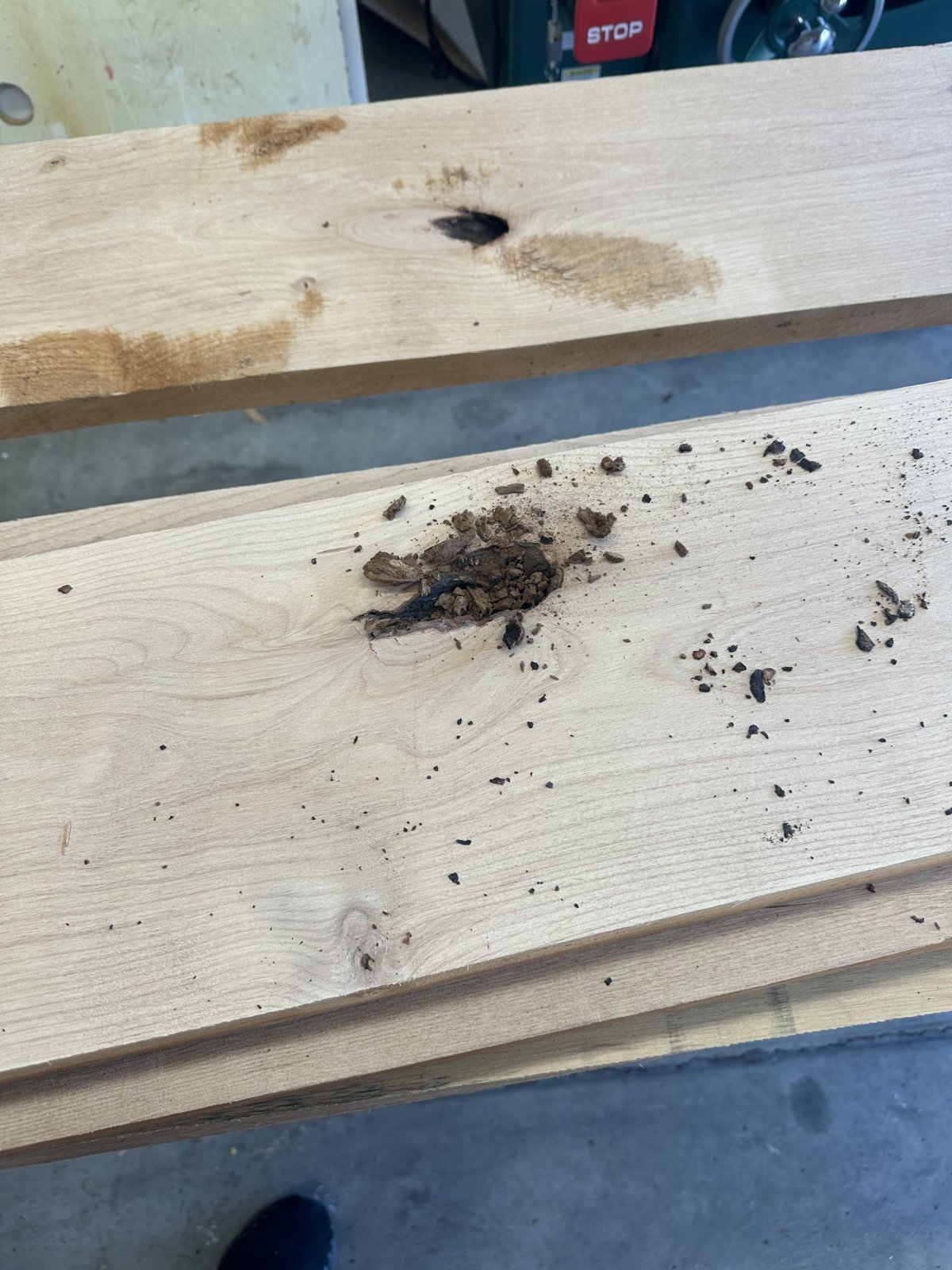

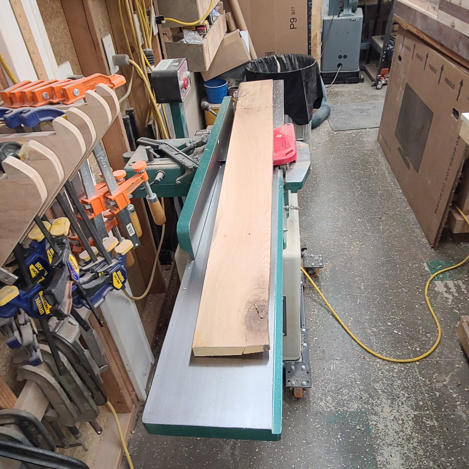

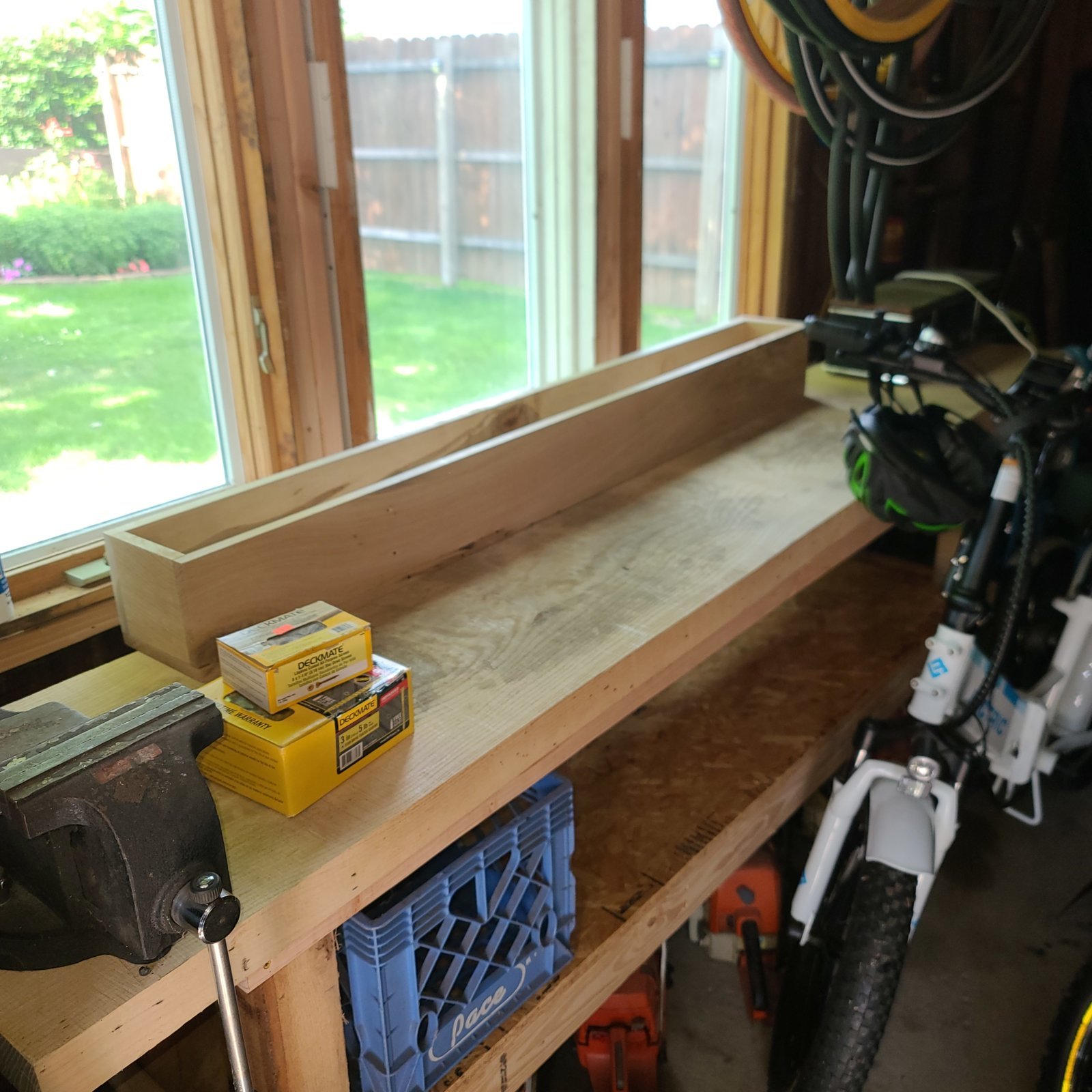

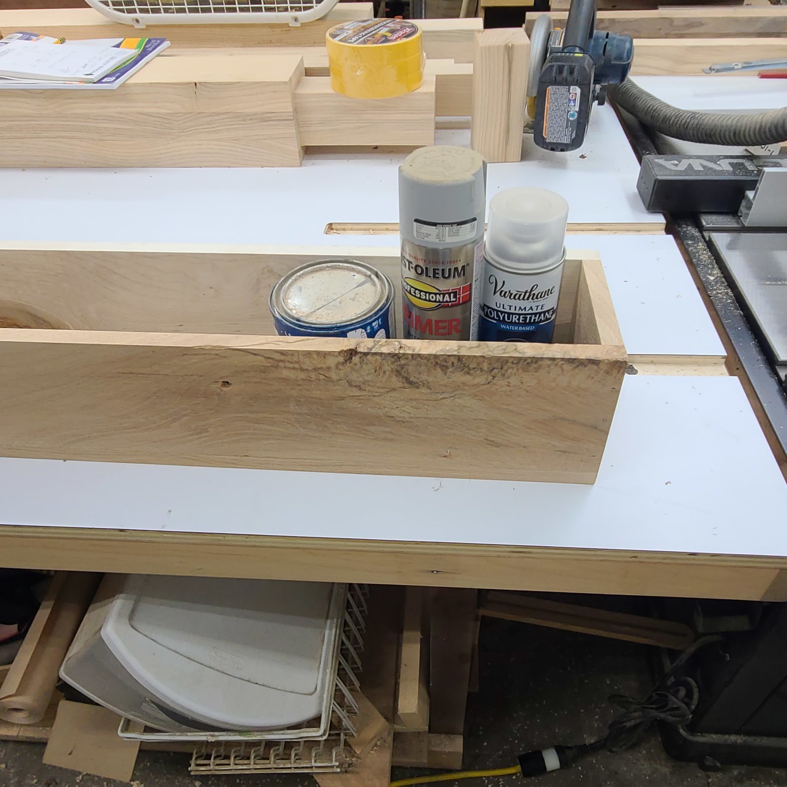

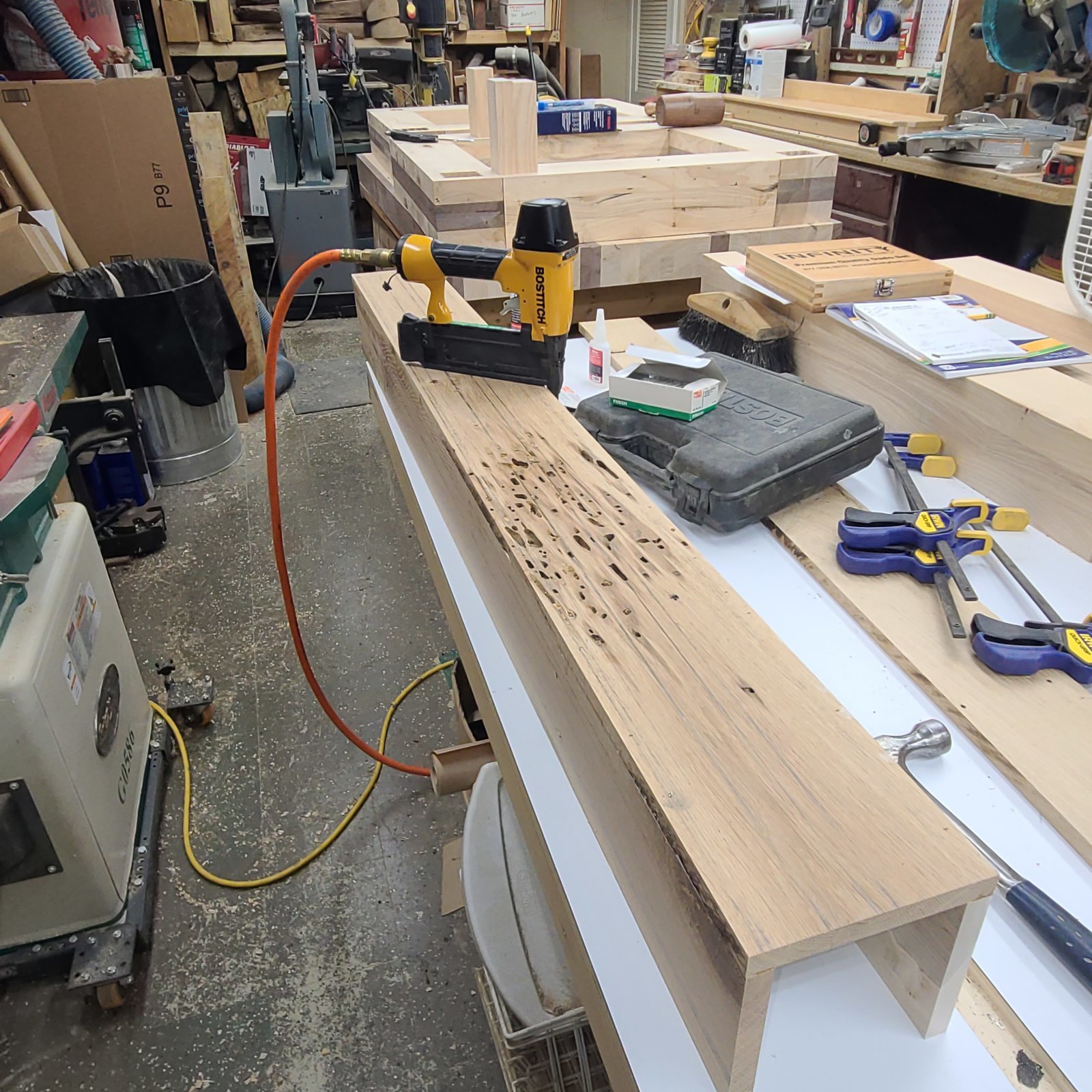

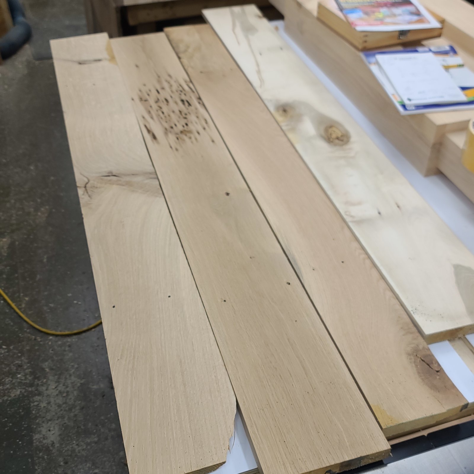

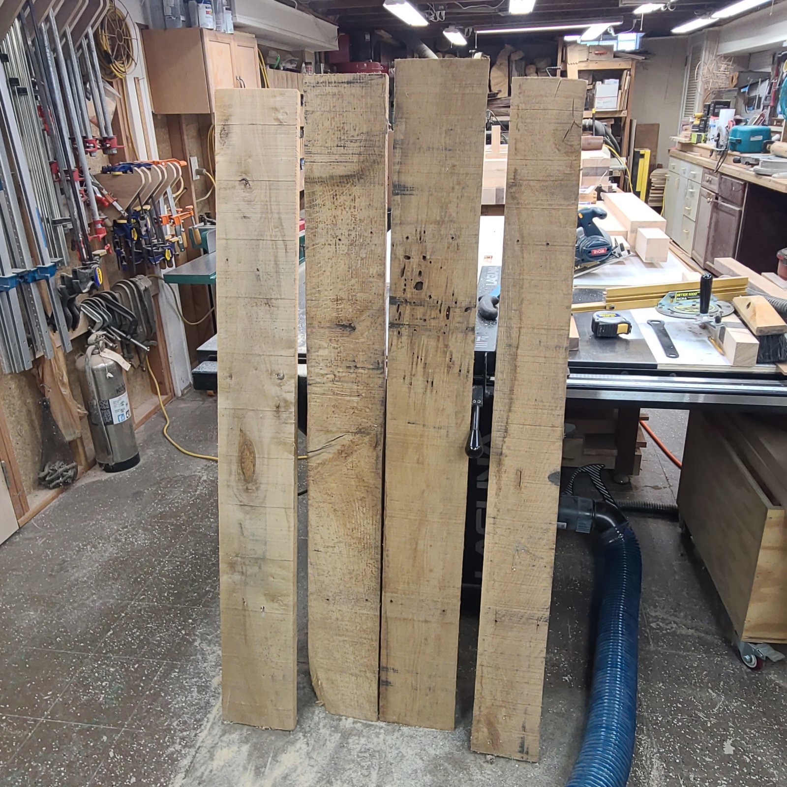

    Got in the shop today to work on the can tray for the workbench. Sticking with my motto that wood is free and it's everywhere I selected some hardwood boards from my stash, been in the shop over a year so it's plenty dry . 3 oak and 1 maple.
    Ran em through the jointer.
    Now jointed on 2 sides. Notice the ant holes, lol. Kinda looks cool and will work just fine as the bottom board for the tray.

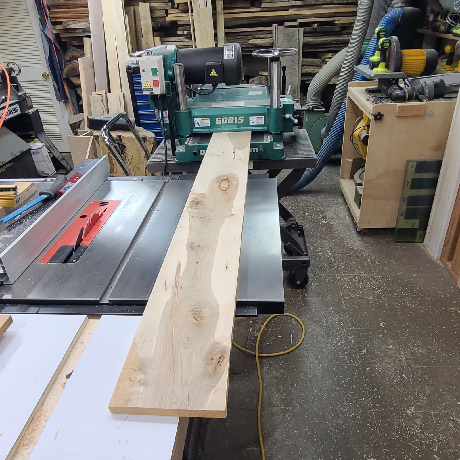

    Next I ran them through the planer to thickness them.

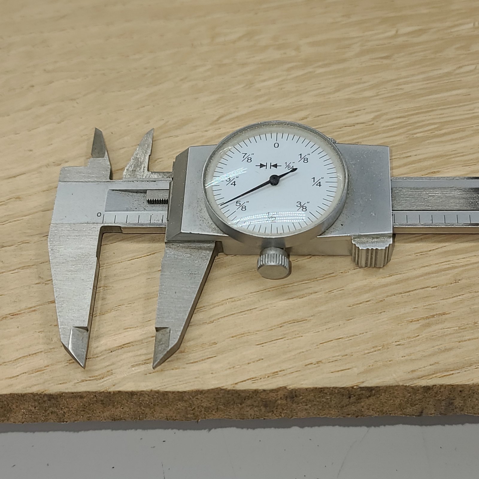

    They cleaned up just over 5/8"

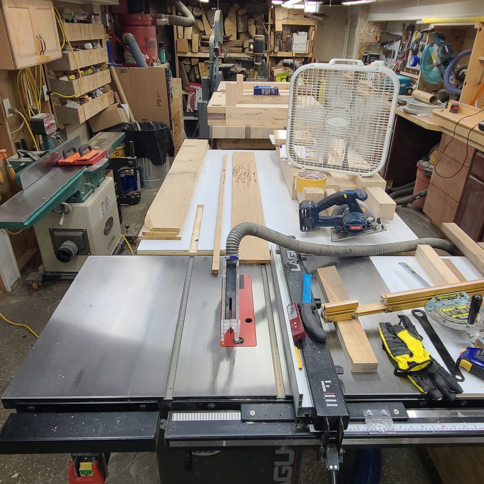

    Ripping to width on the table saw.

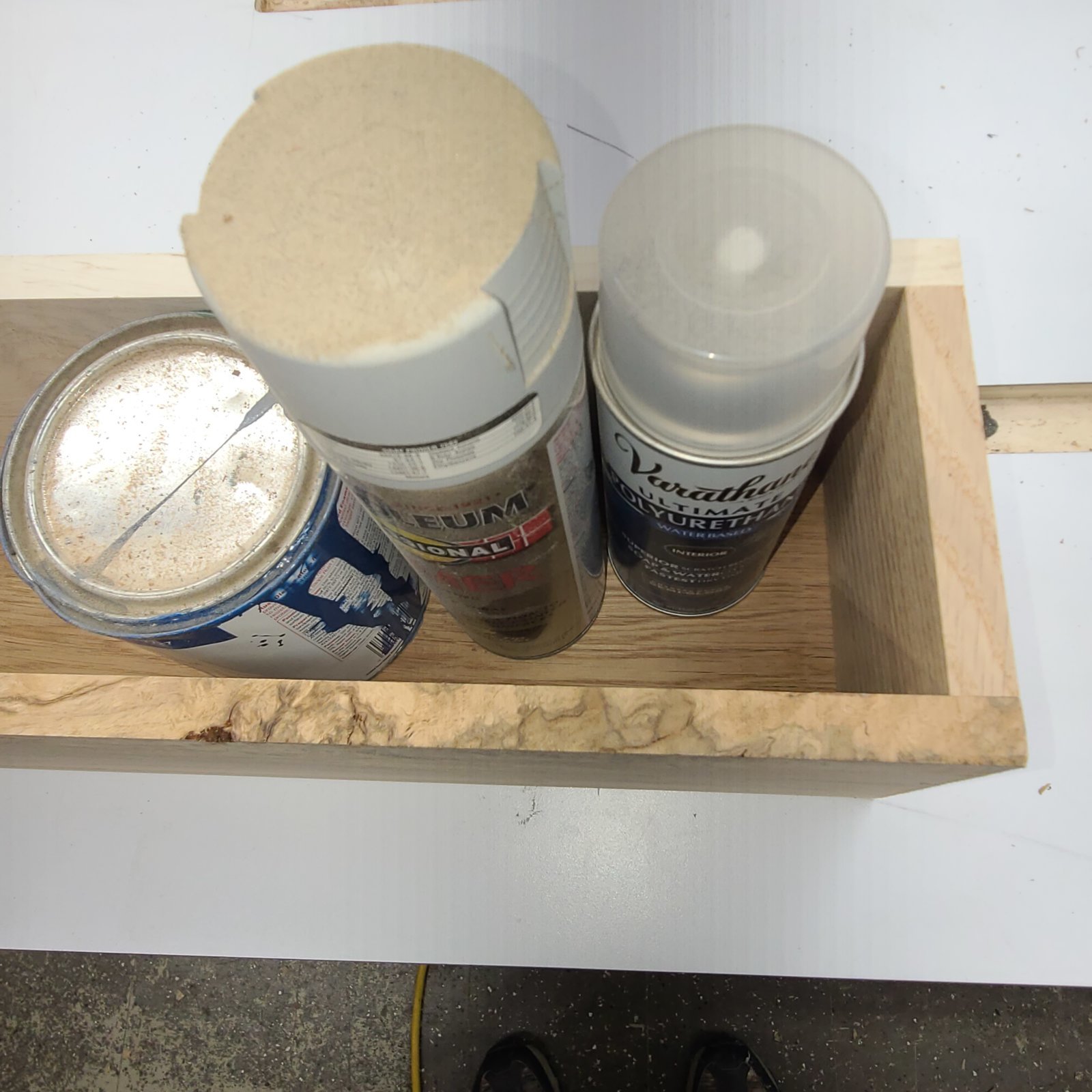

    I used thick ca glue, a brad nailer, and accelerator. Zero dry time needed.
    Cans fit fine and will also hold a quart can.
    Tray is 5x5.
    It will hang off the back of the bench after I sand the top. Right now the top is a rough chainsaw finish.
