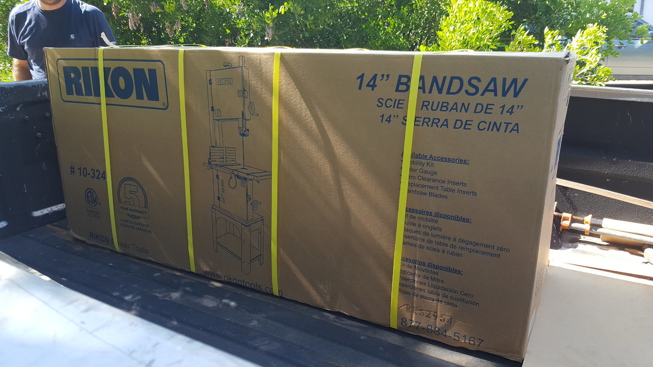

    new toy yesterday

    Very nice. That should help with the splintering problem.

    Indeed. Works great.
    So far I have used it to cut cabinet grade 3/4" plywood and it is fantastic. It has a scoring feature that makes a 2mm score on the first pass. It's optional and is activated with a push/pull button. I haven't seen a difference in the cut quality with or without the score feature. The key is speed. Push the saw too fast and you will get splinters. Use a slow even speed and you will not splinter the ply. The motor is a variable speed via a wheel below the handle.
    The track is very rigid and doesn't flex. The track stays put without clamps. If you go this route and decide to purchase clamps, everyone recommends the Dewalt clamps. They are cheaper and work fine. The difference between the clamps is the Makita clamps have screw handles where the Dewalt is a quick clamp. The saw also has adjustment knobs to eliminate play in the track.
    I haven't tried to bevel with it yet. It will do from -1° to 48° with stops at 22.5° and 45°.
    It has a soft start and a brake.
    The height adjustment scale is in metric but I don't use the scale. I just set it for material depth or below and go.
    Here is one of the reviews I based my purchase off of.
    http://www.woodworkersjournal.com/track-saw-review/
    The other review is an Amazon review from G. Conner. It should be the very first review here...
    https://www.amazon.com/Makita-SP600...d=1503919984&sr=8-1&keywords=makita+track+saw
    If you do purchase it, don't be alarmed that the rubber splinter guard is in the blade path. I looked through the manual and multiple on line videos about it before I just decided to go with it. You will end up cutting the guard but that is how you fit it to the saw. It is the only "set-up" that was required; aside for the track tensioners. You can this thing running out of the box in less the 5 minutes.
    I can't wait to find new uses for it.

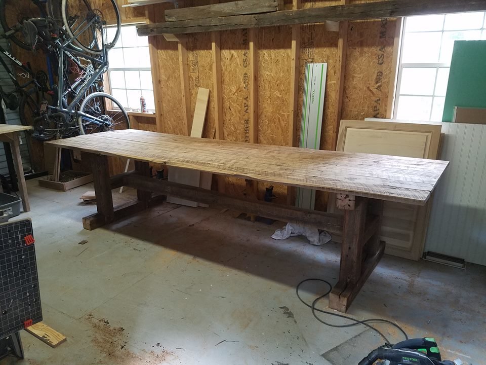

    10 ft farm table I just finished with 150+ year old barn wood.

    That's gorgeous. How did you connect the top to the trestles?

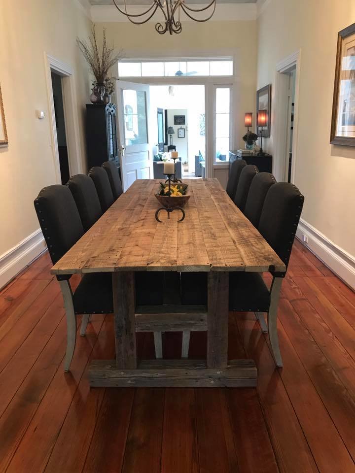

    Thank you.
    I built a frame spanning the two trestles with some cross bracing to attach the top, one thing I didnt take a photo of. But here is a a side shot of the table

    Very nice. :thumbsup:

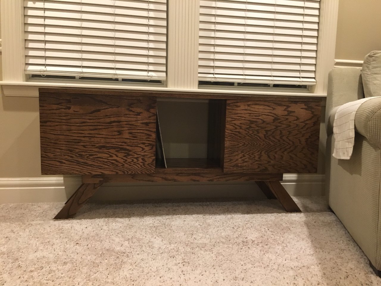

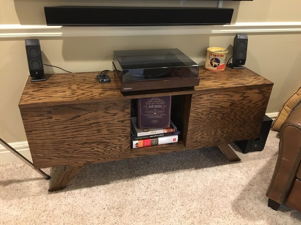

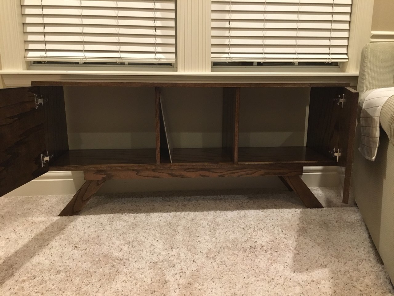

    Made my first attempt at some plywood furniture using edge banding. Almost all cuts were made with a cordless skill saw and fence, I really love this method.IMG_2820.jpg IMG_2821.jpg IMG_2824.jpg

    I should probably upgrade my speakers before someone reports me to the record snob forum!

    Looks retro but I like the look!

    That's what I was going for thanks!
