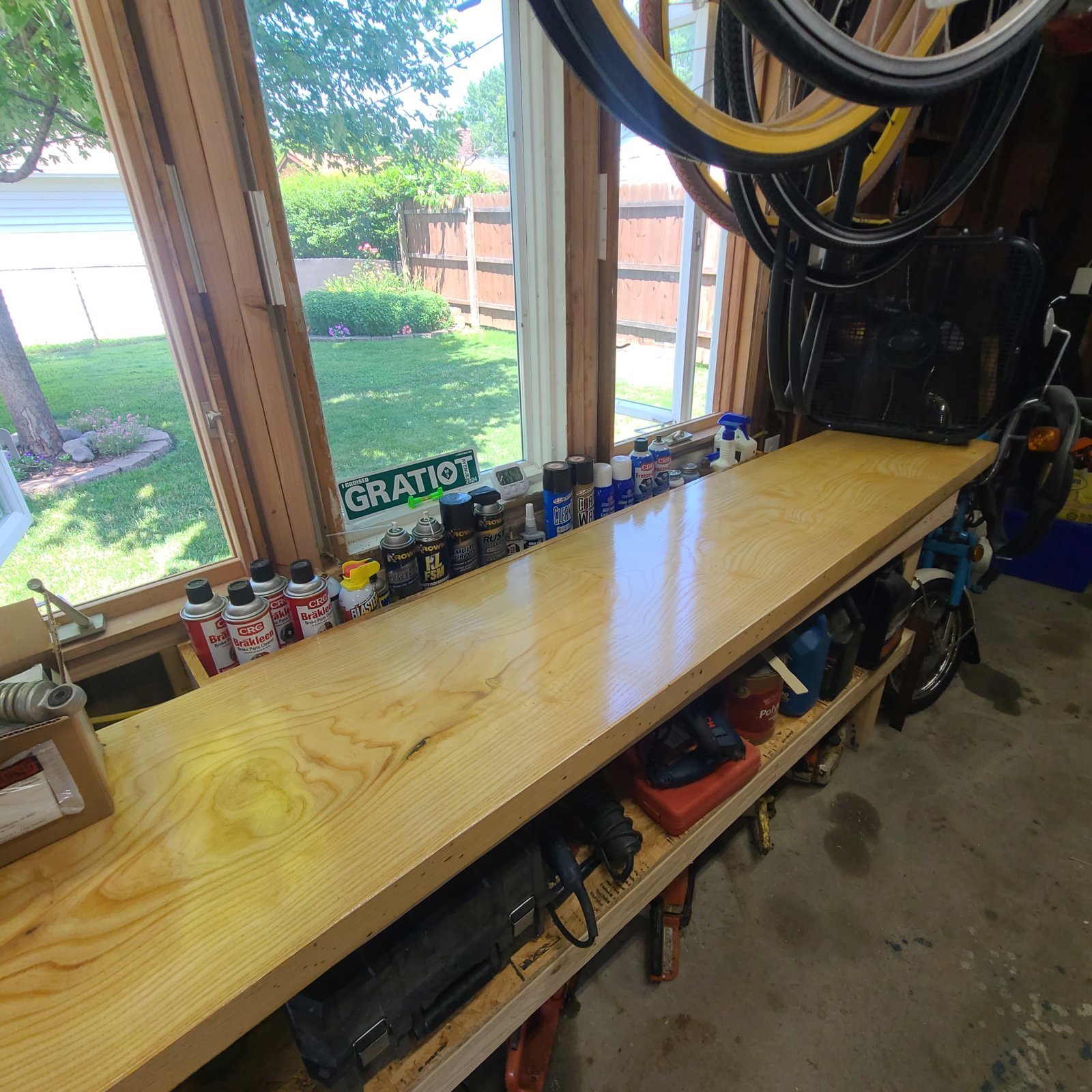

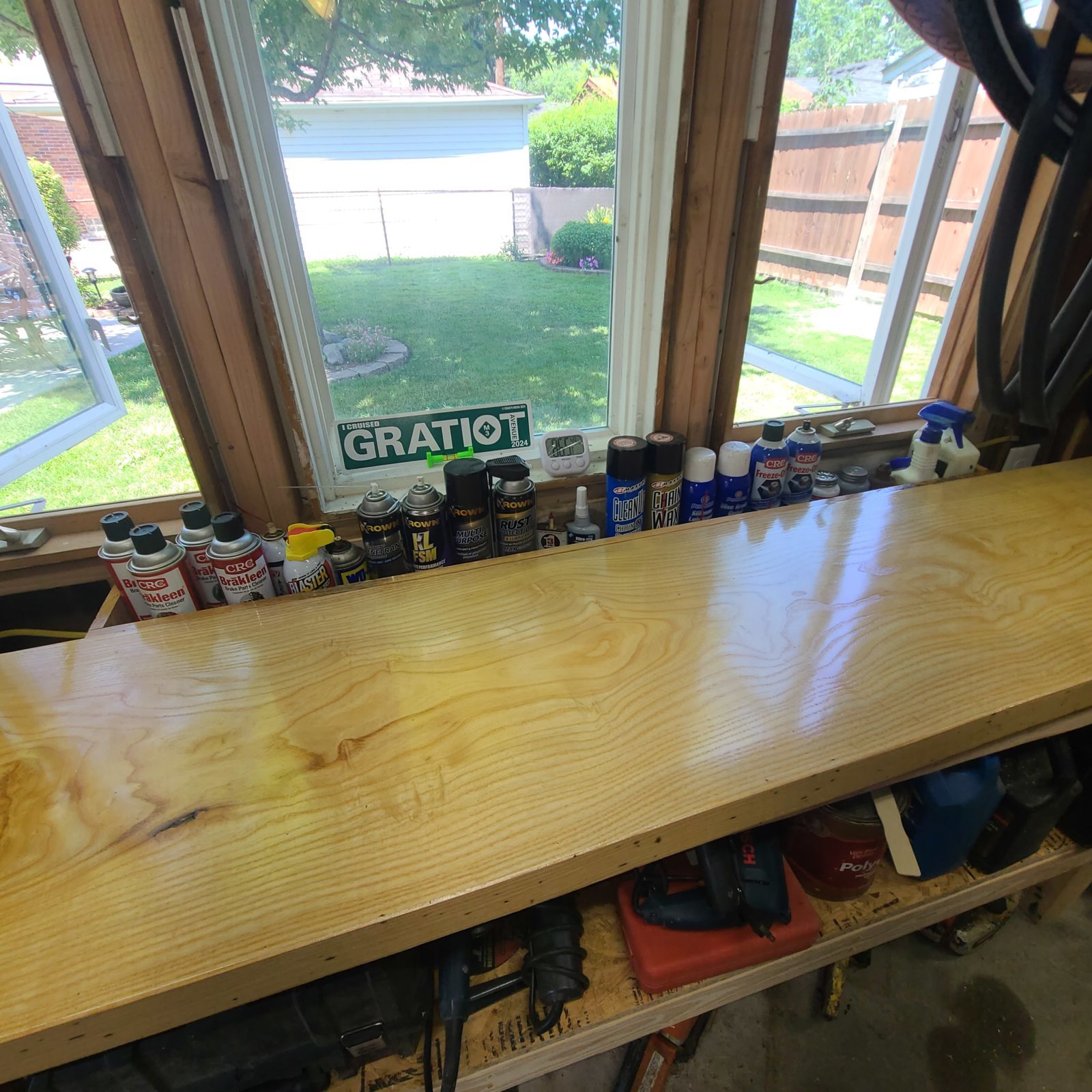

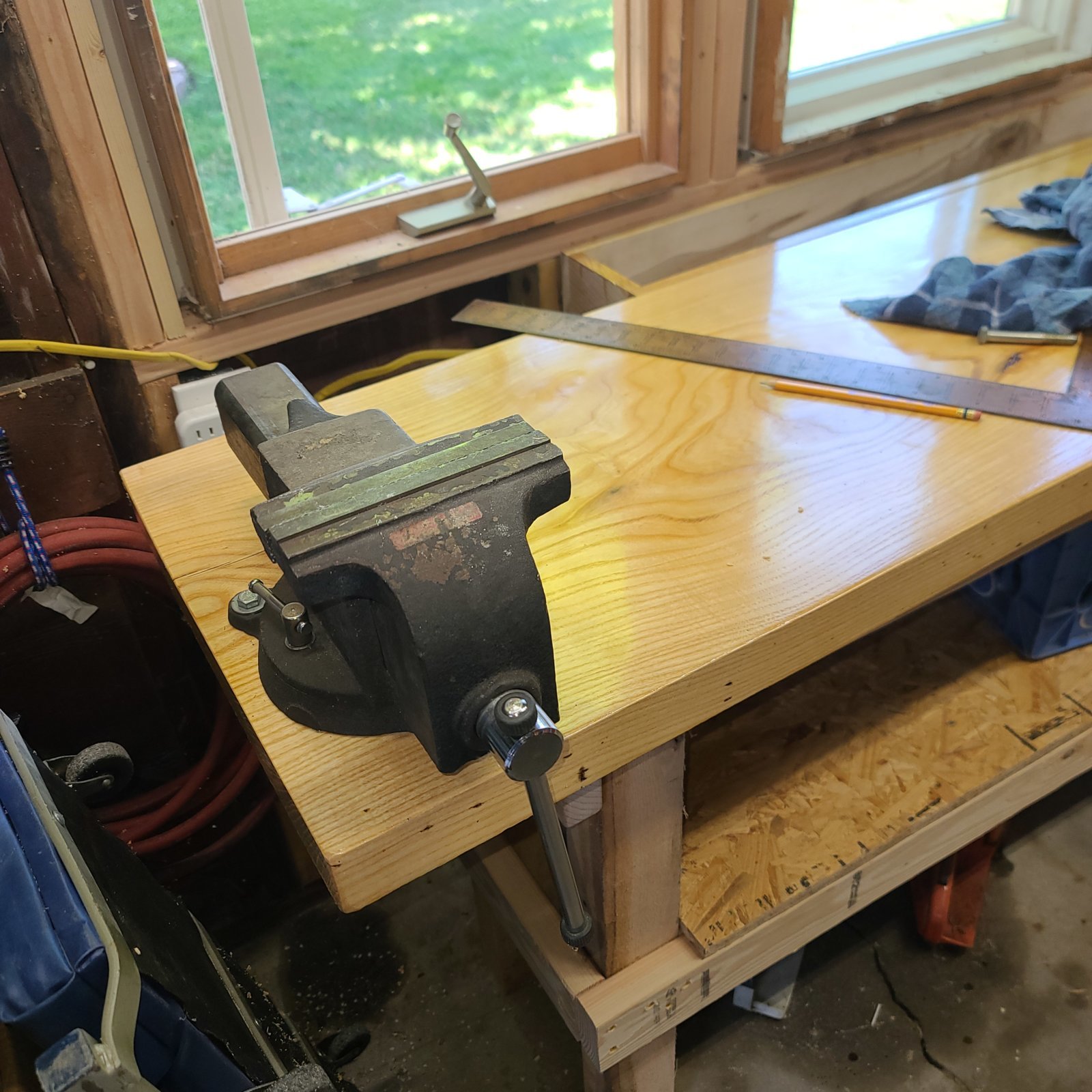

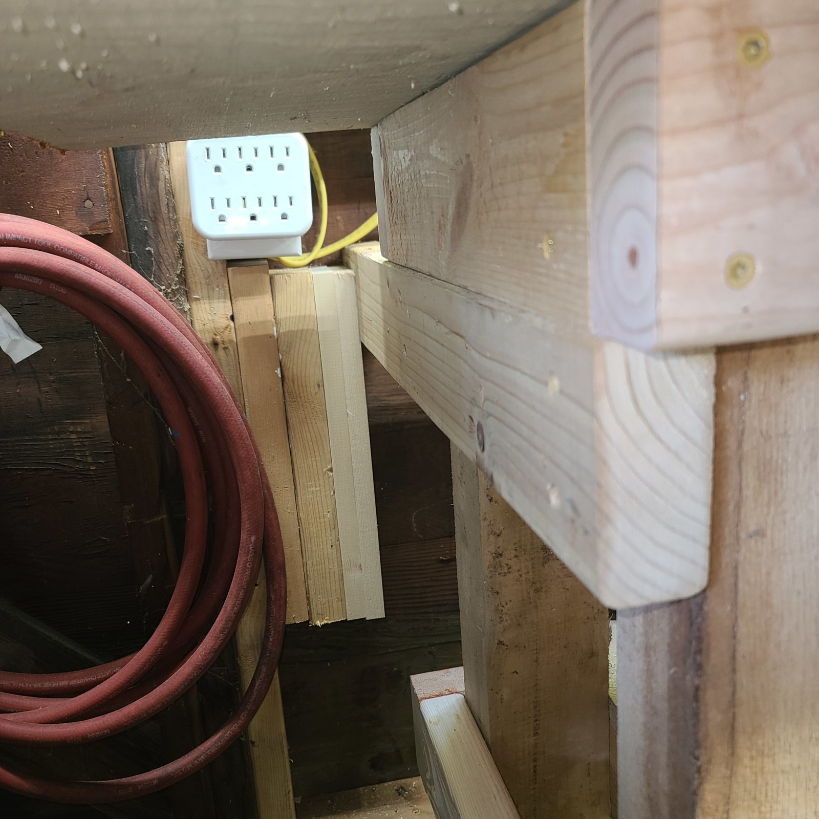

    Well I got the workbench part of the garage project finished.

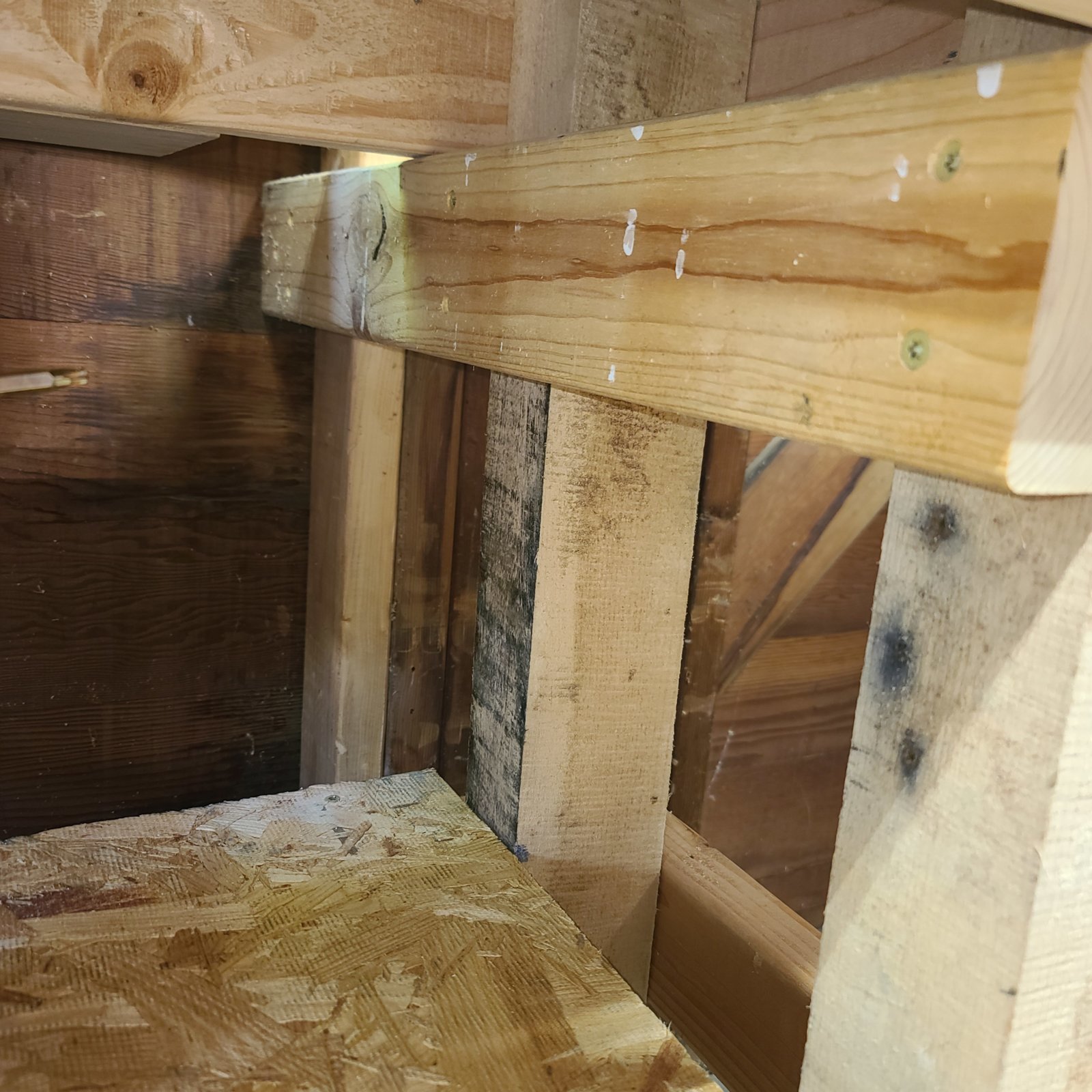

    Since the bench is so narrow I though it would be a good idea to attach it to the wall to prevent a tip over.
    This side I had to build up. Bench has no movement now.

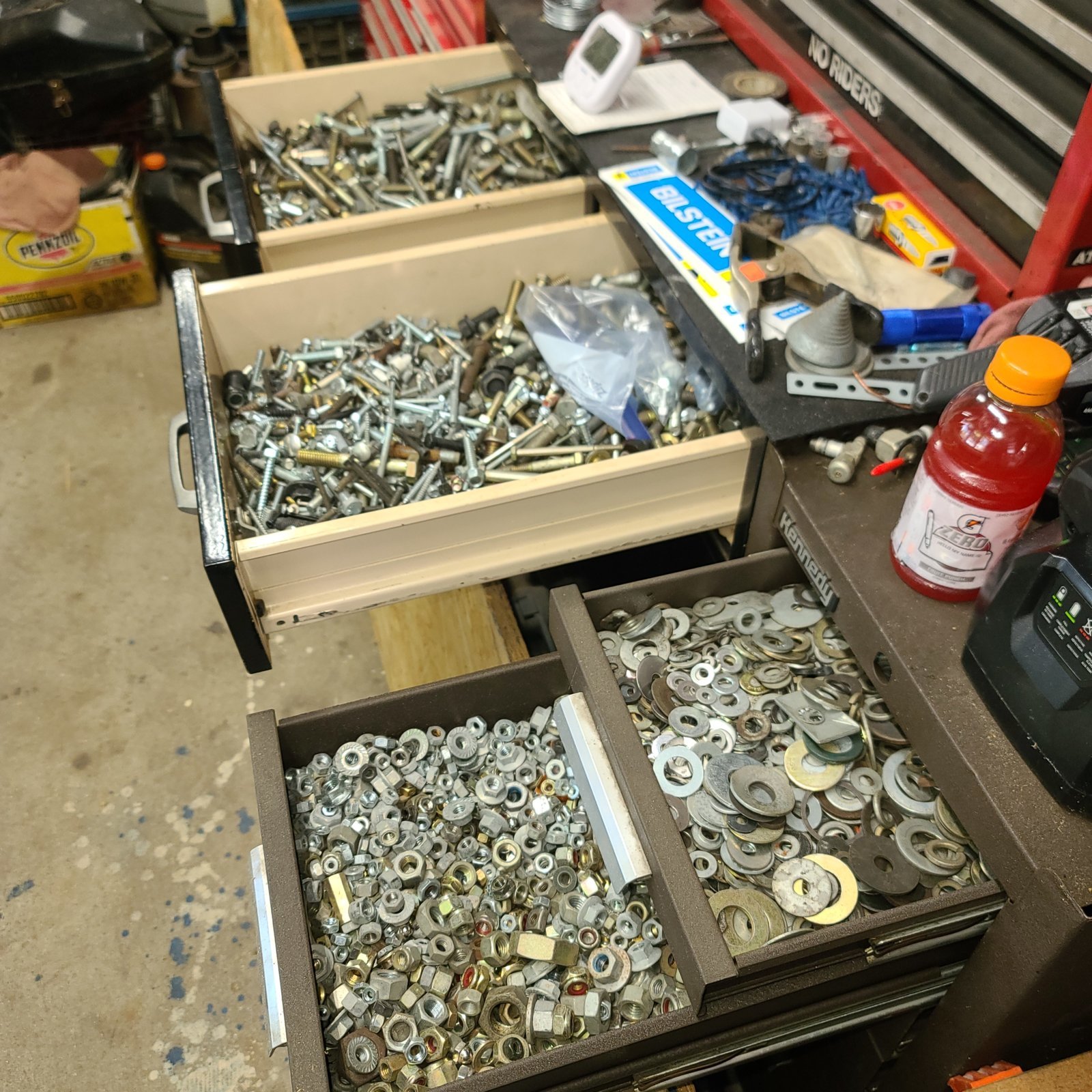

    Sorted through my hardware to find bolts to mount the vise.
    Drilled the holes and got the vise mounted.
    Put a bunch of stuff away on the bottom of the bench.
    And I filled the can rack. It's nice to have all my mechanic in a can in one place.
    Only thing left to do now is to frame in and install a new entrance door. Probably paint the garage next year.

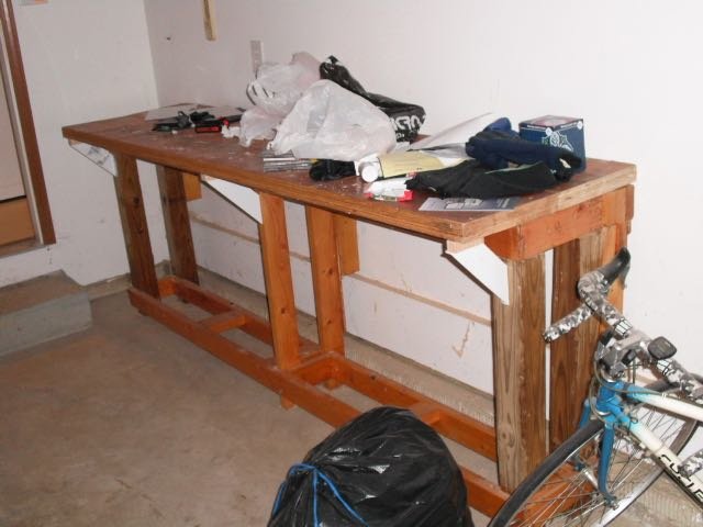

    This bench is narrow-ish and has recessed legs to make room for the car so lag bolts hold it to the wall studs. For additional stability the legs closer to the garage door are longer than the legs closer to the inside door, quite a difference in leg length given 8 ft of bench in a sloping garage. I never did fully use it but finished as far as I did just for grins and giggles.

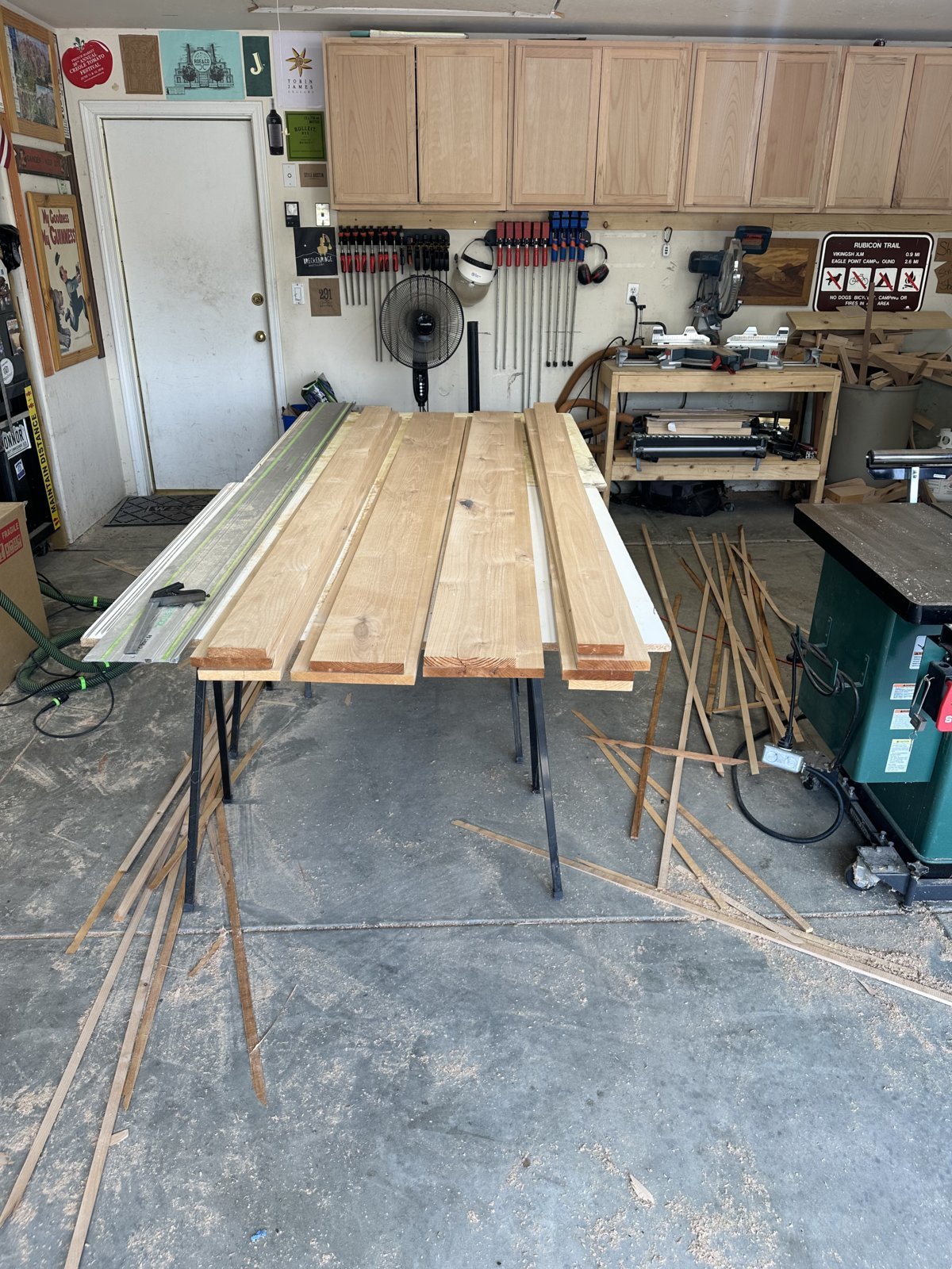

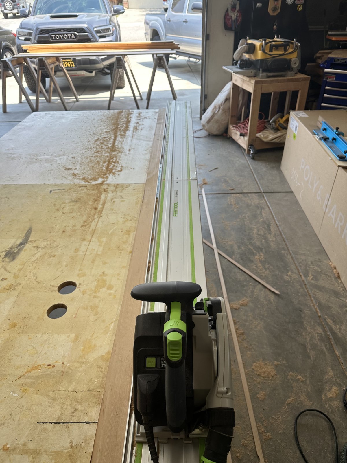

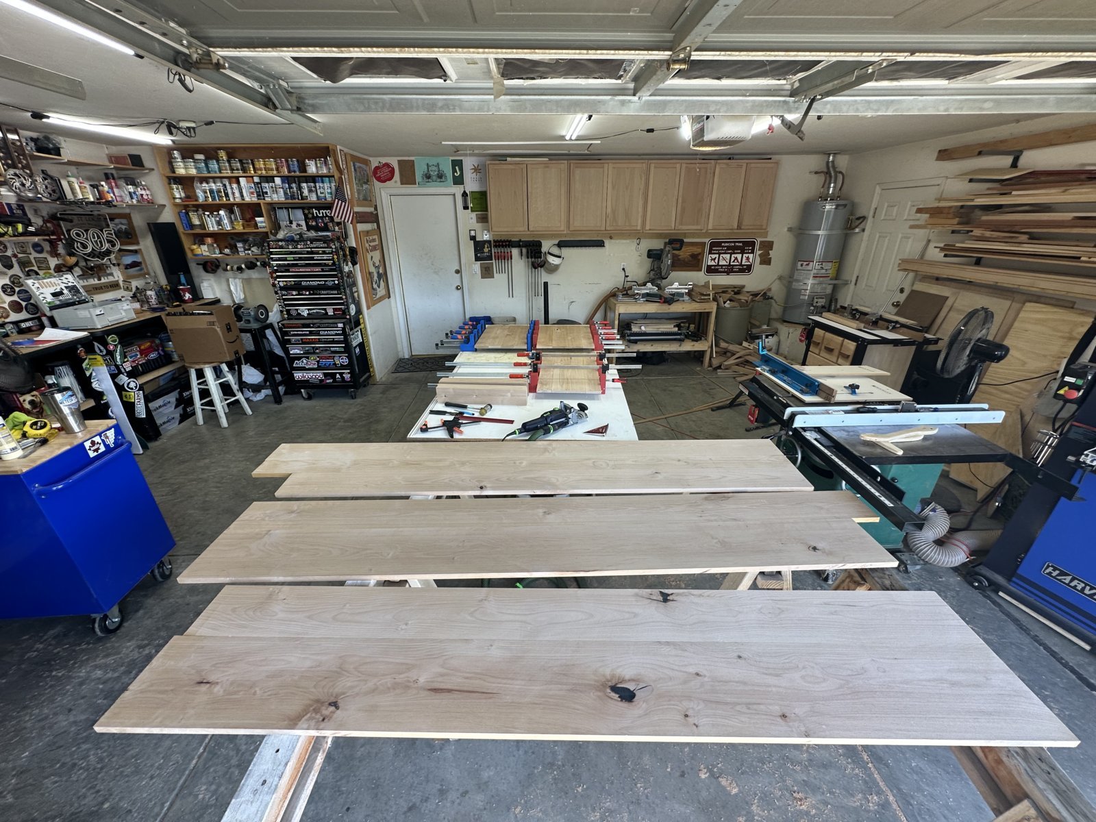

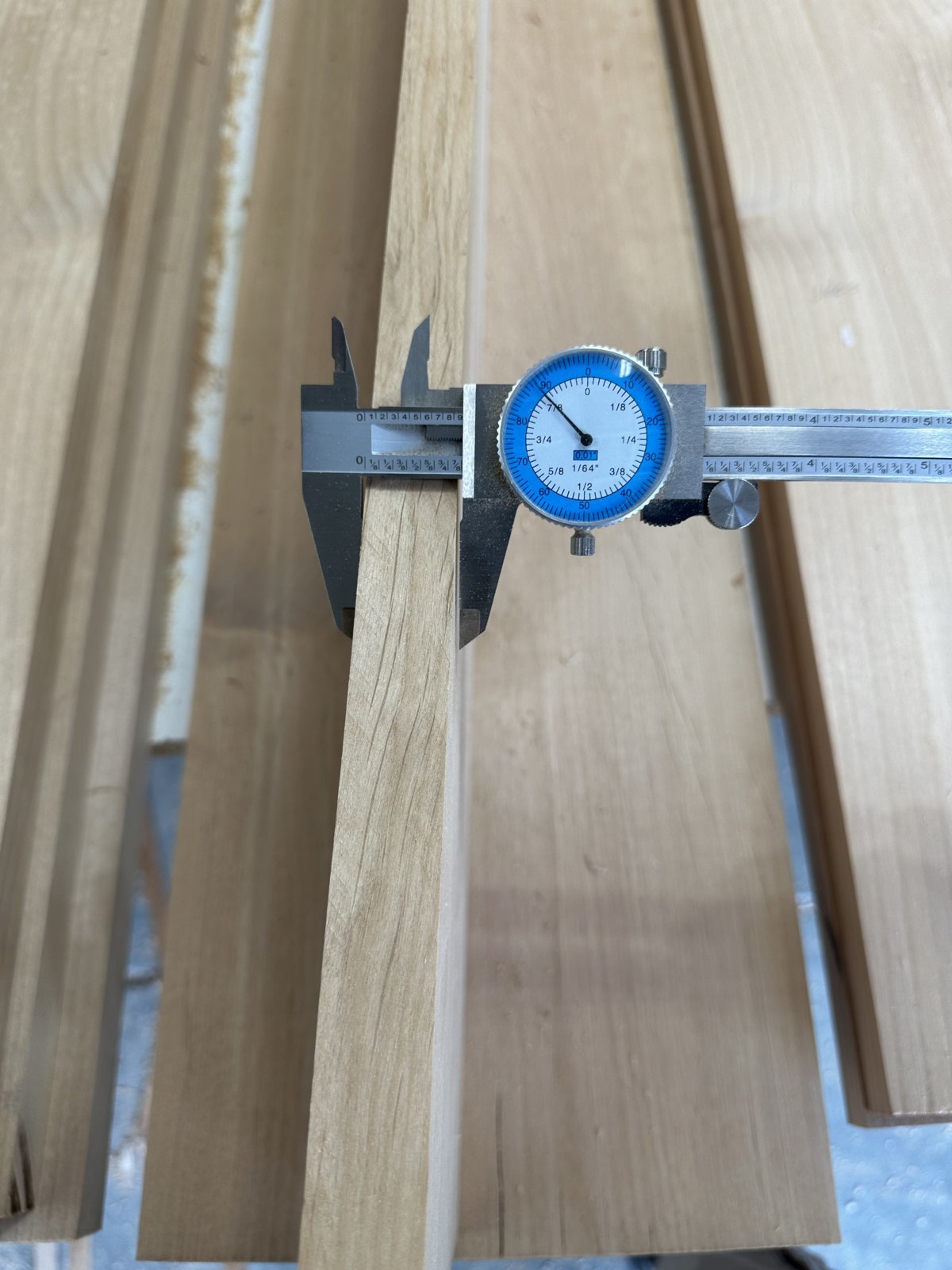

    Got this far today before it hit 100 degrees in the garage and I quit.
    All the rough cut 5/4 planed to final thickness. Went with 7/8 just because.
    None of these board had a straight edge on them, so I used my track saw to fix that. Had to link my two tracks to make this work.
    Cleaned up opposite edge on the table saw and sorted into 4 groups for the 4 16” x 76” panel glue ups.
    Hopefully get a couple of the panels glued up tomorrow morning before it gets too hot to work again.

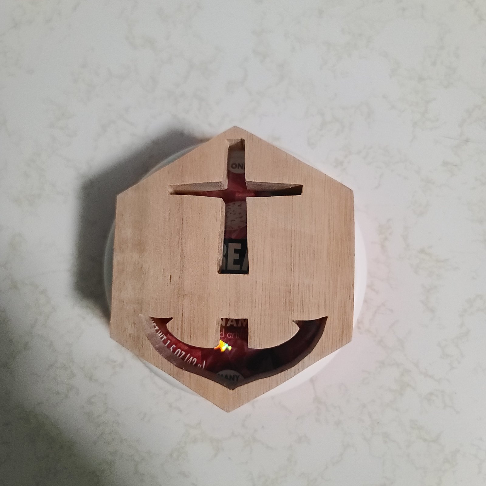

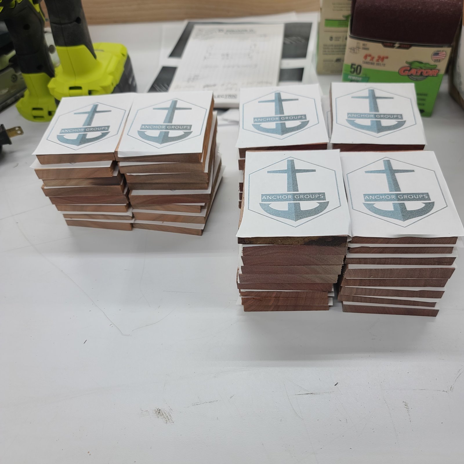

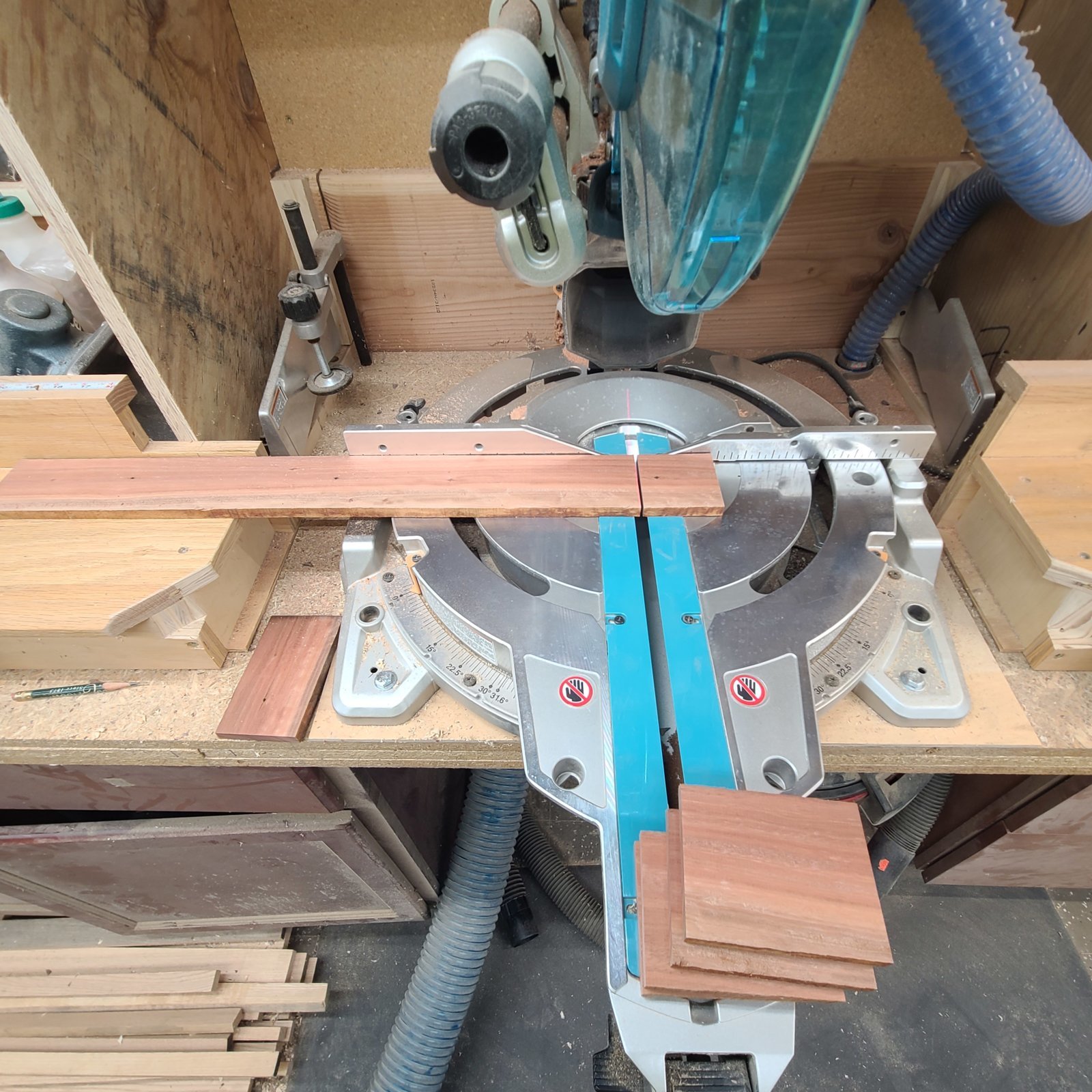

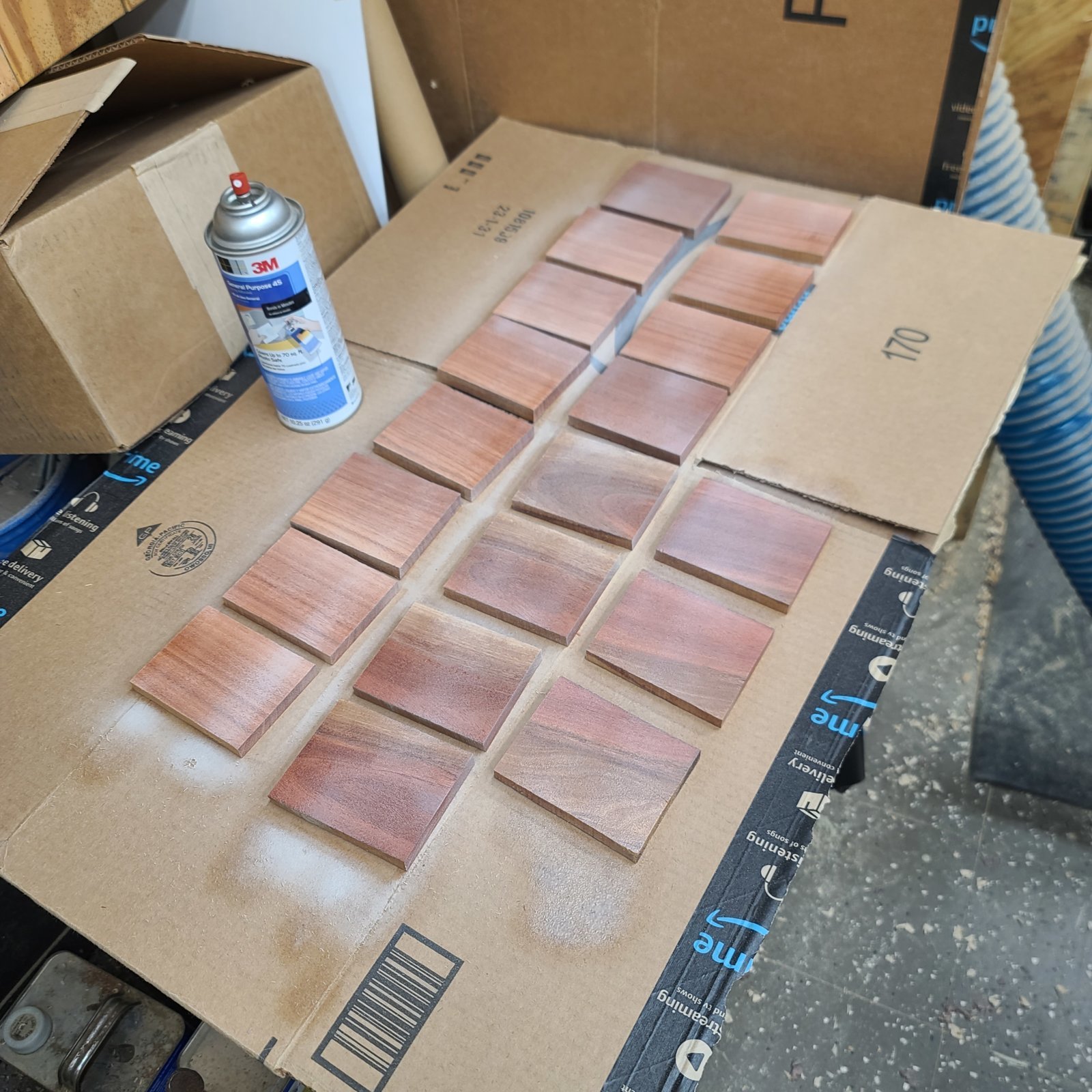

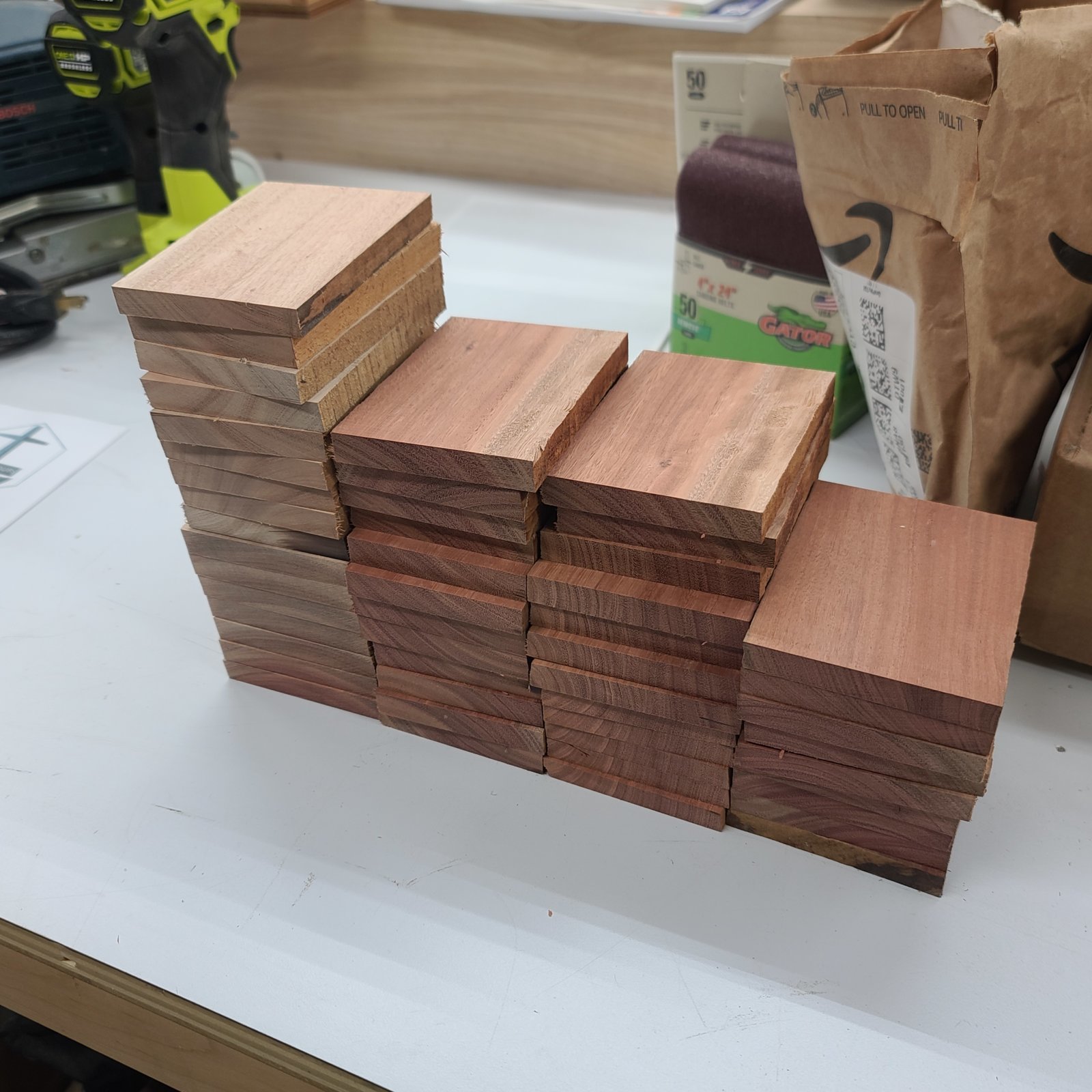

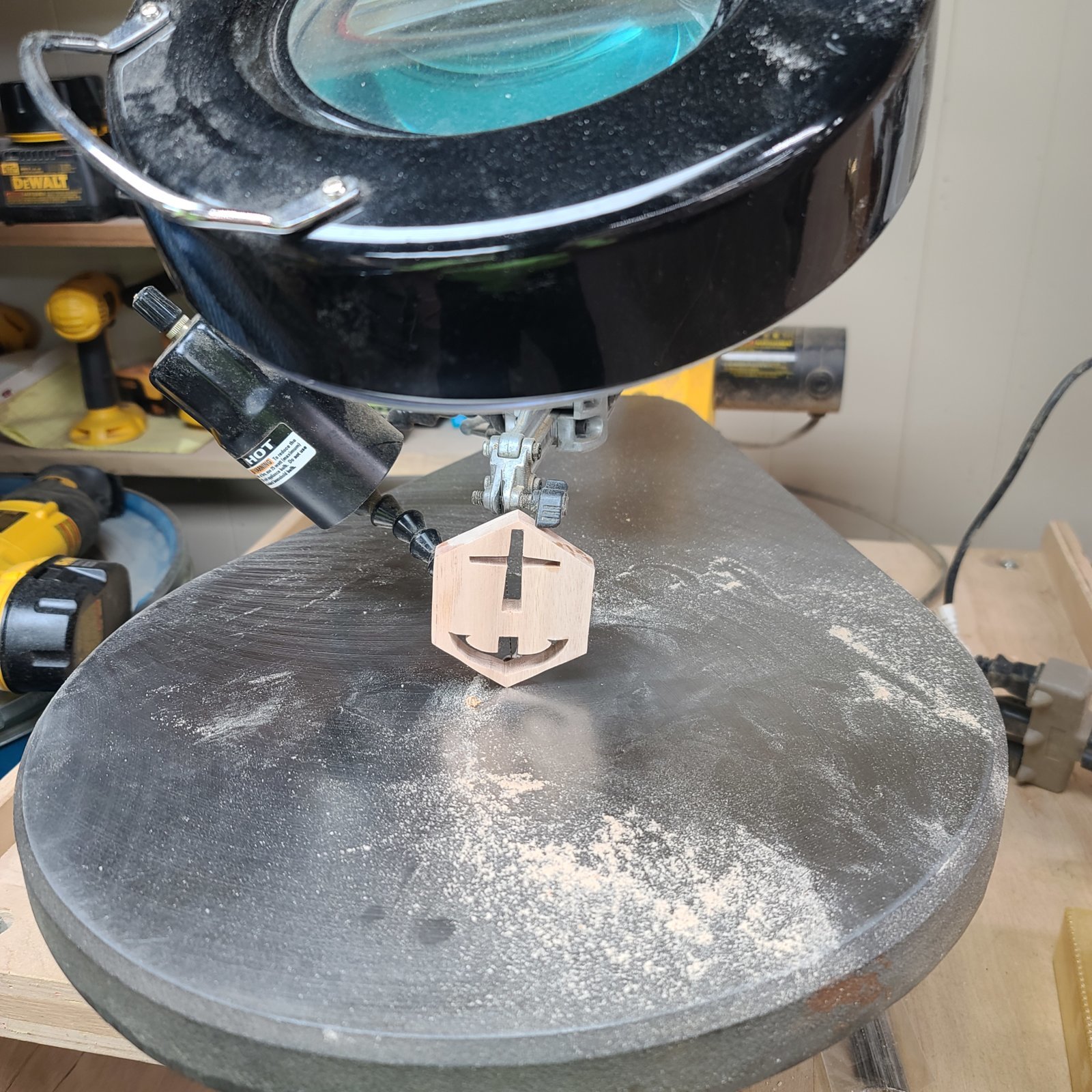

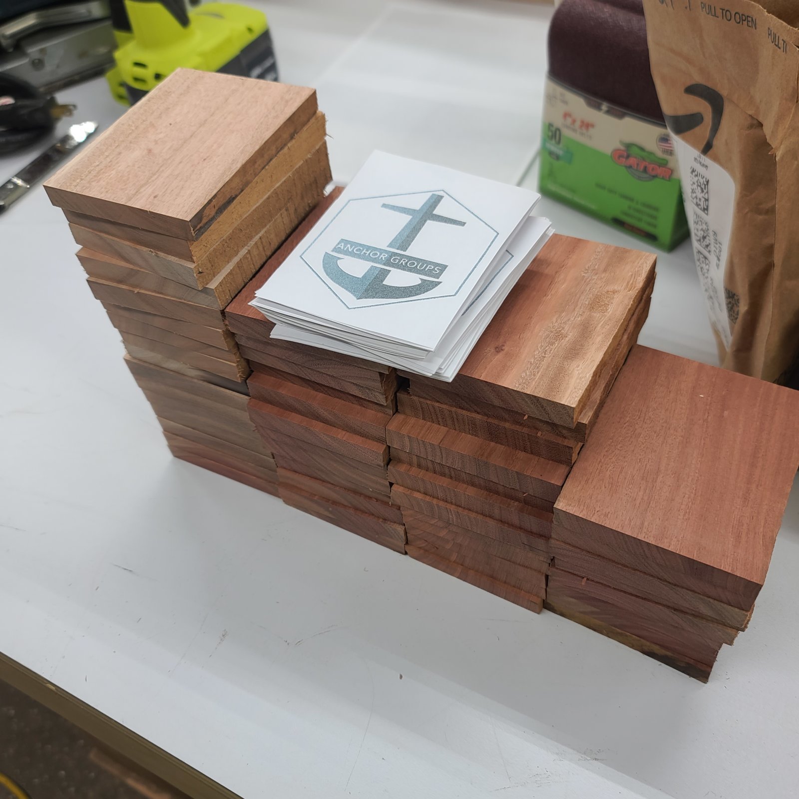

    I needed a change of pace kind of project, something simple and relaxing. So I decided to make some small little medallions of my churches logo. Our church is in St. Clair Shores, a nautical city, so it has kind of a nautical logo. So I made some copies of the logo and selected some wood. Free wood from packing crates from India, I have no idea what the species is. I ran the boards through the planer to clean them up, about 3/8"
    Cut around the nail holes and imperfections on the miter saw to get the blanks I needed.
    Got a nice stack of blanks. About 2 1/2" × 3"

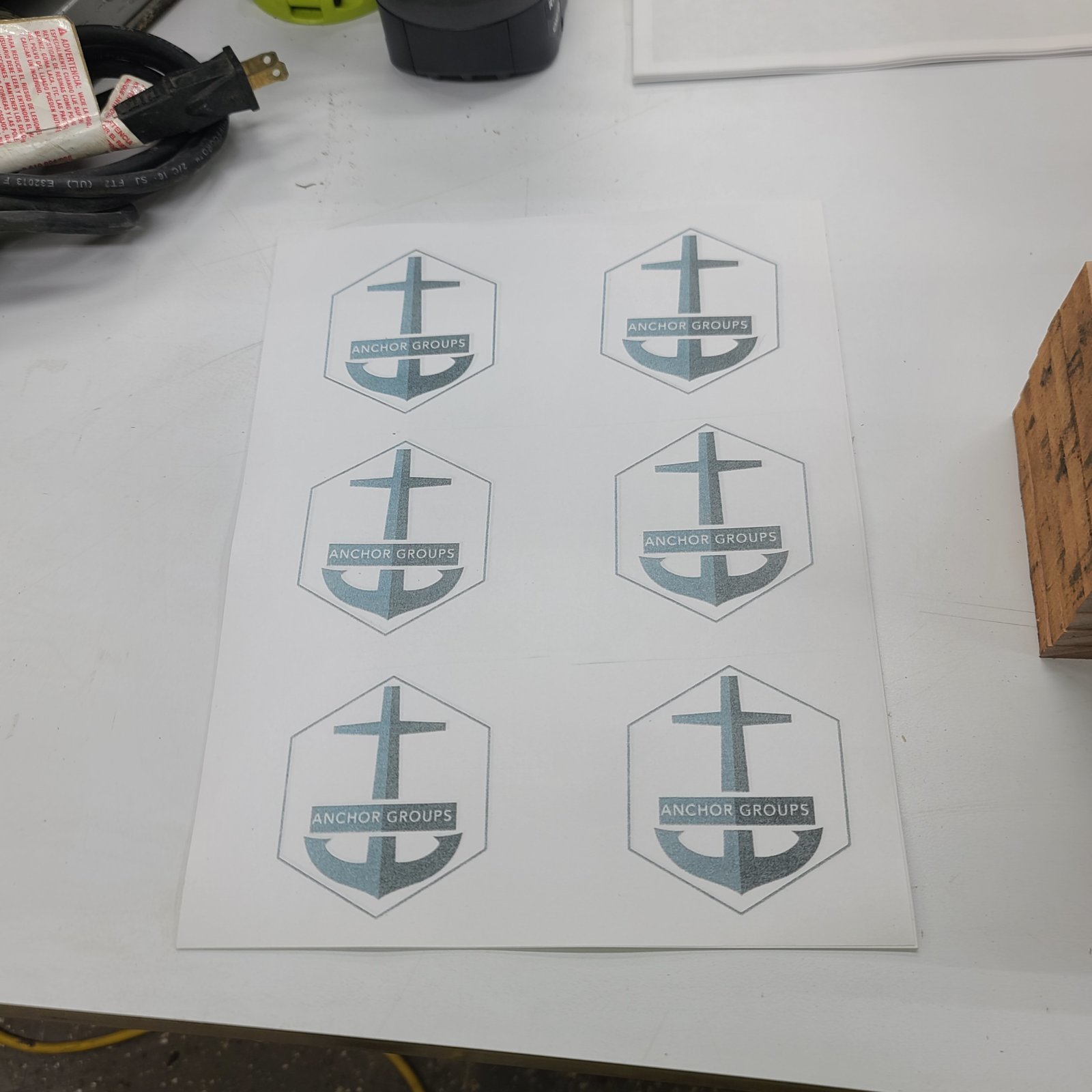

    The logo.
    Cut the patterns out.
    Spray adhesive.
    And attached the patterns.

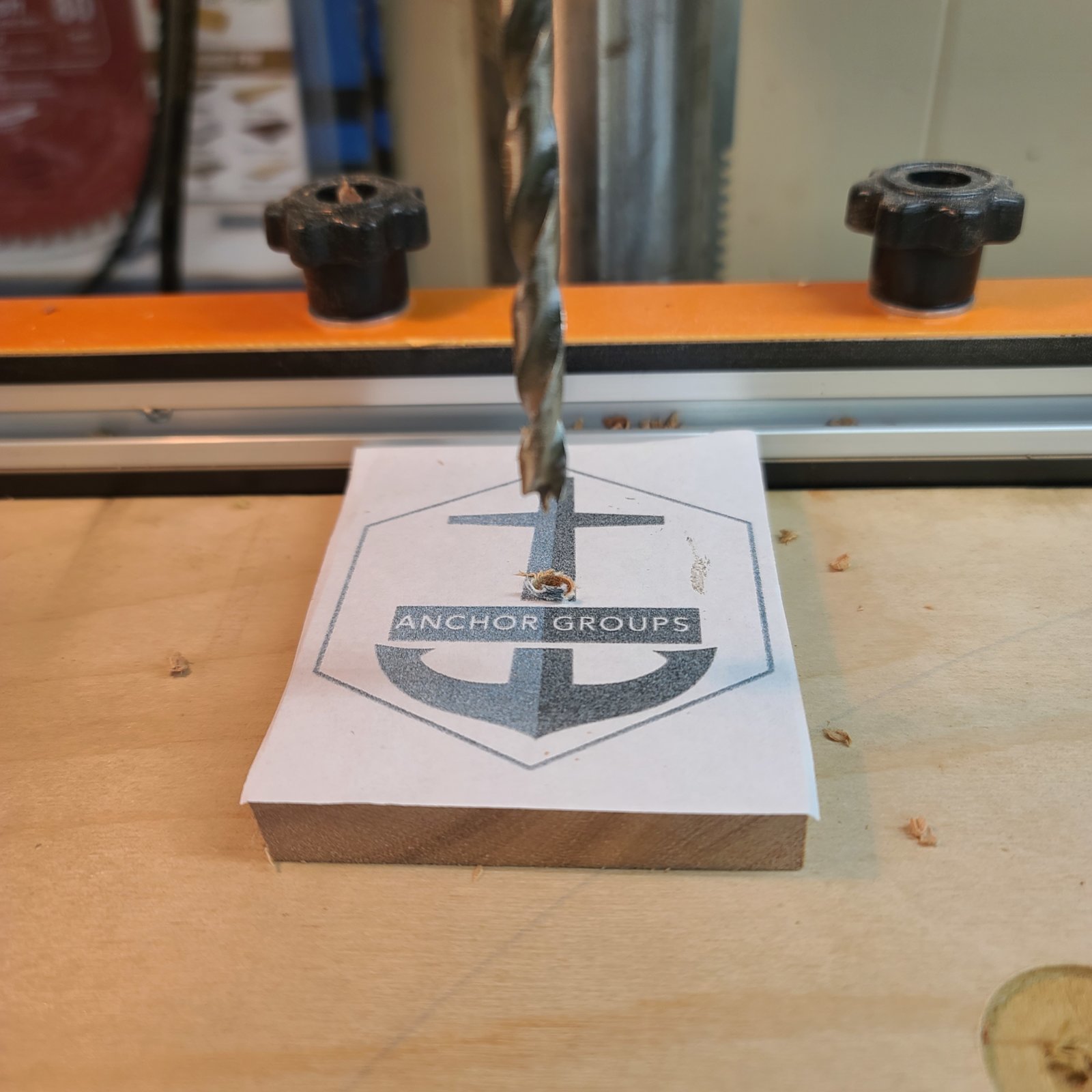

    Used a Brad point bit in the drill press to make some entrance holes.
    And cut one out on the scroll saw.
    It's about the size of a can of breath mints, lol.
    After I get them all cut out I'll give them a light sanding and dip them in blo and take them to church and put them on the information shelf for free.

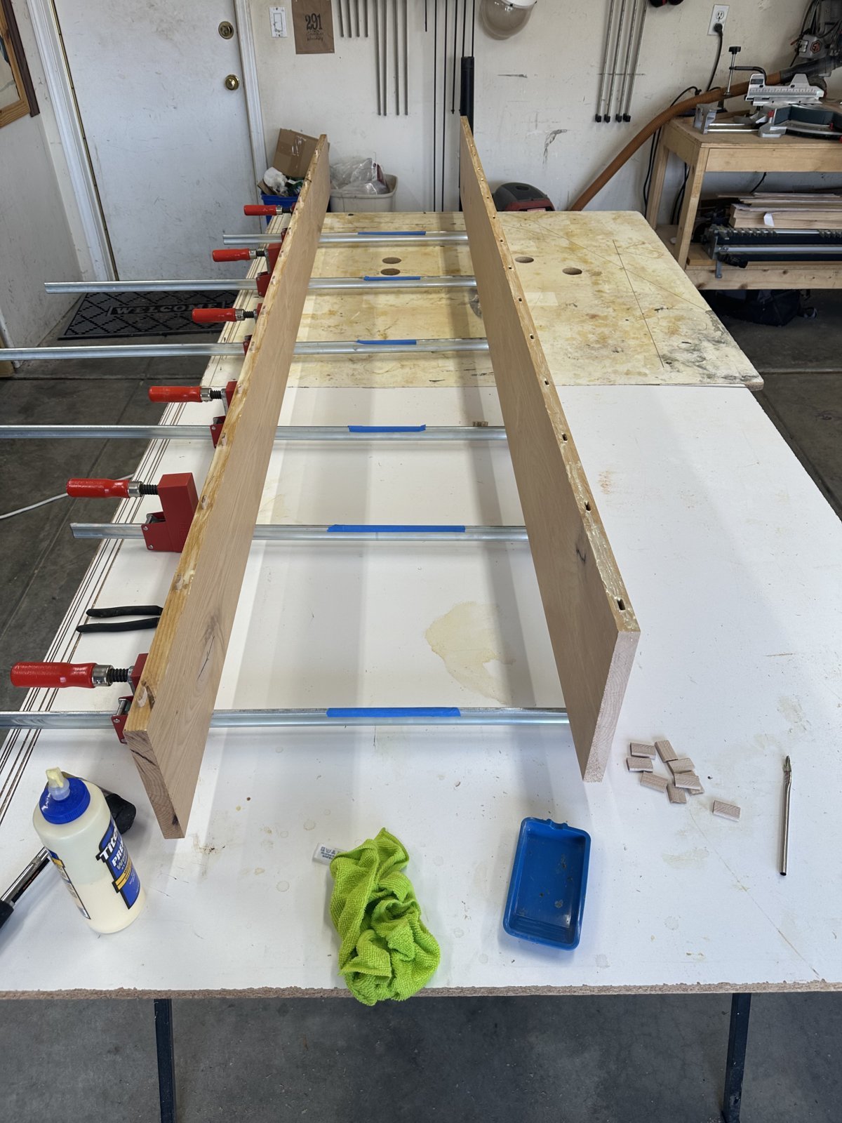

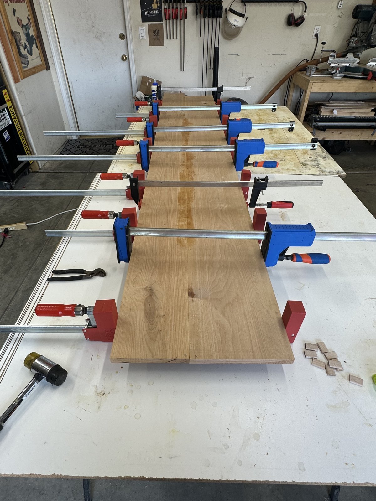

    Got three of the panels for my TV Console glued up. These will be the top, sides and bottom of the cabinet. The center shelf and dividers will be out of thinner stock. It is slow going in this heat.
    I really love how the Domino allows me to get super flat panel glue ups with long boards.
    I will agree that the Domino is over priced, but for me it is totally worth it. It turned this hack into a passable woodworker.

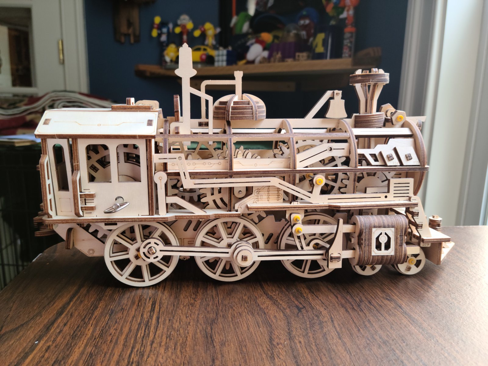

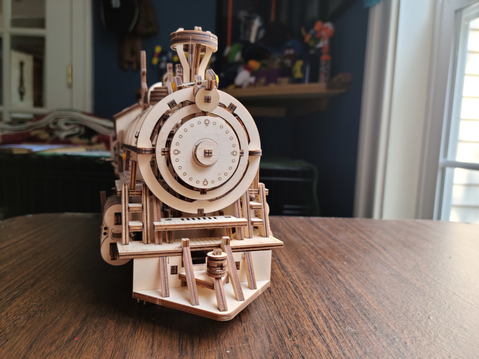

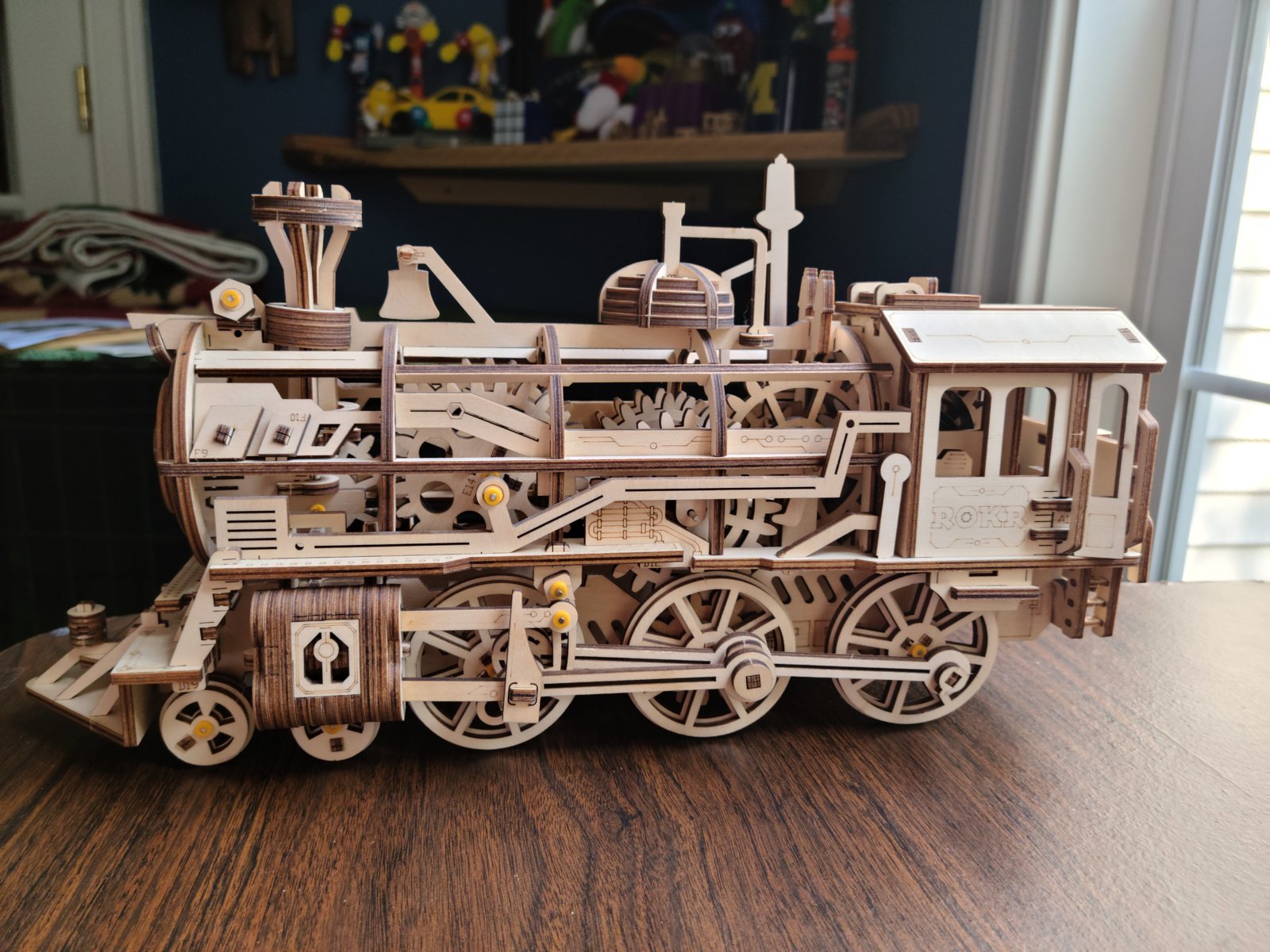

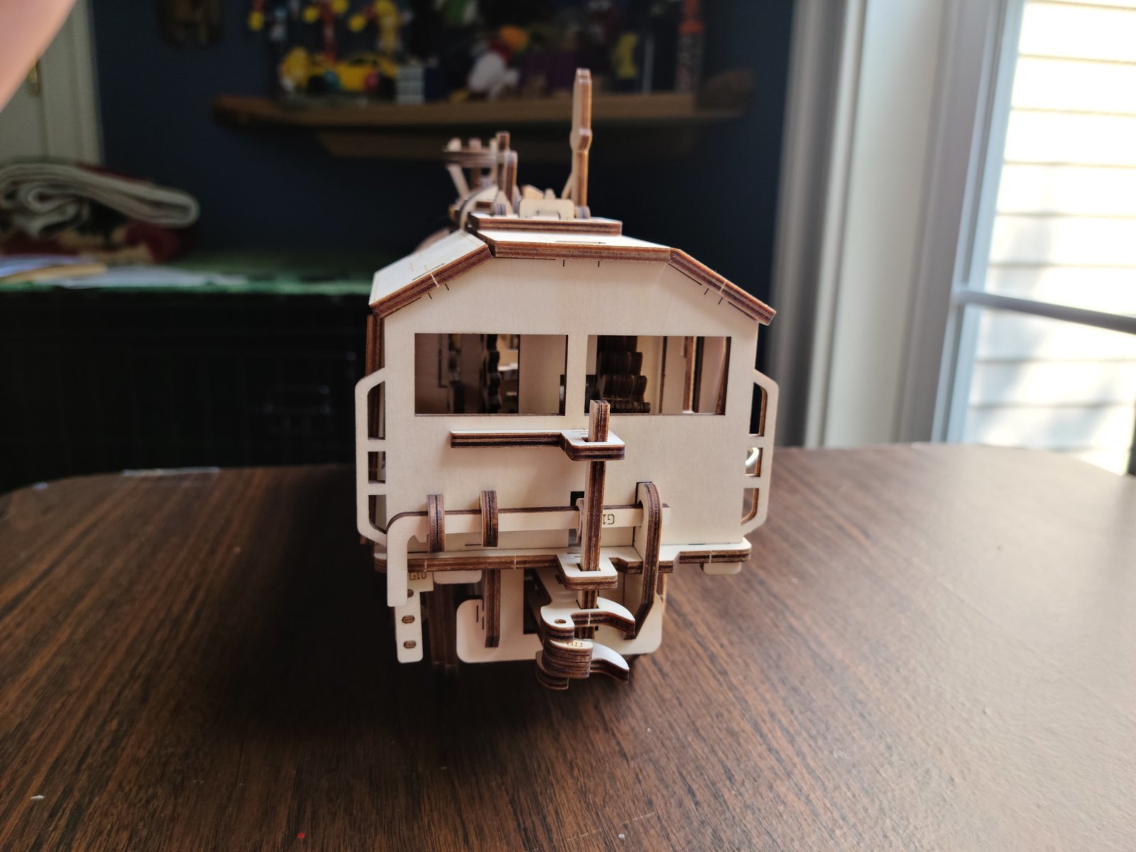

    A while back I started this laser cut balsa type plywood train that's supposed to move under its own power. Done, moves a little then stops. There's a misalignment in the gears that I'm probably not going to look for right now.

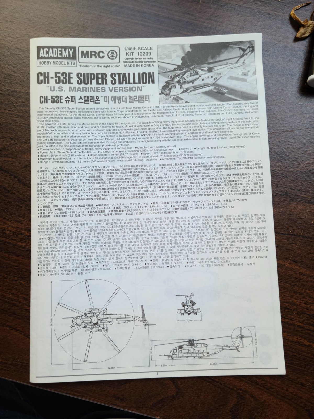

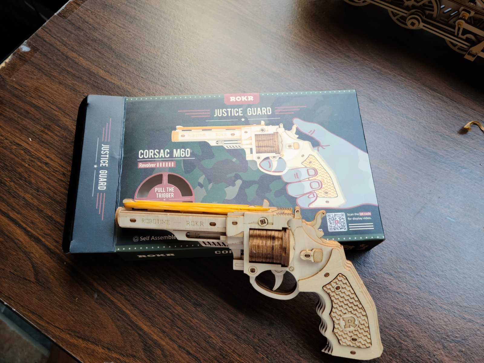

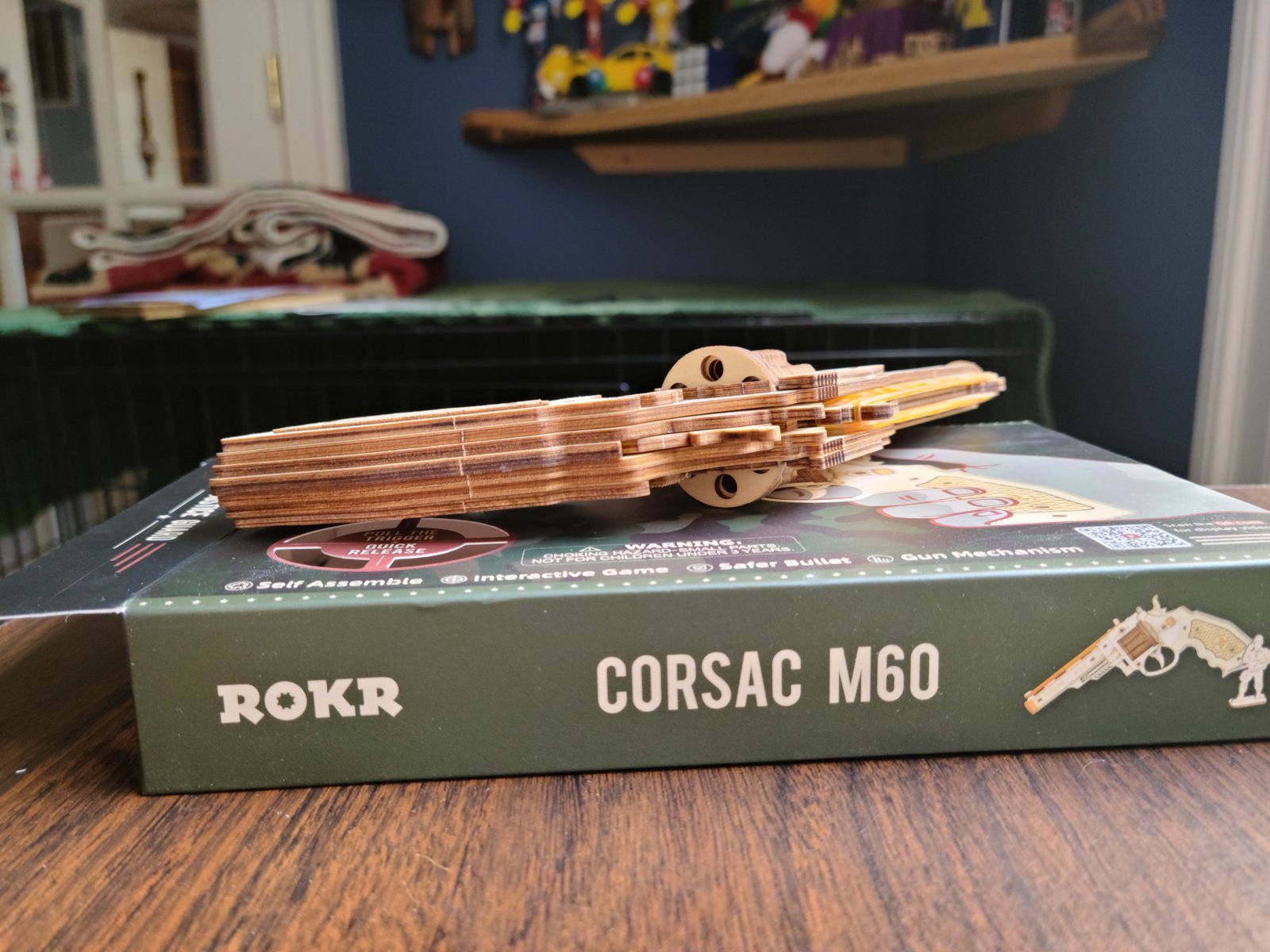

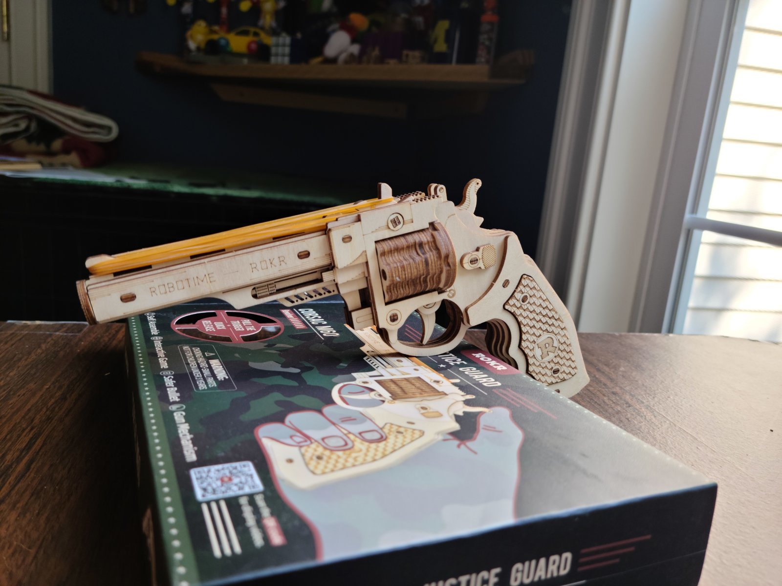

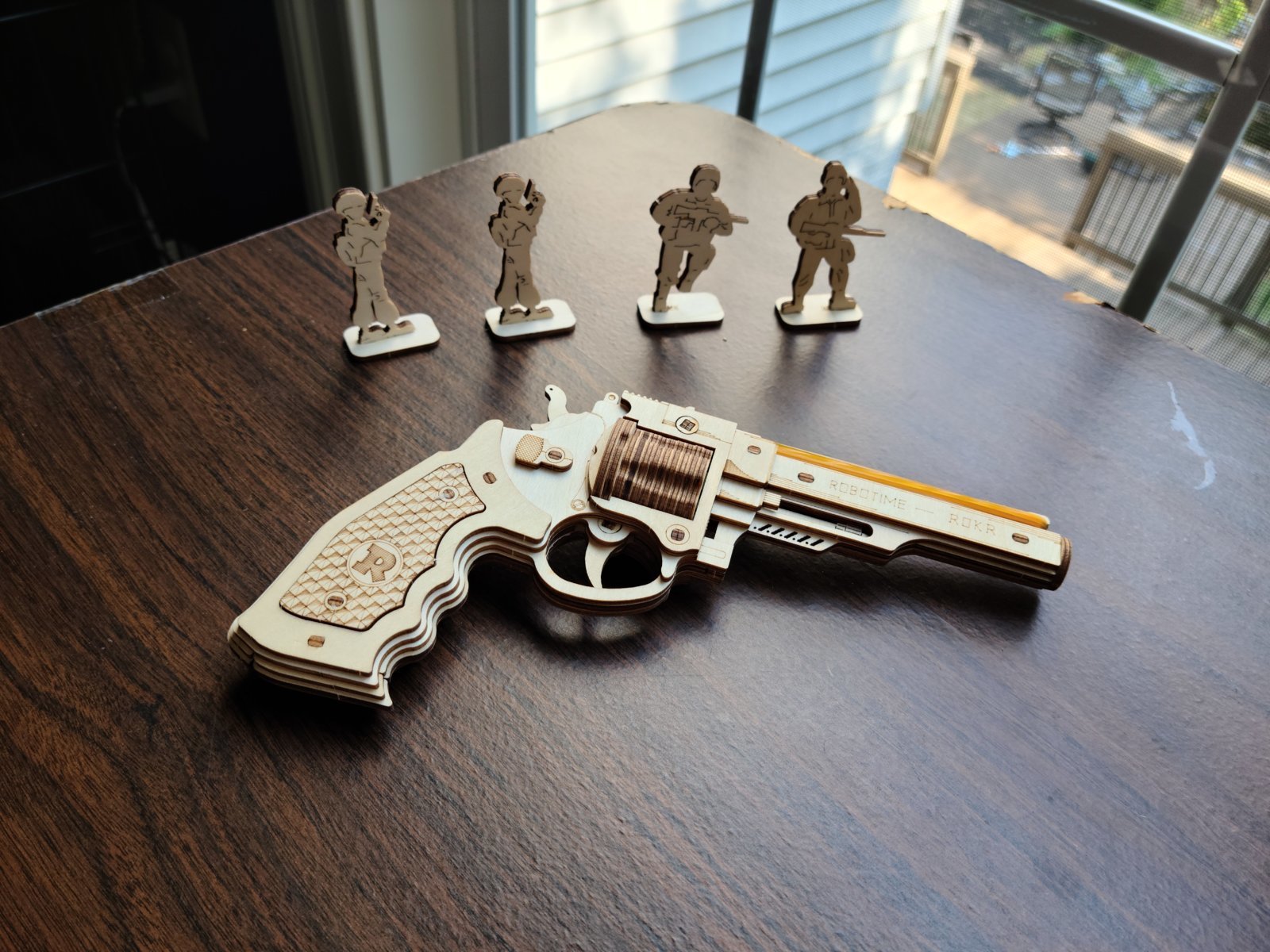

    Then this showed up at Christmas. Corsac M60 six shot rubber band shooter with targets. Loads six rubber bands, pull the hammer back and fire.

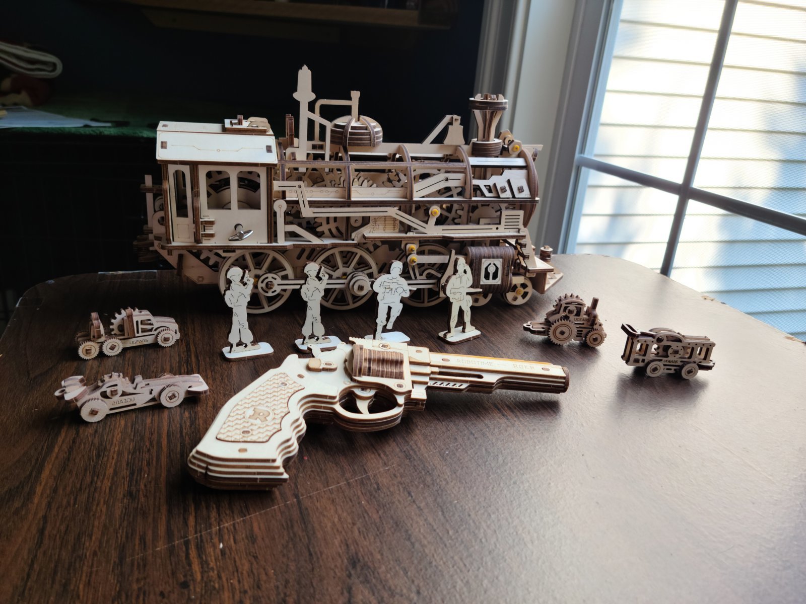

    The collection.
    Maybe this winter I'll finally tackle this.

    Man that train looks cool.

    Frustration aside that it doesn't fully run, I do like it and it will somehow be displayed in my office when we build the new house. There is also a coal tender that I may try and find.

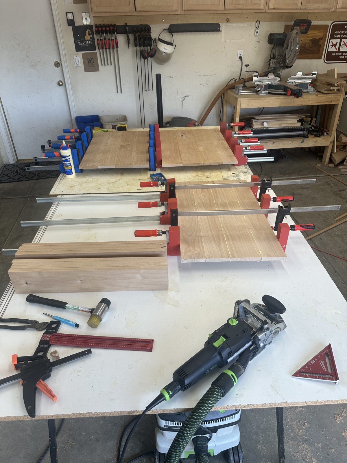

    Glued up the three horizontal shelf panels. Still need to glue up the two vertical divider panels before I can cut everything to final dimensions and dry fit the cabinet.
    I am currently on vacation, so should make a little more progress tomorrow.
    The HF Bremen clamps work just as good as the Bessey. I will likely pick up 4 of the longer ones next time there is a good coupon.

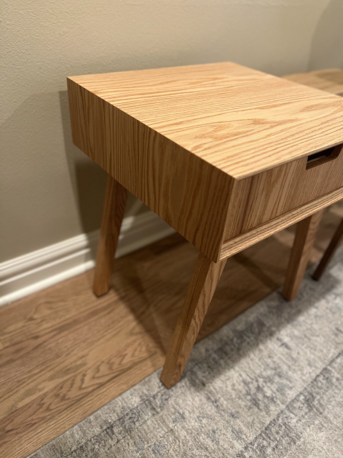

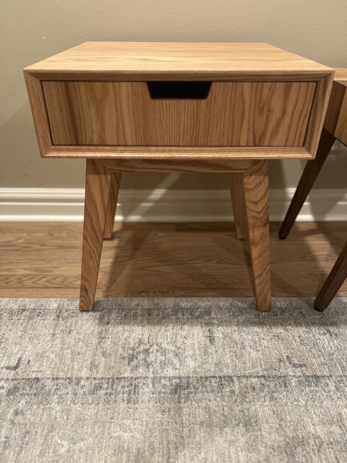

    Finished up table #2, I’m looking for ideas on perhaps different legs for #3

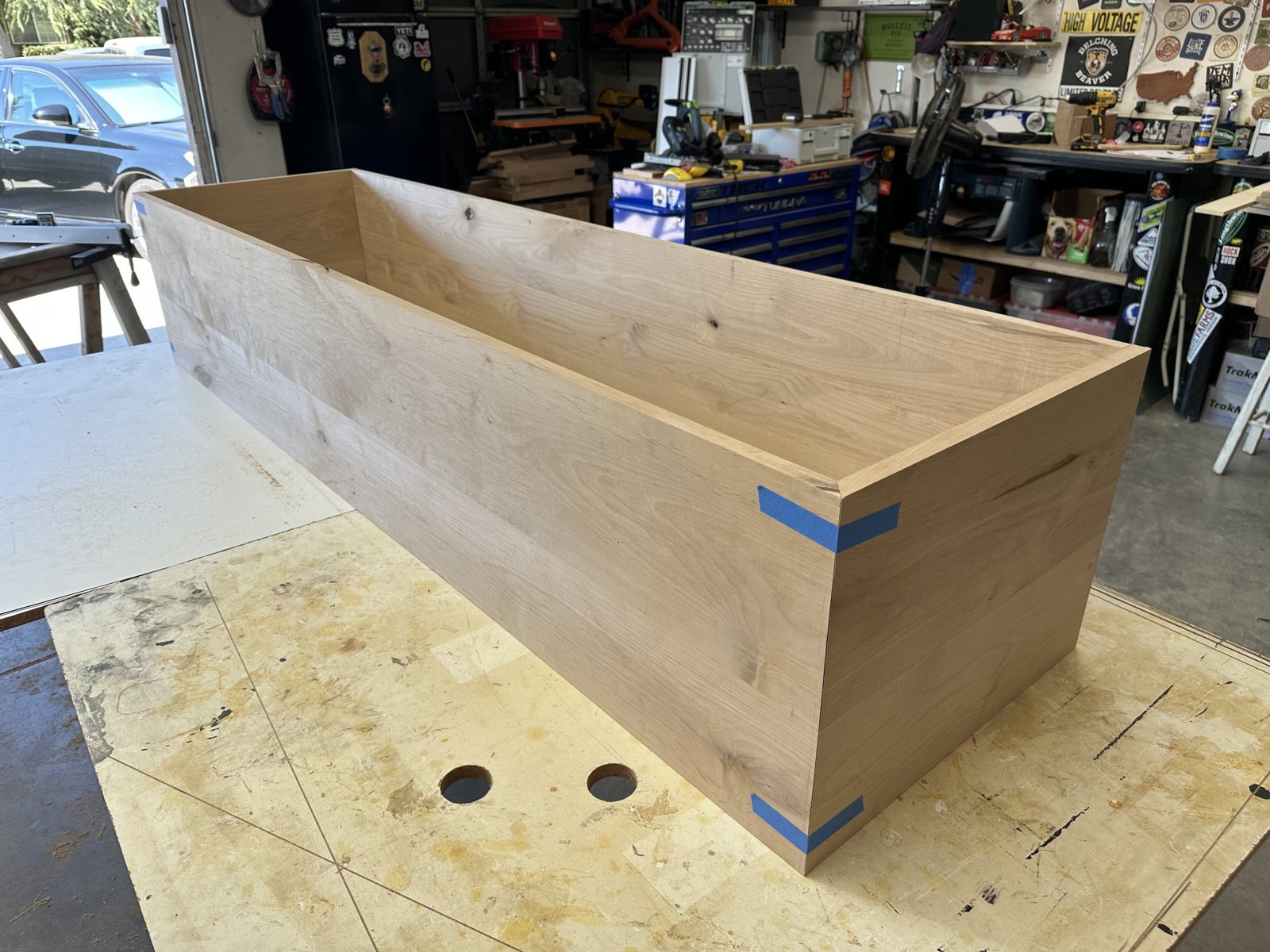

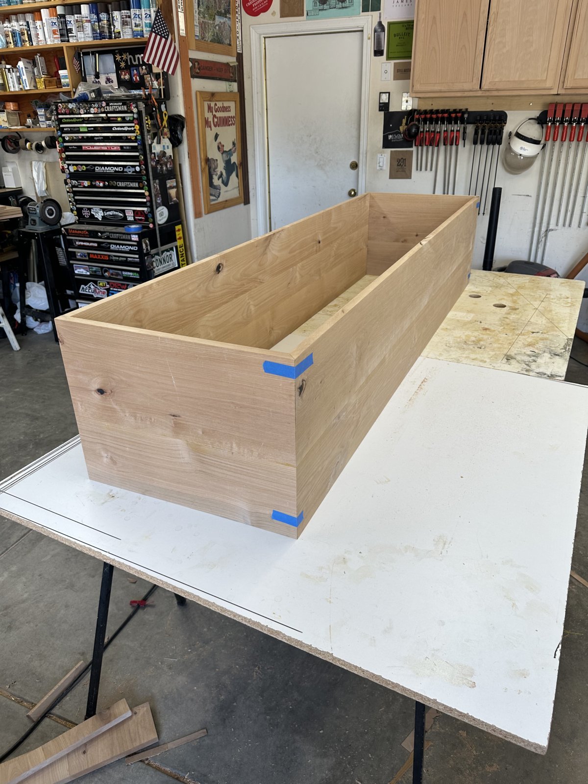

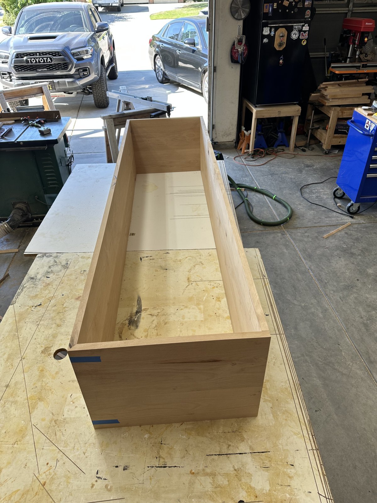

    I have a case! It is only dry fit for now. I think this is the most work that I have put into something so unexciting. Working with these big panels has been a challenge to say the least. My wife helped cut the top and bottom pieces on the table saw to make it a little safer.
    The case is 80” long 16” deep and 21 1/2” tall. The top is miter cut and the bottom is a simple but joint. It will have 4” legs later and be divided into 6 compartments. The top 3 will hold my left, right and center channel speakers and be covered in grill cloth. The two bottom sides will be drawers and the bottom center will be open for my receiver and cable box.
    When completed a new 85” TV will grace the top.

    If it has a back panel, I would have a out panel matching the exterior size and a secondary inner panel that matches the interior size fused to external ... for strength. I you want "mostly open" instead of enclosed, you can do the same two-tier with just a border-strip along the wood edges that still reinforce the corners from flex/collapse. Interior shelving helps, but that two-tier that touches all inside surfaces along top/bottom/sides was used for a nightstand I wanted to be rock-solid.
