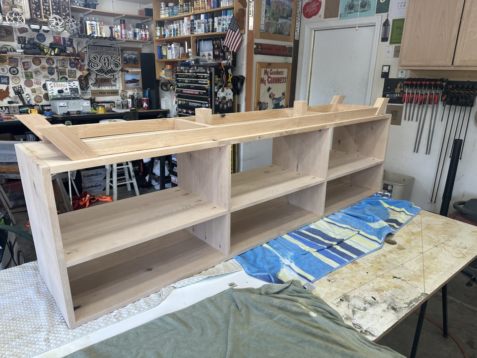

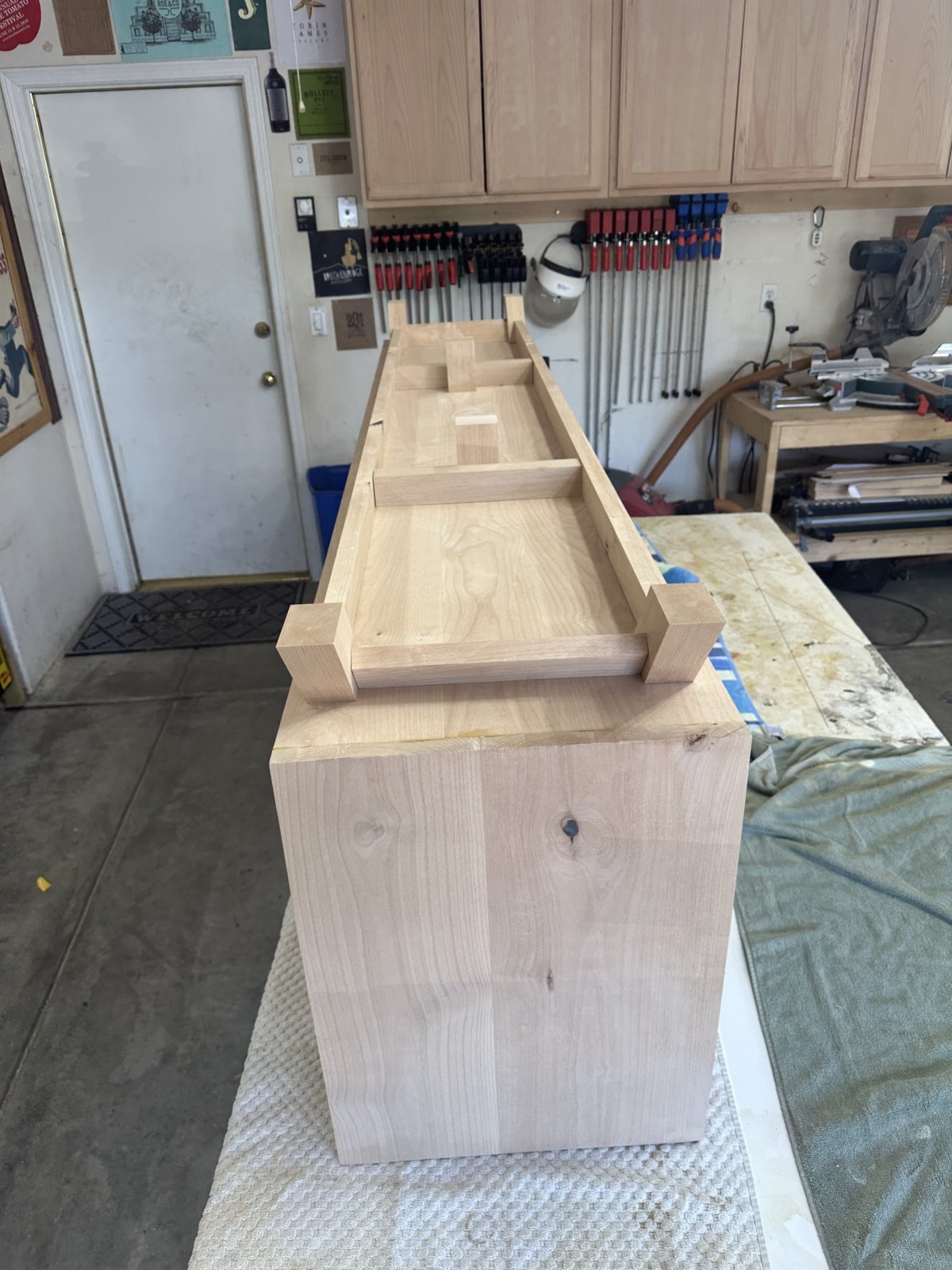

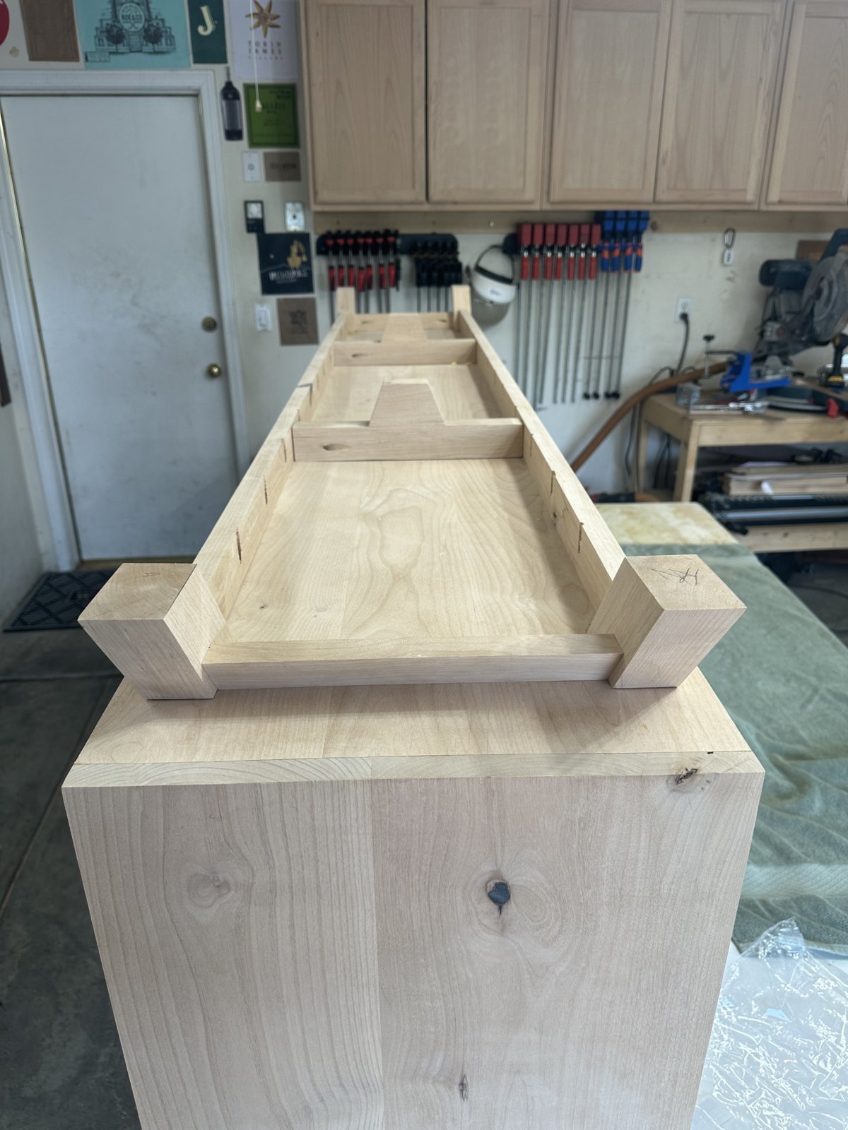

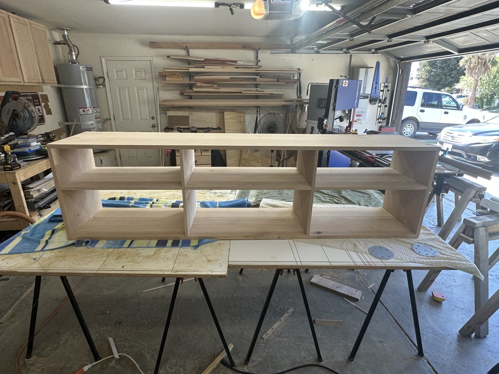

    I like what you're doing with the base. The ends look great.
    Thought for the middle ones, why not just glue them to the bottom of the frame with the side grain? Put a 45 on the ends to hide them a little. And you'd have a single profile on the frame from the front on the cross members. May even look like one piece of wood.

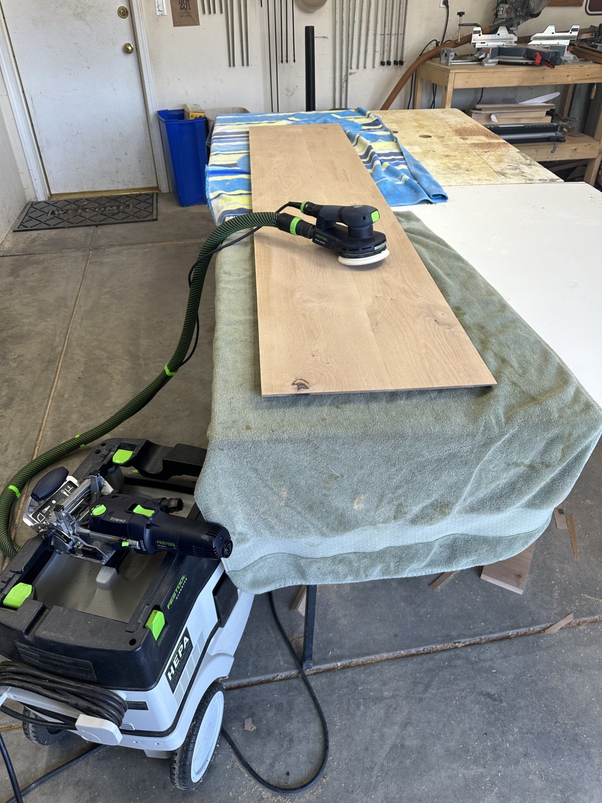

    Odd, with my Festool sander, I can sand for hours with no buzzing.

    Looking good, like those legs!

    When is use, the two inboard "posts" will mostly hide. If you want slightly better strength to keep them from buckling, try a flat "H" shaped sheet that hides inside that center portion, locking those "posts/legs" into the center space with the open top/bottom of the "H".

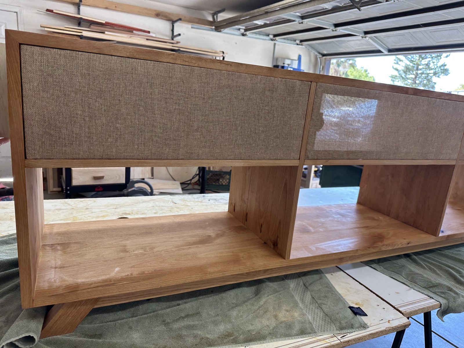

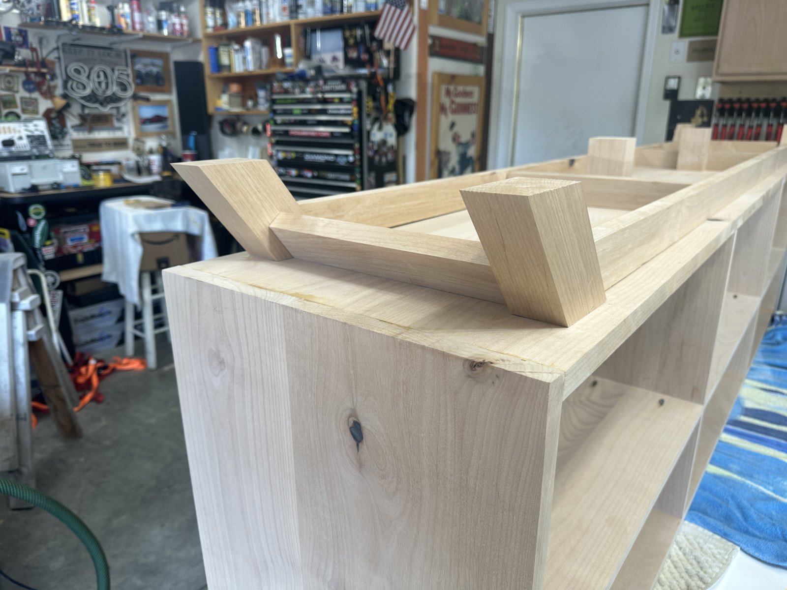

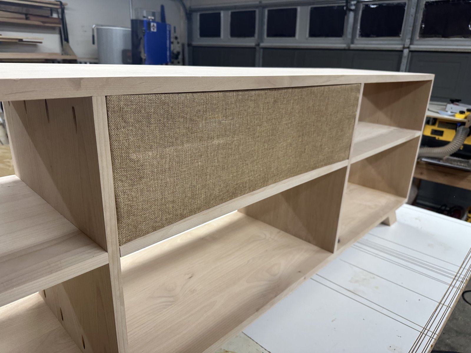

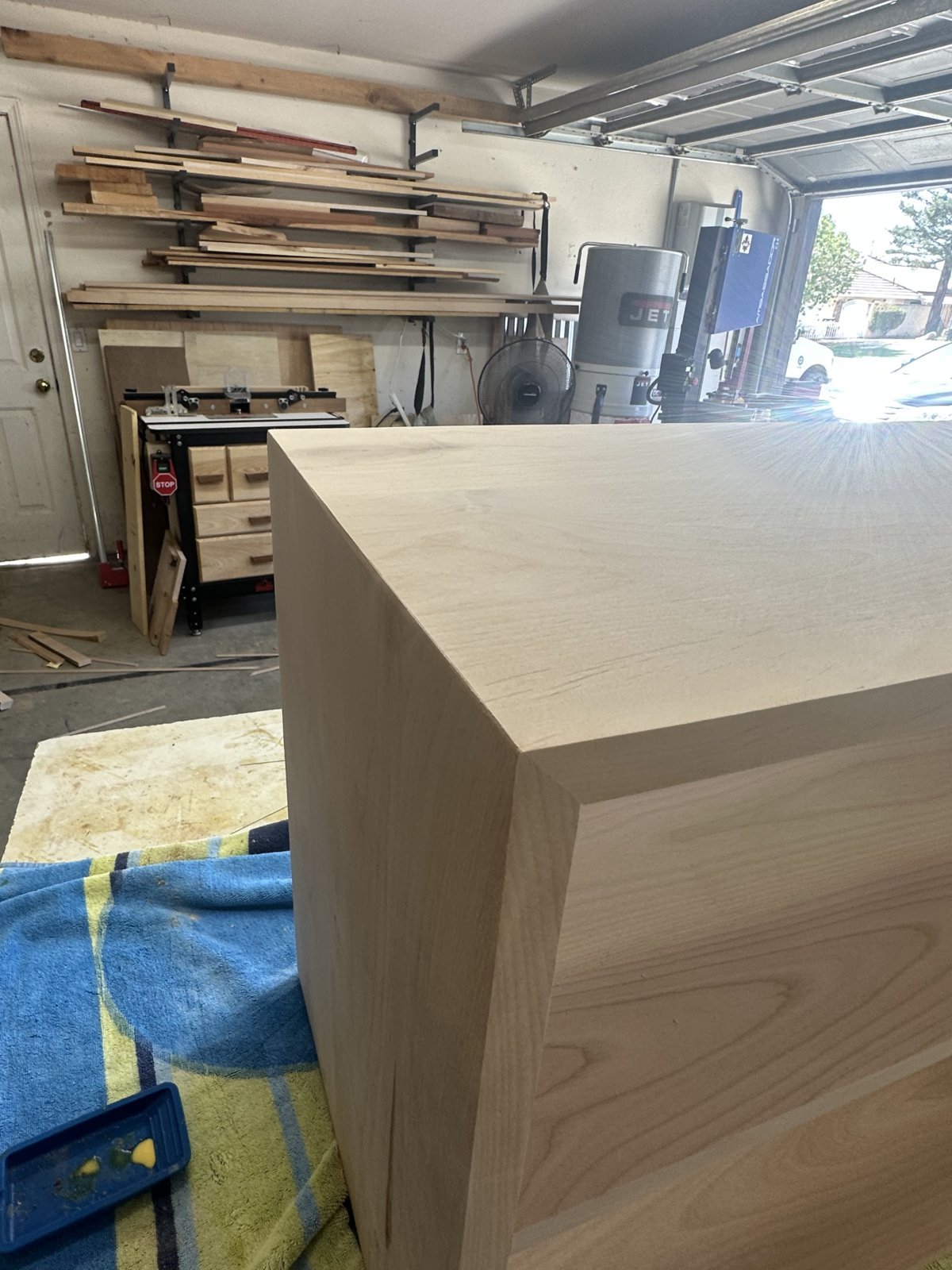

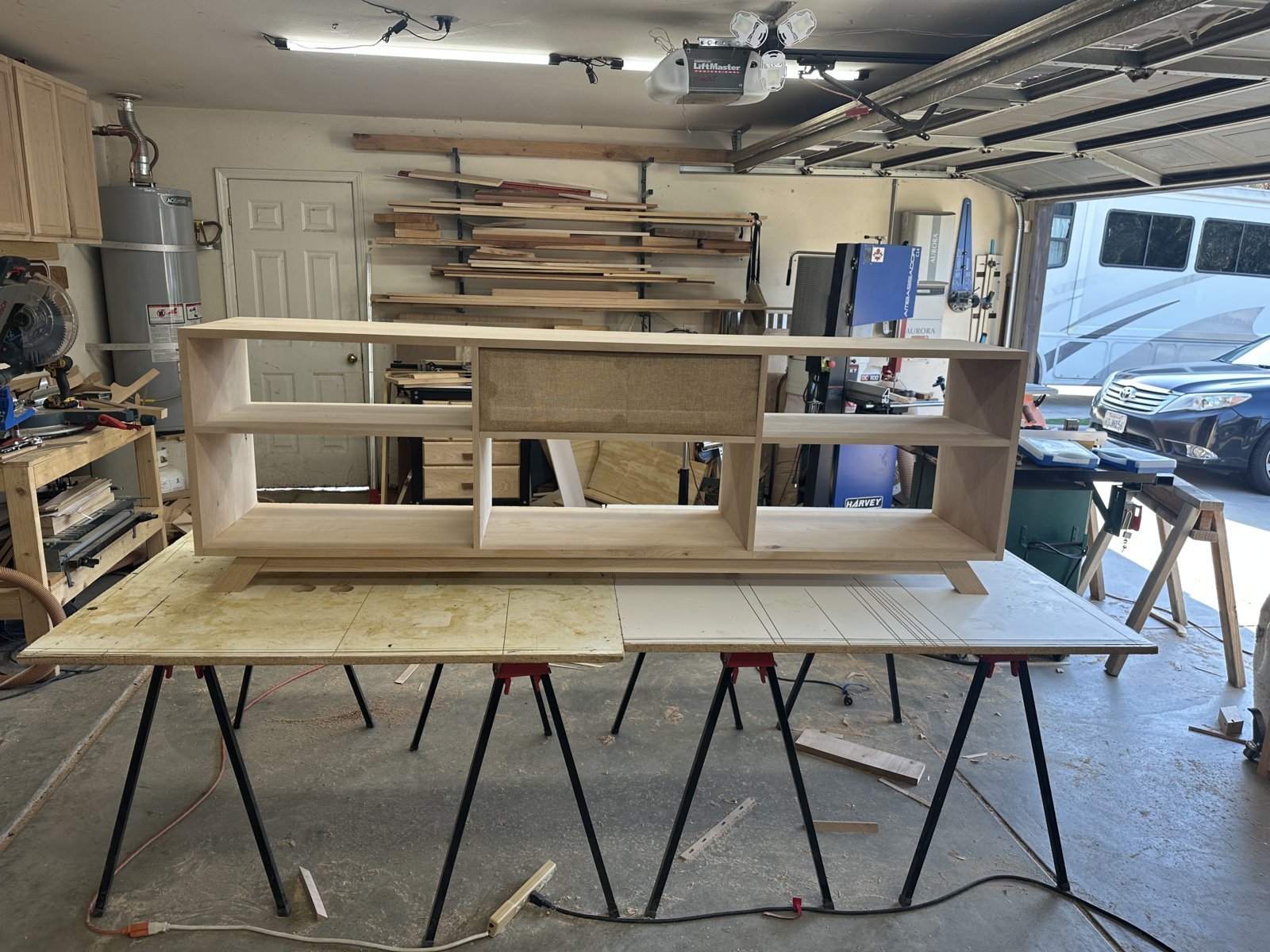

    The leg situation has been solved and the base is now attached. The center legs are invisible unless you lay on the ground. The whole structure feels very stable / strong.
    Center section grill is mocked up just to see if I like it and I do.
    Currently you can see an outline of the frame from backlight. This should not be an issue once it is pushed up against the wall
    Need to make the other two grills and finalize their placement. They will be held in place with small magnets that will keep the center from bowing in like it currently does.
    Then finish with Natura one coat. Drawer slides will hopefully be here before next weekend then I can build the two bottom drawers and be finished with this project. Then I can order my new TV for it!
    This has taken me much longer than I originally anticipated, but the final outcome will be worth it in the end.

    Looks solid!

    The human eye is worthless at measuring distance, but can easily pick-up "out of square". I see what is basically "squared up".
    Nice work.

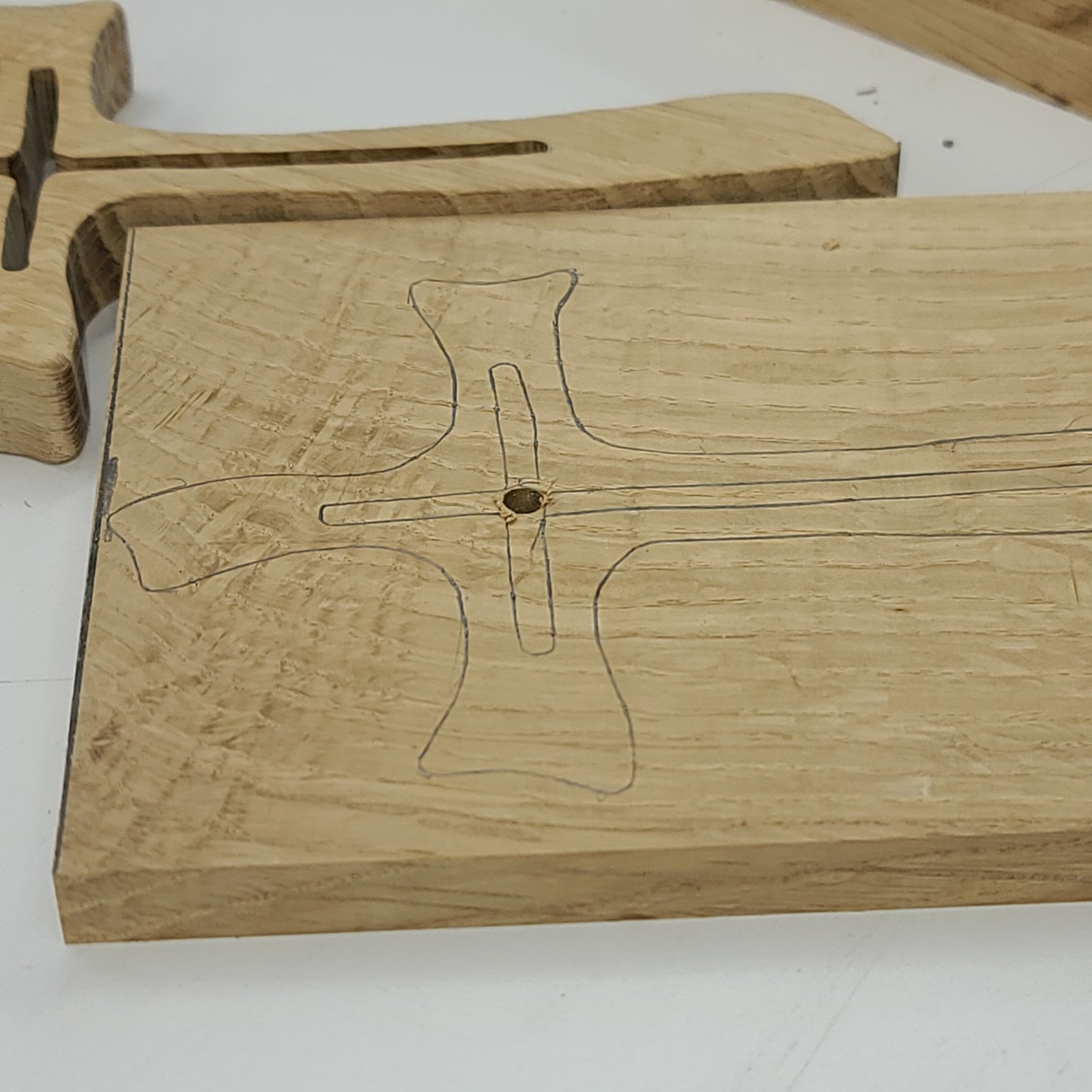

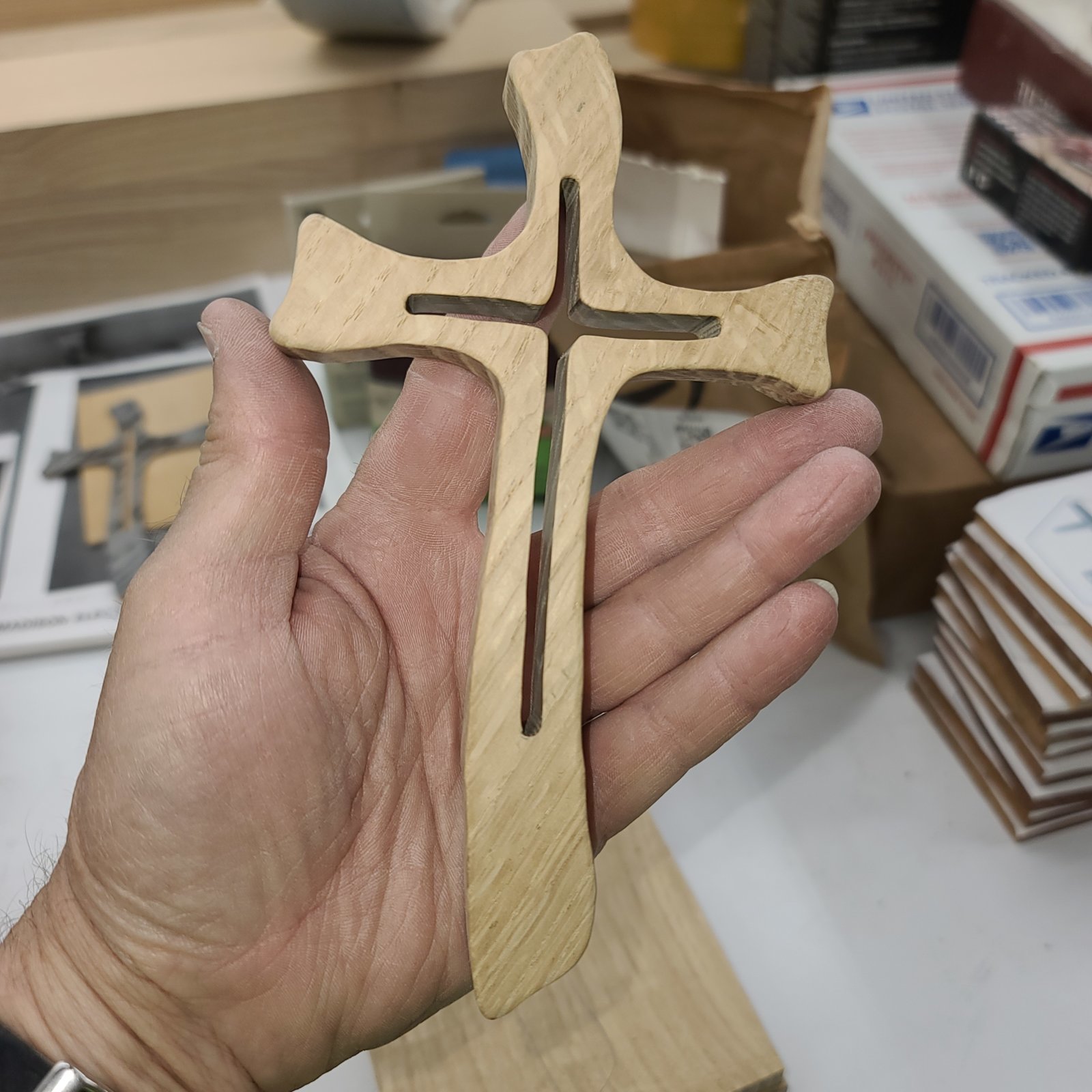

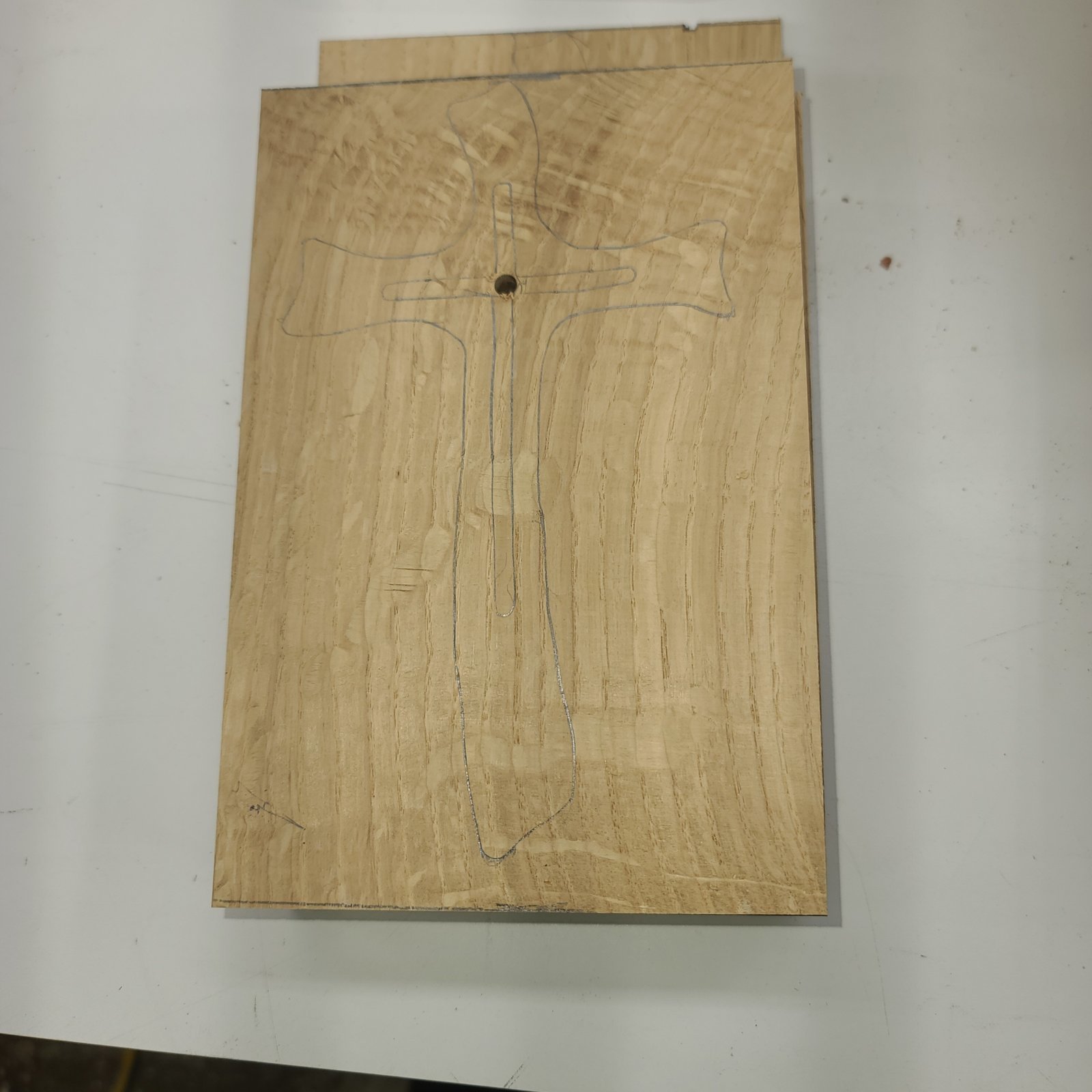

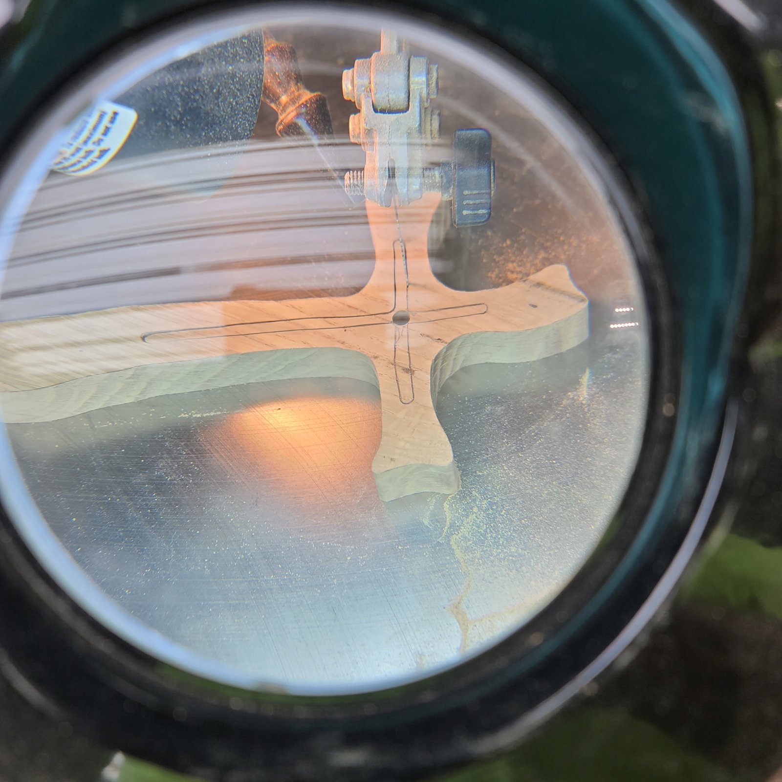

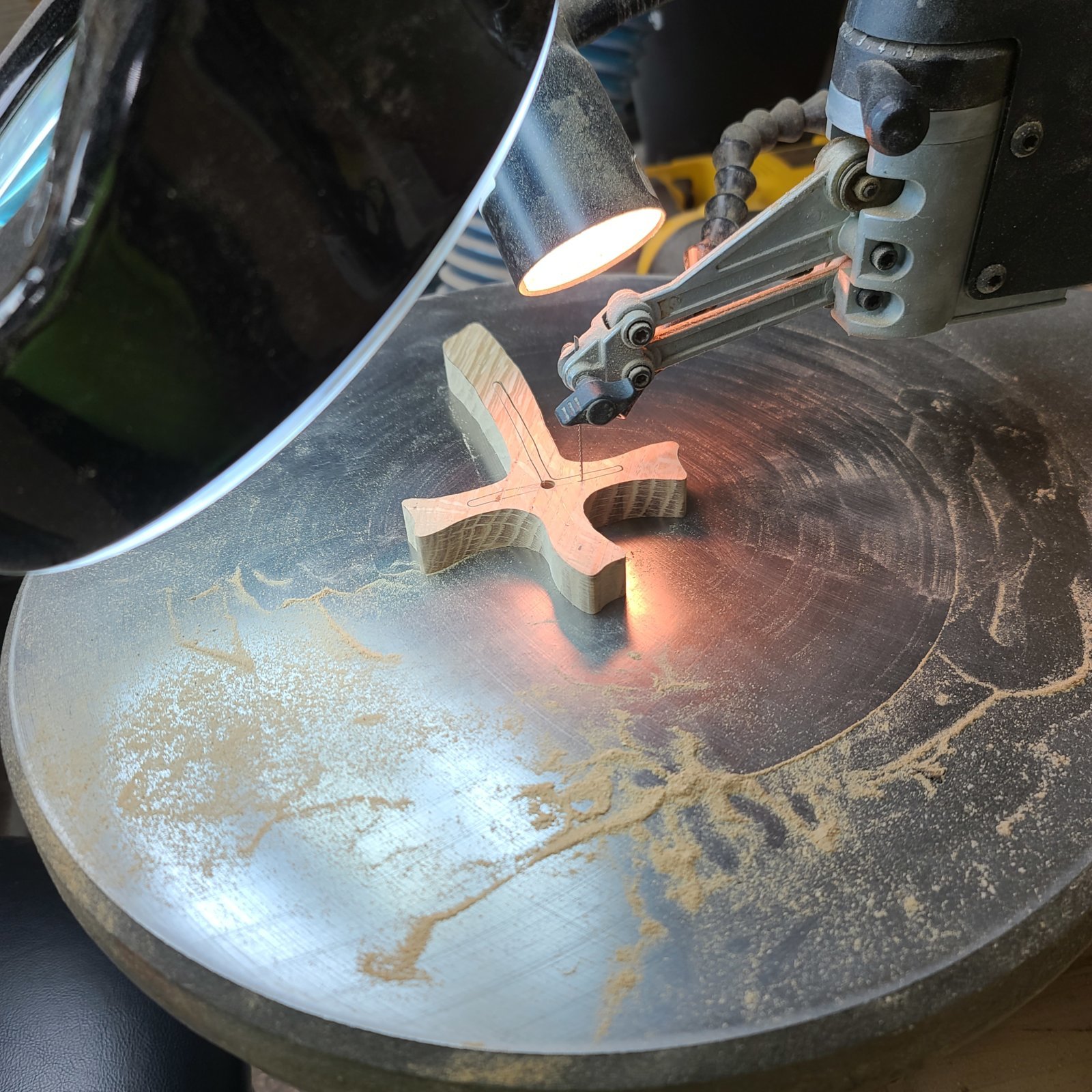

    Still in scrolling mode, I'll be doing this for awhile. Scrolling is a nice break from all the other things I ha e going on. Eventually I'll get back on the workbench project.
    Also making some crosses for the church. This is some oak pallet wood scraps.
    A lighted magnifying lense helps with my old eyes.
    Actual size, lol.

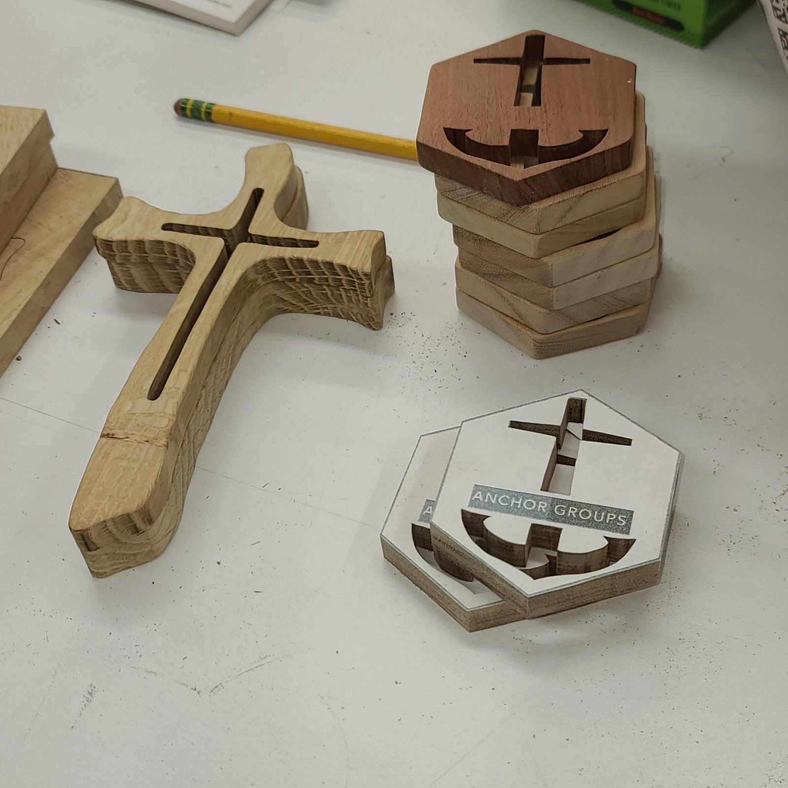

    The final result, just needs to be oiled for a finish.
    After cutting the first one I reduced the thickness from 3/4" to about 1/2" It cut much easier, oak is pretty hard.
    So I've been making some progress on the church giveaways.

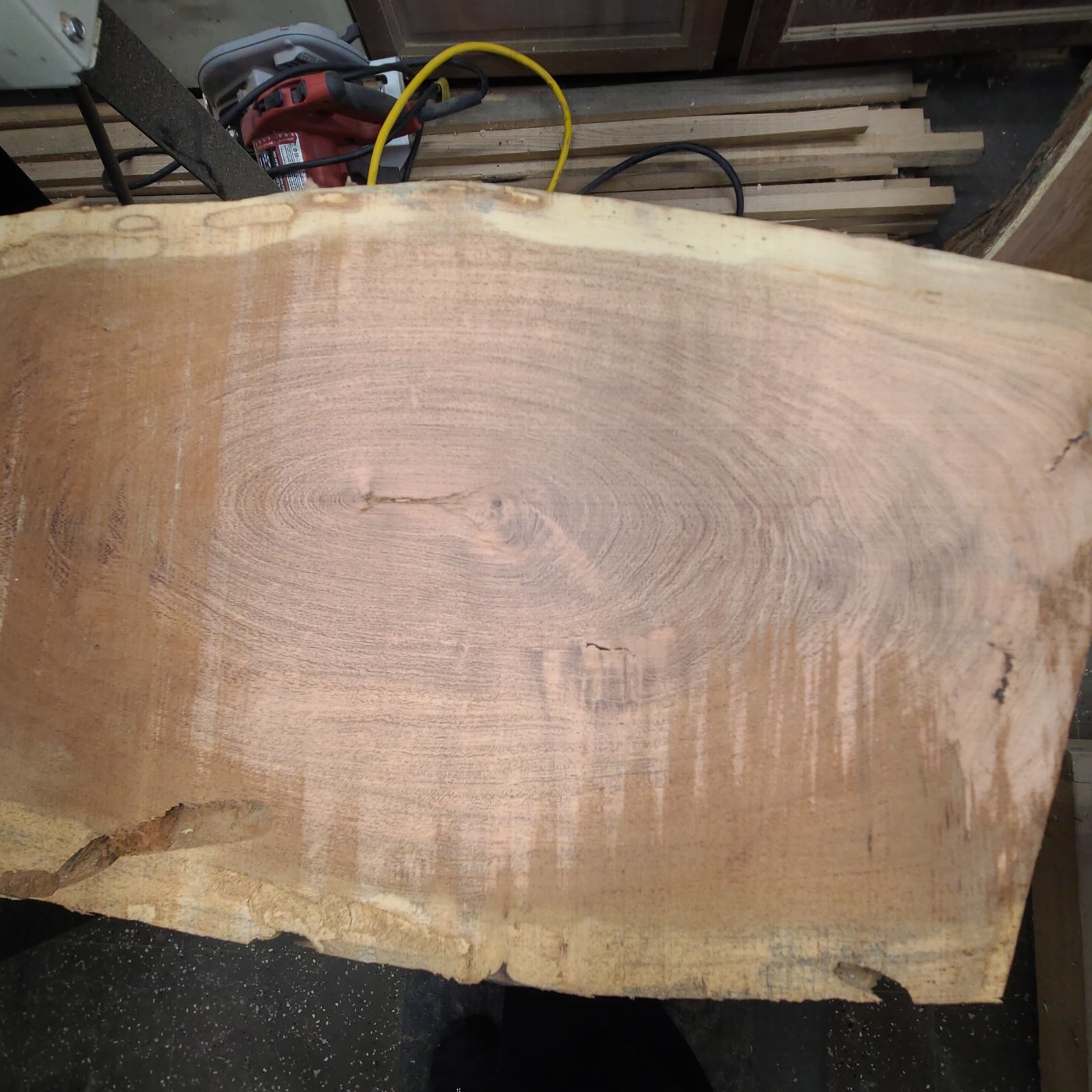

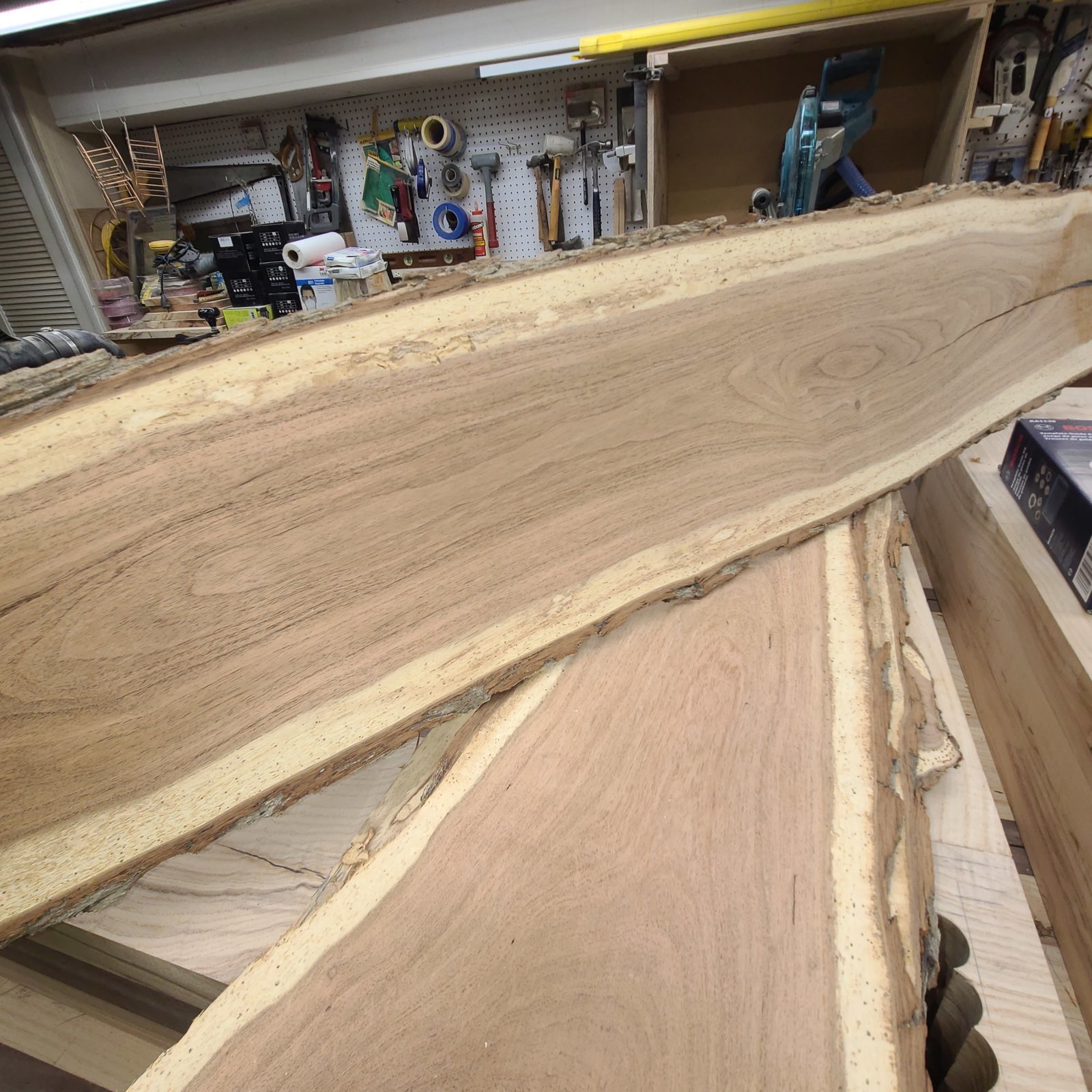

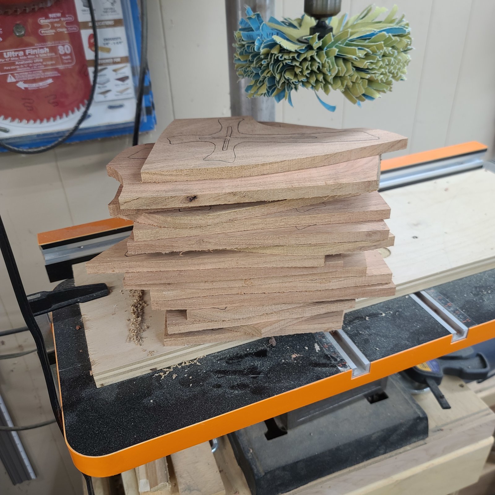

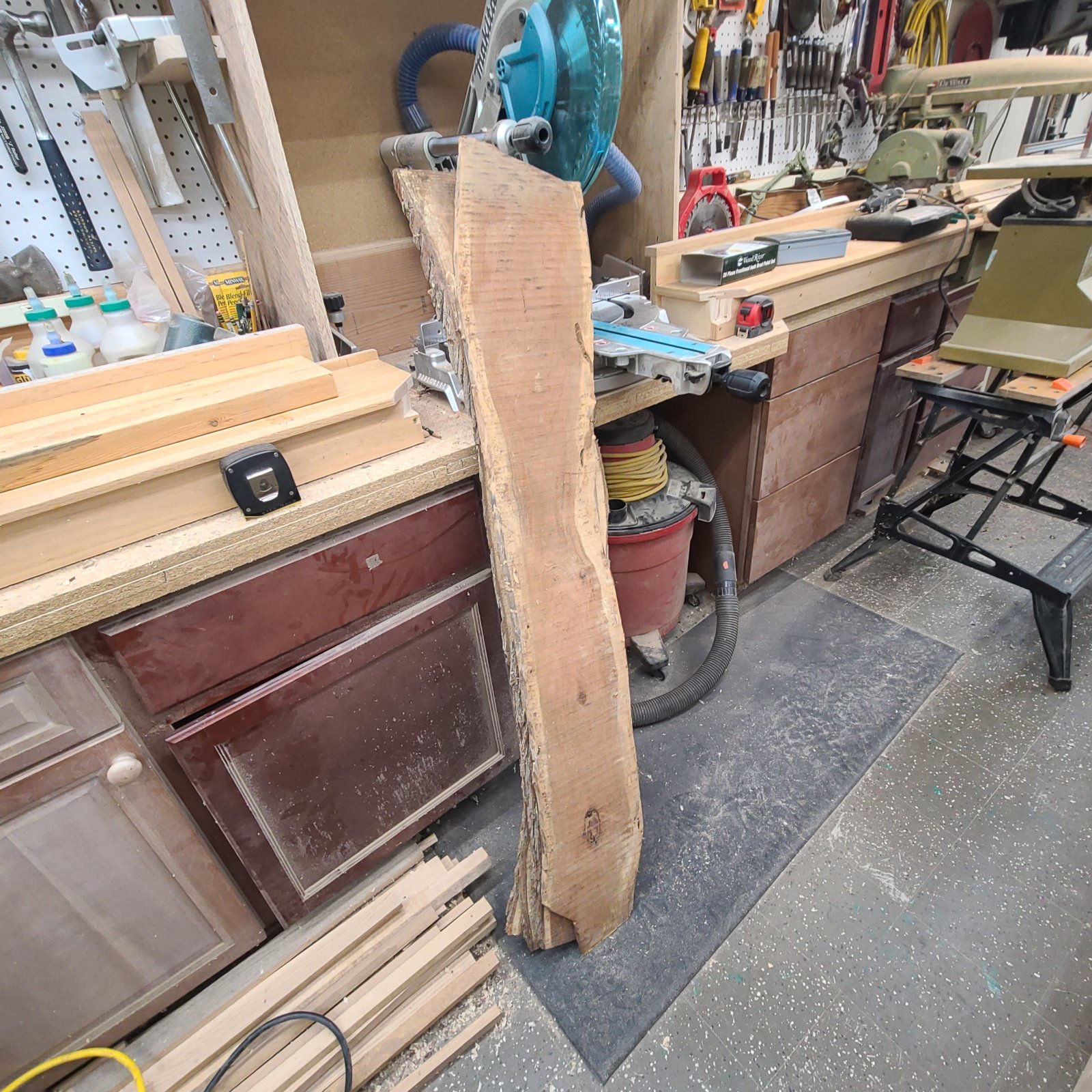

    I visited a friend a long time ago in Texas and he gave me a bunch of Mesquite thins. I've had them in my stash for a long time waiting for the right project. Thins are great for scroll saw work and I needed some more blanks for the church cross project I've been working on.
    So I grabbed a few boards. They are rough sawn right off the band mill. Many years dry in my garage.
    We don't get Mesquite in Michigan so this is a treat to work with.

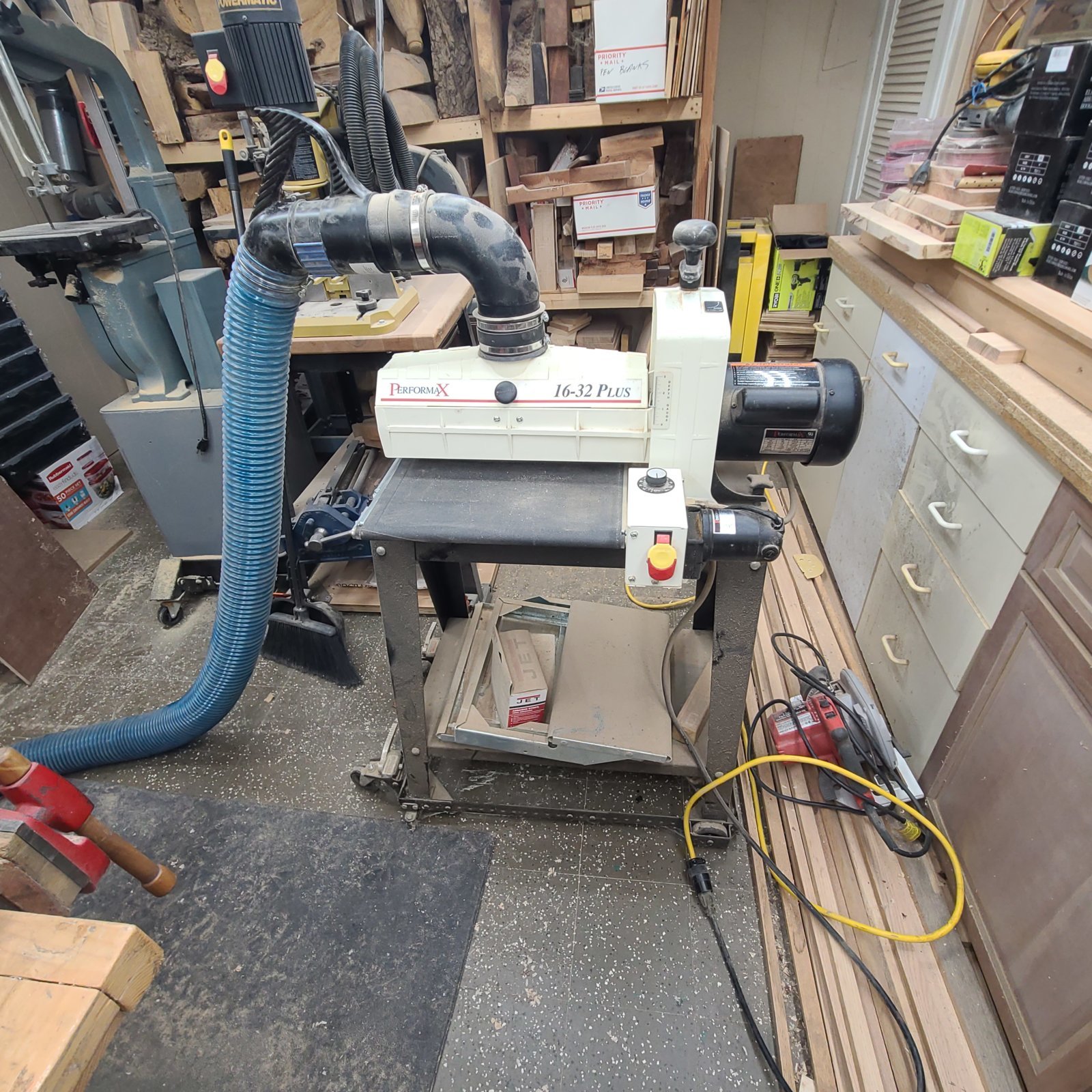

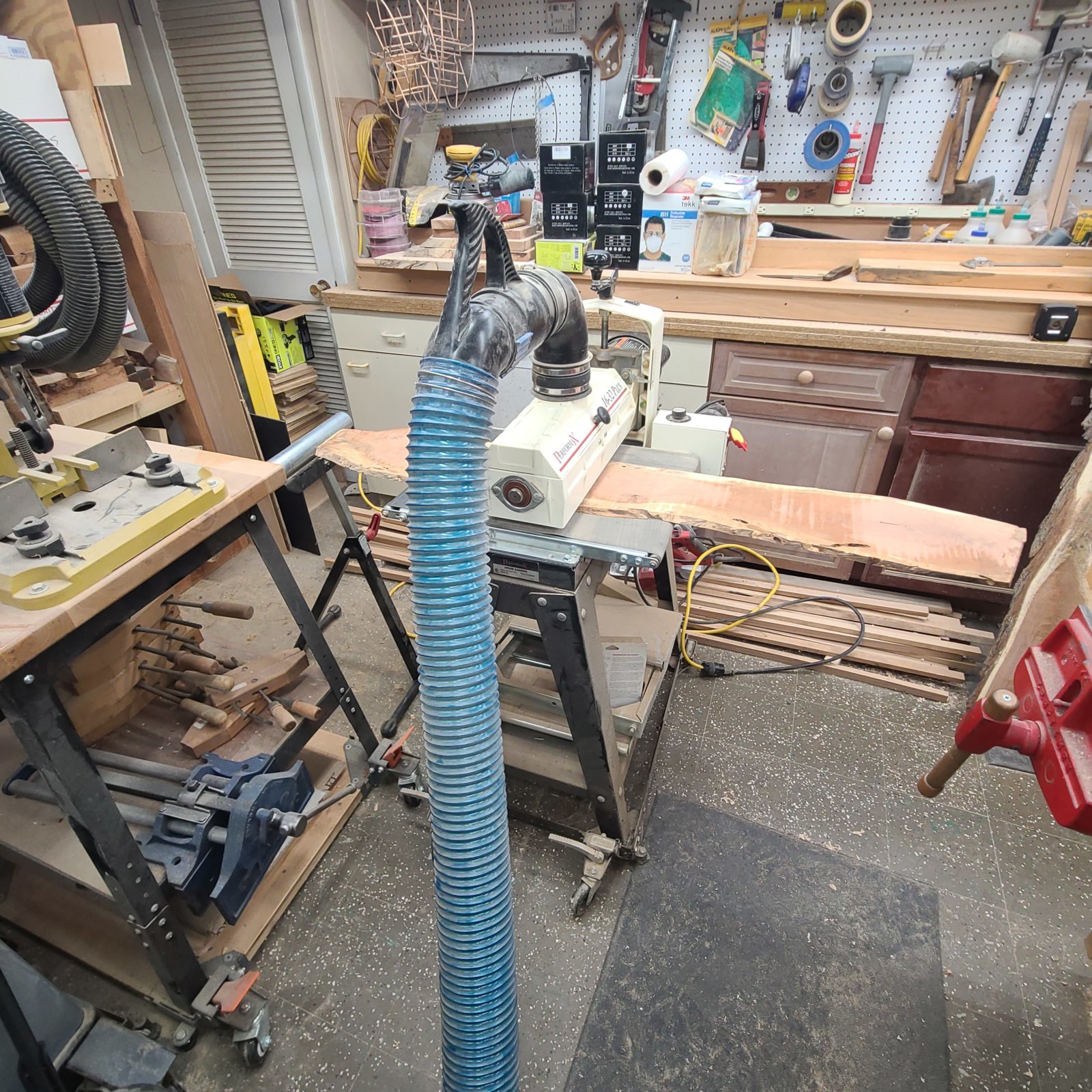

    I set up my drum sander.
    And ran the boards through, a few slow passes on each side.
    It sure is pretty wood.
    20240729_170756.jpg They cleaned up at 3/8" perfect for scrolling.

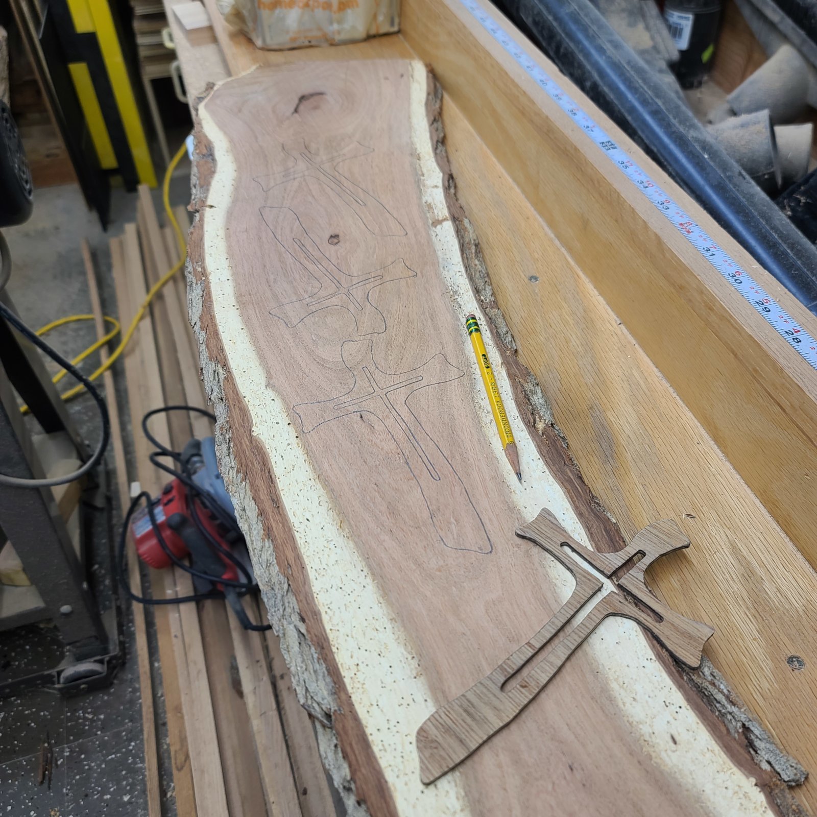

    I layed out some patterns and worked around knots and splits.
    And then i cut the to rough size on the bandsaw. I got another 16 blanks out of 3 short boards. Just gotta drill the entrance holes and scroll saw them out.

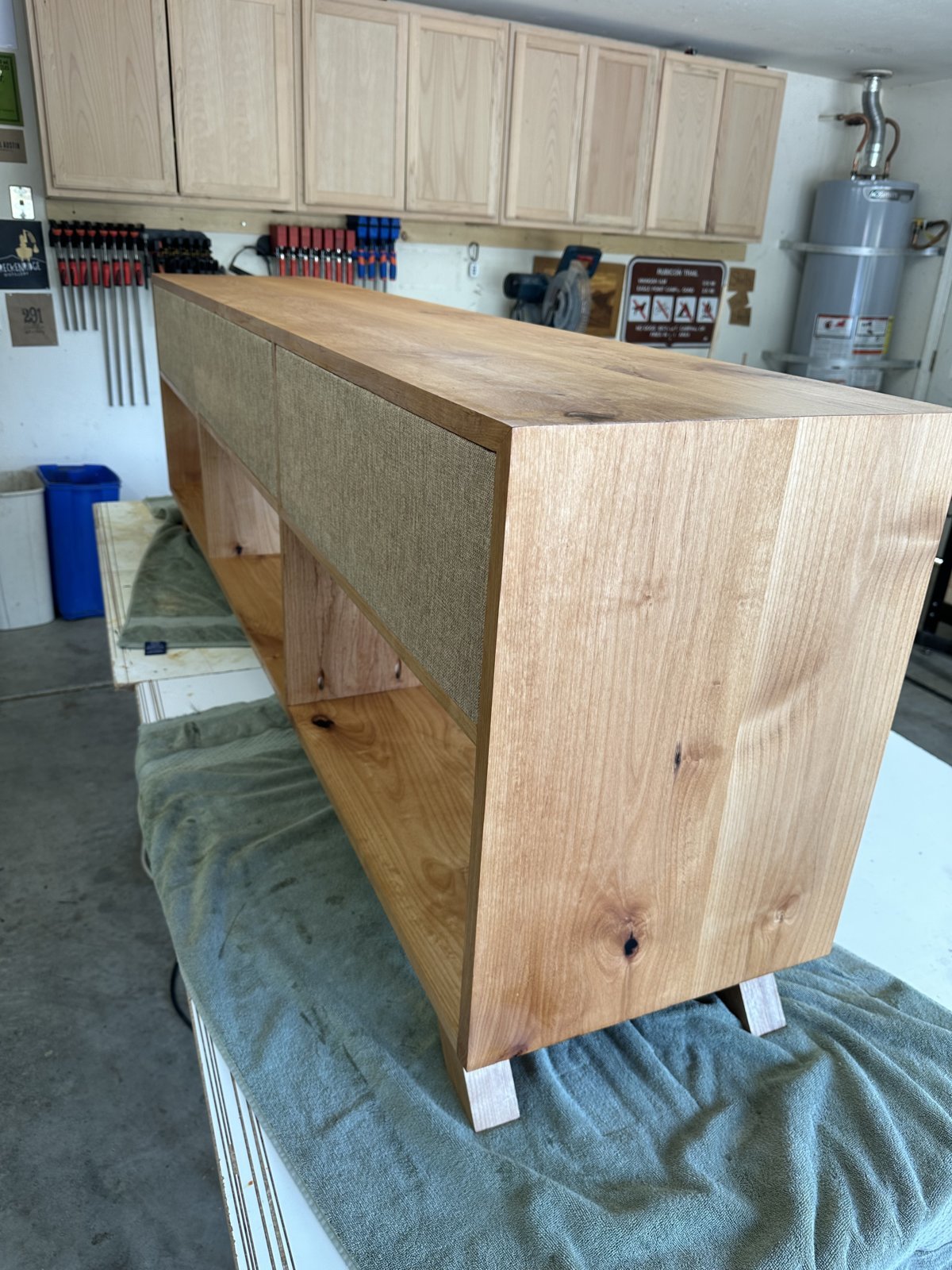

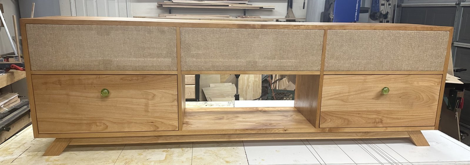

    I am calling it finished.
    I may end up remaking the drawer fronts sometime in the future. The dark pieces of the panels are bothering me a little. They were made out of the last of lumber that I had left over. I will see how much it bothers me once I live with it in the house for a while.
    Next up is a coffee table to go with the chairs and tv console.

    Looks good to me. I would just categorize the "dark spots" as "giving the console character".
