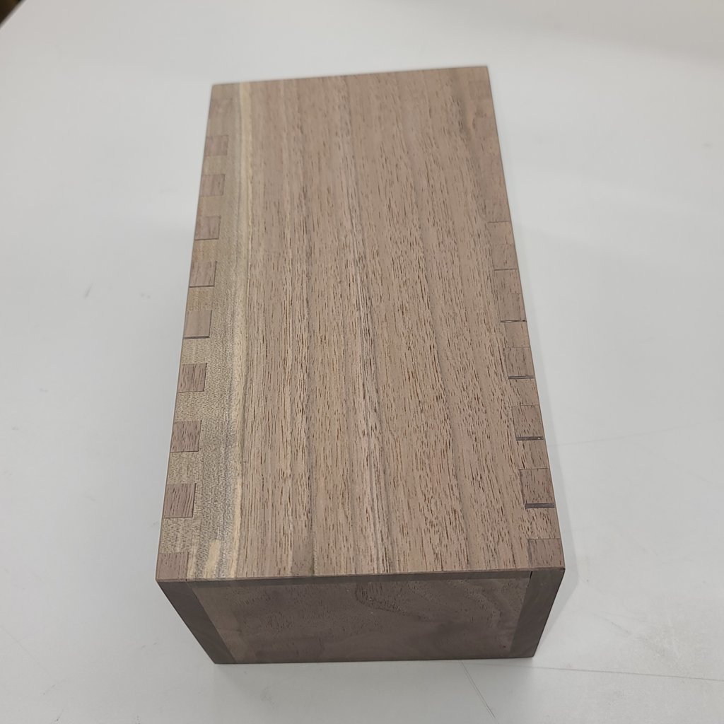

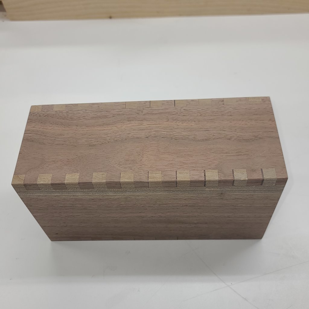

    Making a box for a.post office box door for a friend. Finger joints came out a little tight at first, so I recut them and now they are a little loose. Oh well, I'm not starting over, the door fits perfectly. I'll make some filler with glue and walnut sanding dust.

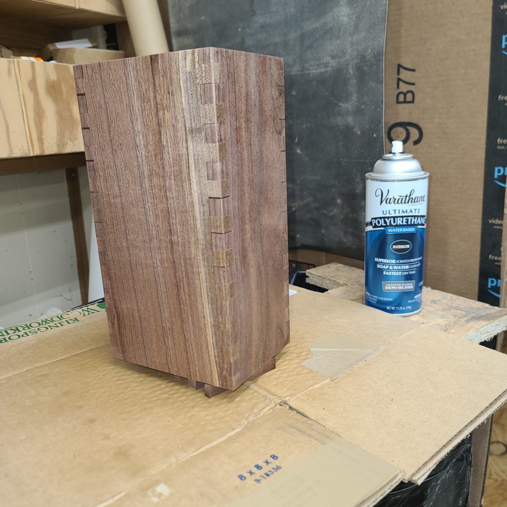

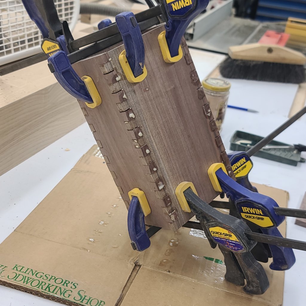

    Box is out of the clamps and first sanding is done. Gaps need filling.20241227_123217.jpg
    Made up some filler with walnut sanding dust and some tb3 glue.
    Forced it into the gaps. And glued the end cap in.
    Sanded smooth again.
    It's passable, lol.
    It'll get a few coats of water based spray satin polyurethane.

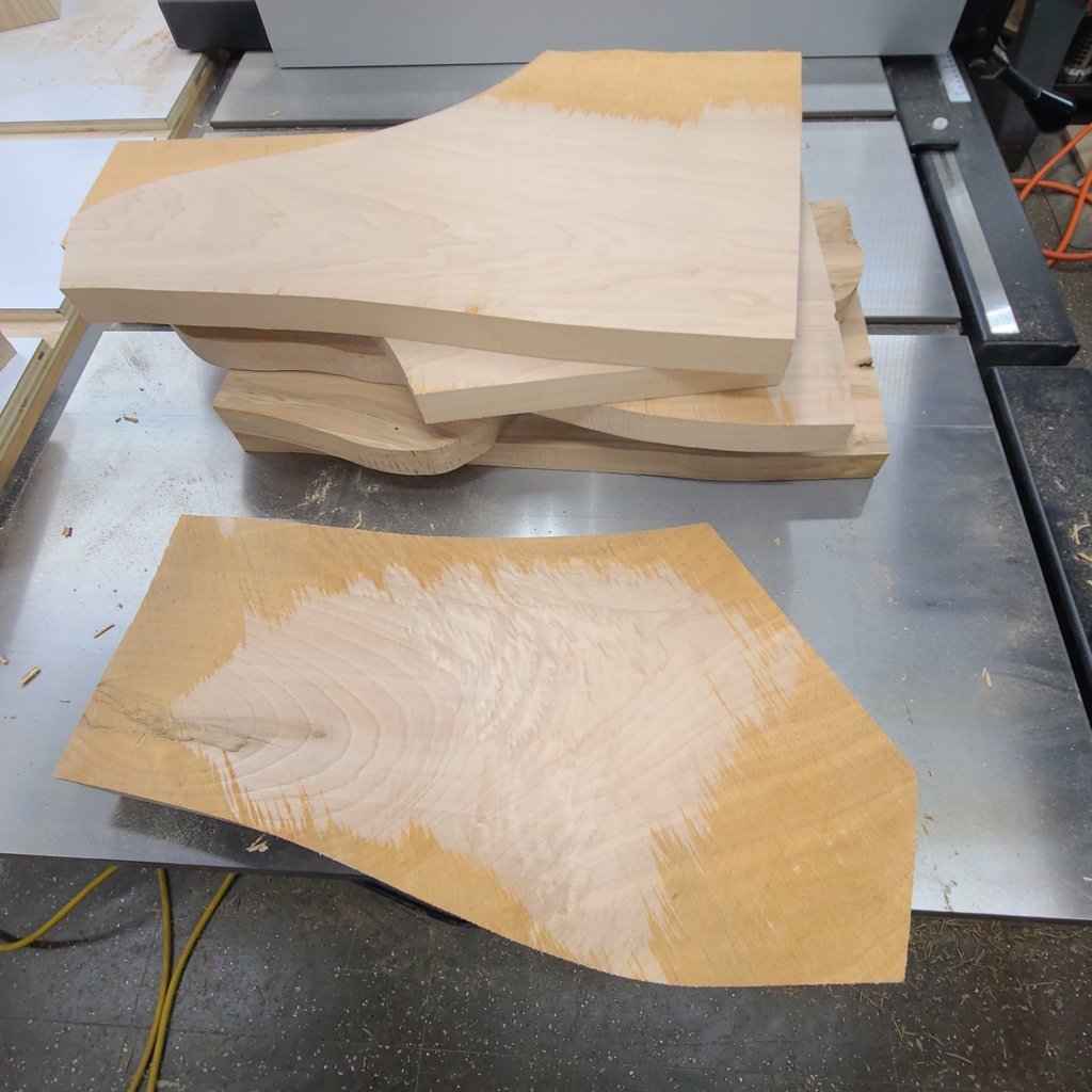

    While the filler on the box was drying I started prepping some stock for the next project.
    A few random boards of maple. Pattern traced onto them.
    I cut them out of the boards and ran them through the planer.
    Cleaned up at 3/4" now I need to retrace the pattern onto the blanks

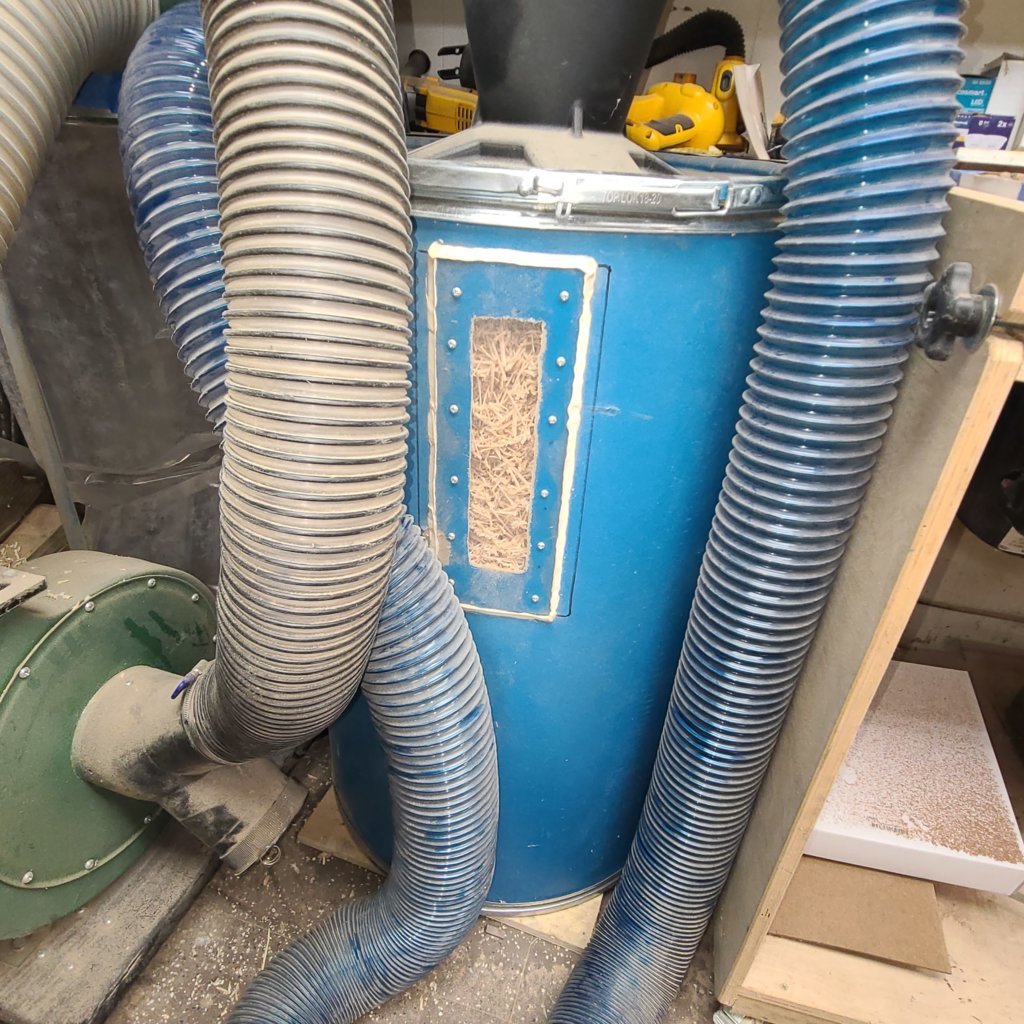

    Filled the dust collector drum again.
    This planer makes really long chips. I think a Byrd shellix head will be in its future. They make smaller chips, run quieter, and make it really easy to change the cutters. I already upgraded the jointer.
