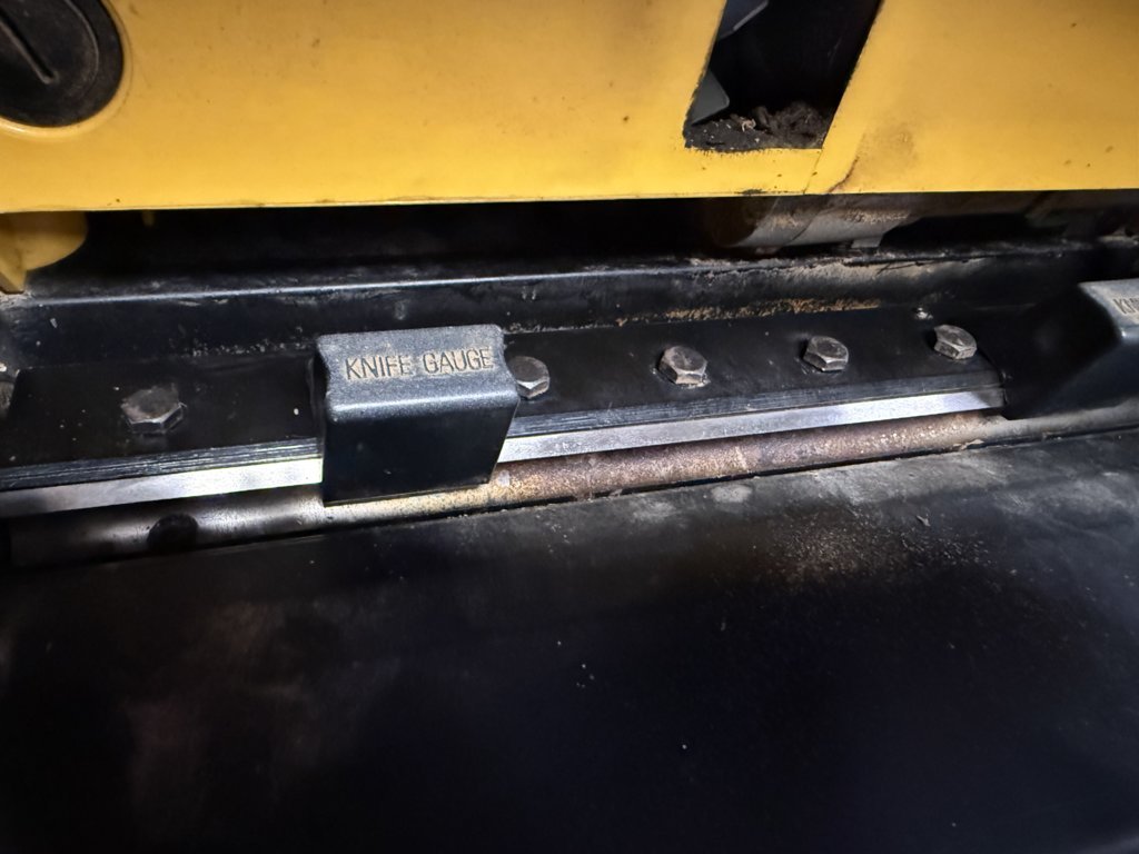

    Let’s get back into woodworking I said, it’ll be fun I said
    replacing knives on a planer

    Now let’s go plane some boards and make some noise!

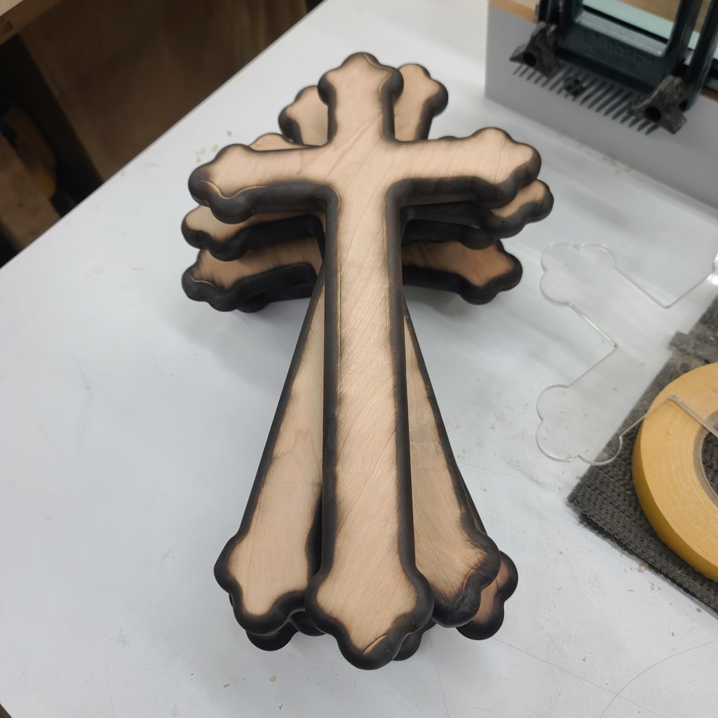

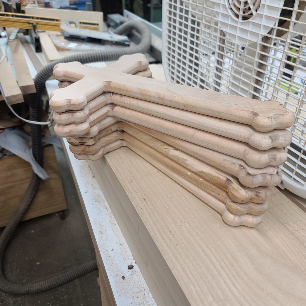

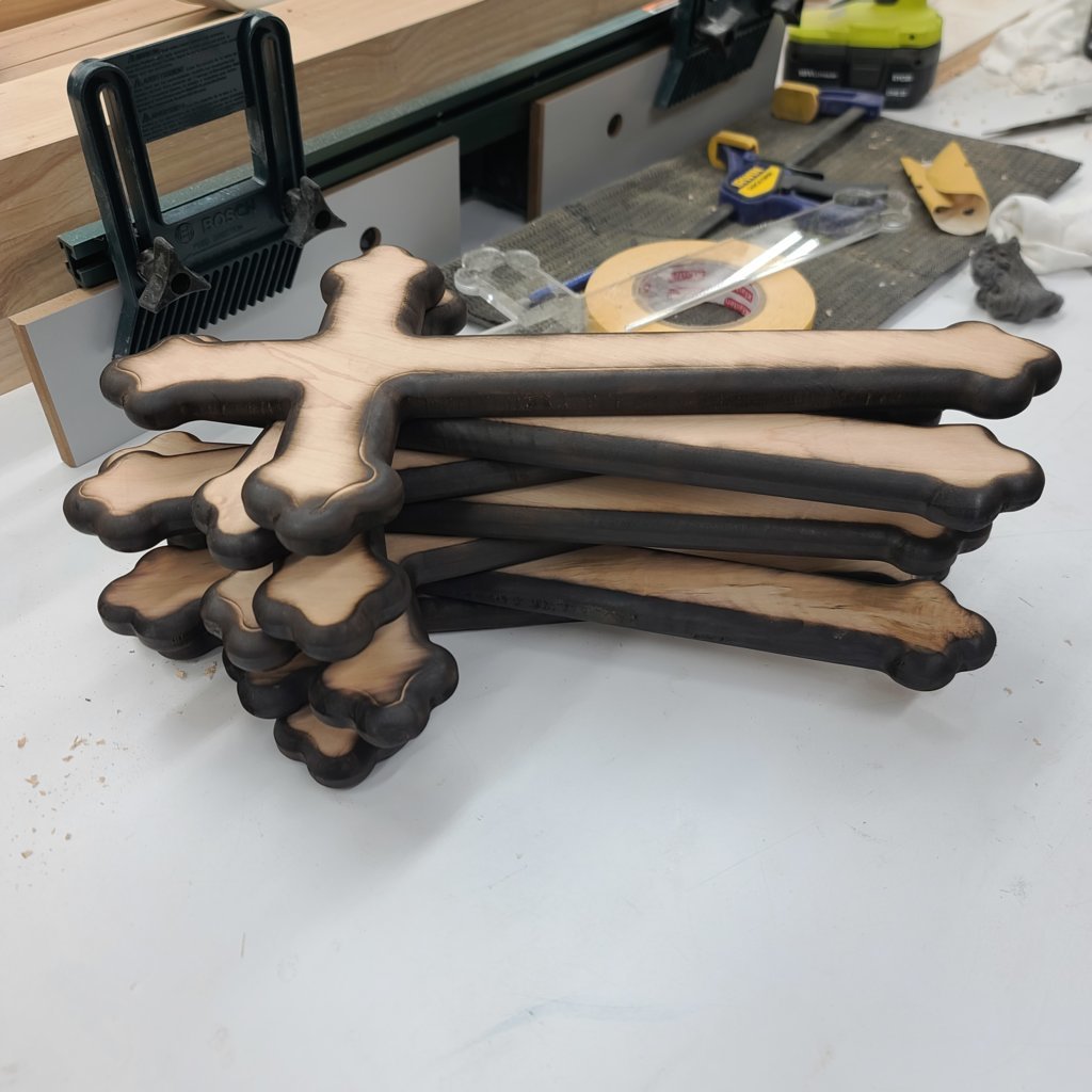

    Roundover is done.
    Lightly flap sanded.
    Edge burning is done.
    Next will be flat sanding the face and then applying a finish.

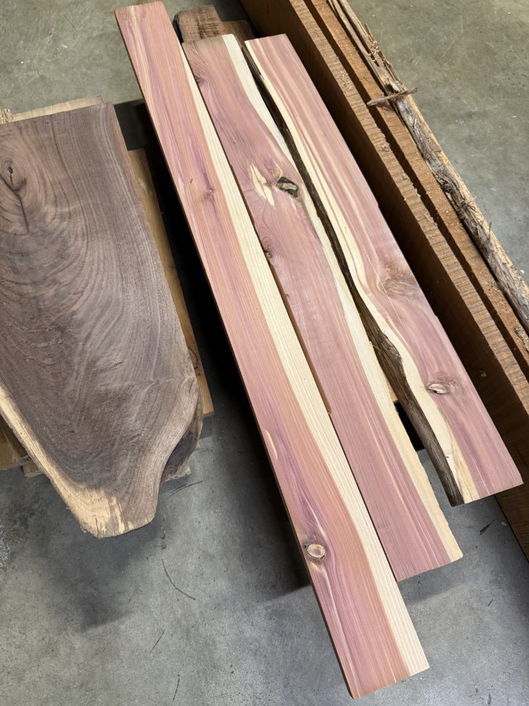

    Guess the blades are set right!

    I bet the shop smells great after planing that cedar! Nice walnut slab too.

    Had to plane it in the driveway, no shop for me, yet…

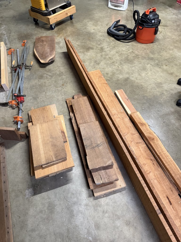

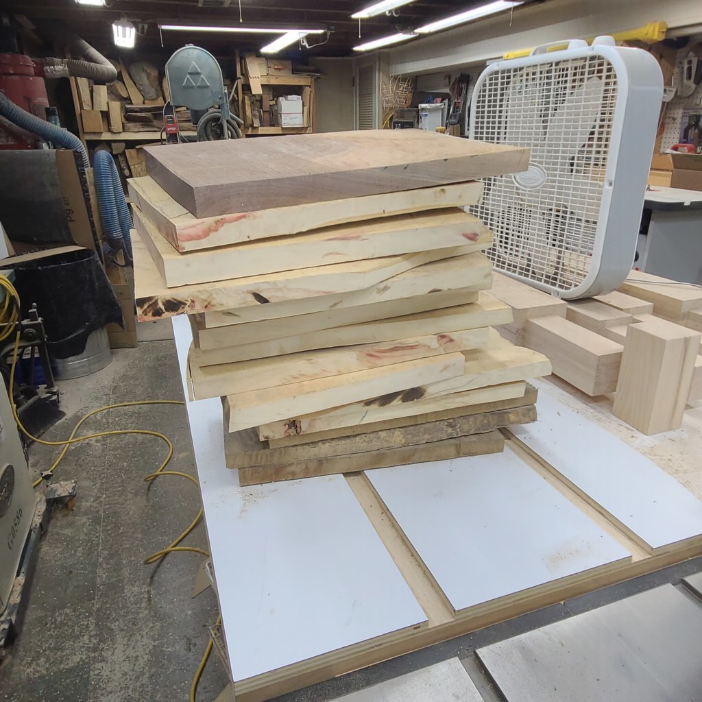

    Well pastor at church gave me the green light to ask for donations for the large cross with all money going to the benevolence fund. So I started prepping stock for the next batch.

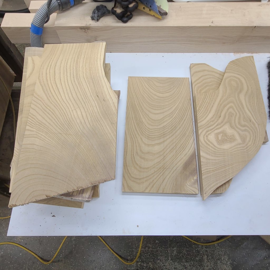

    Anyone care to guess the species of this wood? Hint, you can't buy it in a lumber store, at least I've never seen it for sale.20250105_172048.jpg
    I have more to plane down yet. This stack is maple, box elder, and one piece of walnut.

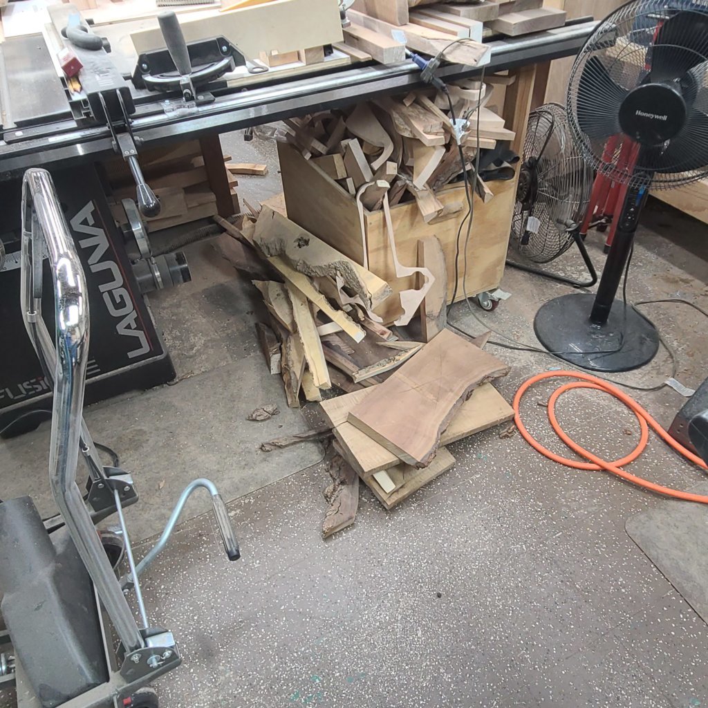

    A burn day is in my future, lol. Scrap box is overflowing.

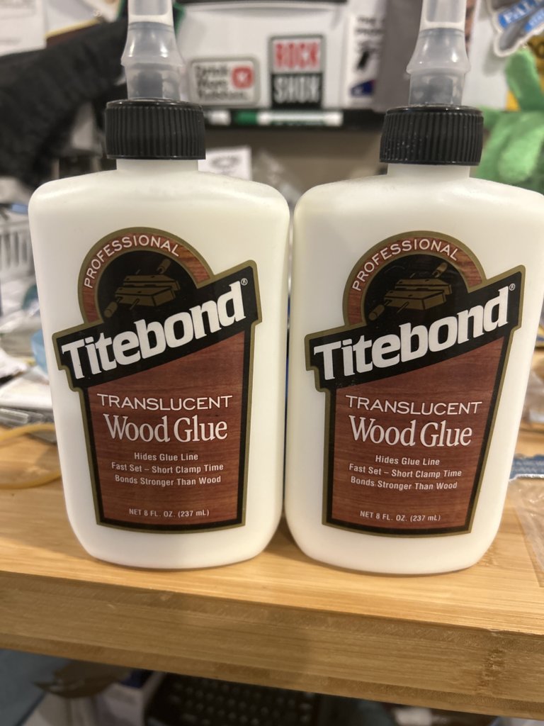

    I plan on making some thick decorative 8” deep 40” long shelves by gluing 3 pieces of various wood species.
    Indoor dry situation finished thickness around 1.75” - 2”
    Will be floating
    Main question is what glue would you recommend?
    Any other suggestions or warnings welcome

    Titebond I, II or III would work fine for you.
    Since your project will be indoors, Titebond I is fine. Of all the glues, I is the "weakest" - but all are much stronger than the wood itself.
    Think about how long it will take you to spread a layer of wood, then get the glue with the appropriate open time. To me, this is your main concern.

    Thanks I was thinking of using a mini roller with the glue above pictured

    That glue will work fine. I don't think you will need to worry about it being translucent, as your joins should be tight.
    Rollers work great to spread glue - as do old credit cards (acting like a squeegee).

    Don't have an educated guess, but im certainly intrigued. that grain pattern is really cool.
    Is that Ironwood?

    Nope, lol. Next guess.........

    Balsa?

    olivewood?
