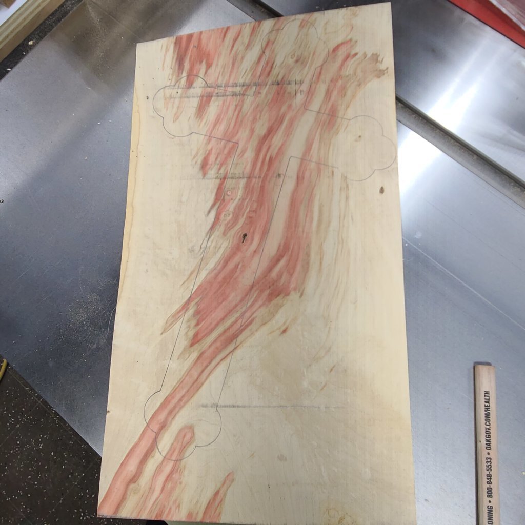

    What are you planning on for a finish? That flame box is beautiful!

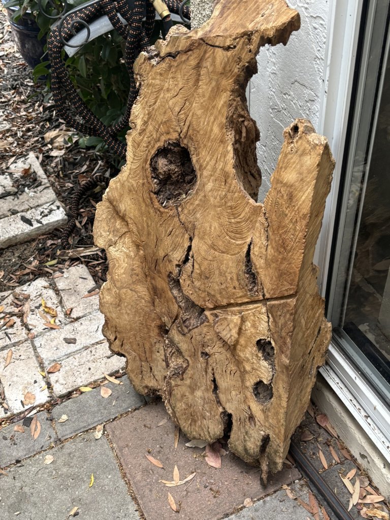

    In PHX AZ there is a higher-end "fashion mall" with Tiffanys, Cartiers, Tag Heuer watches, Prada, etc. Having looked in the Cartier store (security guards at the entrance) and Tiffanys (no guards), I asked Tiffanys what makes them different from Cartier in their opinion. The response: Cartier makes what it can with the shape/size/color of the high-quality stones (be it a Jaguar or a leaf) while Tiffanys alters high-quality stones into pieces that are more of a standard shape (necklace, ring, etc) but still dazzling.
    Find out what that piece of wood "wants to be".

    I love that, it is in the spirit of everything I try to do with wood, what does it want to be, what is this piece the best suited for?

    Not really sure on the box elder. I have a couple of others with some red figure, may test with those. I really like a blo finish but if it darkens it too much it may end up being water based polyurethane.

    The cross-shape leaves much spare wood for testing finishes. I think. :anonymous:

    Yeah it does. I've done some of the smaller crosses in box elder and blo does darken th red up a bit but it still looks nice. The white wood can vary quite a bit between trees becoming mostly on the yellowish side but again, still nice and warm. Actually with a penetrating oil finish I find that it preserves the color longer. With waterbased poly the red seems to fade over time because it's just a top coat and doesn't really soak into the fibers of the wood.

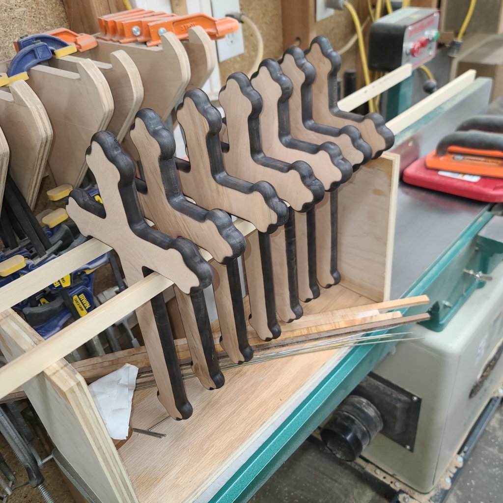

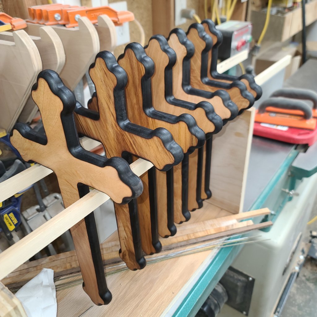

    All sanded while I was chatting with you guys. Lol.
    And blo applied. See how warm it looks?
    Blo is a very slow finish to apply but it really soaks in and cures from within. Only thing is you have to be carefull with the rags hang or lay them flat as they can spontaneously combust. But no solvent, no smell, and it's actually good for your skin, lol.

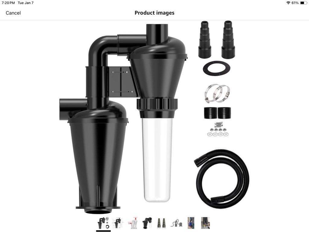

    Is anyone using a dust collector like this?

    I use a super dust deputy but that's on a large harbor freight dust collector. Looks like that one is made for a shop vac. I don't know how good the Chinese cyclones are? Kinda why I stick to dust deputy brand. Nothing really against Chinese product but some things you just don't know?

    Yeah I’m looking for something small, I don’t have a lot of space. But for the cost of a shop vac plus the adapter, I’ve been looking at this one:
