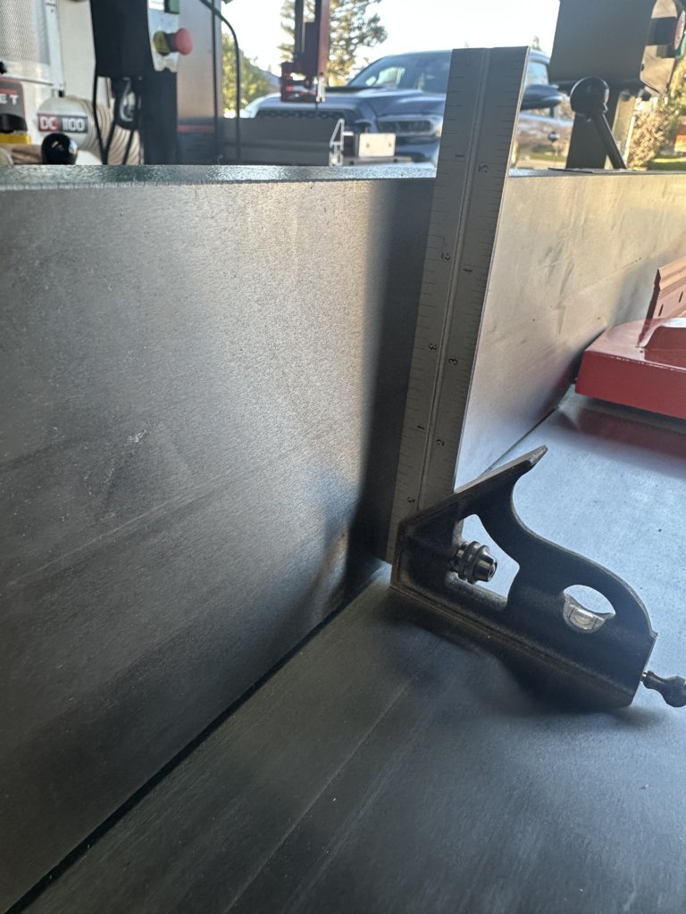

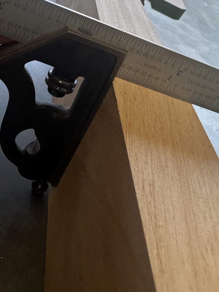

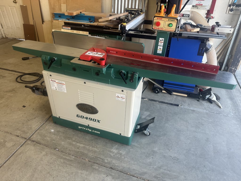

    Finally had some time to finish setting up my new jointer. Very happy with my first test pieces.
    I have a couple of projects rolling around in my head. May go to the lumber supplier and pick up a few boards tomorrow.

    Very nice!

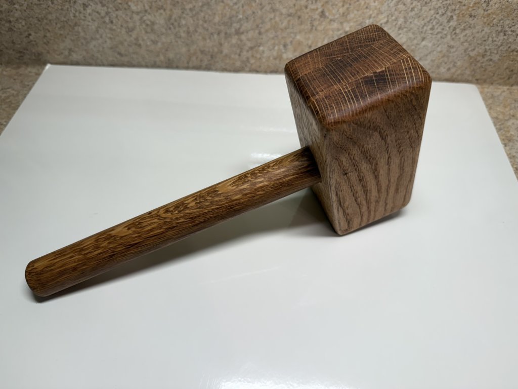

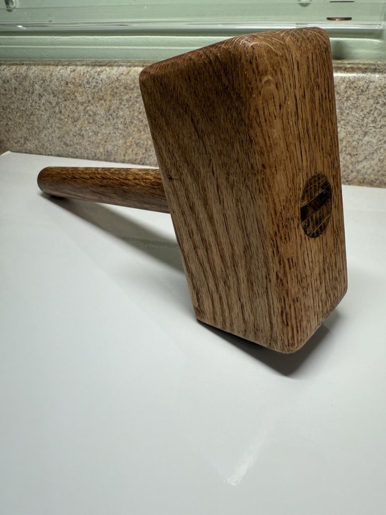

    Had some scrap oak laying around, so I made me a mallet!

    Here come the judge - order in the court!

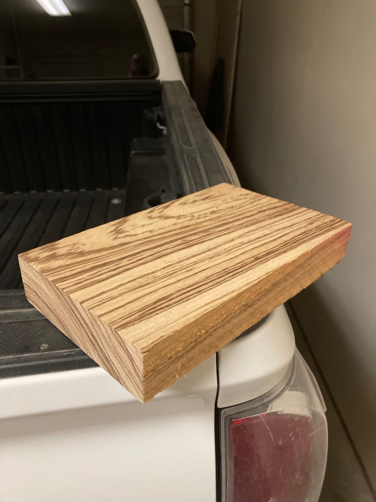

    I found this block of zebrawood atin the "by the pound, scraps" bin at the local wood shop. I was wondering what to do with it. I am inspired to get creative with it again ...

    Use it for an inlay on something. Maybe pulls or knobs of some sort.

    I have an idea, but need to test on cheaper woods first, verify if the idea is even of value to a recipient or just an idea for some other application.
    Does anyone have a recommendation for a clear-drying pour-in-plastic? My idea is to hollow the center of a 10.5x6.5x1.74 (inches) block into a "frame". Then place a "keepsake" (the keepsake is relevant to the other person but maybe not enough of one) to embed that in the clear-drying plastic. Basically "the keepsake, suspended in clear plastic, inside a nice stained wood frame, viewable from both sides".
    If this sounds stupid, please stop me before I waste any time on testing.

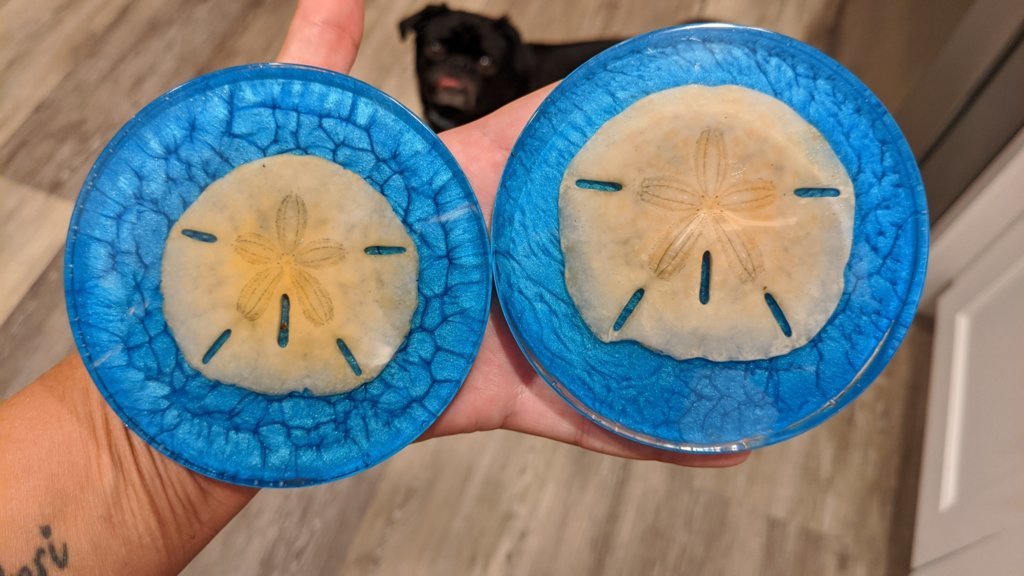

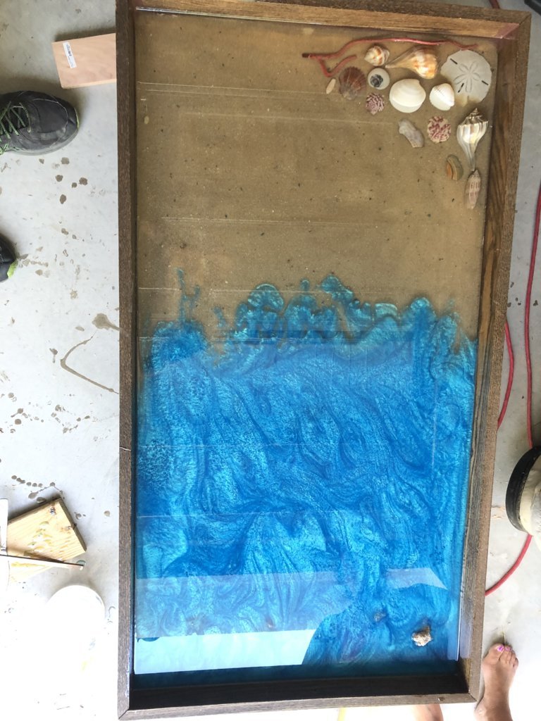

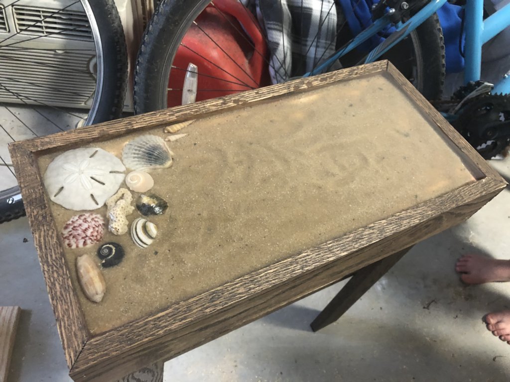

    Here’s a couple I’ve done from about 5 years ago. They still look great today

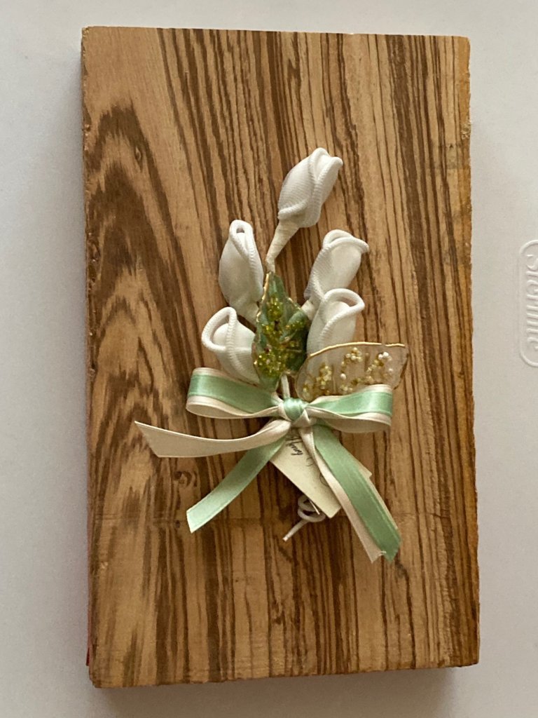

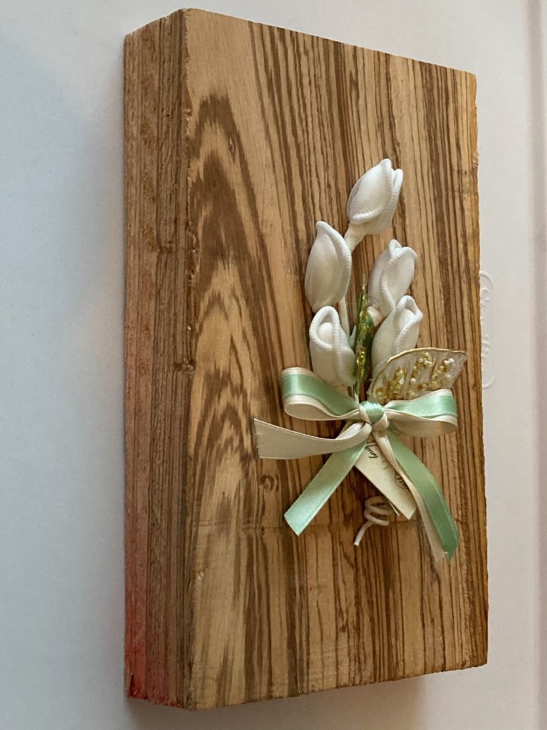

    Totalboat? Or I can ask others as well. Here is the "remembrance" they handed out at their wedding, there are candies folded into the petals. Zebrawood I think will make it memorable.

    One other piece of advice
    paint that thing with the epoxy first and let it fully dry. The better you can seal up the porous bits, the less bubbling you’ll get in the epoxy. Also, if you’re using wood as a border you’ll need to paint it with epoxy too.
    especially when you’re doing deep pours, you’ve got to make sure everything is sealed otherwise youll end up with bubbles trapped in the epoxy.
    I’ve encased sand dollars in epoxy for coasters and it just means using a brush and putting a thin coat on there, letting it dry, then setting it in the mold and doing the pour.
    incoming pug photobomb

    Just got back from the wood store ... picked up some more zebra wood to practice before I use my only copy of the flower. I will be putting the wedding invitation in a shallow cut on the back as well and epoxy it.
    I think some spray acrylic seal on the invitation will protect the ink from bleeding, and pre-spray the flower to get in all of the crevices first.
    Then pre-paint with epoxy ... the flower, the invitation, the side walls. Starting with the extra piece of zebrawood and some cheapo ribbon and knobby menthos and some business card to see if everything falls apart.
    Air bubbles will probably be the death of me, though. My brothers think they will not see it as kitchey, I hope the recipients do not. I really want this to be a good product of meticulous work.
