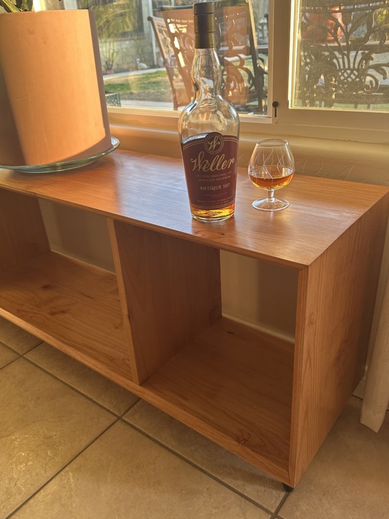

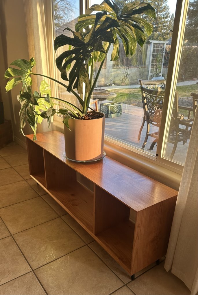

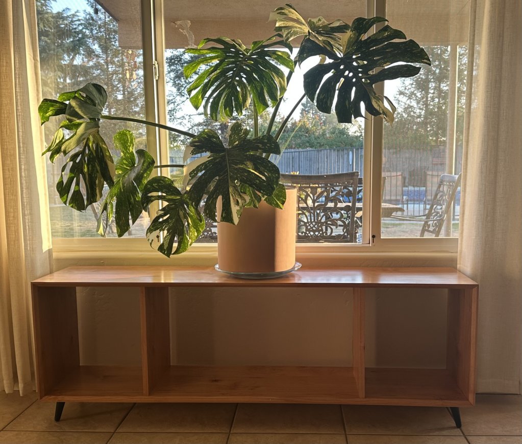

    I'm not MSM guy but that is very clean and appealing to my eye. Beautiful work.
    Love your work Gary!

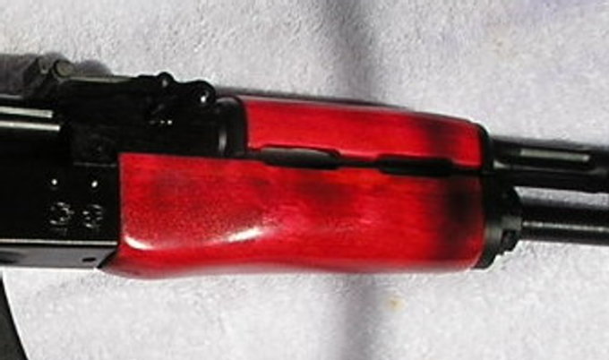

    Yes. This is how I made my new USA stock for my AK a very nice bright deep red but still see some grain. This was a water based, powder stain. Wear gloves!!
