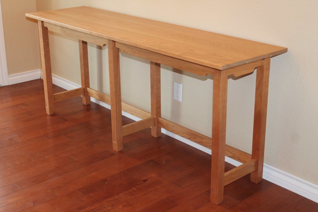

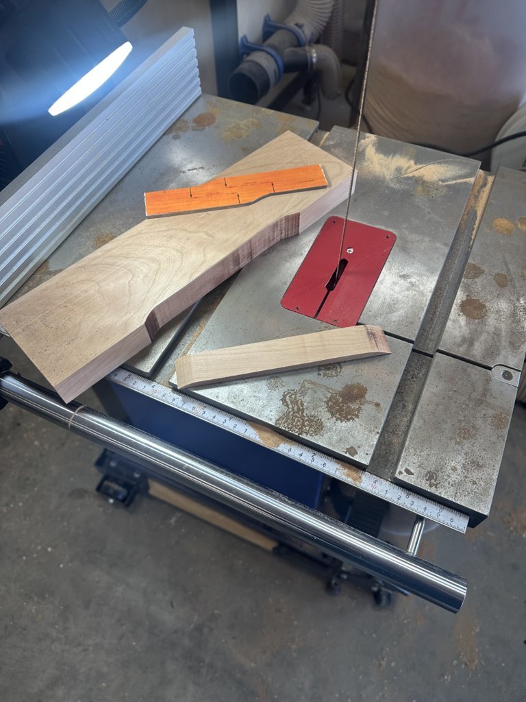

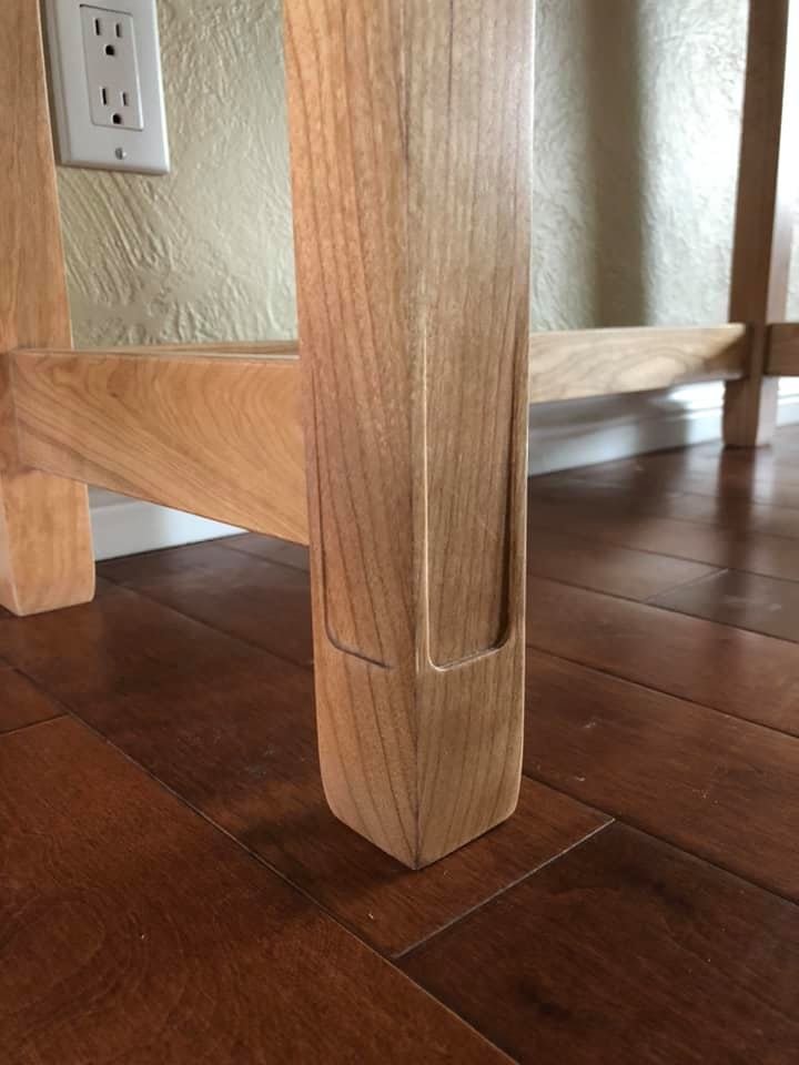

    You can't go wrong with G&G and cherry. It's one of my favs! Darrell Peart is a expert on G&G and his books are very inspiring. A leg indent would look great on your cabinet. https://www.youtube.com/watch?v=Aii1pQc-boM
    This is a table I built a few years ago in Cherry

    That table looks great!
    Thanks for the video link. Leg indents, cloud lifts, and ebony plugs are all part of the overall plan. Those along with glass doors are details that I have never done before. I think that this build will really challenge me.

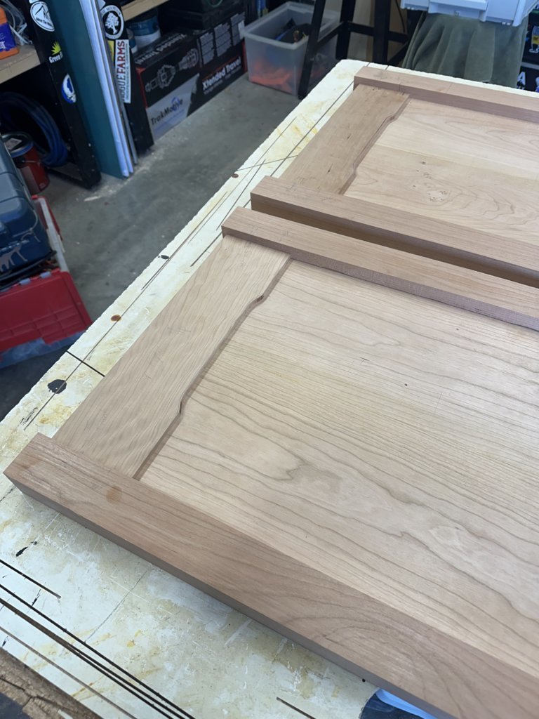

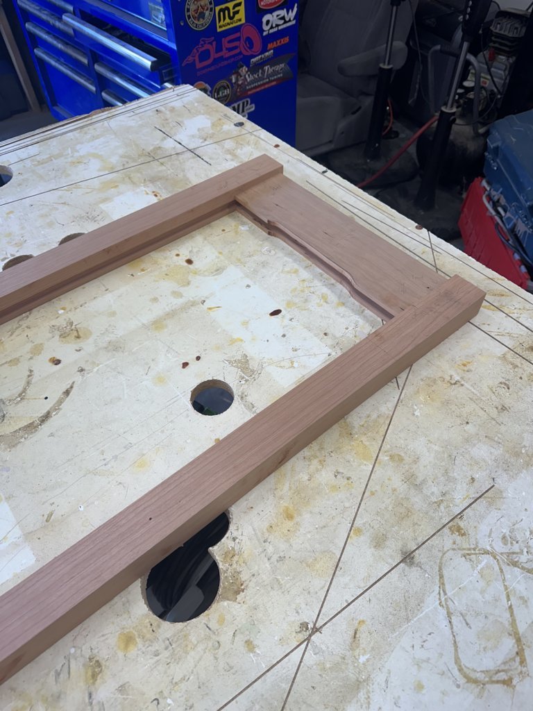

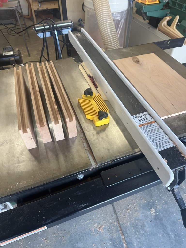

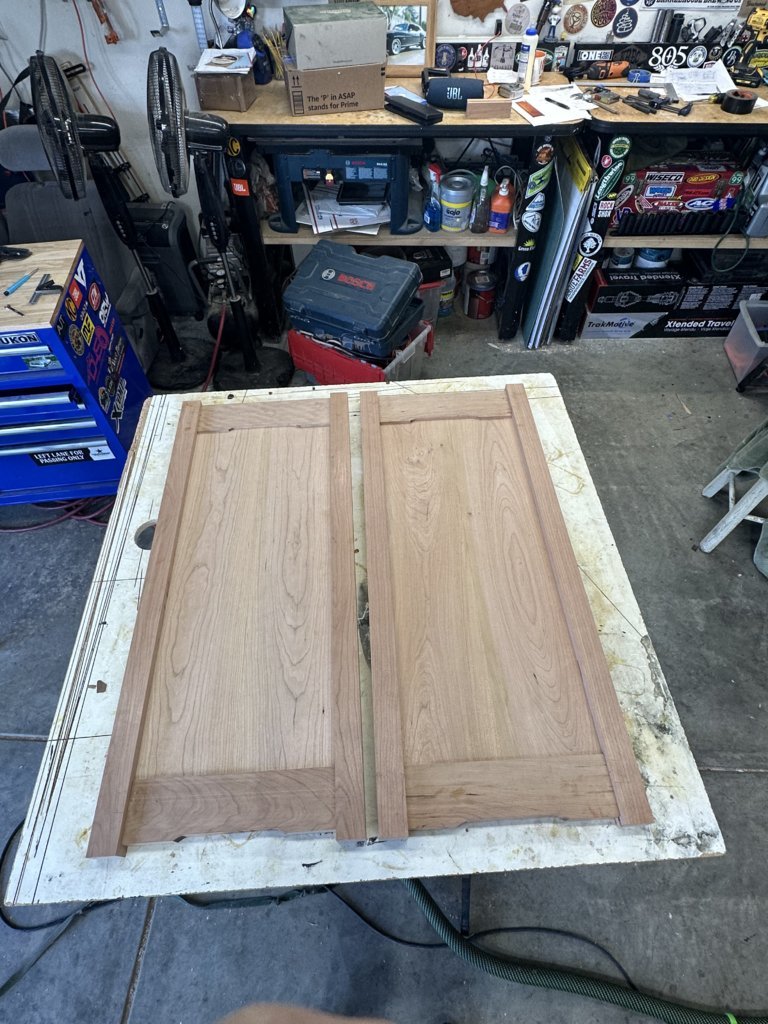

    Progress was made slowly today. I got the two side panels mortised and dry fit. The center panel is 1/2 thick.
    A few pics of today’s progress.

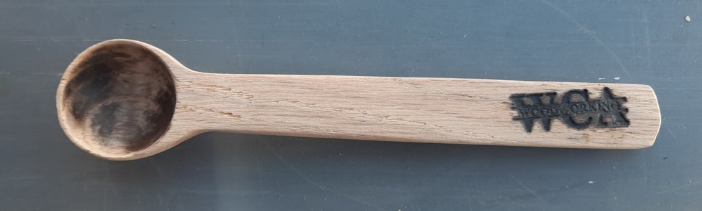

    Made this today. Teaspoon size

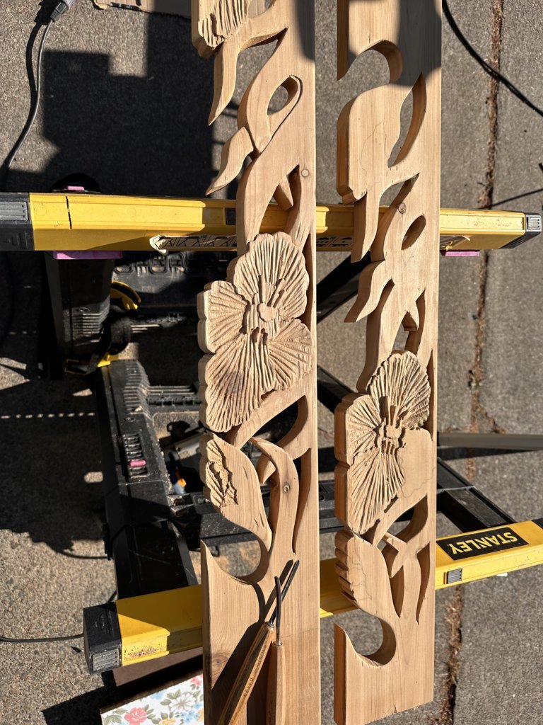

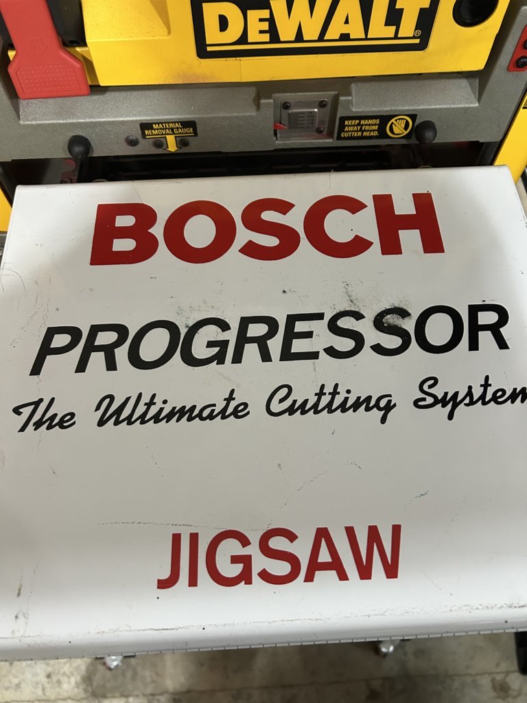

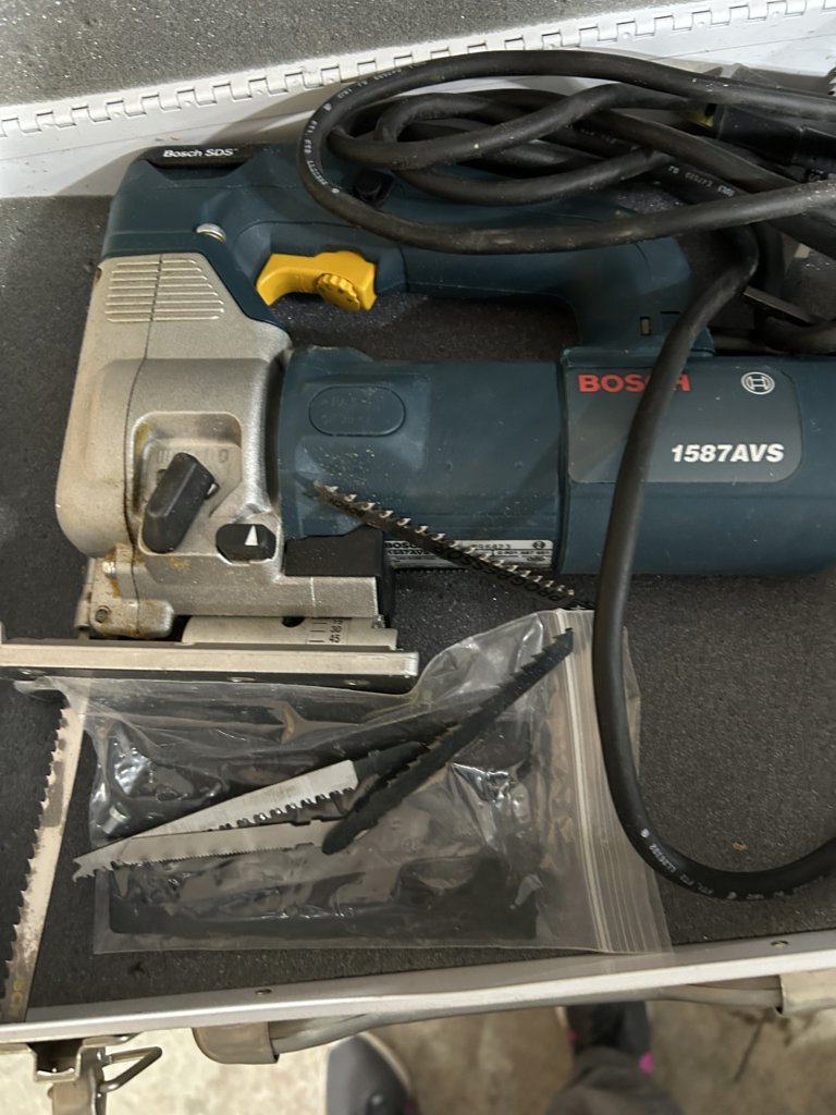

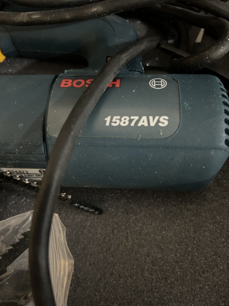

    I’ve had a Bosch 1587AVS for countless years. I bought it at the height of my Landscape Maintenance and Construction business. It is one of the finest pieces of equipment I’ve owned. I used it predominantly for scrolling the faces for hand carved curved oriental bridges and matching planters, so most of its mileage has been in cedar. My patterns were tight and intricate so I need little deflection. Pictured is some 5/4 trim work for planters. The bridge faces were 2x12 cedar. I was able to achieve the same result with the roller guide behind the blade. You truly will get what you pay for. If I were to calculate the cost of ownership the Bosch has paid for itself time and time again. Good luck

    Those are beautiful

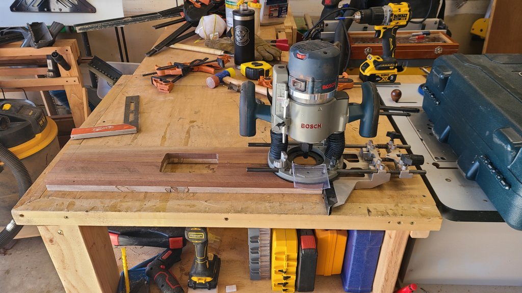

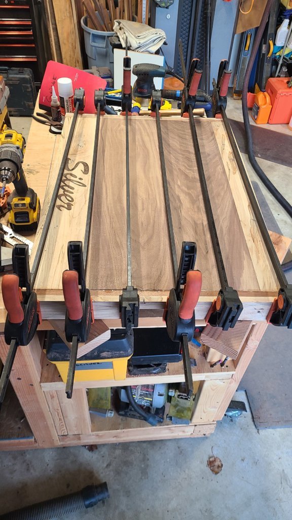

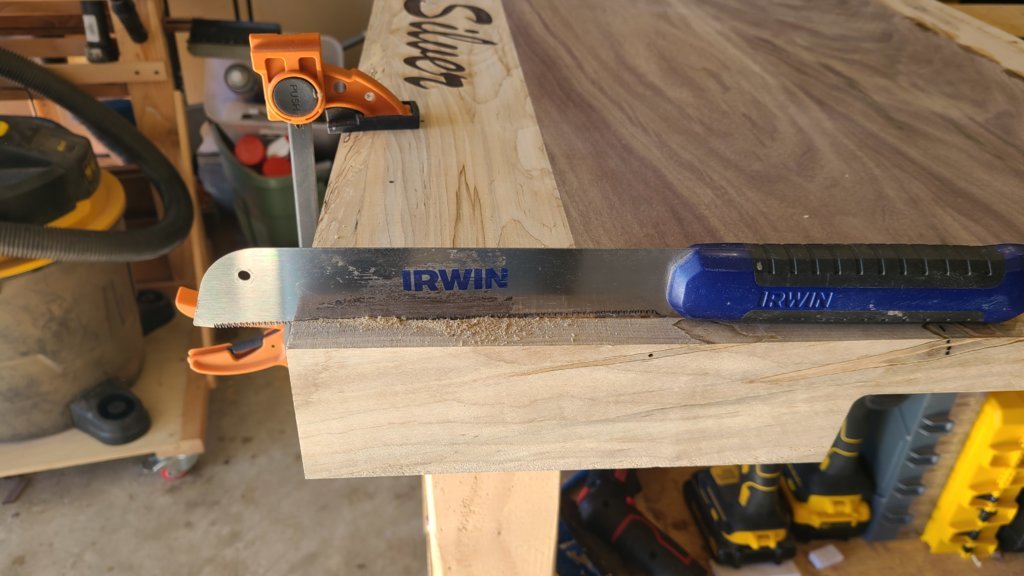

    Another step backwards, but I may finally have turned the corner on this.
    After I cut the ends off, I noticed my line had drifted and it showed. My table saw is too small for the cut and my cobbled together workbench doesn't give me a level surface to support a piece that big on the job site saw. So I set up a guide for the router with a 3' level and went for it. I lost just under 1/2" in the process.
    Glued some scrap walnut to the ends I cut off. This morning I broke out the router and guide and hogged out what I needed to get the stove clearance.
    A little sanding and it's back in glue about an inch wider than it was before. Which will still work. Hope to have it finished and delivered by the weekend.
    Not many pictures, but a lot of good music while I made man glitter.

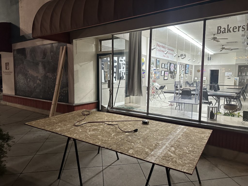

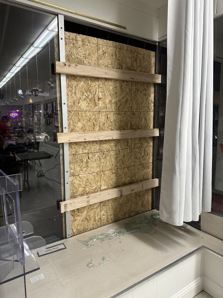

    Unexpected emergency woodworking trip tonight. My 78 yo father is a member of the Bakersfield Art Association. He called me tonight in a panic after a random homeless guy walked by and kicked in a 4x8 plate glass window.
    A quick trip to the Home Depot and a bag of tools and I am woodworking, at night, on the sidewalk, in downtown Bakersfield. It is officially patched up until a professional can get here tomorrow.
    Not my best work, but passable for the situation.

    Homelessness coupled with mental illness is a tough thing. That's an expensive window to have to replace.
