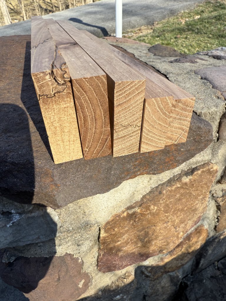

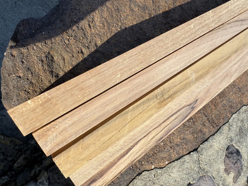

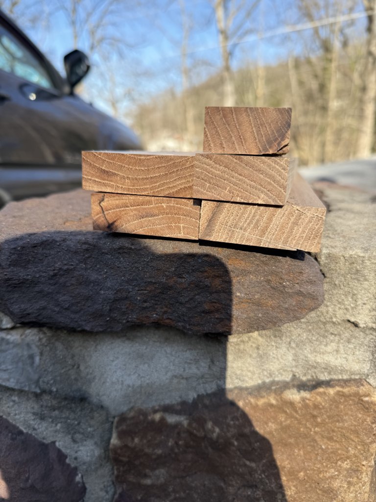

    They didn't tell you what it was when you bought it? Do you have a detailed pic of the end grain?

    One of those mixed boxes of hardwood cut offs. I’ll grab a pic of the end grain later this evening.

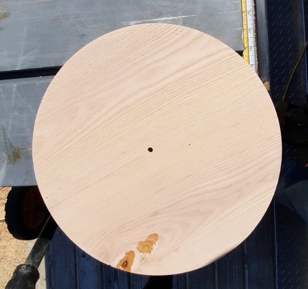

    You can cut a nice circle on table saw...

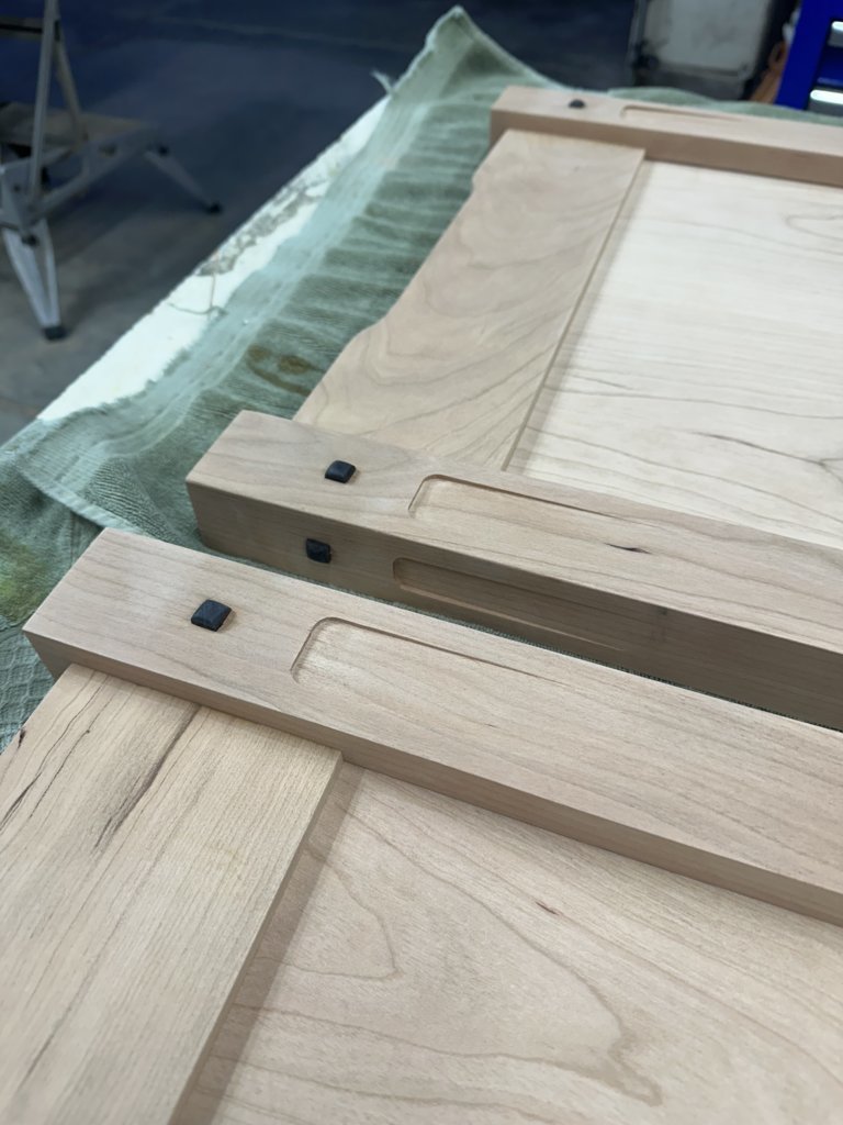

    Out of clamps!
    Tops
    Bottoms

    @DoubleB Are the plugs real ebony? It's looking great!

    Thanks!
    Yup they are real ebony! I was able to order two small pieces online when I got the rest of the hardware.
    I am happy with how it is turning out so far.
    Still undecided on the final door design, pull design, and type of finish I will use. A long way to go still.

    I don't know anything about wood. My wildly inccorrect crazy guess is black limba. Obviously probably not, but its pretty whatever it is :thumbsup:

    I can see that too. Looks fairly similar to the limba in my shop right now

    That looks a lot like American Chestnut. I have a few old pieces I can check when I get home.

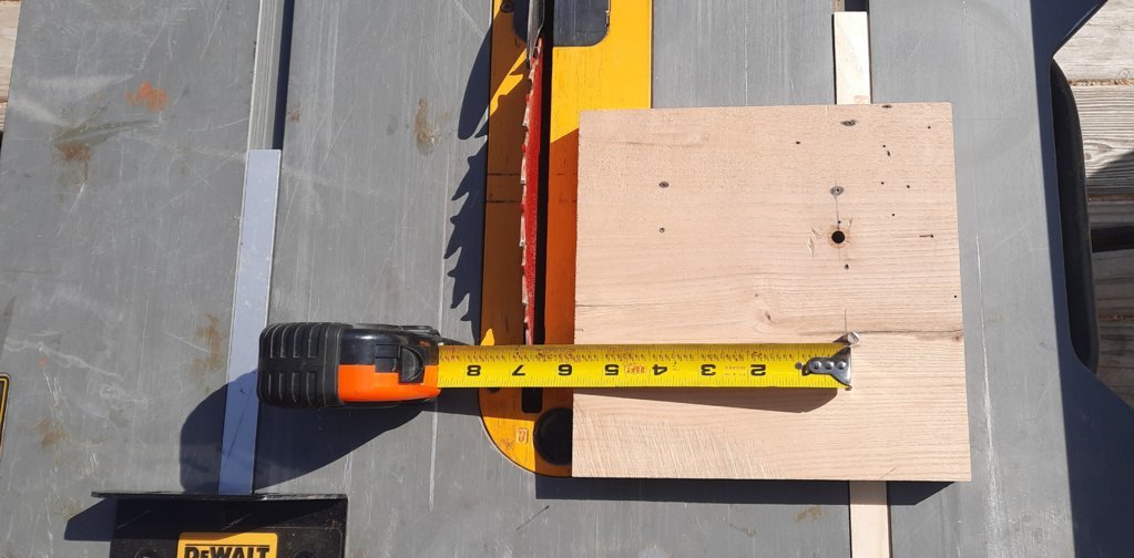

    For those interested...heres the simple circle cutting jig for table saw. Basically place pin half the diameter of circle you want. Continue Cutting corners off then cut high sides... rotating slowly, then finish the last by keeping it at highest point of circle and let tablesaw do the work.

    I just did that Sunday. I would only add using a full kerf blade. I used a thin one and it had a nit of flex to it.
