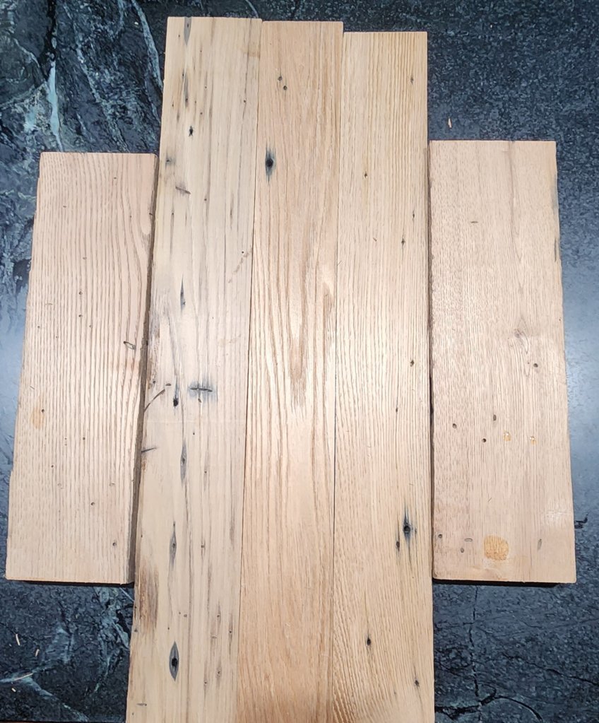

    Some stuff. Not a lot, just some.

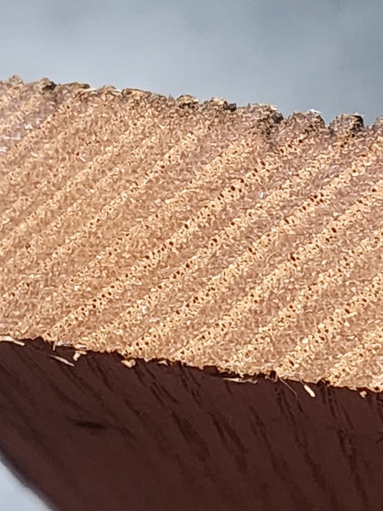

    @308savage This is American chestnut. Came out of a barn in Virginia. Looks similar to your wood but I doubt it's chestnut. There's not alot around any more.

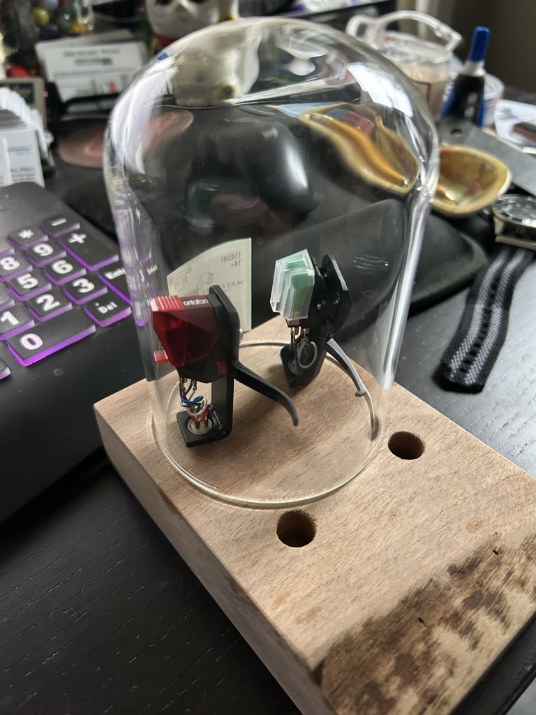

    Hows the Ortofon red compared to the Audio Technica?
    Pablo8[QUOTED] likes this.
  9. Mar 13, 2025 at 5:48 AM
    Pablo8
    Pablo8 Here!
    Aug 7, 2019
    #301483
    9,923
    Paul
    Everson WA
    2019 Cement Sport 4X4 MT AC
    OVT, 4.88, ADM, F&R ARB lock, KO2's, RWD L MOD
    It is better. Not that the AT is bad.
    Orto really brings out the highs in a good way if everything else is correct. Bass end ok.
    AT is just a well rounded OEM cartridge with good bass.
    Right now I have a Goldring E4 Flagship. An absolute gem of a cartridge. Closest to live I’ve owned frankly

    Finished with Minwax special walnut stain and Gilbey's Hard Wax Oil

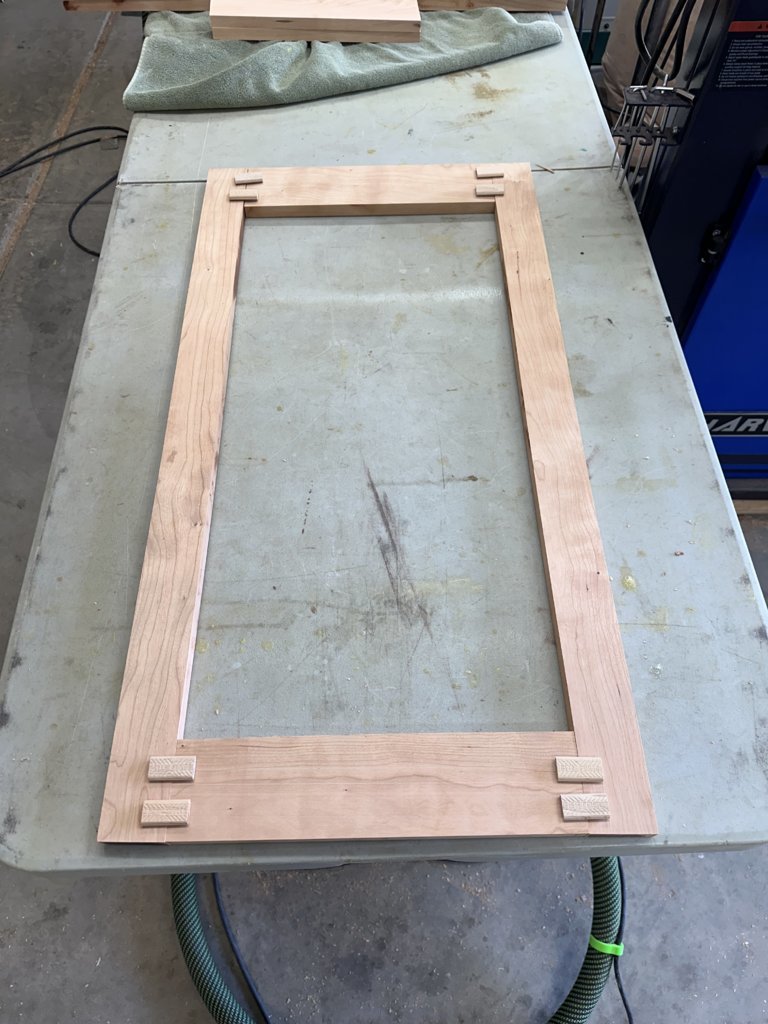

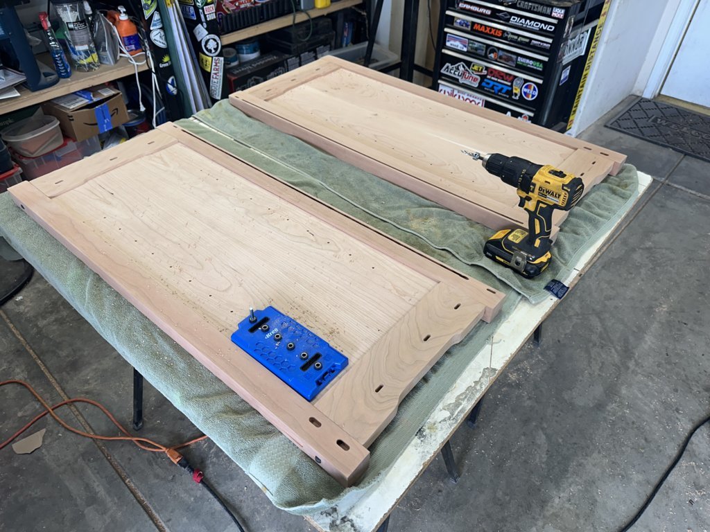

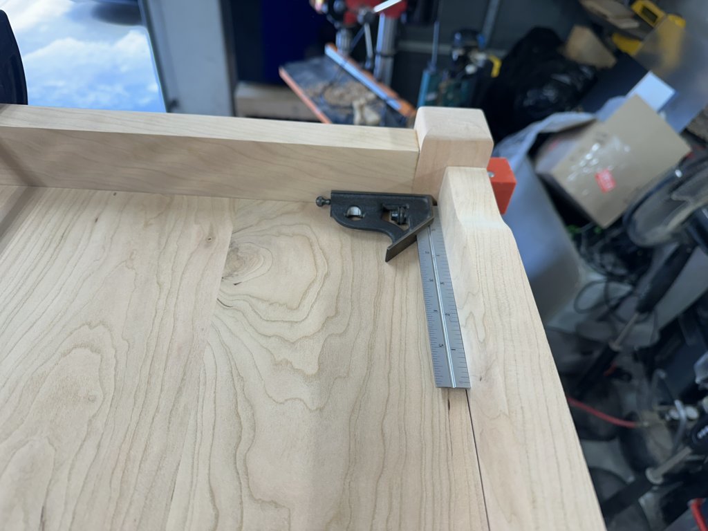

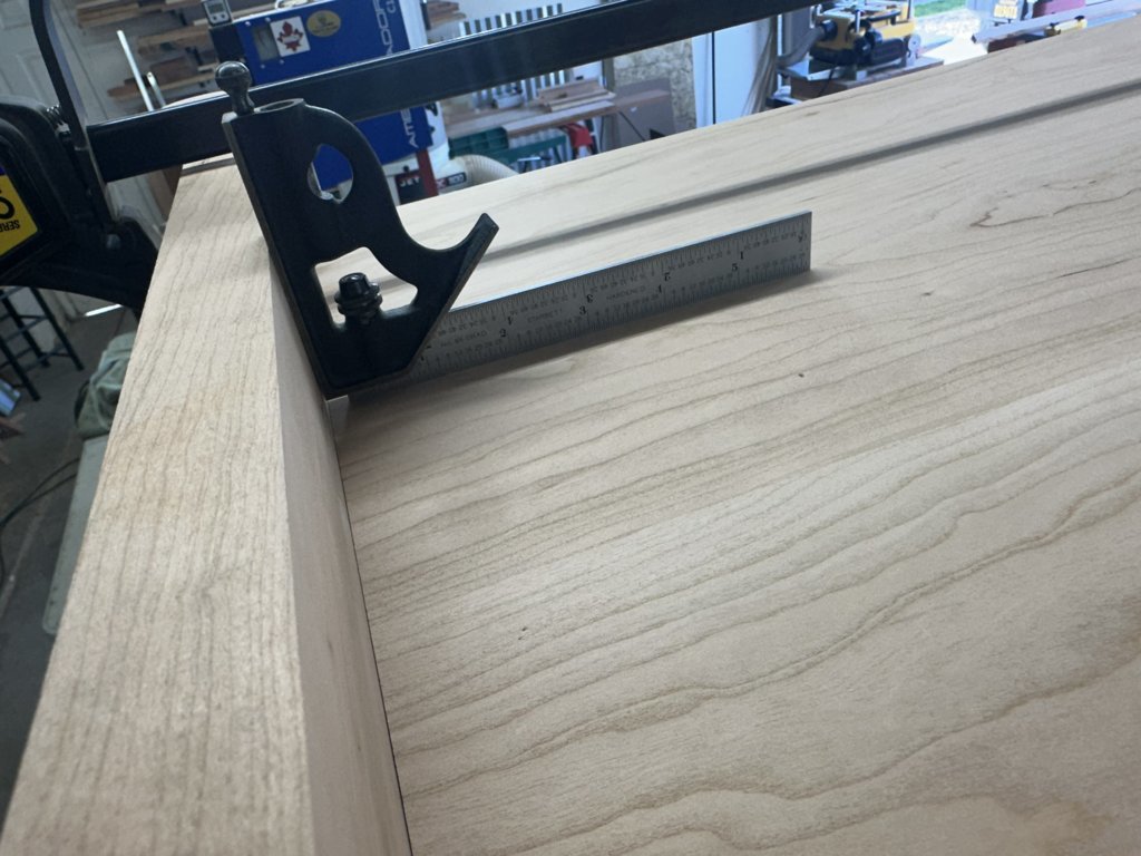

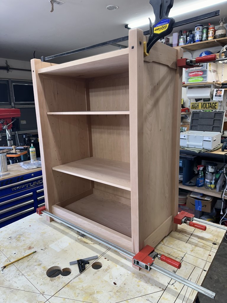

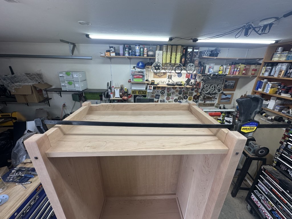

    Today’s progress report.
    Shelf pin holes have been drilled, cabinet is currently dry fit, shelves are done, doors are roughed out. Not sure exactly how the doors are going to look. Trying to decide if they will get a cloud lift detail or not, then 1 3/8 plug or two smaller plugs in each corner.
    Waiting until tomorrow to glue it up when my wife can give me a hand.

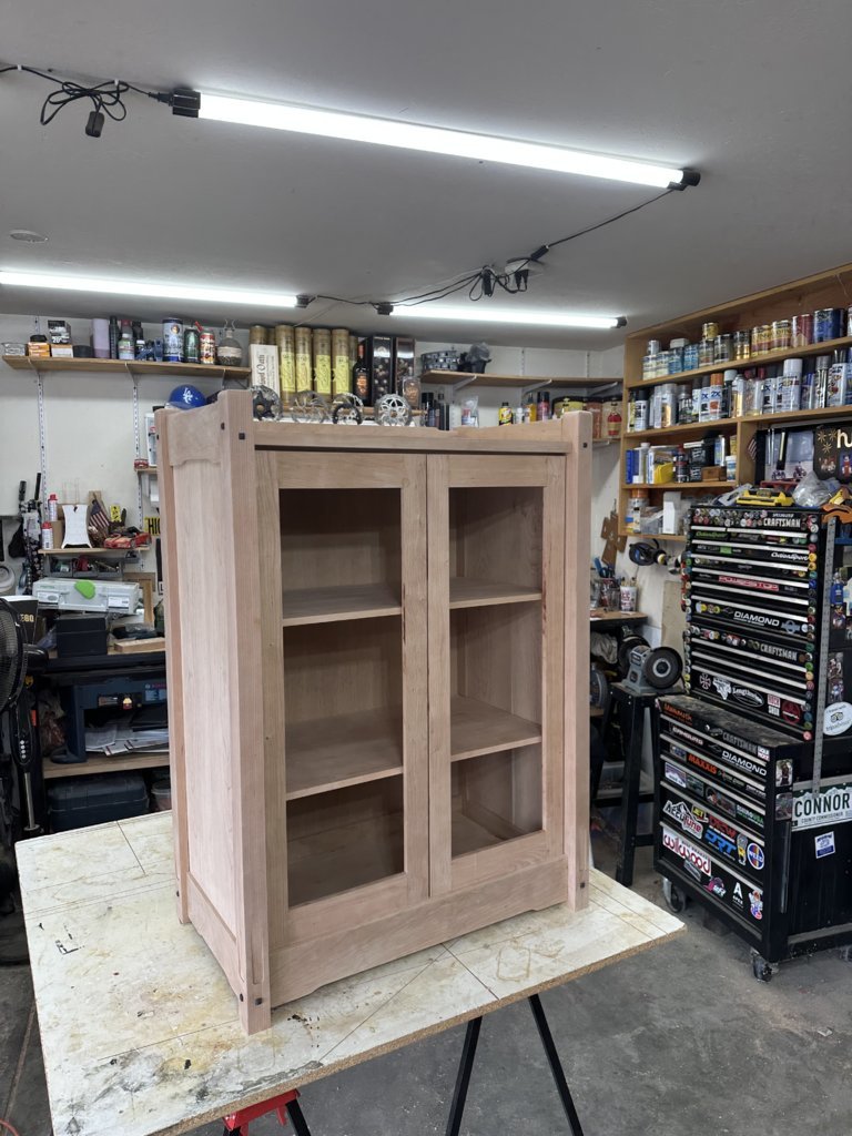

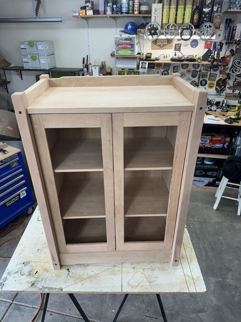

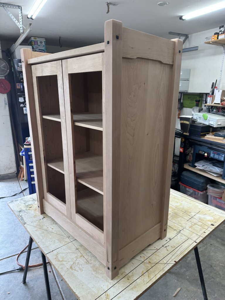

    If you don’t want to be threatened with divorce, never ask your wife to help you back up a trailer or lend a hand with a complicated glue-up. Things did not cooperate, I lost my temper, but it is dry and stands by itself now. She closed the garage door so that the neighborhood would not hear my displeasure as clearly.
    Doors are just balanced in place in the pics and are waiting for the hinges to be delivered, ebony plugs to be installed, pulls, and a final sanding. I decided not add a cloud lift to the doors due to their small overall size.
    I am done for today and the finish line is in sight!

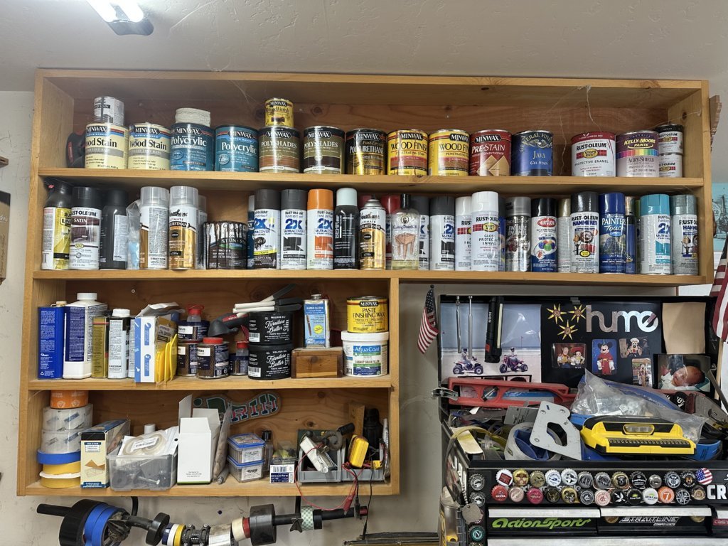

    I have used a few different stains over the years. Honestly, I have never been happy with any of it, even when using a pre-stain conditioner. IMG_8852.jpg

    I didnt care for the prestain conditioner

    I used a water based stain once, came out nice but needs multiple seal coats
    The only rule laid down by the boss are no yellow or orange tones. Rules out anything with golden or honey in the description
    I used Special Walnut the last three projects and it looks decent but can be blotchy even on hardwoods if allowed to soak unevenly

    I rebuilt a maple desk I first made 30 years ago ... I was damned lucky it has held together through so many moves! But also the polyurethane has turned the ugliest shade of orange I have encountered.
    I fully disassembled all parts and tried to sand/remove all of the old poly ... was mostly successful. Then I tried a couple of stains on the maple, including on a couple of new pieces that were engineered to make it more robust. But the stain was deeply inconsistent even on the new maple pieces.
    I ended up with Seal-A-Cell and Arm-R-Seal to protect and gave up all of the "stain" experiments.

    I've used Varathane for many years, and had good luck with it.
    Varathane is now owned by Rustoleum, and I haven't bought stain in a while. Hopefully, they did not change the recipe.
    Buy some small cans of stain, and try various brands on scrap wood. See what is easy to work, and gives you a nice finish.

    I've used some of the Varathane by Rustoleum and I had no issues with it. Felt just like Minwax to me :notsure:
    Never used it before the buyout, so I can't really compare.
