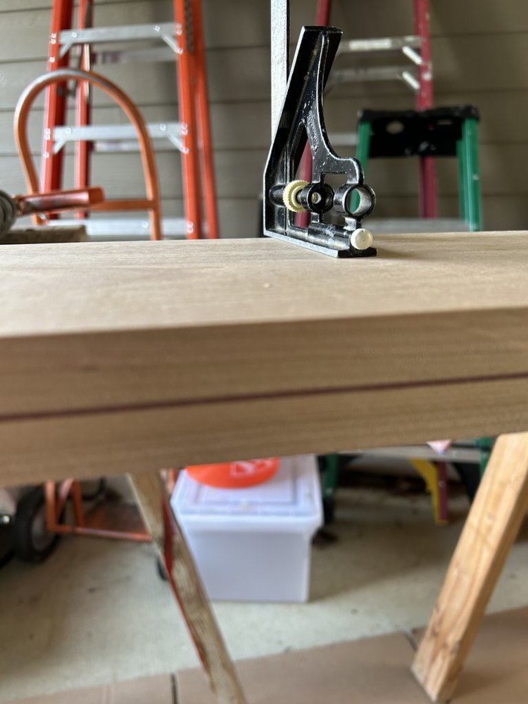

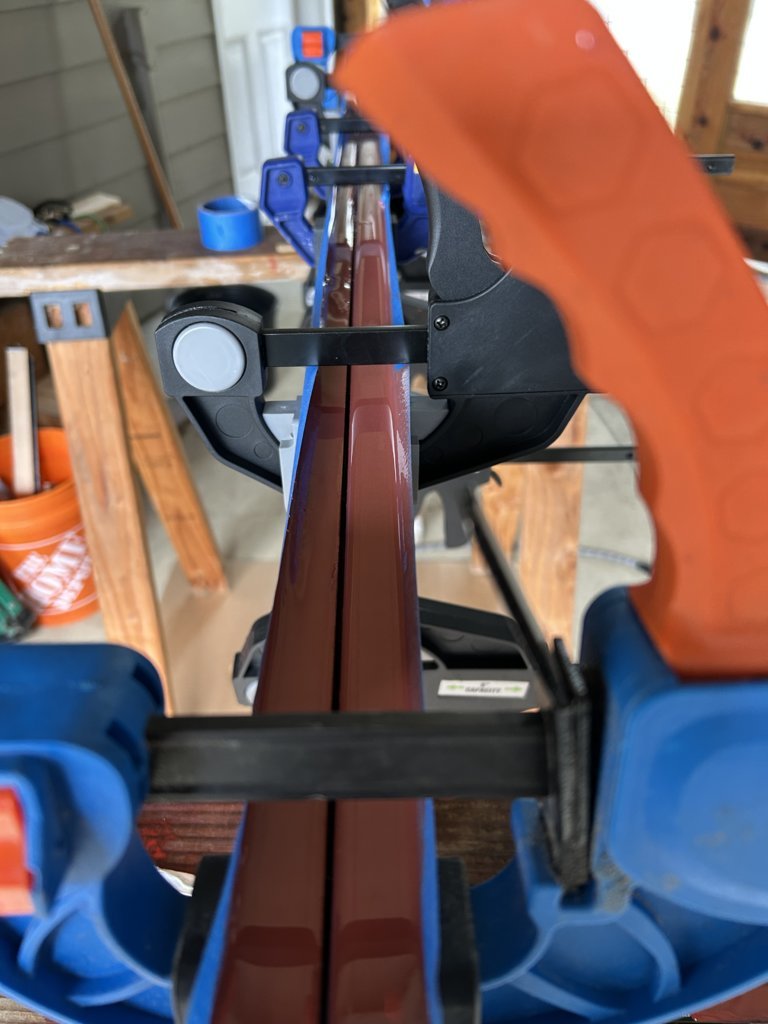

    The pour went ok - technically easy. I calculated the volume of the gap and added 10%. I had no leaks and just a little spillage
    The bad news I didn’t mix enough
    The good news is I didn’t mix enough
    I seemingly didn’t get the color right so I will have the wife mix the color and I will fill the rest. Will leave end this color most likely
    I think plastic cup measure lines are very approximate and more loss in cups than anticipated

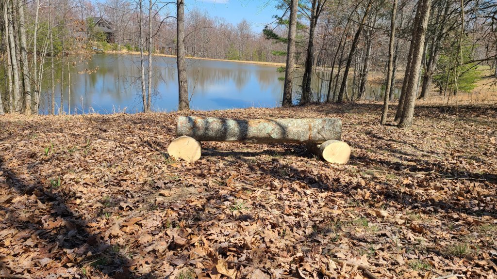

    So while the build continues, I took a break from brush clearing to make my first project at the new house. Made a poplar bench to take break on.

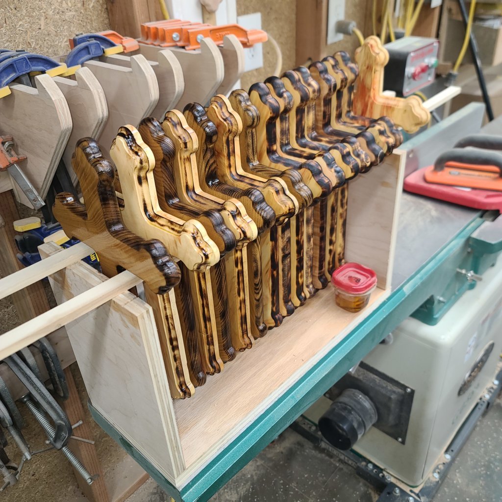

    Well I got some shop time today. Sanded the faces to 180 grit. Then got a coat of blo on these. I still have about as many to sand and oil yet. I think next Batch I'll leave some plain and not burn the edges.
    Freshly oiled and not soaked in yet.

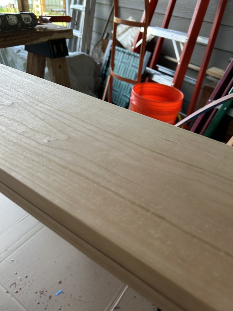

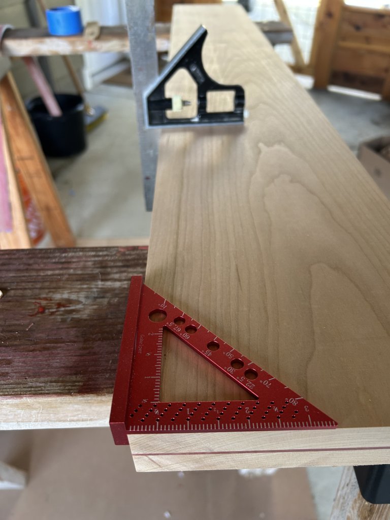

    So the laminate epoxy is rock solid on my first long shelf. I know it’s obviously not yet a perfectly square rectangle ~1.5x7x46 inches
    Will this work?
    1) Run one side through planer
    2) That newly planed face against fence of jointer then joint one edge
    3) That new edge against table saw fence and rip parallel
    4) Run unplaned face through planer
    5) cut ends square to edge
    Does this make sense? Step 4 should make face perpendicular to other face, no?
    my jointer is only 6” hence my dilemma
    DoubleB likes this.
  12. Mar 29, 2025 at 3:30 PM
    woodtickgreg
    woodtickgreg Well-Known Member
    Jun 10, 2021
    #368186
    3,377
    Greg
    Michigan
    Yup, that'll work.

    Most square I ever made any piece of wood
    Least amount I trust my planer. Kinda scary screwy. I set for a light pass and friggen starts hogging wood.
