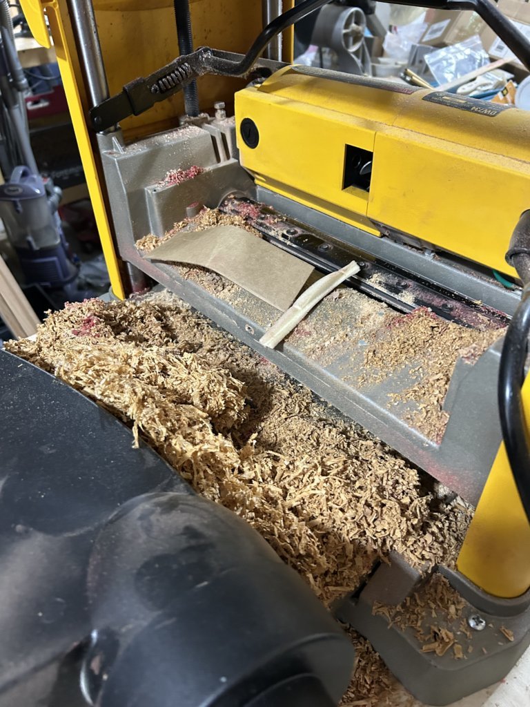

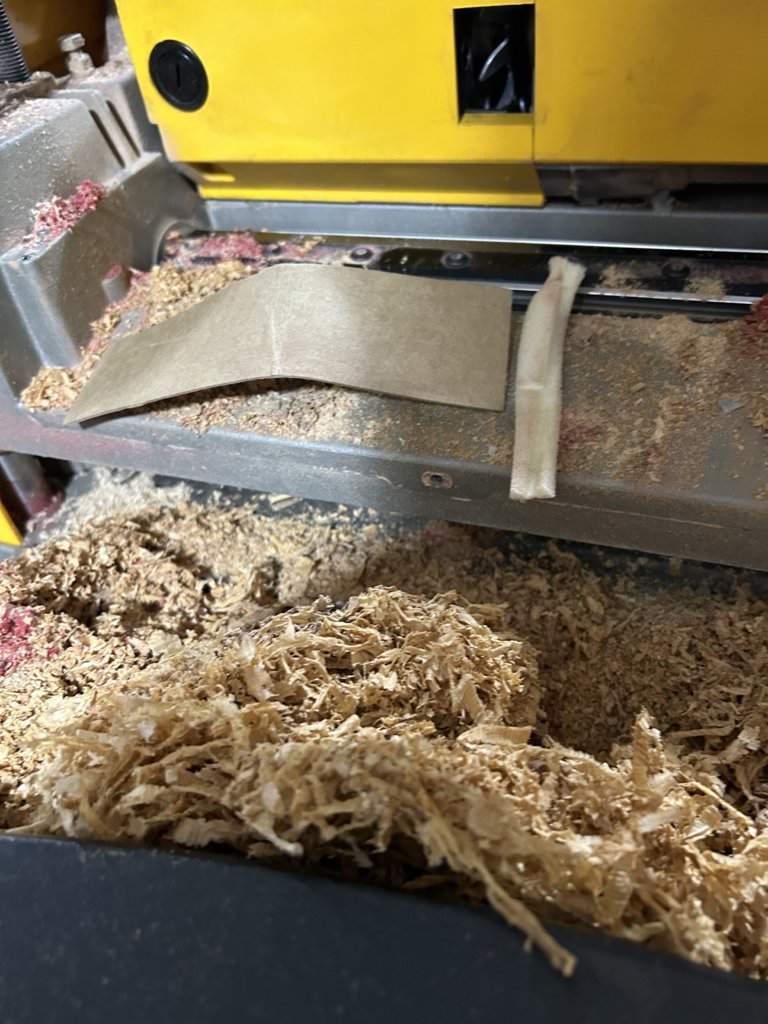

    Wait. It gets even funnier.
    First let me say: It's the poor woodworker who blames his tools!
    Well itsortaisthetool - I take the blade shroud off and here is a strip of foam rubber and a rectangle of cardboard. These were previously never visible to me - not sure why they were there, but this stuff caused a HUGE ball of a buttplug of all sorts of shavings (and I just thought my shopvac wasn't cutting it!!)

    I need to go out now. I haven’t swapped the blades around let alone cleaned it….

    Bourbon state
    Thats packing stuff from new machine. You are supposed to remove before using:eek:

    OVT, 4.88, ADM, F&R ARB lock, KO2's, RWD L MOD
    It's inside the machine as delivered (under A below). Purchaser just attaches the duct hood adapter. DeWalt had no notice to remove anything INSIDE the A cover, and it was not visible when I put the duct adapter on.
    I'm really surprised it didn't get a huge bolus earlier! DeWalt!!!
    No I blame DeWalt corporation for putting packing material in an area that is not normally opened until needing blade change or maintenance.

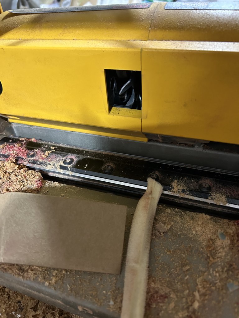

    Cleaned, waxed, etc ready to go
    And I found where the foam came from and not a setup interface! I glued it back in place IMG_0246.jpg
