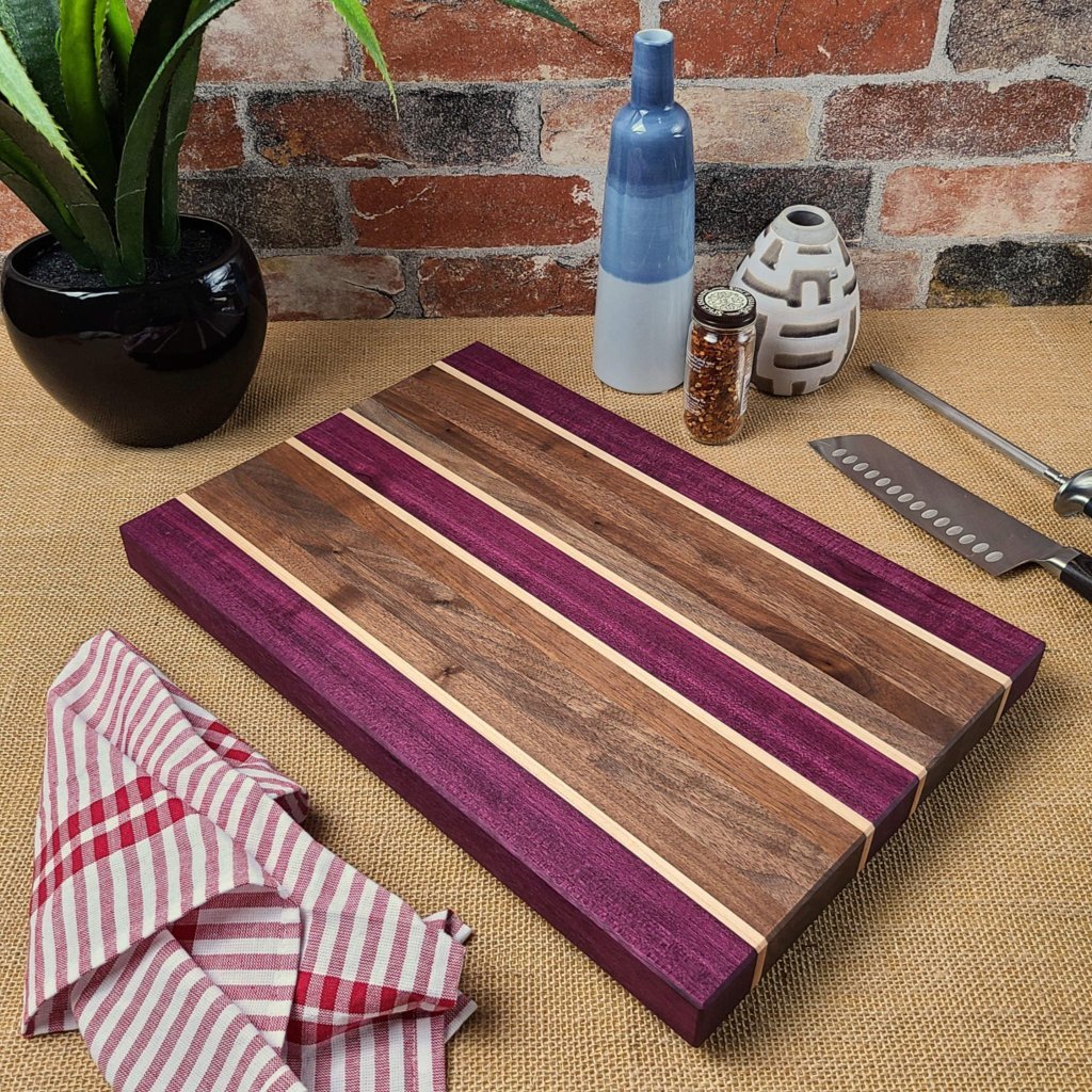

    Are you asking? Some use it as small bars in cutting boards or even large. Heres couple examples:

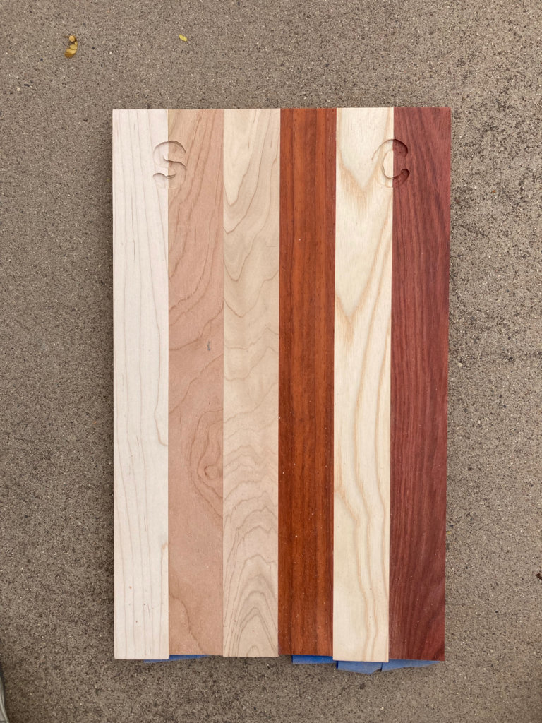

    Not the thickest cutting board ever (3/4 in). Not the most complicated ever. Glued up, waiting 24 hours now, bloodwood, ash, padauk, maple, cherry, figured maple. The C and S will be routed-in using a sign-letterering template squares, leveled-filled with clear epoxy. The first initials of of my brother and his wife, but subtle instead of "screaming at you".
    Not bad for a first attempt at a cutting board I think, and to try the letter-routing and and epoxy pour, with cove inset for fingers (maybe) and roundover bit the top edge. Maybe will not send it, but will see how it goes.
    If I get bold I may try a "wenge" or "purple heart" 1/4 in thick strip across for "engineering" and "pretty", but cannot screw up the cross slot at that stage of the build. I will consider that.

    Out of clamps, sanded smooth transitions. Only took 5 minutes of sanding! :D

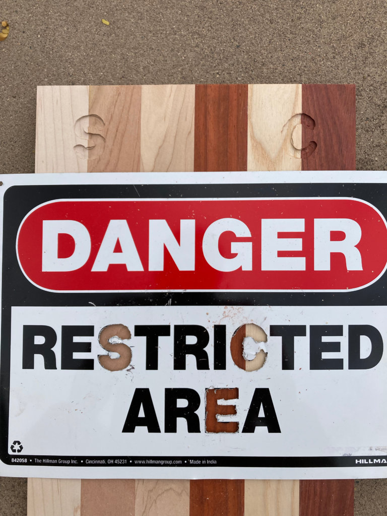

    Went to HomeDepot, bought a sign that I think describes my twisted mind. Routed out the E as a test, then C and S. After testing a couple of times I took the plunge. I think my brother (C) and sister-in-law (S) might be impressed by the letters filled in with epoxy resin. I do not care how rough it looks ... I like the "less than perfect".
