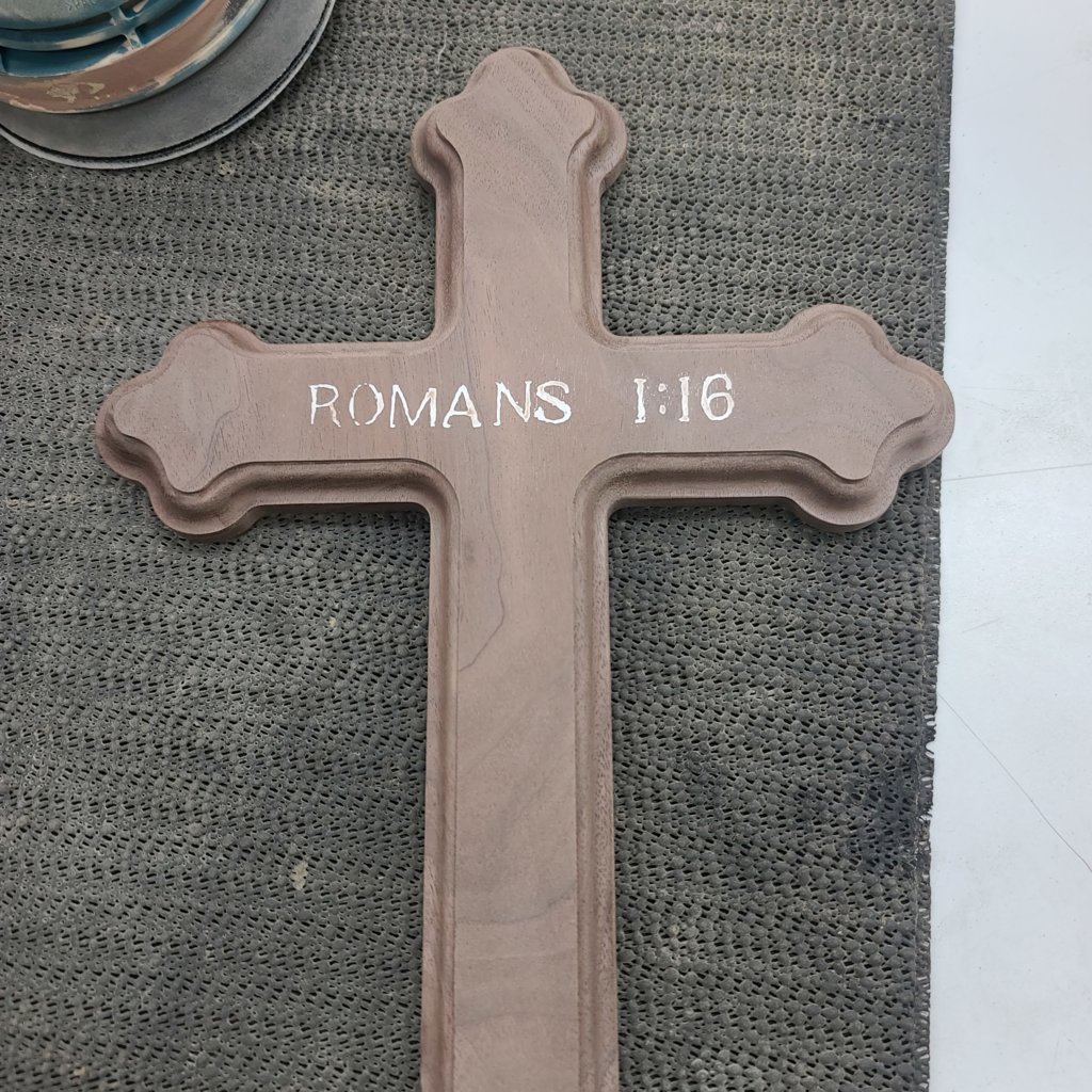

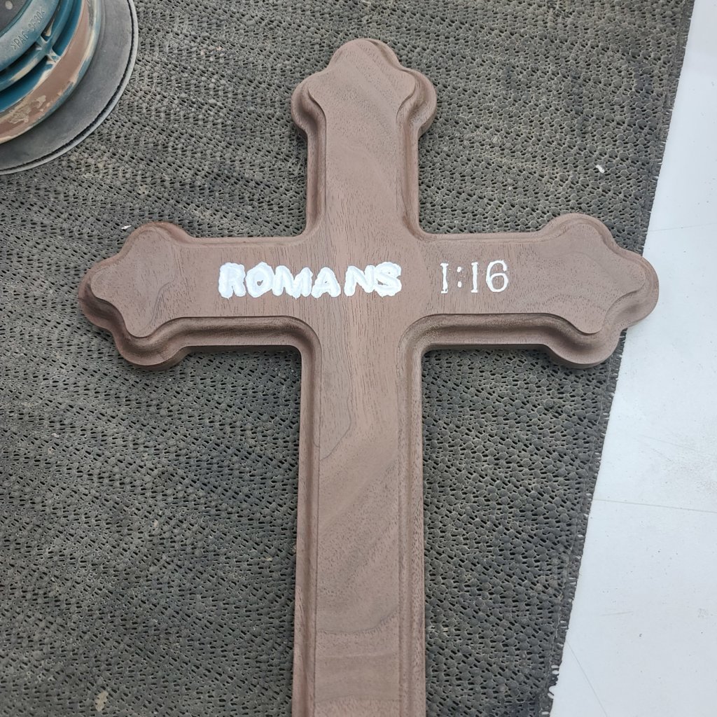

    I .ake failures too, Lol. I. Making this cross for one of my mentors at church. This is his favorite scripture quote.
    I used a Drexel with a fine point cone and then filled it in with a paint pen. But when I sanded the excess of the letters where too thin.
    So I changed to a ball bit and carved it all out and started over on the Roman word. PaInted it again and I'll sand it when dry. This will get a polycrylic finish when I get the letters done.
    Carving is not a skill I'm very good at, this is my first attempt at something like this.

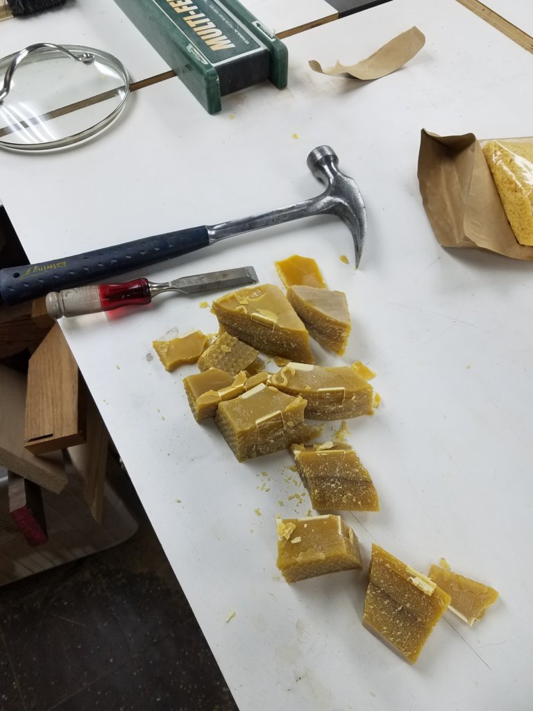

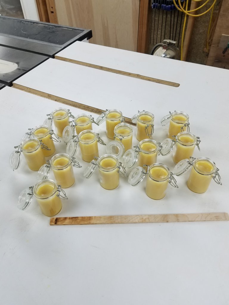

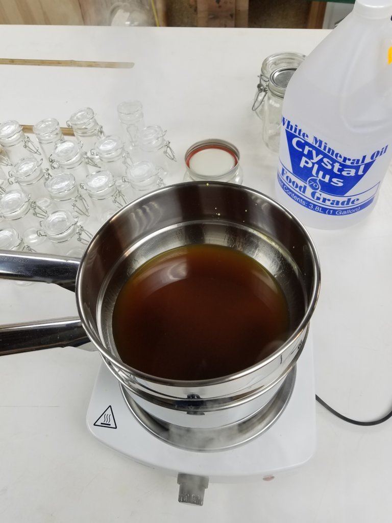

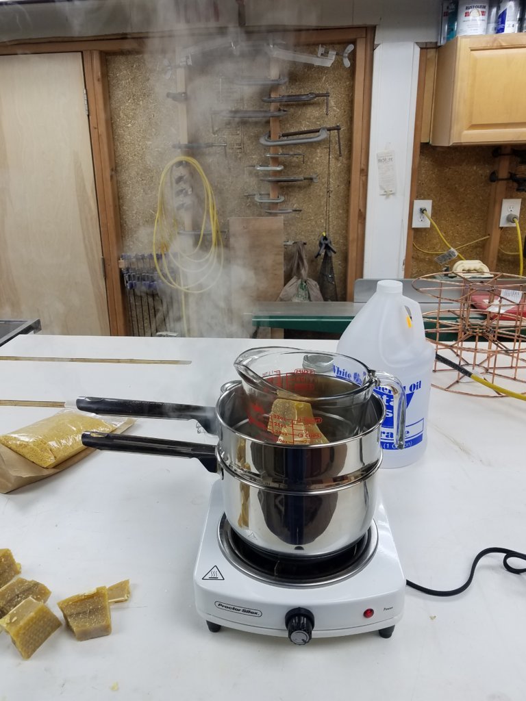

    Here's my process for making a mineral oil and wax blend for cutting boards and wooden utensils.
    I start with bees wax that I get from a bee keeper
    I melt the wax in a double boiler that I purchased just for this task. Don't use your wife's pans! Lol.
    A slow water boil. I melt it in the measuring cup first so I can measure the proprtions

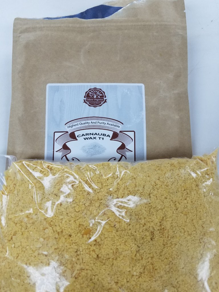

    I add a little carnauba wax that I get off Amazon. It makes the wax part a little harder and longer lasting.
    Melting the carnauba wax on top of the bees wax.
    Wax transfered to the pot.
    Add the mineral oil and allow it to heat up again. When you add the oil the wax will harden so you have to re melt it with the oil.
    All blended.
    I poured it back into the measuring cup to make it easier to fill the small containers.
    Then let it cool and harden. It's a soft creamy paste that is easy to apply with just a paper towel. Apply it, set it someplace warm, and then wipe off the excess a few hours later.
    I do the same thing with turpentine and blo and wax for a workbench finish. I use more wax for that. Write down how much you use in your batches so you can duplicate it later. 4 to 1 is a good starting point.
