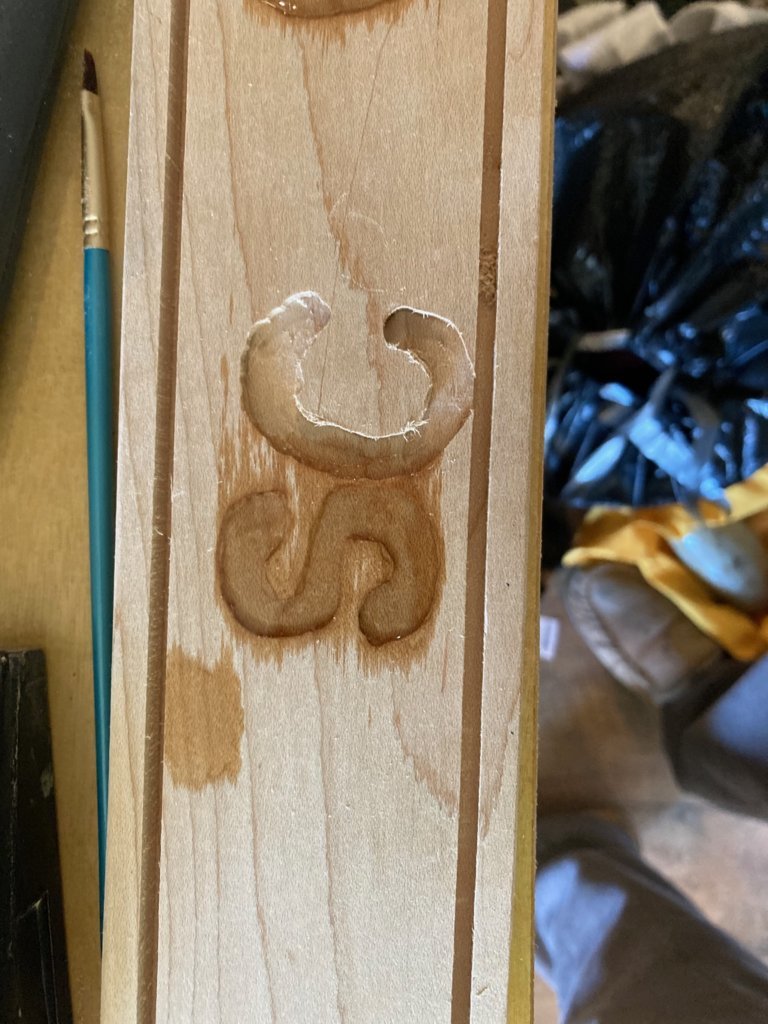

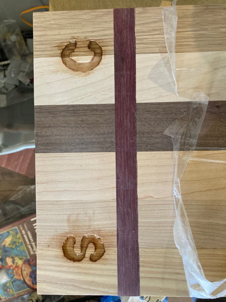

    I am mixing much smaller amounts (1.5 tsps total volume) so I sometimes question if enough hardener gets in.
    The fuzzy S is with a first attempt at routing the S into a board so could be ruined. I carefully poured the mixed resin/hardener to "level" into raw wood, but it crept out anyway probably due to that much mix all trying to flow/expand at the same time.
    So I went back to the main piece (other photo) to line the space with resin/hardener mix first with a brush. Still crept out a little (the shadows, but shadows are set now and will be sanded out later). This morning the just-lining-amount was sticky enough. I dripped 5 larger drops of mix into each letter, and re-added 3 drops of only-hardener to each to try to re-balance. Seems to not be creeping up/out. I think if I add 5 drops (each successive layer) on top of the mix that is at least not free-flowing that only 5 drops of fluid will not put enough pressure on the sides of the spaces to creep (fingers crossed) anymore.

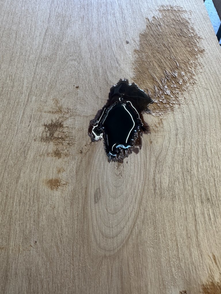

    I used this cheap stuff from Amazon when I filled the knot holes in my TV Console build with black tinted epoxy. No bubbles or other issues.
    I did a couple of pours until it was overfilled. Then I gave it a couple of shallow passes on the planer to clean it up. I hate how messy this stuff is.
    Here is one after finish.

    That won’t work- I mean maybe I am not reading it right but you must plane-sand-polish to flat fill

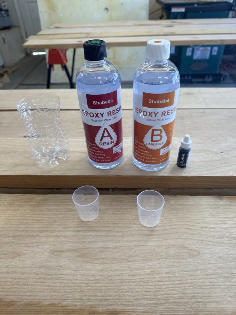

    That stuff isn’t terrible- I mean it’s a decent value. Slow cure - mix 50/50 and wait a couple days!
    It does have good bond strength and takes color well - and is cheap

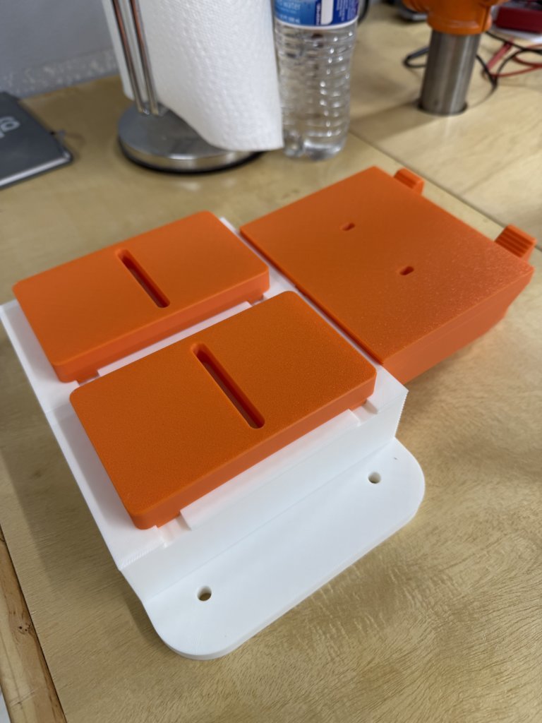

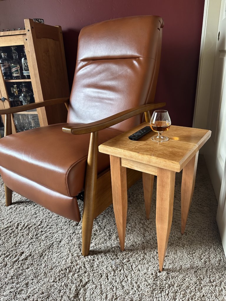

    Made this simple table to set my remote and drink on when sitting in my chair.

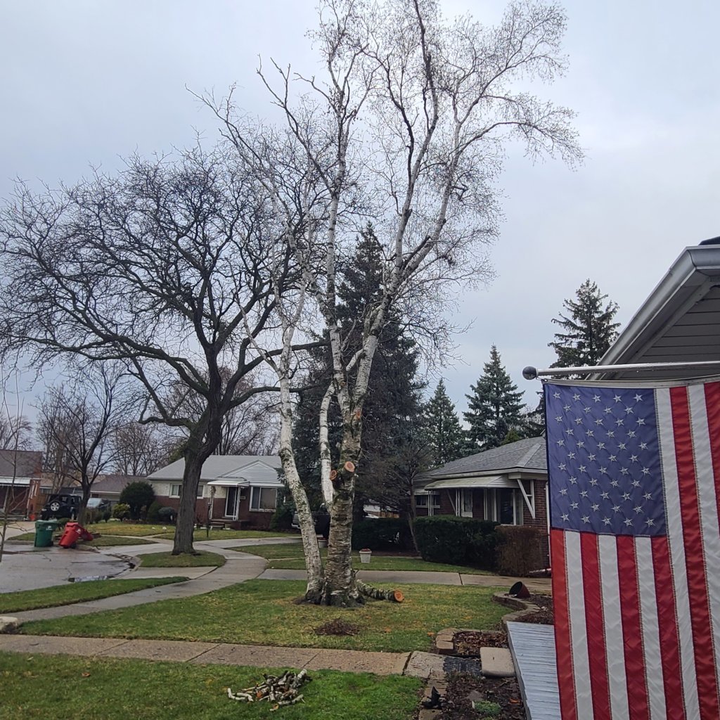

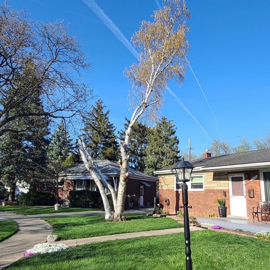

    The tree saga continues.
    What I started out with.
    I made good progress today until I personally ran out of gas, lol.
    Only to high branches left now, but they hang over the house. I have an arborist throw bag I use to get the ropes attached to the branches from the ground. But these are very high and I throw like a girl, lol.
    One of my neighbors helped us today to pull the branches over as I cut them. No chipper so all the branches are cut up and tied for trash pick up. It's a lot of work but I'm almost there. Doing the best I can with this 65 year old body and trying not to end up in the er.

    You should use one coat of a sealer like a clear poly not water based. Let it dry completely. Then add your epoxy. As far as epoxy goes get a kitchen scale and use that. Then mix to directions of the epoxy. For thicker pours you can layer. Small stuff like the letters you can pour to just overfill then sand down to flat.

    You do not sound negative or unapproving. This is just tricky business.That first fuzzy S was poured right up to board level with no side-wall sealing, but pushed itself past and would need sanding/cleanup.
    I am trying to minimize the cuttingboard surface sanding/planing I am trying to keep as much epoxy as possible inside the letters. I did get a sticky-finished layer inside the letter to block grain-seepage and am filling in thins layers (letters are only 3/16 in maximum deep) so that each next layer is only very light load to push against the sides.
    Seems to be working, and if it does it will be the path for future boards. I am not sure what the absolute best way is but anything that minimizes surface cleanup/sanding (I have only a random-orbit sander, no planer) while giving me less stress is a good plan.

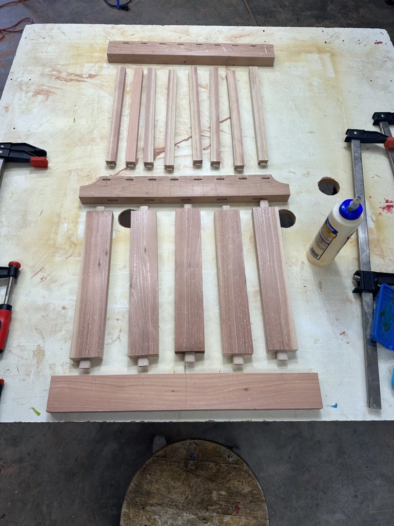

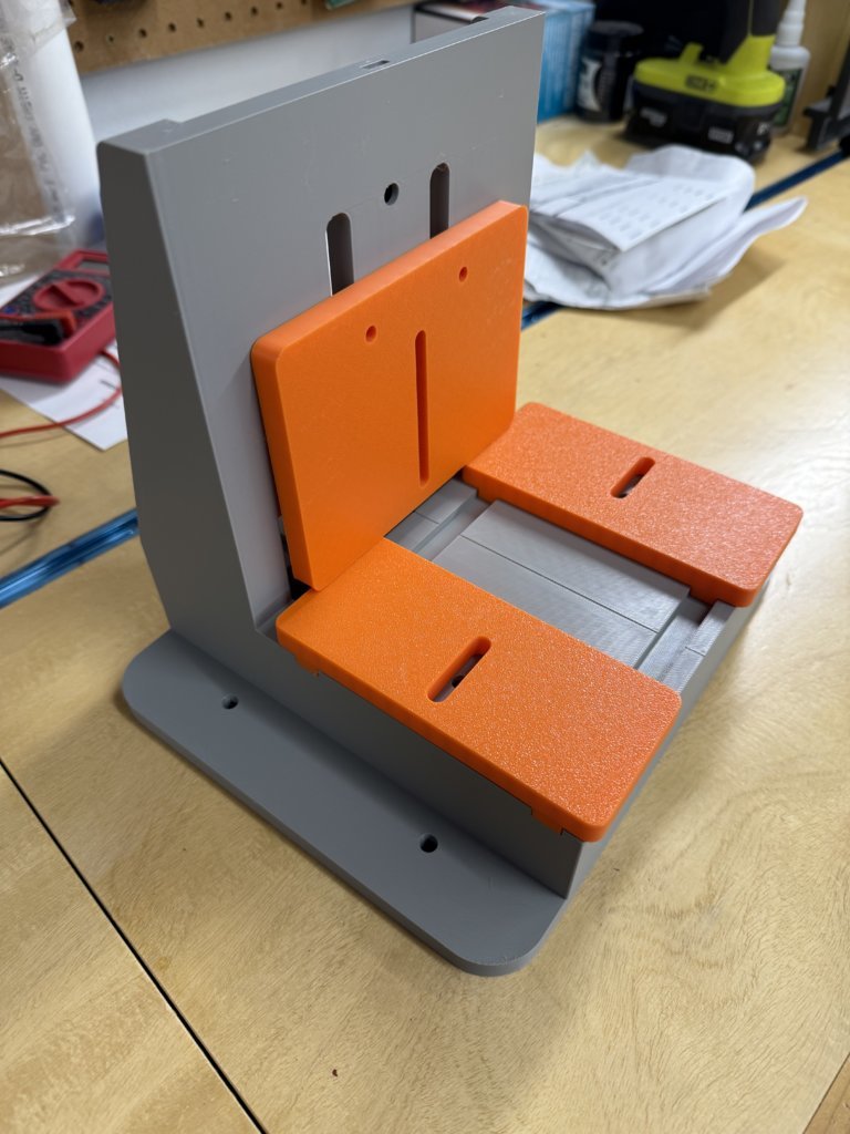

    Its a fixture that you mount the Festool Domino in that allows you to cut mortises in small stock, hopefully with accuracy and repeatability.
    Pablo8 and Pixeltim like this.

    Does it replace the circled piece or do something different? The circled jig is what I use when putting mortises in narrow stock. I used it for the slats on my chairs for example.
    wilcam47 likes this.

    Yes, I think its a more fixed version of that.

    I have not used it yet but my initial thought is that the one in the video is capable of more operations, theres probably some overlap but that thing looks slick.
