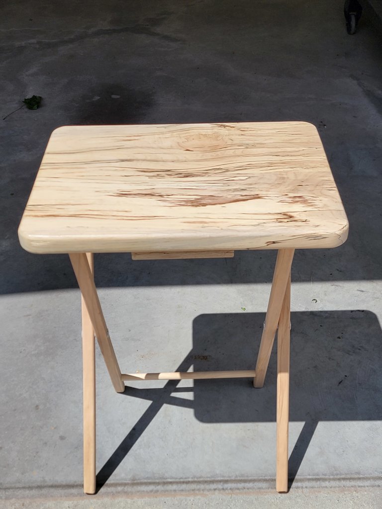

    @wilcam47 ... no river table but I did make a TV tray from that piece of wood.

    thats nice looking tray!

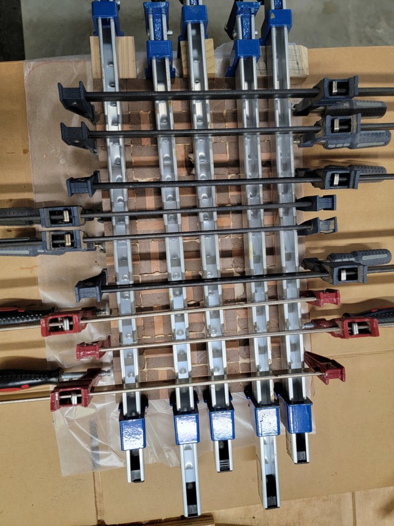

    I need more clamps.

    That pattern should look very cool. I have never made an end grain board and was wondering how you planning on flattening it?

    I have a drum sander that I use on end grain stuff.
    If it was small enough to fir in my planer, I would build a scrap wood frame around it the same thickness and plane it. I usually use scrap 2x4s and cut them down to roughly the same height so it's planing the 2x4 and the board at the same time. That way it helps prevent tear out and/or flinging pieces out the end.
    I could always use my router sled too, also with a frame if I didn't have the drum sander.

    I don't have a drum sander, nor a router sled. So, thanks for the tip on using a frame made of 2x4 and the planer. A drum sander may be in my distant future. I think my next big tool is going to be a lathe.
