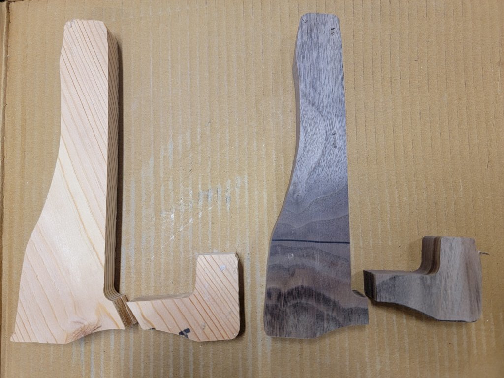

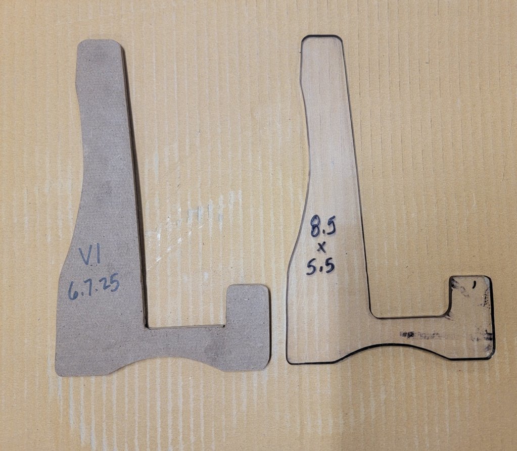

    Ok... I'm frustrated.
    I made the template from 1/4 inch hard board (left) to make the Lexan template on the right... i outlined the edge with Sharpie to be able to see it. I used my router table with a flush trim bit with a bearing and all went well.
    Since everything went smoothly I decided to proceed to some scrap wood... the pieces keep breaking at the bottom. Not sure if I'm putting too much pressure on them or if it's just a dumb design or if there's a better way.

    You trying to router it all at one pass? Id try multiple passes. Depending on wood type it will be a weak spot. Id run grains like this or use harder woods such as hickory or ash but still take smaller passes. Or use jig saw: and trace template then cut with jigsaw kinda close to line and finish it with the template and router.

    Im only using the template on the table to fine tune the lines.. I trace it on the wood and cut it out with the bandsaw and maybe taking a 1/16th with the bit... i may have to re think my design
