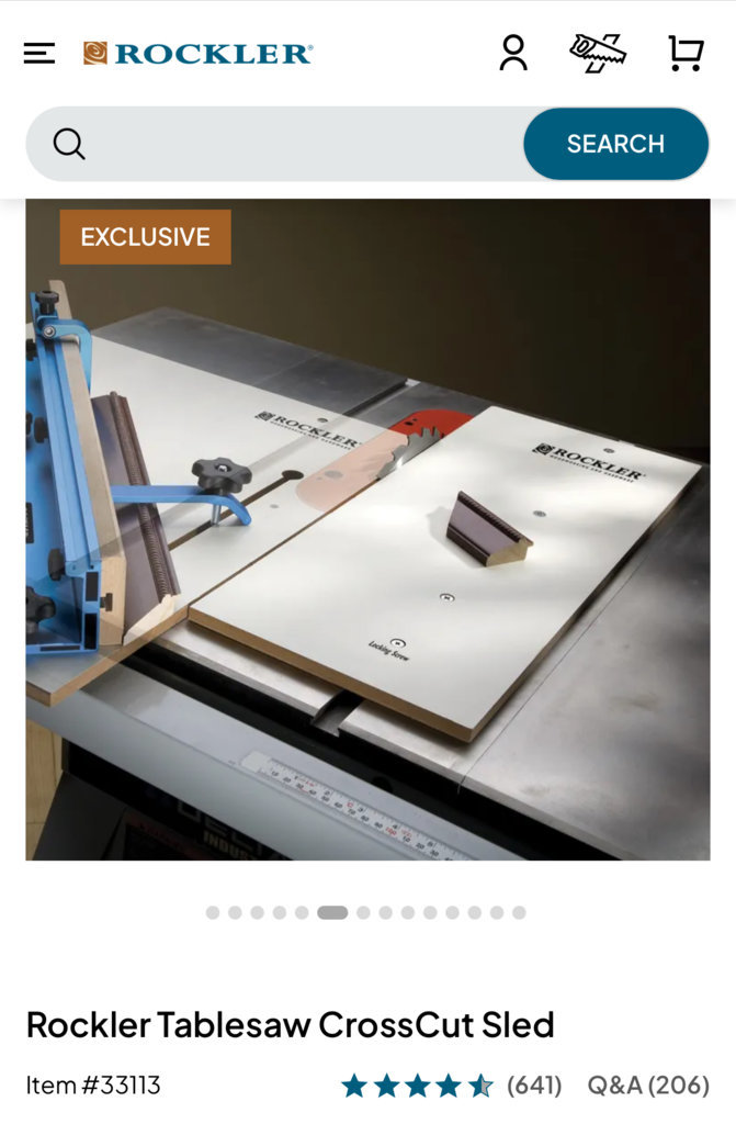

    I was shocked lately to see the prices of table saws. I think the Grizzly that I use is almost twice as much as I paid about 8 years ago.
    I have never really thought about the miter slots. My saw has two. I typically only use one sled and that is a Rockler Cross Cut sled that only uses the left slot. The right side, does not move, is optional and not really necessary. This sled uses metal runners.
    My old homemade sled that I scraped a couple of years ago used hardwood runners that I cut out.
    I do however use a regular miter gauge with an mdf fence in the right slot.
    I almost forgot since I do not use it very often, my tapering jig uses the right slot. I also have a cove cutting jig, that I have never actually used, that uses both slots.
    I guess that all of this is to say, one is fine, but two would be more versatile.

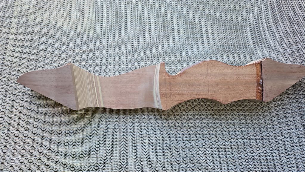

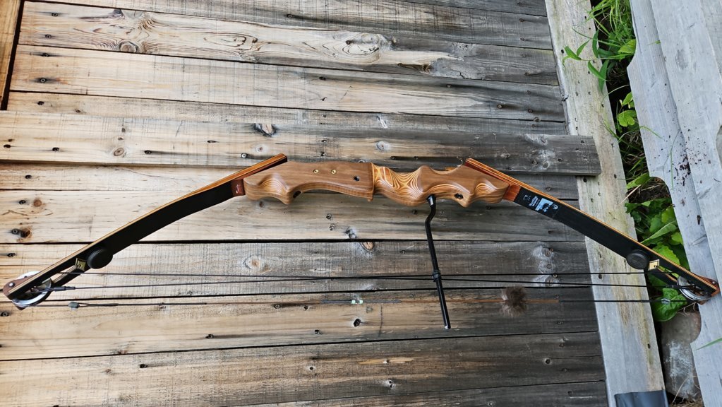

    Ok...here goes...
    I'm not much of a woodworker. But when I do it usually small stuff..

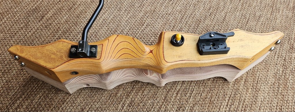

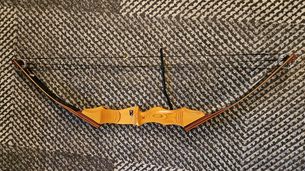

    This is a 1986-87 Martin Warthog Magnum.
    The blond maple laminated riser has 30+ laminates and Babinga veneers. In my eyes the maple clashed with the dark core and black glass limbs.

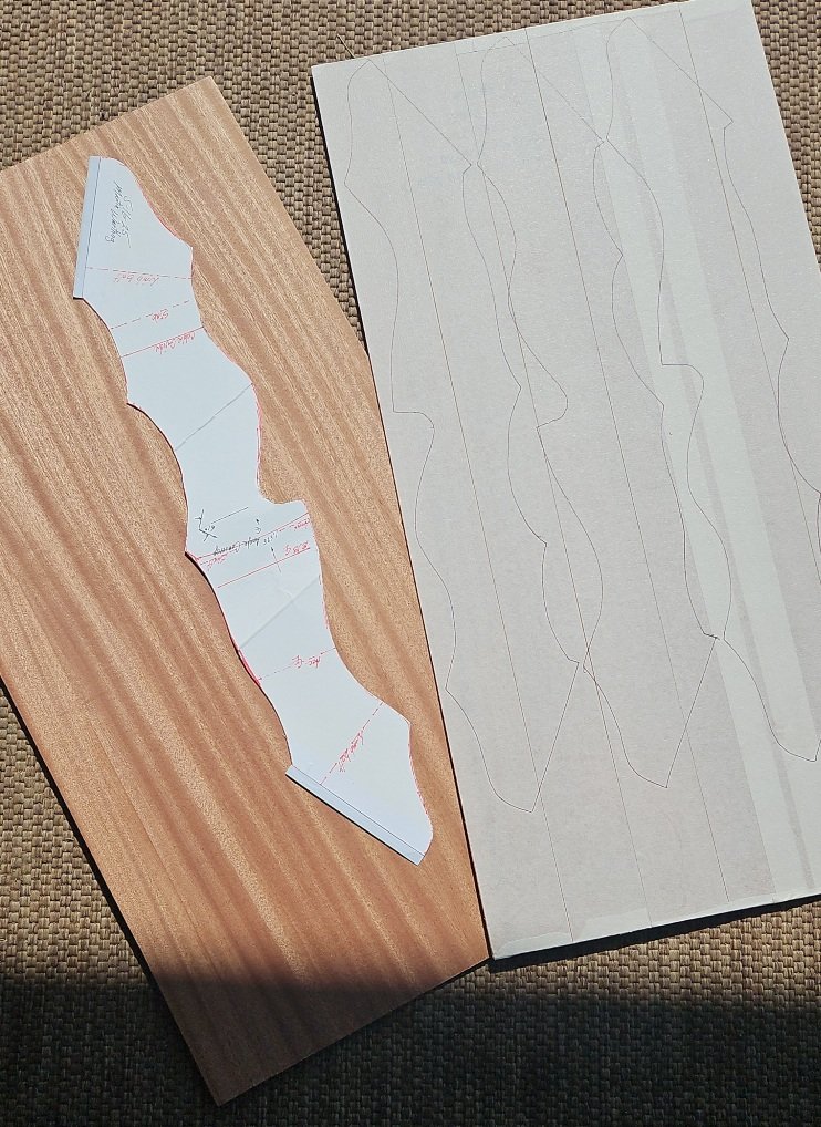

    So....I decided to make a new riser to better match the limbs.
    The new riser consists of 25 Mahogany/Birch/Mahogany 1/16" ply laminstions with 1.5 oz fibergalss cloth between each lam. Capped with cheeks of 20+ year old Walnut, harvested from my backyard after a microburst felled it.
    It took 3 weeks to lay up the block. 95% of the carving was done on either a belt or drum sander. The sight window was milled out.
    It took a week to hand sand it to 400. Then 3 coats of Satin Spar Urathane.
    You really have to view it in the sun to appreciate the depth and grain shift of the Mahogany.
    I have not shot it yet due to recovering from an injury, and it's killing me not to.
    I have shown it to a few guys I shoot with and they drooled over it.

    Nice work!

    same . . . that turned out great!
