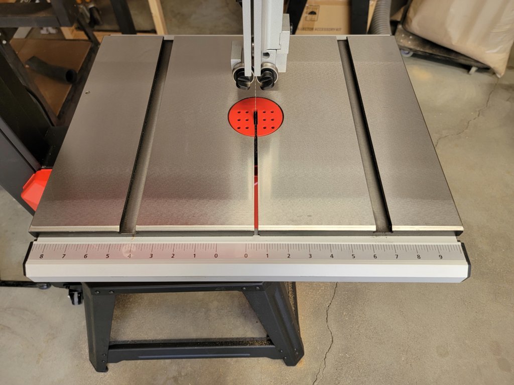

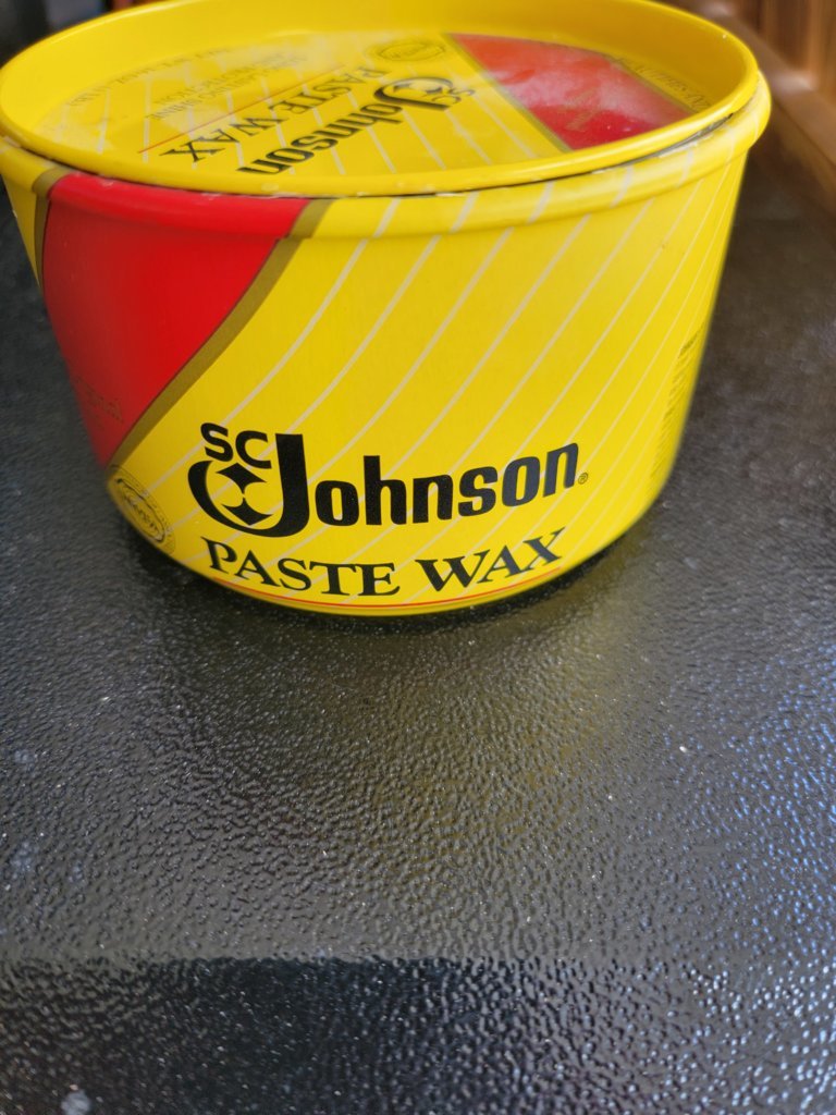

    On tools with cast iron tables like bandsaws and tablesaws, I've found using a paste wax works best. It only takes a bit of time to save headaches later. This can will probably last well after my lifetime.

    Oh.. I might have upgraded

    Been using that for many years. Still on the original can and it's still half full. I bet it will outlast me. I'll will it to my daughter! LOL

    When I was in high school, I worked in a good sized print shop.
    A can of paste wax was on the table of the paper sheers (giotines) to assist in the large sheets stacks of card stock sliding on the table.
    We waxed the table at the beginning of our shift...at least.

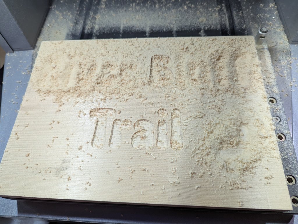

    just helping out someone's eagle project with some signage...

    That's a good thing. They don't make it anymore. I have a can of that and a can of minwax. And I also make my own with turpentine and wax of your choice.

    That’s the good stuff, make your table saw smoooooth

    I wasn't aware they discontinued it!

    Thanks California and Michigan. No voc's, it has solvent in it.
