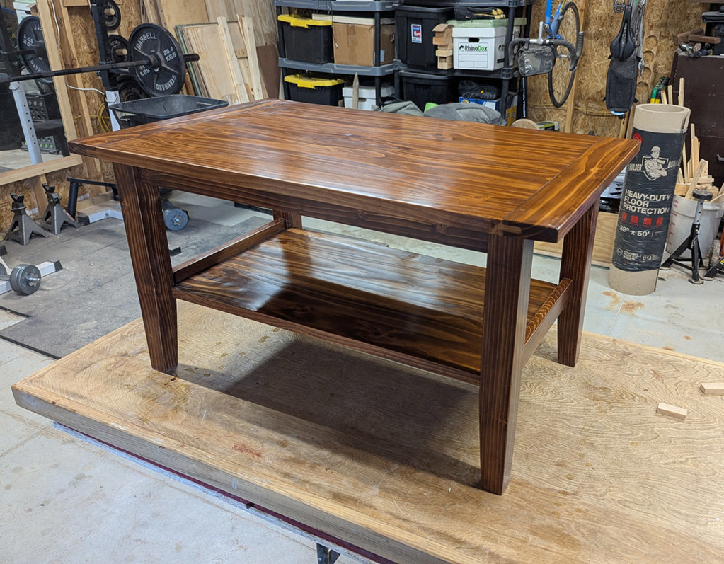

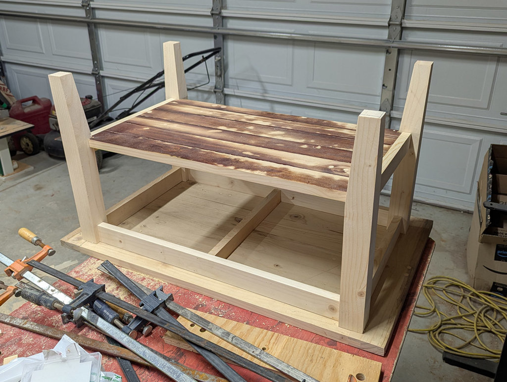

    I completed my first furniture project in several years last week.
    It's a basic coffee table about 30"x20" and 18" high. I used dowel joinery and it's made from reclaimed/recycled/free wood, and used old stain and oil based polyurethane I had on hand. The only things I purchased for the project were a set of 5/16" dowel centers, a box of 5/16" dowels, and sandpaper. Took about 2.5 weeks working a few hours here and there on evenings and weekends
    I didn't need a coffee table, but I had the itch to make a wood project and didn't want to invest too much into my first project after a long woodworking hiatus. My plan from the beginning was build the table and then list it on marketplace, but I have no idea how much to list it for because I spent way too much time on it for the mediocre result haha.
    Progress pictures I took along the way:
    Early rough mock-up
    Dry assembly of frame
    Upside-down dry assembly with shelf
    Rightside-up dry assembly
    Tabletop after sanding, before stain. Pegged breadboard ends.
    These boards were pieces from a bed frame and had several existing holes that needed to be plugged as well.
    Stained top
    All pieces stained
    Glued/assembled frame
    Completed.
    4 coats of oil based polyurethane. Final smoothing with 0000 steel wool. Hand buffed Johnson paste wax.
    I'm happy to have completed another project after several years off, but I could tell it's been too long and I was out of practice. Learned some lessons and I'm looking forward to the next project hopefully going smoother.

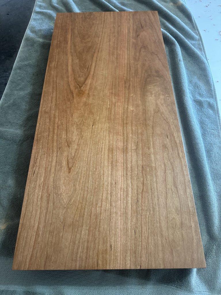

    Finally finished the Hard Maple and Cherry shoe rack. It will live at my sister’s mountain condo in South Lake Tahoe where shoes will be wet and snowy in the winter. She wanted glossy, so I sprayed on a gloss spar urethane finish.
    The top before installation.

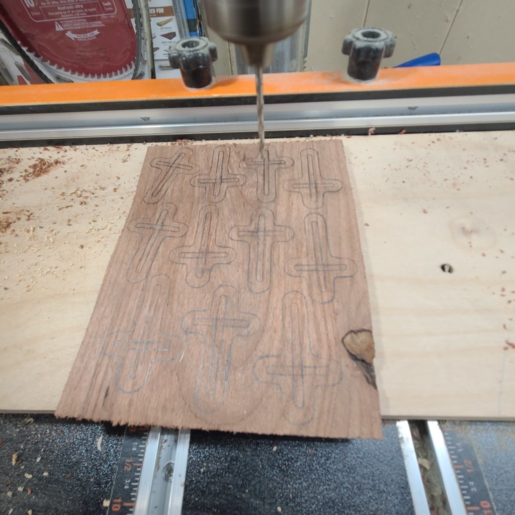

    The I drilled about a 100 or so holes.
    Next will be lots of scroll sawing.
