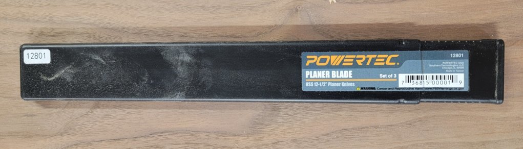

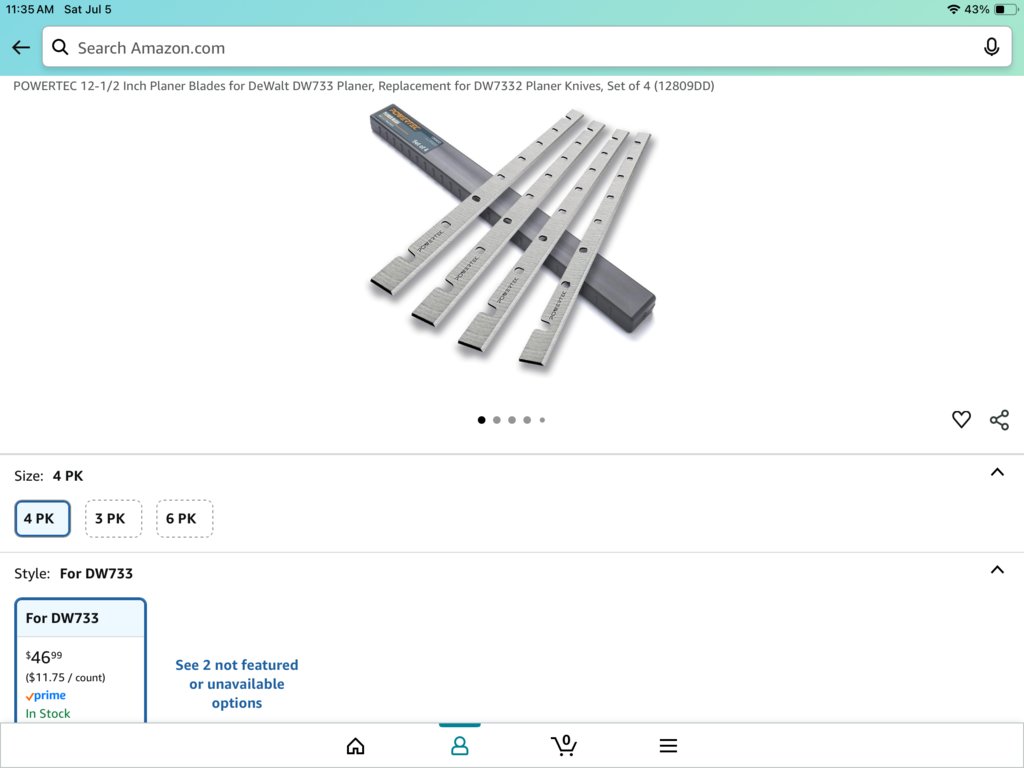

    I just picked up new planer blades from Ama zon for like $28 a set ... no way im paying $80 a set from Home Depot

    That’s the brand I bought, no complaints

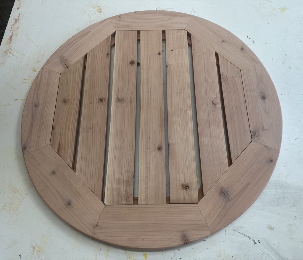

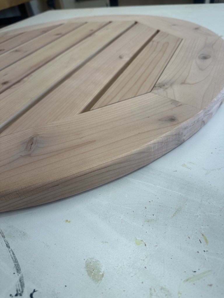

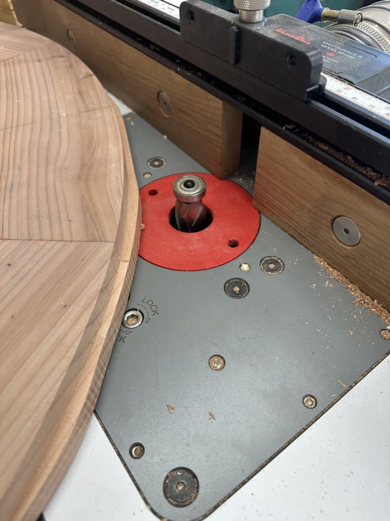

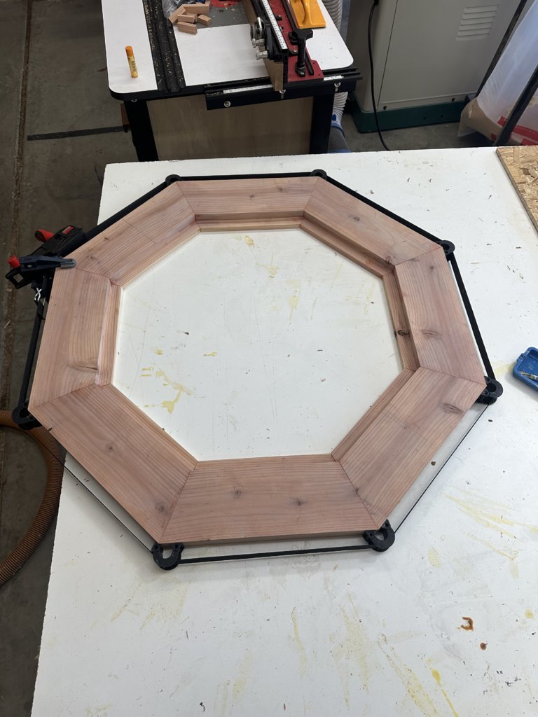

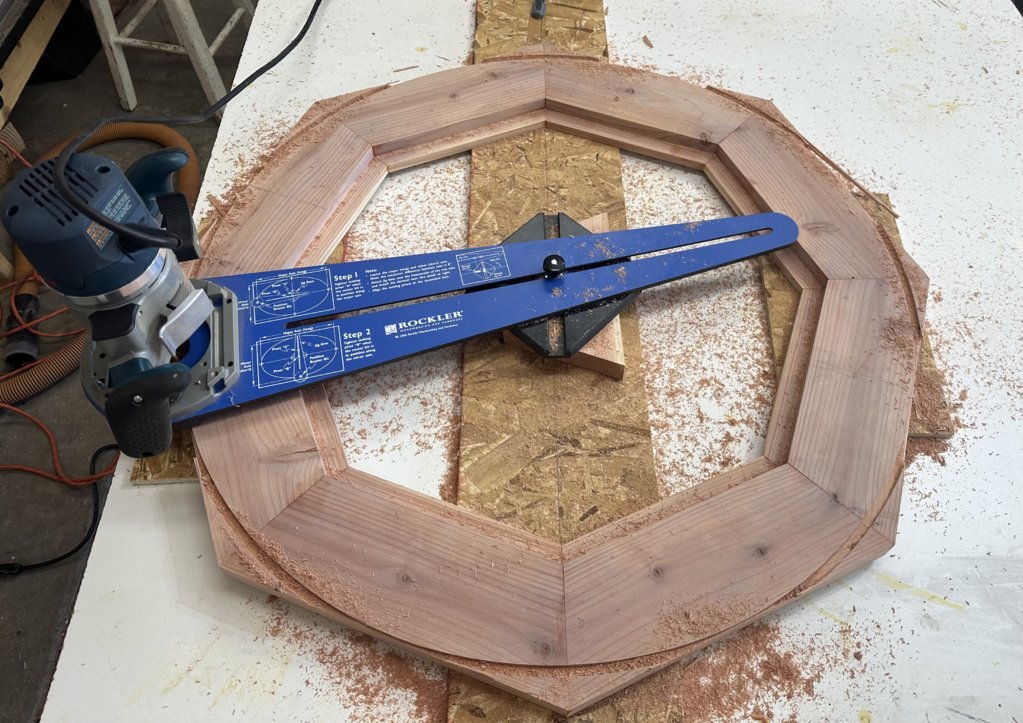

    Making a circle can’t be that hard, right?
    Glued up the octagon this morning.
    Made 3” x 3/4 slats while the glue was drying.
    Made one pass with my circle cutting jig.
    Cut the rest with the bandsaw, then moved over to the router table and my big compression flush trim bit.
    I rounded off the edge with a trim router and 1/4” round over bit .
    Slats are dry fit for now.

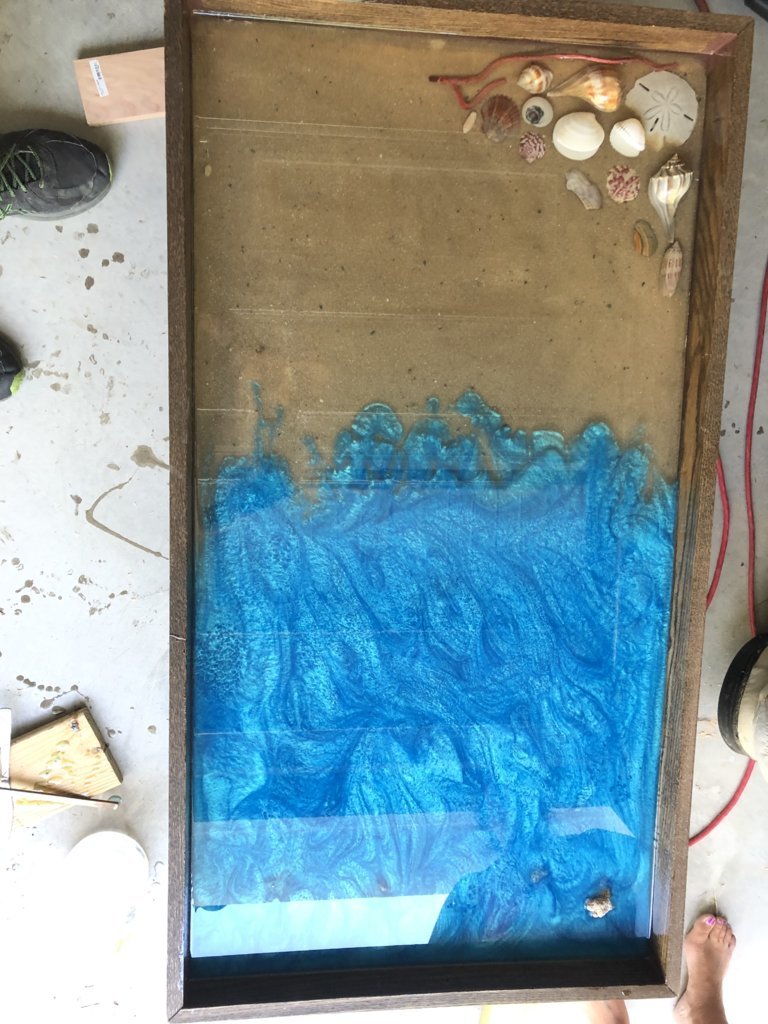

    lol I said the same thing when I first saw that guy post that project on IG. That’s got to be 6-700 bucks worth of epoxy
    still a really cool piece

    Heavy AF too

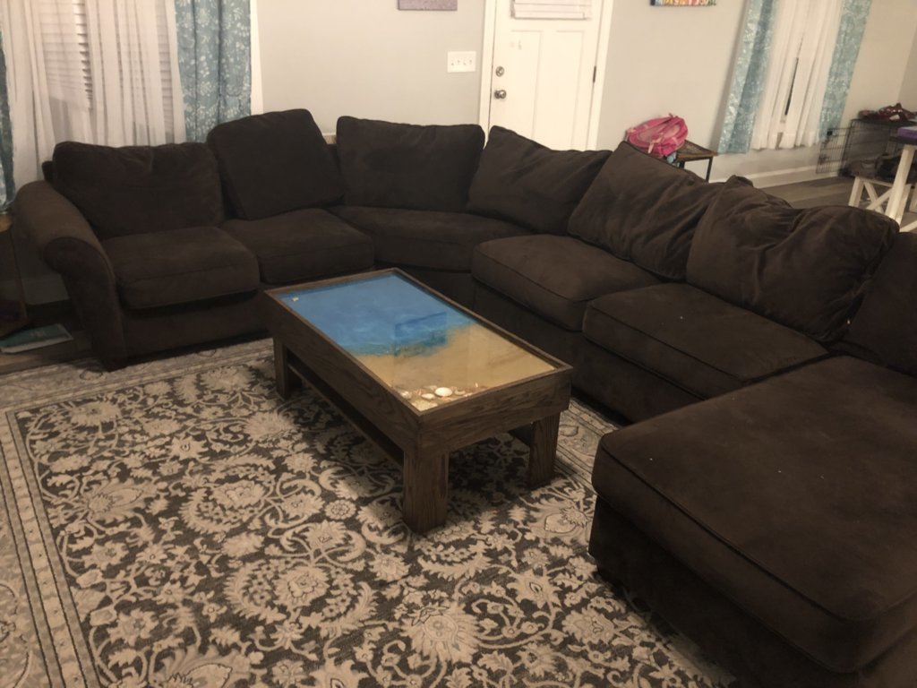

    My coffee table was about $600 in epoxy and it probably weights 200lbs :anonymous:

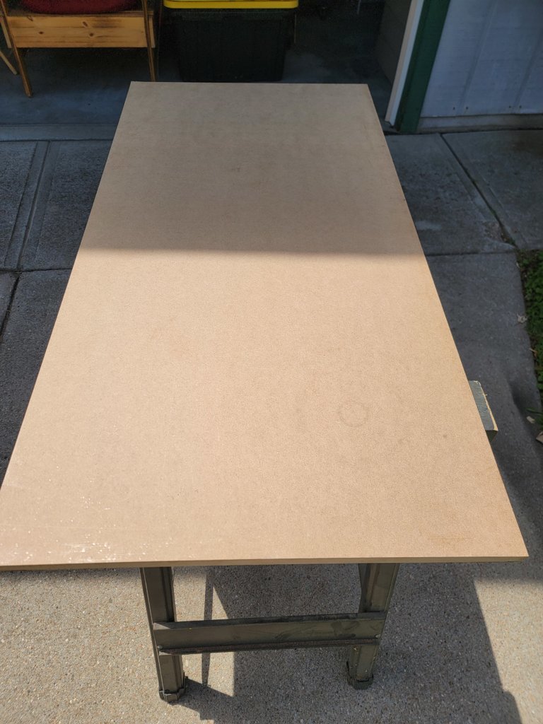

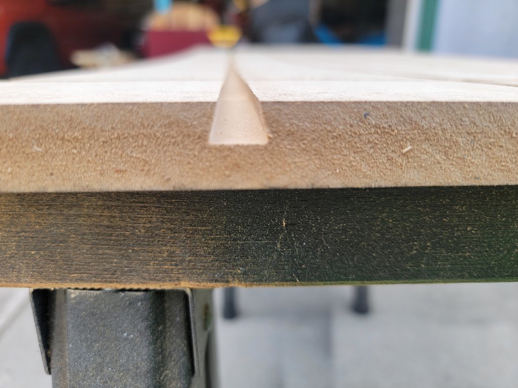

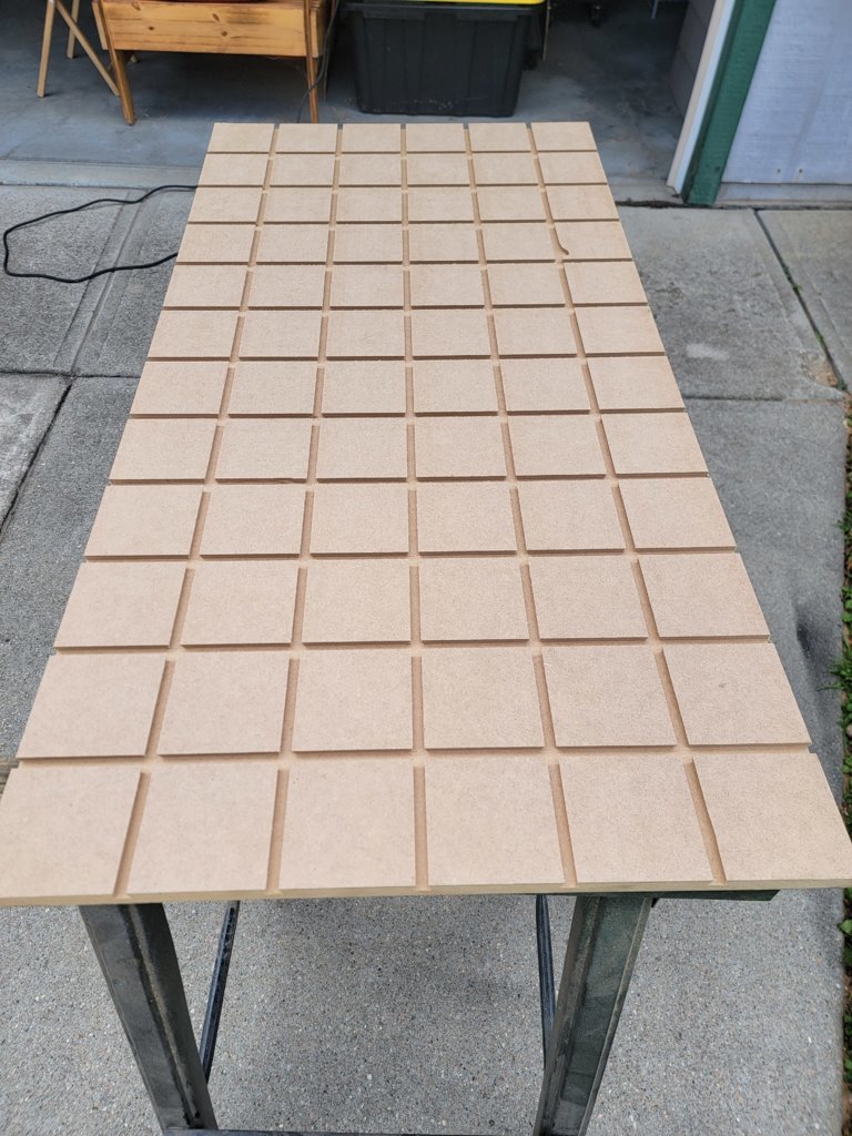

    3/4 inch MDF before and after cutting dovetail grid

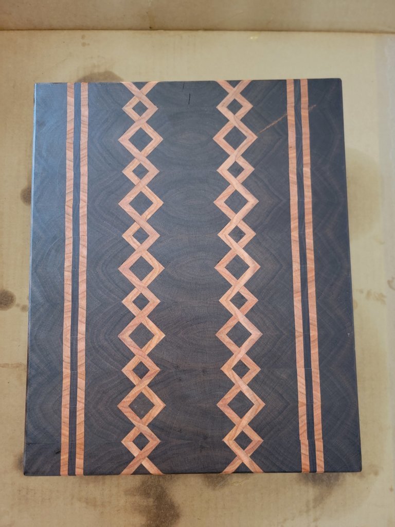

    Finished this Walnut and Cherry board

    That’s sick!!

    Looks amazing.
    How about a few in progress pictures so people like me can actually understand how you accomplish these cool pattern?
    I haven’t made a cutting board since pre covid. Maybe after I get through the next few projects on my list.
