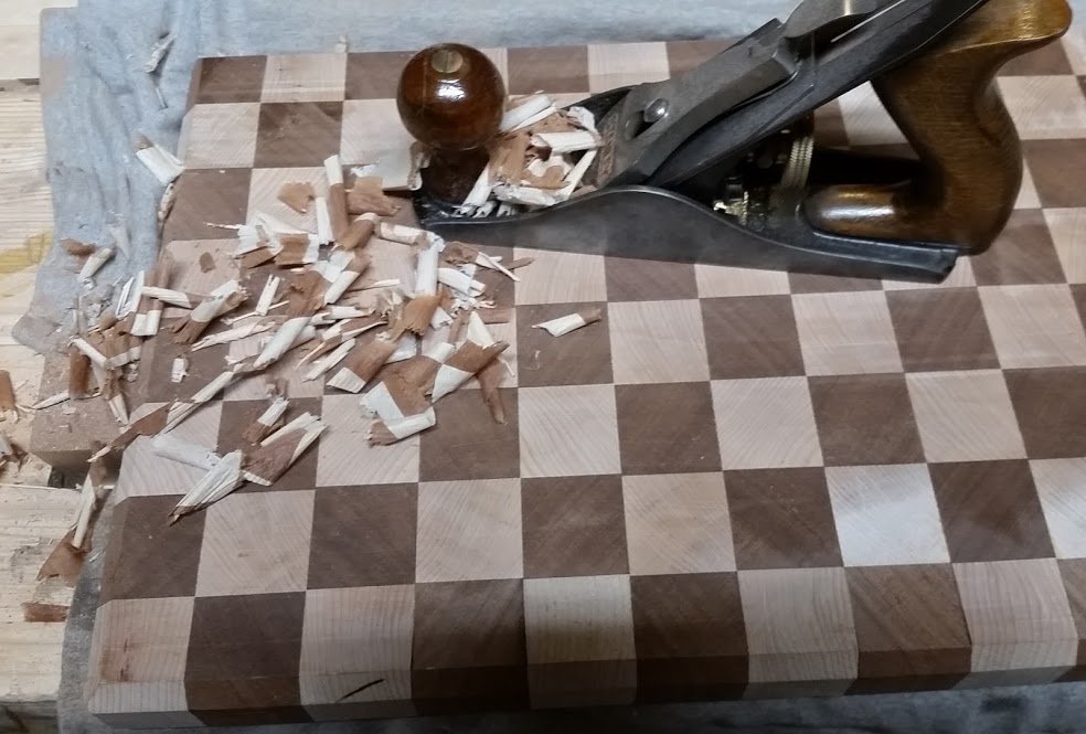

    The first set (regular checker board style), i actually hand planed. It wasnt too bad, keeping a sharp iron was key. The second set (plaid style), i ran through with a fresh set of knives on my DW 735. The first pass ended up nicking the blades, and i had to sand out the ridges.

    No planner after the glue up. End grain and planers don't go well. I wish I had a wide belt sander that is like a planer.

    True, but the glue failing usually isnt the issue, its the different woods swelling/drying at different rates after being wet, that causes the boards to crack.

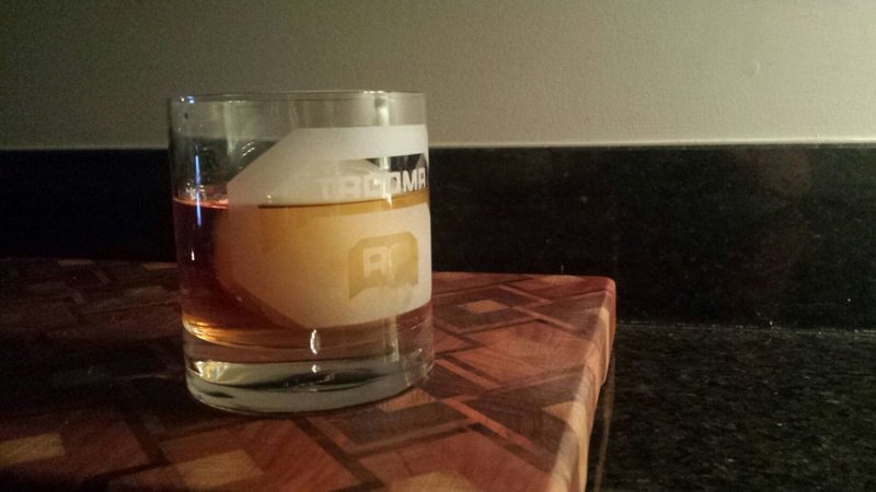

    This is the only one I can find right now. This was right after I made it.

    The glass was a tw secret Santa gift a few years ago.
    If you take care of the cutting board it will look like that forever. So might as well use it.
