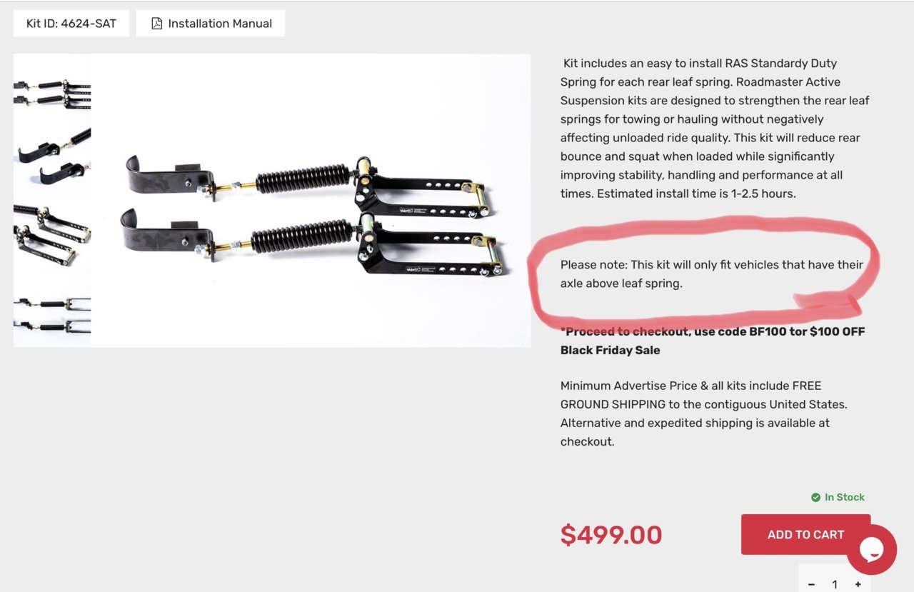

    Hi all. I checked out the roadmaster active suspension. Put in my specs…2015 Tacoma 2WD.
    They showed their product but states it only fits vehicles with axel above the springs. Anyone have a set of these on a prerunner 2WD? Thanks in advance and happy thanksgiving to all!

    Take a look at Hellwig helper springs.
    https://www.hellwigproducts.com/product-list/helper-springs/
    Looks like EZ 990 would fit your rig (scroll down till you find the right fit).
    I’ve had the helpers on mine for the past two years and they’ve done the job with no issues. Save you some money as well.
