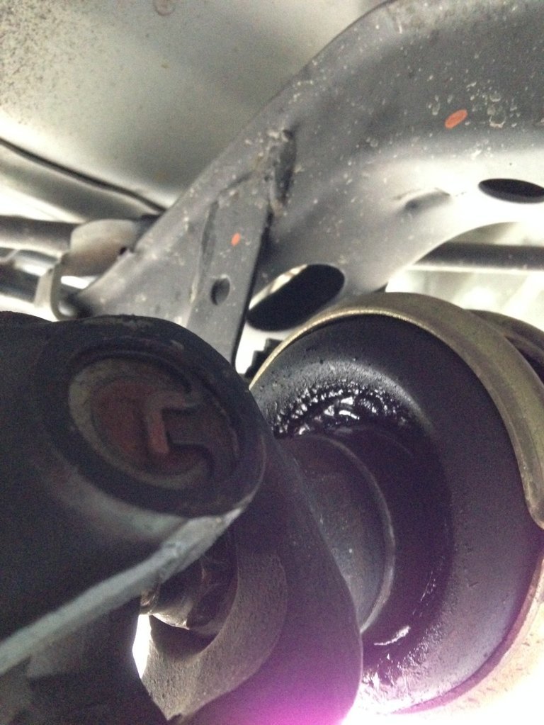

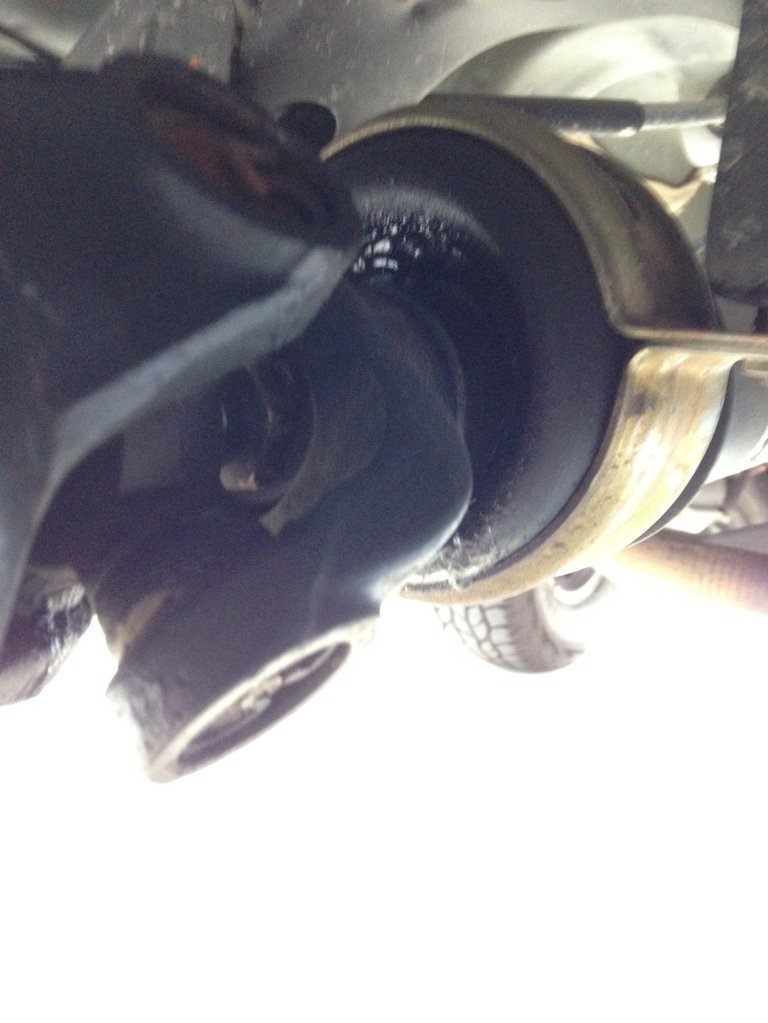

    when you start having driveline shudders, and the bearing has play in it or starts to squeak.

    I found a receipt from the last owner when they got the frame replacement a few months ago before I bought the truck. Says the carrier bearing needs to be replaced. haven't looked yet though. going to see how much play is in it later. I get a nice clunk sometimes though, hoping its the carrier bearing and not the U joints

    I did it a while ago. $80 for the part. I used the link as a guide, worked out pretty good.
    My bearing was good, it was the rubber that failed. The shaft was spinning on it a squealing. I filled the new one with silicone to give it more support; worked great.
