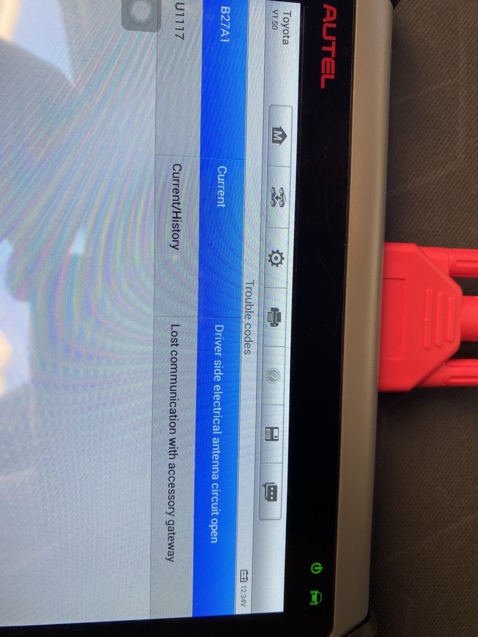

    Anybody can help him with his code

    The Diagnostic Trouble Code (DTC) B27A1 is detected by the Certification ECU (Smart Key ECU Assembly) if an open circuit is detected between the Certification ECU (Smart Key ECU Assembly) and front door outside handle assembly (for driver side) terminals.
    What are the symptoms, or is it just some erroneous code that was stored a long time ago and you are now just reading?

    I can’t open the door with the thump press

    Then I’d check the wiring, I *think* a dead Door handle module will give you a some form of communication error not open circuit error. The wiring would be anywhere between smart key ECU and door handle.
    There is another thread with a link to Toyota’s “testing procedures” that provides a ton of info and module locations.

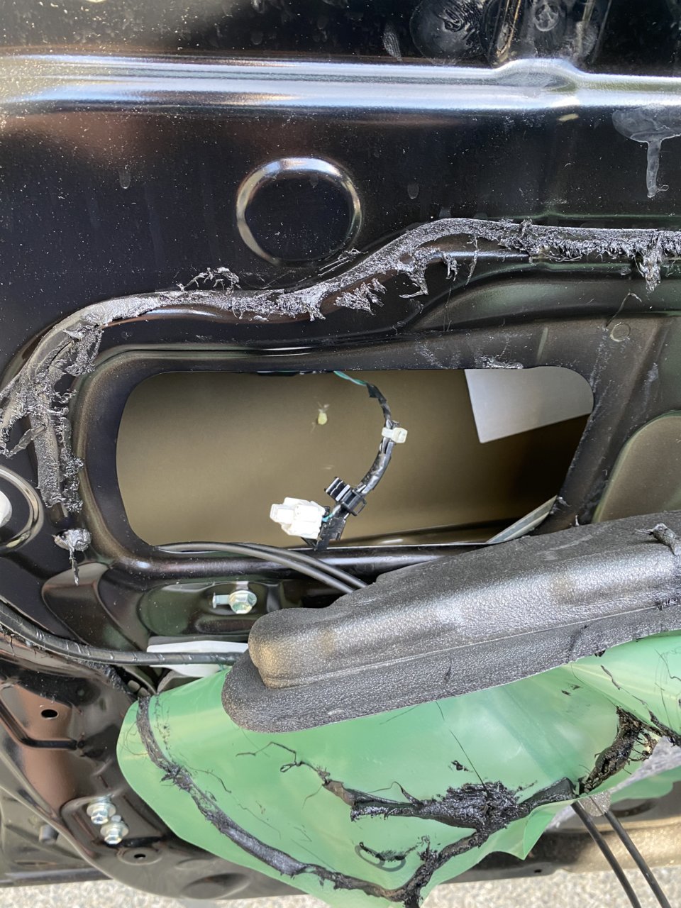

  7. Jun 20, 2020 at 6:39 PM
    AlbTaco
    AlbTaco [OP] Member
    Jun 16, 2020
    #331623
    13
    Ron
    2017 Black TRD off Road
    I open the panel 075FC262-AC5A-4B4B-8895-696C44DBCD43.jpg door and was just this lol unplug wire
  8. Jun 20, 2020 at 6:59 PM
    mutely
    mutely Well-Known Member
    Feb 15, 2017
    #210640
    1,848
    TRD Pro in metallic primer
    Glad you got it sorted
