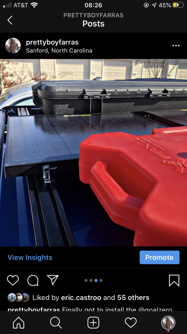

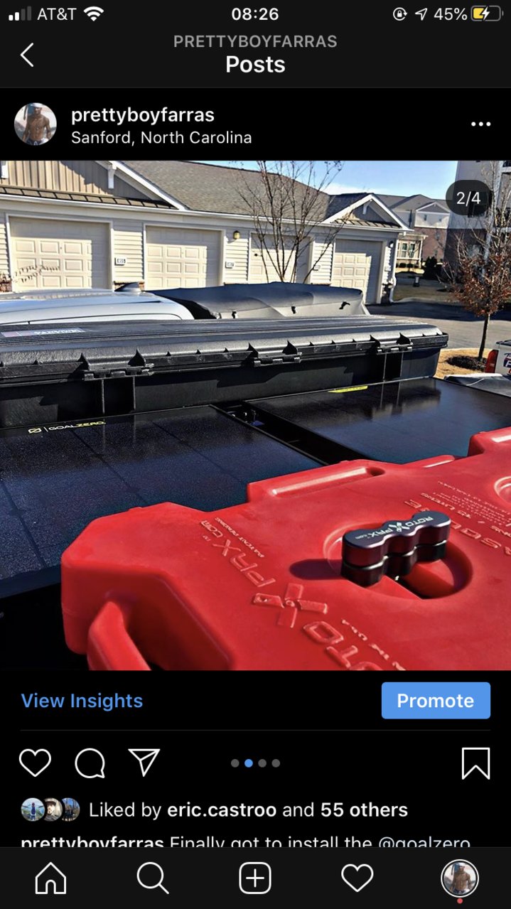

    My truck is an sr5 and I was thinking of putting a solar panel on top of my roof between the rotopax and the pelican and wire it to the bed to something like a goal zero power station. Did anybody attempt that? I found a dude on YouTube but he has the power supply in the cab. I’m more interested in someone who has done it and hooked it up to the bed and made it a clean OEM look. Maybe hide it in the back or something. This is the video of the dude on YouTube that attempted it. I’m sure he is on here so shout out to him:

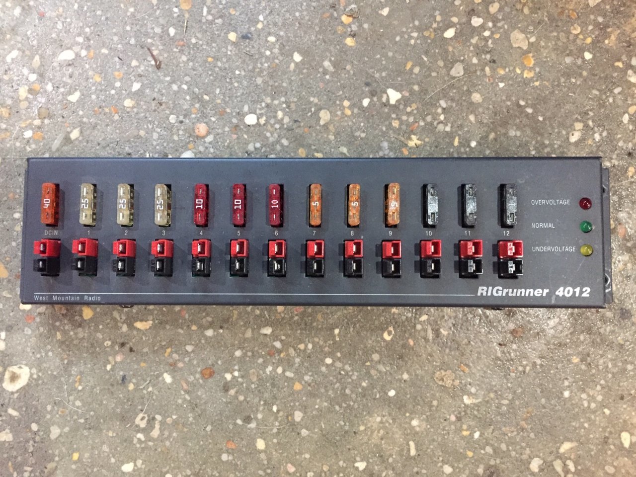

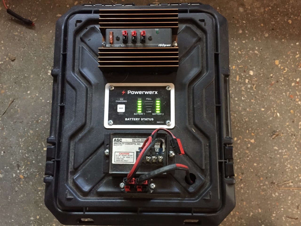

    I use two large panels on my Yakima rack. Made mine so that I can take them on and off as I want though. I use them mainly for emergency power for radio equipment during hurricanes etc. I just mounted the charging equipment and deep cycle batts in Ammo boxes from Academy that we’re on sale. They can be charged by the vehicle, solar panel(s), or generator as needed. Gives me lots of options and flexibility for powering radios, laptops, inverters, and can easily be moved from one vehicle to another or even left to power a base camp.

    went really good actually I went with everything Goal Zero including top Solar Panels on the roof and it’s been working good so far

    Looks killer man! Great job!

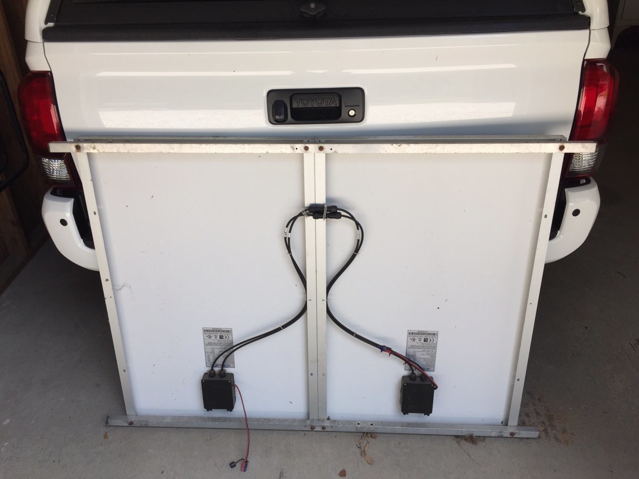

    Im running the Victory4x4 rack. Wanted something that didn’t affect my ability to put stuff up there. So I sandwiched some little panels between the cross bars. A whopping 30watts! Then I used the Renogy wanderer solar charge controller. Pretty much just a trickle charger during the day.

    Are those their Boulder 50 panels? Looks good

    Carlos - that's a really good solution. Can you flesh out how you did it a little? How do you secure the panels to the rack pieces? Thanks.

    nothing exciting, just removed the aluminum extruded crossbars from the rack. Made 2 holes each side of the panel frames. Put the hardware on the crossbar, then the panel on that, install the nuts from inside the panel frame. When done you have all three panels and both crossbars as a unit. The take the whole unit and reinstall onto the rack.

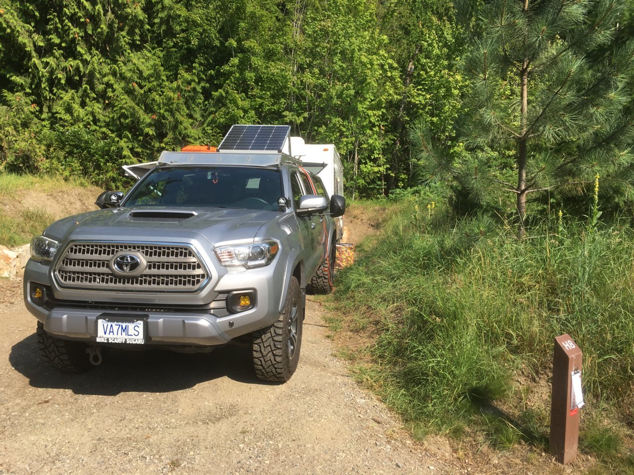

    That's awesome, I've been contemplating doing a more permanent install on the Prinsu. I've already got a 100w panel that goes up top while camping;

    I did a full panel on my roof rack. Really wondering what @ApacheComa used for his. The Goal Zero Boulder 50 is 21.75" wide where mine is 20.5" wide. I definitely don't have space for Rotopax on the roof. I have maybe 10" of open area left. I've got a 42" Plano case up there, so maybe his is thinner?
