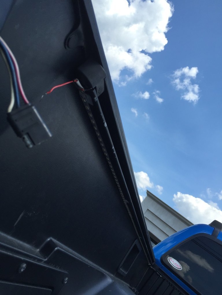

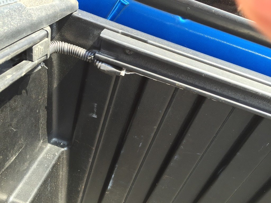

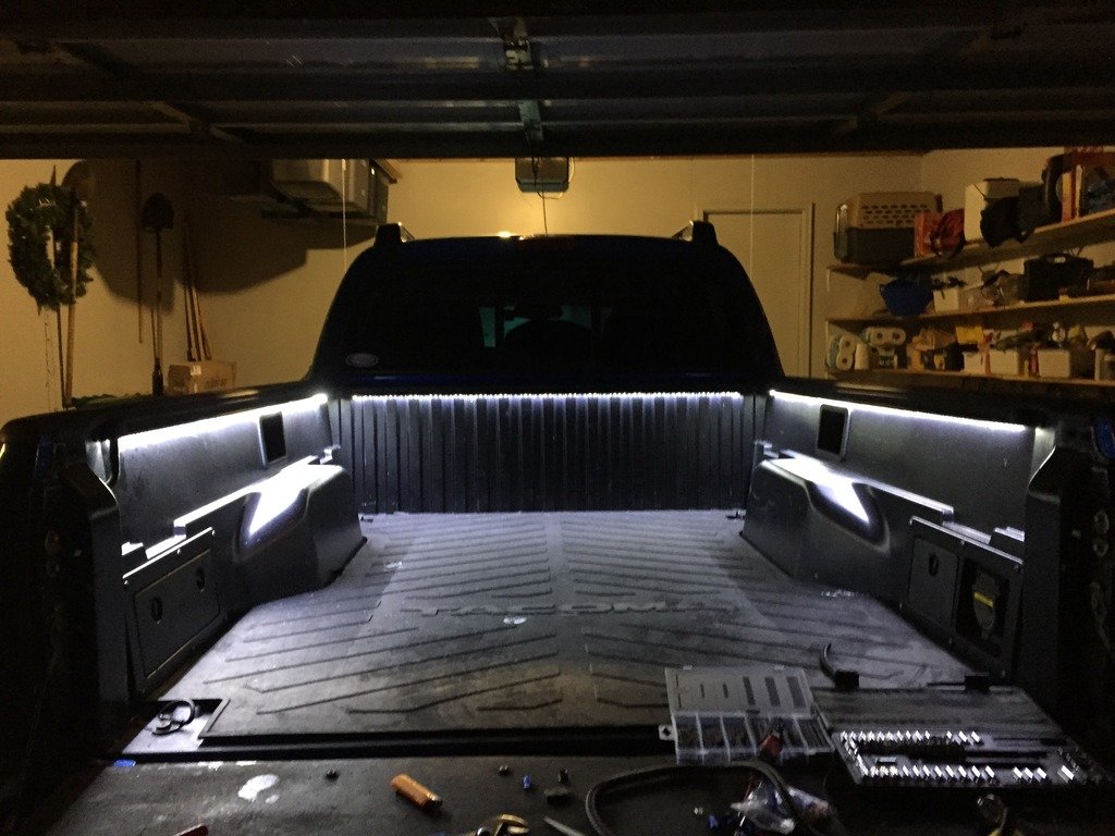

    I vote LED Strips under the rails, depending on how crazy you want to go with accessories it can be done pretty cheap. You need a switch, wiring to run from the back of the truck to the front, these lights LED Strip Lights, an couple of connectors for the corner THESE(i have a couple I could send you if you go this route). I did this a few weeks ago and spent quite a bit but only because I used @Iggy. 's switch panel, OTRATTW switches and installed a Blue Sea fuse panel at the same time. If you decide to tackle it and have any questions let me know, I am wiring illiterate and I figured it all out it just took a bit. Here are the results.
    It is REALLY bright in person.
    Here are the corners.
    Here is the view from the bottom(before it was wired up obviously)

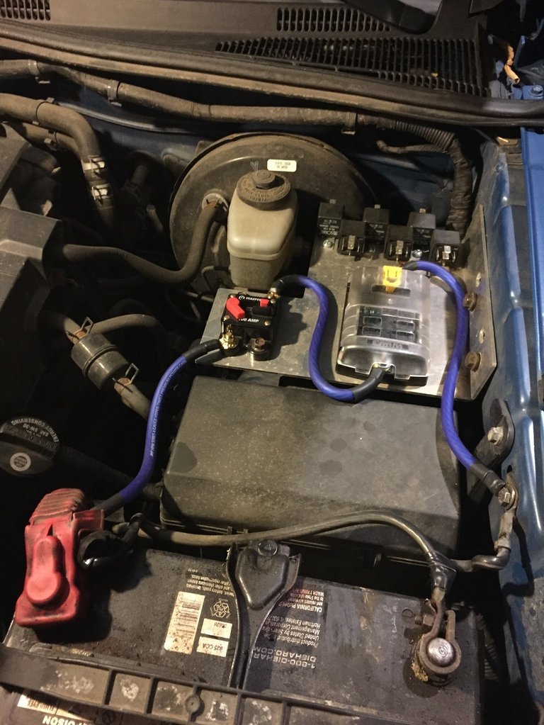

    Here is the fuse panel all wired up in case you want to get crazy...
